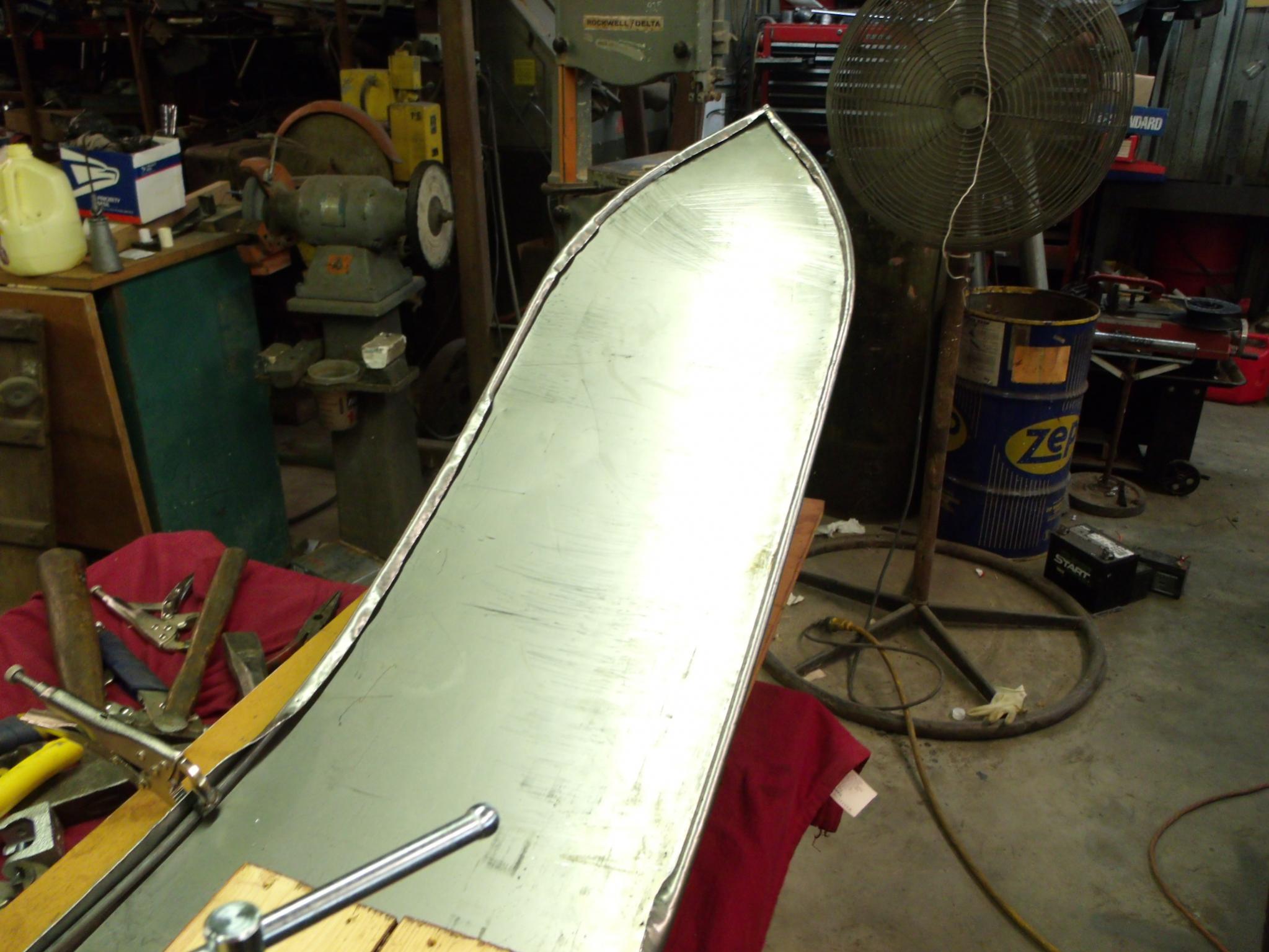

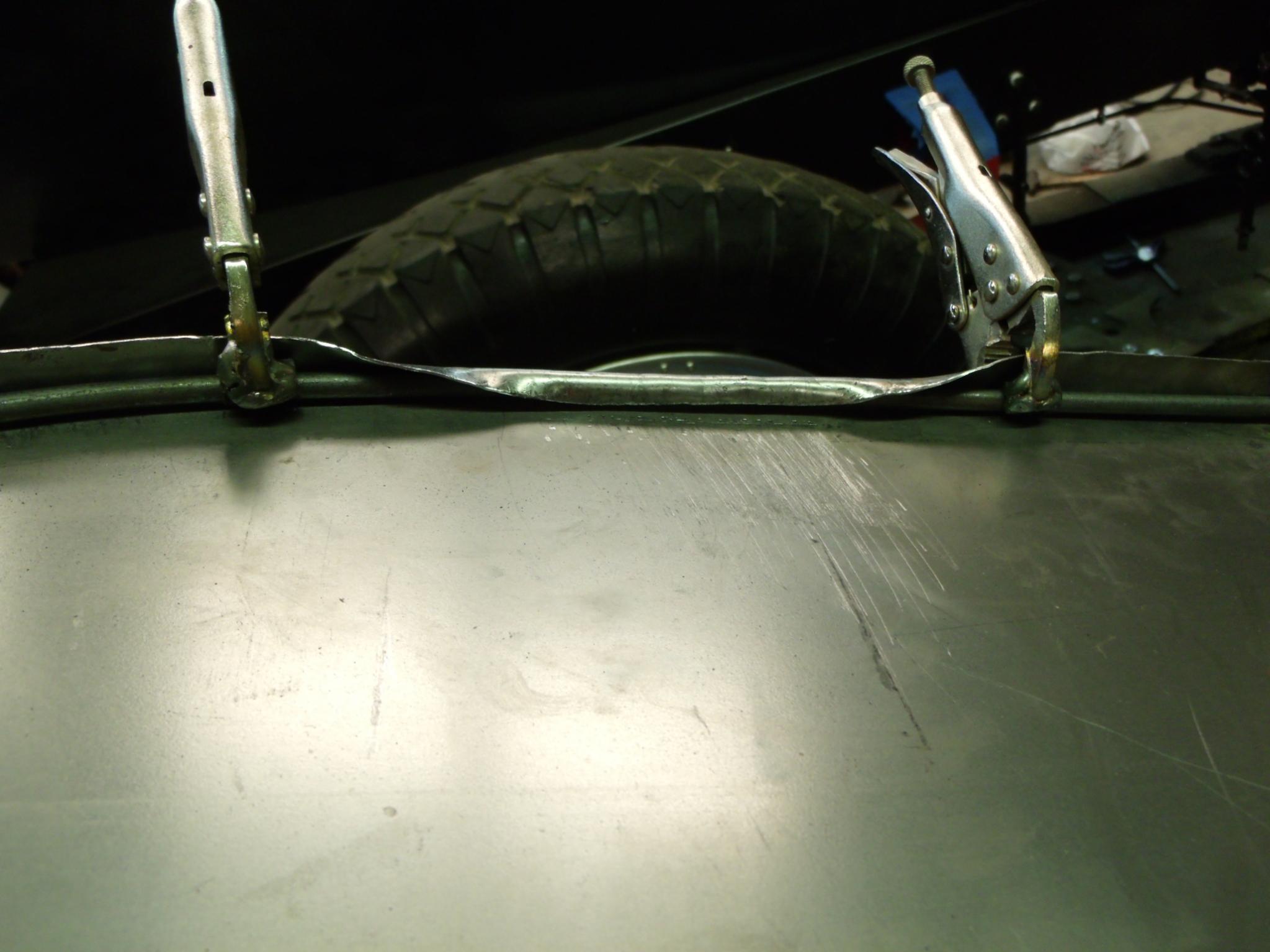

    I'm bending the 1/4" rod around my jig (there's that word again) to fit into my fender and using the torch to heat the rod so it will keep it's shape. Everything is a little hap hazard around my shop so the jig falls off the bench, I jump back and after a few seconds I feel a sensation in my thumb. Somehow the torch flame is right on my thumb! Interestingly, I was wearing latex gloves and the glove over my thumb was not burned. Anyway, I had my thumb in ice water the rest of the day. Some may wonder why this flurry of posting activity. I still have a lot of work to do--three outside awnings and a bathroom and another dropped ceiling--but my worker has run off to Kentucky for a working vacation and until he returns I can't do much except work on the speedster. Cool huh!

    I'm a rolling dat metal. I bought some cheap little vice grips at Walmart and welded on some bits of angle. I had to get the 1/4" round all the way into the corner so I could peen over the lip. They worked pretty well. The job was kind of tedious. I also clamped down the fender so everything stayed flat. I got about half the fender down before I had to go home. Maybe I can finish tomorrow and move on to planishing. What kind of word is planishing? Sounds French. Probably dates back to the days of armor. Do you think the old armorers held armor conventions to unveil their latest models. Bevor 3.7? Vambrace 4.0?

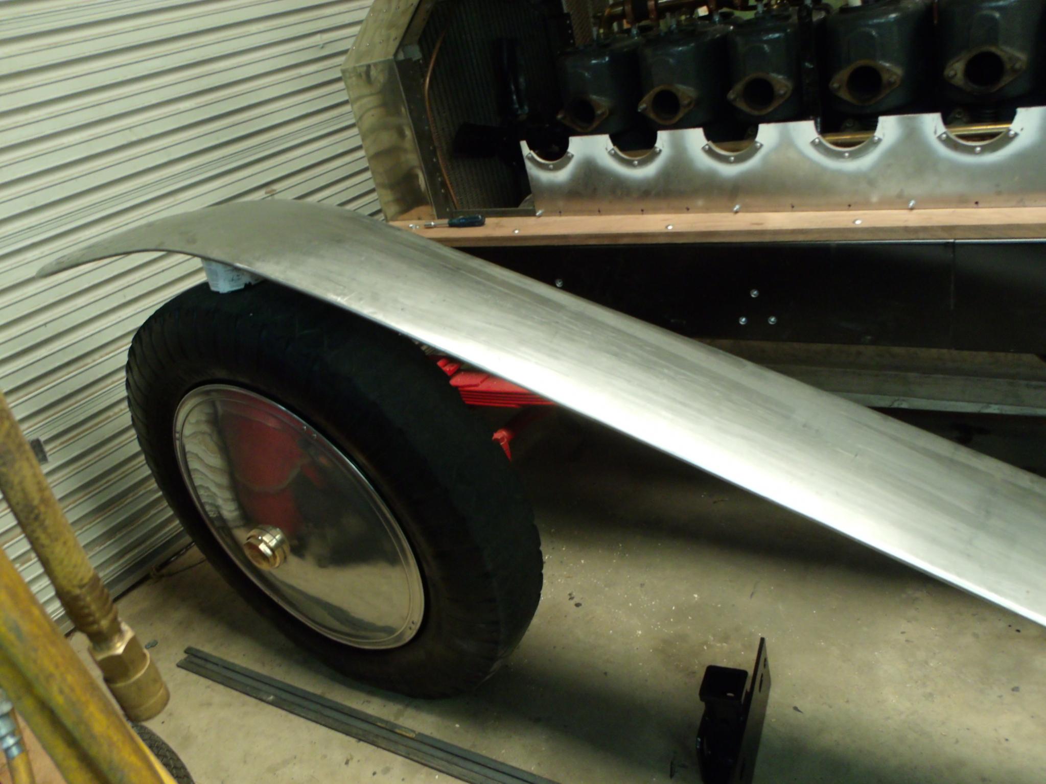

    I started hammering with the planishing hammer but when you're dealing with a six foot fender things get tricky. If I varied the angle just a few degrees from vertical I wound up with a big dent. A helper would have been good or maybe a skilled metal worker. I abandoned the planishing hammer and borrowed a leather panel beater's bag from my buddy Don. After a few minutes of hand beating I realized this was going to take a week and my arms weren't going to hold up so I got out my air hammer. I don't know what model or make the air hammer is but it's very controllable. I was able to run it back and forth inside the fender in even strokes using a wooden contour gauge for a guide. When the fender was roughed in I ran it through the Chinese Georgia modified English Wheel with the 12" radius lower wheel to smooth things out. The Chinese did some modifications themselves--on the lower wheel set axles between the time I bought the tool and the time I bought the wheels so I had to spend some time to make it all work. Still some fine smoothing work to do on the fender but I was impatient to start the other side.

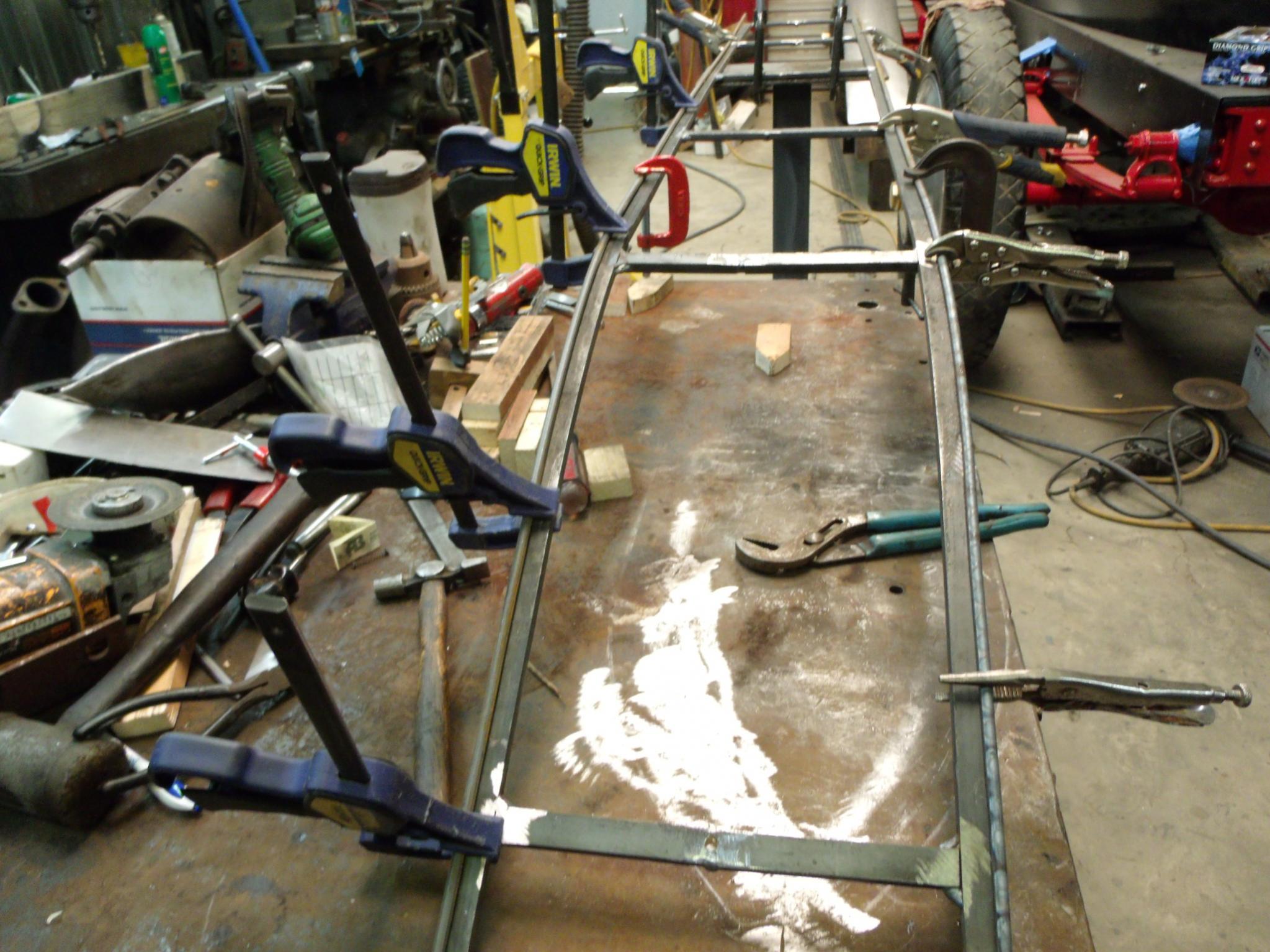

    Started beating and hammering the other fender. I got the sides hammered down then dollied them straight only to find out I'd put an interesting curve into the fender. I would have left it but it didn't match the other side. The fender was too unwieldy to put into the shrinker so I mounted the shrinker on a piece of angle and used it to straighten out the fender.

    Yes, I'm back, sunburned and broke. Didn't do much when I got back to the shop, but progress is made in tiny steps. I bent up the .25 rod on the fender jig with no little trepidation. As you remember this is where I nearly burned off my thumb. Luckily, I survived. The next step hammer over the lip of the fender. You've seen it before, but hang in there, many more exciting things to come.
