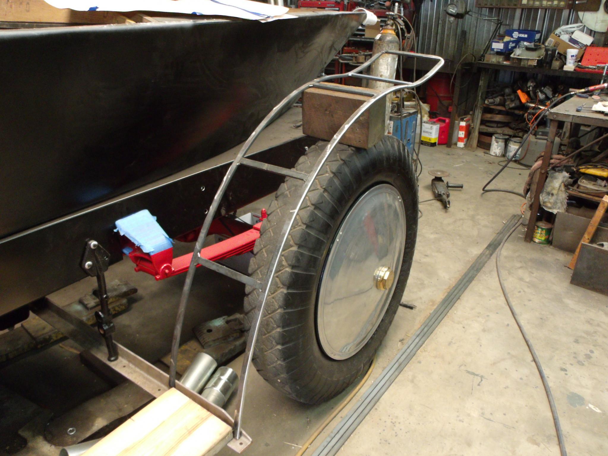

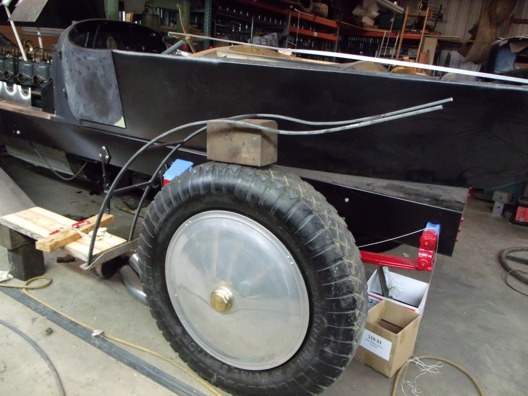

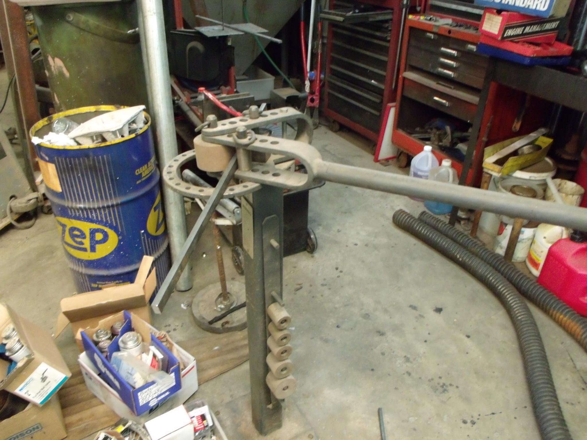

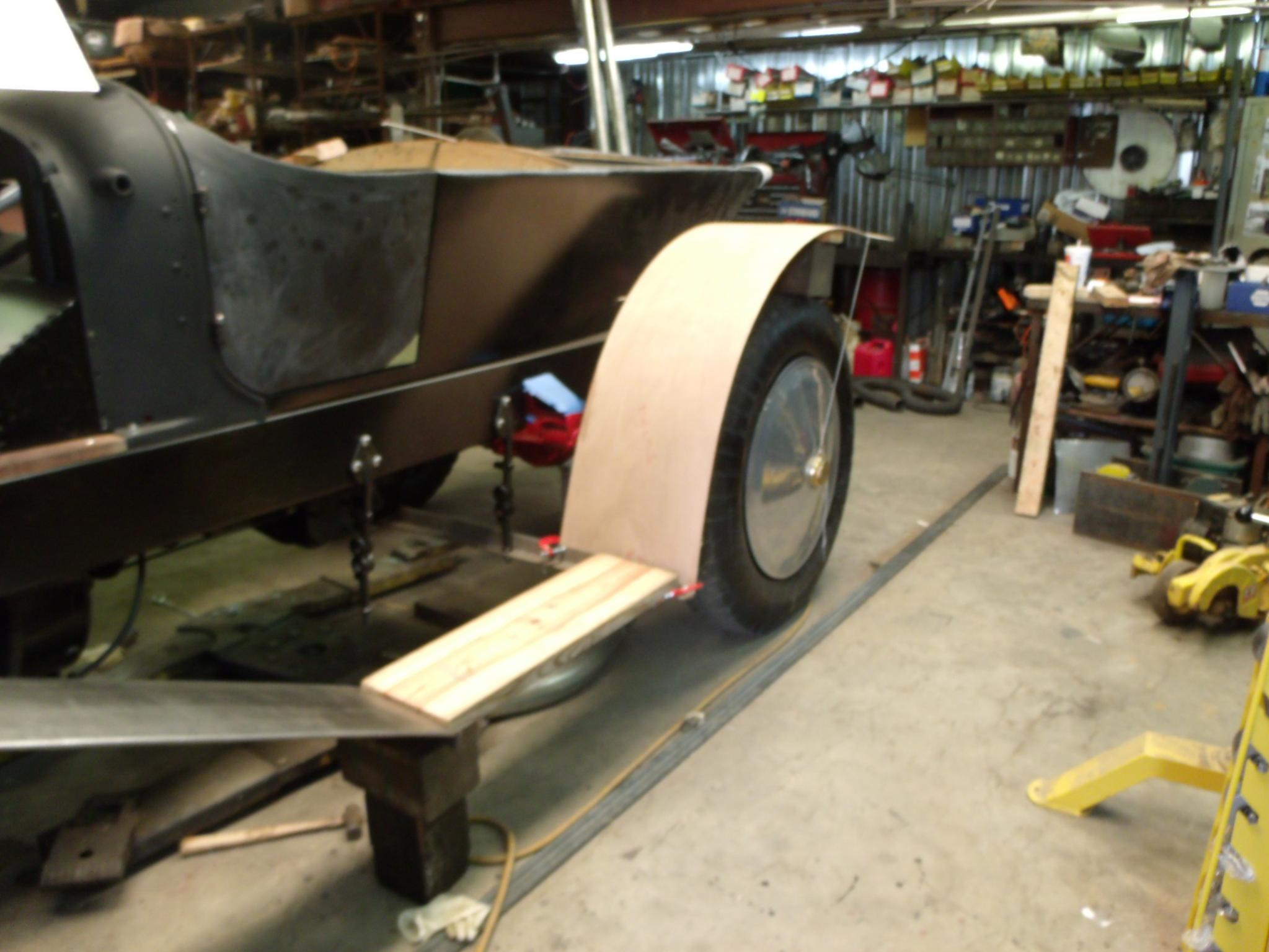

    Okay, so I messed around with a mock up of the rear fender then I started bending up some metal to make a jig. I want the rear part of the fender to have a little kick up and I can't get it into the roller. I dragged out an old bender I bought about 20 years ago to see if it would do the job but I've got to anchor it to the floor first. The bender was one of those useful looking items that never seemed to have much of a use.

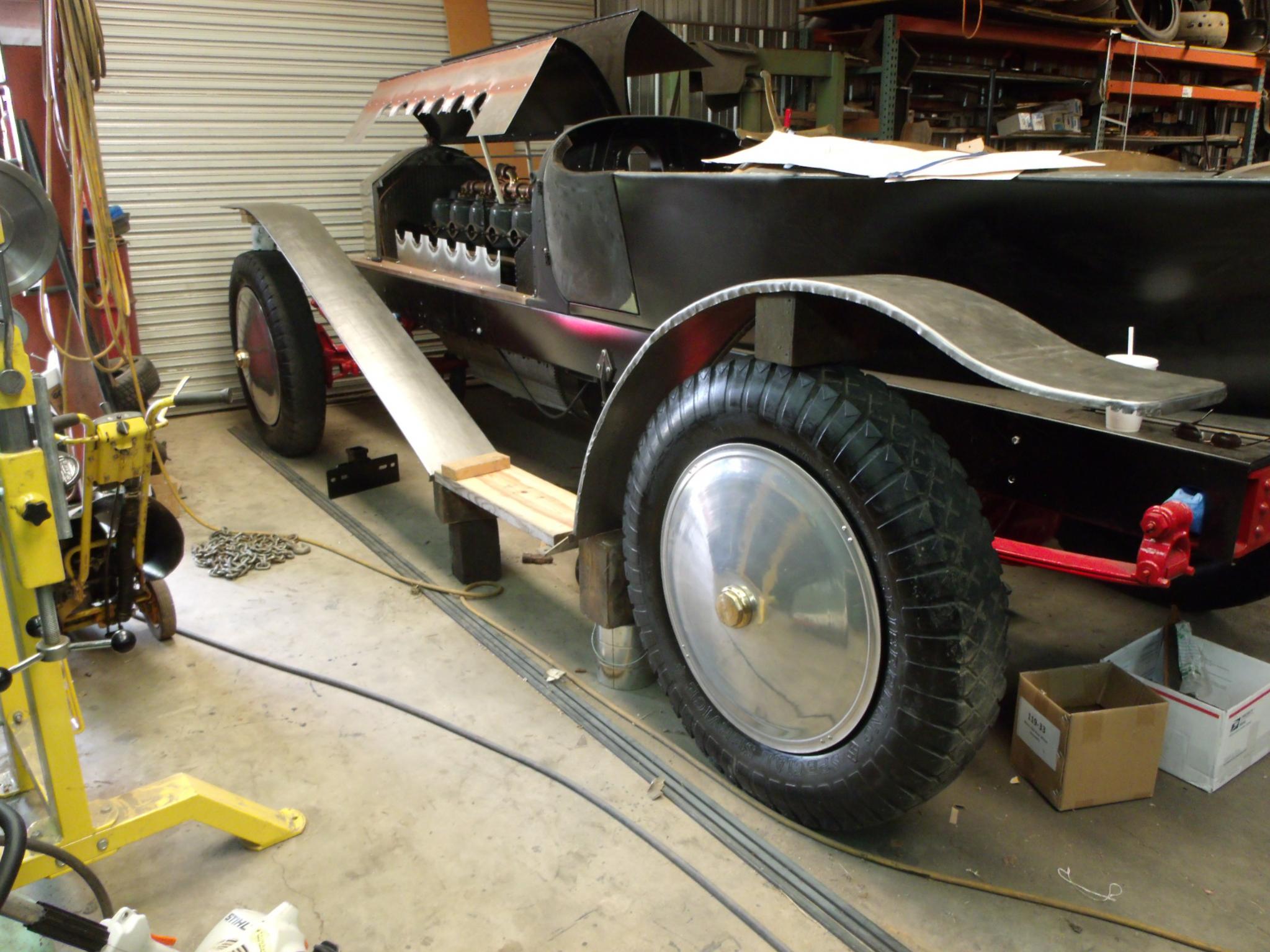

  2. Nice shape on the fenders!

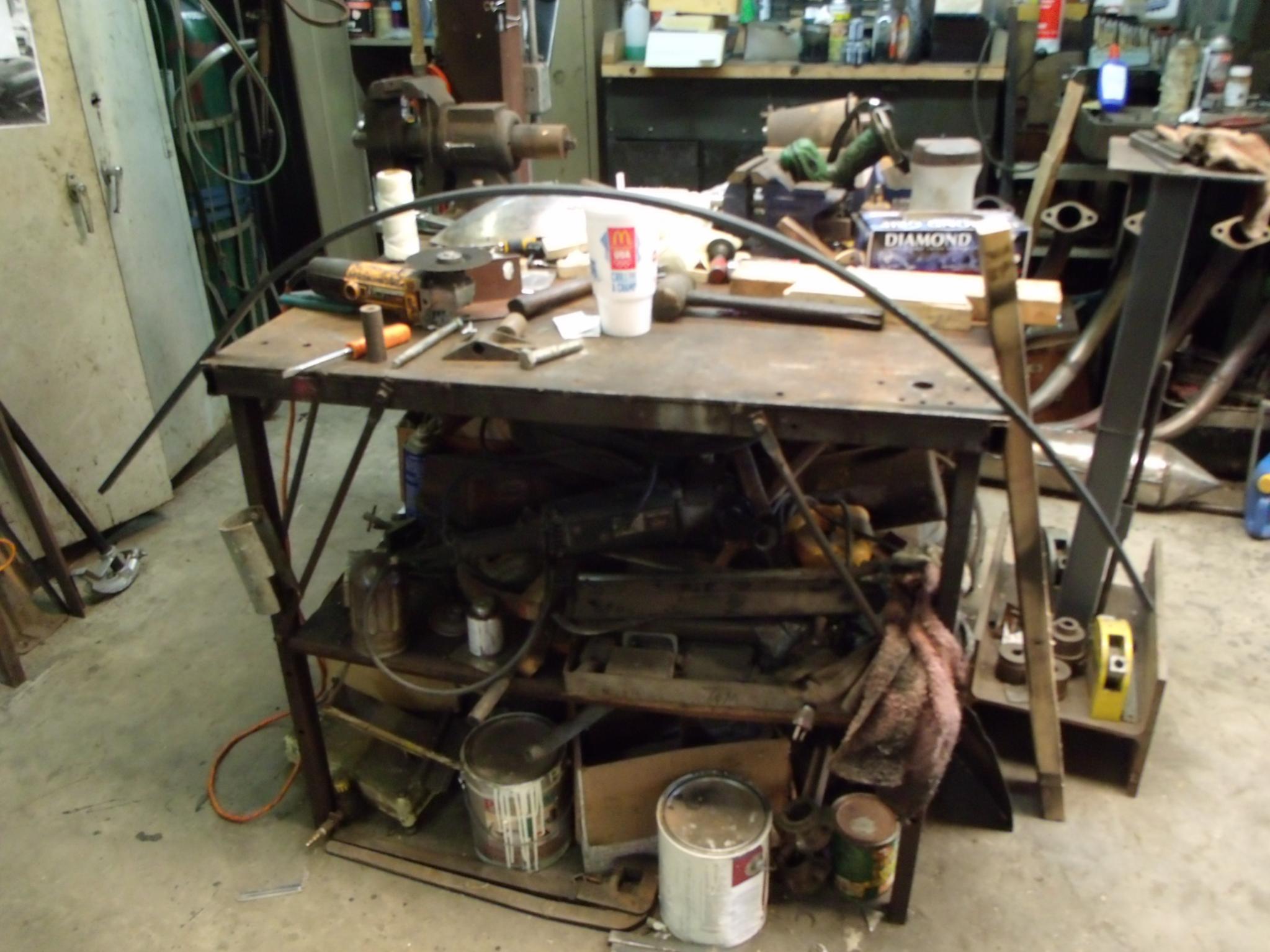

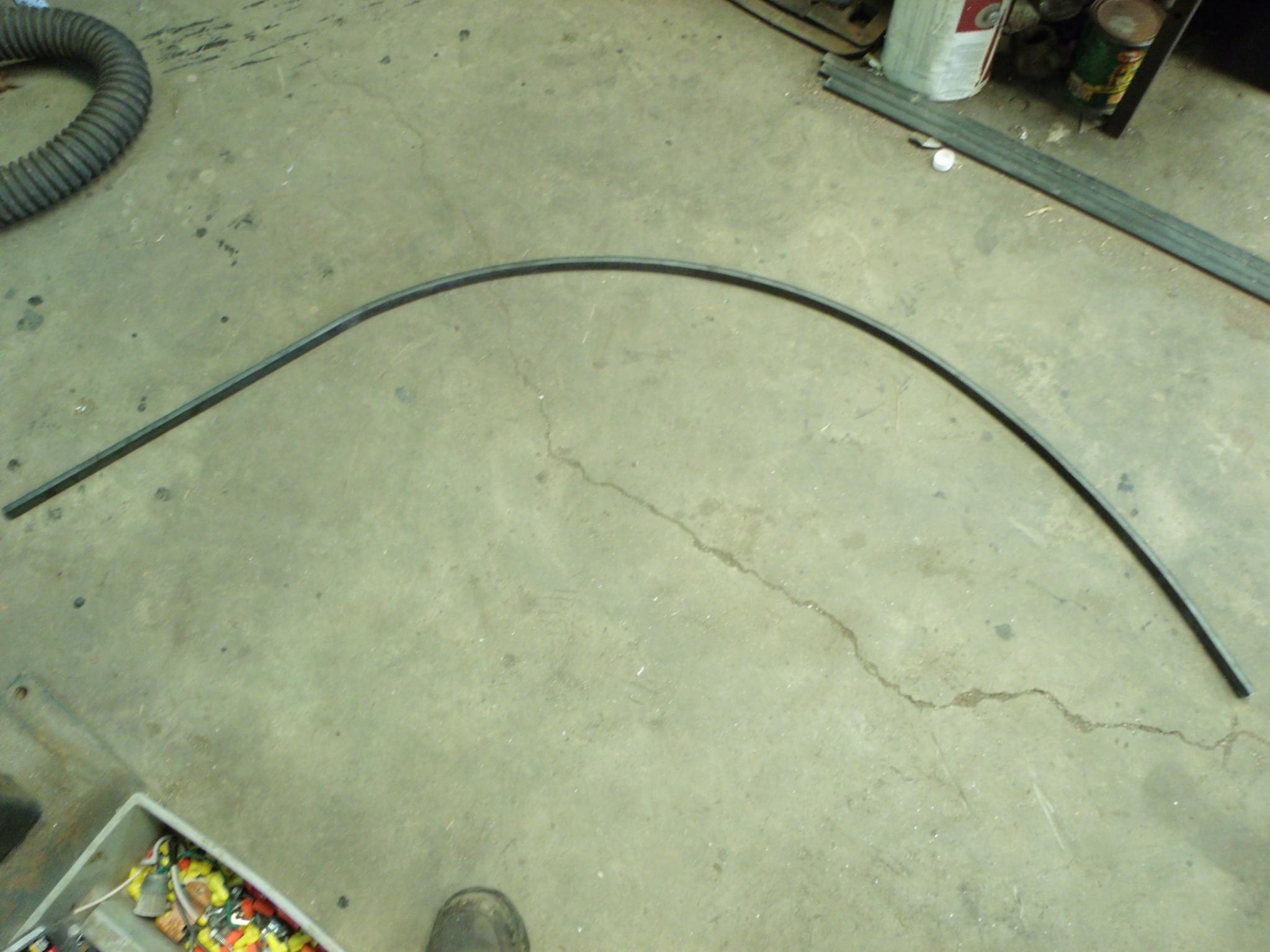

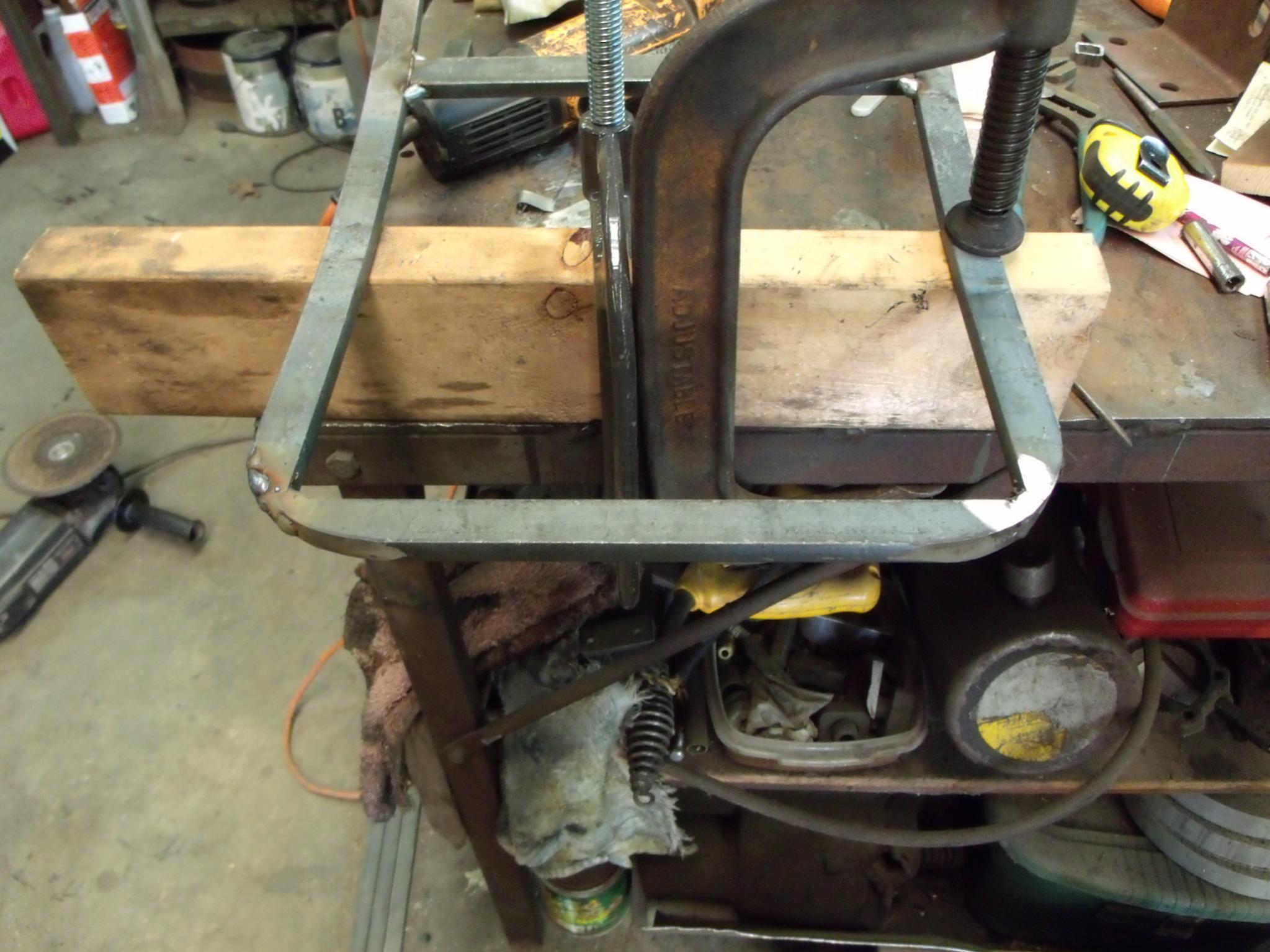

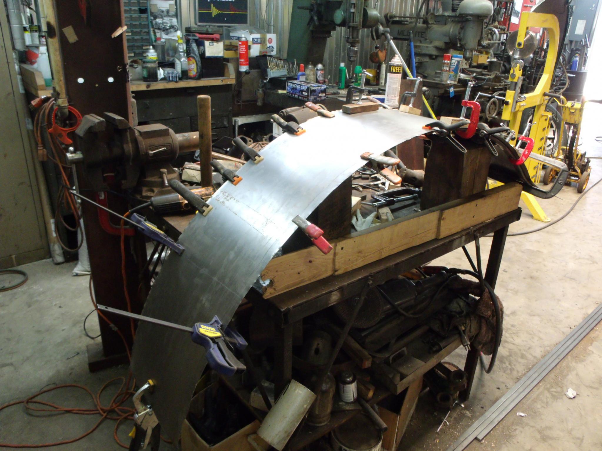

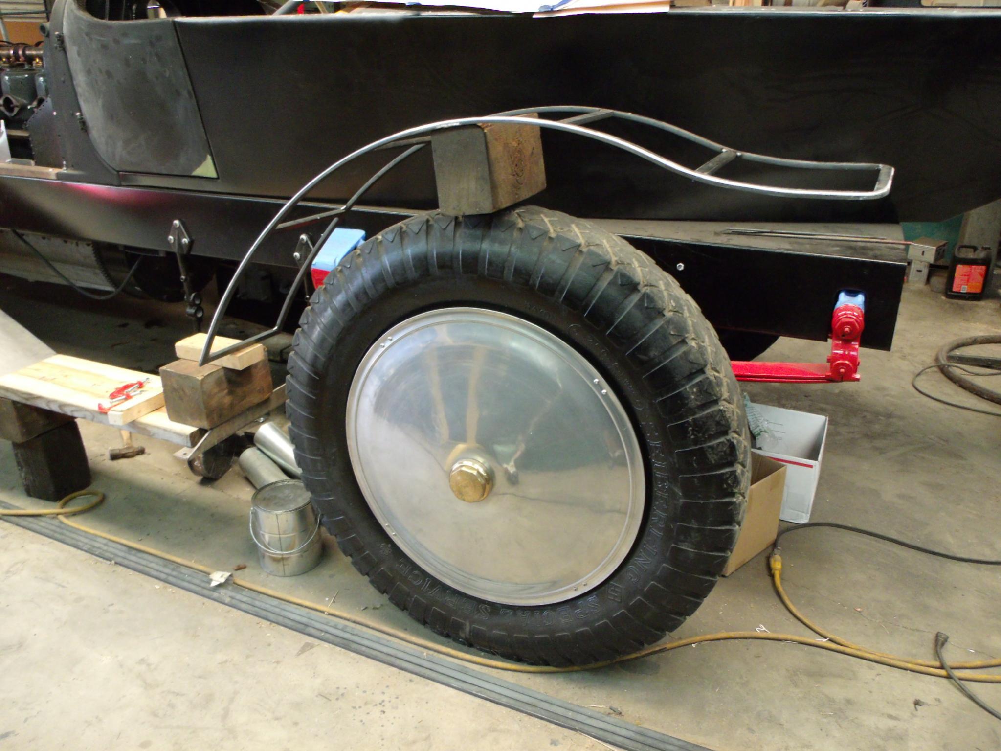

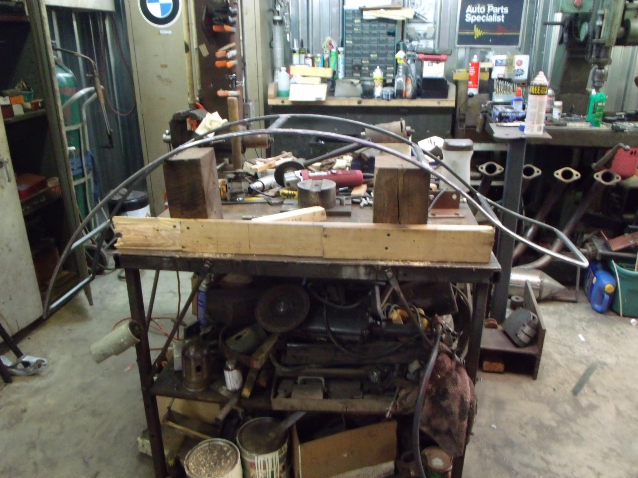

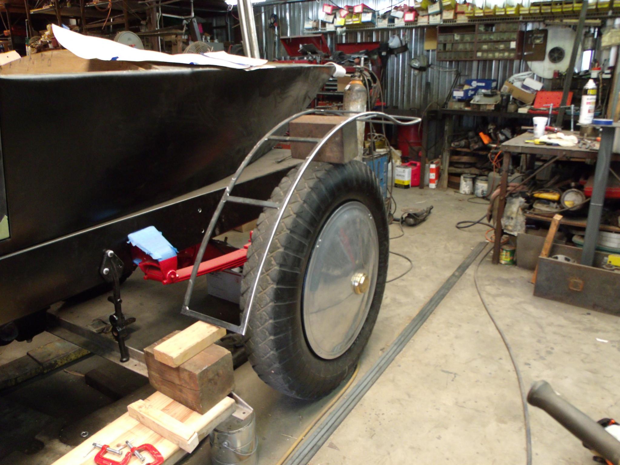

    The jig continues. Making two identically bent pieces of steel can be difficult. But, I persevered. When I got the pieces close I clamped them together and heated them up at about two inch intervals. That relaxed them both. But not me. All that torch work got me hot. No jokes now! After that I welded the two sides together. The tail is too long and needs a proper shape. Rounded? Square? Pointed? Suggestions?

    Where are the taillights going? If you hang them from the back of the fenders I vote square, otherwise I vote somewhat rounded corners, but not completely round.

    On the shape at the rear of the fenders, my suggestion would be about a 12" radius side to side, with about a 1" radius at the corners.

    Pointed would match the theme of the boat tail, but I think rounded would be more "traditional". :)

    I vote for the taper that july08 shows. It goes with the boat tail well and has a proper vintage look.

    The jig is up.

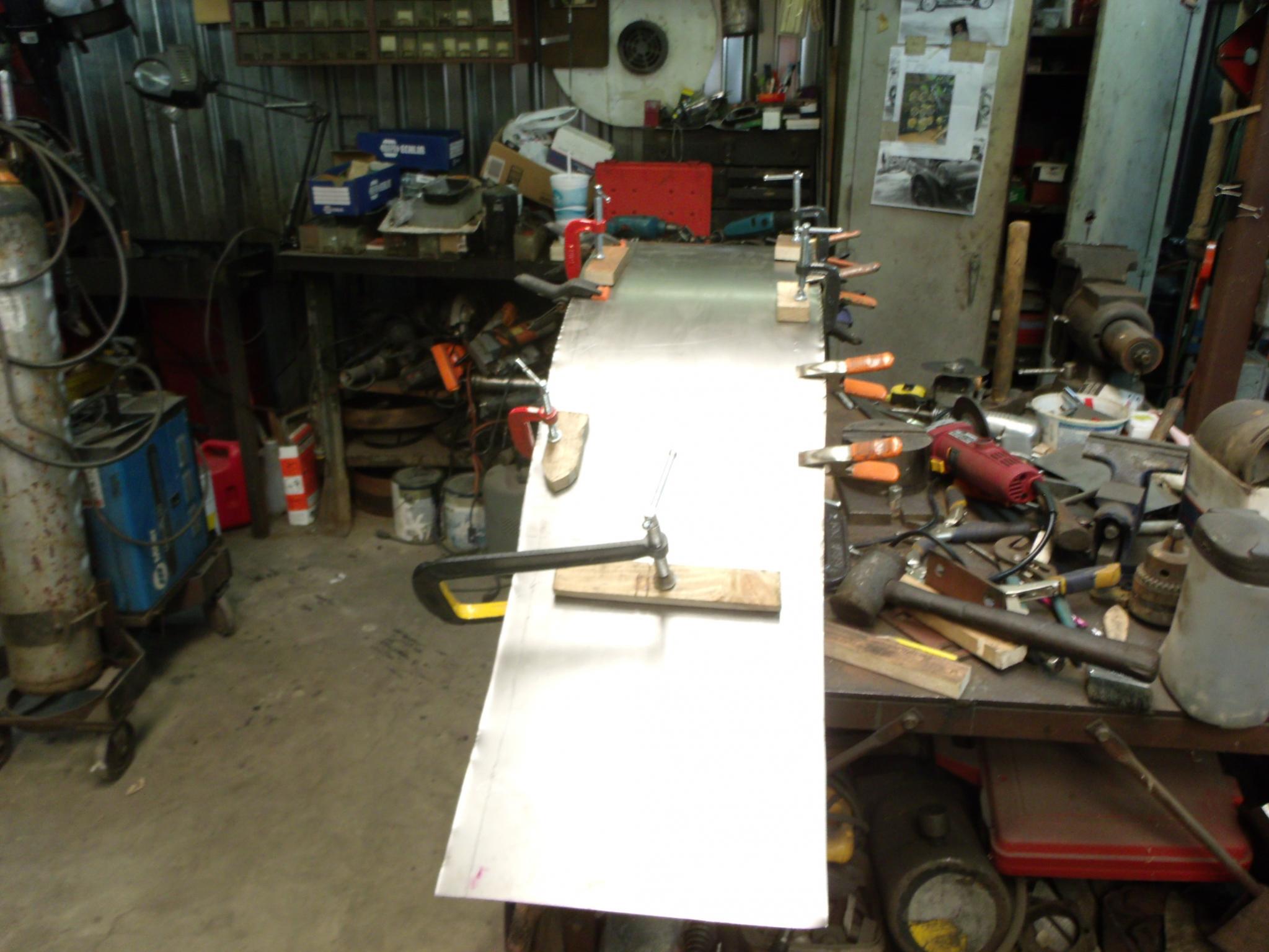

    Or down. After much contemplation I settled on the rounded corner concept but after observing with the jig from all angles I got to thinking that the fender wasn't long. So I added about nine inches to the jig. Of course that meant rebending and rearching the jig which took about all day to get right. Finally I was able to clamp the sheet metal to the jig in prep for the great hammering.

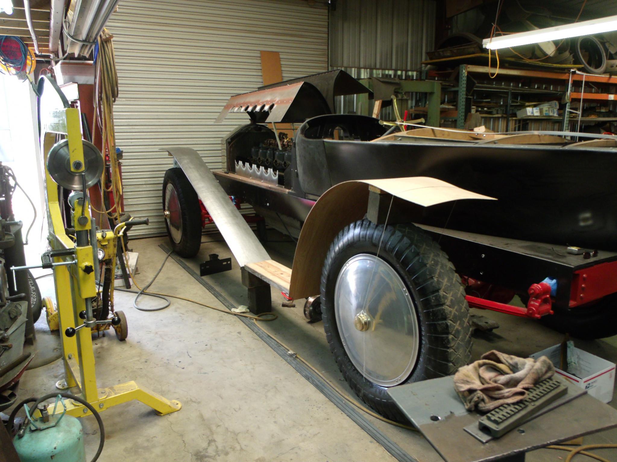

    Hey, I've worked three days in a row on the speedster. That's because I got the awnings done and the bathroom is done enough to use. I need a break. I hammered all day and produced a fender. Unfortunately I don't have any 1/4 inch rod. I'll get some tomorrow. I also realized I might have a problem when I start crowning the fender towards the rear at the up sweep. The change in curve from positive to negative may cause a problem. We'll see.

    You can still put crown in the panel there, but you'll have to do it by stretching the turned down legs instead of just pushing up the center.
    Probably ought to get that done before you wire the edge, because the edge is where you'll be working that area.
    Think about it like you already had a big long U shaped piece and you were going to try and bend it into that fender shape you've got there now.
    In that case you'd stretch the center to make the convex area (or more likely, stretch the center and shrink the edges at the same time), and you'd stretch the edges to make the concave area.
    It's just like doing a very shallow/subtle saddle reverse.
    Raise the whole center until you get the crown you want (which will probably push the fender all out of contour), and then stretch the edges in the concave area to get the contour back.

    Just go slow, it'll be fine.
    It's a lot easier to stretch with caveman tools than shrink, so you've got that going for you already.
    You just need a smooth faced hammer and some kind of a back-up dolly. Can be an actual dolly or just a heavy chunk of steel that you've polished smooth, whatever.
    When you strike hammer on dolly, you're stretching, so after you've raised your crown, just work the edges on either side of that concave area between the hammer and dolly until the shape comes back into the proper contour.
    If you're not using a dedicated body hammer and dolly for this, I suggest sanding and then polishing the face or both your hammer and "dolly" before you begin.
    Every dent in the hammer face will become a dent in the panel each time you strike, so it will save a lot of trouble later to make sure your tools are slick before you start.
    Go slow and try to keep both sides the same, and you'll be fine.
    Worst case, you take that fender to a Metal Meet somewhere and let a guru there either fix it for you, or show you how to fix it yourself.
    It's pretty hard to screw one up so bad that it can't be fixed at all.
