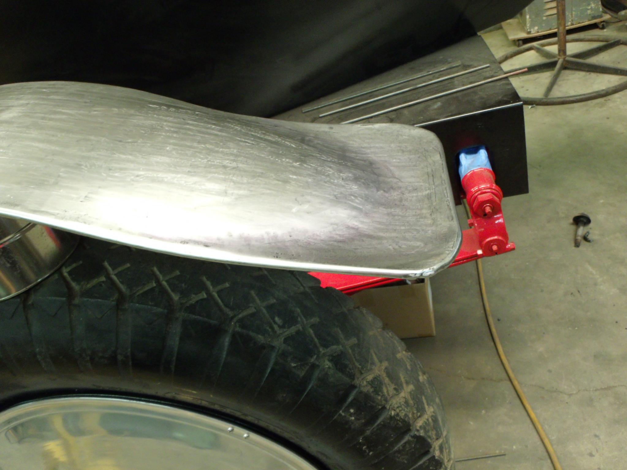

    Hey, Ryan knows what he's talking about. I tried hammering my mock up and all I got was a bunch of wrinkles where the curve reversed. Finally, after pecking around for an hour, I came up with a sort of compromise. I didn't try to work it real smooth. It's a little hard to see but the "tail" section dips down then flares back up. See what you think.

    That's an interesting, original variation. I say, "That dog'll hunt!" :D

    I like it.
    Well struck, sir.

    Nicely done Jerry. Love the way the car is evolving.

    That practice piece looks like the perfect solution. An awesome build.

    Well, now that I had some idea of what I was going to do via my mockup I got to work bending up some 1/4 rod for the edge then rolling the lip, pounding the fender and rolling it smooth. I lengthened the upturn at the back and left it flat. That will save me a lot of work and it still looks pretty good. I also kept the hammer away for the curve betwixt crown and flat. (I've been waiting this whole time to use that word betwixt.) See what you think.

    I got all the beating and wheeling out of the way yesterday but I forgot my camera. So now I have four fairly smooth fenders that need a little touch up and I started thinking about fender supports. I was planning to use the original supports so I dug out the old fenders and deriveted a couple supports off. After half a day of piddling with them I determined it would be way easier and look much better if I just made new supports out of some 5/8 round stock.
