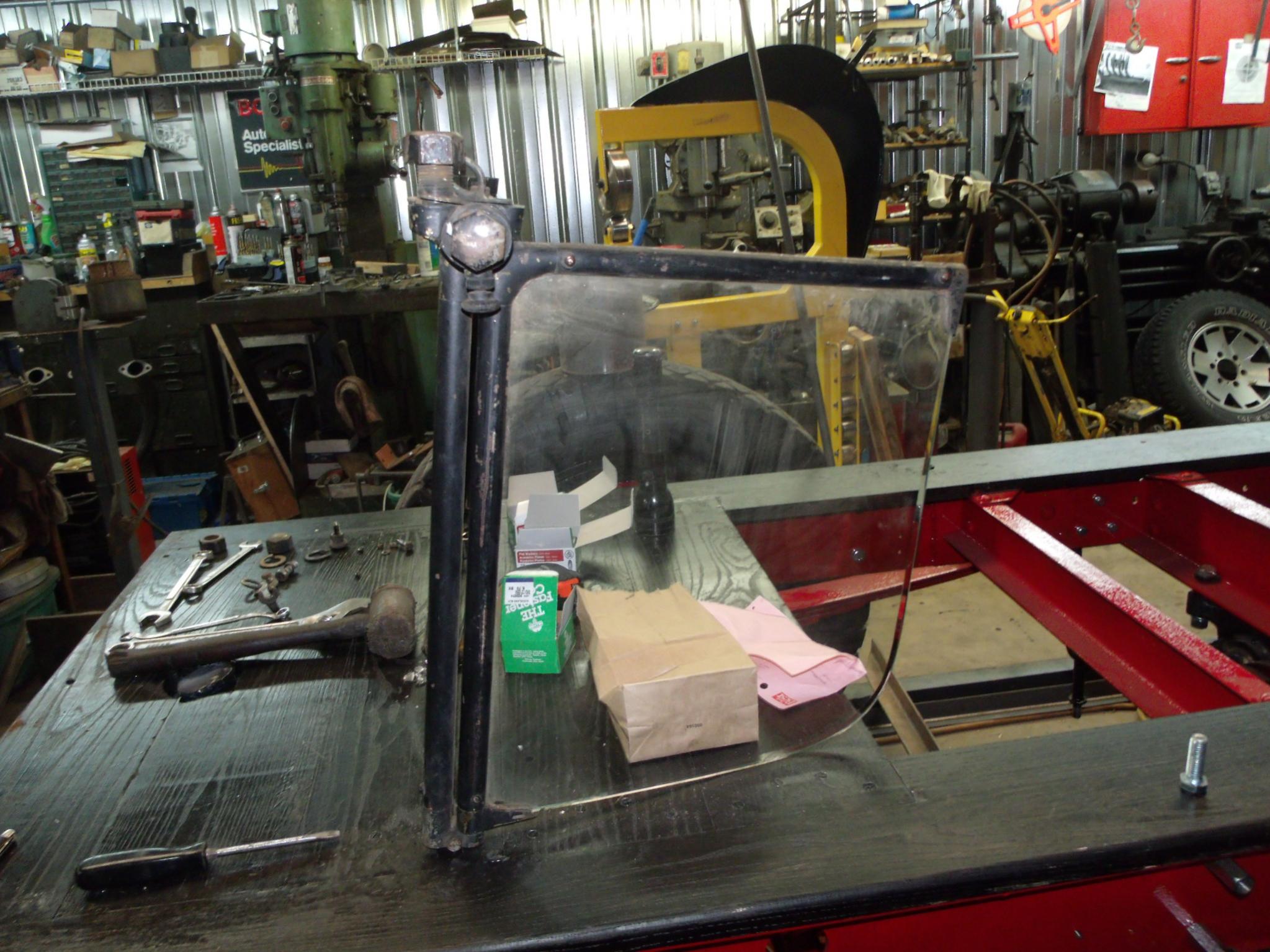

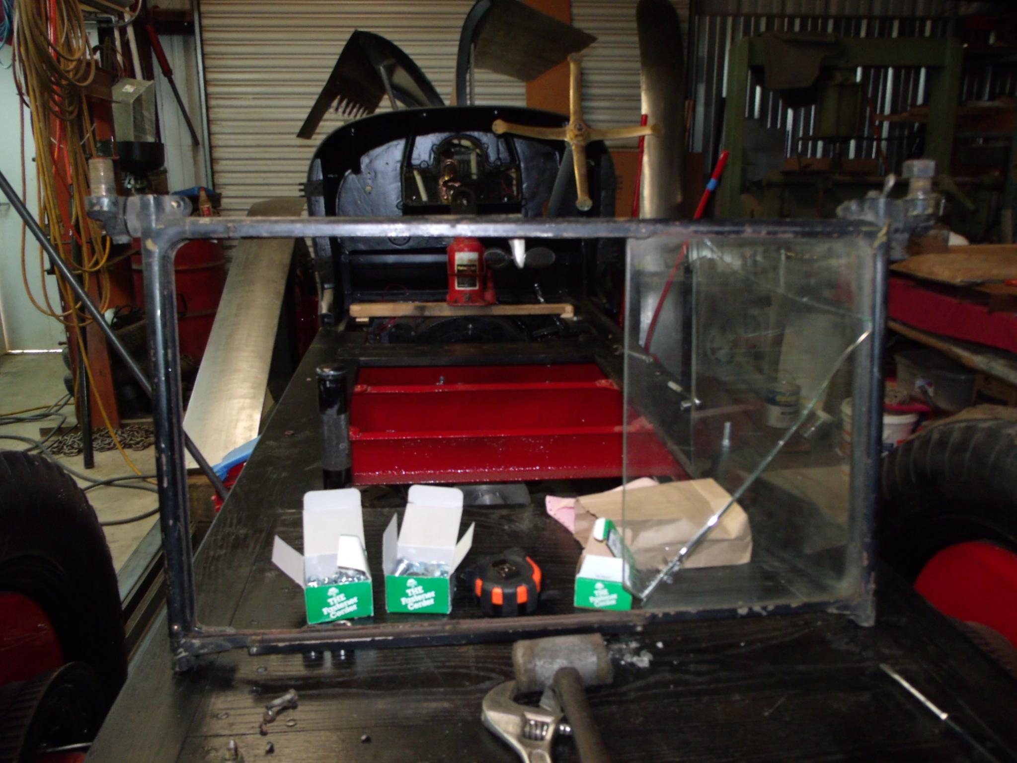

    New Windshield
    Old actually. I believe this is an accessory rear windshield for a dual cowl phaeton. Unbelievably, I got it cheap on ebay. Had to be St. Eligius! In the first two pictures it's upside down. You can see that the wind wings are real neat with beveled gl***--nice PLATE gl***. The windshield is a little too wide but I can take care of that with no problem. As far as the height--we'll see. I plan on raking it a bit too. The wings will hang out somewhat over the doors which will be nice. I think I might also change the shape of the gl*** in the wings slightly. Of course, in accordance with standard shop operating procedure, as soon as I took the windshield apart I put everything in a box and stashed it away.
    Fender braces
    Before I could make up the fender braces (irons?) I had to firm up the running board position which meant solidly attach the running board hangers. That's why I had to take off the body and frame covers. I bent up the left side rear braces but they still need to be tweeked. I also have to make up some supports for under the fenders. That's where the step bolts come in. Time to order!
    Jerry

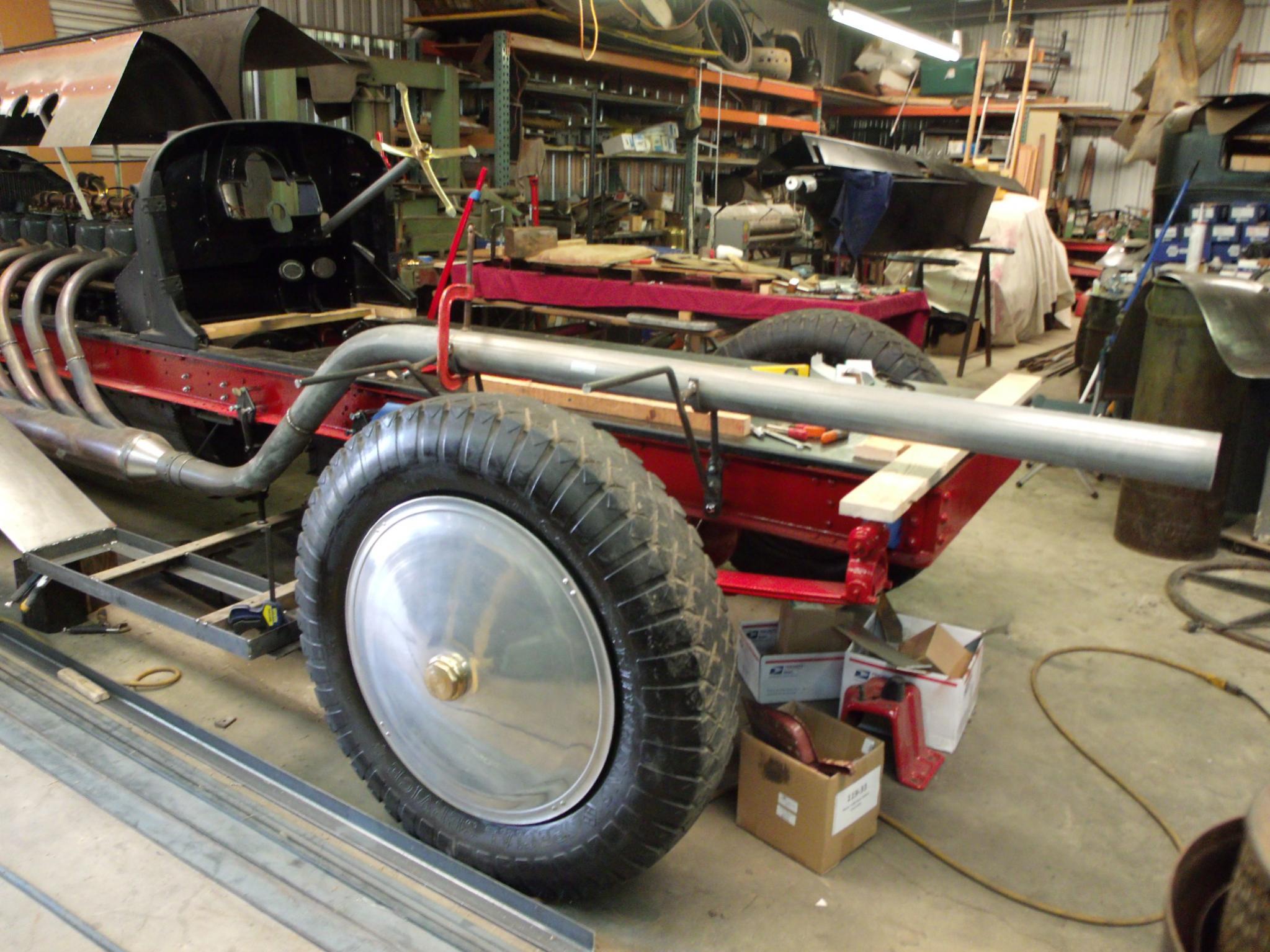

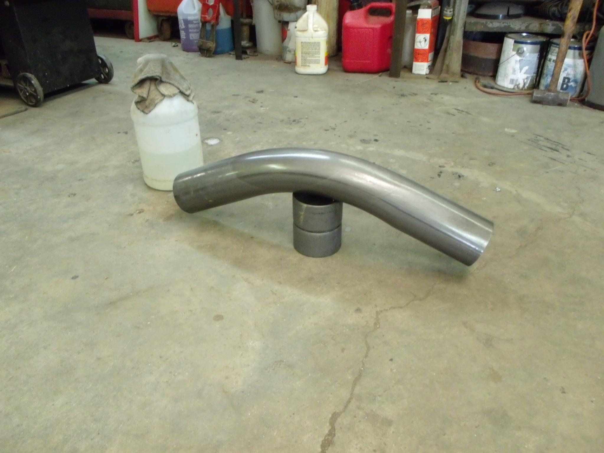

    Exhaust and Hangers
    I got the two fender/exhaust supports built so I figured I might as well tack the exhaust system together to make sure everything would fit together okay. The pipes are 3.5" electrical EMT. I have to take off the zinc plating because it's nasty to weld and I don't like it anyway. A little pool acid makes a nice show. I put the long pipe into a piece of 4" pvc. When the plating's gone I rub it down with metal prep. The EMT has almost a mandrel bend. Tomorrow I weld the pipes together. I also changed the protective lense on my welding helmet, Man, what a difference! I can see again! I don't know how I was welding! Not sure how I'll get the acid out of the pipe. Exhaust! Fenders! Running Boards! Man, I'm cooking!
    Jerry

    That long pipe is going to sound great!

    Wash out the pipe with a baking soda solution ASAP or rust will start.
  14. jimmitchell70
    Joined: Aug 6, 2009
    Posts: 230
    jimmitchell70
    from CT
    64 Dodge 440 -Is that what's he'd doing in Picture 3?
  15. yonahrr
    Joined: Feb 27, 2010
    Posts: 1,348
    yonahrr
    No, That's the pool acid. Mmmm bubbly!

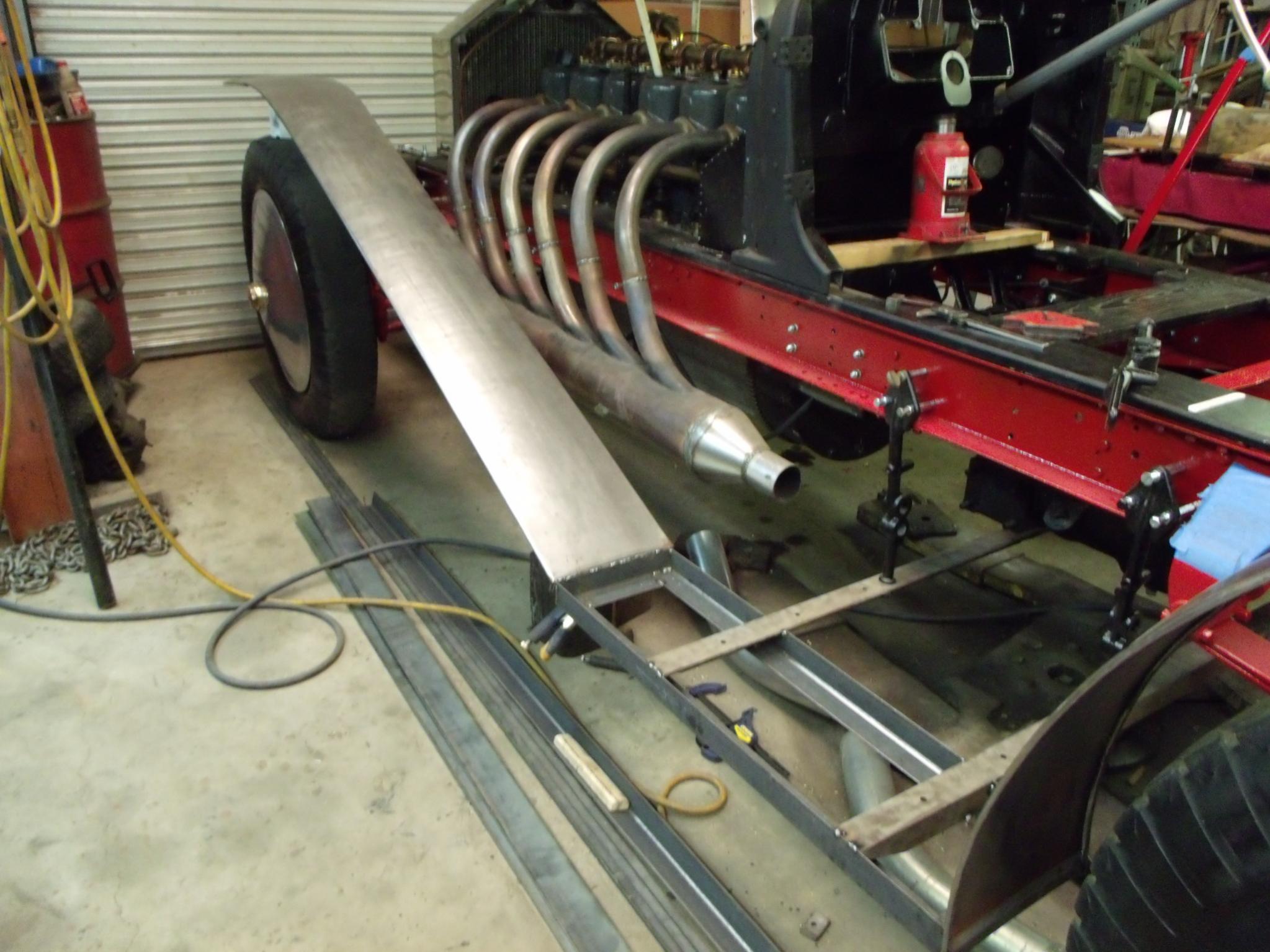

    Exhaust
    I siphoned the acid out of the PVC and into a jug. I might need it again. After I rubbed the pipes down with metal prep I needed a way to attach the system to the muffler. An EMT connector seemed to be the answer but it looked a little too modern. After I added a band around the center and some rivets I was satisfied. Looks sort of medieval. I loaded up some .23 wire in the MIG and welded the pipe together. I might add a few bands (br***?) around the joints but for now everything is fine. Now I'm thinking some sort of interesting fishtail for the outlet. So next I'll make some fender supports for the other side. I can't seem to find a couple of original bumper mount brackets that I wanted to fashion the front fender supports out of. They're somewhere in the shop--but where? Ever have that problem?
    Jerry

    Just a thought...might want to put some sort of baffle or big (1/4") mesh in at the end of the pipe to keep the critters out. That thing looks like one giant Habitrail to me...hate to see it get loaded up with bedding. Then again, it could be world's largest mouse cannon! patOOOM...thwack!
  19. 64 DODGE 440
    Joined: Sep 2, 2006
    Posts: 4,434
    64 DODGE 440
    from so cal
    Perhaps a Brooklands style flattened funnel on the end? Something along the lines of this. Sorry I don't have a side view.

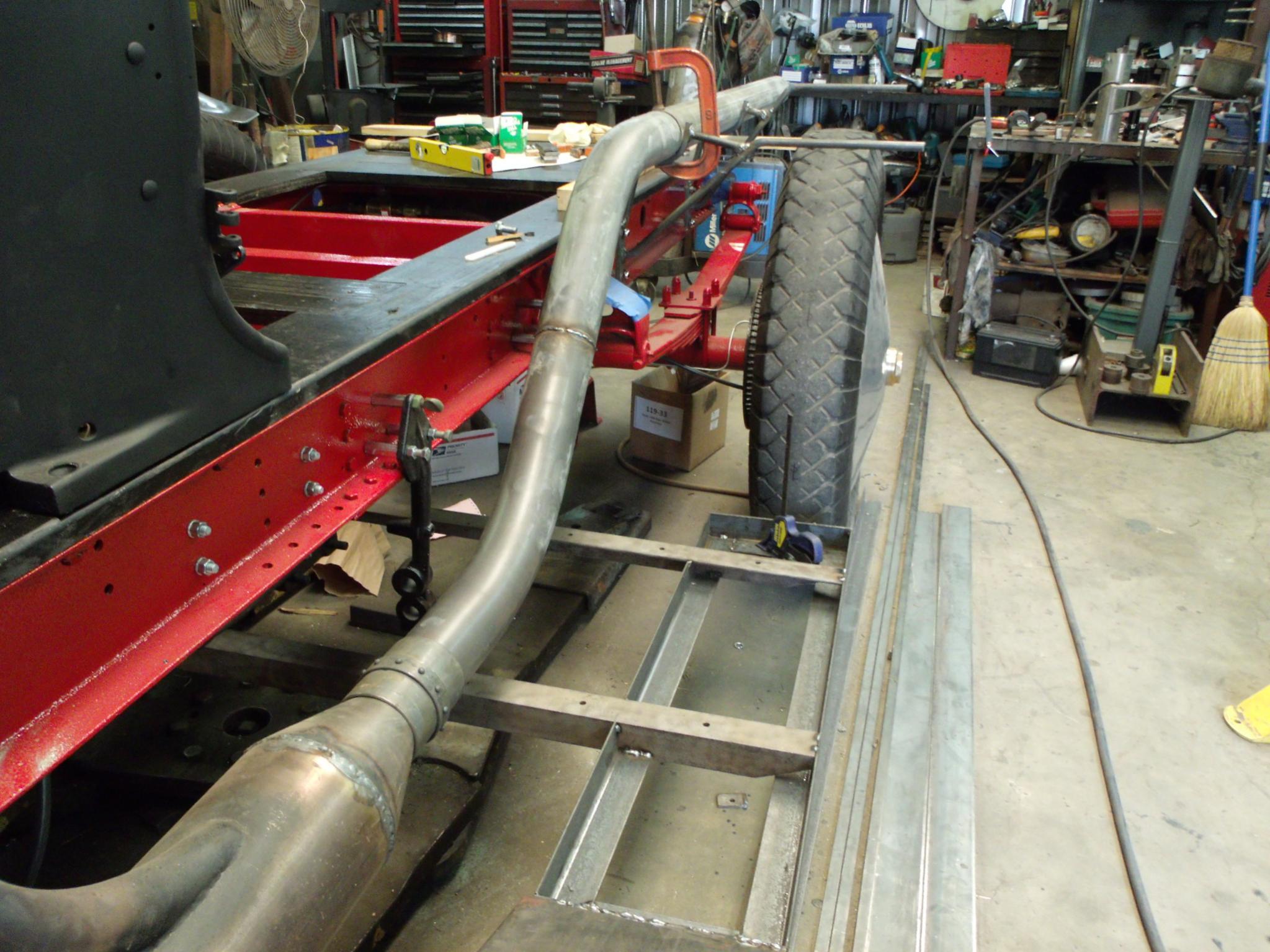

    Leg up
    Thought I might as well build the right side step since I was getting the exhaust squared away. As you might recall the left side has a tool box for a step that goes between the shifter and the rear spring. The right side step goes around the exhaust pipe. It's got to be pretty sturdy so I made it out of 3/8 by 1/2. Box will be covered with aluminum plate etched with Seagrave Special or something neat. I used the left side toolbox/step to hold up the pattern and make sure the height was correct. The bender came in handy to make the piece around the pipe but when I got everything tacked in place I realized I'd made it a little too tight. There's not enough room around the pipe. I'll have to cut and add a little to give it more clearance. Also raked my arm on one of the fender supports. Notice the makeshift bandaid. Plym49 The build is going where it wants too I'm just trying to keep up. :)
    Jerry
