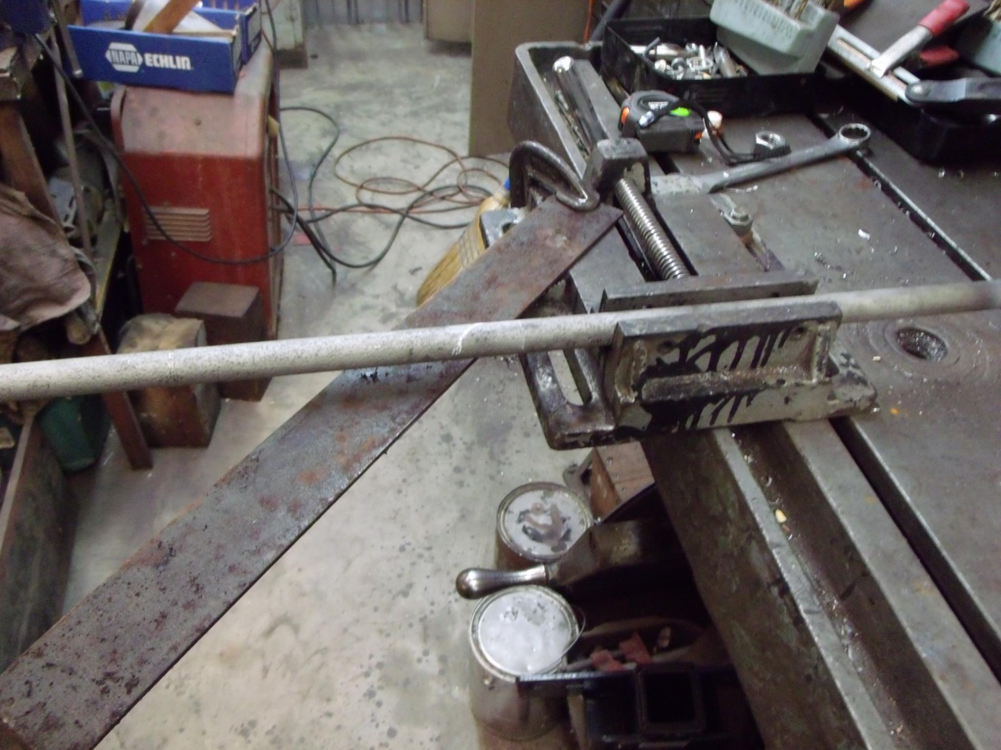

    Speedway sells 11/16" fine thread nuts.
    Or, you can source a castleated version off the top of a Moog K727 ball joint, or any early Ford tie rod end.
    Finding a die might be a bit expensive, but you could always single point the threads before you bend the rod.

    McMaster-Carr has 11/16 x 24 stainless nuts for $17 each ( 9562A70Q) and a die for 11/16 x 24 runs $75 (26005A17)
    Good luck,
    Bruce

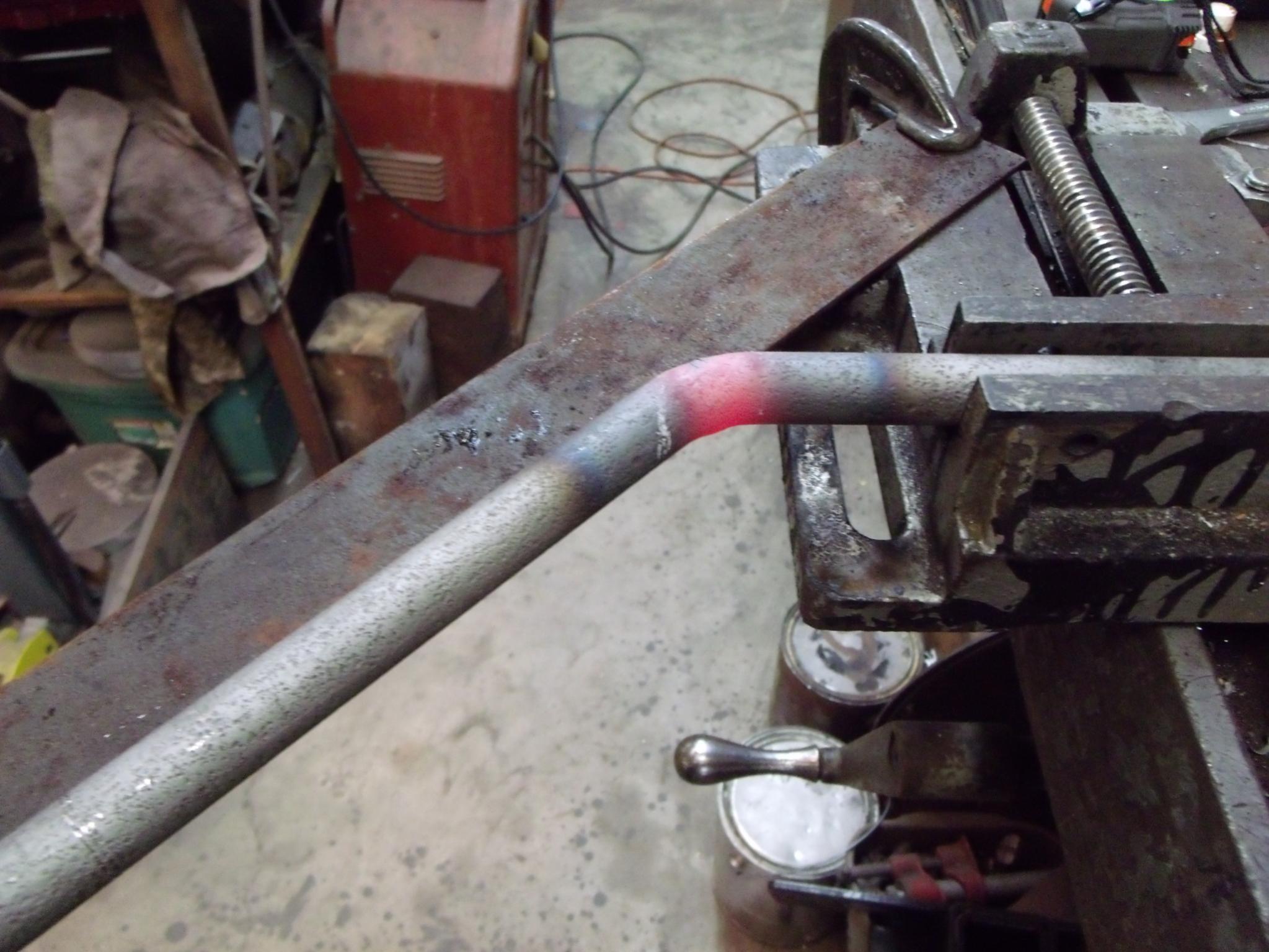

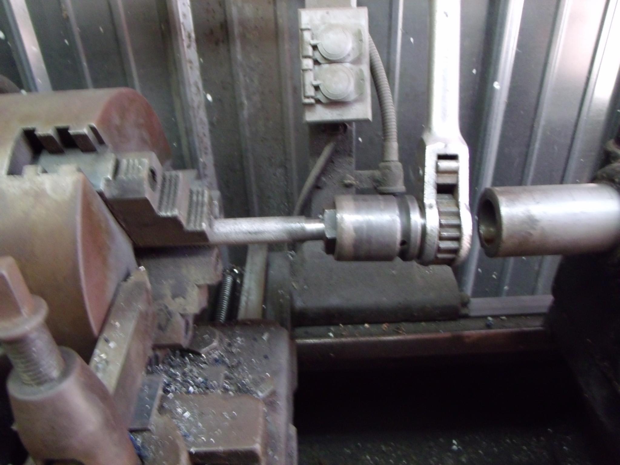

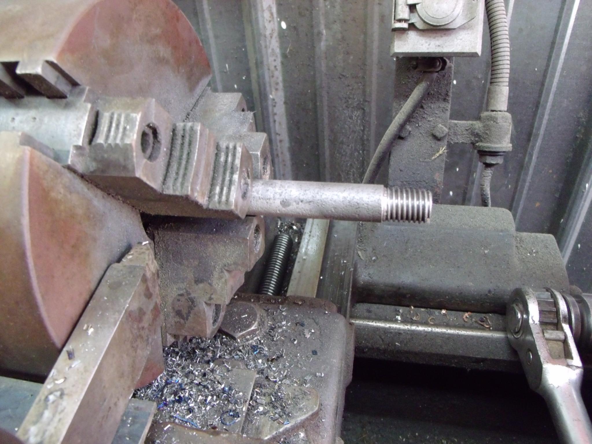

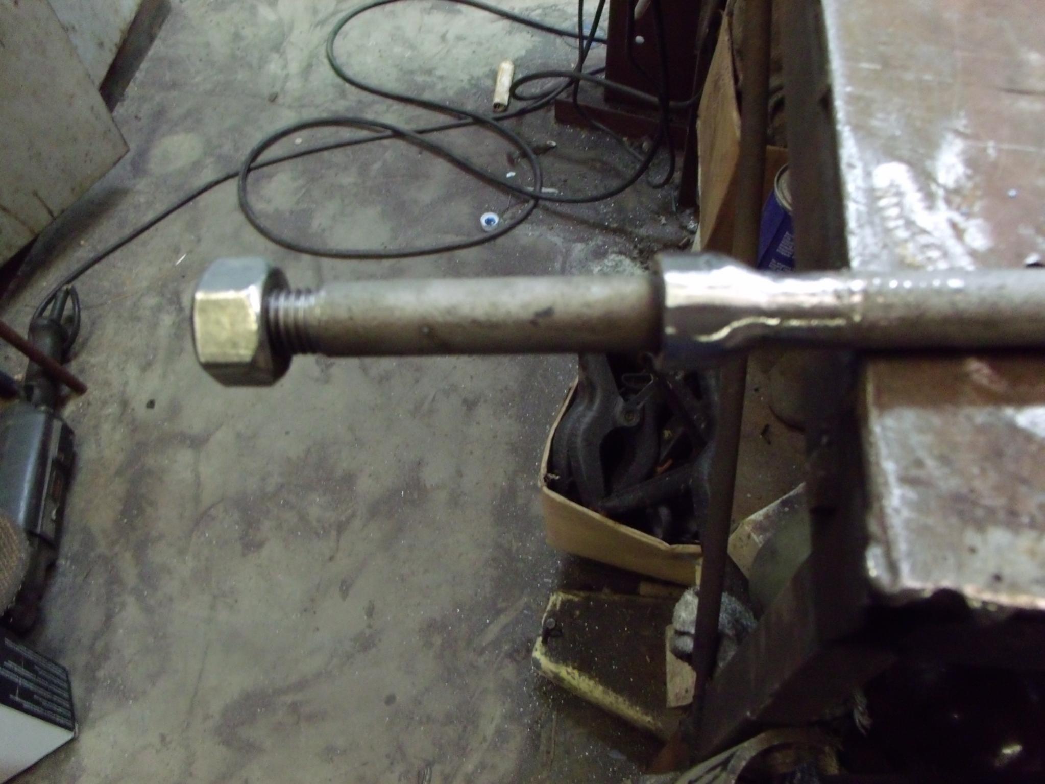

    I think I forgot to say this is a low budget build. No offense, but 5/8 nuts are 25 cents. I wasn't happy with my first front fender support. I kinda jumped the gun. ( What does that mean anyway?) So I cut a new rod then turned it down the rod in the lathe and threaded it to 5/8. Luckily I had some oversized 5/8 nuts I ordered for something. I drilled out one of the nuts and welded it in place as a stop and turned it down too. After some precise measuring I fired up the torch and made some precise bends. This fender support came out so good I made another like it for the other side.

    I was thinking the same thing when I found them! But thought maybe you were dead set on the 11/16 size. I think your end result is the best solution to the issue.

    Had an oil pan drain plug(missing) in that size, welded a nut inside to solve the oddball bolt size problem.

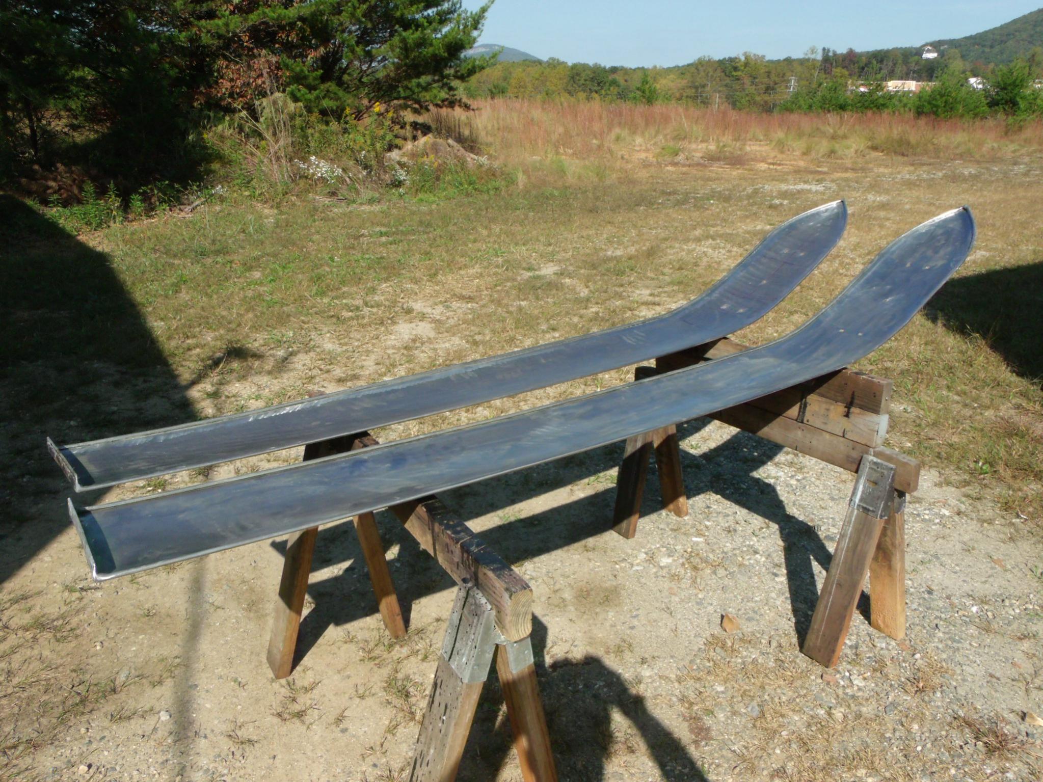

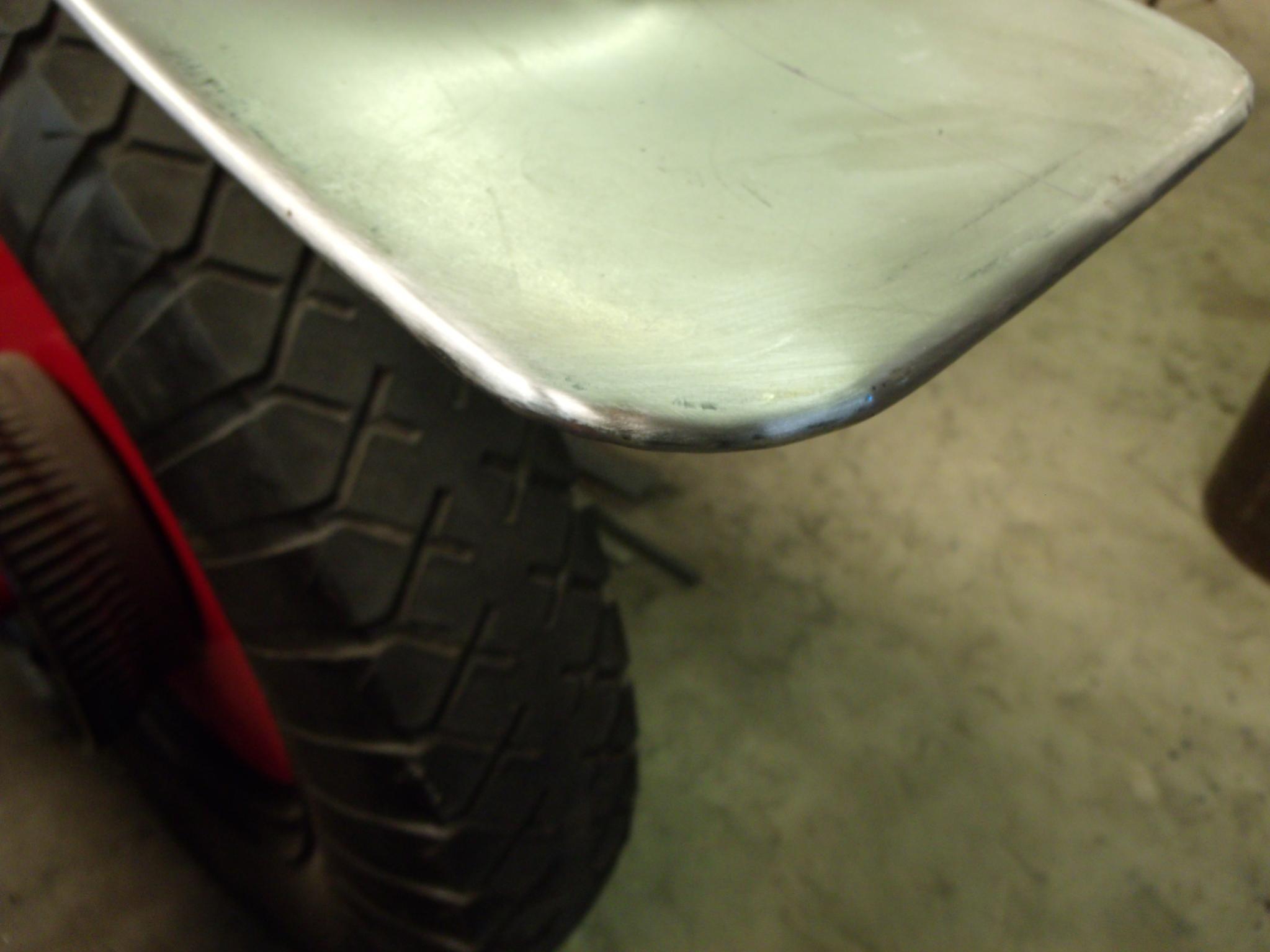

    I'm afraid the speedster will have so much natural shop rot on it by the time it's done there will be no need of faux patina. Plus my painting ability is marginal therefore it will look like it was restored thirty years ago. Hey, I made the final support and got started smoothing up the welds on the other fender supports. I need to the roll the bumps out of the fenders before I make up the fender to support pieces. For this I need someone to help hold the fenders as I guide them through the E. wheel as they are so long. Any volunteers?

    Today I began by running the rear fenders through the E wheel but found the wheel wasn't high enough for the full curve of the fenders. I had to put the thing up on blocks. Next I smoothed up the front fenders by hanging them from wires and running them through the E wheel. After that, Neil my buddy from Scotland came by and helped me with the curved part. About an hour later I think I'd about smoothed all the sheet metal I could without making it worse. A little metal prep and primer and I'm ready for fender to fender support pieces. Unfortunately (or furtunately money wise) I rented out the unit I had with the spray booth so I guess I'll be priming the fenders outside. No matter, as Neil says: "Let yer wind blow free where ere ye be for holdin it in'll be the death of ye."

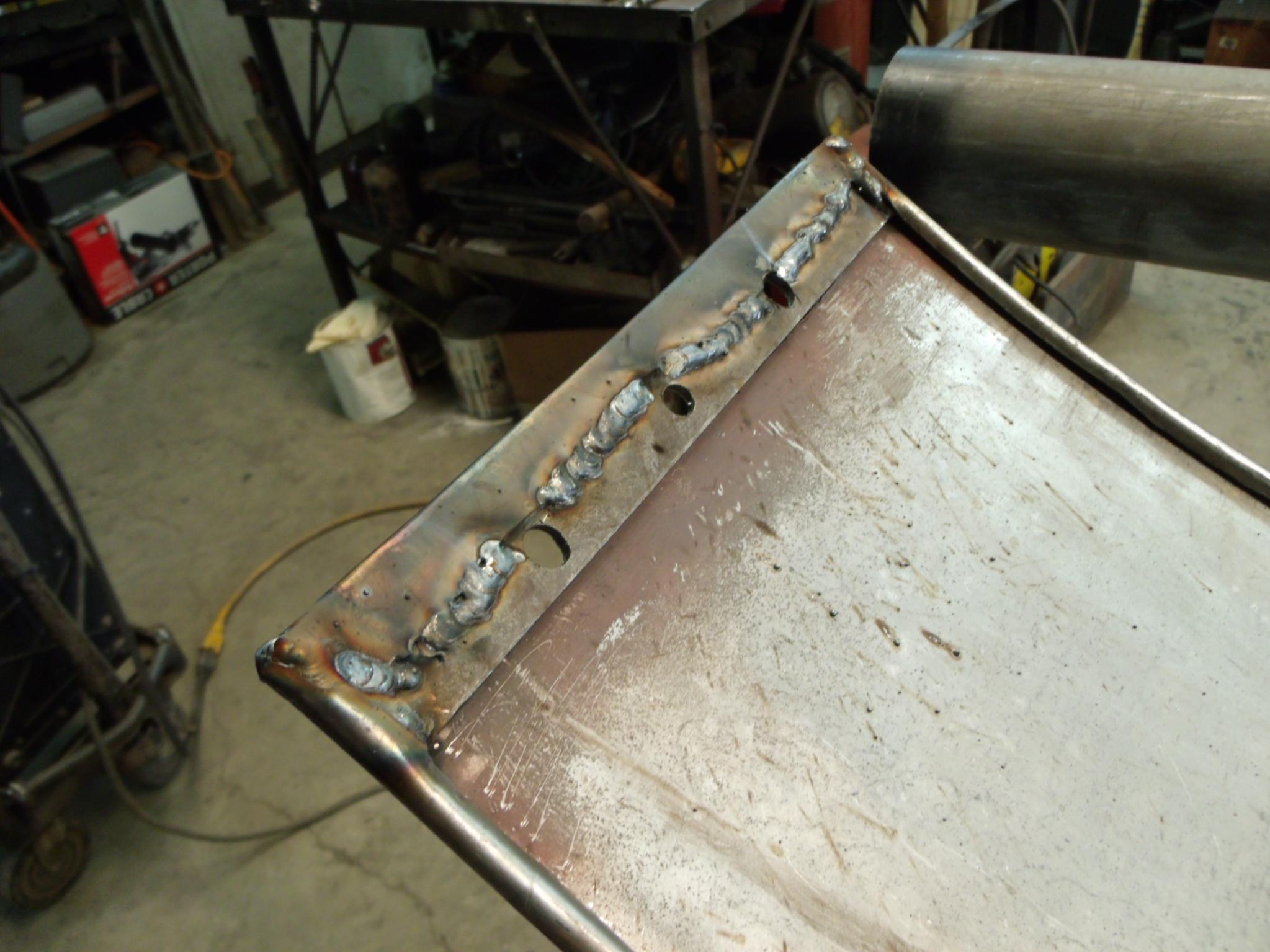

    Filing round holes square--no fun. There is a certain Zen to it, though. Whatever that means. They probably make some broach or punch that turns a round hole square in nothing flat but all I have is a Chinese file. I calculated 34 holes for all the fender supports. I'm sure this is what apprentices are for. BTW, I looked into step bolts. The heads are really big--1 1/4 for 1/4 inch bolts. Lots of variation in diameter too. So I decided to turn down common carriage bolts to an acceptable size. What the hell, I've got the time. It's faster than making a round hole square. ps. I ordered square nuts for under the fenders.

    Support Report:
    26 holes squared leaving only 8 left--4 each on the left and right lower front fender supports. The front fenders are pretty stiff without the lower supports so I'm contemplating leaving them out. The big problem now is where to prime the fenders, brackets and supports. Cold weather is setting in and I have nowhere to paint except outside. Mmmm. Pictures coming.
