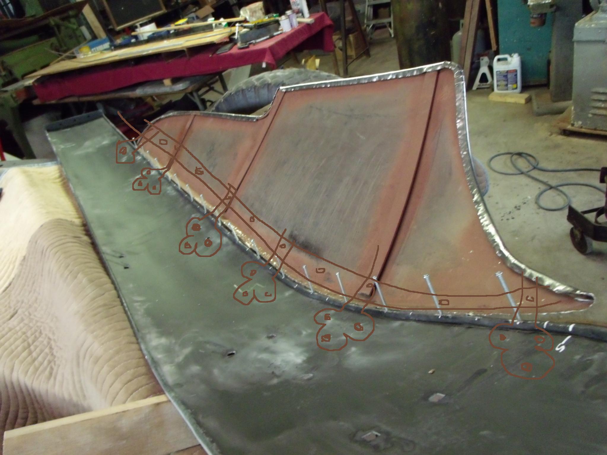

    I got to the shop a little late, but I did get there. Cut out one fender apron then welded in some stiffening members to help with the ecstasy factor. Since I don't have a fancy jig I'm going to try and roll the sheet metal over the 1/4 by gentle persuasion with a large hammer.

    I guess I needed a jig.
    Well, I needed something, a tool maybe to turn up that lip. It worked out pretty good. I also decided to spray a little Rustoleum under the lip. It can't hurt can it? The weather has been ****py here. Wet, cold overcast. Hard to get into the working mood. Plus you won't believe what they're doing around my little shop. The STATE is building a 4 lane byp*** around the town. Giant graders and bulldozers travelling up and down my road. They're cutting trees everywhere. Everybody's getting paid off but me and my little 1/4 acre. Is this an excuse for no progress? Hell, I got to blame someone! :) Driving by spring!!

    I had a plan
    I had this plan. I was going to make this 1/4 rod surround then cut out some metal form it around the surround, make up some tabs and bolt it in next to my fender. Sweet! Well when I got the thing done, or almost done, it didn't match up to the fender. It looked terrible. I knew I needed a jig! In retrospect I really needed the apron to go under the fender's lip. So I cut out the 1/4 inch rod and rebent the edge. The only way I could think to attach the apron to the fender was to drill tiny holes, insert tiny studs, then punch holes in the apron, line it all up and bolt her up. I wanted the apron to be removable. So the holes are drilled. Now I've got to cut off the heads and clean up the threads. I left the heads on because I needed to have something to tighten the screws with. I guess I could have double nutted some studs now that I think about it. Hell, I can't think of everything! Not with those bulldozers rumbling outside my door! :)
    Jerry
  10. gosh
    all this is happening under the fender ? why couldnt a strap have been bent to sandwich the apron in place wth fewer screws/bolts
    gee i hope that rod on the fenderedge is not weakend now
    a couple three- four clover leaf shaped straps a few more carrriage bolts ?
    them bull dozer do not run 24-7 do they?
    wishen yall the best good luck

    Apprenticeship
    I think I was supposed to have an apprenticeship or something. Well I'm learning. But then again, I always was a slow learner. I got my little studs in and cleaned up the threads and punched some holes in the apron. Of course all the holes had to be adjusted by hand. You see I should have punched the holes first then used the holes as a template to drill the holes in the fender. Live and learn. The other side will be easier. Because to took out the 1/4" rod the rolled edge got ******ed so I have to rework that. At least the rain has stopped. Left my camera at home so you get ****py cell phone pics.

    Looks like it's coming along well.
    A bit late for you, but Harbor Freight sells a rivet-nut tool that will install machine screw threaded rivets in sheet metal.
    I used one for my toe board and trans cover in my coupe.
    Costs under 20 bucks.
    BUT, it's best if the back side is not seen. They're not pretty on the back side.
    Sets 3/32", 1/8", 5/32", and 3/16" blind rivets and
    Threaded nut sizes: 6-32, 8-32, 10-24, 1/4"-20

    Did they have those back in 1923? As you know I use only authentic 1923 tools and techniques. All my machines, hand tools, electric hand tools (built in China in 1923) and fasteners were made in 1923. Even the electricity I use was generated in 1923 and has been circling the grid until I captured it, had it thoroughly identified by electricity experts as 1923 electricity before running it through my tools. Rivnuts?! :)
    So I think I finally have the fender apron thing down. I may very well be able to make the right side apron in about 30 minutes. I tidied up the apron, rolled the edge and made some welds. I still have to cut down the fastening studs and rivet the stiffeners and make up some attachment tabs. Just checked the pictures--boy are they bad! My camera ****s. I tried the macro function--note, don't do that.

    Right side
    I worked on the right side apron. It might take a little more than 30 minutes, but not much more. I got the top and bottom formed. I think my right biceps is getting bigger than my left from swinging the hammer. I hope the girls at the beach won't mind too much. Okay I learned a big Chinese secret when using your 1923 hole punch and flanging tool. The thing will stop working to good and here's the reason--it's out of oil. The tool is air over hydraulic. You can try pour oil in that filler hole--good luck! I dis***embled mine and filled hydraulic part with ATF. Worked great! Cell phone pics again--sorry. Jeez, I just looked at them Bad, bad, bad. Sorry!
    Jerry
