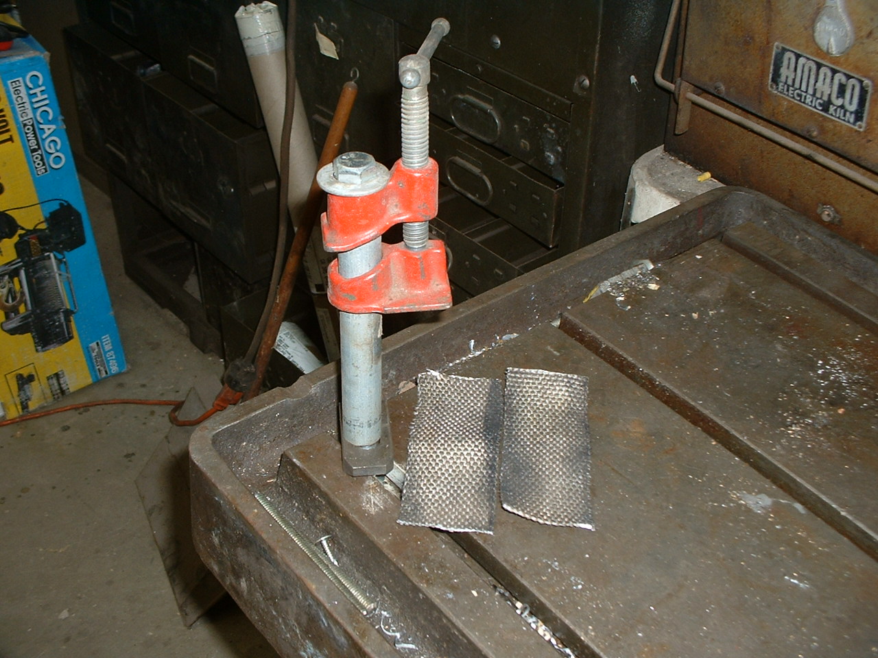

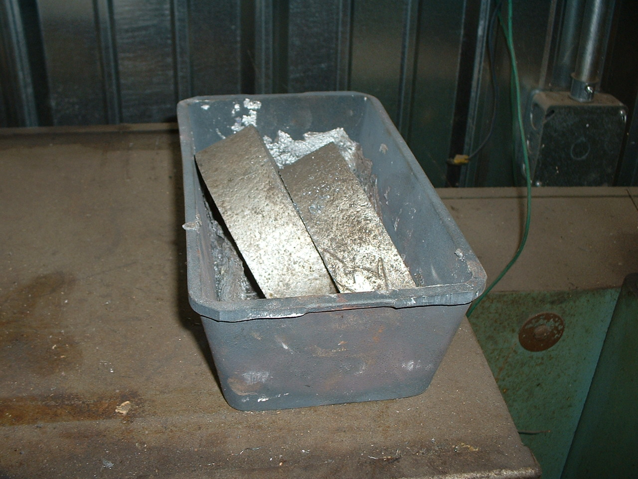

    Oil plug
    The oil leak I had was because I was missing an oil plug that goes in the oil level indicator. It's a 1.5X16TPI plug and I can't find one so I'm going to make one. I've done a little aluminum casting so I made up a plaster cast off the oil pan plug which is identical. I heated the mold in the oven to drive out any moisture left in it. Tomorrow, I'll melt some aluminum in the same oven and pour it fill. I use a cast iron bread pan. I'll have to touch up the threads on the lathe but that's better than machining up the entire plug. It should come out pretty good. I hope. The clamp is to hold the mold together. I'm thinking the top might float off when I pour it full.

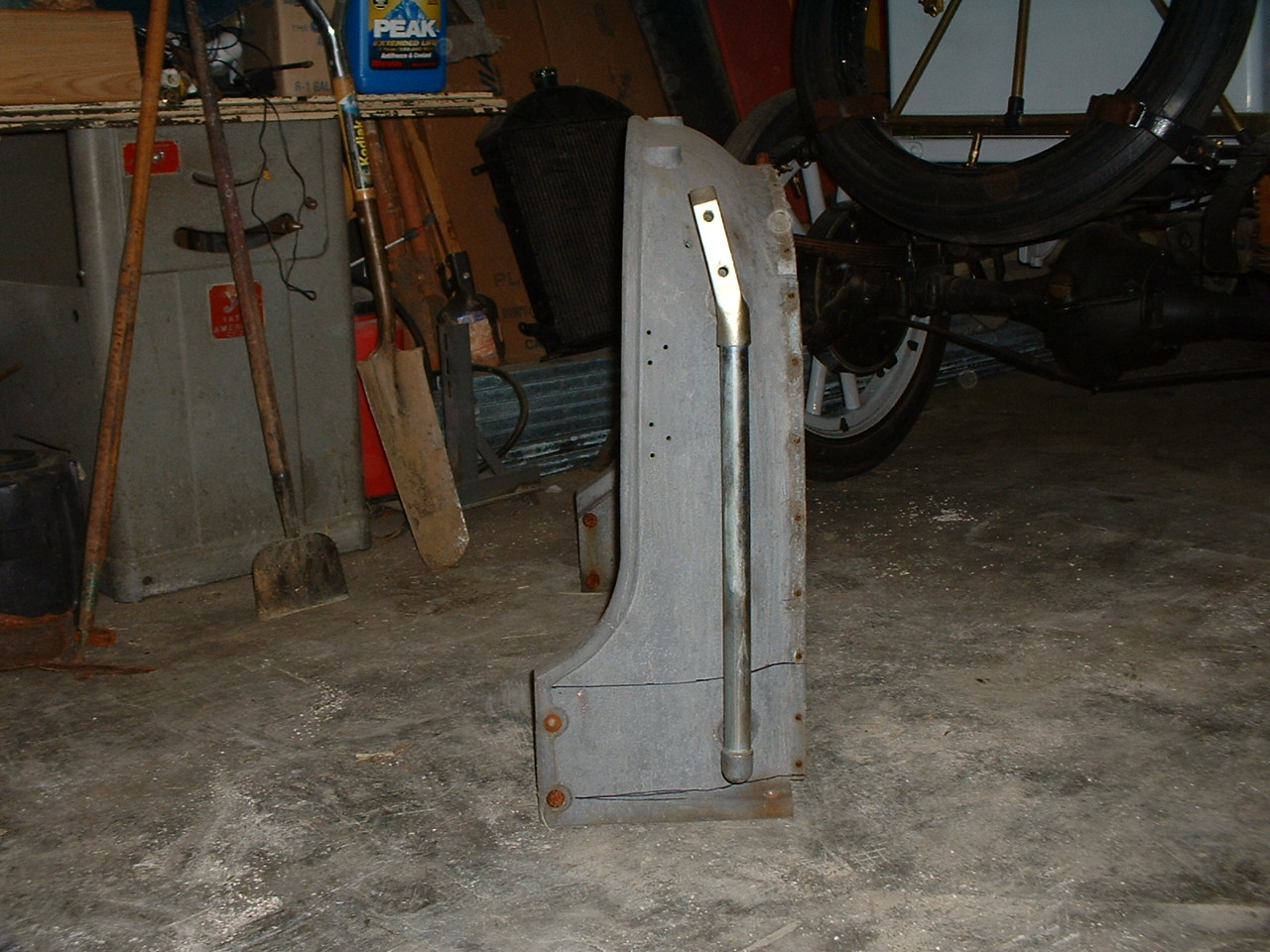

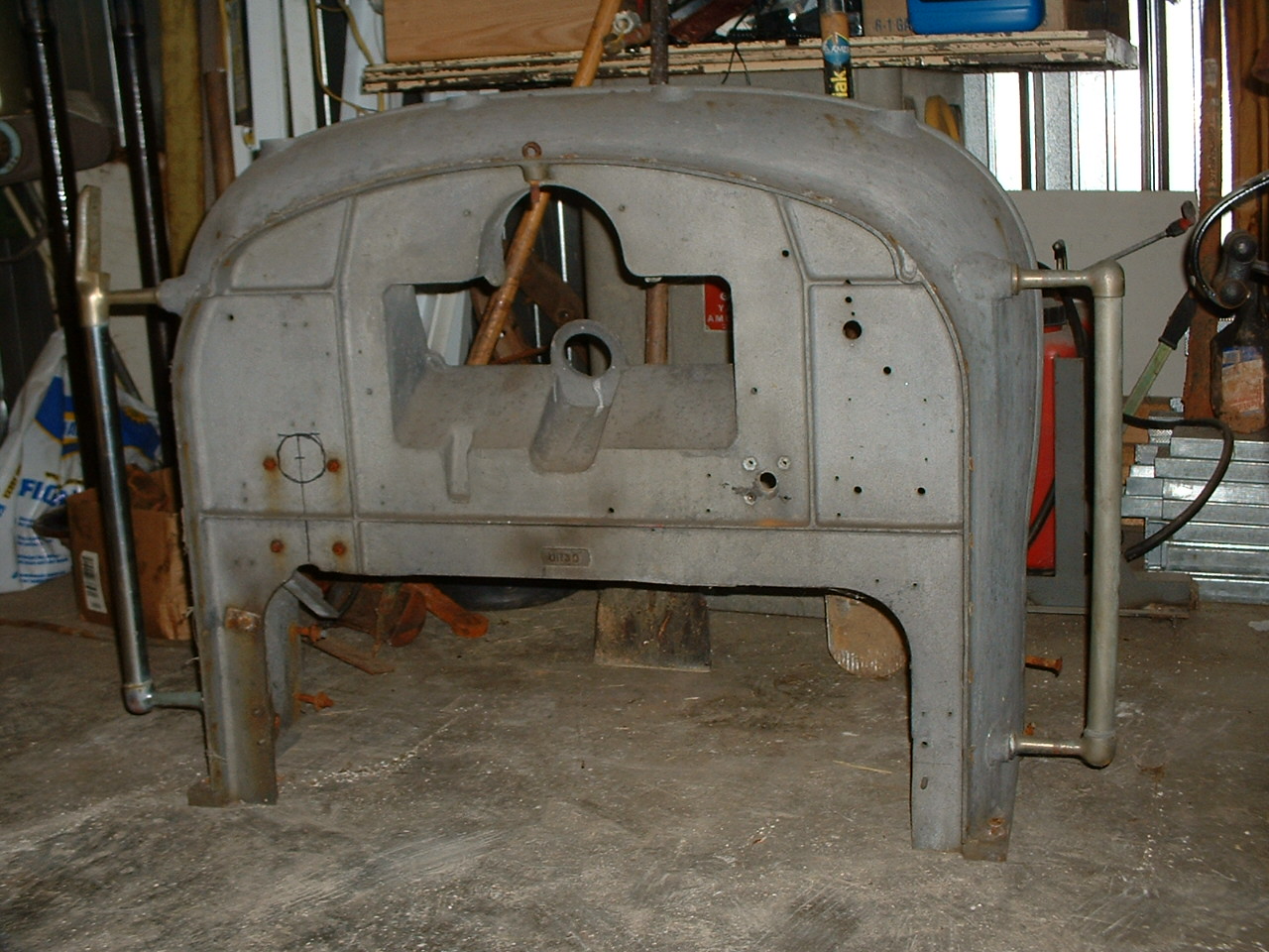

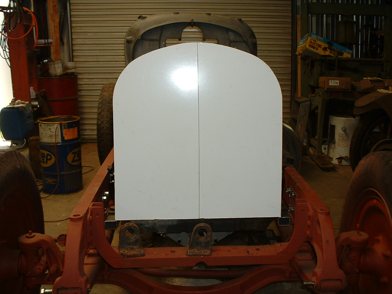

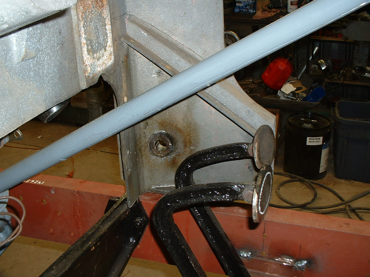

    Cowl
    The firetruck came with this neat aluminum cowl. It's got some br*** handles and a few protrusions on it but they can be removed. The cowl is not so aerodynamic but it is cool. I was going to cut off the lower 7 inches and bring the doors an inch or so off the frame height. One has to picture it with doors fitted and the back half of the body in place. I even toyed with the idea of polishing it to a high luster and doing the rest of the bodywork in aluminum. So here it is. You can see a similar cowl in the last picture of a Mercedes. I'd appreciate any comments about using it.

  4. yonahrr

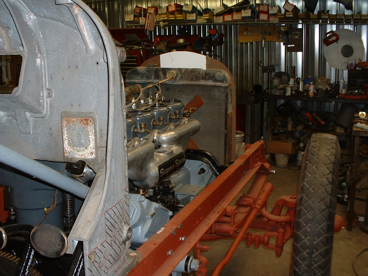

    There's a big Seagrave V12 and ****** on ebay for $700.00. How about a 50's V12 Speedster?

  5. Jerry- the owner of the restoration shop I used to work for had a early 6 cyl speedster that had a cast aluminum cowl. Will see if I canj get him to send me some pics (he was midway through the project when I was there).
  6. ... that cowl is fantastic by the way!!!
  7. thats a great cowl. very cool.

    I will have to go check that one out! If I remember right, those Seagrave V-12s were actually a Peirce-Arrow design that was purchased by Seagrave when Peirce-Arrow folded in 1938. The Seagrave versions are mostly unchanged from the original Peirce design dating back to the early 1930's...I believe they employed them all the way into the 1950's if memory serves.

  12. Jerry,
    Go to your private messages (I just sent you one anyway) and you'll find "edit sgnature" on the left.
  13. Watching your video- DON'T CUT THERE!!! That curved area gives the cowl great character. I would go up and take material about 6-8" higher where the cowl thins out a little.

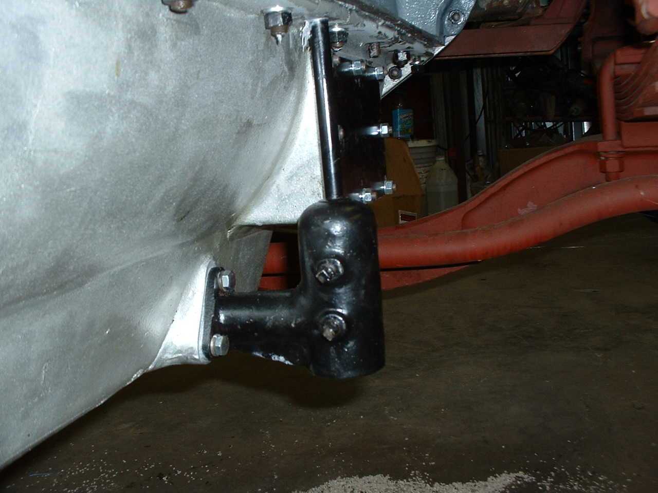

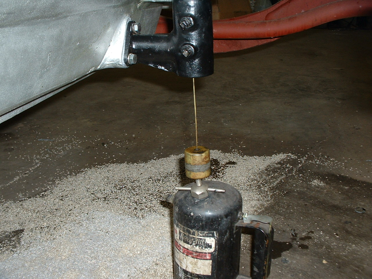

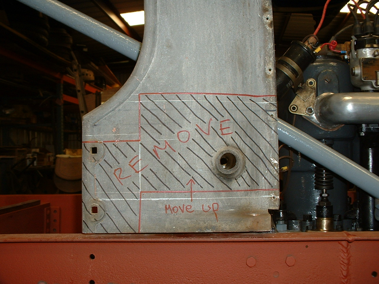

    Cowl
    First I finished installing the oil level indicator that I made the plug for. You can see the float that goes inside it. There's also a small red ball that fits the top of the wire. After that I worked on the cowl. As you can see I marked out where I think it ought to be cut. Some objected to where I was cutting but I don't think I made myself clear. I've got to get the bottom of the cowl lower or else the pedals will interfere with the floorboard. On the inside shot you can see where the slanted floorboard goes. That has to be lower or the pedals will not stick up high enough. Take a look and let me know what you think. Also forgive my cr*** commer******m but maybe there are some guys with ebook readers out there.

    I think it'll look good with those sections removed. I understand the previous comment too, but seeing the floor mounts on the inside, sometimes something has to give.
    I love this project, really.
  26. You could reposition the floorboard "shelves" starting at the bottom of the cowl. Then you'd simply be running your horizontal floorboards on top of the frame. I love the look of a Mercer/Stutz raceabout, but it can almost have too much of a spindley look (having trouble putting my thoughts into words) like so many of the early T raceabouts have.
    Having that extra few inches will make your body choice and car stand out from the others in a good way.
