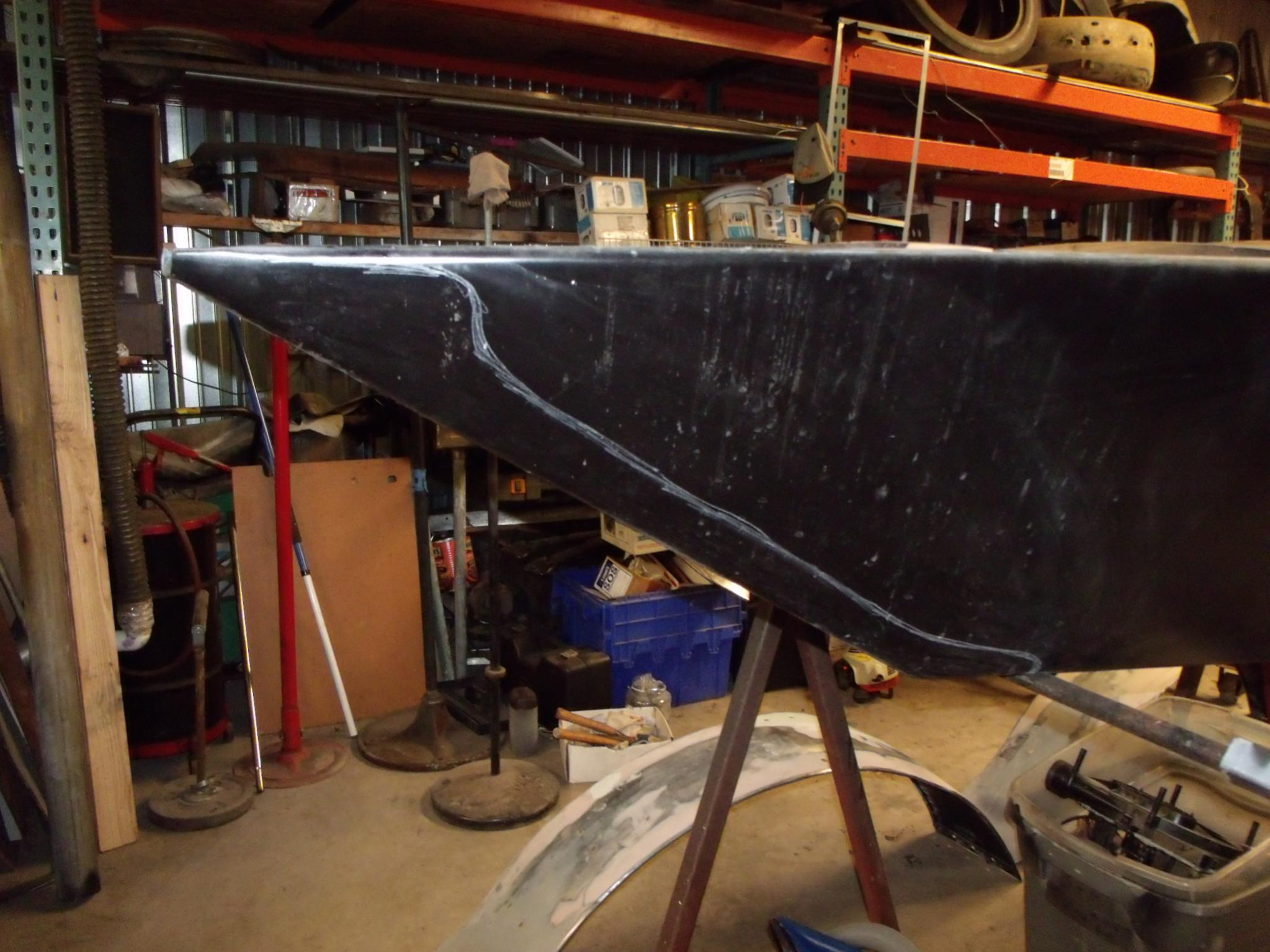

    I'm trying a new setting on the camera. It looks like a lady wearing a big sun hat. That's what technology has come down to--your index finger moving around a screen and an icon of a lady in a sun hat.

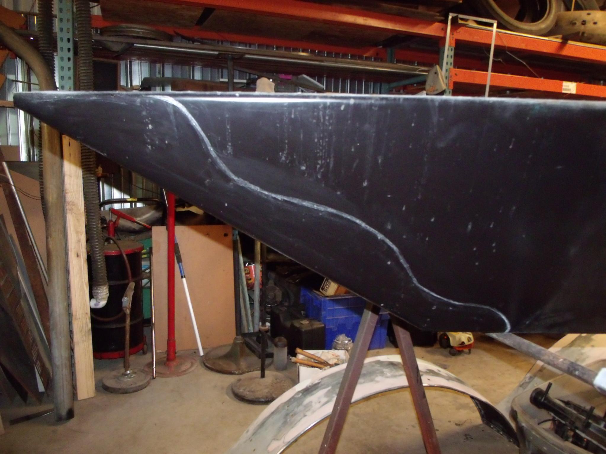

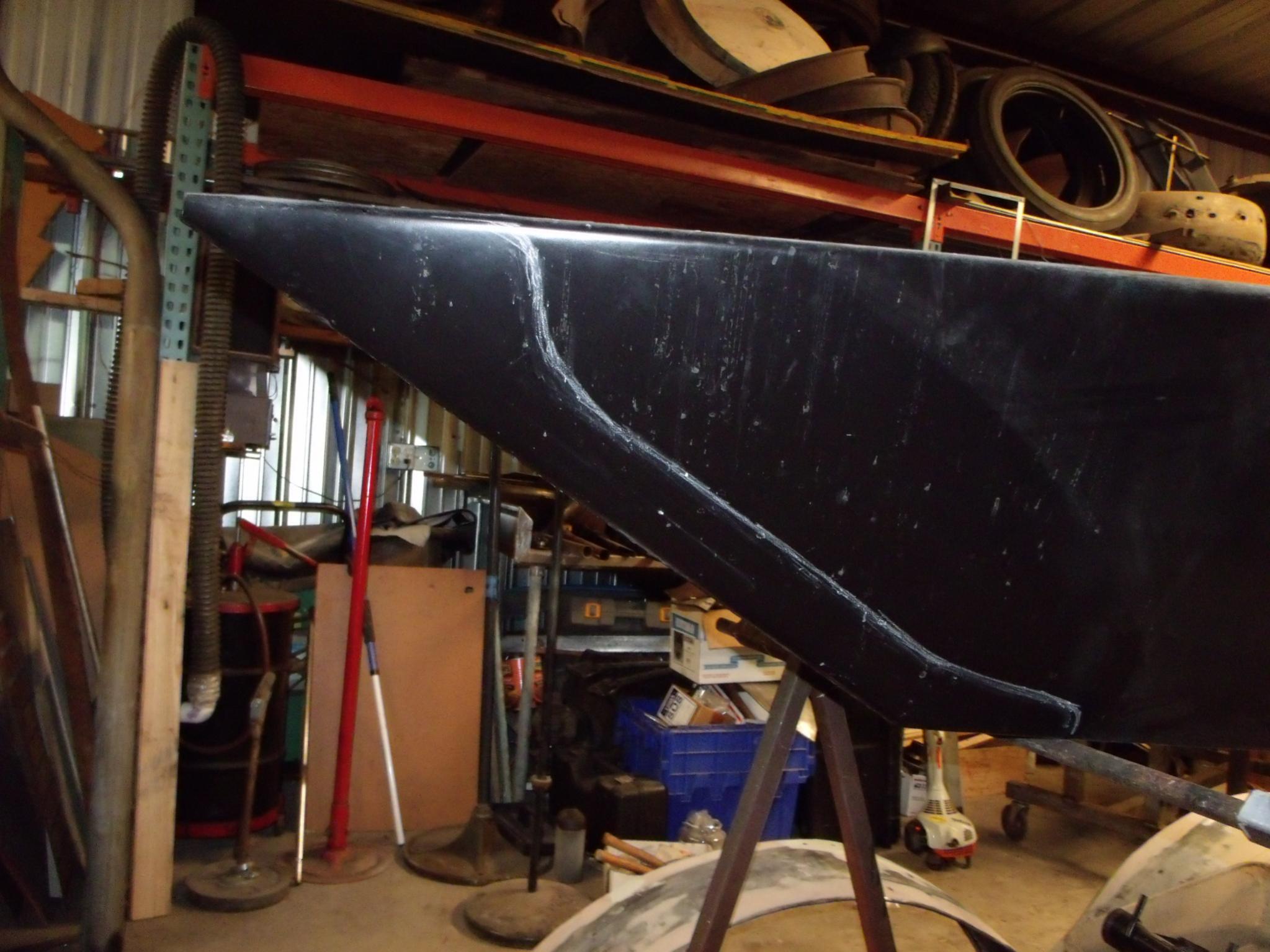

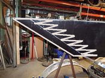

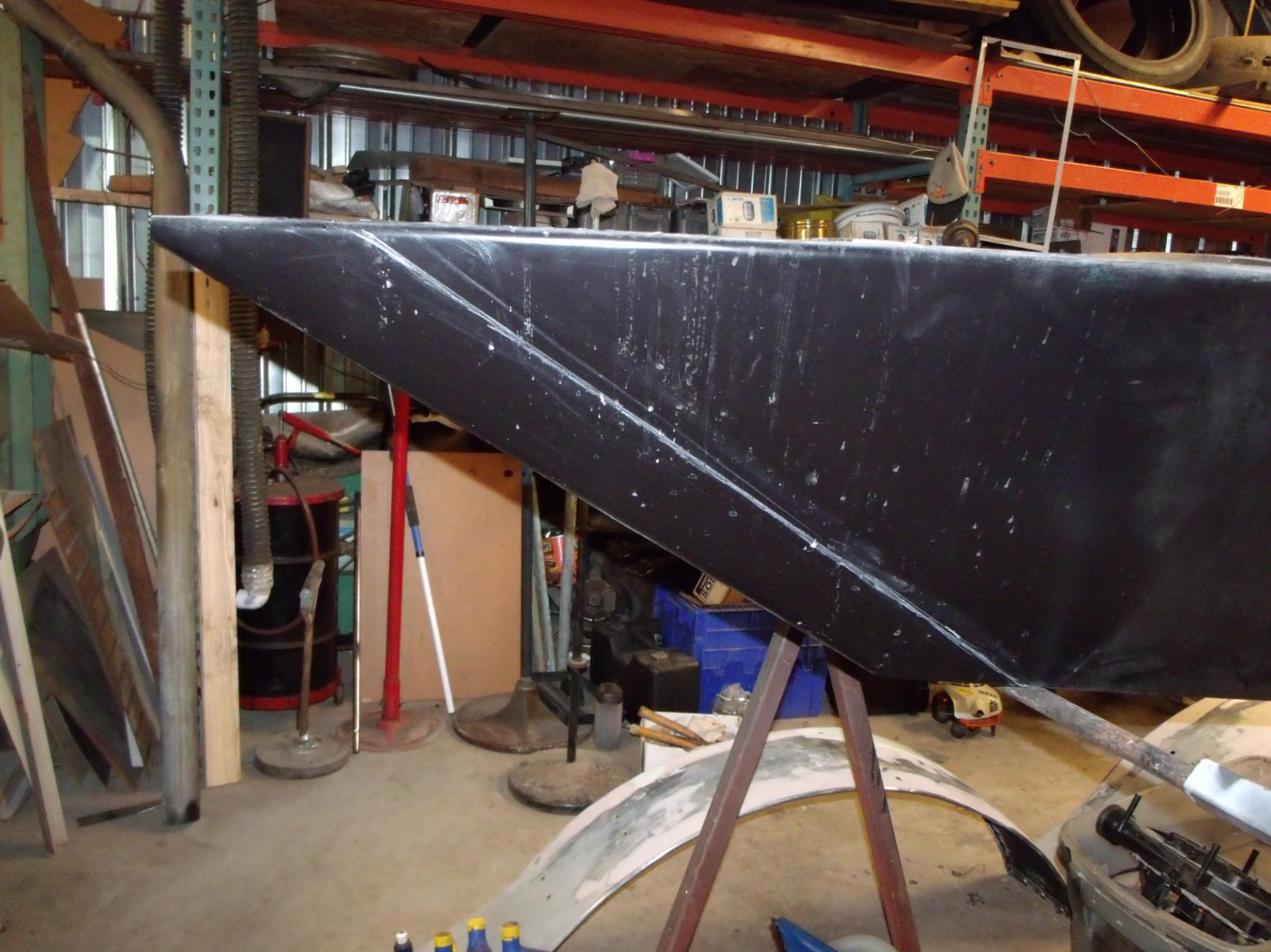

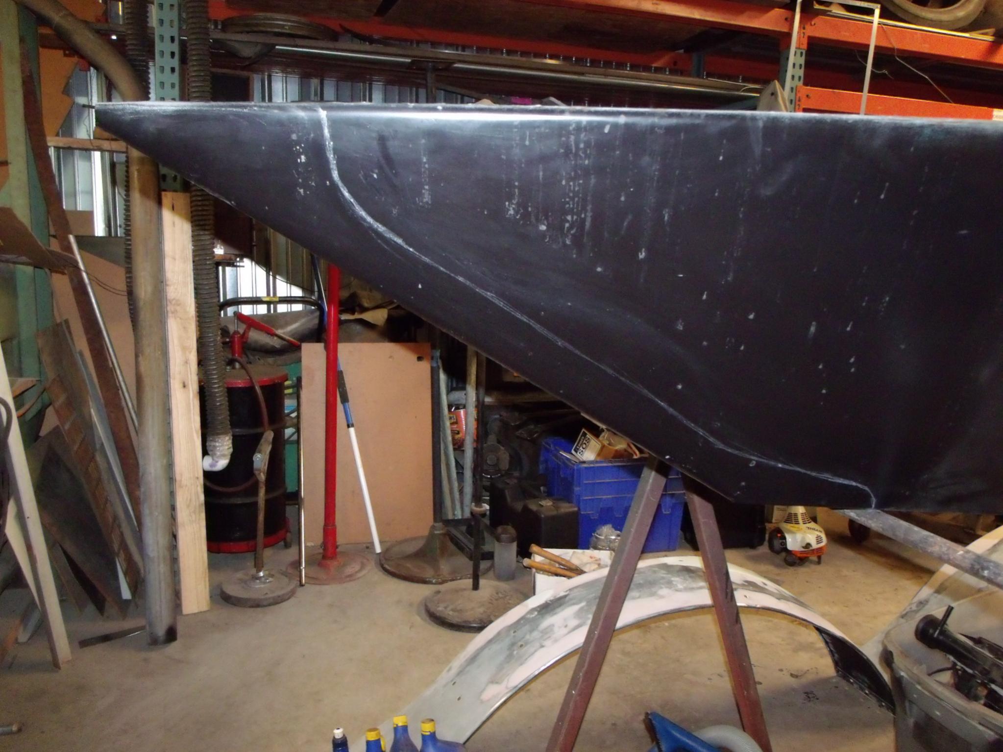

    I'm trying to get all the metal work done so I can move on to the holy grail of PAINT. You'll notice that the word PAINT is made up mostly of PAIN with just a T thrown in for fun. I think that's on purpose. Other than the rear fender aprons the last thing is the metal that finishes off the boat tail. What do we call that? Stern plate? I wanted to make it out of br*** but since the radiator is nickel (or German silver) I suppose to balance things out the stern should be nickel too. I using stainless because it looks pretty close to nickel and it's readily available and inexpensive (cheap). The metal arrived all beat up but luckily I think I can cut what I need out of it anyway. So here's some choices on the shapes. Some look the same but there are suble differences. Feel free to submit your own.

    I vote for a gentle continuous curve, similar to #3 and #6 without the flat spot on the bottom.

    From left to right, number three.

    I would go for straight & traditional with a cap at the top.

    Top row, number two or three. Like the bow trim on an old Dodge or Gar Wood runabout. Done.

    I concur.
    Like the fourth boat from the left.

    X2...That one just looks right!

    number three. top right

    Century Boats often had interesting bow pieces. Here is one that would suit the tail of your car. It likely could be fabricated in stainless steel. Coming back over the deck is very helpful in covering the junction of all of the deck sheeting at the "bow". It makes it easier to fit the deck planking & protects it in use.

    Easy enough to rattle-can some silver on there in different styles to see what suits your fancy without hacking up 'spensive sheet metal.
    There are lots of straight (or mostly straight) lines on that car, so some consistency in the trim might be either too much or not enough. Need something to throw off the public? This might be your opportunity.

    Any way to show us what the whole car looks like from the side?...I would like to make a sketch of the boat tail shape, but I think we should take the whole car into account so the shape relates to the rest of the vehicle....there may be a curve in the doors or fenders that will tie in.....

    Top row #2, it is more in keeping with the overall look of the vehicle.

    Lots of great suggestions. Side view of the speedster? Search back threw the posts you'll find a bunch. Stern cruiser? Once, I had dreams of sailing a double ended ketch single handed around the world. Now I have dreams of finishing a speedster.
    Working on the ***umption that it's hard to put metal back I cut out #2 I think. I can cut off the bump on the bottom later if it offends me. The photos make it look bigger or smaller than the eye sees it. Something about the curve.

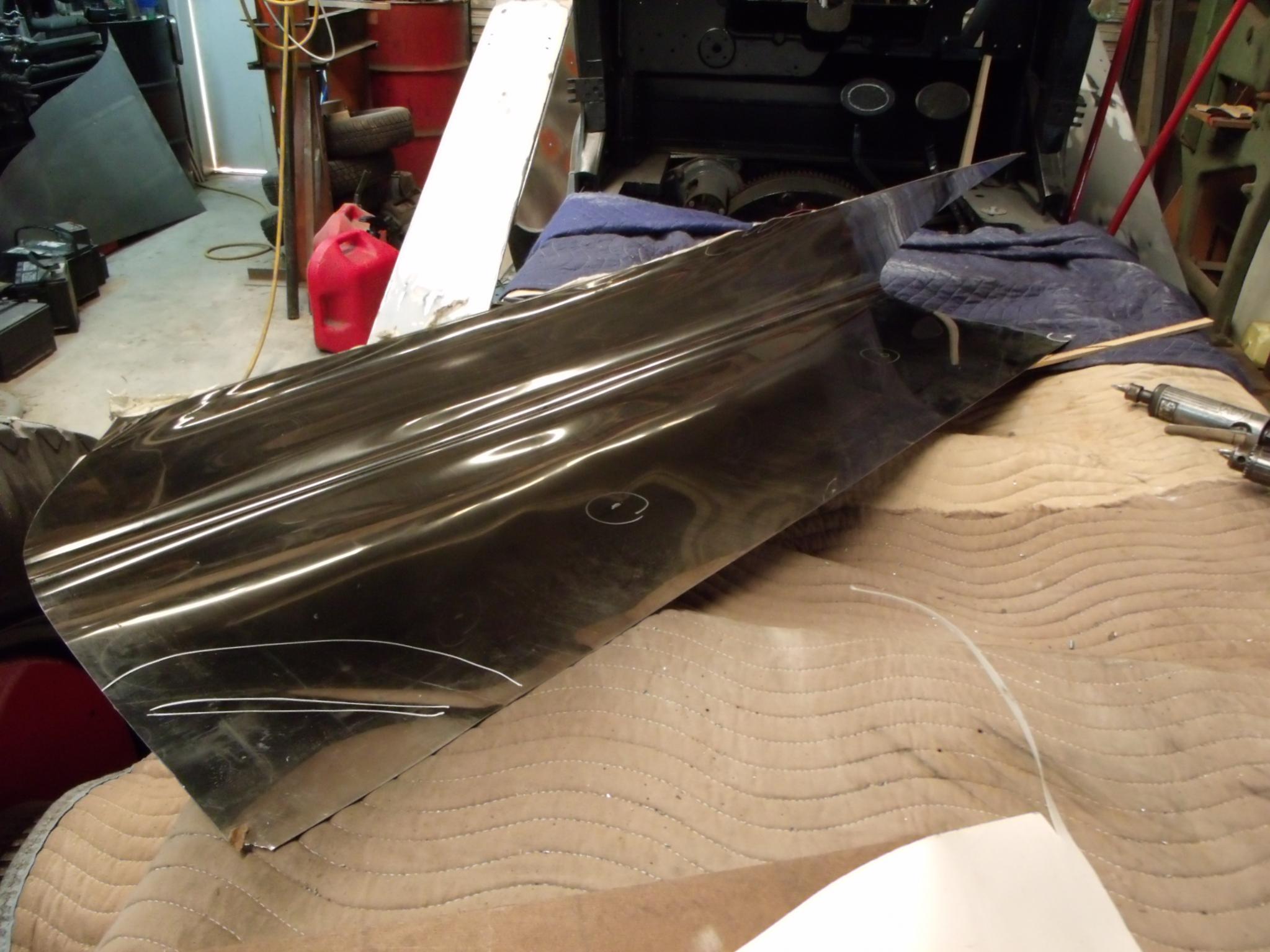

    I did manage to pop some holes in the stern piece. I couldn't drill them, the stainless just got hard. My whitney punch popped the holes but I really had to lean on it. I ordered some stainless screws to make threaded rivets out of from MacMaster Carr and they should be here on Monday. I couldn't afford the real thing from Restoration Supply because they would have cost over $50.00. I can make my own for about $10. That leaves $40 for something else. The last sheet metal work is the rear fender aprons. They're going to have to go under the fender supports because of the muffler supports. Maybe I can start on them tomorrow if it's not too cold in the shop. They're saying 21 degrees tonight.
