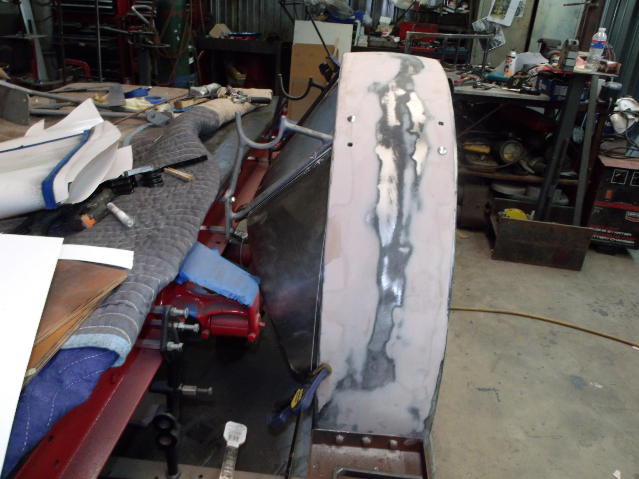

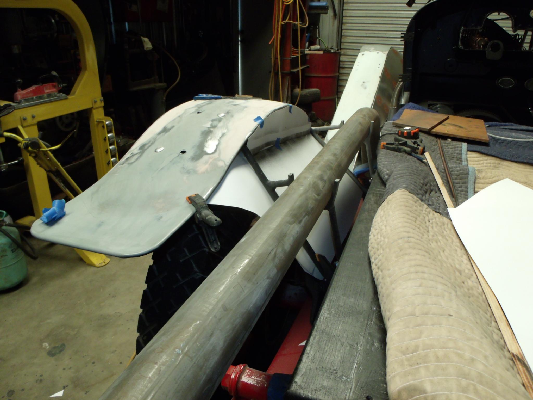

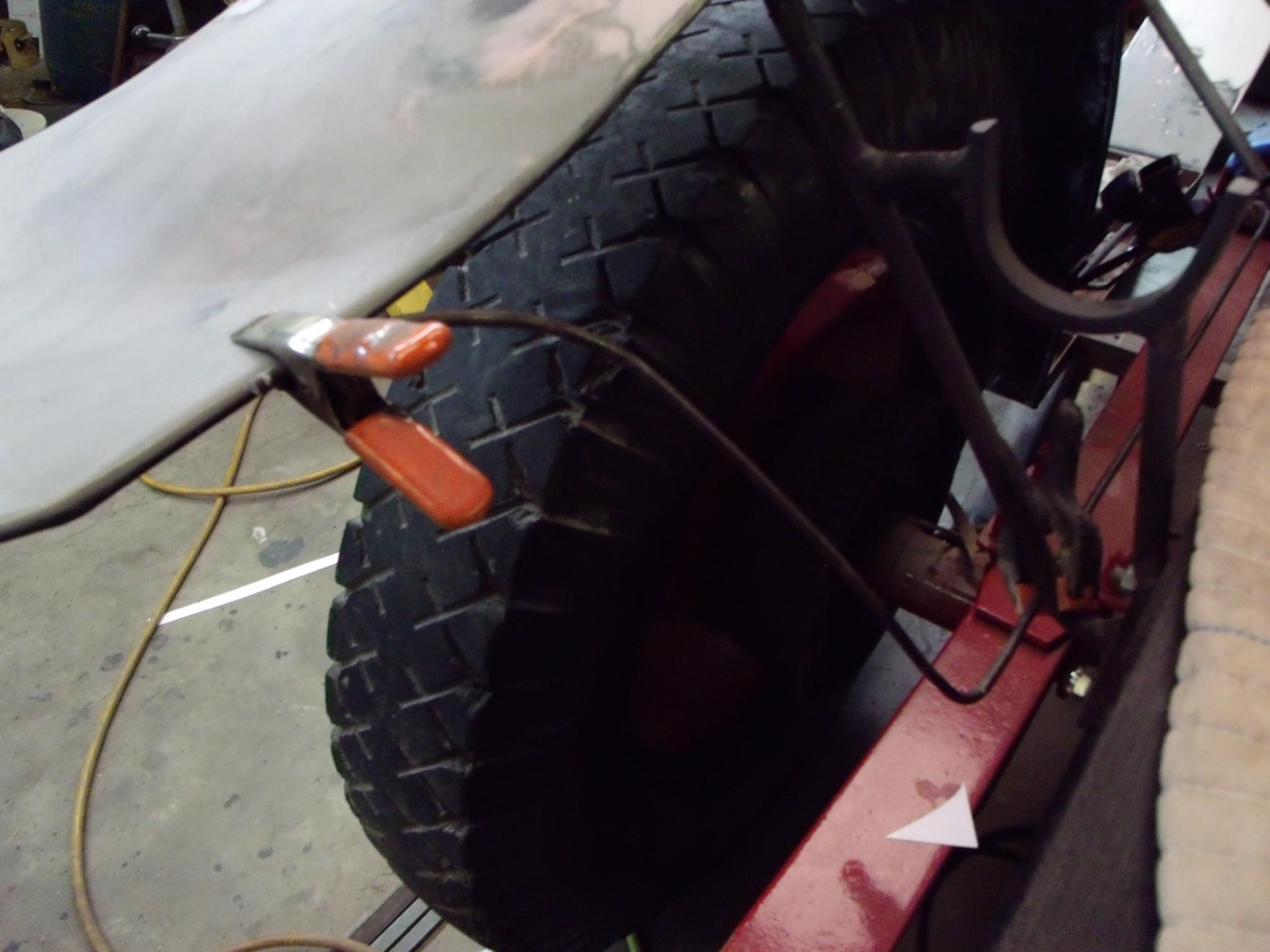

    The giant speedster started out as a bare bones big racer that wouldn't have needed any fender aprons ( or even fenders) but it kind of grew into a gentleman's giant road car and that's when I figured it needed aprons.
    Hey Jack, would we know any of the movies it was it?
    Rear fender aprons:
    I got some Walmart poster paper. This stuff is really cheap. Where can I get something about three times as thick? Anyway, I mocked up some rear fender aprons to get an idea of how they would look. See what you think. I have to go under the fender supports unless I make the aprons in three pieces which will be pretty labor intensive.

  6. lamb en ating? the paper will work with spray contact cement ...
    or even just doing reinforcement strips around edges...
    or taping wire to the paper to hold shapes ...
    foil tape...
    gogogogo
    just a thought after closer scrutiny of the mock up .:D.
    have all the apron tuck under the edge of the fender ..so about a half inch of overhang of fender above all the apron
    visually keeping the two separated :)?
    and bring the apron back to the tail a bit more?:rolleyes:

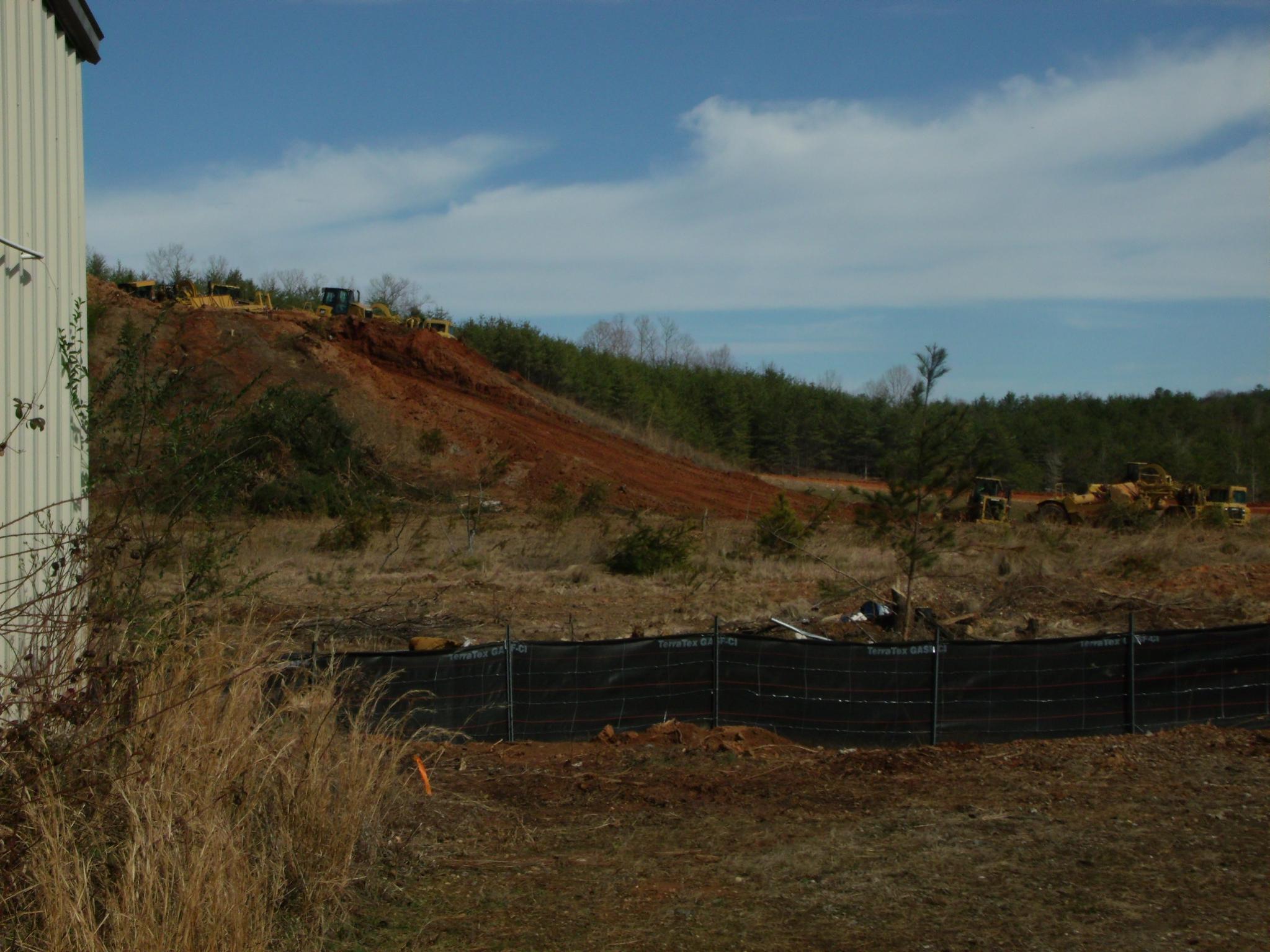

    Remember that song? The Little Nash Rambler? Of course, I hadn't been born yet. You believe me right? How come songs like that don't make it on the radio any more? Or do they? I only listen to talk radio. You can see in the picture all the grading going on behind my shop. Well, the big diesels are droning all day long, but that's not what drives me insane. It's the constant beep, beep, beep of the back alarms. Man! I'm going crazy!

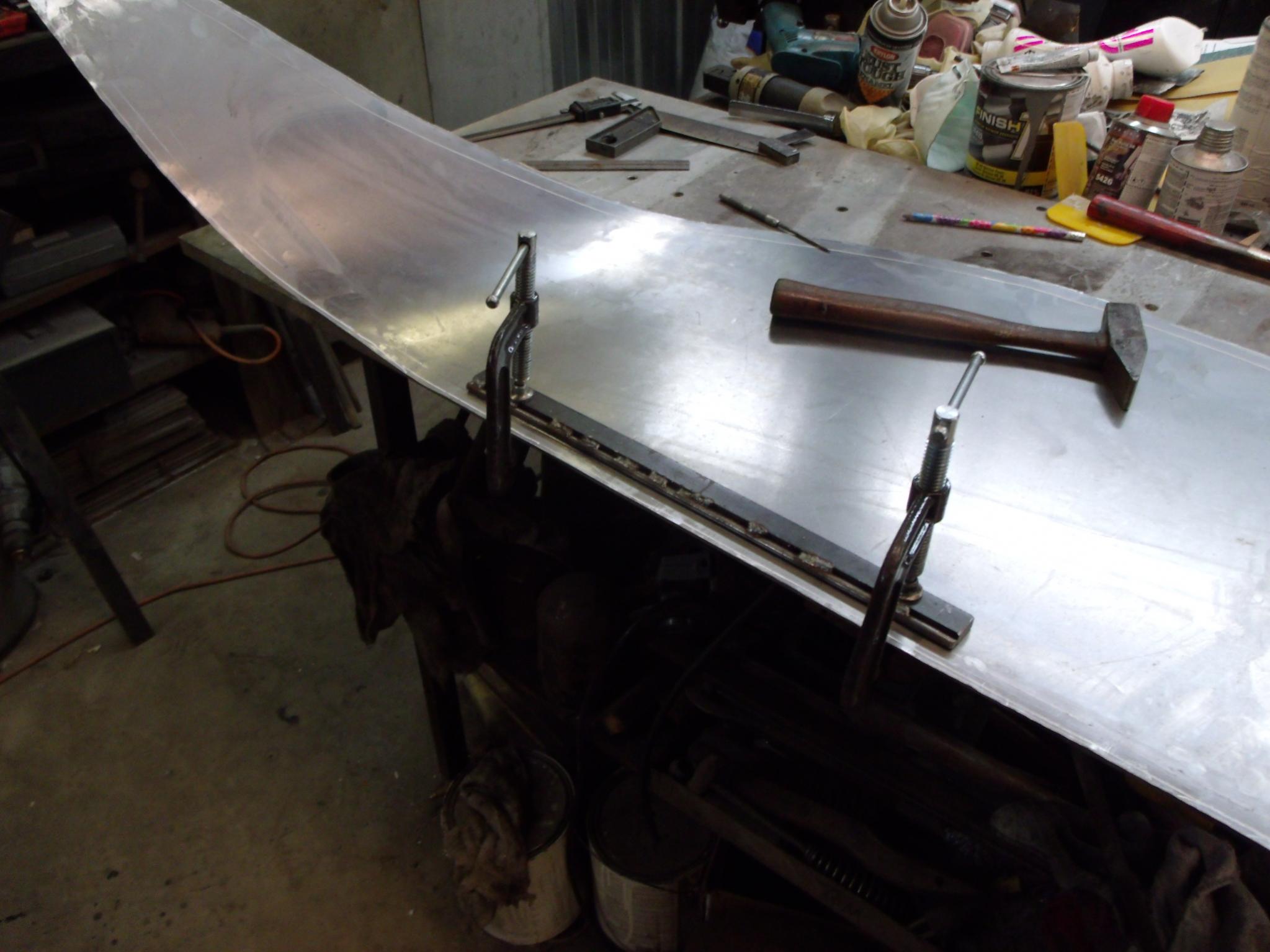

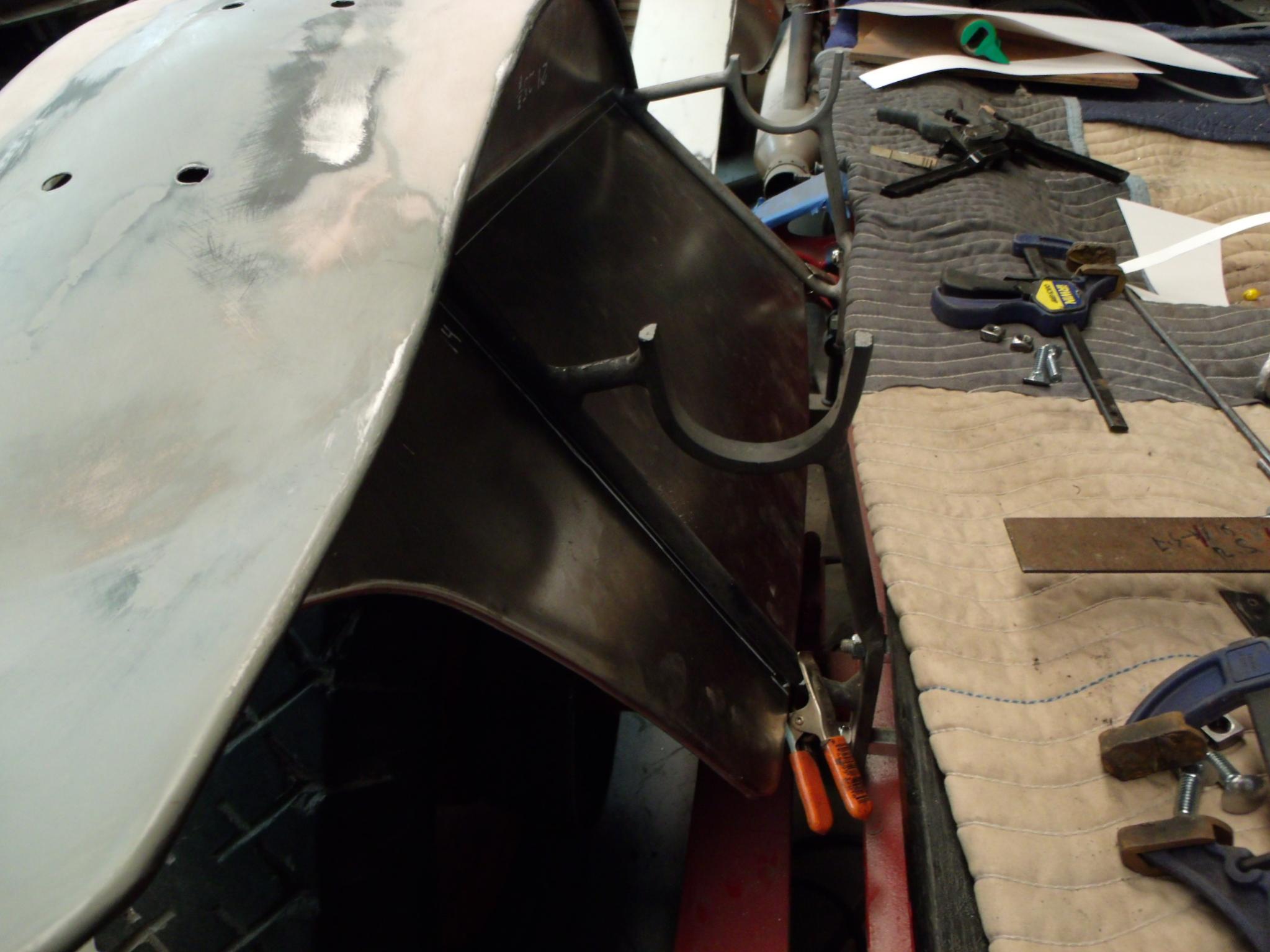

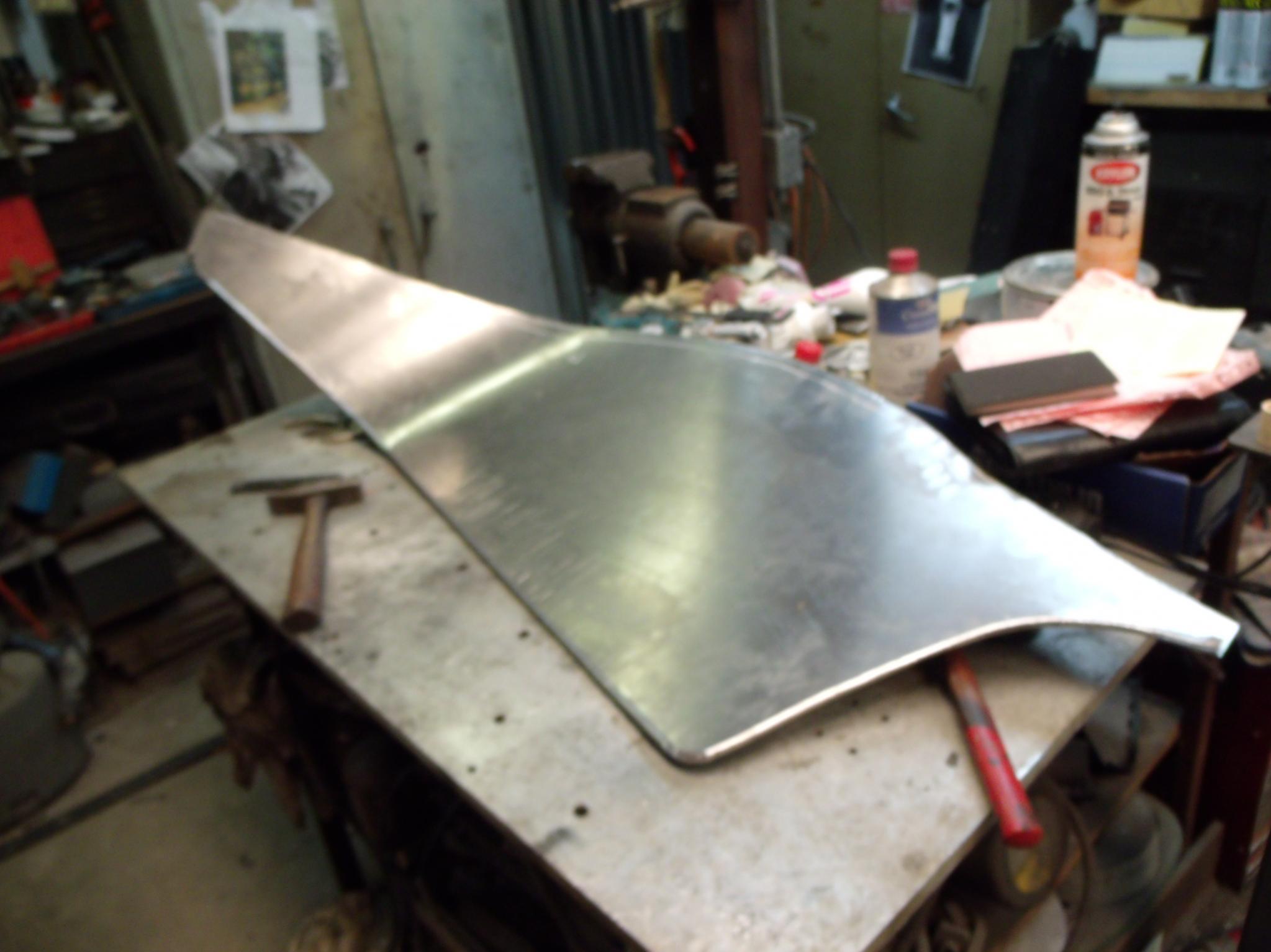

    I bent up some more 1/4"' rod for the perimeter of the rear aprons and drew out the shape on a piece of sheet metal. I hope to get to the shop today and cut it out. First I've got to go by Yonah Station and make a handicap ramp (this is our first dry day in about a week) out of asphalt patch. My architect told me the new handicap bathrooms have to be 8' X 10' Wow! You're supposed to have room for an attendant now. Luckily, the business is not expected to provide one. Good thing I'm not constructing any more buildings.

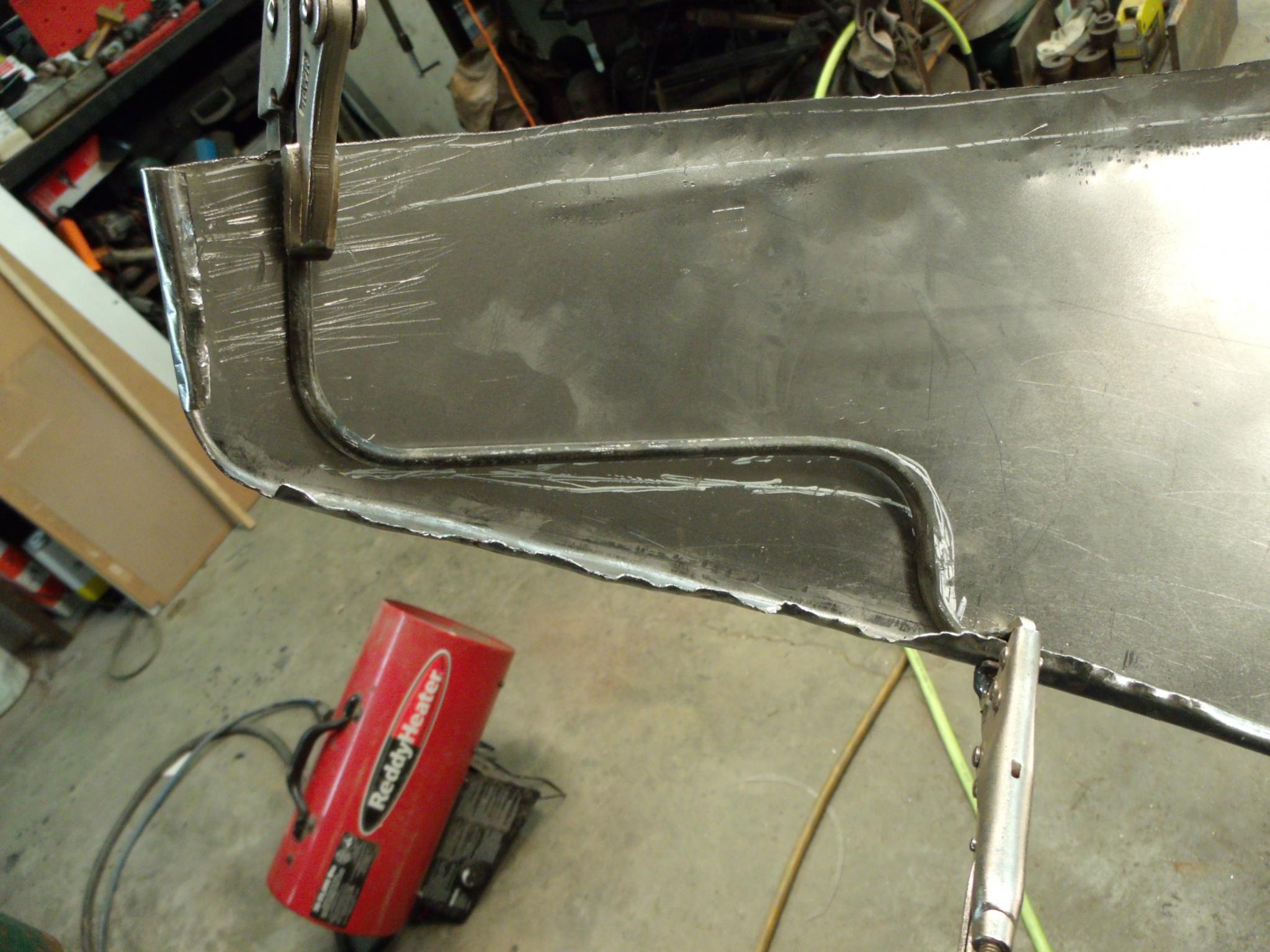

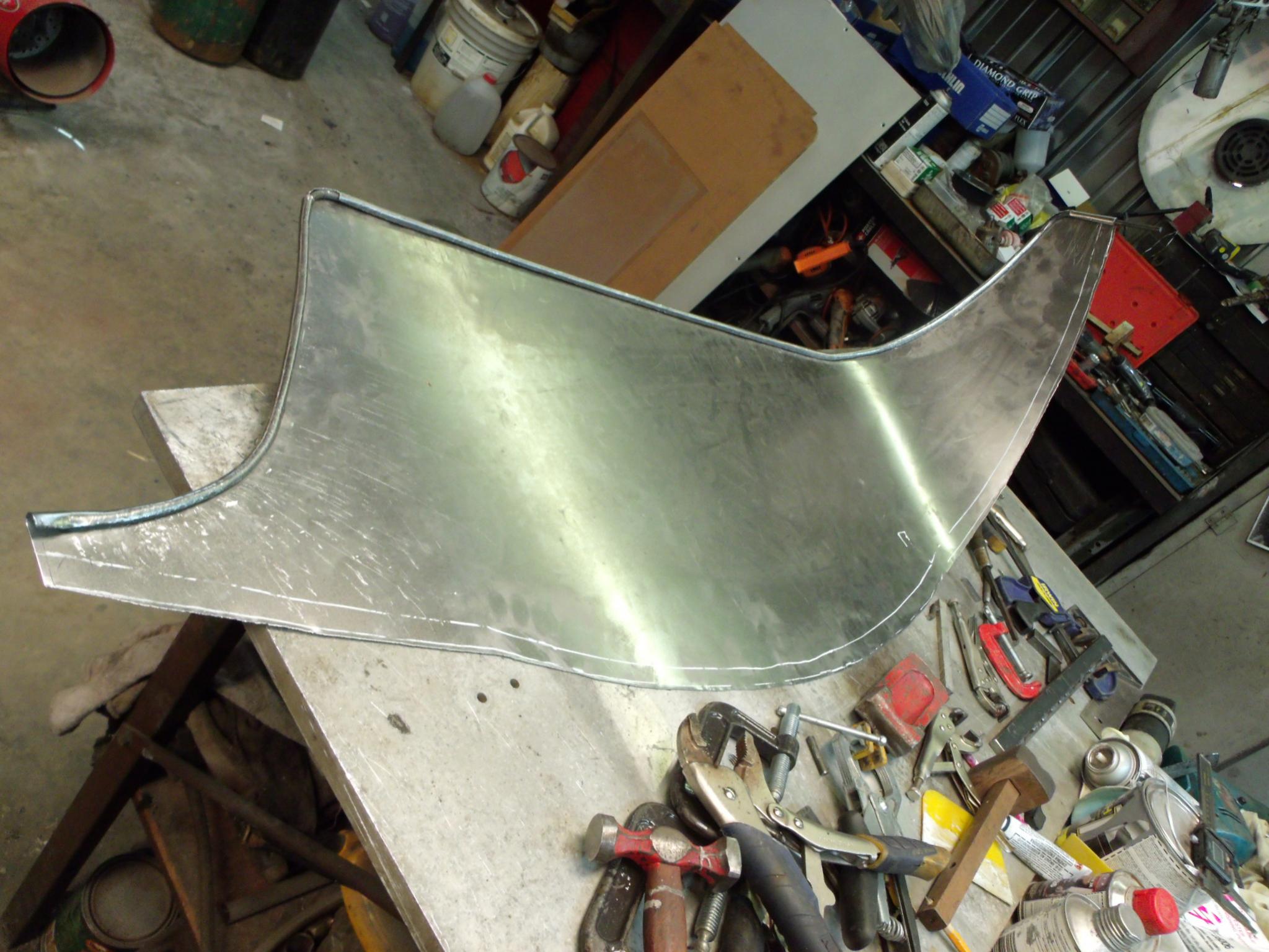

    I cut out the sheet metal and bent it around the 1/4 round. A lot of banging instead of beeping. Tomorrow I'll have to fit the apron to to the car. This will be where I find out if I made any colossal mistakes. There's always one blurry picture.

    I came down to the shop the other day and there was a lake on the west side of the building. The graders had buried a culvert that drains my property. It had been raining for two days and the water had built up to within about six inches of the building's slab. I made some calls. I guess there was no danger of flooding since the rain had mostly stopped, but still... The next day they uncovered the drain so now I just have soggy land.
    The rear aprons are more work than the front ones. More bends and stuff. It took me all day just to get it to fit half way. I still have to come up with some fastening method. I may not even fasten the apron to the fender but instead let it float free. I like that--float free. I want to float free--in the surf on a beach in Antigua!

    It will rattle unless you tie it in somehow, or put some rubber in between the two pieces.
    But it's good that the rain stopped before your building floated free :)
  11. strong magnets.... string...:)
    or attached to the fender bracing (your choice how) with leather gasket between
    strap over the two brackets
    bolts thru the two bracket
    studs under the two bracket ??????

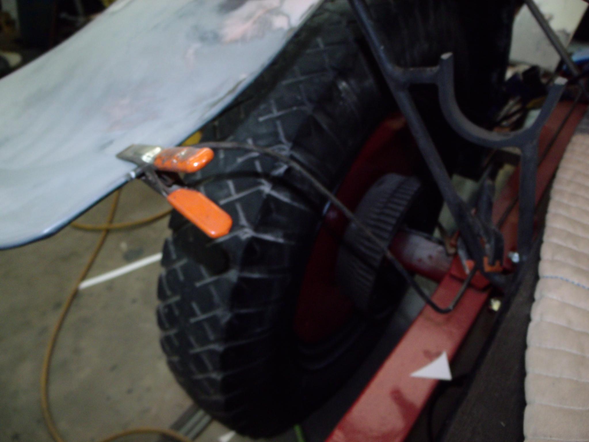

    "Gosh, this rear fender apron is awfully close to the rear spring," Jerry said scratching the few strands of hair he had left.
    "Ach, mon, you've gone and cut the metal too close," said Neil, Jerry's friend from Scotland. "Now you'll have ta make the blasted apron all over."
    "Nonsense," said Jerry, "watch this."
    Jerry took out his pliers and with deft strokes peeled back the metal he had previously bent around the rod that formed the apron's cir***ference. In minutes he had reshaped the rod and recut the sheet metal to provide clearance for the rear spring.
