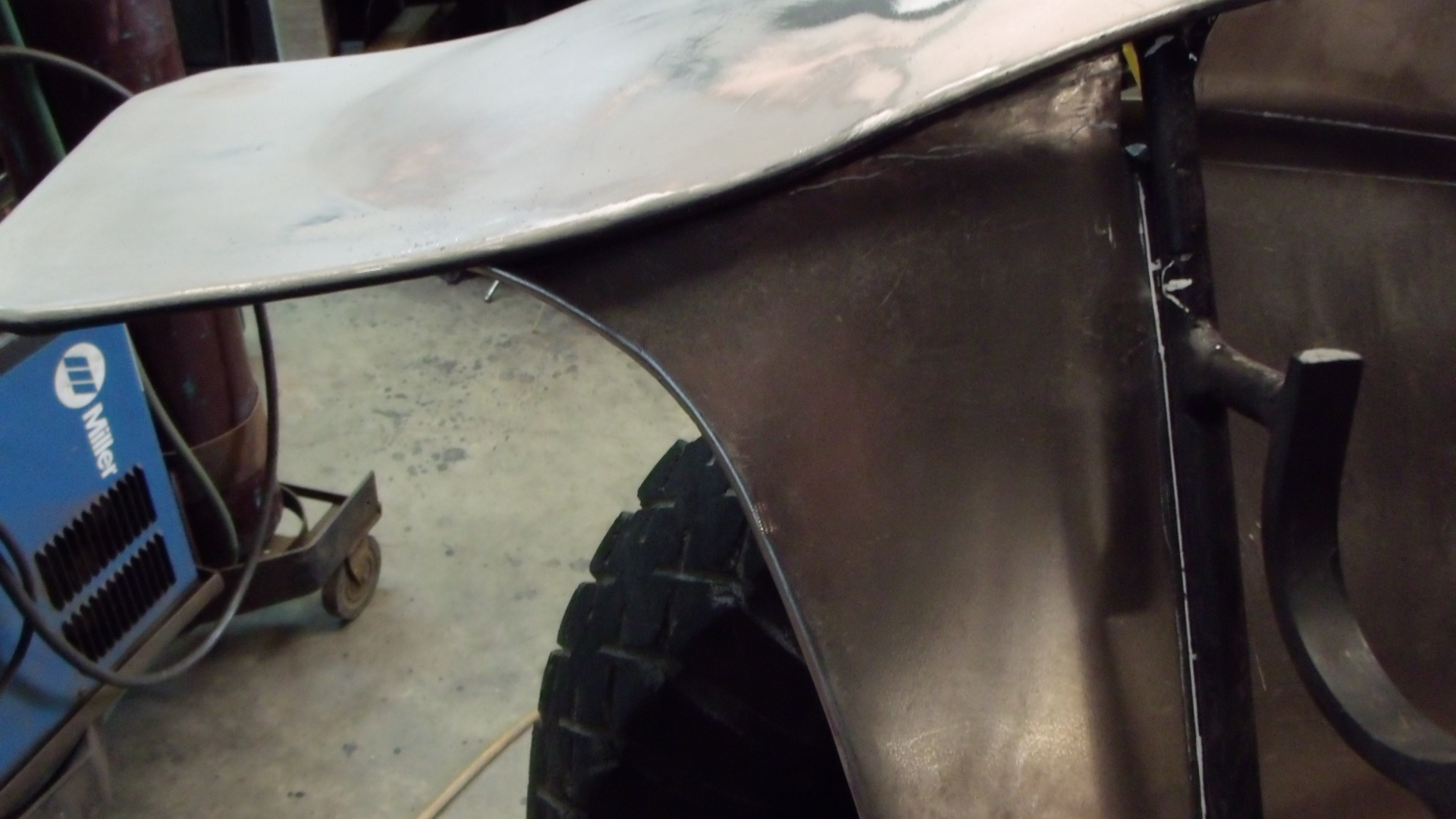

    I drilled more holes and tapped them too. Then I mounted the apron and tweaked and filed. I think I'm done with the left side for a while. I did stick a piece of fender welt in there just to see what it looked like. On to the right side!

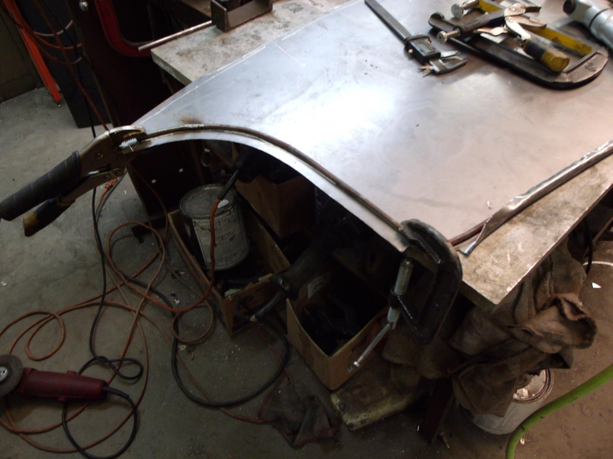

    I cut out the right side rear apron (or was it the left--no matter.) The I bent up a 1/4" rod to that conformed to the other side--only the mirror image. With both pieces I clamped and banged until I had something. Today I'll bang some more. I've about had it with sheet metal. News Flash!! I've decided to sell my shop, take the proceeds and build a bigger one up at Yonah Station. This is based on the fact that there's too much beeping and flooding and earth moving going on around my old shop. It's too small too. And I've got no where to put the speedster when it's done and with this byp*** and shopping center going in next door maybe someone will give me enough to make a profit on the place. So if anyone wants to buy the birthplace of the Giant Seagrave Speedster--I meant to say--the Historic Birthplace of the Historic Seagrave Giant Speedster--let me know.

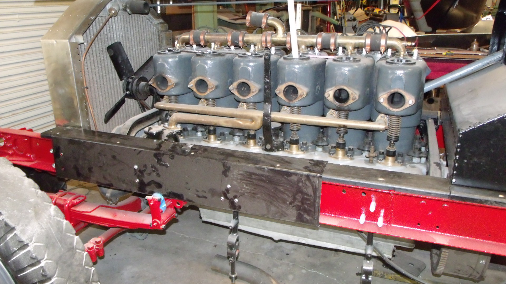

    More tenant stuff going on so speedster time is limited. Also I forgot my camera so you'll have to look at these ****py cell phone pics. I am closing on on the end of sheet metal work. Just the top of the apron left to fit to the rear fender and I can move on to paint prep. Yay!! Thanks for all the fund raising. I can see us topping 9 bucks by fall. Cool!

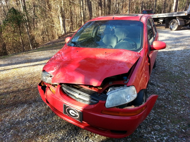

    I've been dreading painting the speedster. Bodywork and paint are not my thing. I want someone else to paint it but, alas, no money. Then I saw an ad on Craigslist: 2004 Aveo wrecked--right here in town! An idea began to hatch in my mind. I bought the car for $700.00 The ***le was clean. Cool! Next I called the junk yards and found all the parts I needed in RED for $600.00. I ordered 2 new headlights and radiator on the interweb for $250.00. Then I took the car to the frame shop--$300?. IF all goes well I might be able to clear $1500.00 on the car and maybe I can get the speedster painted for that. I've already got the paint. So with fingers crossed I started stripping things out to get the sheet metal ready. I worked feverishly. I was starving. Then suddenly, Steve, an old college friend, appeared at my shop with a bag of bagels. It was a sign things were going to work out. Hey, where can I find lox in this town? Or maybe a cream soda? What is lox anyway? Listen to me!! Can you imagine? The speedster painted!! Am I that close?
    Call the publicity department--ASAP!
