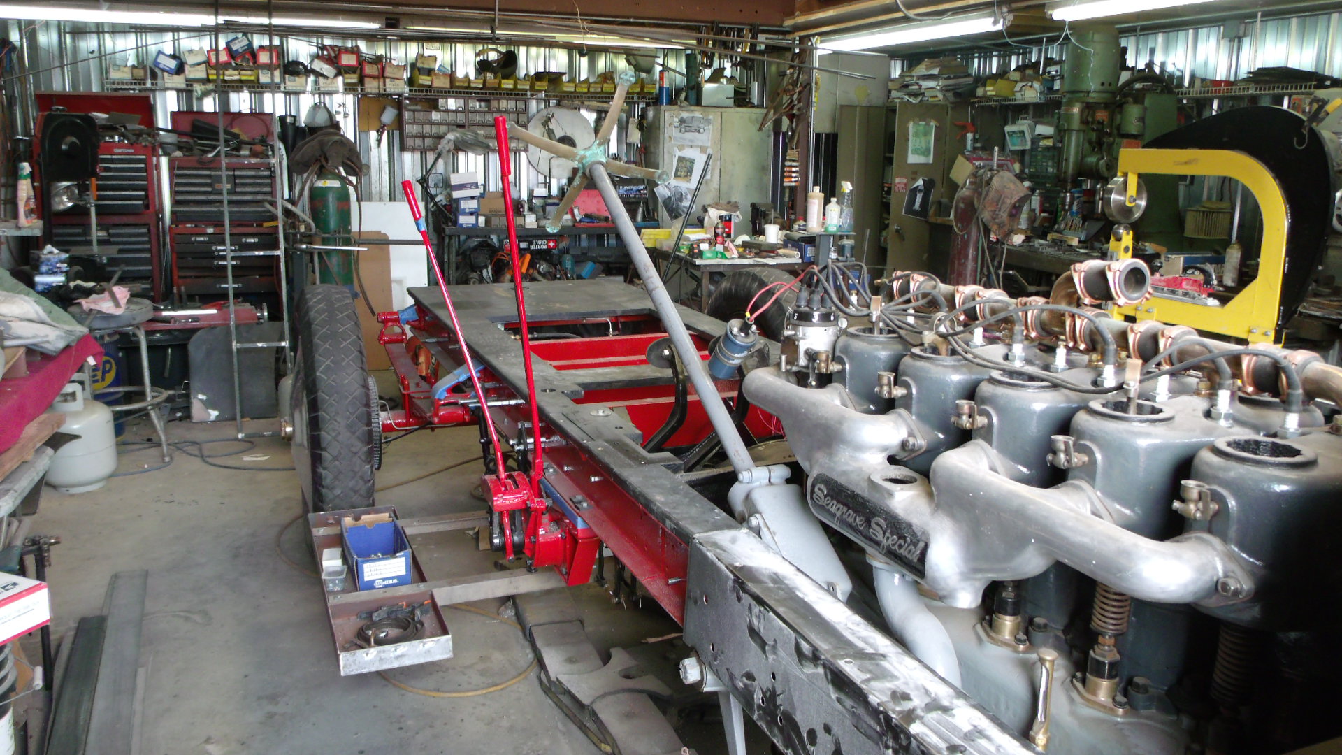

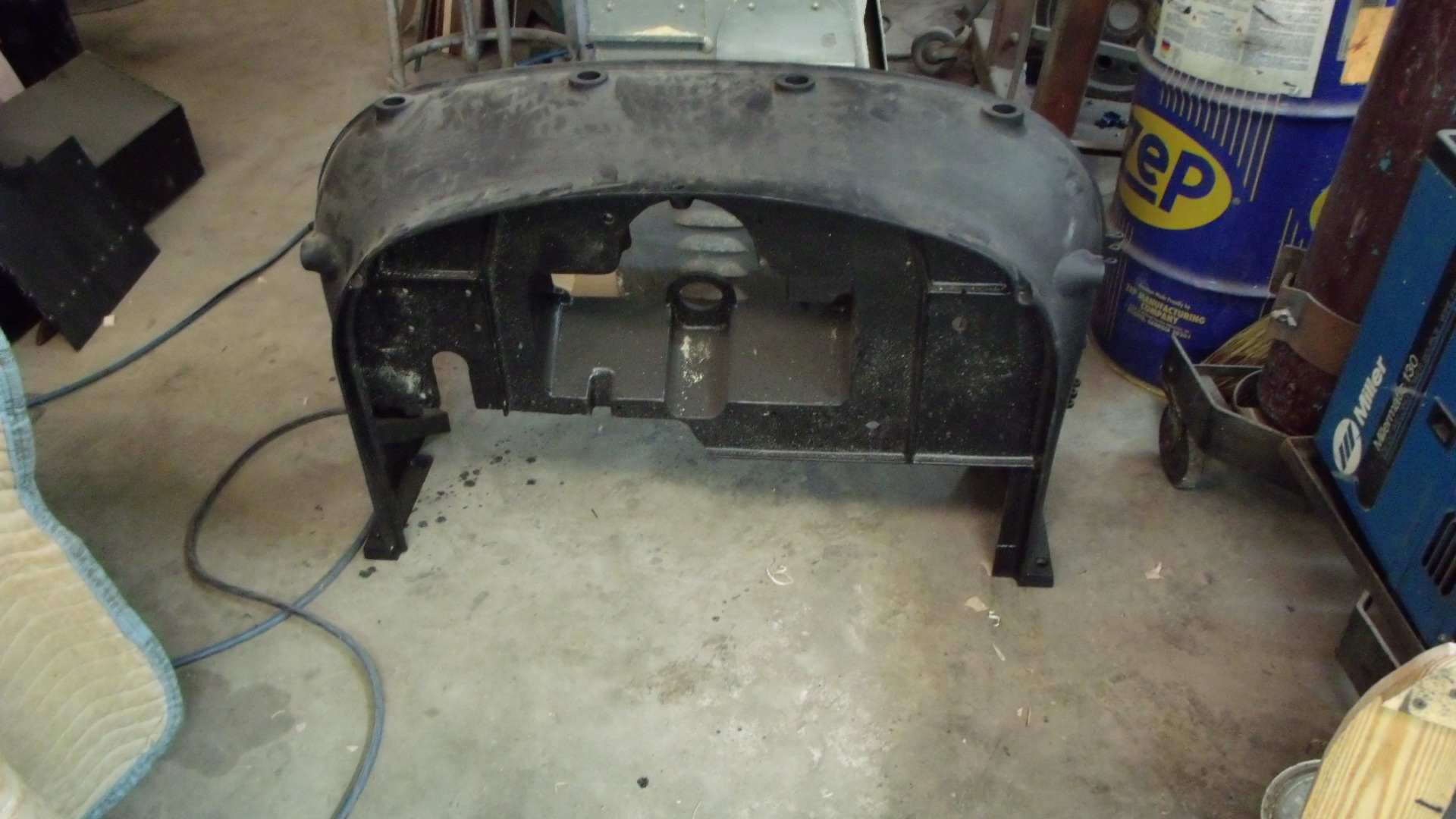

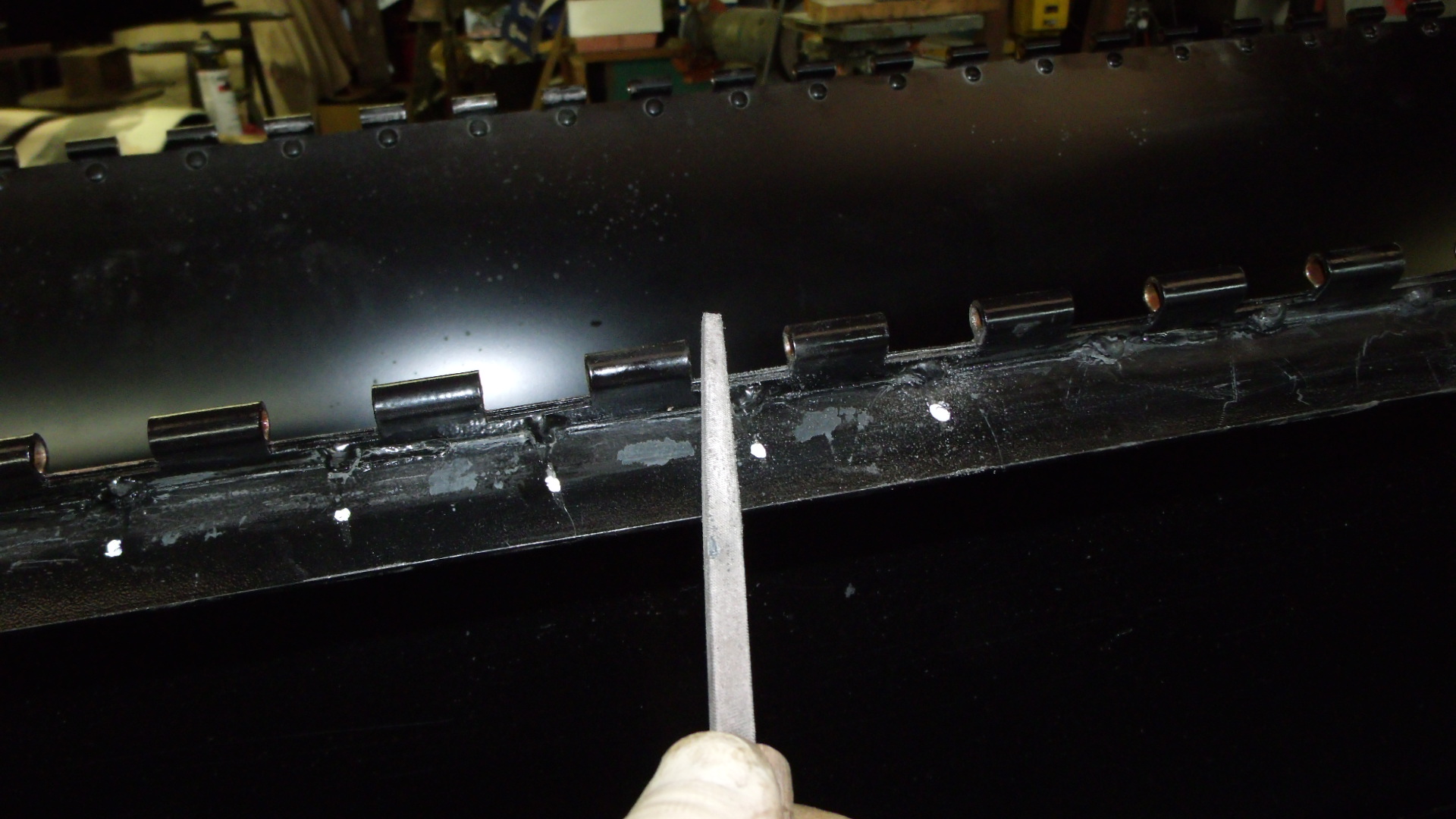

  17. yonahrr
    Joined: Feb 27, 2010
    Posts: 1,348
    yonahrr
    Where's Jerry?
    Update. I've got the frame covers, the cowl and the hood stripped off and I've been going over them trying to get them ready to go to the paint shop. This doesn't mean doing any more body work, just cleaning up metal work and making sure bolt holes line up. The hinges on the hood are giving me some problems. Several of the barrels are tight against the sheet metal and are going to s****e off the paint when the hood opens or closes. I should have seen this before I riveted everything together but I'm not that sharp. I could chalk it up to patina and let it ride, or I could spend another two weeks trying to rework the offending hinge barrels. Mmmm. One way or another the parts are going to the paint shop on Monday.
    Jerry
  18. BuiltFerComfort
    Joined: Jan 24, 2007
    Posts: 1,619
    BuiltFerComfort
    Put in a piece of long wood dowel rod between two hood parts, down near where it rubs. Open hinge, use dowel as lever fulcrum / spacer, to ever-so-gently bend the metal back a little, you may need a touch of rubber hammer action. Do it subtly and evenly and it will look fine.

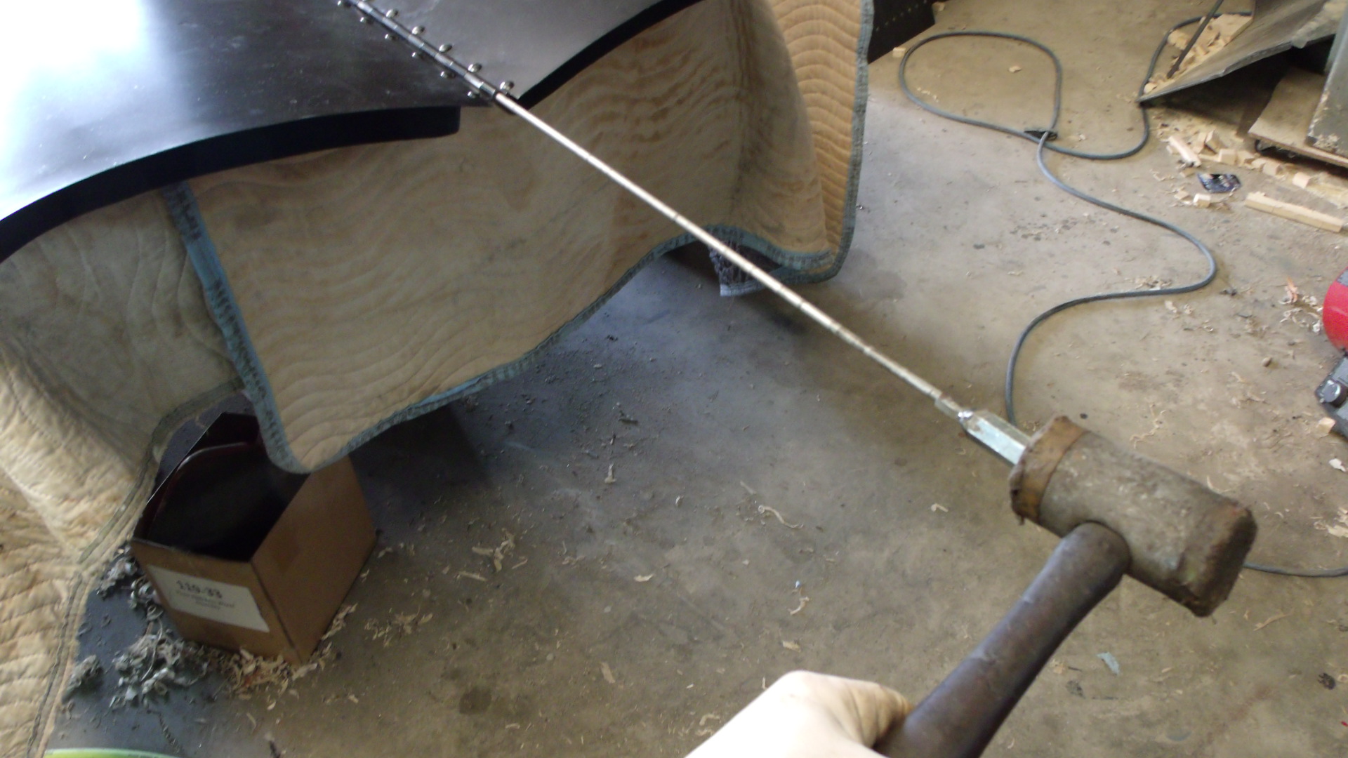

  20. yonahrr
    Posts: 1,348
    yonahrr
    Happy, Happy, Happy
    Everybody in my house has been watching Duck Dynasty. Life here in Cleveland Ga is a lot like it is on that show except no one I know has that kind of money.

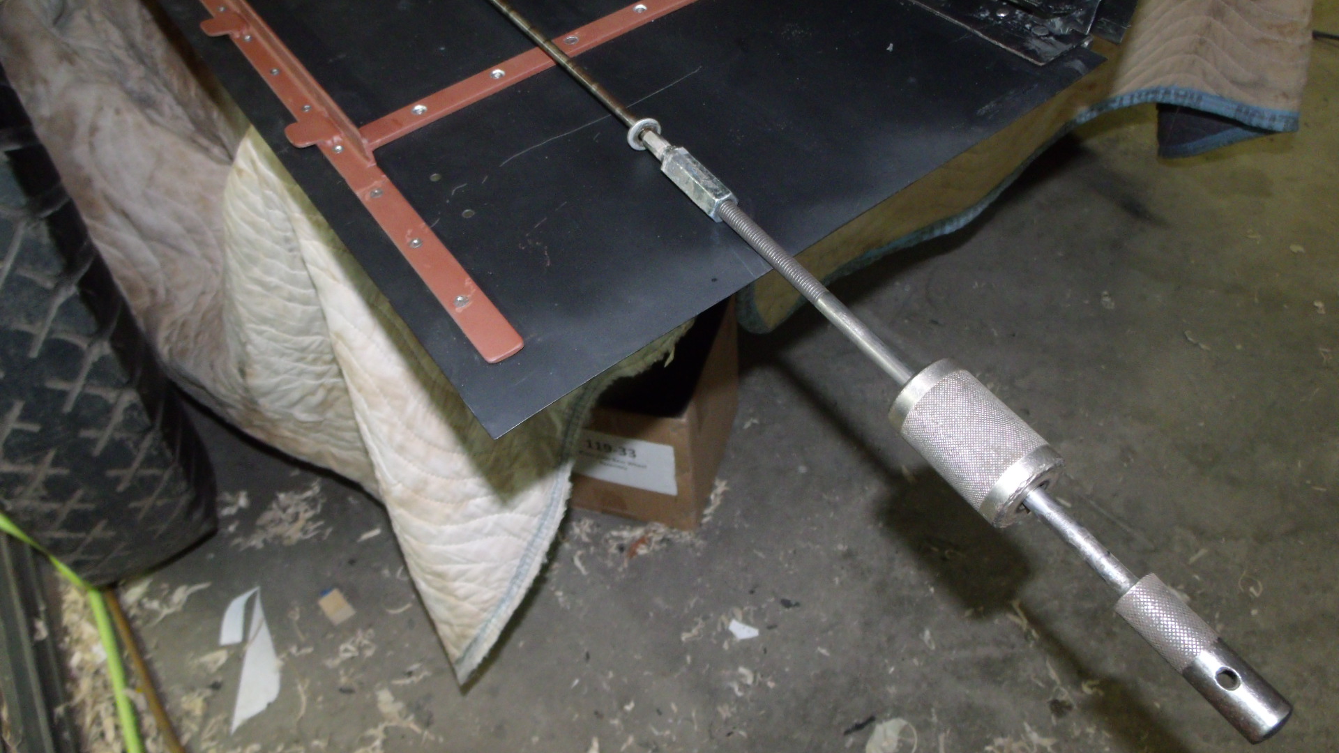

    Well, I finally figured out how to get the 5 foot pins out of the hood. Thread one end and use a slide hammer. It'll make your hand sore hammering out a 5 foot pin 1/4 inch at a time. I filed and cleaned up around all the hinge barrels so I think there won't be any paint s****ed off. I decided I need to make a cradle to hold the hood for the painter or else the hinges won't get painted right because the under side is going to be black. Tomorrow's project. Other than that, I think the first round of bodywork is ready to go to the paint shop. Keith has almost got the Aveo back together. I don't get paid until it's finished.
    Yesterday, while Alex and I were driving home, he spotted an 18" round snapping turtle on the side of the road. The photo doesn't really show how big he was. Alex had heard turtle tasted like squirrel so he wanted to take the snapper home and cook him up. I said it'd be better if we let the snapper be.
    Jerry
  21. carbuilder
    Joined: Nov 21, 2006
    Posts: 982
    carbuilder
    Jerry what I have done in the past on long hood hinges is grind a slight taper on the leading edge, wd40 the rod then attach a variable speed drill on the back end run the drill at a slow speed & push the rod in it will work in just keep wd 40ing it as you feed it in & make sure as it feeds in you keep the next hinge segment in line. Pounding can bend or kink the rod if you hit it wrong. It works for me.
  22. 64 DODGE 440
    Joined: Sep 2, 2006
    Posts: 4,434
    64 DODGE 440
    from so cal
    I used to work as the mechanic in an aircraft paint shop. Believe me when I say a very small amount of WD-40 can cause major headaches in a paint job.
  23. yonahrr
    Posts: 1,348
    yonahrr
    I had to squirt a little oil between the barrels to get the pin out but I cleaned everything up before I put it together. I'll oil the hinge up after the paint is on. Paint don't like oil. Keep silicone on the next block over.
    Jerry

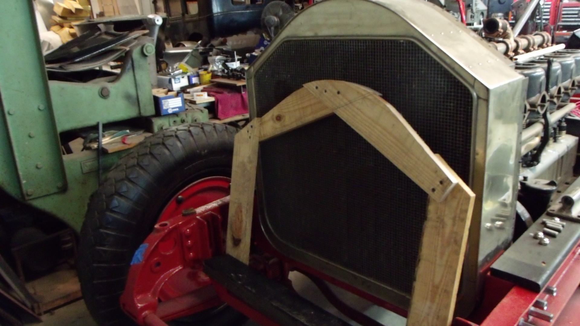

  26. yonahrr
    Posts: 1,348
    yonahrr

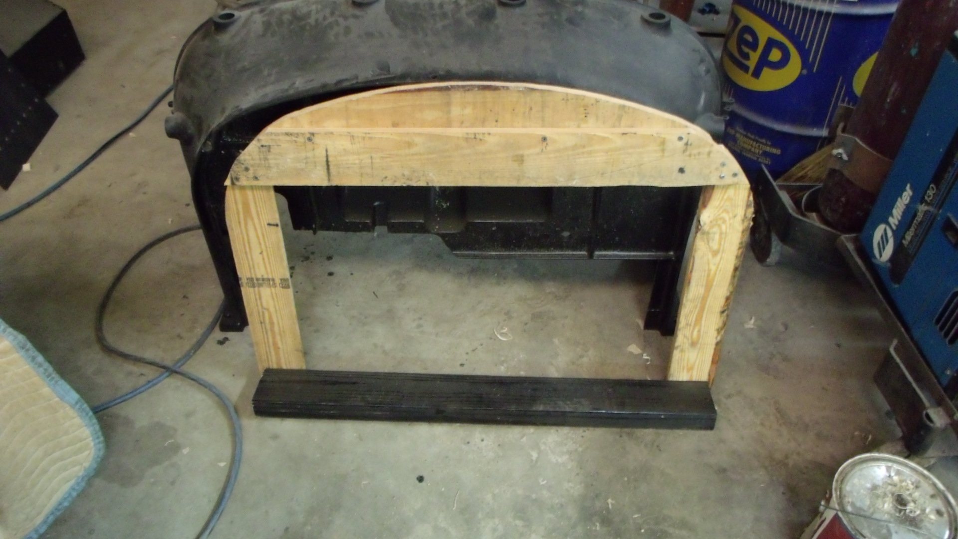

    Hood Cradle
    I'm probably going overboard but I just don't see how the paint shop is going to paint the hood without a cradle to put it on. Building this thing isn't easy either. I had to s****e up the wood first. I didn't want to buy any so I went down to Chow Trailers and stole some from their old pallets. Then I traced out the cowl and the radiator. This sounds easier than it was. After cutting it on the bandsaw and screwing it together I soon had something to look at. As a friend of mine says--"All I lack is finishing." This means adding two braces in my case. After that it's off to the paint shop.
    Jerry

  28. nitrobrother
    Joined: Dec 24, 2004
    Posts: 4,379
    nitrobrother
    Even your supporting projects are cool. Are you going to do one last mockup/full ***embly before blowing it apart for paint?

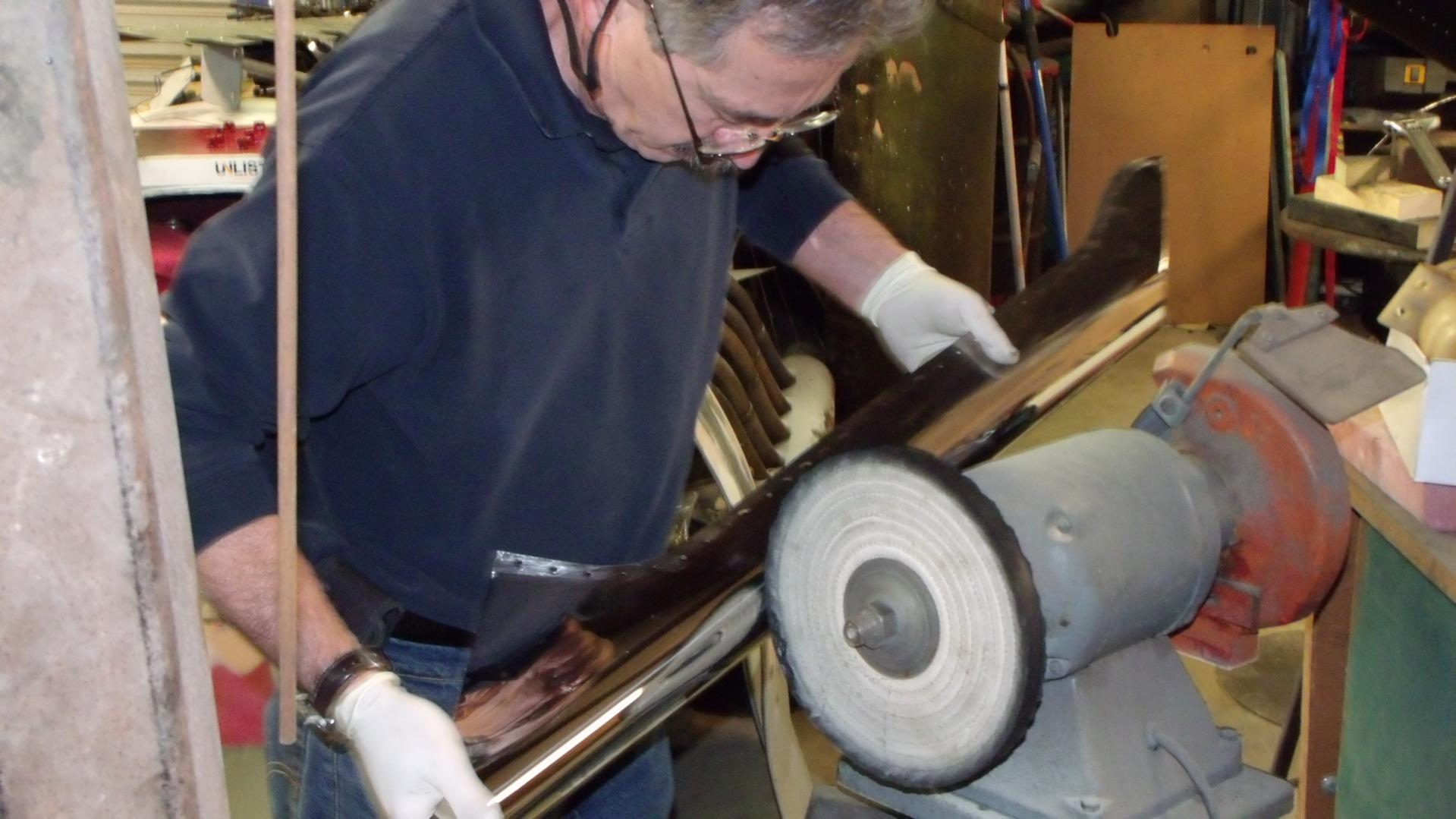

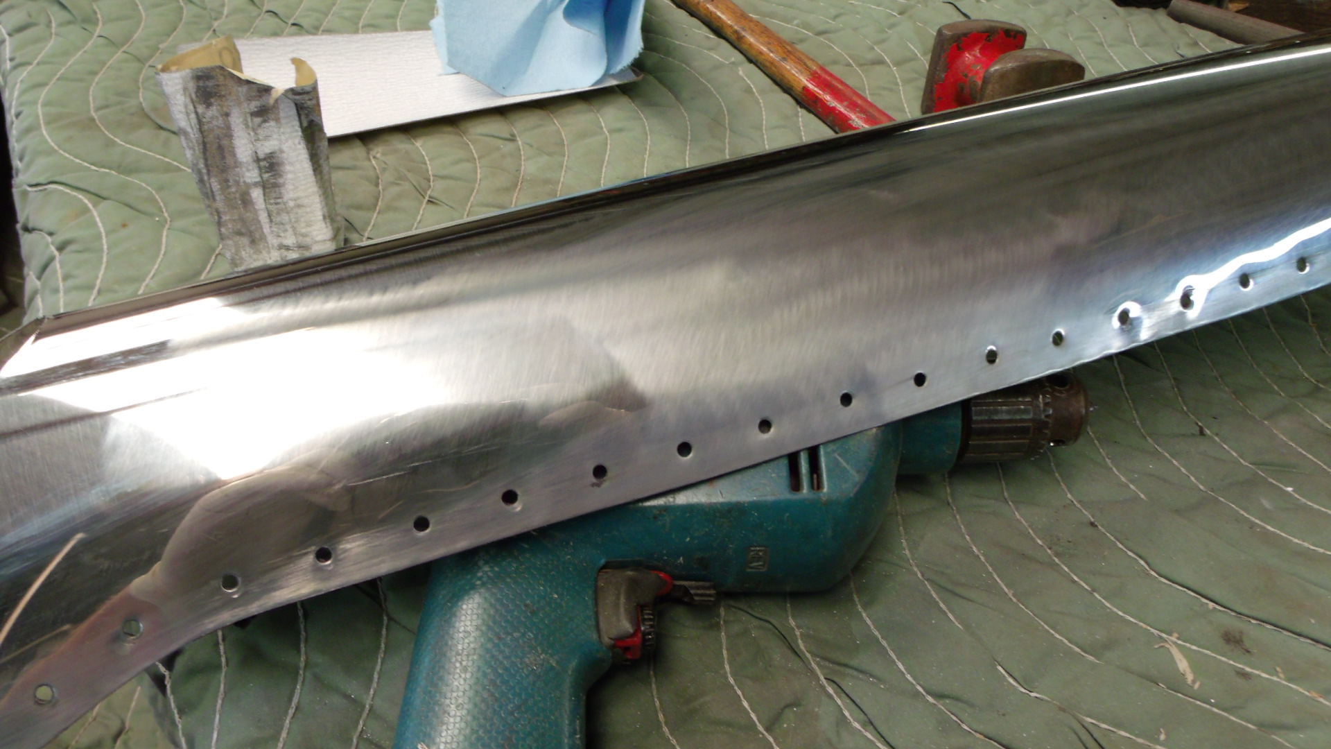

    Cradle, Buffing and Aveo

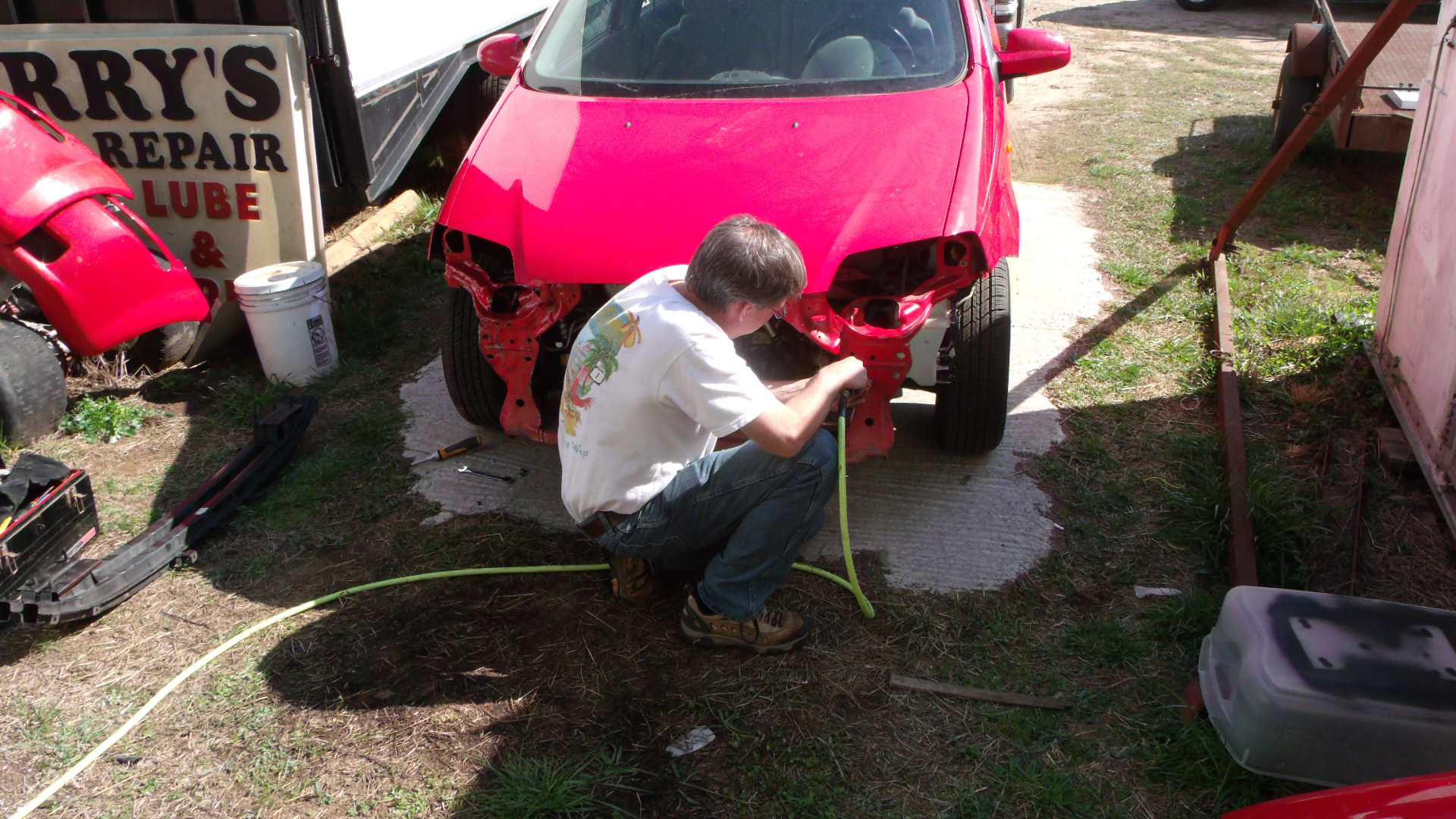

    I finished up the cradle and muscled on the hood. Some wheels would be nice but I couldn't find any laying around the shop. Still trying to get everything ready for painting I peeled the protective skin off the stainless tail piece. It was like a mirror! I'm trying to match the radiator so I decided to take off the shine with a little buffing. I also took the rough edge off where I cut the piece out. Next I checked outside where Keith was working on the Aveo. By golly, he had the blasted car finished! When do I get paid, Keith? The paint man wants his money!
