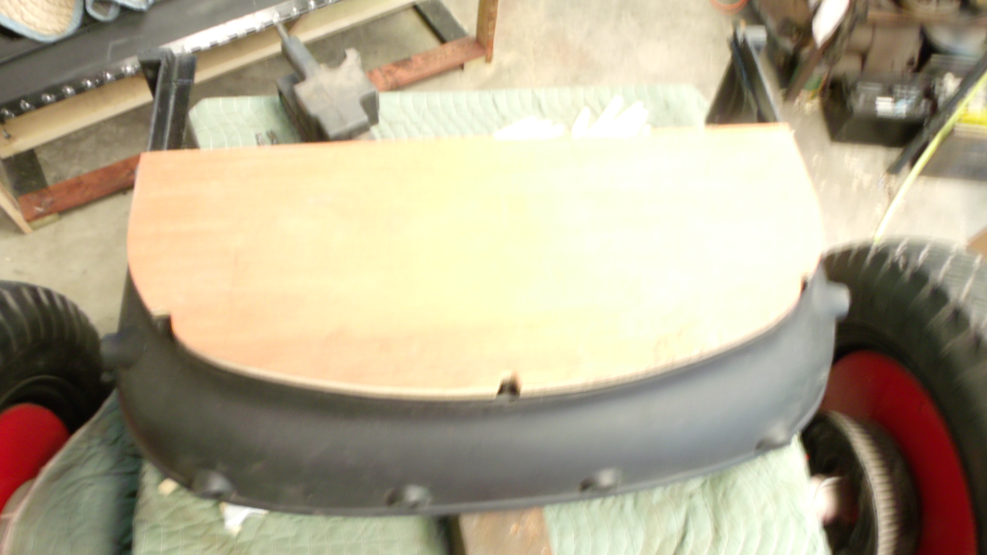

    Before the Paint

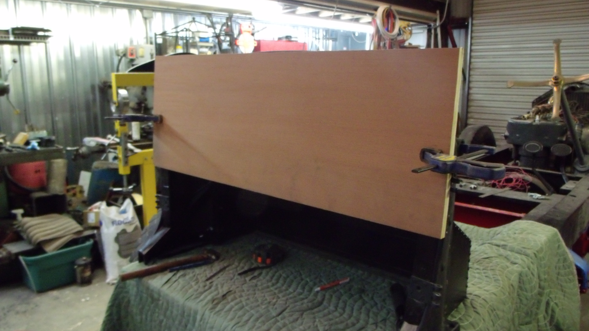

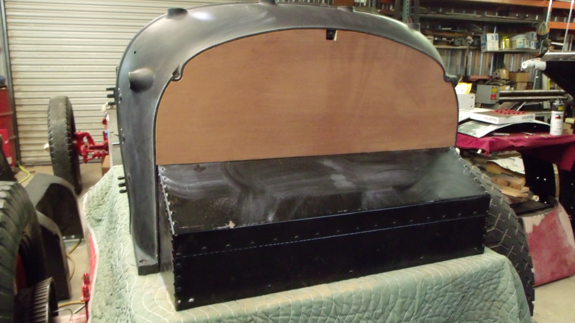

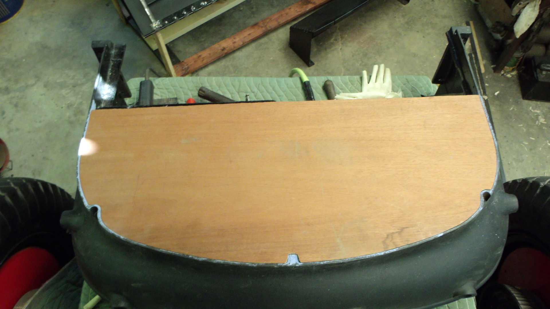

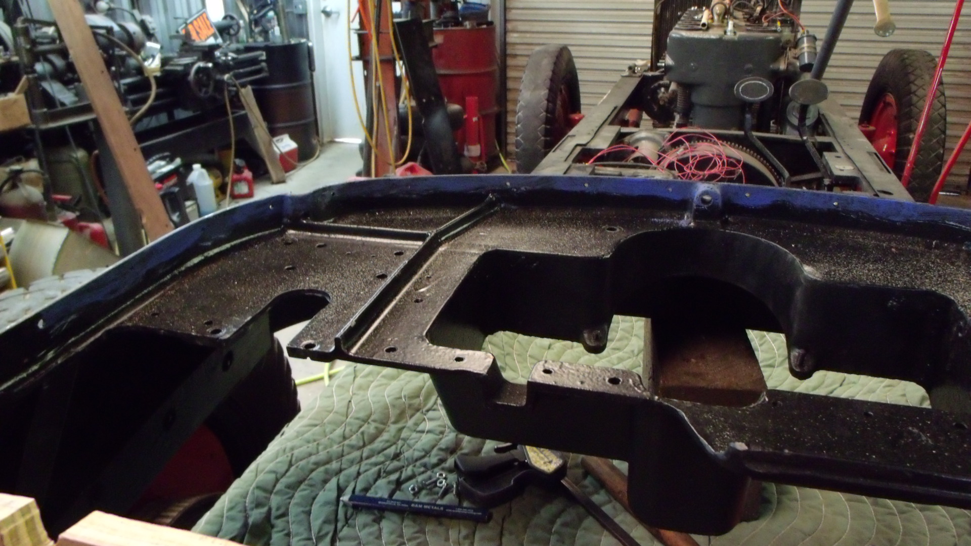

    I'm still trying to do some stuff before the paint goes on. I needed to cut out and fit the firewall wood. So rather than risk chipping the new paint I figured I'd do it now. I had a piece of walnut? faced plywood left over from when I built my 1914 REO speedster so I cut a rectangle out of it big enough to cover the firewall. I clamped it into position and reached in with a long scribe and traced around the inside of the cowl. Then I cut the thing out on the bandsaw. For the final fitting I mixed up some chalkline chalk and water and dabbed it on the inside of the cowl. A hundred fittings and sandings later the wood fit pretty good. Tomorrow I have to cut the wood to meet the footwell.

    "Firewall wood" is not a term you hear much, with wood being, well, susceptible to fire and all that. What will you finish it with to keep it from becoming an oil-soaked mess? Thick Polyurethane varnish maybe?

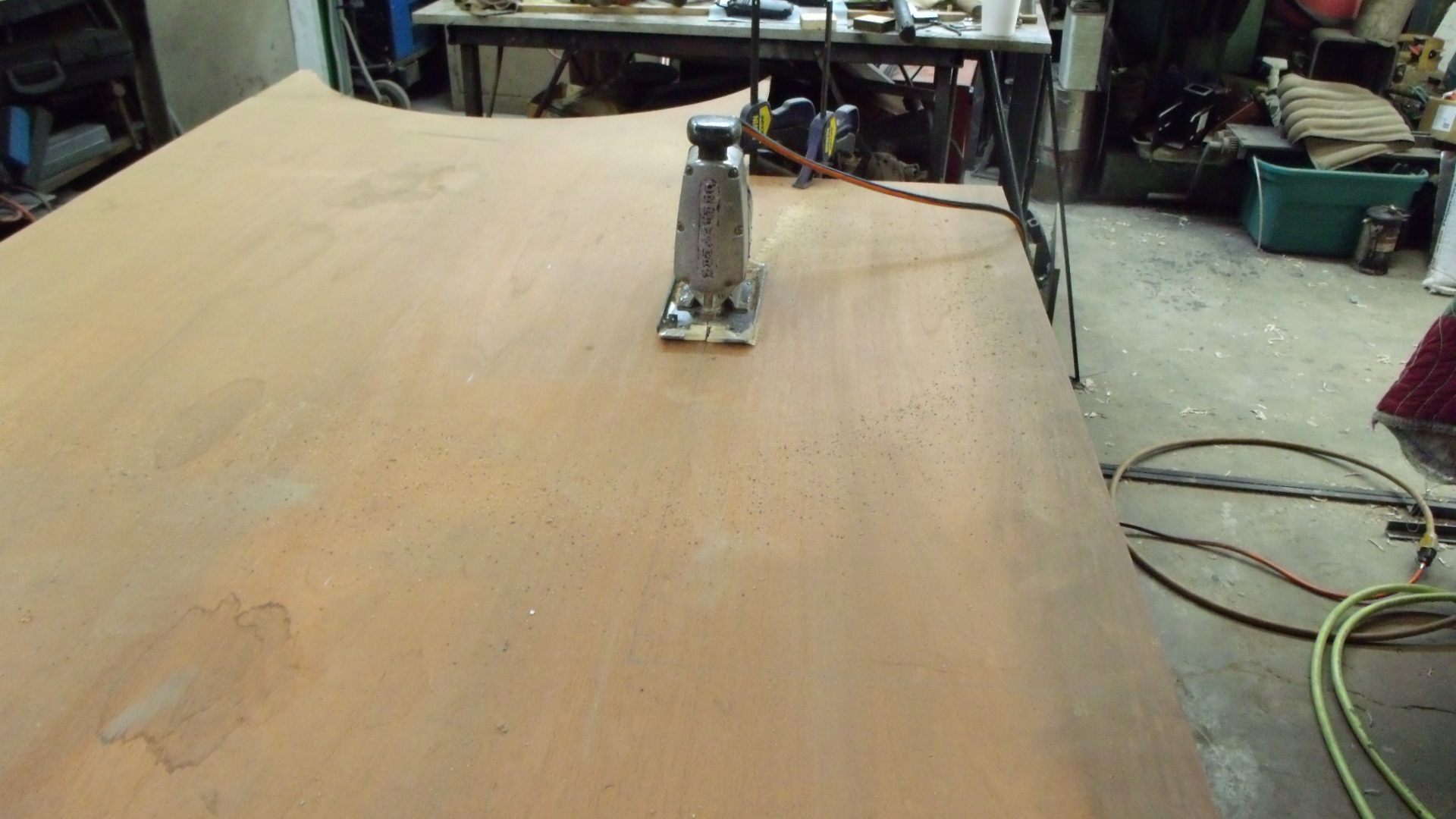

    What do you mean Wooden Firewall?
    It's code, I tell you! I got the fire proof wooden firewall fitted to the footwell then I blew on some Bullseye Shellac. Did I mention it's made from the Lac Bug? This will protect and seal it until I put on some polyurethane. There will be a br*** plate in the upper middle to hide where the gizmo that holds the hood hinge goes. I can just imagine all the neat stuff bolted to the firewall: spark plug holders, tools, electrics, Tesla Coil, oil can, ??? My brain was feverish with ideas so I started to cut out the dash board. That's when my 40 year old Craftsman Scrolling Jig Saw locked up. I stripped off the cover and saw the grease inside looked like wax. I hosed it down with Napa Chain and Cable Lube--another of my favorite products. Tomorrow I'll cut out the final shape on the bandsaw. The fit won't have to be that great since there will be a leather cushion running along the top of the doors and over the top of the dash. As for the layout of the gauges and doohickies--that will require many hours of contemplation.

    I wouldn't worry about a wooden firewall. Take a piece of that wood and a piece of .030 aluminum and do a torch test on them and I think the aluminum will burn through faster than the wood and the wood will give you "warning smoke" whereas the aluminum will just surprise you when the flame comes through. Looking forward to seeing the beast all painted and put together. Keep at it, you are doing great! :D

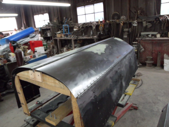

    The big day has arrived.

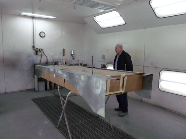

    Well, one of them. I had to race around this morning pickup some metal roofing for an awning we're building over the entrance to a rental unit and by the time I got back I wasn't sure if I was going to have enough time to load up the bodywork, deliver it and get back in time to pick up the kids at school. After I got things loaded I realized I only had my cell phone to take a picture with. The body shop is Allen's Paint and Body. Not only is it the oldest paint and body shop in Cleveland Ga, it's one of the oldest businesses in Cleveland GA. If fact, Ed Allen, who owns the place, might be the oldest man in Cleveland GA. Probably not. But they've been painting my vehicles for a long time. Eddy, Ed's son, runs the frame shop. He straightened the Aveo. And Bruce, Ed's other son, is the painter. That's Bruce in the background. I think they were kind of excited to get something to work on other than the run of the mill insurance work. Yes, I made it back in time to pick up the kids.

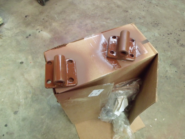

    Lesson learned

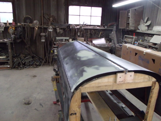

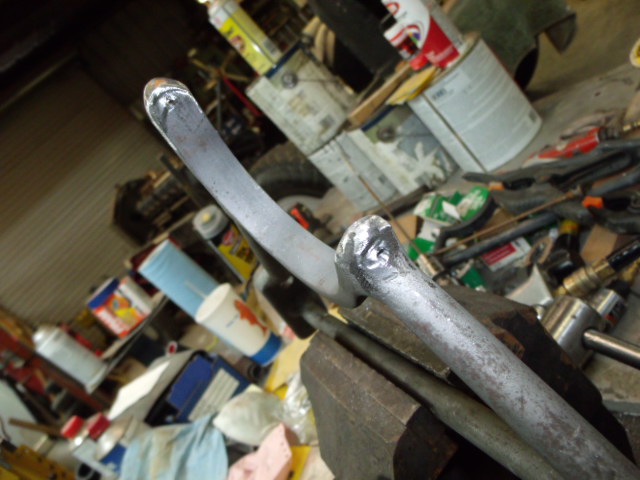

    The old ways are best. Everyone told me to use straight to bare metal epoxy primer so I did. Well it's a good thing I had the pros at the Allen's do the body work. They noticed the epoxy primer did not adhere to the bare metal on several pieces of sheet metal. Okay, it was probably my fault in some way, but where I used plain old Rustoleum red primer, the paint was stuck like you wouldn't believe. From now on, it's Rustoleum red primer! The ****py epoxy is gone now. So is my bondo work. I should have just done the metal work and brought it straight to Allen's. Another lesson learned. I blasted some red primer on the fender brackets. They looked so good some p***ing trumpeters blew a fanfare.

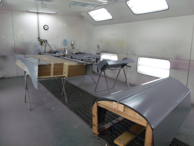

    Striptmus Prime
    I mean strip it and prime. Yes, they took off all my so called direct to metal primer and put on their own. More blocking required. I may come down and help. Meanwhile I've been getting the main body ready and working on fender braces etc. Wait for the red.

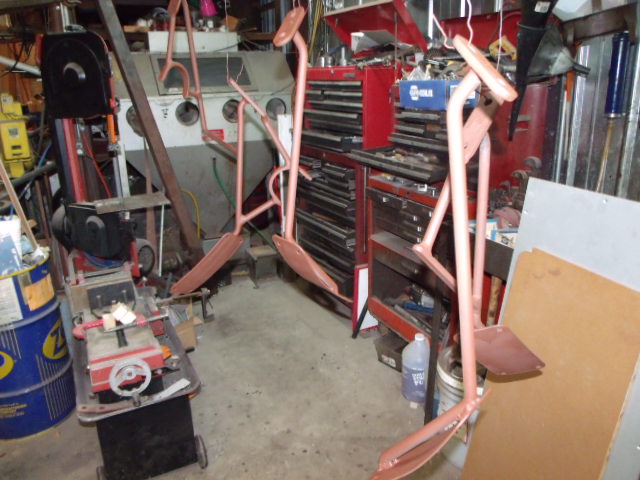

    I suppressed my urge to go by the body shop on Friday and Monday. I'll stop by today. I did manage to paint the running boards and supports yesterday. Today, maybe I can get to the fender supports.
    Jerry
