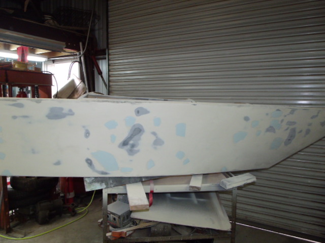

    Got off the phone with Bruce and he said the speedster body needs more work. The left side is okay but the right side has some "puckles" in it. I picked it up and brought it back to the shop. He's right, there are about fifteen low spots of varying sizes. At least he's thinking of me. I figure about eight coats of primer and more blocking. While I'm doing that, check out this website. It's enough to make you give up on any metalwork you might think about doing.

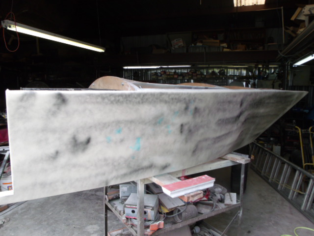

    I don't know anyone who's read that book. Thank God! Well, I've got most of the rental **** behind me and today I worked on the body almost the whole day. It feels pretty straight. About 3:00 I primered it up, sprayed on my guide coat and blocked it off. The body needs another heavy coat and more blocking but that's it. I predict red paint this coming week! We're all getting a little tired of this nonsense. Although I must say my bodywork skills are improving rapidly.

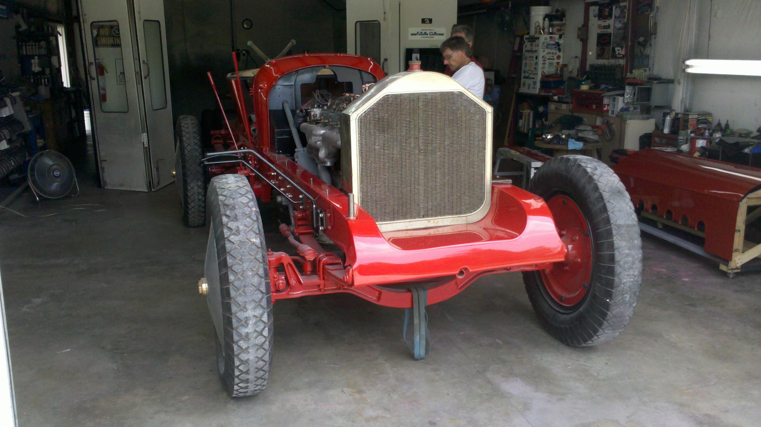

    Sanding, Sanding, Sanding... Bruce said he's painting the cowl, hood and doors this evening. But this evening in Northeast GA we're getting high winds, lots of rains and even hail! Not sure if Bruce will paint or not. The power went out several times. Will know in the morning. Fate conspires against us but we will prevail!!

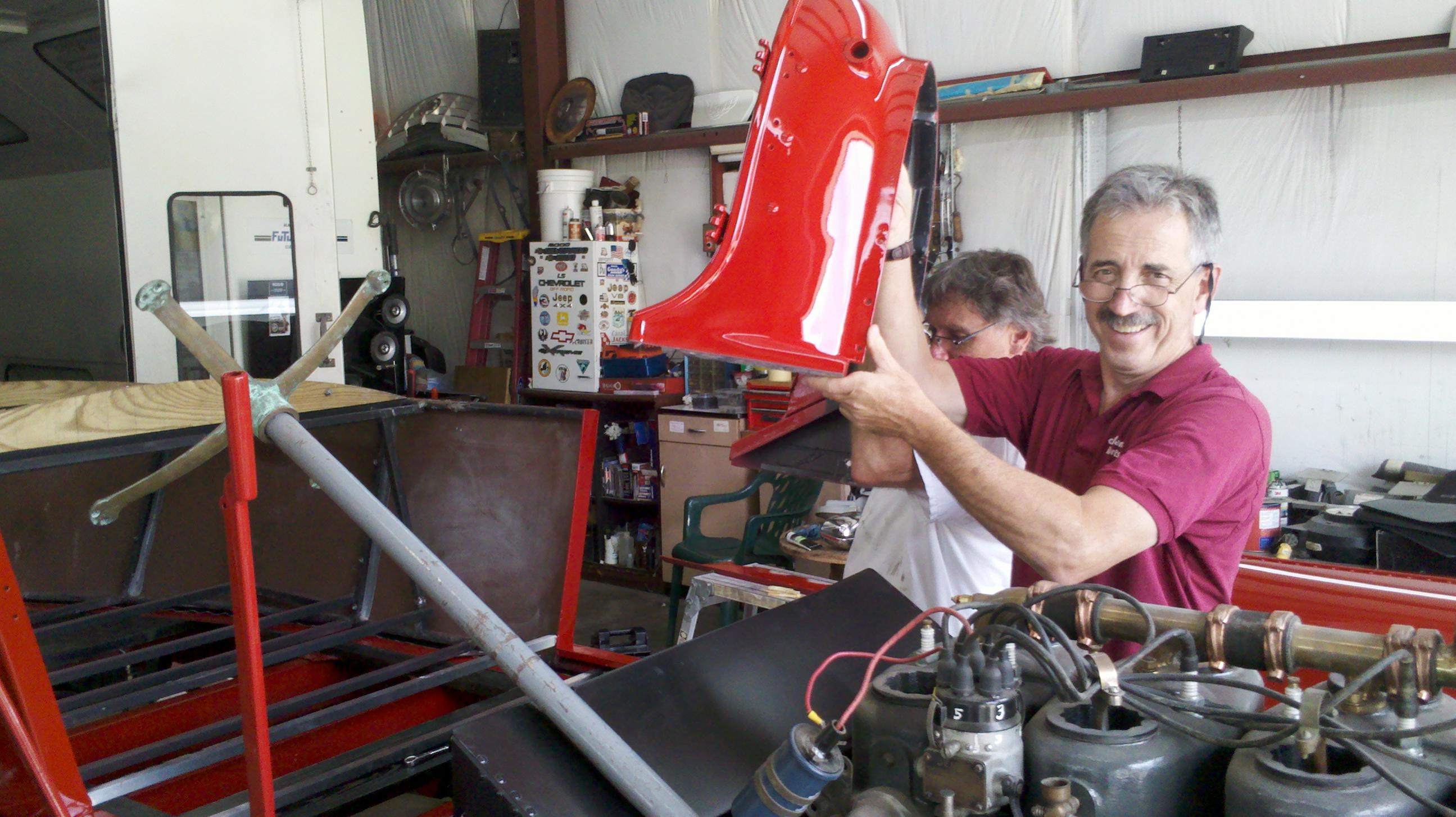

    While I sanded tiny craters out of the body, Bruce painted the hood, doors and cowl. The craters went all the way to the primer. I looked like I was bleeding from every pore of my hands. Bruce says he is painting tonight. We rolled the hood outside in the sun about 4:00. It was dazzling! You can't really see it in the picture. Take my word. Just buy some Concept. You'll be happier. Tomorrow, if all goes well, we are putting the body on the ch***is. It's the only way to get the thing back to my shop.

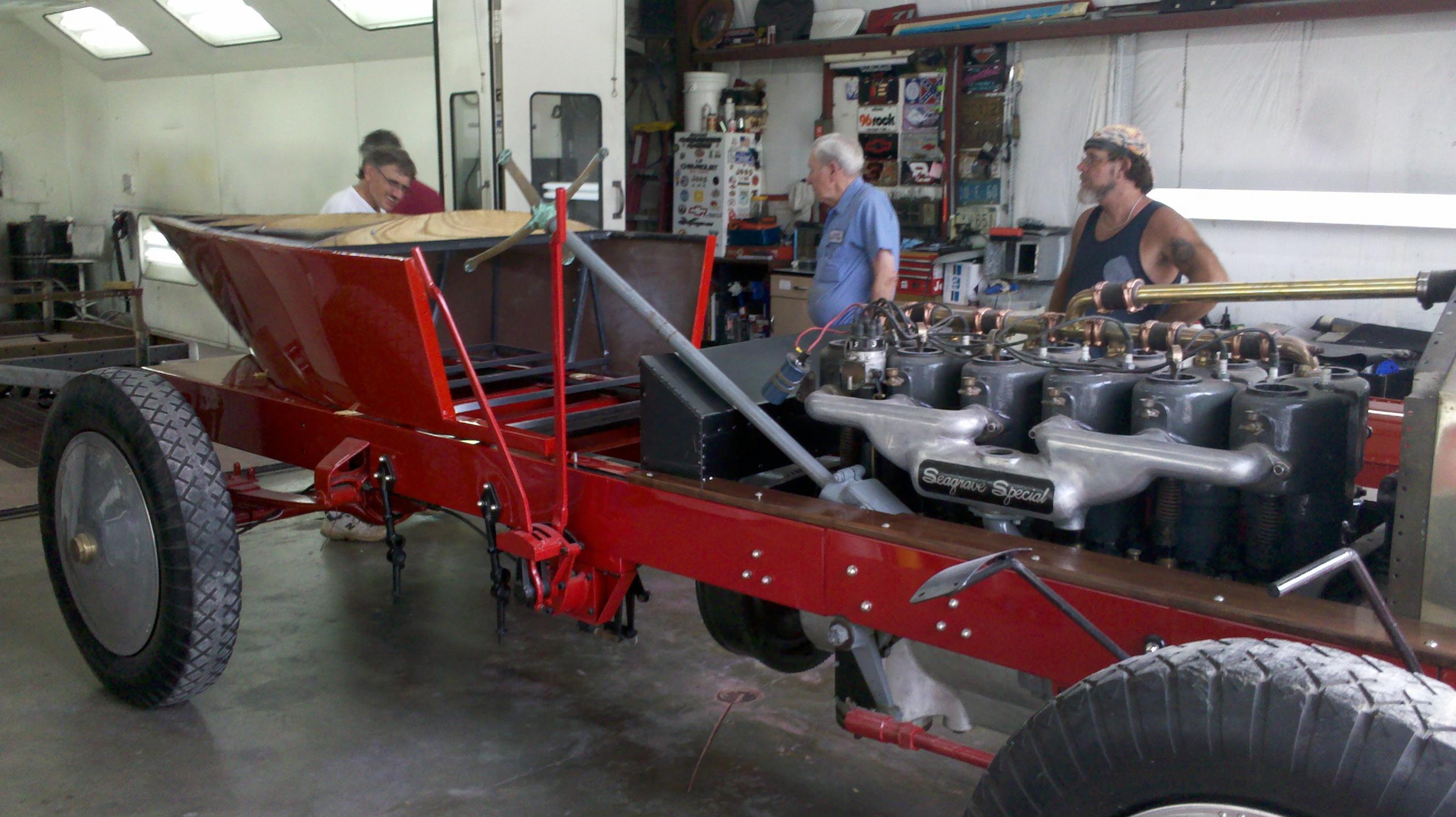

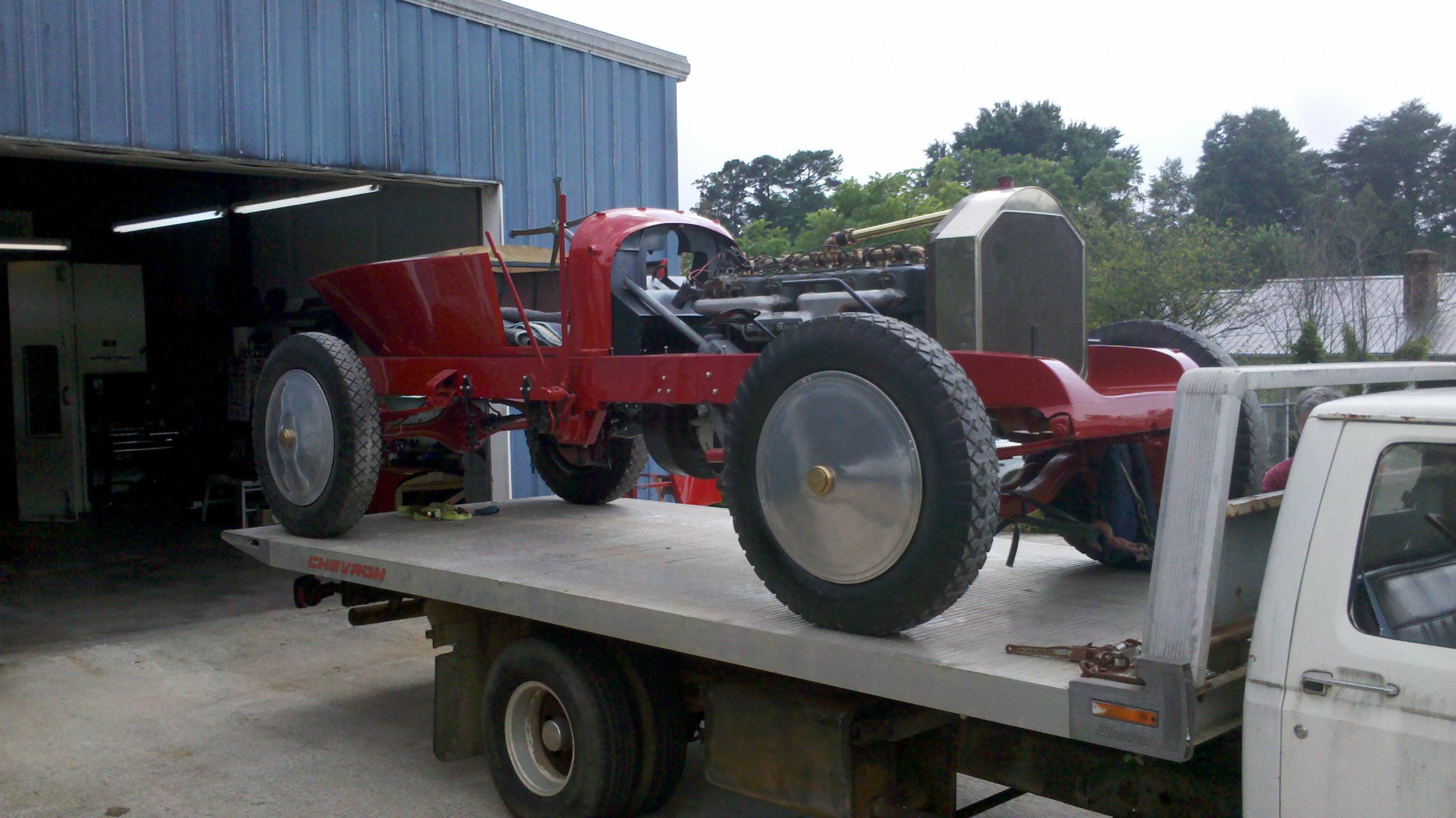

    ***emblation
    Keith, a good friend of mine, came over and helped me load up the Speedster for it's trip over to Allen's P & B. Bruce and his dad were waiting along with a few curious spectators eager to see what kind of vehicle the half boat body went on. The trouble came when we had to put the fender welt between the body and the frame cover but it really wasn't that much trouble. After we cinched down the body we lowered the cowl in place. The right side was a little tight and I had to remove the wooden hood shelf to be trimmed later. Keith took all the picture since I left my camera in my Aveo. The Speedster looked really good on the rollback. Bruce did a great job. Hard to believe we're really on the down side of the project. Hey, I'm already thinking about the next project! I can't reveal what that is just yet. Very hush, hush!
