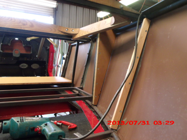

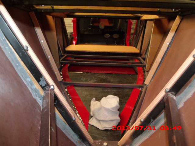

    It's one of my favorite movies. Check it out. I think it inspired Men in Black. So no one will probably see what's hidden below decks inside the Seagrave Special but I think it ought to look good down there. To that end I've got to line the ribs to have something to screw too. Sounds simple but for some reason it's been taking me a week. Of course there's the usual interruptions of my land flooding, me writing letters to the development company causing the flooding, me writing letters to the city council, the grading company dumping seven loads of dirt to fill in my property so it won't flood any more. Things like that. But I'm getting close. Tomorrow maybe I can start cutting slats.

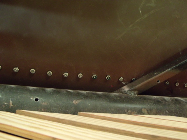

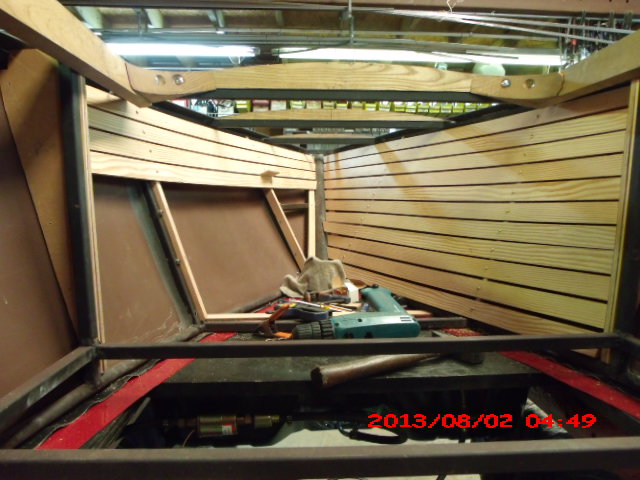

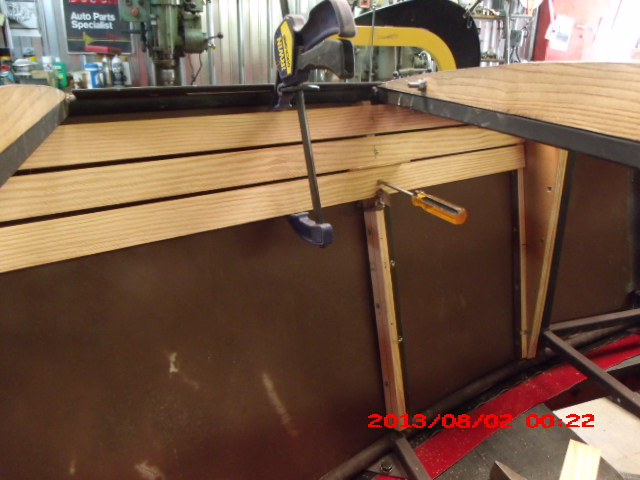

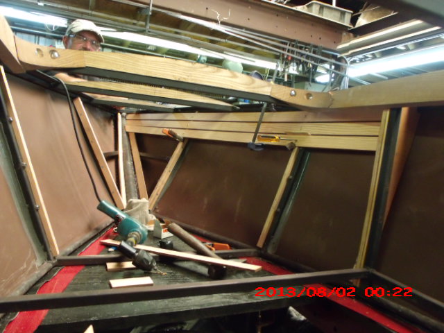

    Slat Machine

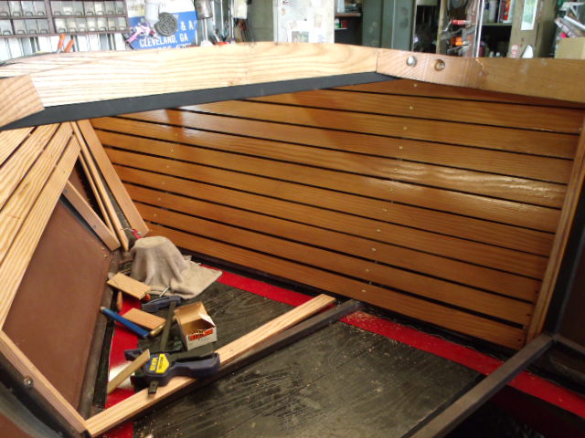

    That's what I felt like today. In the last picture you see the result of a day's progress. Every slat must be hand fitted then drilled with a pilot hole and a screw hole. When all the slats are fitted I've still got to sand and varnish them. Ah, the price of perfection! Well, not quite perfection. All right, near perfection. Okay, okay, would you believe 7th grade shop cl*** quality? Because that's where I got all my training. Some oval head br*** screws arrived from McMaster Carr this evening. There'll be a trim piece in the very rear. I had to space the slats 1/8 in the front and 1/4 in the rear for them to come out right. All that math! 7th grade was good for that too. Mr. Kuett's Algebra cl***! I remember a girl named Margie who sat in front of me. No wonder I never learned quadratic equations! That's why I flunked out of engineering in college! It was all Margie's fault.

  18. okay ..I do know a little about wood ... hopefully your slats are kiln dried and the grain is all in the same direction... these slats will likely tell the humidity and temp and likely distort ... the only way it won't is with enough support or backing of some kind..or movment allowance... ask me how I know this .. every square inch of our log home is made of wood .. very few places in the house are still square or not altered after 7 years due to the weather.... all log home take on the tumbled down look its nature doing its job.... I see a few unruly slats now .MAKING ALLOWANCES FOR THE WOOD TO "MOVE " OR" SLIDE" ON THE SCREWS where possible ---- slot instead of a hole and a washer to cover the slot. hope it all works out for you :):):)

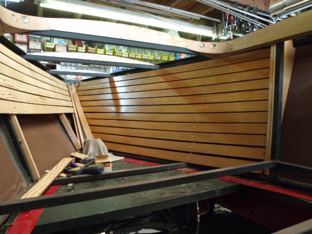

    Slots on the slats

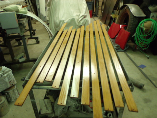

    Paperdog, you make it sound so complicated. You forget I got my training in 7th grade wood shop. It's all I can do just to get the slats cut and fitted. Okay, I had help yesterday so I got a little more done. Alex took off the slats and sanded them down. Then we applied a little Bullseye shellac before laying on a coat of varnish. Before I screwed in the slats I put some Loc***e 290 on the screws holding the tailpiece on. 290 wicks into the threads and holds everything tight. I started to finish the other side but my band saw blade broke. Tomorrow. My new oval head screws looked real good and yes, I lined up all the slots.

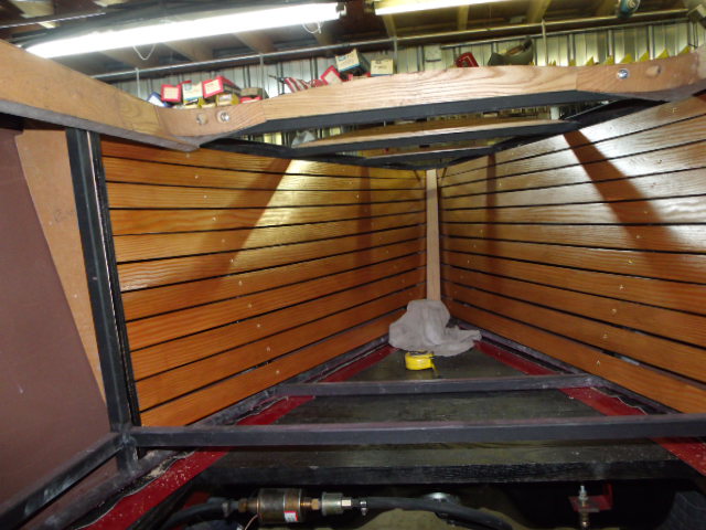

    Dang it!

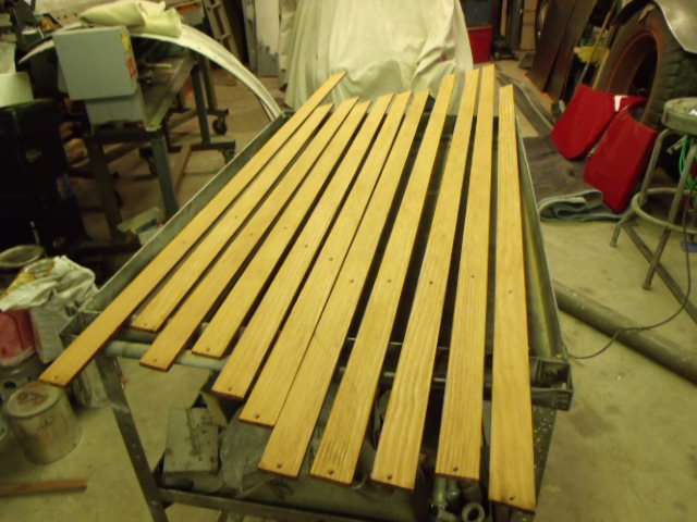

    I keep leaving my camera at the shop. Not that there's anything much to look at. I just today finished up cutting and varnishing the slats on the other side. The slat thing was getting kind of tedious so it'll be good to move on. I want to get into the decking but I have to finish the interior stuff first. I don't want to be hanging over head first inside the p***enger ****pit doing woodwork. I don't have a clear plan for the interior because I know even less about upholstery than I know about woodworking. I do have the leather though.

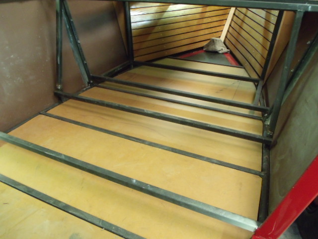

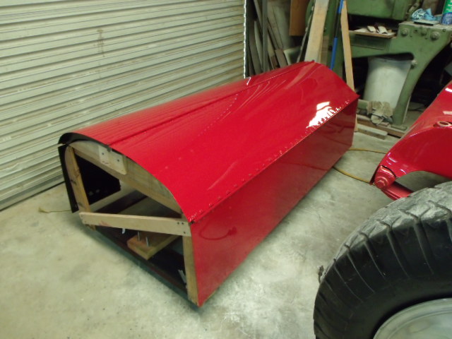

    Not me, the camera batteries. I finished up the slats today and was going to take a picture but the camera batteries were dead. I remembered to take it home, though. It had one new picture of the hood in it. I took the picture just after I moved the hood from Allen's body shop to my shop. Cushions: I was going to make the bottoms removable but the backs will be fixed in place. More wood work tomorrow putting in place floor boards as well as all the wood the trim will fasten too.

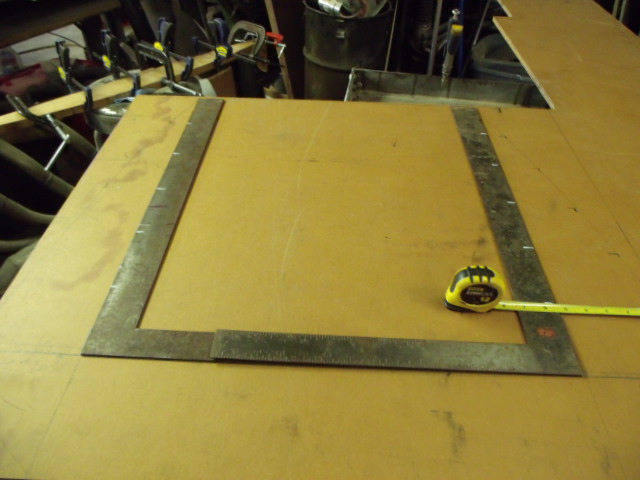

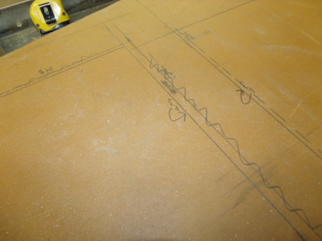

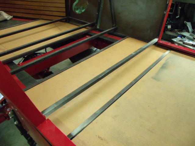

    Sign board that is. I like sign board. It's water proof and smooth and it's got that neat paper on both sides. You can paint it and there's no pesky grain showing through. I spent all day making floor boards. (Now don't tell me it's not authentic. After I paint it who will know? You're all sworn to secrecy remember?) Each one had to be hand fitted. Can you read those heiroglyphics? After I was satisfied with the fit I pulled them out and Bullseyed the bottoms. I was going to put battleship linoleum on them but lately I was thinking '23 was a little late for linoleum. Being an open car I started leaning toward something all weather like some sisal carpet or mats. Maybe you guys have some input.

    Varnish extra on the cut edges, so it soaks in. That's where water might gather. Also the tops if you'll have mats or anything that could trap water.
