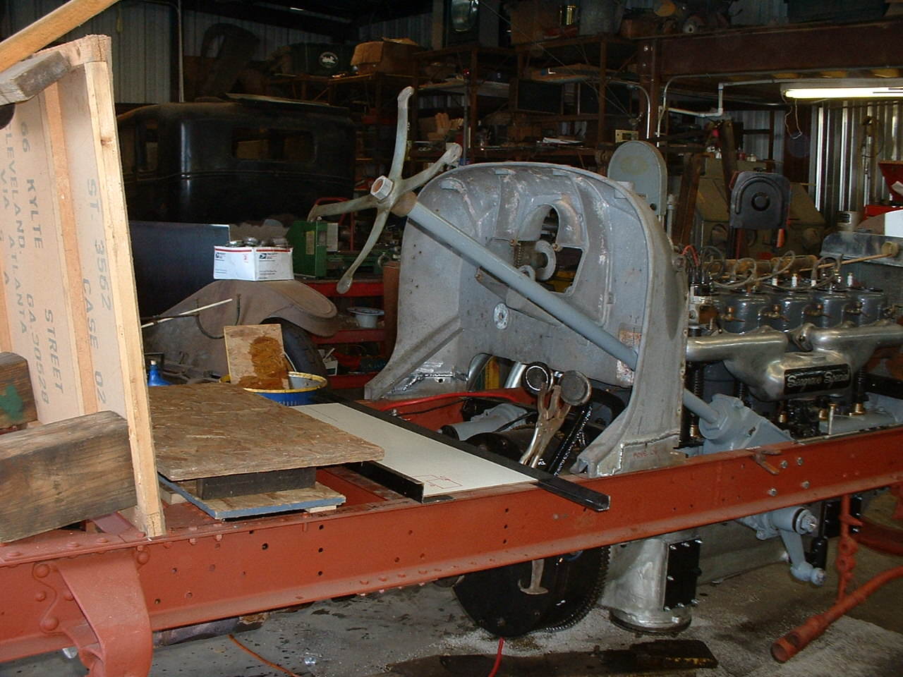

    Cowl

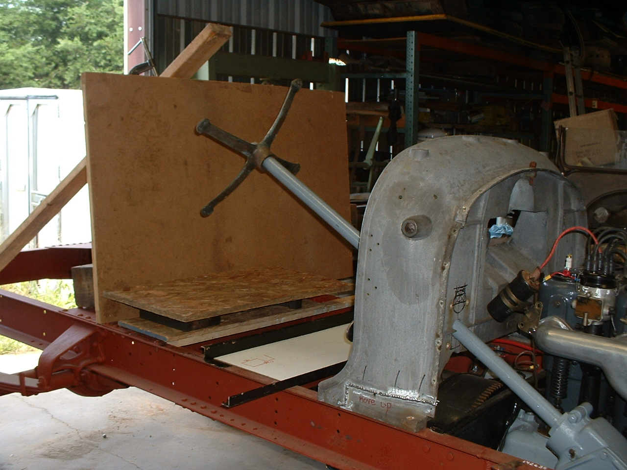

    Cutting down the cowl sounds easy but really there was a lot of soul searching and measuring because once you cut you obligated. Recutting and rewelding is a bad. In the first picture you can see the original cowl and where I marked it. I spent Friday cutting down the cowl. It took all day because I wanted to preserve the cast beading. I left my camera at home and didn't get any pictures. Sorry. Dennis the welder had it all welded by the time I showed up on Sat morning. It looked great. I cut a hole for the steering column and set the cowl on the frame. I hope you'll agree it looks a lot racier. This body will have a door, so imagine that in place. The pedal height came out good too. I mocked up a seat back just to check my driving position.

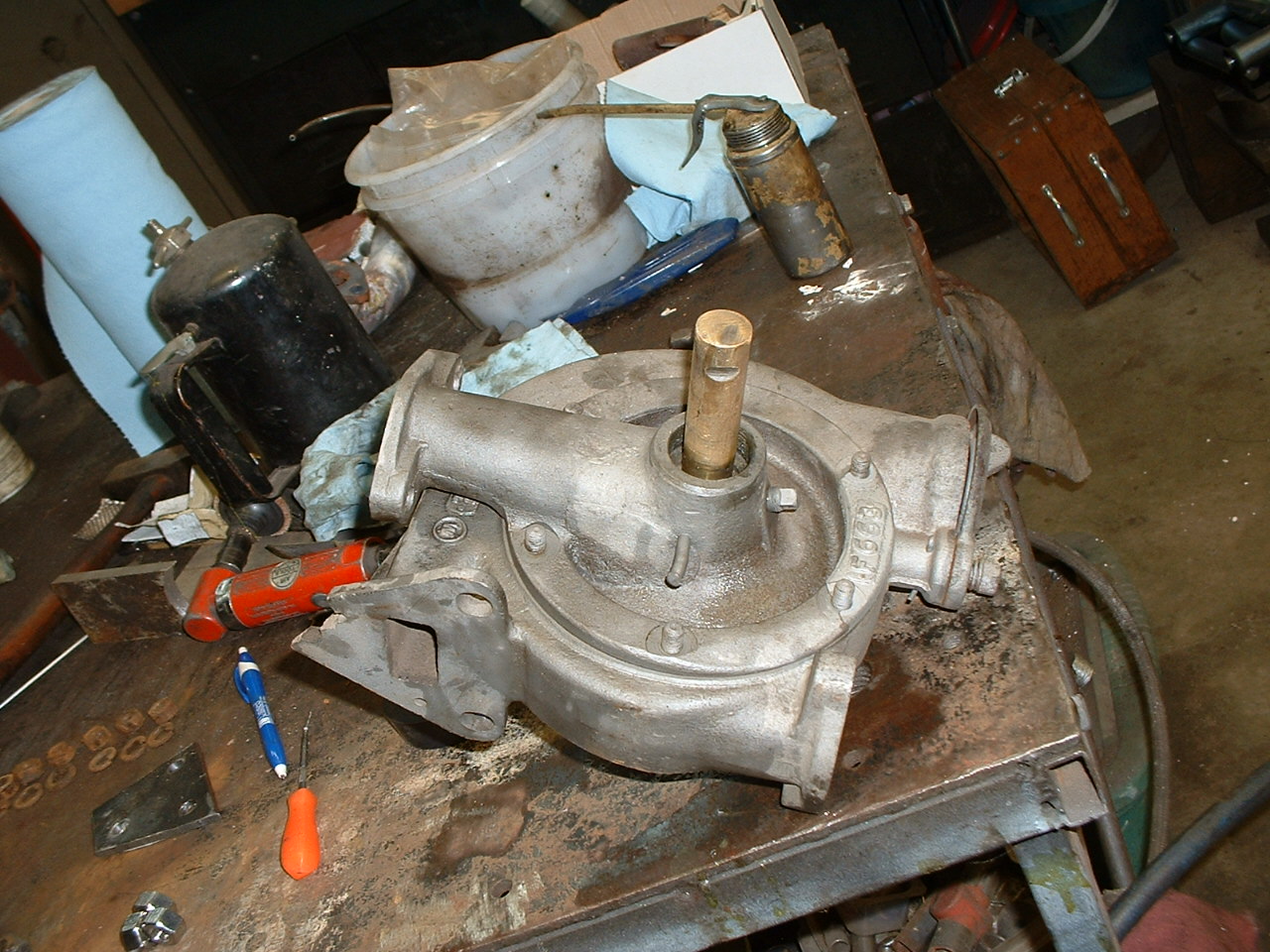

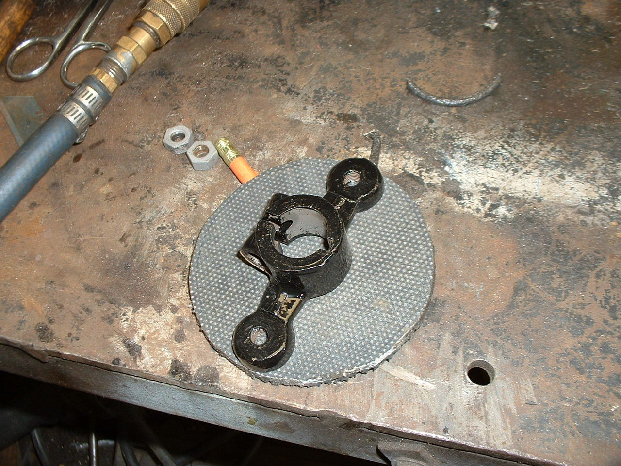

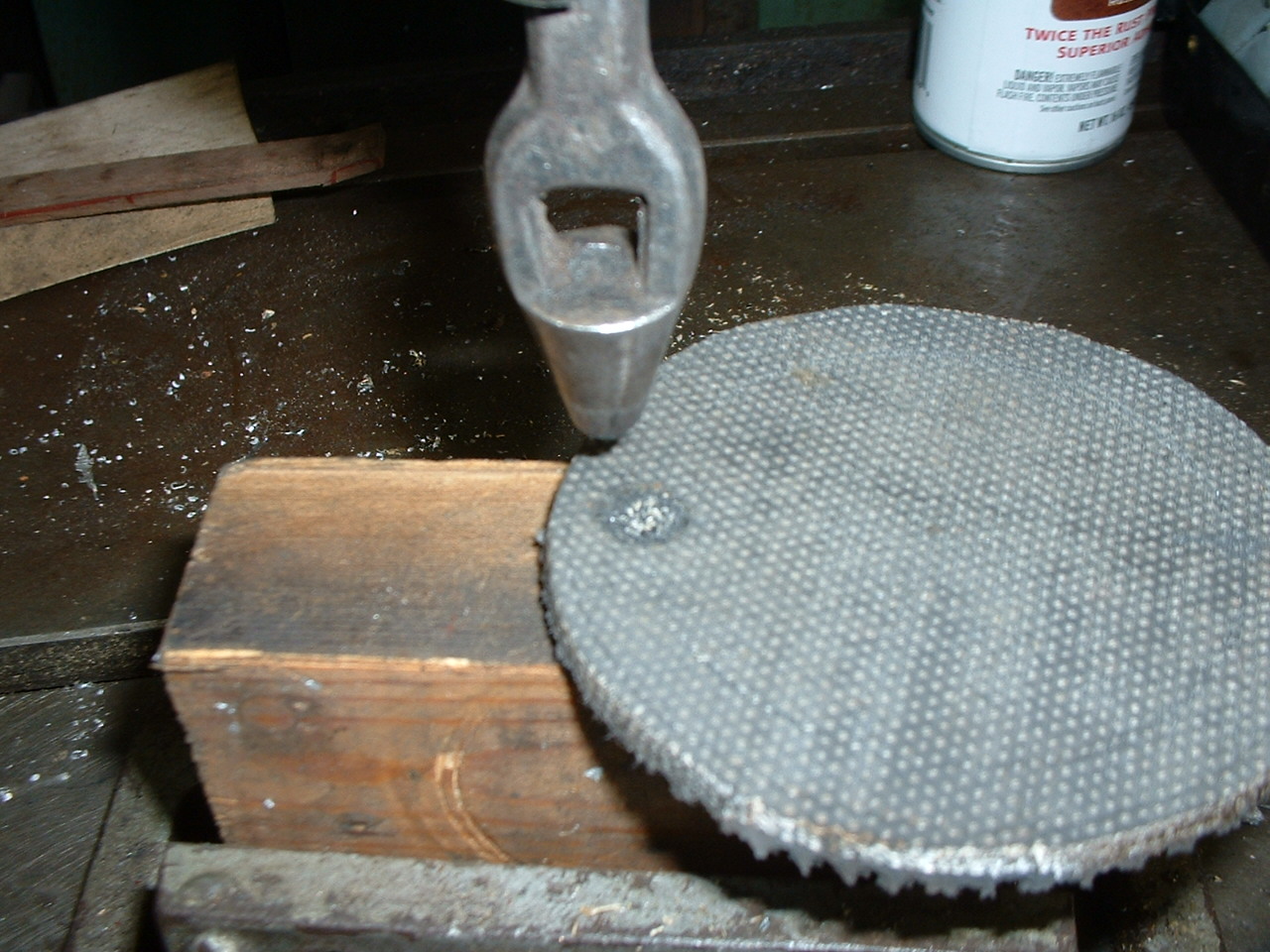

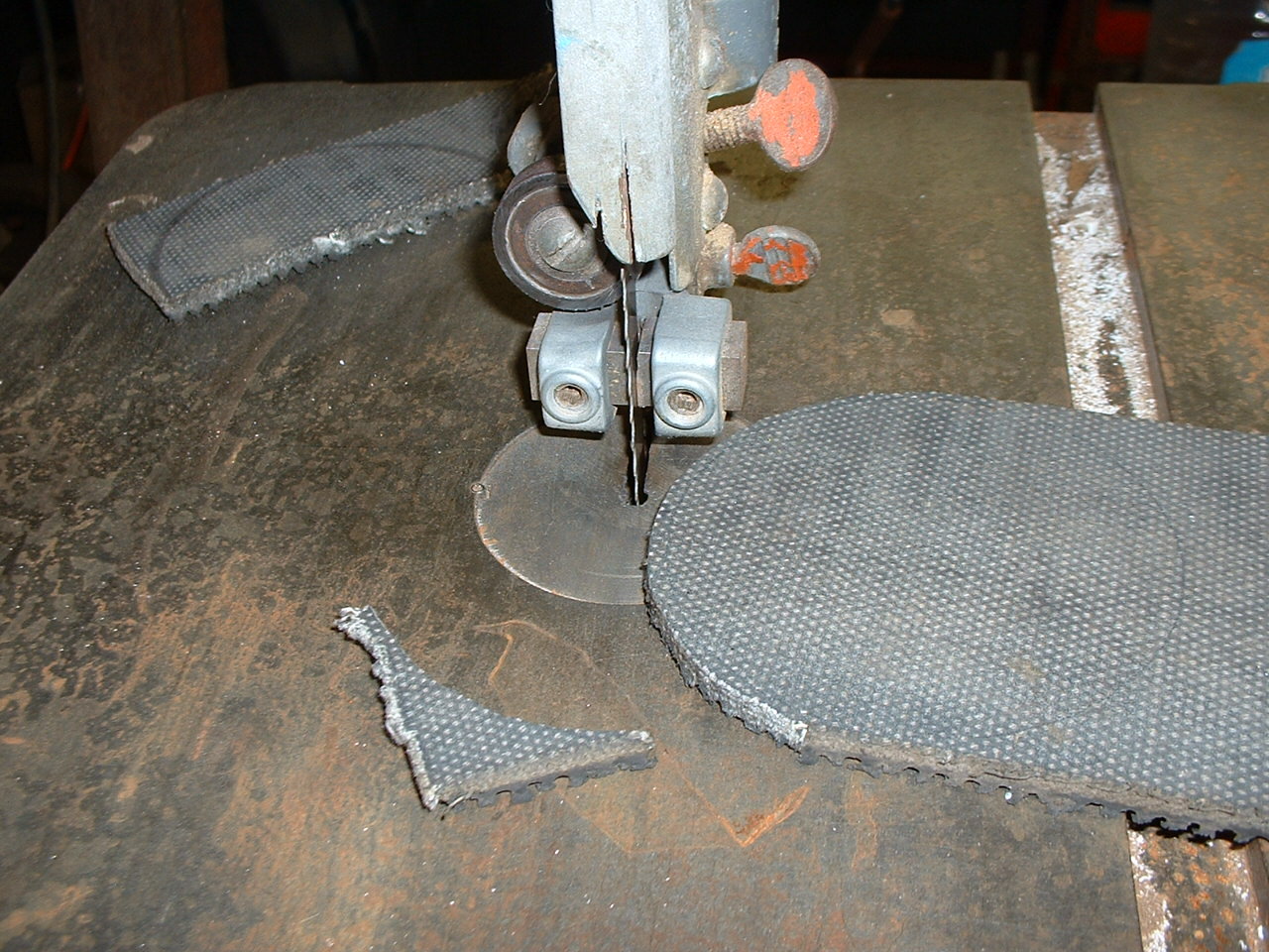

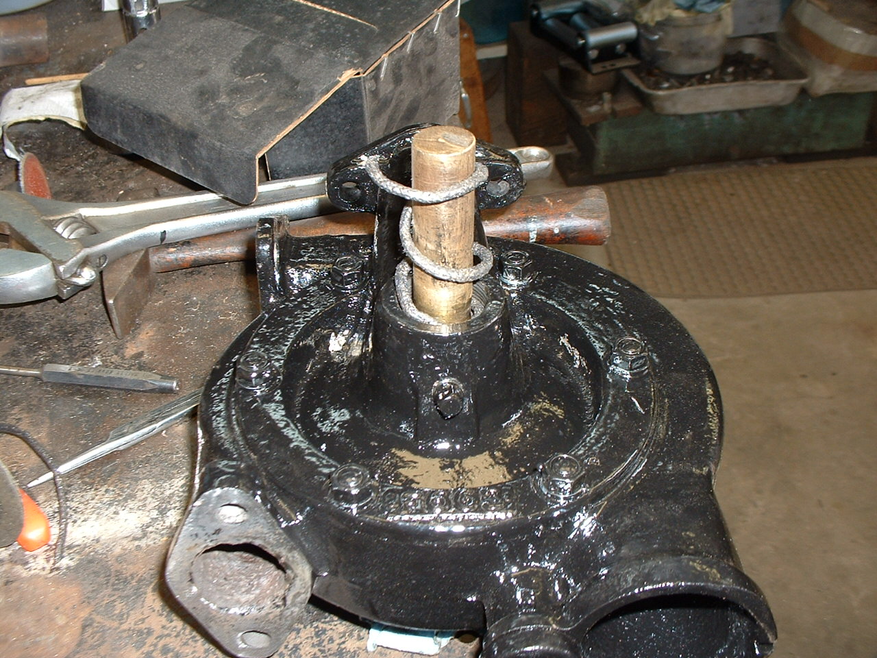

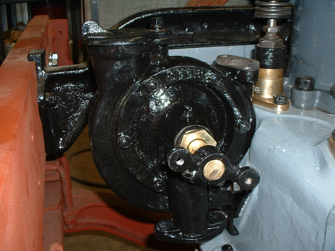

    Waterpump
    So the engine runs now but I've got to get some water in it so I can run it long enough to set the mixture and timing and bask in its glorious thunder. The waterpump has graphite packing on both sides. The shaft is bronze. Every other old car I've owned had a steel shaft and they all needed replacing. This shaft was perfect. Cool! I tried all my tricks to get the water pump apart but I'm afraid it will break. The bushings feel fine so I dug out the old packing, bead blasted it and painted it with POR15. I figure if you can paint over rust with the stuff, how much better will it be if you paint over clean iron. I also painted a bunch of other stuff. Once you crack a can of POR15 you better paint everything in sight. I also polished up the br***. Next I've got to hunt up some conveyor belt material for the flex joint. Then bolt-r-up.

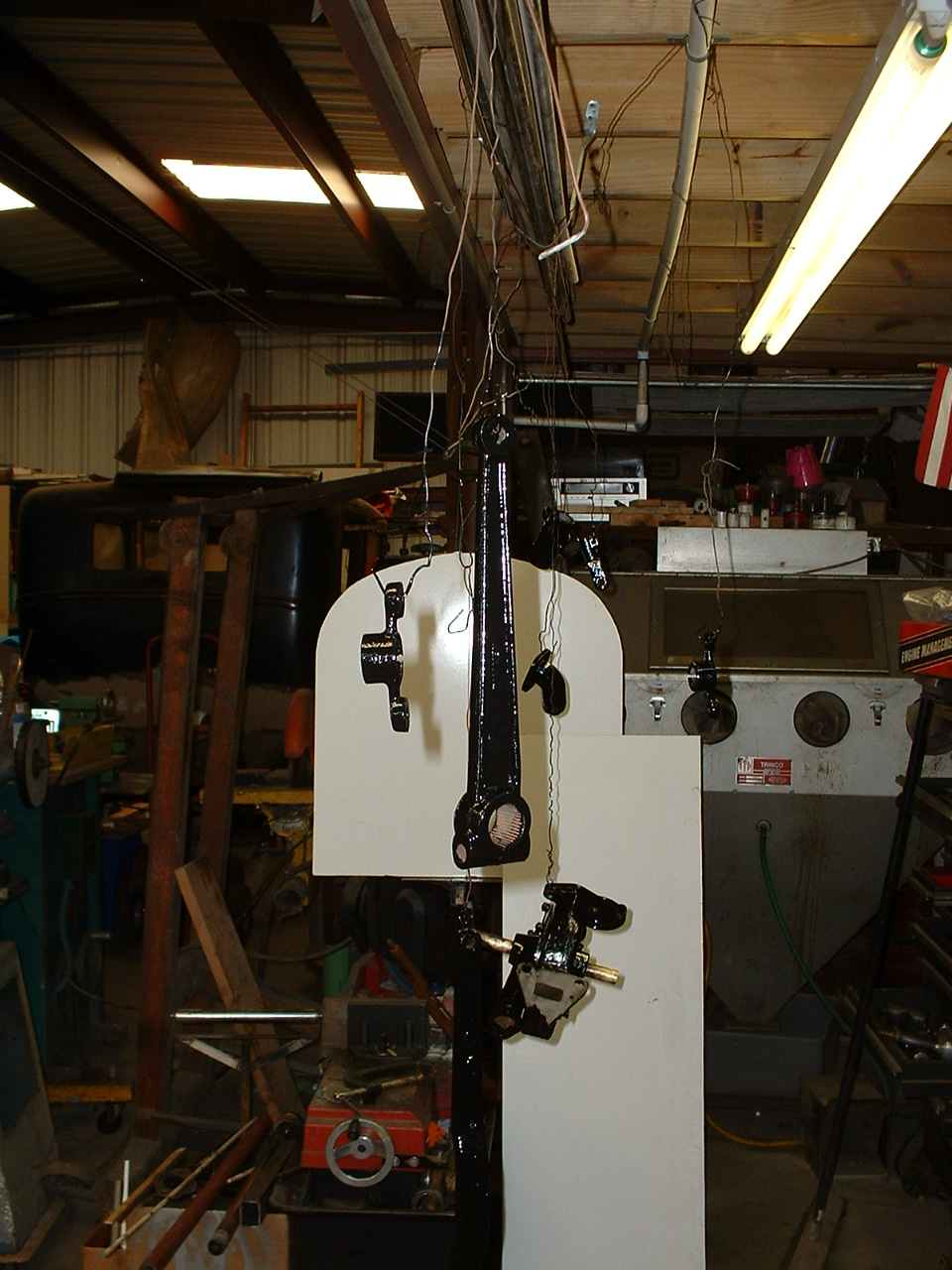

    nali

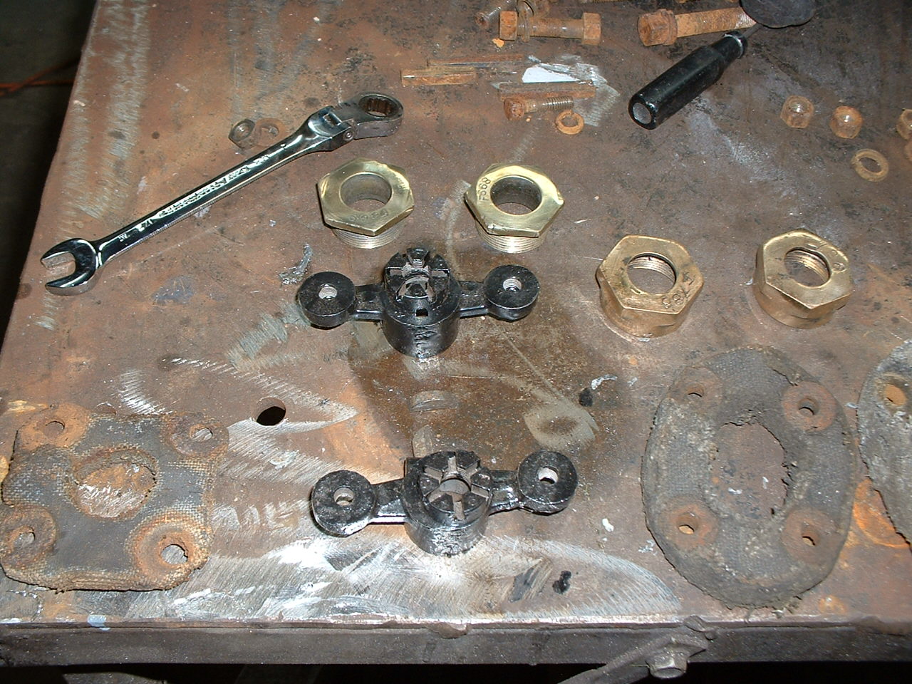

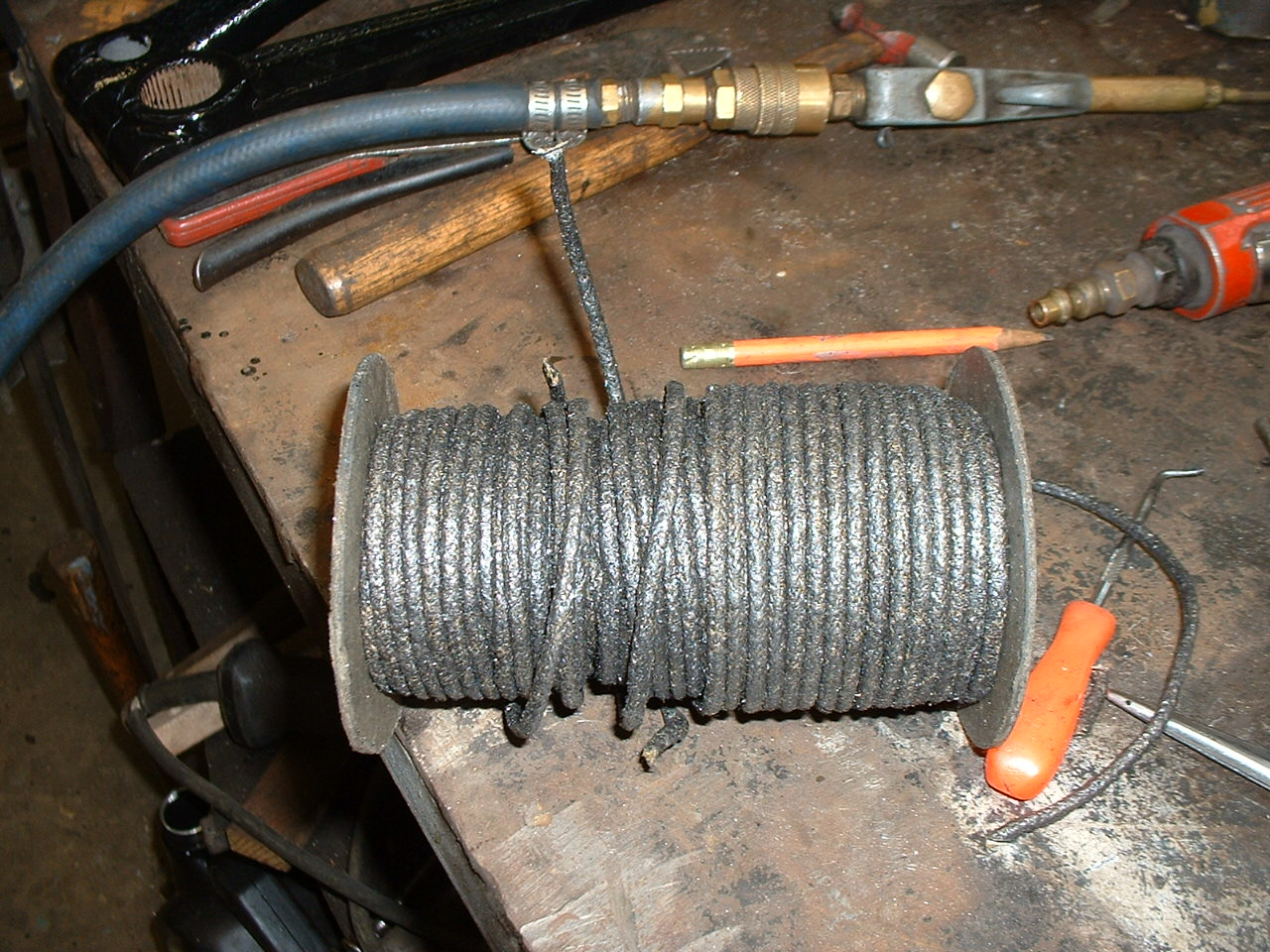

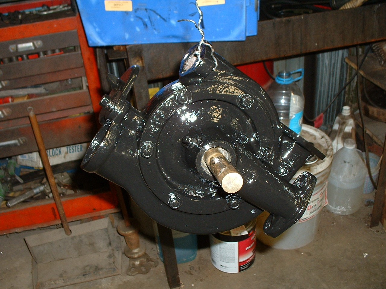

    More Waterpump
    Today I started ***embling the waterpump. Most of you know these old things have graphite impregnated packing. I bought a roll of it at Hershey years ago. No one ever told me the correct way to install the packing so I made up my own procedure. Wrap it around the shaft, add a little oil, compress it with the packing nut, undo, add some more packing, retighten. It seems to work on my other cars. The flex joint I make out of some conveyor belt material. I use some gasket punches I inherited from my dad to make the holes. For little holes I use the drill press as a kind of arbor press. For big holes I use the hydraulic press. Hope this isn't too boring. The drive on the other side of the waterpump is for the generator. I'll worry about that after the cooling system is done.

    Forgot to add. That filler cap you see on top of the pump in the last picture is for the oil. The oil slides around a cast channel in the waterpump and into the side of the block.

    packing a pump is easy you cut the packing into a ring make your cut at an angle like 45 deg opposing so when the ends meet they fit together when you install a ring use the packing gland - metal retainer to bottom the ring out in the stuffing box - place where the packing fits , every time you put a ring in move your cuts where the rings meet to different positions 12 o clock 4 o clock 9 o clock 1 o clock etc so the liquid doesnt have an easy path to follow to leak out dont want all the ring ends to be in the same position , i dig this build ,

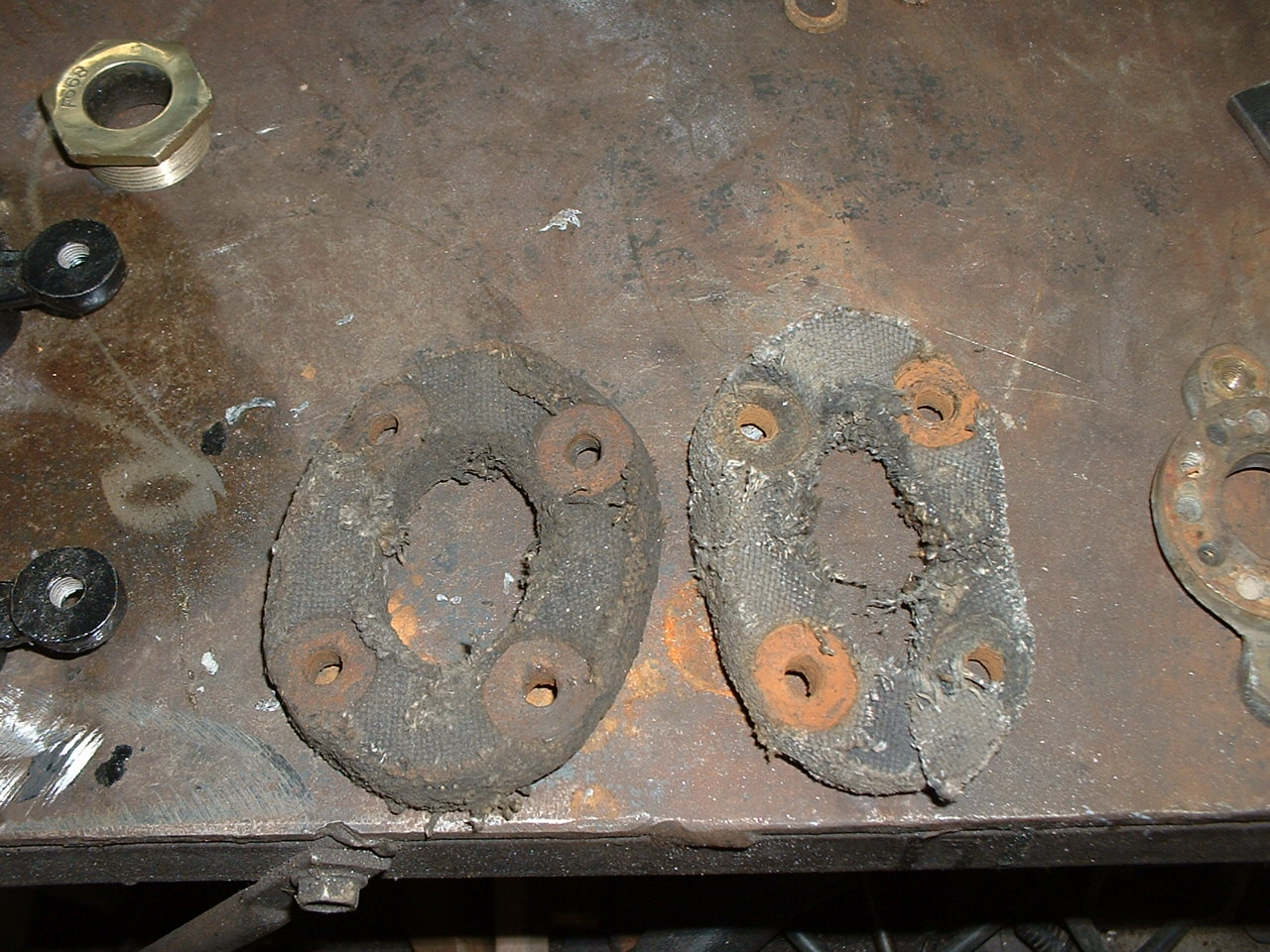

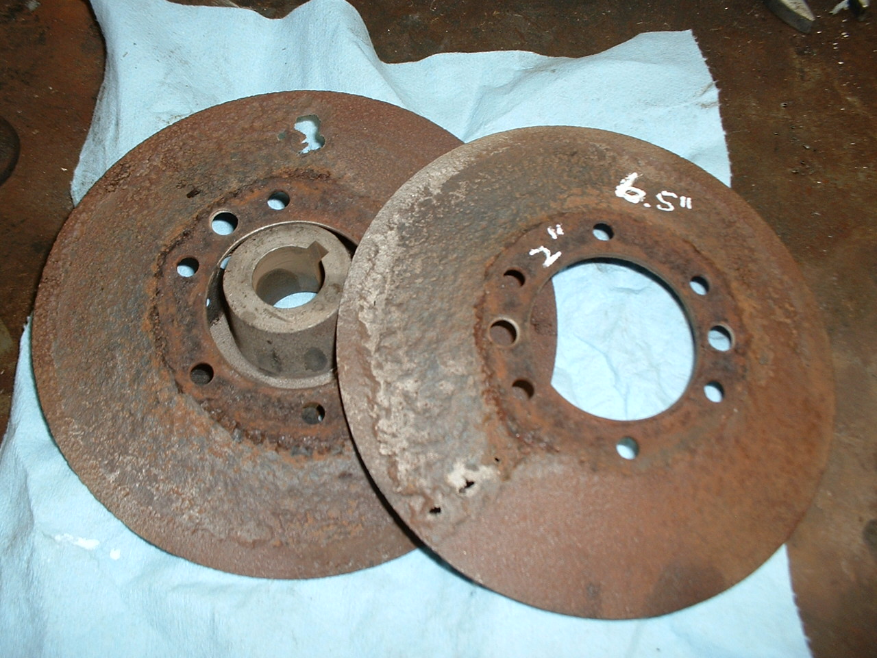

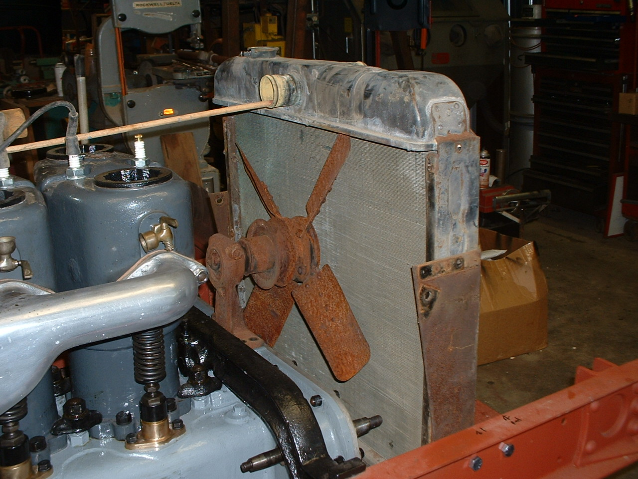

    Fan
    Just got back from Pigeon Forge TN with the family. The kids loved it but we sacrificed a lot of money to Dolly the goddess of country. Continuing with the cooling system I dismantled and inspected the fan ***embly. You can see it in the before picture. They used some pretty primitive bearings back then. They look like something out of your kids bike. One of the races was loose in the housing so I tack welded it. Crude but effective. The hardest thing was getting the seal apart. The seal is just a felt ring that is held in a threaded housing that screws into the hub. The threads were rusted and it took some cajoling to get apart. I cut a new felt ring with my gasket punches and after degreasing and bead blasting the fan is ready to paint and ***emble.

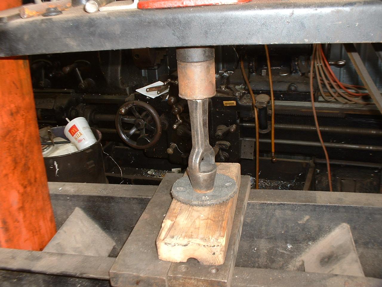

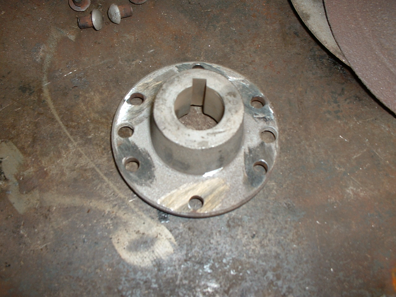

    Fan2

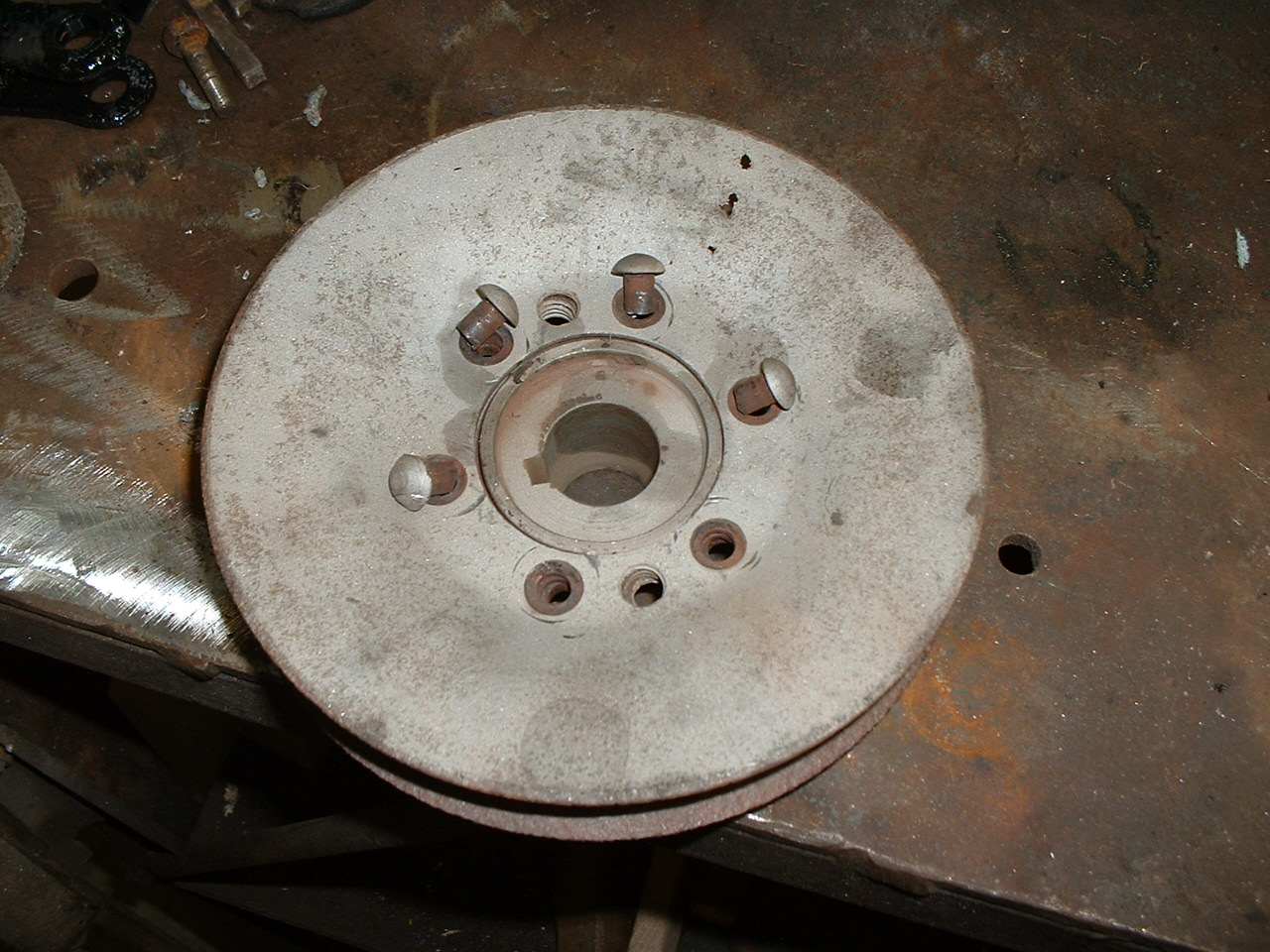

    The fan is driven off the right side camshaft. You can see the drive in the first picture. A one inch wide belt connects to the fan pulley. They thought big back in the old days. The pulley on the camshaft is rusted out. I ground off the rivets and took the thing apart. When I scare up some 12 gauge metal I'll make a new pulley.

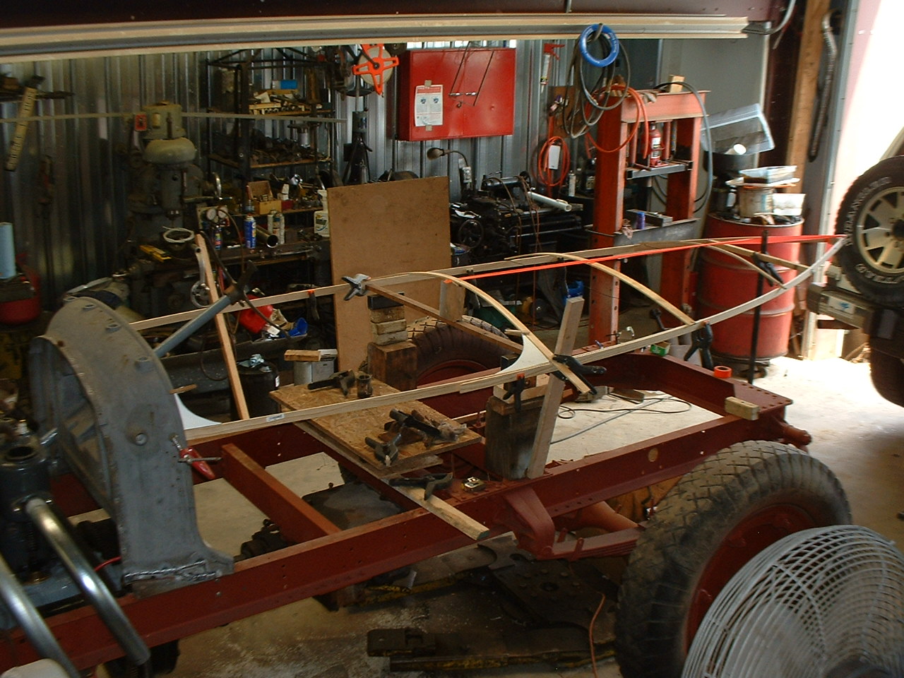

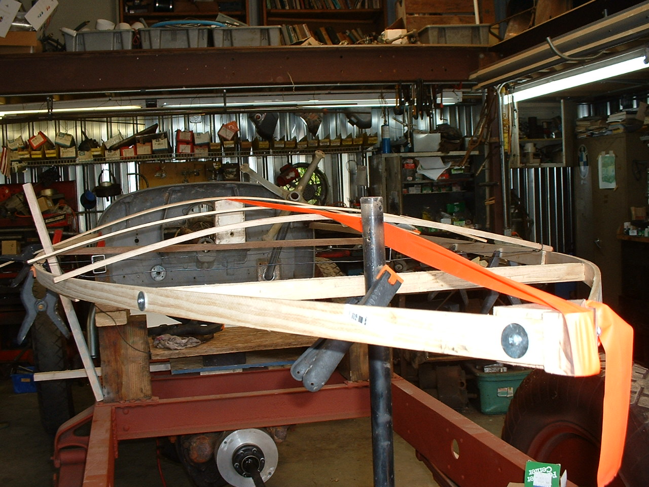

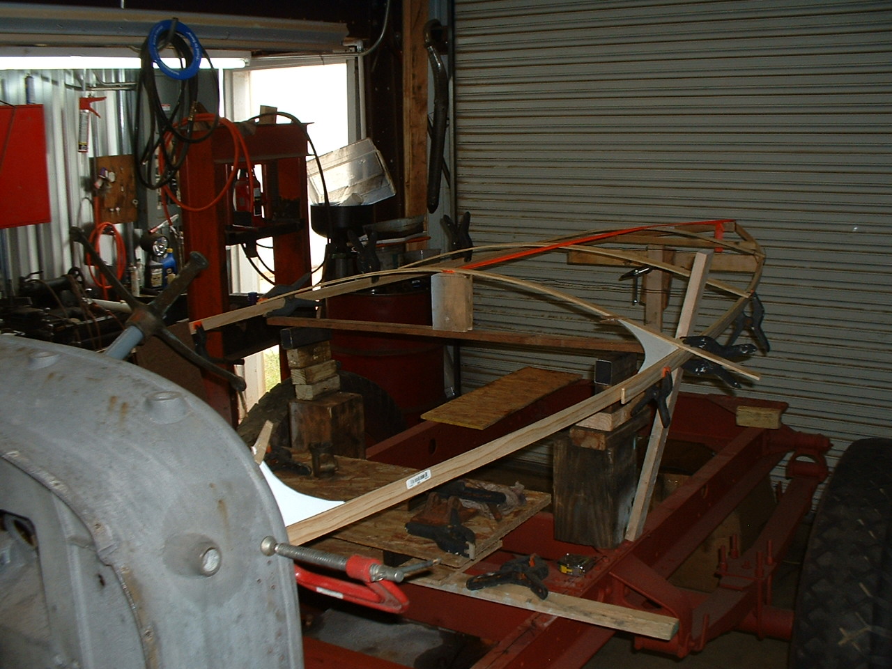

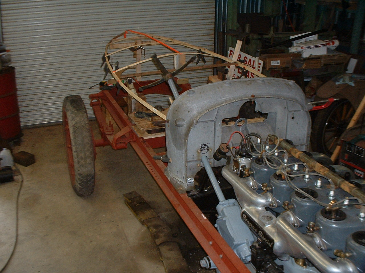

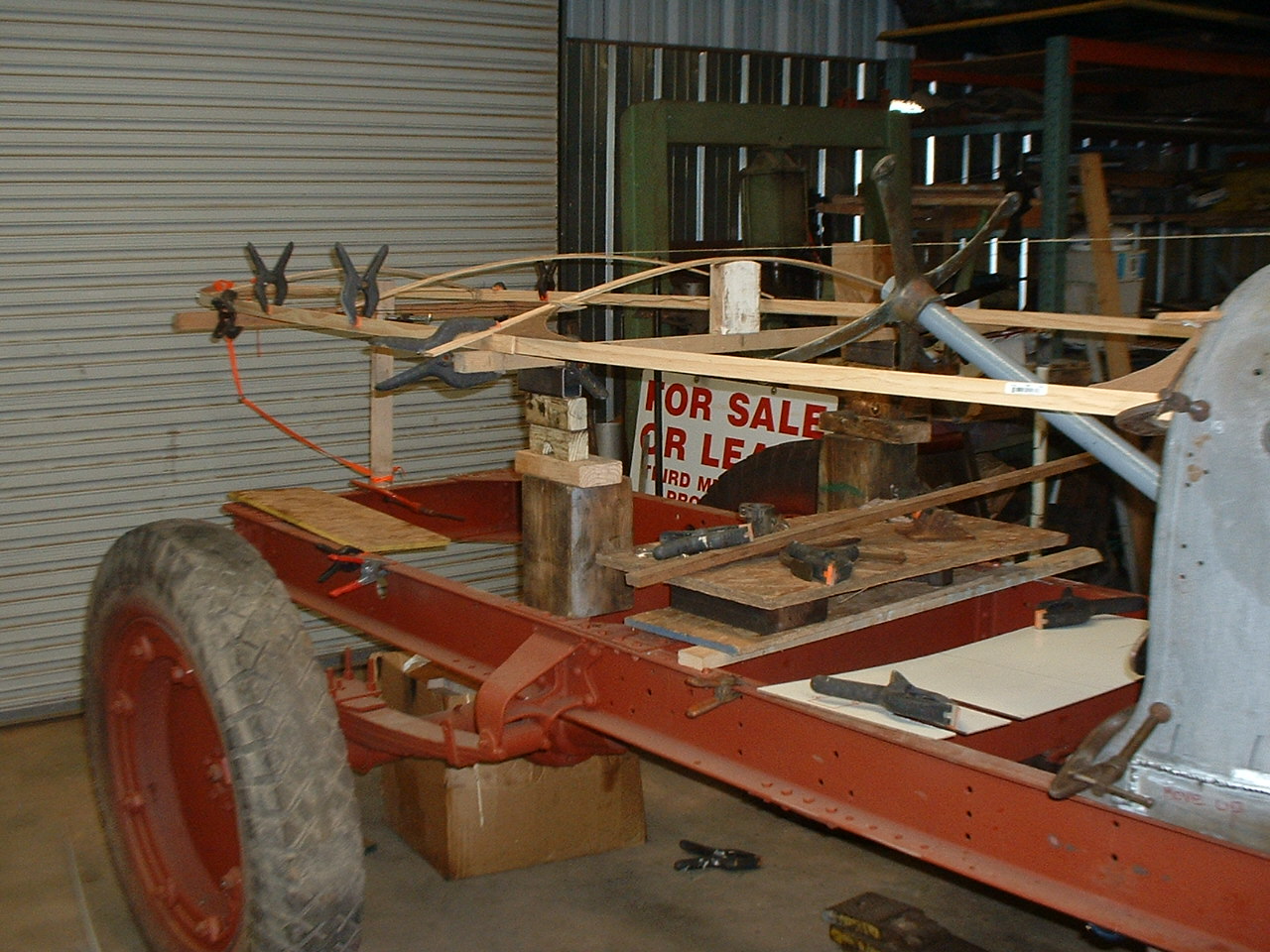

    Body

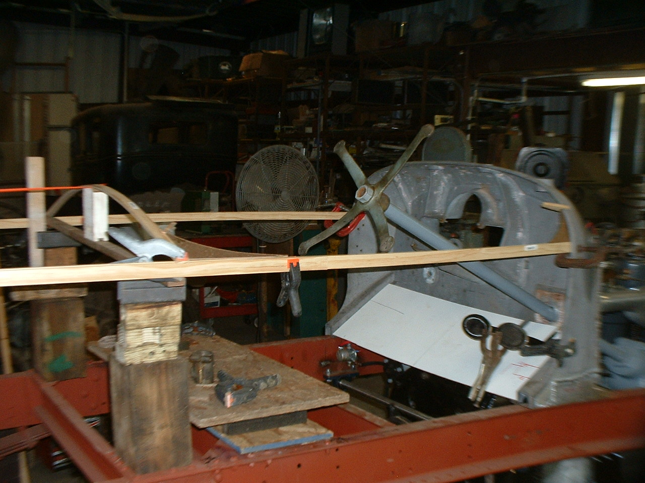

    Okay, I know what you're thinking. He's not even got the engine ready to go and he's working on the body. So here's my answer. Building a car is like playing a chess game. You've got to always be thinking a few steps ahead. The pedal placement depends on the steering wheel which depends on the seat which depends on the... You get the picture. Unless I know where the body's going I don't know where other things go--the exhaust, the firewall etc. I had an idea in my head but I needed to see it. I bought some battens at Lowes and slapped together a quick framework. It's a little hard to see. Notice the corner pieces in the ****pit. See what you think. Nothing is for sure.
    Jerry
    <input id="gwProxy" type="hidden"><!--Session data--><input onclick="jsCall();" id="jsProxy" type="hidden">
  14. Warpspeed
    Joined: Nov 4, 2008
    Posts: 532
    Warpspeed
    Yes indeed Jerry !!
    I think most of us have played the mock up and 10,000 trial fits game.
    It is all part of why it costs GM or Ford so much money to bring out a completely new model.
    While they probably don't use bits of cardboard, duct tape, and coat hangers to figure out how to mount a certain widget.
    What they do, is not all that different in concept to what we have to do.
    It takes them YEARS as well, to get all the relationships reasonably correct.

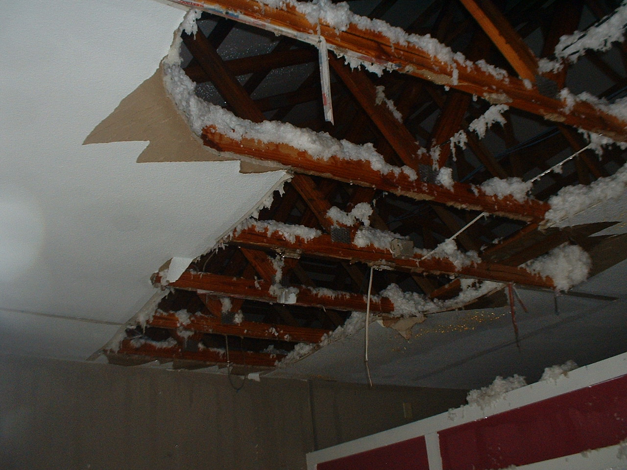

    Could be. $500! I think the guy's dreaming. The ceiling collapsed from a water leak in one of my buildings. It's taking time away from the Seagrave.

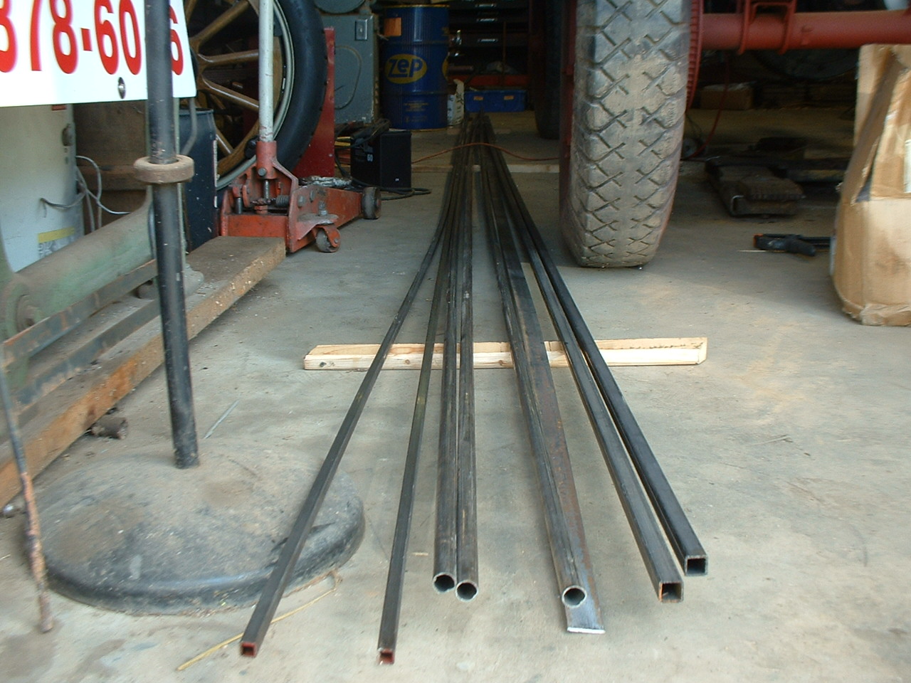

    I had some problems when a bad plumber created a leak in a building I own and the the ceiling fell down. But I had a chance to work on the Seagrave today. I firmed up the temporary framework for the body. I also secured the steel. As I looked at my mockup the vision of a wooden deck hit me. That would surely jazz things up. I'm not sure what kind of wood they use to make those alternating planks. Mahogany and ??? I watched a video that showed a guy using a Beugler pinstriper to make the seams. And I thought they were real seams!! So give me some input. The first and second picture shows my idea for the body--only much much bigger. There's no compound curves and that's important for ease of construction. They weren't into compound curves in 1923 anyway. Now picture the same body with a wooden deck like the next picture. Years ago I built a similar deck for a sailboat I owned. It was really pretty simple. The trick will be turn this pile of steel into a framework. I made work progress but my camera took a dump. Lens error! What the hell is that?
