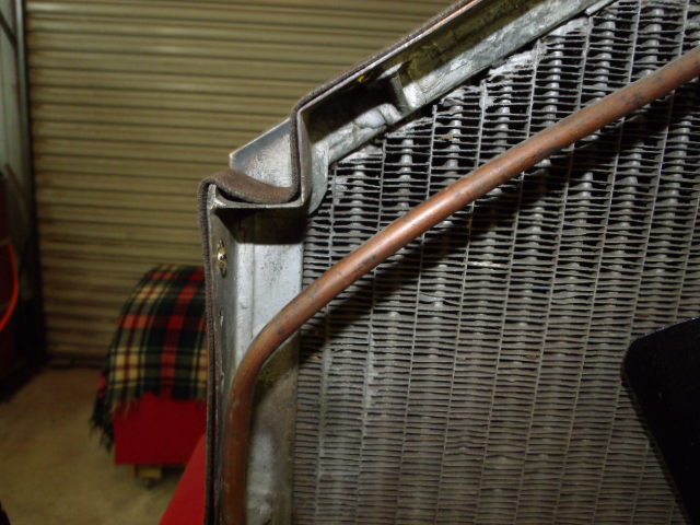

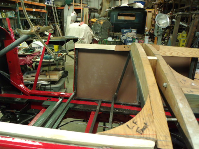

    Interesting--I'm thinking about it. Didn't do much except measure the cowl and radiator for some hood lace. I had a hard time finding some 3/4 X 1/16 thick stuff. Restoration Specialties had it. Also had somewhat of a hard time finding br*** split rivets (at a reasonable price) Snyder's Model T supply 24 for $1.50. I did paint the edges and underside of the floorboards--brushed. Seems like we spray everything these days. I thought it'd be nice to brush something, like the old days.

    those curved corner parts should have their grain at a 45 degree angle to the side and back to avoid splitting ...
    or use laminated beam structure ...
    find beam parts near constrution sites as it is used as headers an floor trusses
    or stack and laminate your own.... glue and clamped to shape
    wish I was closer .. I do not want you to have any problems

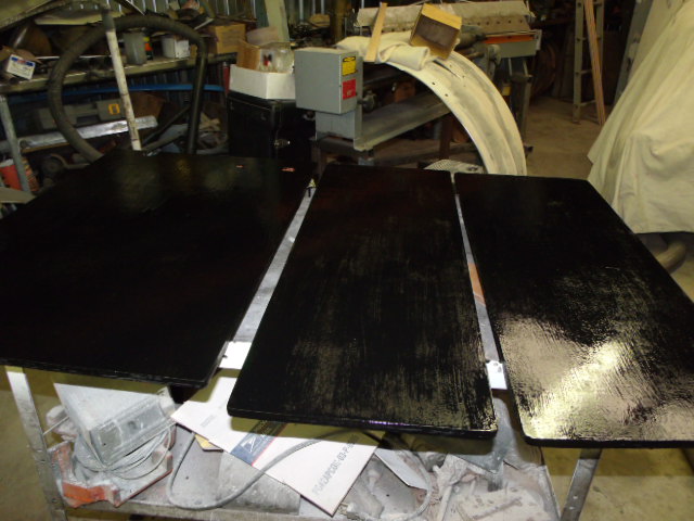

    I brushed all my floor boards too. I then took the gloss and most obvious brush marks down with some 3M polishing compound. I used 'good ole' Rustoleum oil base right out of the qt. can. Important to let the paint cure for several days (or more) before attempting any hand rubbing. I followed that process up with some paste wax. End result is something that has an 'old timey' finish but it has a nice almost satin sheen that still looks brushed on and period authentic without that 'just painted' look.. Jimmy

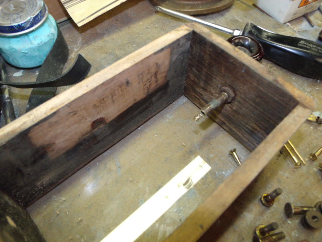

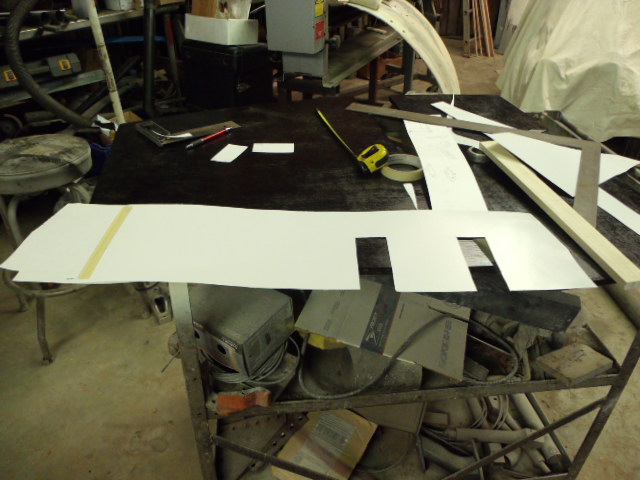

    I like making patterns. I make a lot of them. I made one for the pedal area and one for the **** separator. I like the upholstery in the first picture. It's a 1912 Gobron-Brillie 12 CV. http://ebillionairesclub.com/content/1912-gobron-brillie-12-cv The seat looks like it's do able--at least by me. I also cut out a new seat bottom. The interior is starting to shape itself in my mind. This is very important. I have to see it in my mind before I can build it. All the parts have to fit together in my head. There can be no loose ends. Well, maybe some very small ones. :)
    Jerry

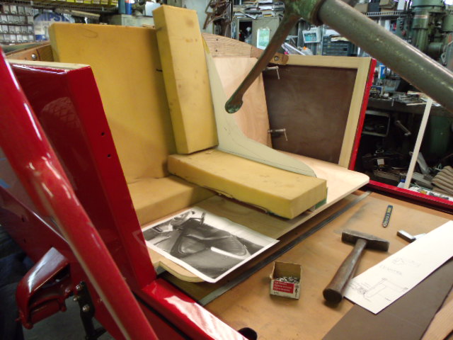

    I also glued some spacers on the firewall and played around with some foam on the seat. Feels good to get that off my chest.

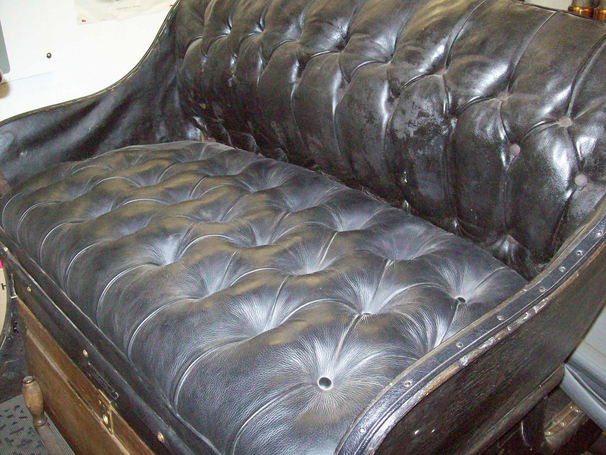

    The largest part of the diamond tuft job is working out the pattern, the leather will be much larger than the backing canvas to allow for the tufts & folds.
    The seat pictured was missing the bottom cushion. The back leather is 109 yeas old, the seat bottom is 3 year old. It took me 3 days to stuff the leather with curled horse hair & almost a garbage bag full of hair. There is absolutely no sewing in this seat.
    There is a fellow named Mel in Pa. who can supply the curled horse hair & has good leather at a reasonable price.

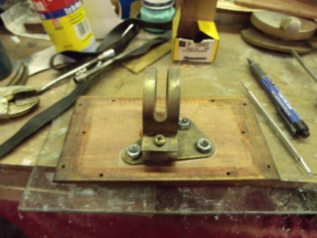

    I had to hunt up some 1/8 X 3/4 flat hood lace which is hard to find. Restoration Supply had it. They also had 1/8 X 1.5 flat hood lace. I ground up an old pair of pliers into a split rivet splitter. Worked real neat. The holes in the radiator were real big but luckily I found some little br*** washers in the bin rack I bought from Don a few years back. I also got tired of searching through every drawer and spent some time organizing. Cool! I need the hood lace on before I can put on the hood. I ordered some br*** screws for the coil box cover. I think I may install the ignition wires while I'm under the hood. This may be complex as there's a fiber tube the wires go through. But the tube is cracked so I may replace it with br***. I might also install the magneto even though it doesn't really work it looks super cool. Then again, as you might have gathered, I might jump onto some completely different part of the speedster and start working there. You see, I'm not really in control of my actions. :)
