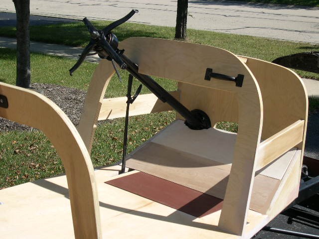

    The dash looks really oversize to me. SEE PHOTO: This is the backboard of mine before gauges, steering wheel bracket and veneer was added. (****py grab handle in this picture was not used and just stuck there to get an idea for positioning one. Seems to me you could trim the dash shorter right along the hole of steering shaft and just make a nice BR*** bracket to support it. Just my 2 cents

    Actually it will shrink of its own accord. The doors take up a lot of the sides. The pad takes up 2 inches of the top. There will be cutouts on either side of the bottom. Plus, if you flip back through some of the old pictures you'll see the old firetruck dash is cast into the cowl and to hide that the wooden dash has to come fairly low. I only had time today to tinker with the shifter and handbrake. I need to buy a French curve or something to draw some graceful lines for the cutouts on the bottom of the dash. I polished the handbrake handle and ****on then moved on to the shifter ****on. The shifter has a reverse lockout which, because I reversed the shift pattern when I reworked the linkage, will now be inoperative. A least until I have time to address it. The paint will have to dry on the e-brake rod before I can install it. I'm cruising ebay looking for comp***es, altimeters, oil temp gauges, inclinometers, pyrometers, gyrometers and knife switches.

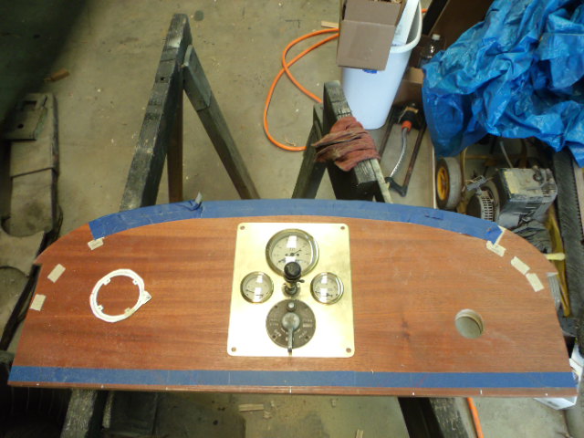

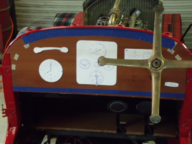

    Mockup
    Choose your dash--or make up a new one. The steering wheel will really be about two feet away from the dash and 10 inches higher than the hole, but you get the picture. Imagine the white paper is br***. I was having a flashback to the sixties in the fourth picture. Hey, Alex earned his brown and black belt last night. Black belt is next. I'll need a new body guard to keep away the adoring crowds once the speedster is finished.

    I vote for picture #2.

    Now that's a dash!

    I like what I see going on with the dash.
    Again here comes my 2cents: The grab handle this time. Before you fit it, sort of tape it on and do 'light' trial grabs and reaches to determine the best placing. mounting it perfectly straight & symmetrical may look better but when the kiddies or wife is actually trying to come on board, it's good to have it placed where it works the best. In my case, I had to angle it. Couldn't find one that didn't look like a door handle to me so I ended up wrapping mine in waxed cotton cord like the racing steering wheels were done. Just a thought.
    My God! I love that Pierce dash! Those two cubby boxes doors could make for some good access for getting at wiring and other things needing fiddling under the dash in the future. Hmmmmm?

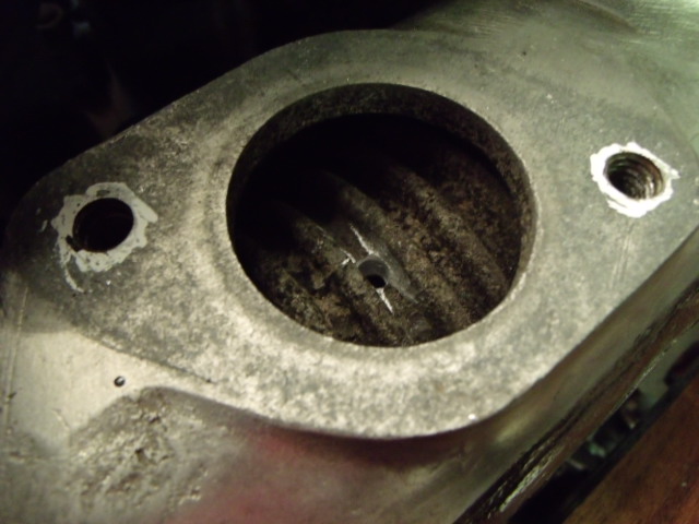

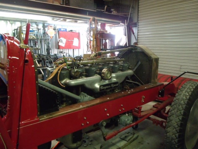

    Nature abhors a vacuum
    Not me though--without it we wouldn't have car engines. The speedster intake manifold cried out to have something right in the middle of it. It used to have this funky heat riser tube. Back in the day engine designers thought gas would be better atomized if it was heated. We know the opposite is true. (We're so smart) Anyway, I thought it'd be the perfect place for a big ol' vacuum gauge. Something to watch while the engine ran. I had to drill a hole to get into the actual intake part of the manifold. Check out my nifty chip vacuum. Bernoulli's principle! Hey, there's another thing we need to have car engines. You wouldn't think it took all day to make a plate, polish it up and the gauge then mount the thing, but it did. Go figure. By the way, I got a beef... What happened to 7/16 bolts? You can't find them at the parts house or hardware store. No one carries them. Why? I spent a few minutes mocking up the dash in situ. Comp*** right below the volt gauge/light switch plate? Don't forget about the big surprise on the coil box. It'll be ready any day now. Have a great Labor Day!

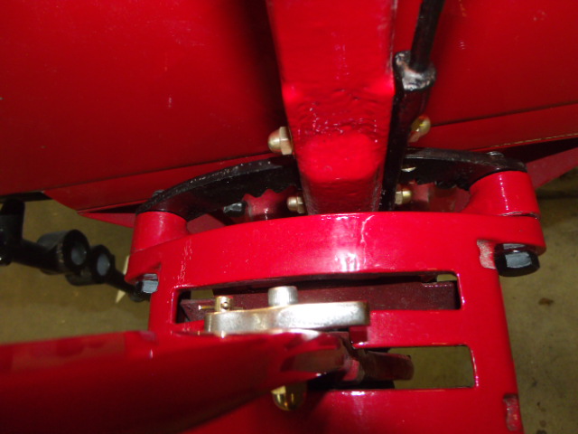

    Well, I tried to make a little speedster money on ebay but I barely broke even--plus I lost two days of speedster work. Don the Morgan guy had this giant old industrial twin rheostat that the steam punk crowd swoons over. I bought it for $40 and thought it might sell for $100. At least that's what other rheostats had brought. 88 viewers, 11 watchers, one guy bid $50 and I had to crate it! Made $10 for that. Wow! But you can't win if you don't bet.

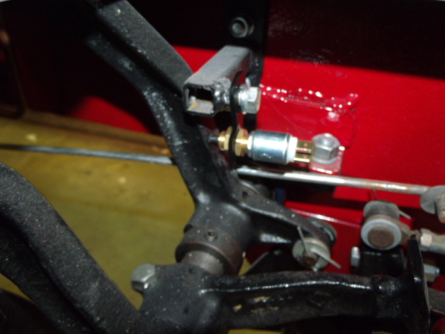

    Got in more odds and ends. The lower Ebrake slide bolts. The brake light switch--courtesy of a 1990 240 Volvo. Hey, it's got two nifty br*** adjusting nuts on it! And here's another beef. I know big time restorers probably mix up top quality paint with hardener every time the have a few bolts to paint but I just whip out the old spray can and give them a blast. So here's the problem. I've been using Rustoleum but it takes forever to dry and there's big problem with the nozzles and even the cans themselves clogging up. A few days ago I switched to Krylon which brags 10 minutes dry time. Problem: the color is very thin and takes many, many coats. What's ya'lls favorite rattle can brands? Help me out here.

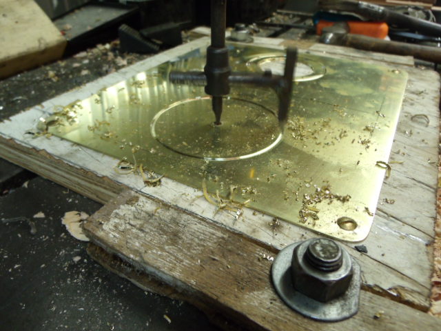

    Excuse my profanity but I love that limerick. I love br*** too. Except when I have to tap it. I still haven't learned that trick too well. Today I made a dash--all day. The gauges were all an oddball diameter so I dug through my oddball tool drawer and found an adjustable diameter hole cutter. I think it was made for wood or plastic but since it had no bit on it what difference did that make. I welded an old lathe bit on the end then proceeded to make circles on the slowest speed of my drill press which is about 60 RPM. It worked pretty good for the first hole and 90% of the second before snapping in half. I got out the hole saw and a die grinder. The result looked good. I think I'll make a br*** plate for the light switches instead of that funky steel one. BTW--know any good limericks?

    That type hole cutter does more and more work as the trench/bevel increases. Next time do 1/3 from the back and finish from the front.
