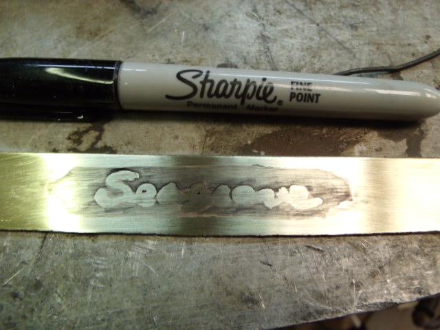

    I clicked on the H.A.M.B. list as usual and it said the Giant Speedster Project had "moved" What does that mean? There were no stats listed like there usually is. Mmmm.

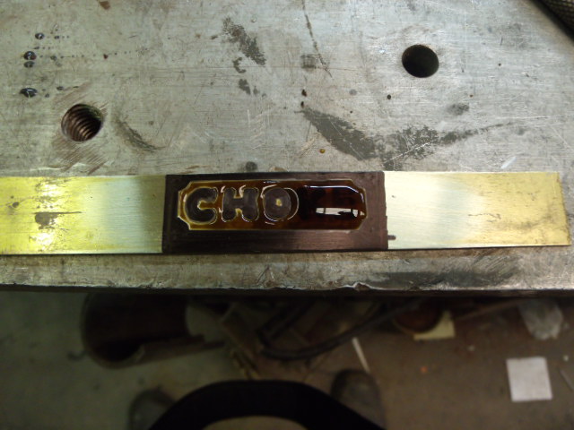

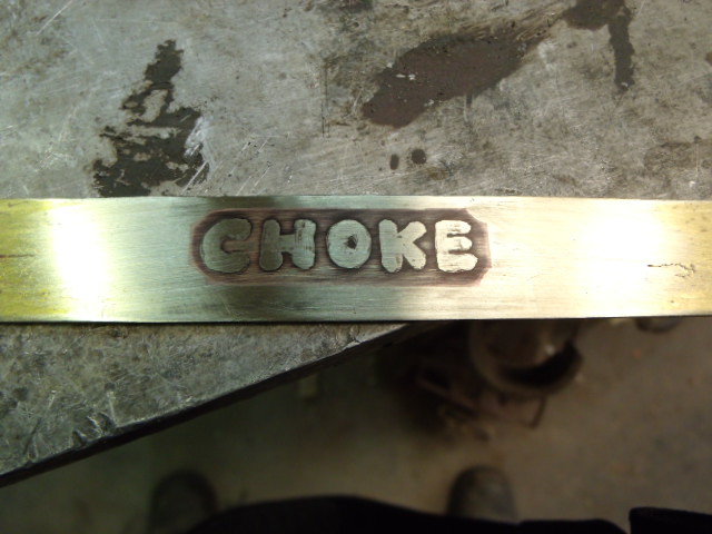

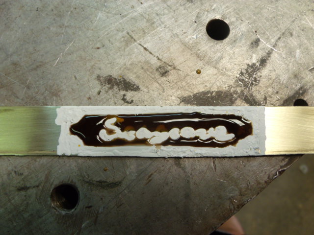

    While I'm waiting for the nitric acid to arrive I played around with some ferric chloride I had left over after making a circuit board. It's not very strong so it takes forever. The first test involved a bottle of whiteout to spell out Seagrave. On the second test I used a Sharpie to spell choke. The ferric chloride just doesn't etch fast enough or deep enough. It was fun though. While I was waiting I messed around mounting the br*** dash and the light switch.

    Jerry,
    This works! I've used this method with good success in my 'artist days'.

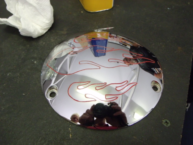

    A great resist for etching br*** are certain felt tip pens “Staedtler Lumocolor CD-R Pen” – They come in a package of 4 colors, Red, Black, Blue and Green. You can buy a 4-pack on Amazon for $6.99. You can order them at any bigger art supply store such as A.B. **** also. The red pen works best for Ferric Chloride and Ferric Nitrate. The black pen works for short etching sessions of 1 hour or less. If you want a very deep etch, and need to leave it in the etching bath for more than 1 hour, I would not use any color other than red. The other colors may break down in Ferric Chloride and Ferric Nitrate after 1 hour or so. Try it!
    I'm not sure if my earlier suggestion was even noticed in the middle of 'LIMERICK-O-THON but a Dremel (or other brand) engraving pen with small bits will make some nice engraving patterns also. You can spray the br*** with a primer or flat black and then draw, transfer, scratch a visible design and just follow the lines like a boy scout craft project. It works too.

    yonahrr
    Not sure if my hand is steady enough for a Dremel tool. I like where you use a laser printer and iron it onto your work. I think I'll try that.

    patman
    I've done the laser printer thing for printed circuit boards, it's a bit fussy, but it does work. Set the printer up all the way DARK to load up lots of toner, and use the thinnest paper you can get to feed properly. Mirror your image, print it out, iron it on good, let it soak in some water for a while to soften up the paper, then you can rub the paper fibers off with your fingers leaving just the toner.
    There is some kind of paper that is used for hospital gowns that is made to dissolve in water when they're disposed. I've heard of using that to print the toner on also. You can also buy sheets of it at craft stores, it's used to back fabric when doing machine embroidery work, then it dissolves in the washing machine.
    Another option would be to hit the local jeweler or trophy store...they could engrave it for you.

    when i was just 10 or 11 i watched a guy engraving gl***es in a mall, he had parkinson's pretty bad but when his engraver touched the gl*** he stopped shaking, the gl***es had old english text and roses and the like, just beautiful, a shaky hand is no excuse.
  12. On the Dremel tool-
    Jerry, I'll use my opposite thumb on the side of the tool to provide a little resistance/guidance, and it really helps!

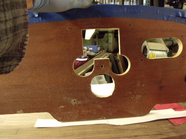

    Dash and Door

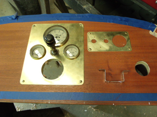

    I knew that when I went to install the door it wasn't going to fit. I had to space and grind and move and remove and adjust and grind. Eventually I got it to fit. The fit between dash and door is critical. I'm going to make up some br*** plates to finish out the gap between the two. I also need to cut a shape into the bottom of the dash and I'd like to cover that with some br*** trim. Left my camera at home so cell phone pics. Hey, I just discovered that a guy a hundred feet from my shop engraves Harley parts with all kinds of scenes. I'll stop in and see if I can get some pictures

    some types of computer printers "art work "can be wetted with water or other solutions and have the ink transfer to the object being worked on ...reversed line drawing -wet applied to wood /linoleum .. to be wood cut or hand etched/used for printing then making into a positive print ....
    so okay my be the right ink could be your repel or guide for repel chemicals for more fine detail hand work on metal????

    I say do it like you did the first go around, have a vinyl cutter make your design and use the vinyl sticker as your resist.

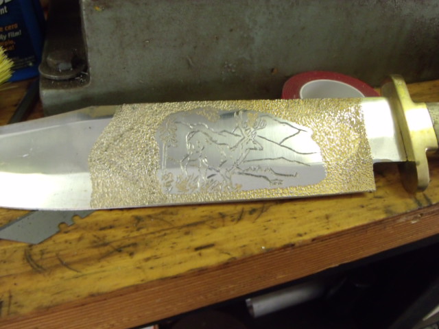

  22. yonahrr
    Joined: Feb 27, 2010
    Posts: 1,348
    yonahrr
    Dave can engrave
    Went over to Dave the engravers place (about a hundred yards down the hill from my shop) to see if he had any insight into my engraving problem. His business is engraving knives and Harley parts but he doesn't use acid. He uses a tiny air chisel which carves the design into the steel--deep too. He likes wildlife scenes. Dave can take a run of the mill knife and make it something special. He prints out a scene on his laser printer but he really doesn't have to transfer it to the metal. Later on at home I found a nifty art deco design for my dash. I could even sandblast this design in the dash and then add some black. Today though I rebuilt the carb on the Toyota dump truck--several times! thought you might like a better picture of the door.
    Jerry

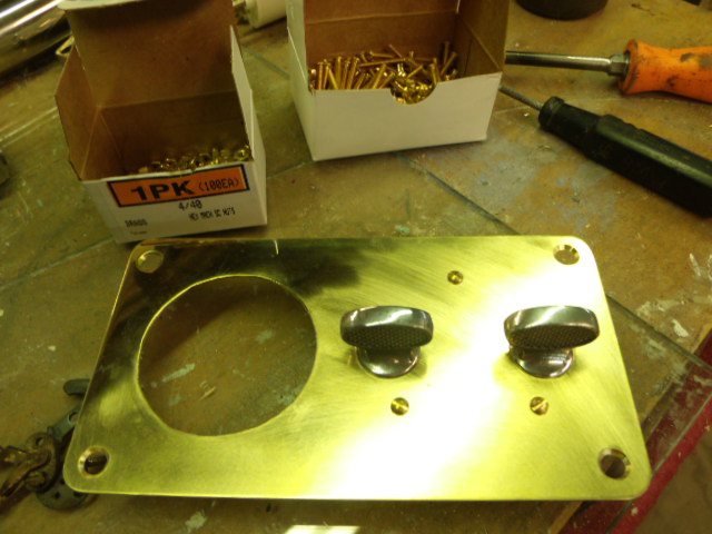

    Remember I told you I had something special in mind for that coil box?

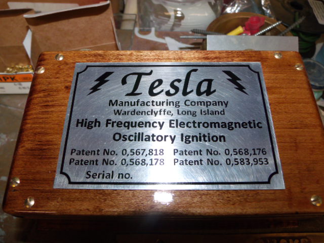

    Sorry it took so long. And this ties into Piston Farmer's comment about the vinyl cutter. I wanted to make a special data plate for the coil box but Michael, my sign maker buddy at Mountain Country Signs, wasn't sure if his vinyl cutter could make letters small enough. You can't rush guys who are going that extra mile for you. Today he called. The real problem was getting the tiny letters off the sheet and onto the plate. But he came through. Looks great! Now the fun starts. I've got to acid etch the rest of the plate, then paint it, then peel off the vinyl. A few tests with s**** aluminum are in order. Other than that I made up a jig (yes another jig) to bend up some br*** to cap the bottom of the dash. Now to order some 18 gauge br*** long enough. While I was in the shop, Kevin was outside working on the Toyota dump truck.
