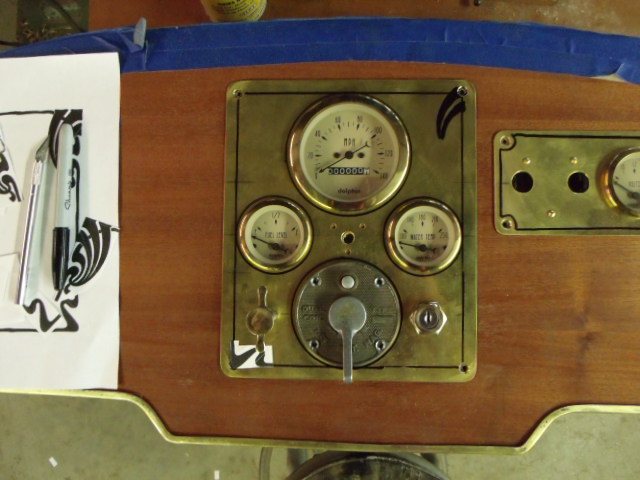

    Jerry its looking great! I cant wait to see the acid etch done. Im still trying to talk myself into buying a vinyl cutter so I can do more etching.

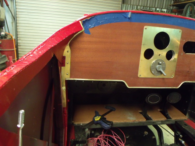

  2. hope you have allowed foot travel room in all this pretty stuff....
    ....those pedal slots seem to be blocking pedal travel?
    drive then decorate
    .oh maniacly obsessive dreamer....
    gogogogogo

    You know human nature better than that. Once I drive it I'll never work on it again. :)

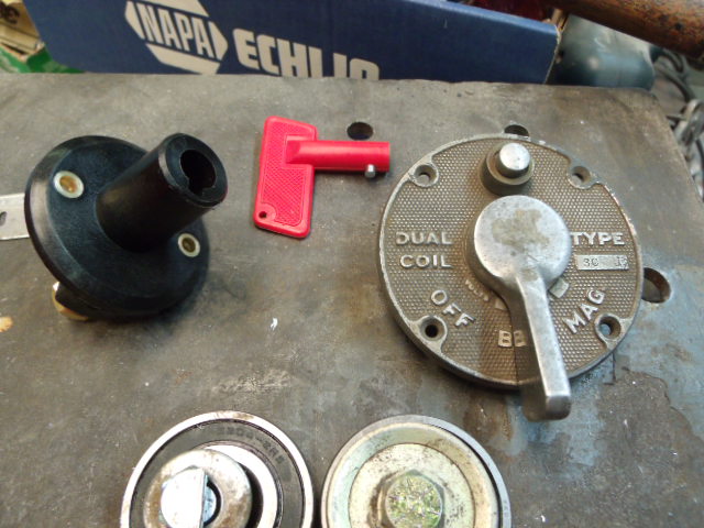

    Mating old and new

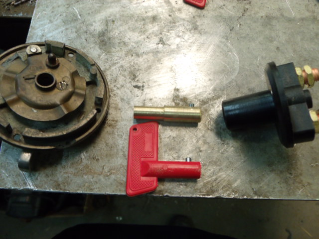

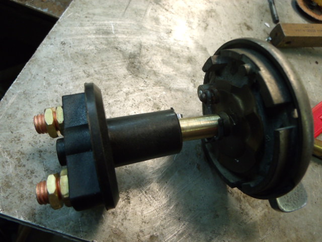

    Get those dirty thoughts out of your mind. I bought that magneto switch part about 15 years ago at Hershey. I think I paid about $35. Imagine how much the thing would have been if it had been complete! I figured someday I'd attach it to a modern switch. That day was today. Can you say Rube Goldberg? Actually it was a masterpiece of mechanical engineering. Got the Toyota dump finished too. Good thing I didn't paint the Speedster. Okay, I used some industrial epoxy but still--the Toyota had the worst case of orange peel you've ever seen. In fact orange peel is putting it nicely. The paint looked more like bed liner. Look for it on ebay.

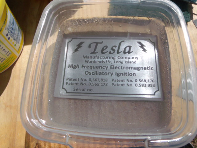

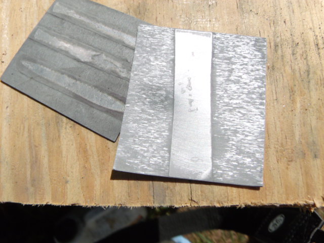

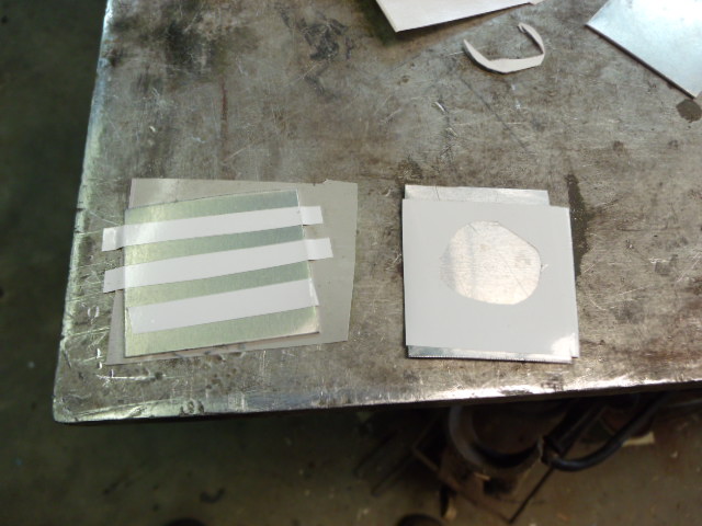

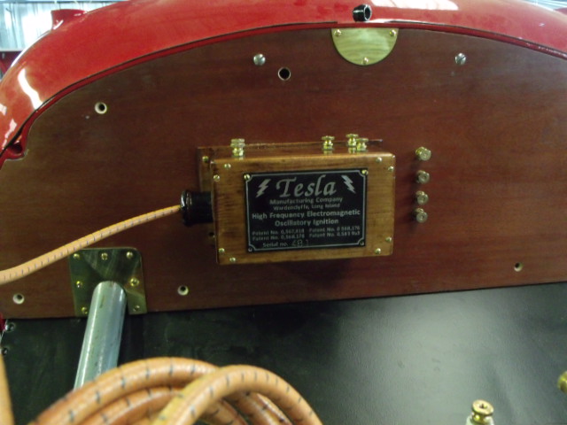

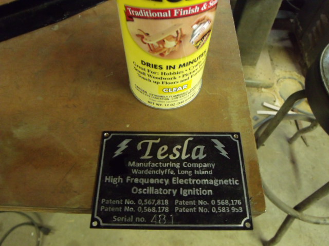

    Dropping acid

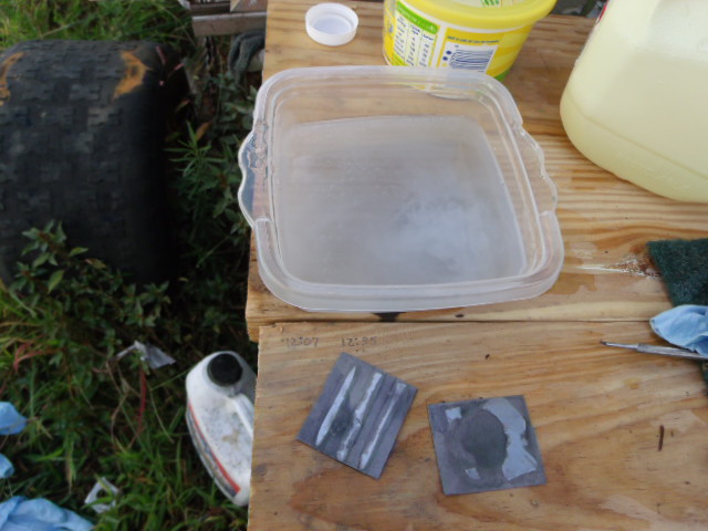

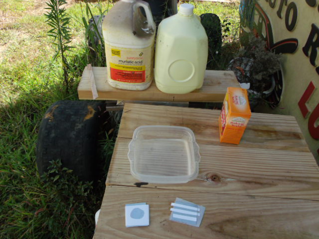

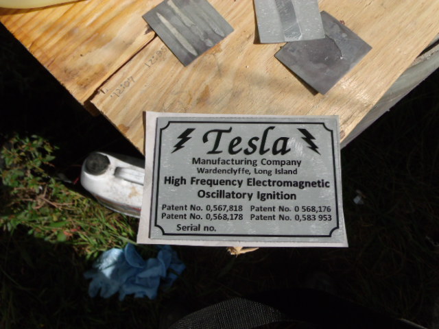

    The time felt right to drop some acid. I was trying to recall some of those old names but all I came up with was Orange Sunshine. The stuff I used today was called Sunnyside! How can you beat that for a name!

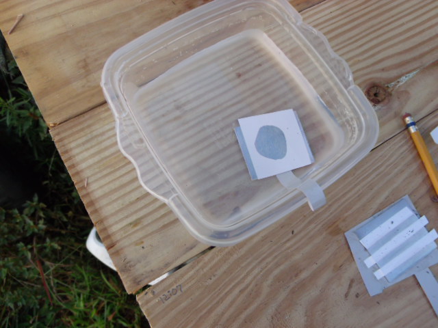

    Even though I used to be a lab ***istant I just poured some into a tub of water. Remember: "Do as you outa, add acid to watta" All chemists know that. (even illicit ones) I made up some test pieces because I didn't want to ruin my one and only original Tesla (not the band) data plate. And boy did I ruin them!
    The reaction seems to take a while to get going. Maybe the aluminum isn't clean enough, and it takes a while for the acid to get through the oxide. I diluted the mix and the next test piece came out right--about 2 hours. If you make the mix too strong the aluminum gets too hot and the vinyl letters come off.
    Next the Tesla (not the band) data plate went in. While it cooked, I worked on some corner pieces for the dash. I checked on the data plate every 15 minutes of so. After 2 hours I pulled it out and scrubbed it down with baking soda. ( Let me know if this is getting too long.)
    Now I have to find some suitable black paint for the plate. It has to be full of pigment but very thin--almost like ink. What to use? Any suggestions?
    Jerry

    REGARDING BLACK INK:
    I did a lot of copper plate engraving and etching print work in the past. I would think the standard black printers ink (etching ink) with a nice neoprene roller would work well provided what you want to ink is raised high enough. **** Blick on line or any real art supply store will have the stuff. I ***ume you are going to clear coat the plate after you apply your black?
    Jimmy
  8. 64 DODGE 440
    Joined: Sep 2, 2006
    Posts: 4,434
    64 DODGE 440
    from so cal
    Hate to be sour g****s Jerry, but that plate should be br***. :p
  9. yonahrr
    Joined: Feb 27, 2010
    Posts: 1,348
    yonahrr
    I'm glad you brought that up. I gave the br*** and aluminum question a lot of thought and could come up with no clear answer. Seems like in the early years all the plates were br***. By 1923 some plates were br*** and some aluminum. I couldn't find and clear dividing line when they all kind of went to aluminum. So I just chose aluminum for the Tesla plate. The Seagrave ID plate, which I never got with the truck, will be br***. If the br*** etching goes well I'm going to make sill plates in br*** and some other stuff. So I guess my general rule will be if it's fancy make it out of br***, if it's utilitarian like a machine data plate, make it out of aluminum. I only remember one other plate on the Seagrave--the Delco distributor--and it's aluminum. Anyway, since the nitric acid has arrived, then next plate I make will be br***.

  10. 64 DODGE 440
    Joined: Sep 2, 2006
    Posts: 4,434
    64 DODGE 440
    from so cal
    Just make two "Tesla" plates, one aluminum and one br*** and then decide. I was just thinking that the br*** would look much better on the wood.
  11. yonahrr
    Posts: 1,348
    yonahrr
    Actually I lied. When I went to the shop I discovered the distributor plate was BR***! I could have sworn it was aluminum. When does dementia set in? Br*** would look better on wood. Doubts. Doubts. How can I sleep tonight?

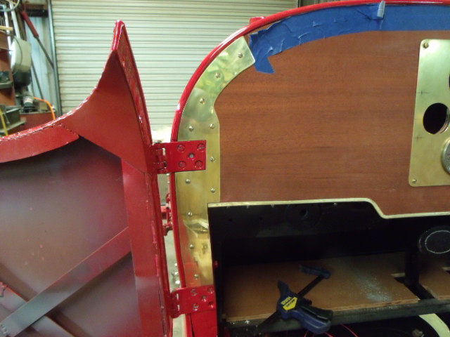

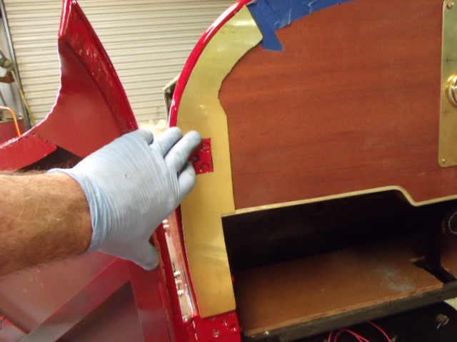

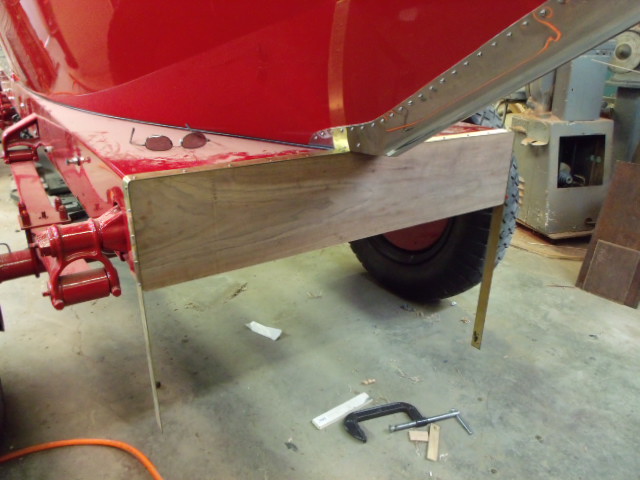

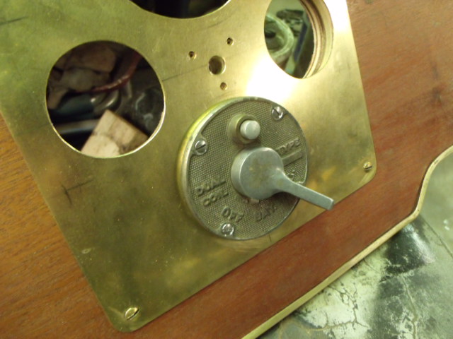

    More br***

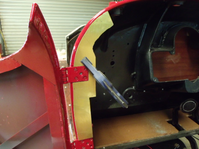

    I started making this piece while the Tesla plate was cooking. Today I finished it. Tkaes a lot of time to scribe and file and sand and fit and check and repeat ad infinitum. Then sand again, buff and polish, drill and mount, knowing you've got to take it off and on about five or six more times. Ah, but that's the fun! Can't make the other side until I mount the door. I got some little stuff done too. screw in the brake handle, some electrical connectors in the firewall, messing around with the deck planks, piping for the gas filler--things like that.
    Jerry
  13. 64 DODGE 440
    Joined: Sep 2, 2006
    Posts: 4,434
    64 DODGE 440
    from so cal
    The br*** looks good with the wood and the red paint!

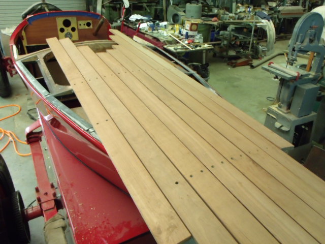

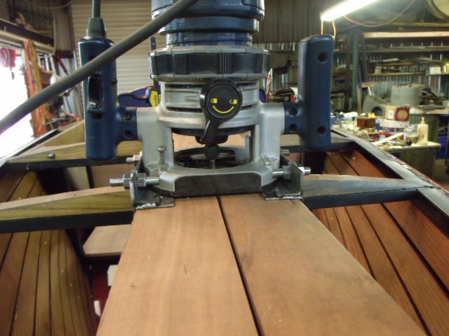

    My propensity

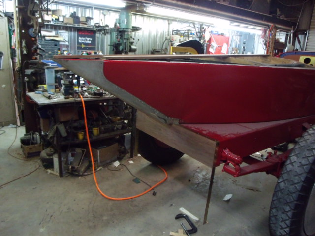

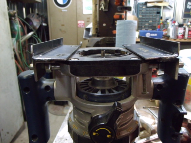

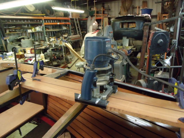

    I gave in to my inclination and jumped to another part of the speedster--the deck. It's been tugging at me for some time. I think my subconscious needs time to work out problems with other parts of the vehicle so I begin a new section while this occurs. The deck is curved and I'm going to insert white wood (maple or something) battens between the cherry planks. To do this I reasoned the gap between the planks must be perfectly parallel. Of course, to accomplish this I need a jig--something to hold the router straight while it cuts the slot. I whipped up such a device this morning. Playing around with the planks made me realize the deck beams were not quite true. I'll take that up tomorrow. I also went to the store and bought some India ink for the Tesla plate. I gave it three coats. What I found out was that the acid left the aluminum quite rough. Paint might have covered the roughness but the ink, being thin, let it all show through. Still, I've had enough of Tesla and his plate so I'm chalking up any roughness to experience and patina. I doubt if anyone will scrutinize the plate too much. Tomorow I'll try and pull off the vinyl. Maybe I should give it a coat of shellac.
    Jerry
  15. Jack Innes
    Joined: Nov 26, 2010
    Posts: 178
    Jack Innes
    Jerry,
    Are you familiar with the deck joint treatment on Mahogany boats. The joints are opened up with a router just as you are doing (usually a V joint) but then they are filled with, originally white lead, but now with a Sikkens product made for the job. This gives those off-white to yellow stripes that look so good. The lead or Sikkens material starts out white & yellows once you apply the varnish. Functionally the stripes are an expansion joint so the wood can move as humidity changes. The modern product flexes much better that the lead. I used to have a stable of wooden boats & have been involved with this process more than once. The definition of a boat is very true; " Boat: noun, A hole in the water into which one throws money."
    Jack

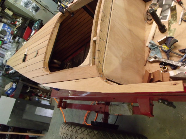

    yonahrr

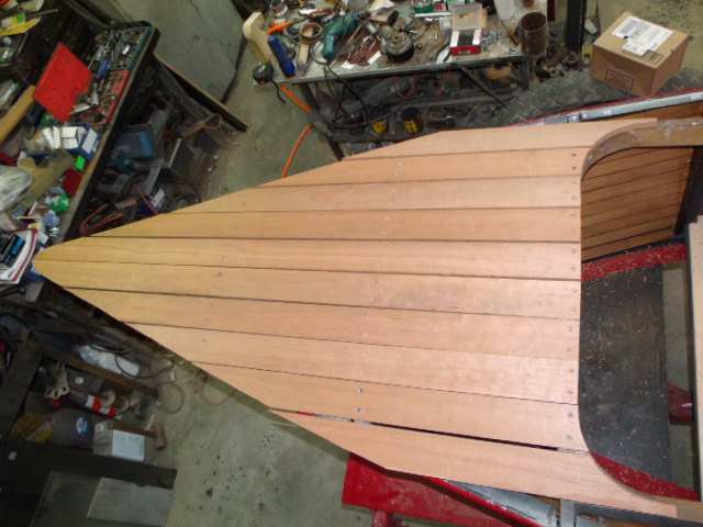

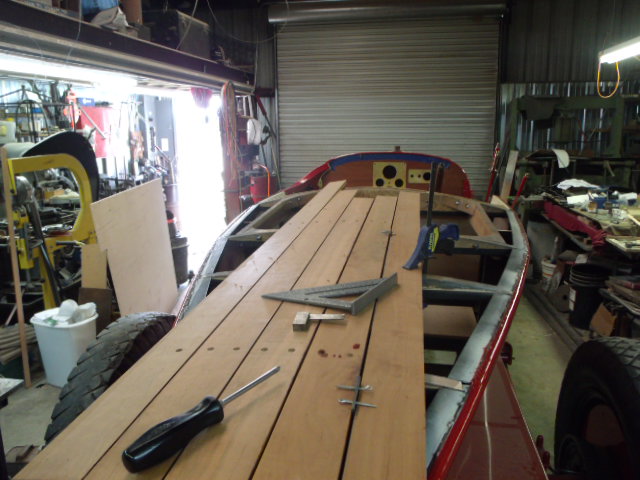

    All hands on deck!

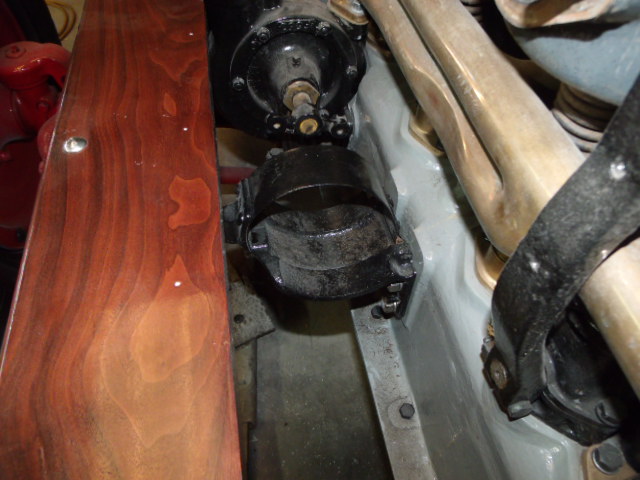

    I started screwing down the deck. The cherry I got from Don had a lot of flaws in it so I had to juggle it around. After I had it fastened in place I marked the perimeter then took it off and trimmed it up. Tomorrow it's back to Don's for some more wood. I also painted the muffler. I originally bought some fancy POR-15 Black Velvet header paint but I got to thinking that when it gets scuffed up I'll have to find some more fancy POR-15 Black Velvet header paint to match it. With that in mind I painted the muffler with easy to find cheap Rustoleum BBQ paint. Mistake? I also got a 4 fuse br*** block from O-Reilly and installed that. And mounted the generator bracket. Lastly I installed my ebay br*** ignition switch and weird choke pull then played around with some arty designs. The screws are getting in my way. Choice: Incorporate the screws in the design or work around them. That's it. Tomorrow morning Alex and I are off to the Flea market at the Atlanta Dragway hoping to find something really nifty.

  24. oilslinger53
    Joined: Apr 17, 2007
    Posts: 2,500
    oilslinger53
    from covina CA
    ***YOU*** sir, are the type of builder I aspire to be... To take a few pieces of ancient fire truck and turn them into something as awesome as this is inspirational to folks like me who are just trying to get their old Chevy back on the road...
    Seeing things like this get me to kick my *** back into gear when I slow down. I can look at pictures of finished cars all day, and it kind of discourages me, but seeing step by step build threads like this make me realize that my build is easy-breezy.
    Keep up the good work, looking forward to the updates!

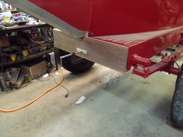

    When over to Don's and bribed him with breakfast at Huddlehouse for some more cherry. Then we went looking for some wood for molding. Up on top of one of his pallet racks he had some 1/4 inch mahogany left over from when he made stripper canoes. It'll be perfect for the molding between deck and body. When I got back to the shop I cut Don's cherry into the side pieces. Hey, it's starting to look like something!
