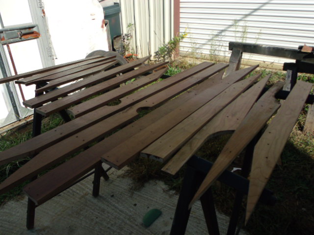

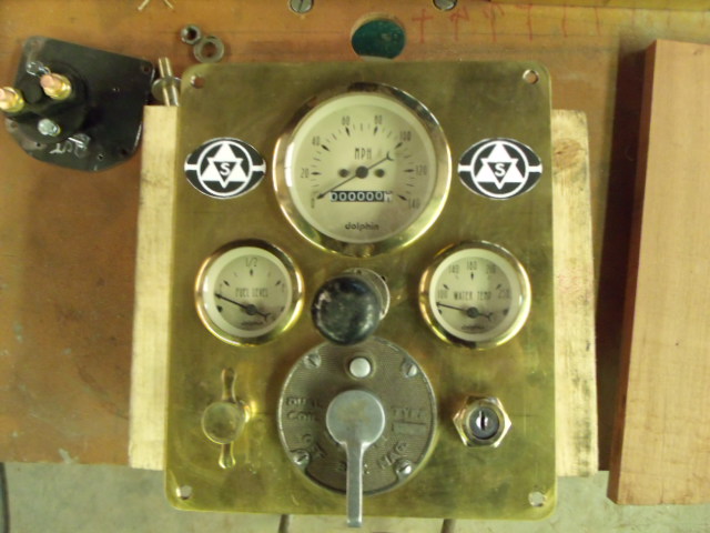

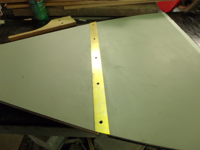

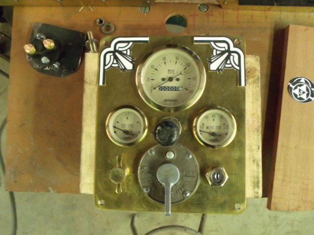

    Had a fairly productive day. I shellacked the back side of the deck planks. Then I made the last piece to cover the spine of the speedster body. Then I worked on the last most floorboard. Took most of the day to fit it in. Piddled around with etching designs for the instrument panel. The S is the original Seagrave logo. The other is just something I found. The designs would be connected with smaller versions at the bottom. I've been looking for something art deco but I have to incorporate the panel's mounting screws. Not easy. Got home to find my 12 foot .5" half oval br*** strips but the company rolled them up. Nice! I'm going to have fun unrolling them straight. Any suggestions?

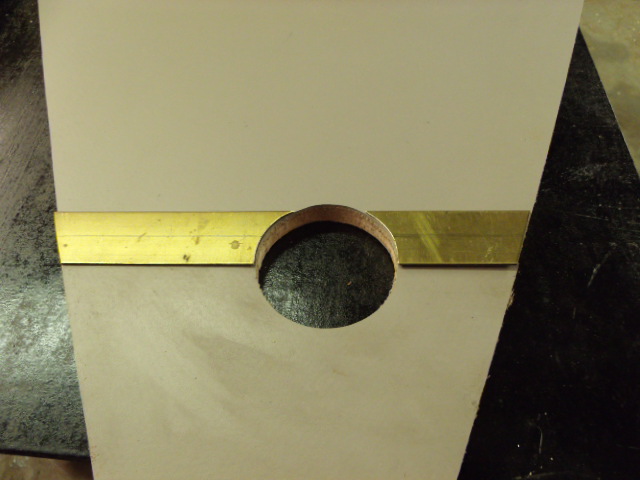

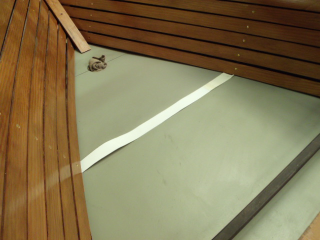

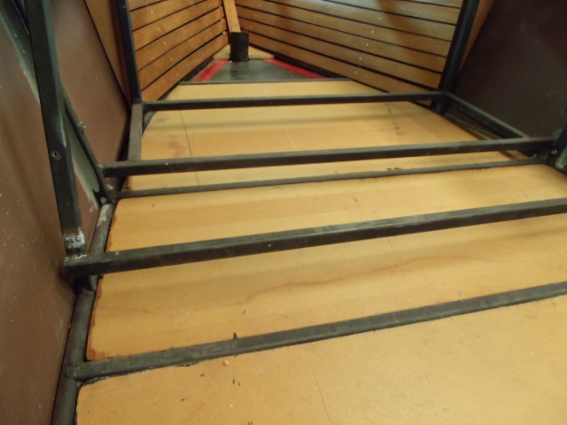

    More floorboards.
    No school today so I couldn't work too much. My goal was to get the br*** finished on the floorboards which I did--mostly. Then I hurried home to make sure the kids weren't destroying the house. That's it. No stories today. You're probably tired of them anyway. :)

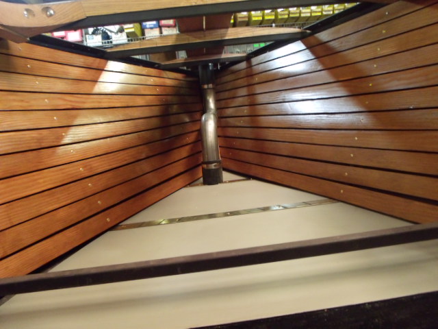

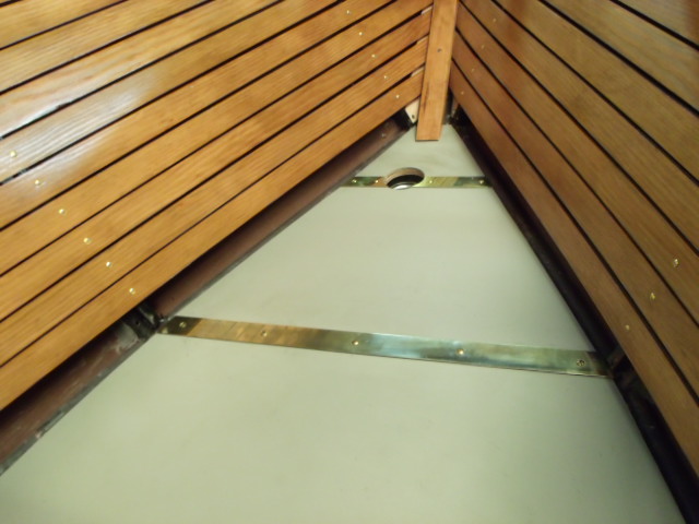

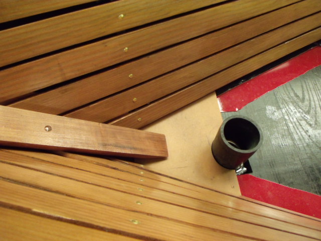

    All hands below deck.

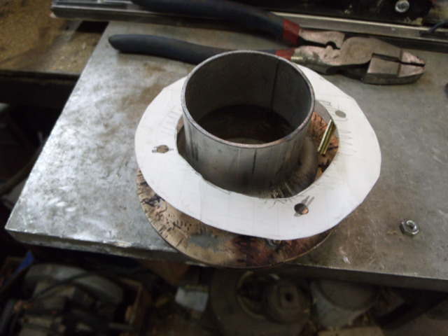

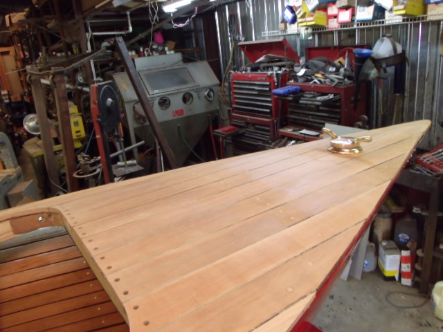

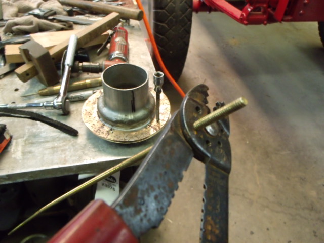

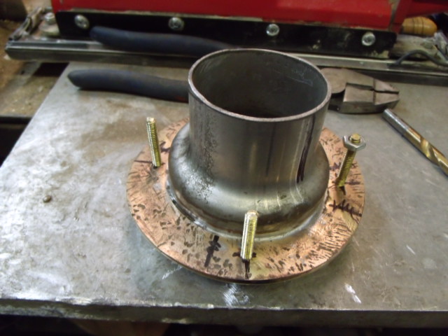

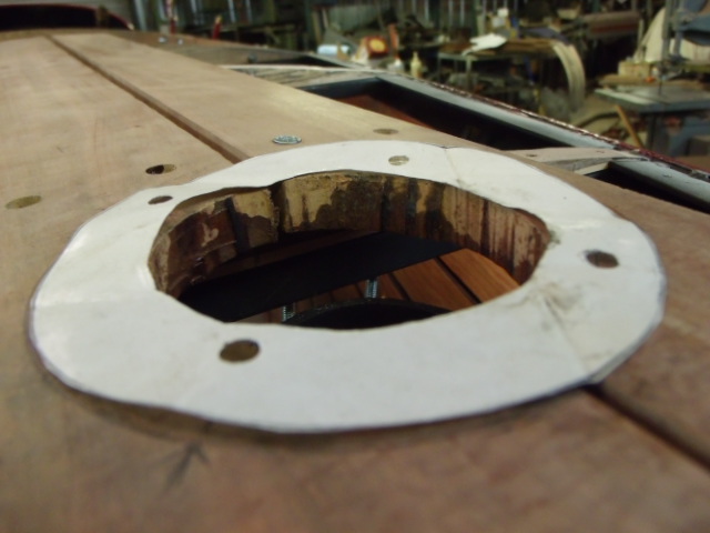

    I'm trying to get all the stuff done below deck so once the deck goes on for good I don't have to crawl down in there. Of course you know I'll have to crawl down in there anyway, but maybe a few less times. So as of yesterday the floorboards are done! I should be ready to screw--the deck on that is. I also put some br*** studs on the gas filler. Crimping piers are the best way to cut small screws. Then I made a template to locate the stud holes and make a gasket. Cork would be traditional. Something modern might be better. I think I'll cover the filler pipe with some black leather I've got laying around. As I sand the humps off the planks I'll be thinking of how to finish the edge at the stainless tailpiece.

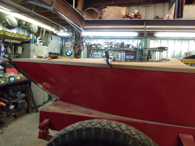

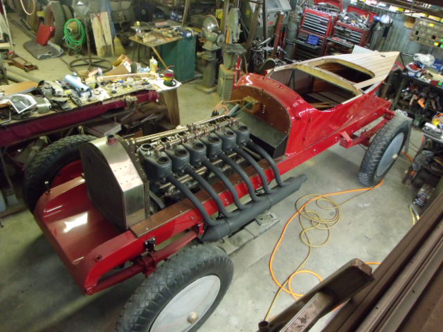

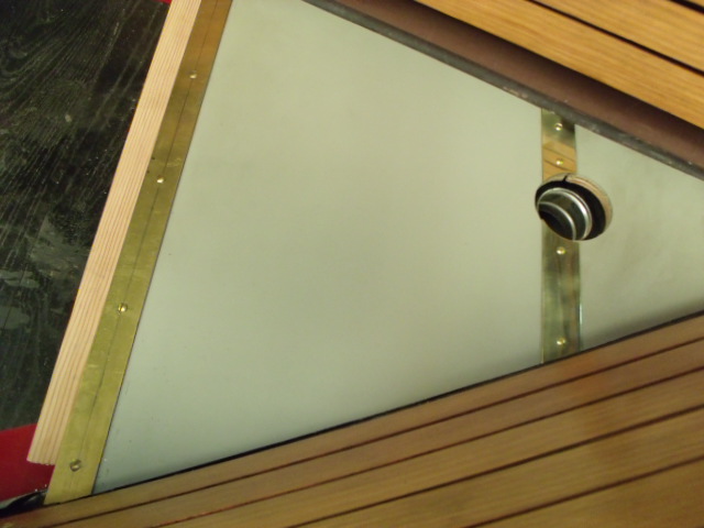

    What the Deck?!
    Started screwing down the deck for the last time. Got most of the big pieces on. Just before leaving I climbed up on the mezzanine (That's a word I use to impress ya'll for a storage shelf where I throw a lot of old stuff. Hey, I found an Atari 5200 up there.) and took a few pictures. It was late and the light was low so they're not that great. Kind a neat non-the-less.
    Jerry

    Wow, it looks damn good from you mezzanine sir. Amazing how it all just comes together. I was always indifferent on the front apron, but seeing it from this angle, I love it. GO GO GO!

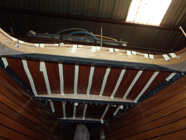

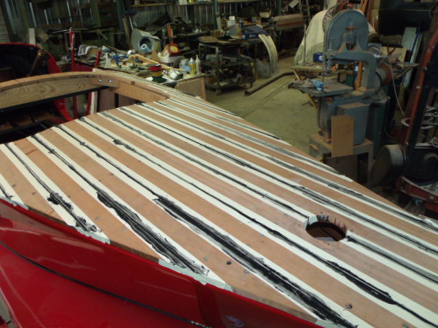

    Caulk to me.

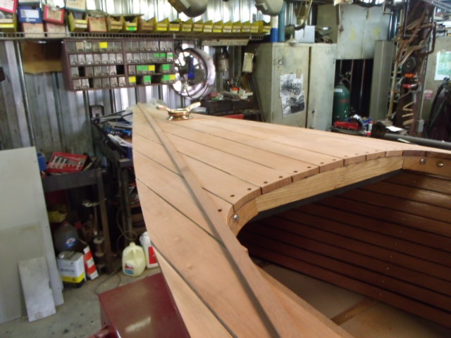

    Had to scrunch down into the boattail, lay on my back and run tape under the deck seams. Kind of weird. Staring up at the planks I felt like I was a Charlton Heston playing a galley slave in Ben Hur. After the big battle scene he had the greatest ironic line of any movie ever made. Ten points if you know what it is. I'm covering the seams with br*** oval but they still need to be waterproof. I hope the goop is dry by tomorrow so I can start sanding.
    Jerry

    I'll let you watch the movie to reveal the great irony of that statement. No pics today. Just sanded on the deck for an hour or so then spent the rest of the day making a handrail for my front steps. Mom's coming to visit from South Florida and we don't want her falling. She's 89. Tomorrow I glue in plugs. That should be very exciting.

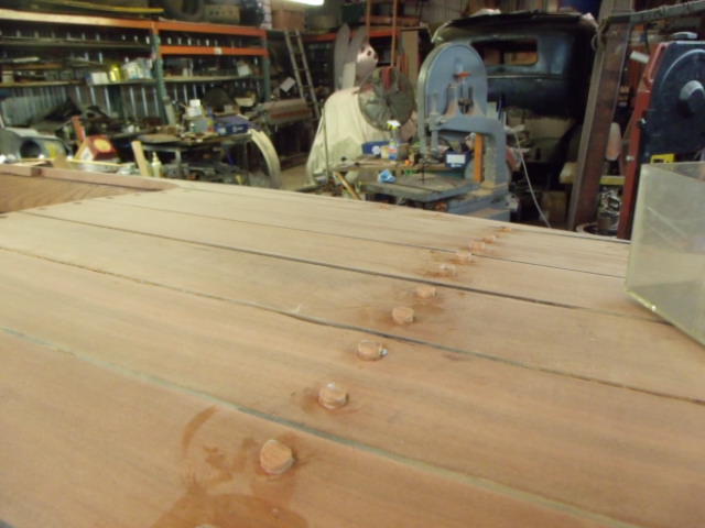

    Plugs!
    Drilled out plugs for 20 minutes then glued and hammered. While they were drying I cut and fitted another handrail for Mom. By the time I got it tacked together the glue was pretty dry so I started chiseling off top of the plugs. I had time to sand a few of them before I had to pick up the kids at school. Tomorrow it's off to Don's to pick up the mahogany molding and two sacks of concrete. "We keep you alive to read this thread!"
    Jerry

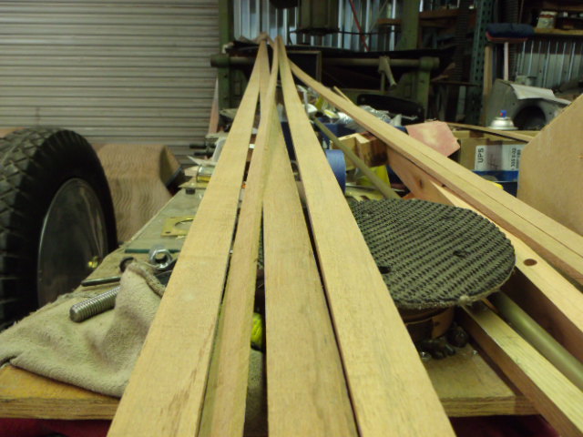

    I got wrapped up in handrails and left my camera at the shop. I had some nifty pictures too. Well the handrails are done and in the ground so hopefully that won't happen again. In between I worked on the side molding by t******* the deck here and there. Then I set up the router table to round off the molding. I promise pictures on Monday.

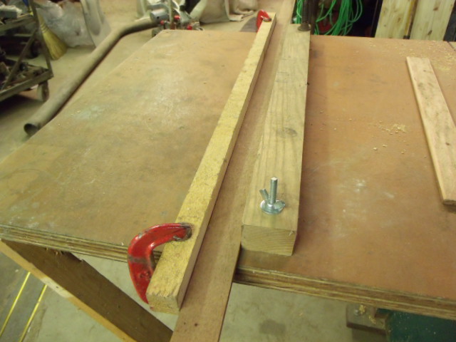

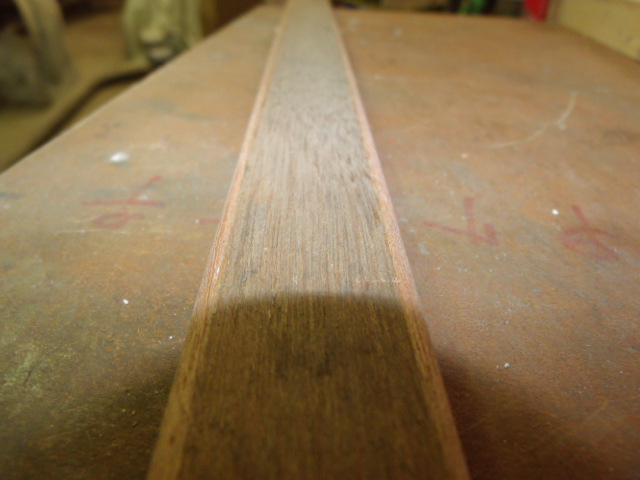

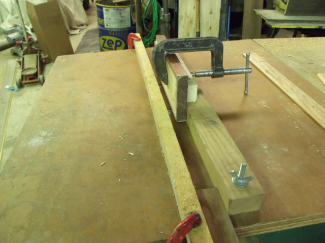

    Recap

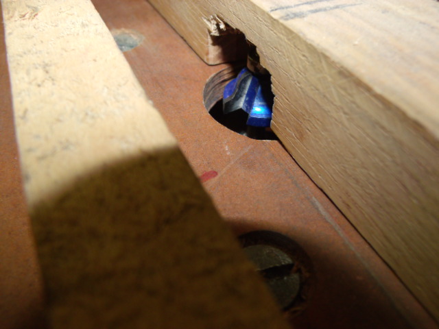

    I got all the plugs sanded off and I went over to Don's and he cut the mahogany for my side trim. Then I set up my homemade router table and ran the trim through it to round the edges. I didn't have a small enough bit for 1/4 inch so I used some kind of ogee bit. What is an ogee? It worked good. You've always got to think ahead when you're doing this stuff so I figured I'd batter make my end piece first. That'll be the next entry.

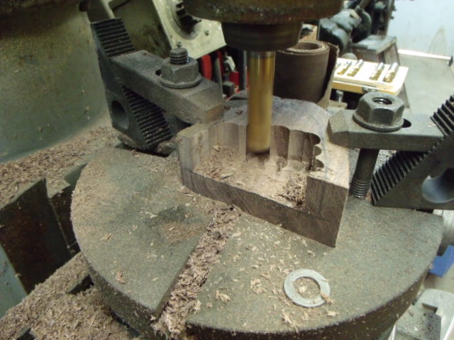

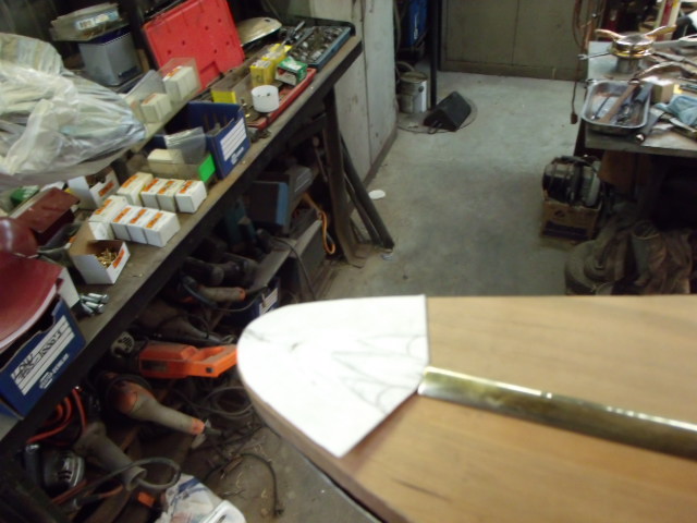

    Endcap

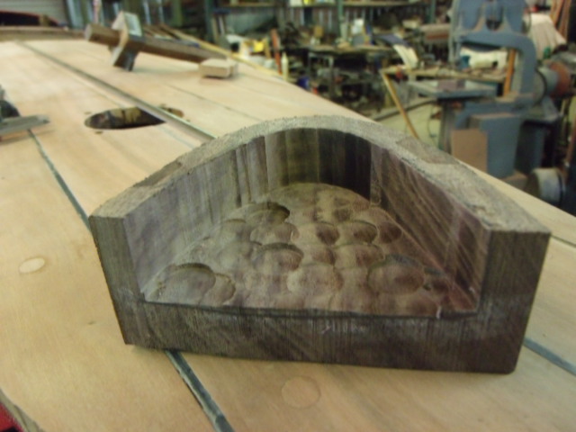

    Hey, this is becoming a woodworking seminar and I'm the wrong guy to teach it. Not being much of a woodcarver I used the milling machine to hog out the wood I didn't need. You can see as far as I got before I to pick up kids at school. I was thinking a duck decoy would look good on the end or maybe one of the things on a gondola. I could get a gondolier hat and a pole.
