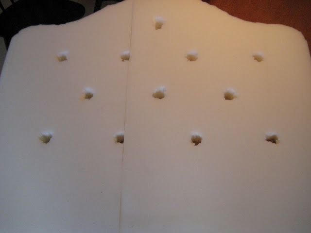

    Jerry,
    Here's a photo and some instructions I cut fro m a web posting I saved recently. This project was a headboard but it's the 'same dif'. It seems one should make the ****on holes a little bigger than ****ons and yes, cotton batting is a must.
    The following text is cut from the photo caption:
    The next step is to cut out the holes, cutting a hole slightly bigger than your ****ons. I used an Exacto knife and scissors to cut out the hole, but you could use copper tubing that is beveled to give a sharp cutting edge. This part was time consuming as I wanted to shape the hole as carefully as I could. If it isn't a perfect circle it doesn't matter, it will get "filled" in with your covering and batting.Once the foam is shaped and ****on holes cut out, lay your batting over the top. You will want to use a hi-loft batting (a nice thick one, or you could double up) that is cut at least 12" bigger all around than your headboard. This is important as you will use up batting and fabric while tufting and will want to be left with some on the edges to wrap under.
    Jimmy
  2. JIMSPSYCLESHOP
    Joined: Mar 26, 2012
    Posts: 56
    JIMSPSYCLESHOP
    Sorry, I didn't enlarge you photos before I sent that 1st message. Looks like you holes might be large enough already. Jimmy

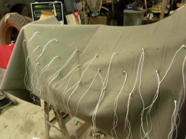

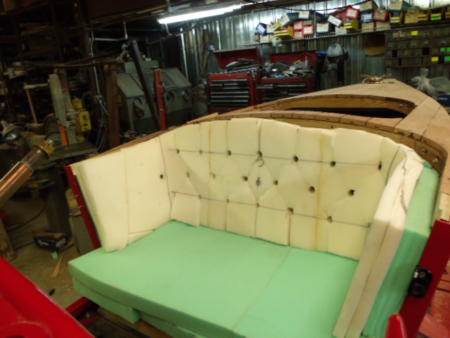

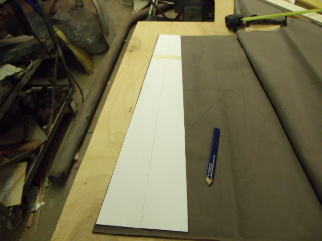

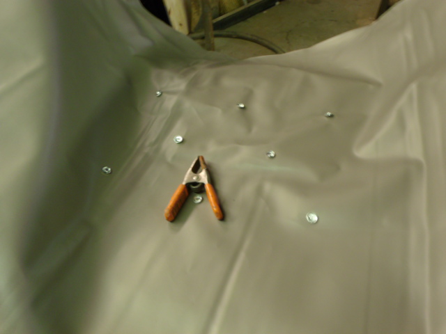

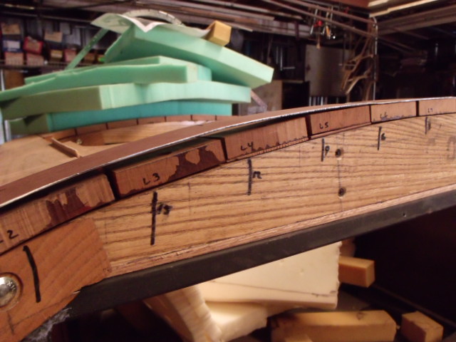

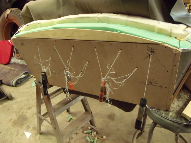

    Worked on the upholstery again by adding another inch of foam. Would you believe it still had wrinkles--although not as bad. I stuffed some batting up under the vinyl but it was apparent that was a bad solution. According to my plan I was to make the diamond on the vinyl 4cm bigger than the diamond on the foam. That was not working. By days end I cut that down to 2cm bigger but I didn't have time to pull the ****ons tight. I suppose skilled upholsterers don't mark anything and just stick the needle in where they feel the next ****on ought to go. I may try that if this new plan doesn't work. I just took one picture--of my new perforated vinyl. The rest was same old, same old.
    Jerry

  10. some of the loose ness mess will pull tight when the top and bottom edge are pulled ....you should be fine with some soft batting and maybe a cut or slit at each hole in the foam an inch or so out in the diamond pattern for the fold to fall into and bigger ****ons good luck

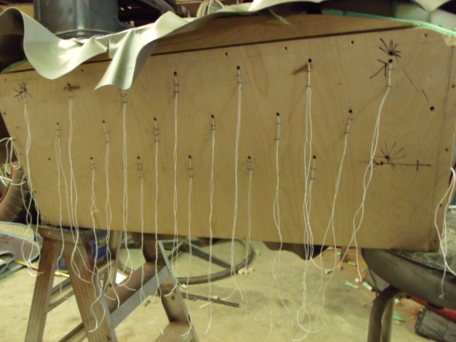

    I also expanded my theories on ****on tufting today. Always use a stretchable medium. The vinyl I'm using is a little too stiff. I have to pull it so tight the foam is reduced to half its thickness. Not good. The pre-measured hole punching trick will only work if you seat is dead flat. Tomorrow I'm going to try ****on tufting on the fly like the pros. I'm also using a slightly stretchier vinyl. What does all this mean when I get down to the leather? I have no idea. I'm still in the information gathering phase.

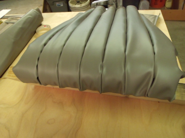

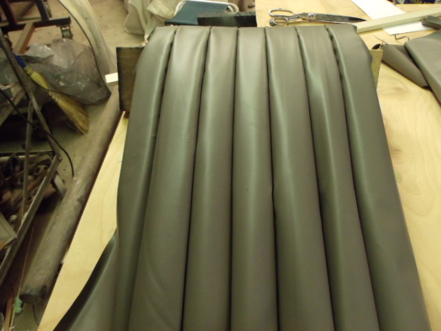

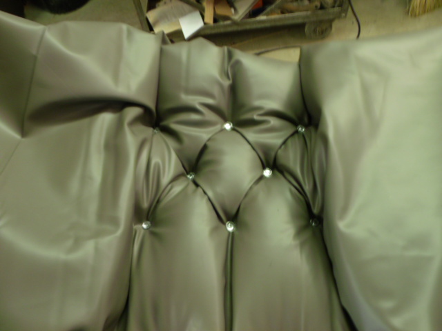

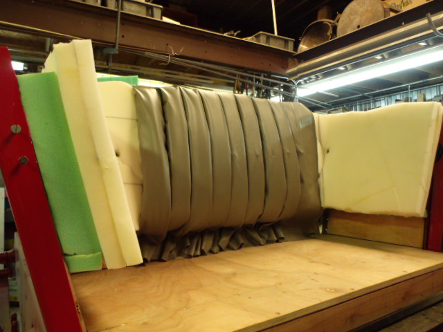

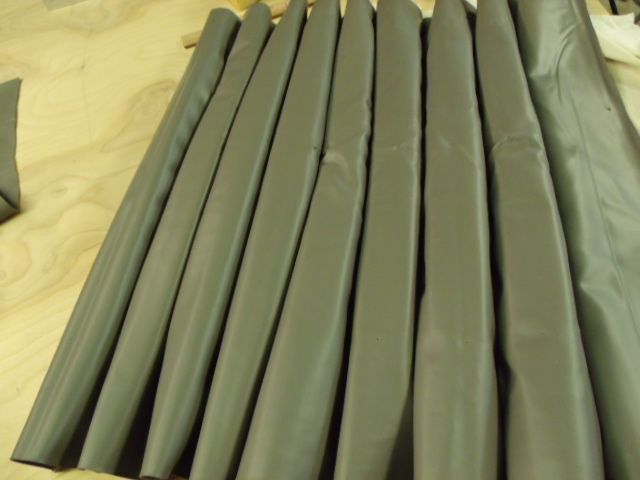

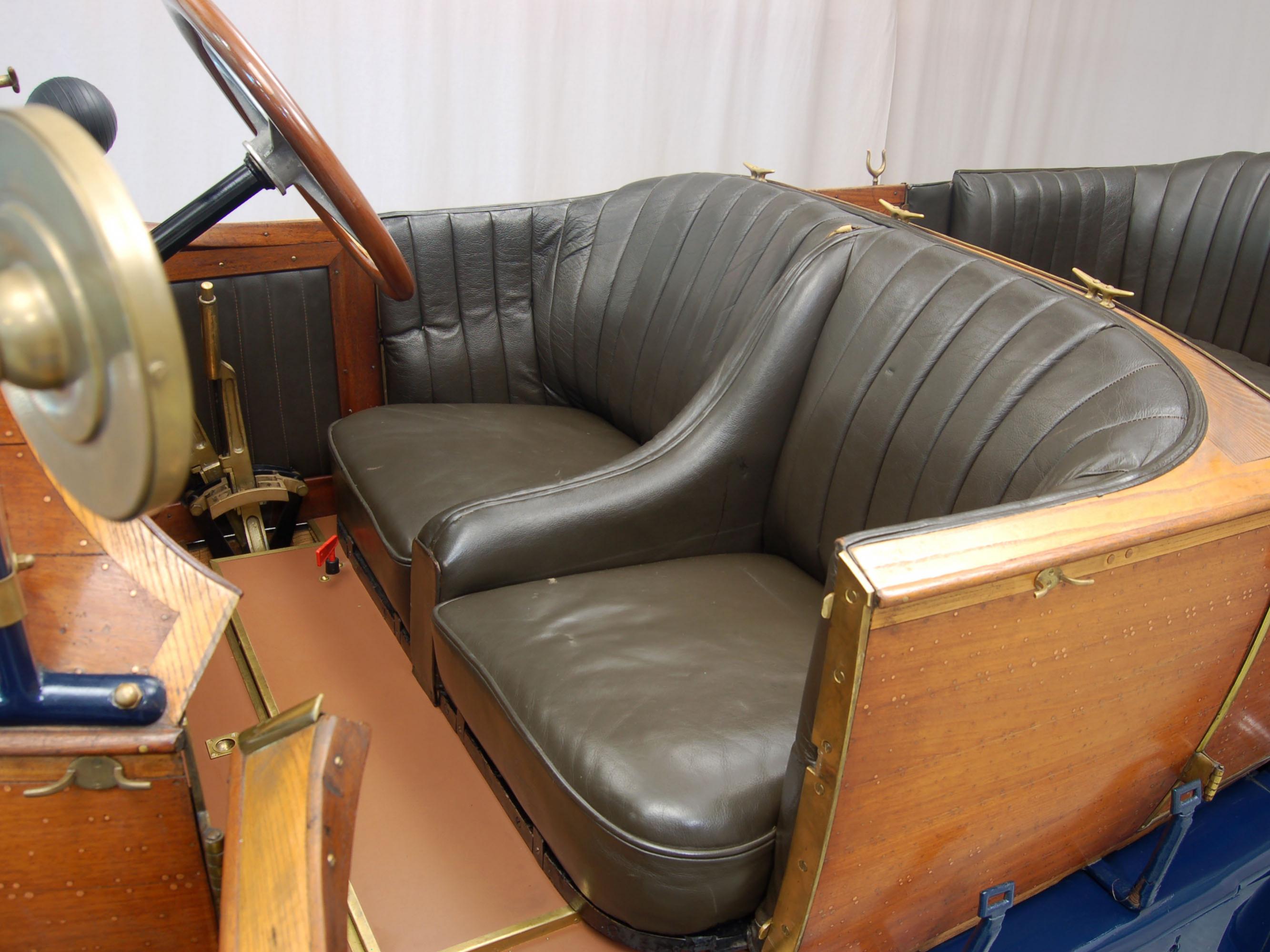

    I'm not happy with the diamonds. The ****on tufting ain't right. I did a little free hand work today and it looked okay but I still have to pull the ****ons so tight that the foam is compressed to half its thickness. So I started experimenting. I'm now going after something like you see in the first picture but without the par***ion. First I made up some 2"X2" pleats which looked mostly like **** but not completely. I realized the top needed to be tapered to lie flat. The sections have .5 borders, are 2" on the top and 6" on the bottom. This way at the top the sections will lie flat. In the corners I make the tops wider. I only had time to make up three sections but I think I'm on to something. More experiments tomorrow.
    Jerry
  20. BuiltFerComfort
    Joined: Jan 24, 2007
    Posts: 1,619
    BuiltFerComfort
    I bet that ribbed method will be much easier and more comfortable too.

    looks like you are onto something good. Consider the vertical pleats with ****ons like Henry did on the model T.

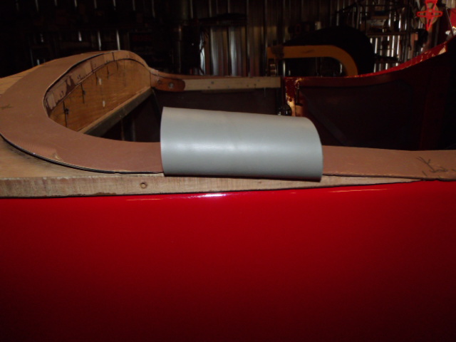

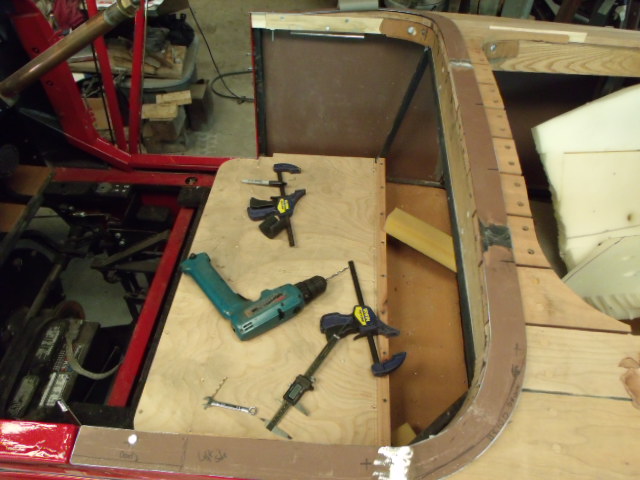

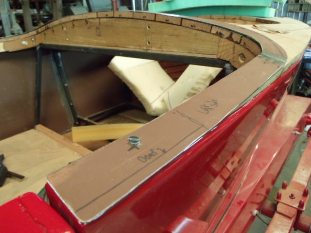

    But foam feels so much nicer. I learned a lot from my consult with a real upholsterer. For one thing the upholstery needs to start at the bottom and finish at the top. That means there needs to be a relief in the deck for a triple thickness of leather to be stapled into. Also to put a roll of leather around the ****pit and on the door tops and dash I need a way to fasten said roll to the deck. So that's where I'm concentrating now--on the roll and the relief. I made up a strip of thick metal to go around the back of the ****pit. I'll weld some studs on it that will go down through the deck. The roll will glue to this and when installed will hide the staples and relief. Ta-Da!! While I'm at it I'll make up the metal strips for the top of the doors too.
    Jerry
