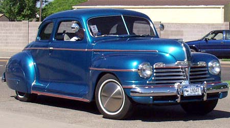

    here's a side shot of 1 i found on carnut, only because for the life of me i could'nt remember what they looked like (i'm gettin old). they are pretty good lookin' cars stock or custom! great story and good luck with yours.
