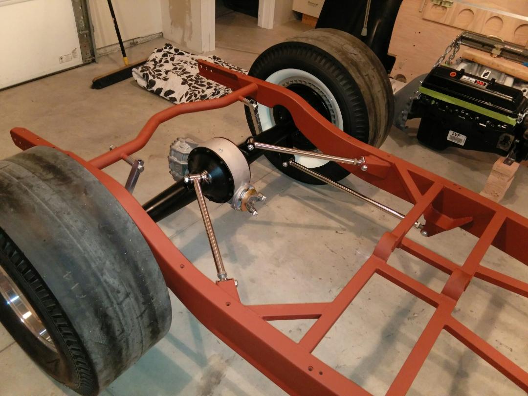

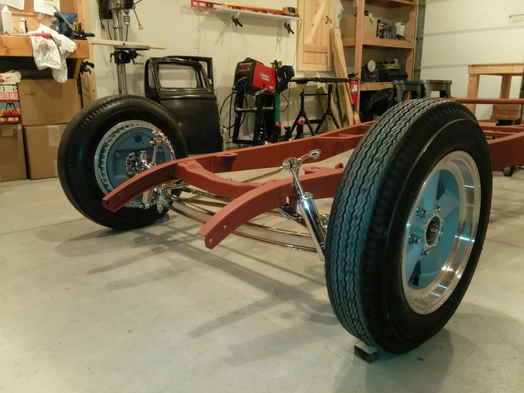

    Well it's been awhile, took the last week off, my wife went to Florida to visit her mom, MY TIME. Started with the frame fully welded and went from there. Had a ball, just me and our pup Daisy.
  4. Splitbudaba
    Joined: Dec 30, 2014
    Posts: 1,025
    Splitbudaba

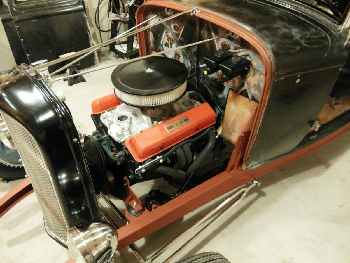

    A few days later I installed the motor/bellhousing/trans and then the body. Starting to get some idea of what the final product will look like. So far so good. Time to finish the trunk and doors, trying to make a convenient package to store for awhile! Had my little helper all the while. IMG_2680.JPG IMG_2677.JPG IMG_2683.JPG IMG_2682.JPG

    There should be a few more updates, and then it will stop. My wife and I are retiring to New Meadows, Idaho. Building a new house and starting a new life. The 32 will be sitting in storage for 6 to 12 months. So I am trying to ***emble it and prime the bare steel before rolling her into a storage garage. Not exactly what I wanted to do, but have little choice. Here are some pics I took this morning before work. IMG_20180216_060211_burst_01 (002).jpg IMG_20180216_060232 (002).jpg IMG_20180216_060221 (002).jpg

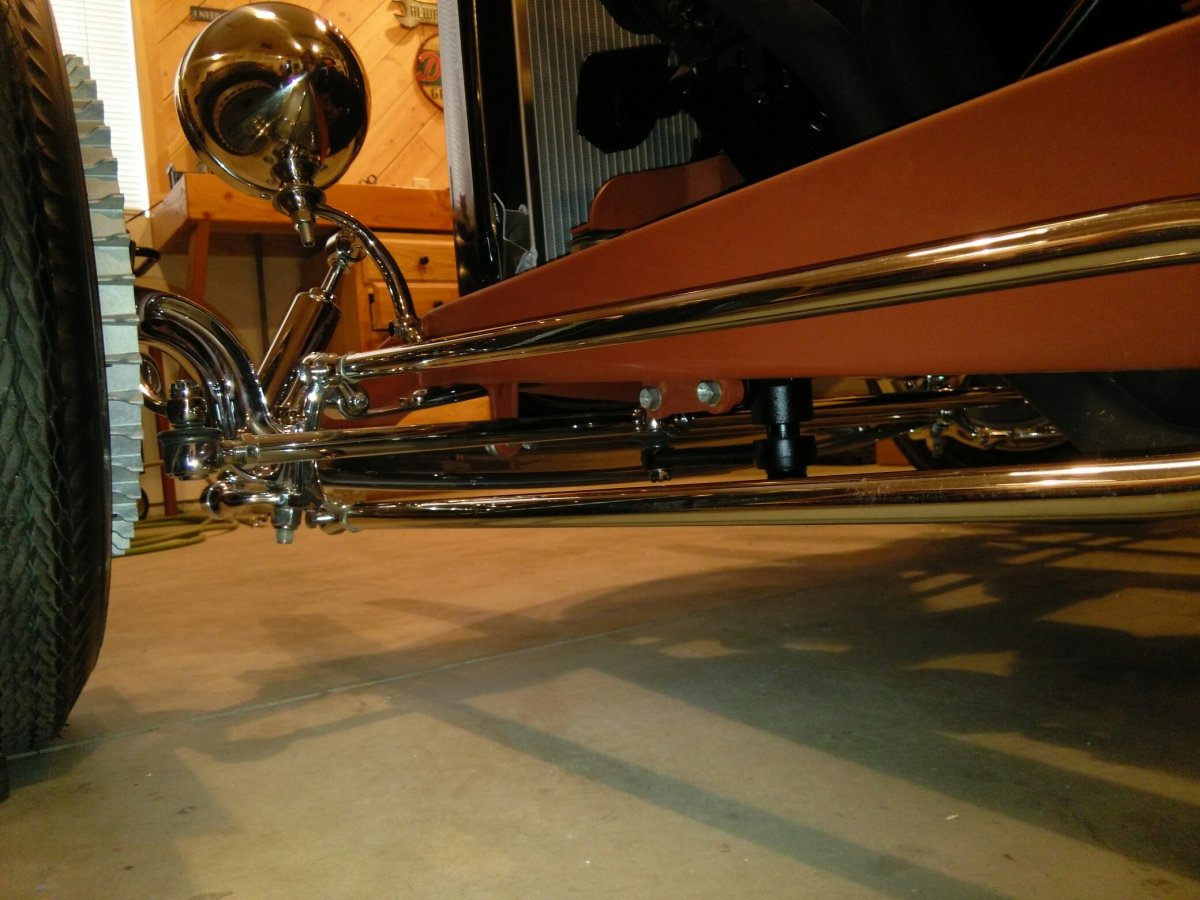

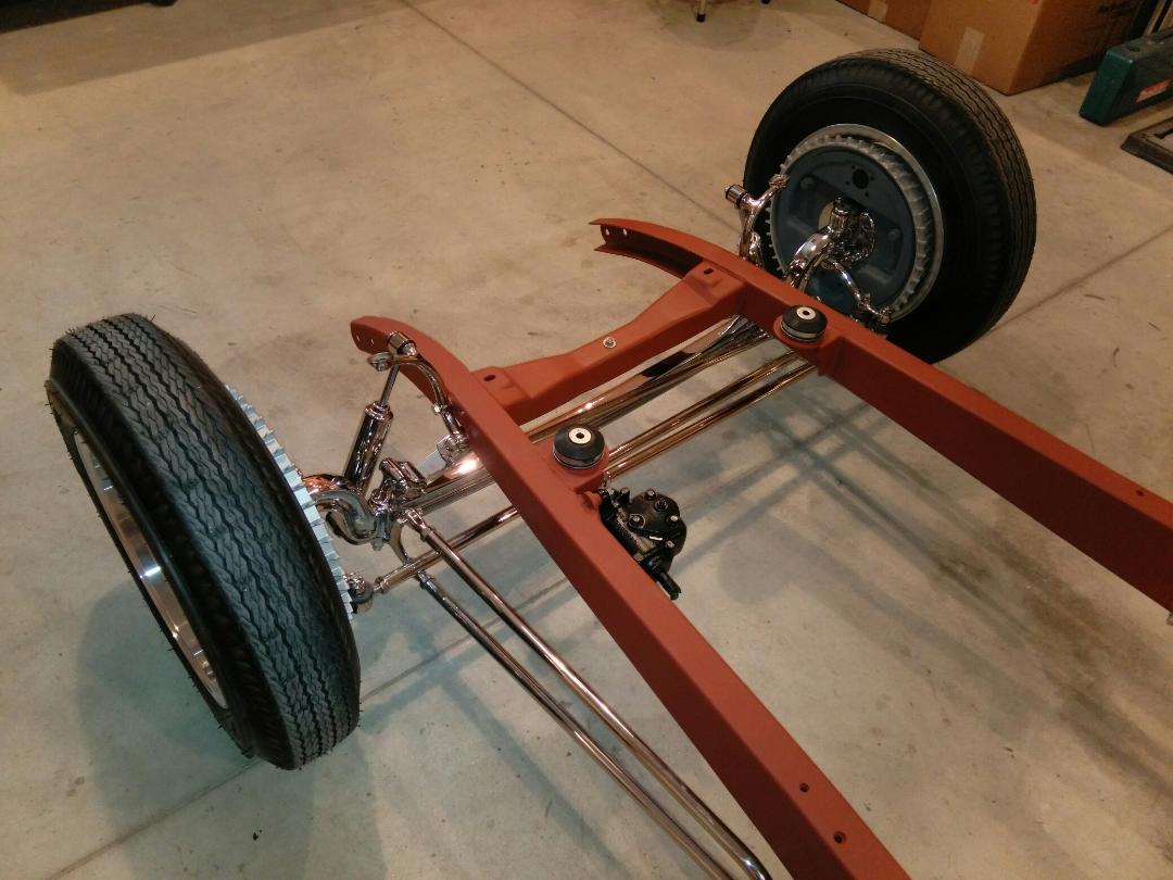

    I can't tell from the pics, but did you have to use a drop pitman arm on your vega box? Sorry to hear about the project going into hibernation, you have one hell of a great start.
  23. Splitbudaba
    Posts: 1,025
    Splitbudaba
    No on the drop pitman arm. The front suspension from So Cal has drop steering arms that mount to the spindle. Took a quick pic. Hope this helps.
  24. big duece
    Joined: Jul 28, 2008
    Posts: 7,220
    big duece
    from kansas
    Ok, thanks.I have the socal drop axle, but with stock '40 spindles and arms. So, I might need the pitman arm with the offset.

    You are correct, I think mine was the GT2 unit, made out of stainless.

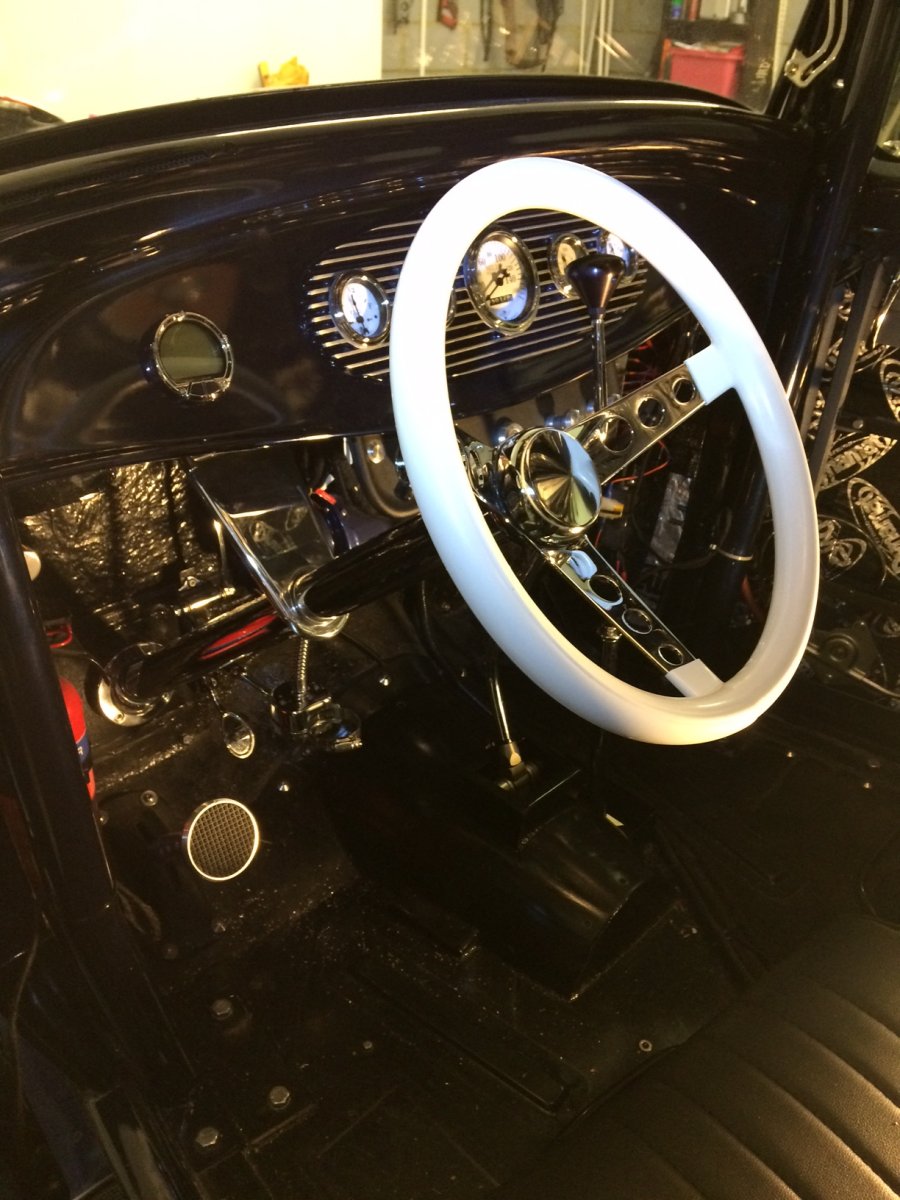

    I forgot how long ago since I posted this and it’s taken me longer than expected to carry out the tweaks.
    The first one was to change much of the steering as I wasn’t very confident with the double D shafts, had a bit of a scare when the steering went very sloppy on the way to a local show. Also the steering wheel was too far forward for me. I changed the UJs and shaft to splined got a longer steering column, column drop and deeper dish steering wheel

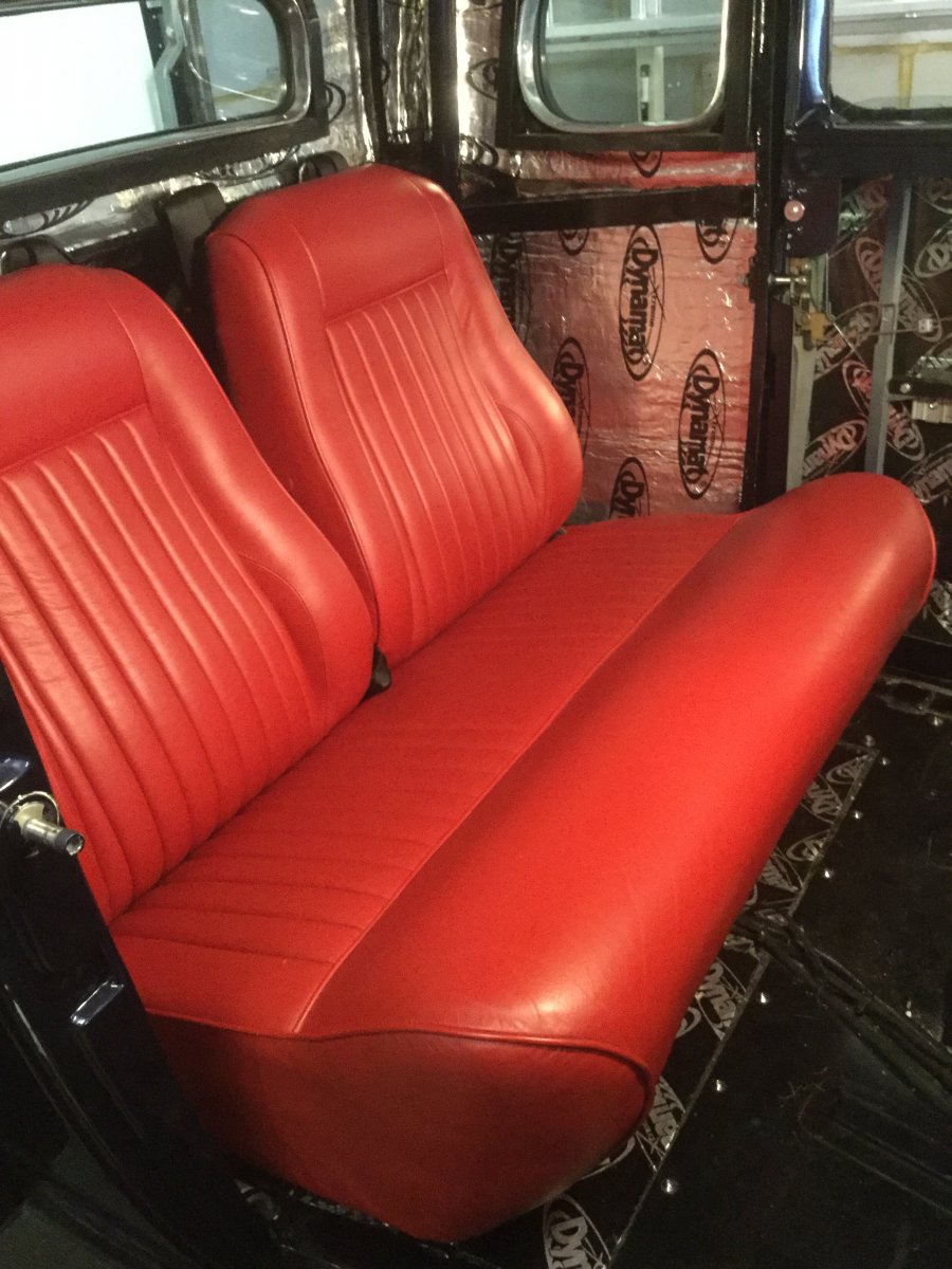

    It was, one of the retaining grub screws had sheared. The floor pan is mostly metal and very nicely done. It’s got a Ford 302 and C4 and I’m getting used to the steering wheel being on the wrong side :)

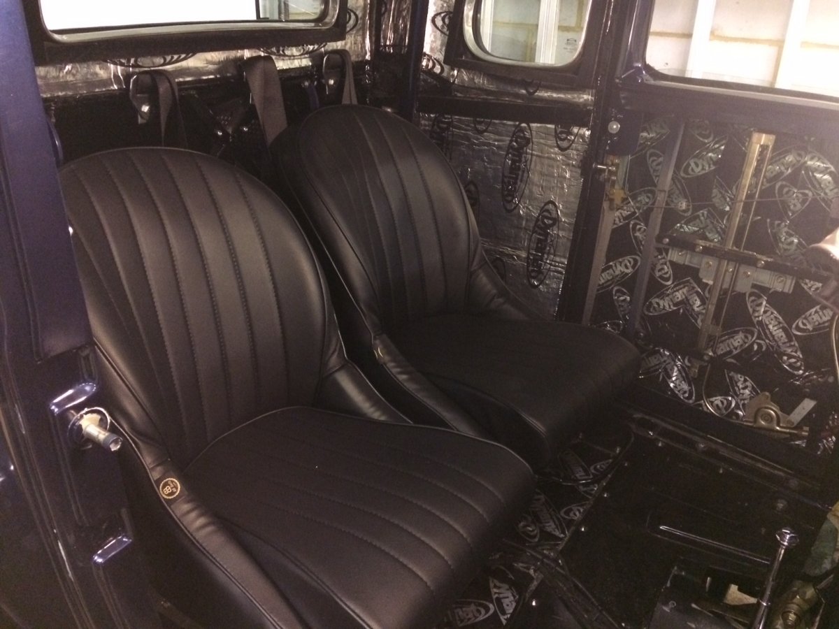

    The next job was to replace the seat, it had a Glide split back bench which was very comfy but I wasn’t very keen on the style. The main problem however was that it sat too high and my head touched the roll cage. I bought a pair of buckets cheap on eBay and it’s booked in to have the interior trimmed out end of June
    Here’s the old seat
    And the new buckets
  30. Splitbudaba
    Posts: 1,025
    Splitbudaba
    Those seats look perfect! Looks like they have a better **** position for those long cruises. Are they stationary or mounted on adjuster tracks? I read somewhere in the HAMB about skipping the roll bar, reason being the fact more guys get hurt banging their heads on the roll bar when hitting a bump. I'm 6'3" and I think I am omitting the roll bar for that reason. Does your roll bar have headrest pads?
