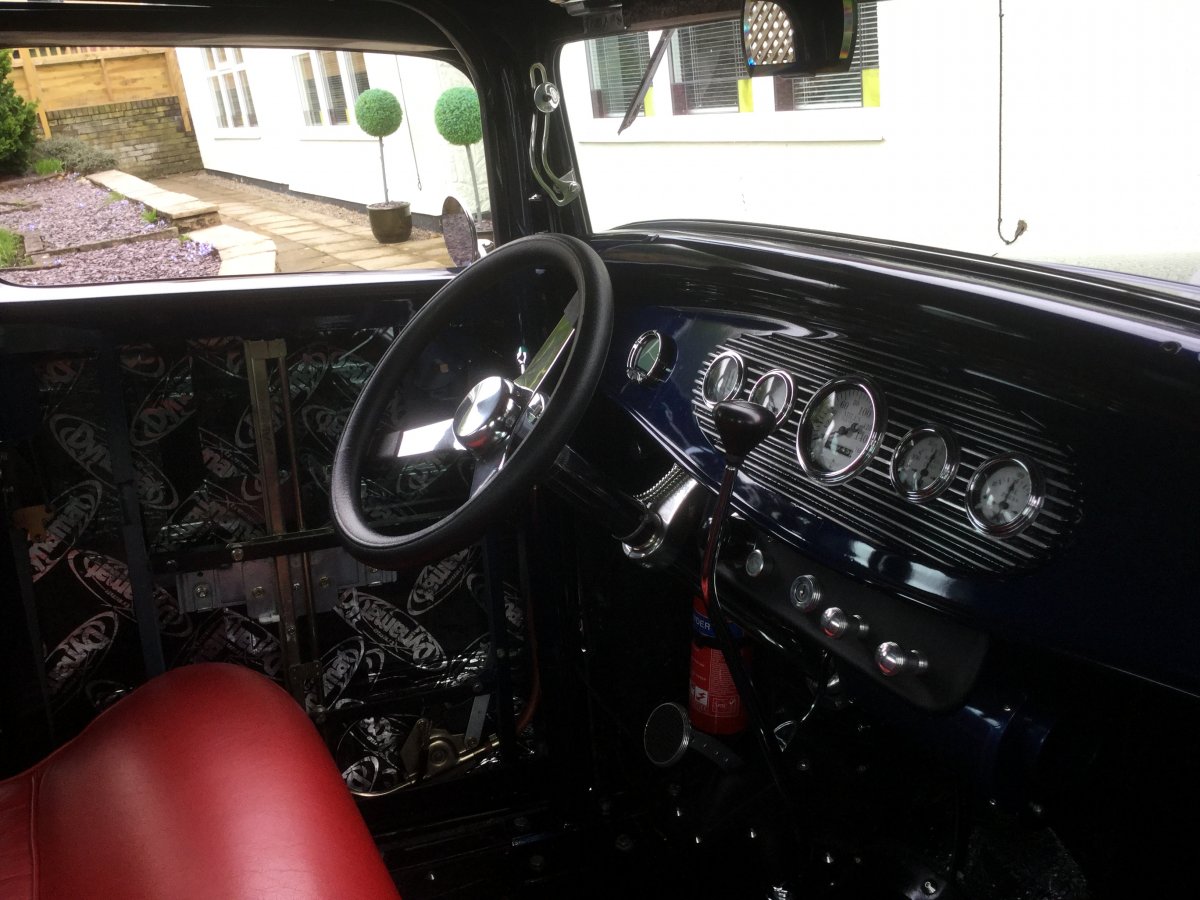

    Thanks, I’m very pleased with the seating position and steering wheel location now. They are on tracks but I like the seat as far back as possible as I like my legs stretched out when I’m driving. The only other tweak I need to make is to move the throttle peddle.
    It’s a 4 point roll cage and was installed very tight to the roof and sides to be as unobtrusive as possible and was a very nice job. The only problem was that it was too tight and the front posts were touching the doors which would prevent then from being trimmed. I did consider removing it. However, having been in a fairly major accident with my gl*** 3 window a couple years ago I decided to keep it and have it narrowed as I have experienced how little protection you get in a gl*** rod. It is currently in a workshop having this done together with the rear exhaust sections being modified so that I can lower the back end as it sat too high in my opinion. I’m hoping to get it back tomorrow.

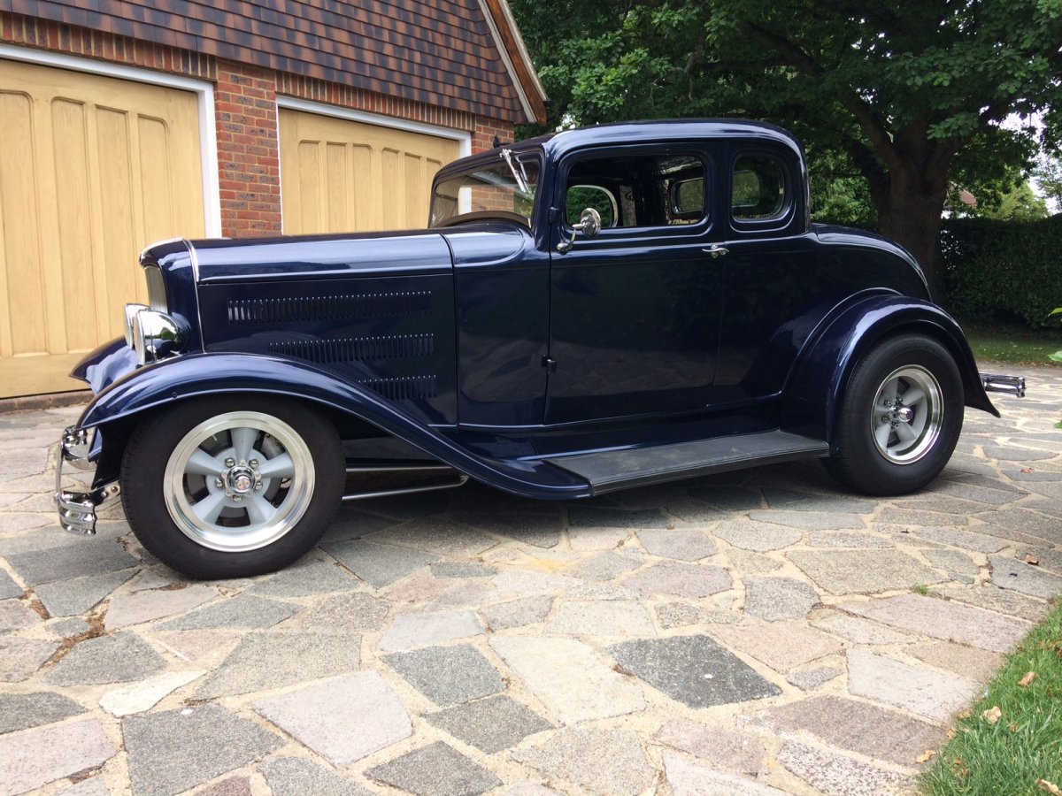

  12. daveh1932
    Joined: Apr 10, 2013
    Posts: 280
    daveh1932
    from UK

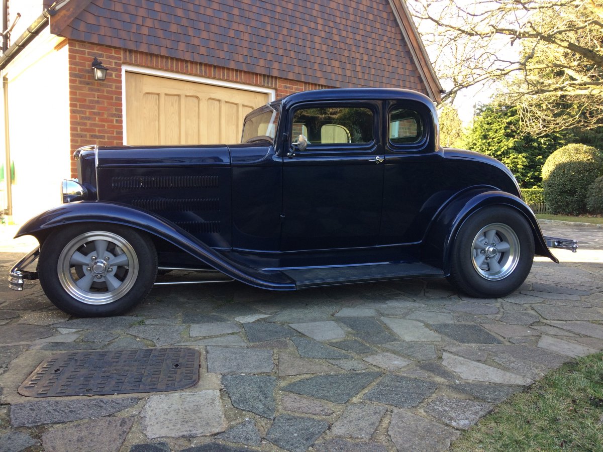

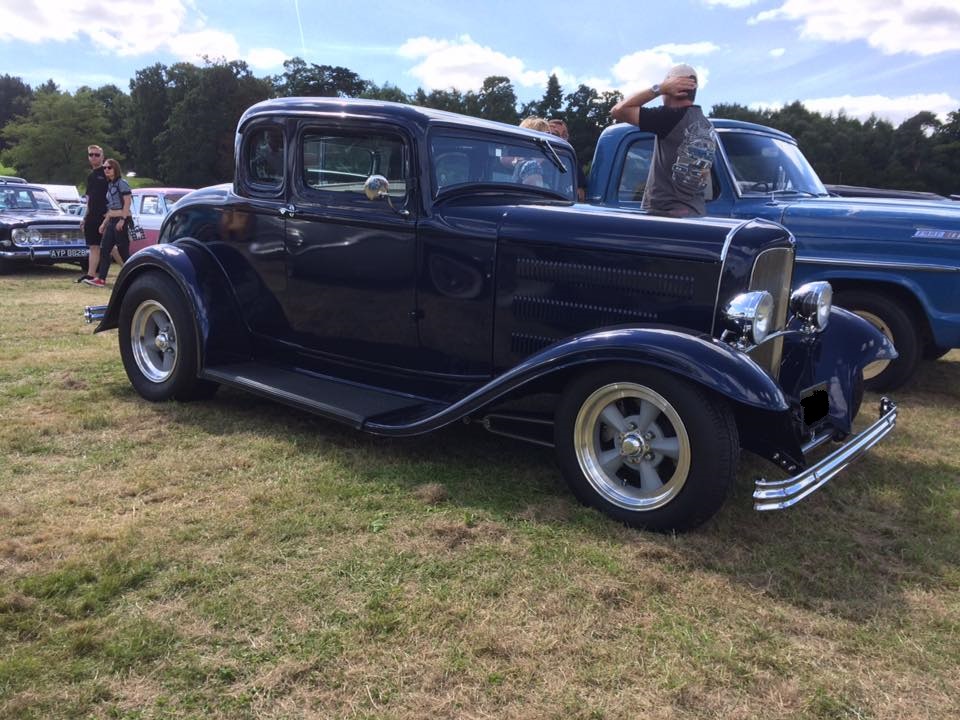

    i picked up the coup this morning and very pleased with the work carried out on it. It sits so much better now:
    here's before the work
    and after:
    I also checked the roll cage, it's 1 13/16th.
    I was thinking I needed bigger tyres on the rear but now the wheels are sitting snuggly in the arches I think they are just right. I want to eventually fit some red band tyres once all the other work is complete

    That sits just right! Changes the whole at***ude your car projects, bad ***!! Your running boards are almost parallel with the ground. Looks Great!! I've decided to build a rollbar to meet or exceed NHRA rules, in case I ever get lucky enough to have grandkids!! Thanks again for your help. Keep posting!

  15. DDDenny
    Posts: 23,425
    Spot on!
    Looked fine before, did you just lower the back, change springs?
    1&13/16" is an odd dimension for round tubing, closest common here is 1.750, did you actually use a caliper or eyeball it with a tape measure.
    Dumb question time, is your tubing commonly called out in inches or millimeters?
  16. loudbang
    Posts: 40,351
    At the new height do you get rubbing on the inside of the front fenders?
    chryslerfan55 and Splitbudaba like this.
  17. daveh1932
    Posts: 280
    daveh1932
    from UK
    The front wasn’t changed only the rear but no issues with tyre to fender clearance on full lock
  18. daveh1932
    Posts: 280
    daveh1932
    from UK
    Thanks, the coil overs were just relocated on to the lowest mount but I needed the exhaust modified as it was too close to the axle

    Thank you I’m very pleased with it. It’s amazing how one small change can make such a difference, I just couldn’t live with it the way it was

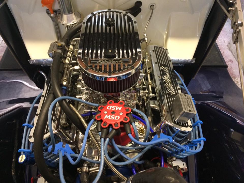

  21. daveh1932
    Posts: 280
    daveh1932
    from UK

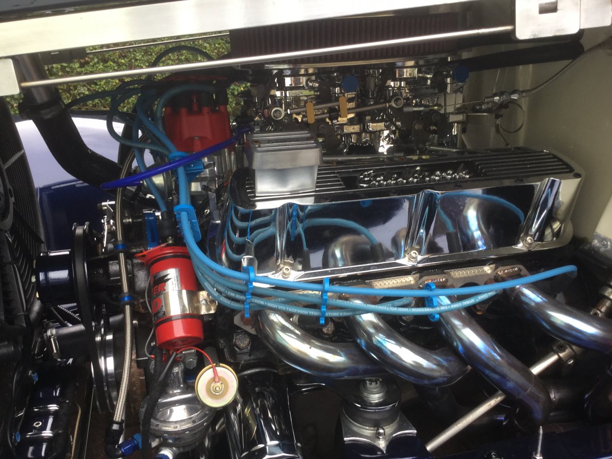

    I’m giving the engine a bit of a make over as I don’t like the dress up goodies on it at the moment. Going for a more traditional style, finned ally parts, parts have been ordered and will swap them out when I get them, hopefully next couple of weeks. In addition to the steering changes it’s currently got a Unisteer rack which I’m going to change out to a Borgeson Vega box. In the photo of the steering wheel you will see a digital tacho on the dash. The rest of the dash is very cool with SW wings gauges, I’m going to replace the existing tacho with a matching clock to fill the hole and get a column mount tacho cup and SW tacho, the interior, the list goes on but I’m enjoying turning in to the way I want it.

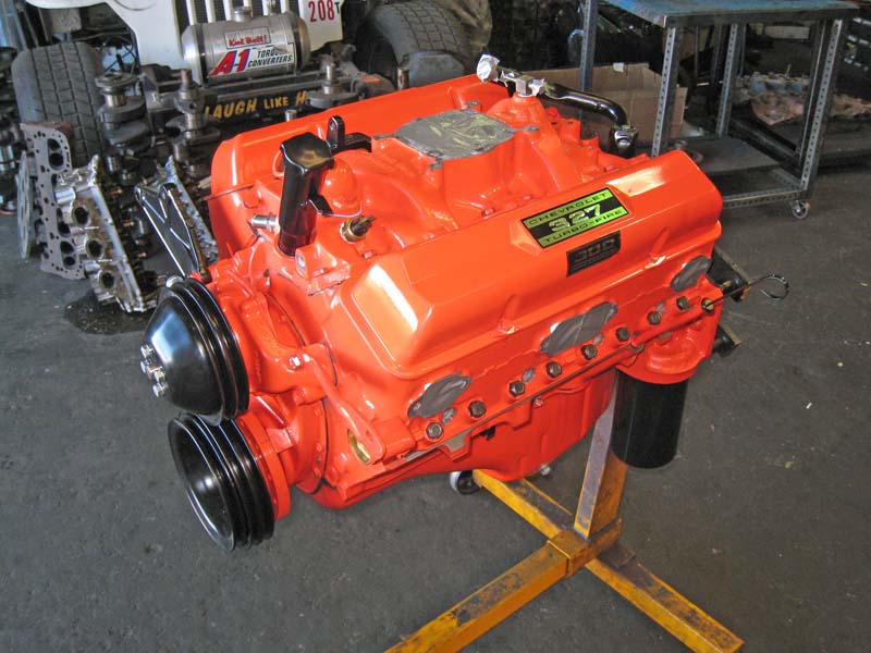

  23. Splitbudaba
    Joined: Dec 30, 2014
    Posts: 1,025
    Splitbudaba
    Sounds like you are a man who knows what you want. But with good taste. I plan on no chrome in the engine compartment, I want it to look like the engine came out of a 60's chevy, 327, and dropped right in the coupe. Just clean. My wife and I were discussing our vehicle needs for our new home. Well my faithful 2002 S10 goes bye-bye. we are going to look at a 2005 Suburban 4x4. Talk about from one extreme to another. Hope my depth perception hasn't gone!! I thought those Unisteer racks were unbeatable, just by dumb luck I put in the Borgeson Vega box also. Can't wait to get your input after you change the steering box. I'm sure you will be on the road way before me. My son bought me the traditional 5 gauge panel for my dash, plan on using SW standard gauges, (mechanical).

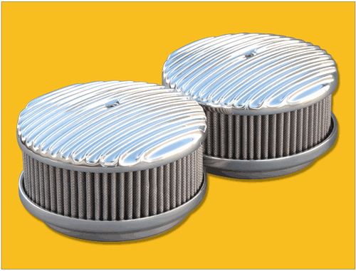

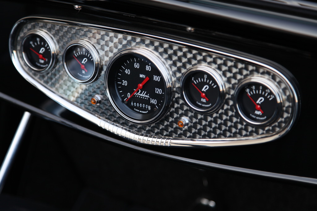

  24. daveh1932
    Posts: 280
    daveh1932
    from UK
    The engine sounds very cool and love that dash panel. The main problem with the Unisteer is that the turning circle is rubbish and much worse than a Vega box that’s the main reason I’m going to swap it out. I live in a very narrow lane and if I don’t set the coup up in exactly the right position when I pull out of the T Junction at the end of my road I can’t do it in one sweep! Here’s a photo of the engine as it is currently
    These are the air intakes that are winging their way to the UK
    Here’s another shot of my dash before I changed the steering wheel and column

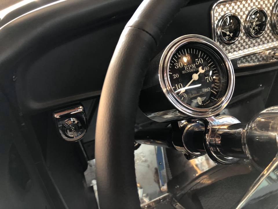

    And the column mount tacho cup I’m going to get when I visit the US in June
  25. Splitbudaba
    Posts: 1,025
    Splitbudaba
    I must be getting old, that engine looks great but it's hard to keep it that way. I did not know the Unisteer had a limited turn radius. I see where that could be a pain, and embarr***ing when you must back up and start a turn again just to make it around a corner.
    Are you planning on getting different valve covers?
    I'm not sure where to put the tach(o) in my coupe. I have fond memories of a Dixco tach I had in my 57' chevy. I have seen some on Ebay. Not the one with painted stripes, just plane chrome.
  26. daveh1932
    Posts: 280
    daveh1932
    from UK
    Yes, it looks very good but not the style I’m after. I’m changing the valve covers, breathers, air filters and have a nice finned oil filter cover, the oil sump, and a few of the bolts on the engine such as header bolts etc
