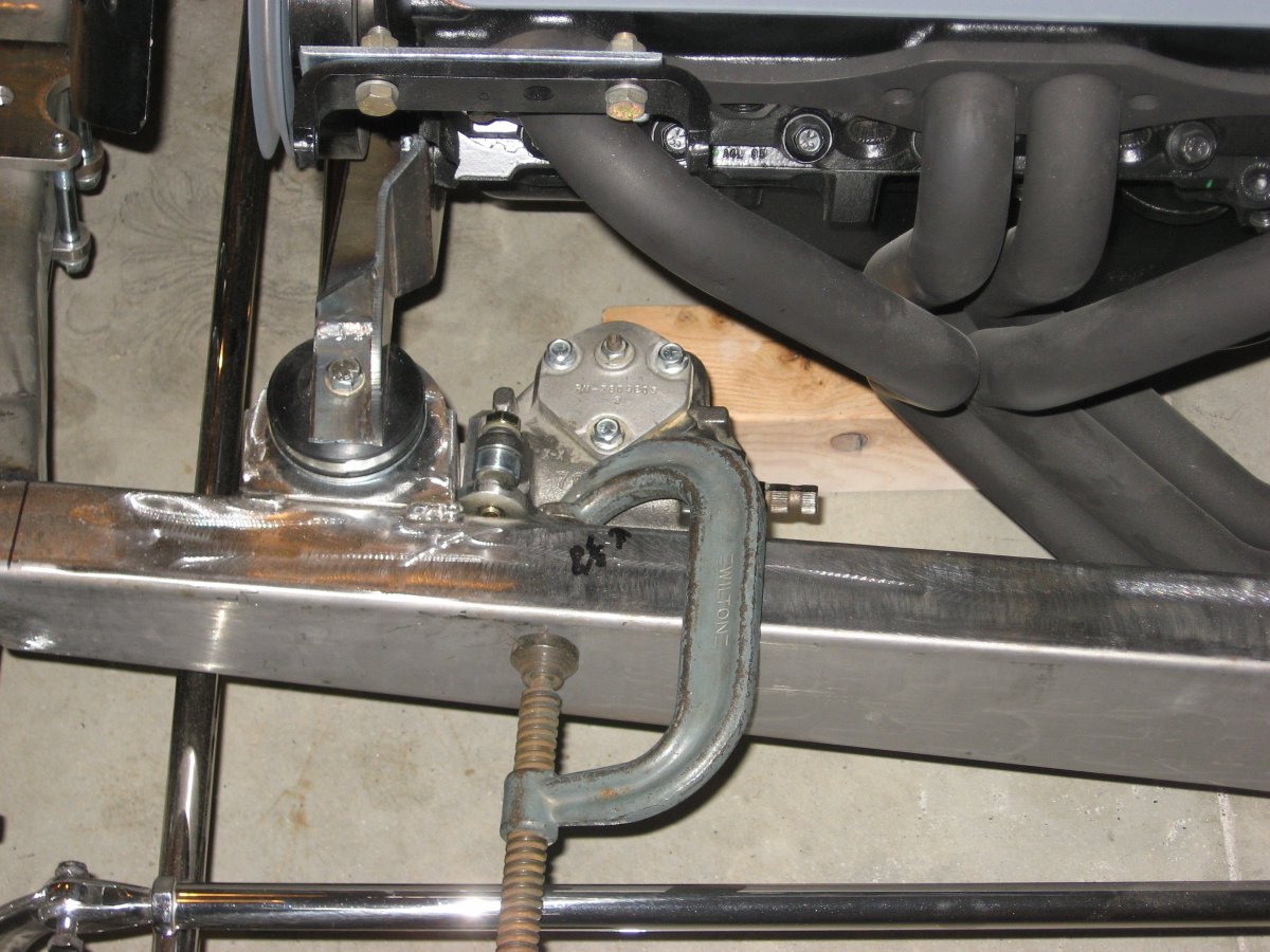

    IMG_2329.JPG IMG_2330.JPG Finally getting back to the coupe. I was installing the 350, decided to joggle the Hurst style engine mount. Took some measurements and bent up the cross plate, added a gusset and welded it up. Now I can run a stock pump and stock style solid fuel line. Any comments would be appreciated, good or bad!

    Great to see you back on your project, very nice work on the engine mount.

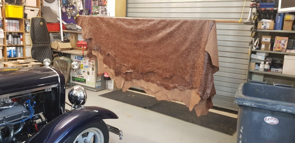

    I was originally going for black but and now going with this, “distressed” brown leather

  8. Did you "joggle" both sides of the motor mount, so that it's symmetrical on the frame?

    Yeah, my OCD made me do it!! Seriously, the joggle on the drivers side really helped with the steering box clearances. IMG_2331.JPG

    Very nice work! I'm ***uming your using a biscuit-style mount. If so, maybe weld on a round plate the diameter of the round pad on top of the biscuit for an even more custom look (flatty style).

    I like that idea!! It will look a lot like an AMT 32 Ford kit from the 60's

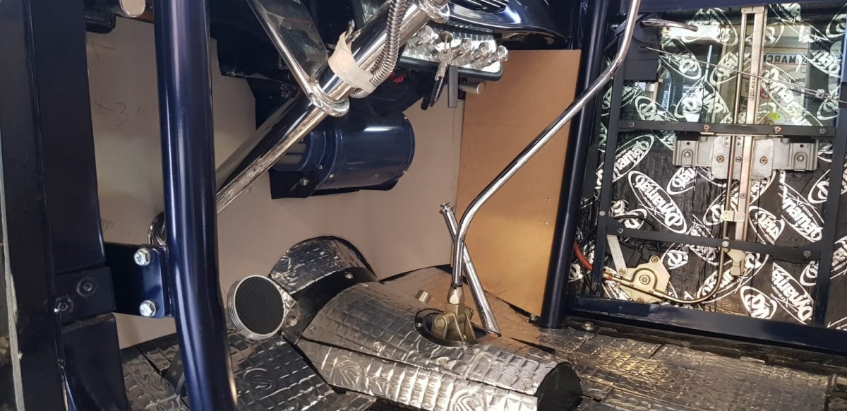

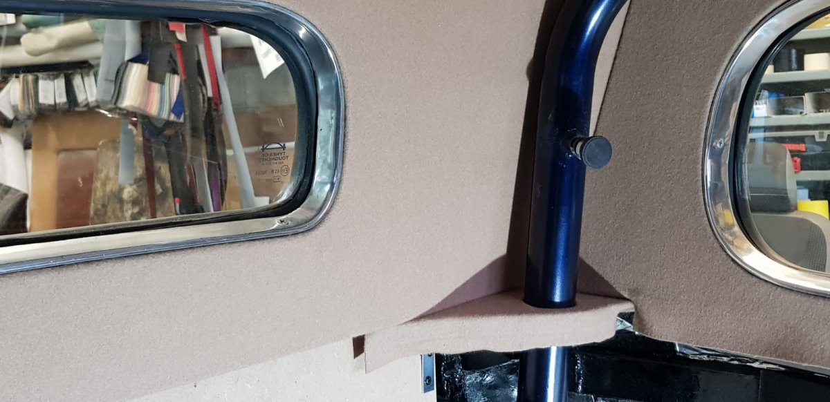

    I received the first progress photos from the trim shop yesterday, headlining progressing well
    He also has another Deuce in the trim shop for some changes to the interior he did 6 years ago

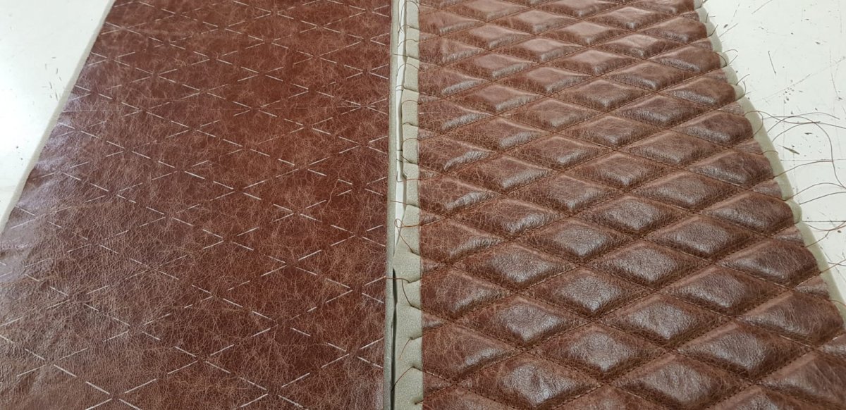

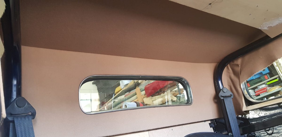

    Here’s a few more progress shots
    4F43DDFF-DCCD-47FA-B69D-1AF1CF0E85AF.jpeg D3CD9056-B5F7-4EDC-94A0-3DFB37F6FF93.jpeg 32ABE885-3673-40FE-9469-F1FAEE72C11B.jpeg

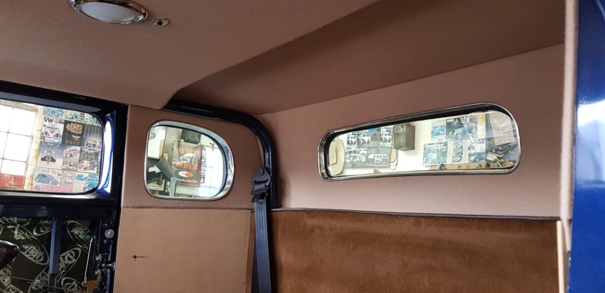

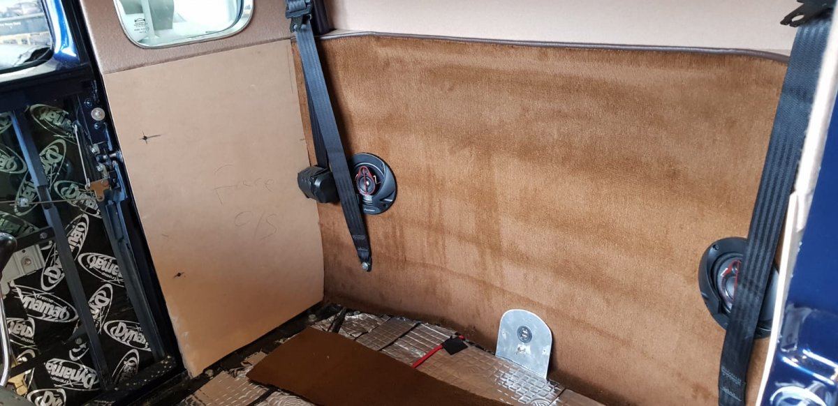

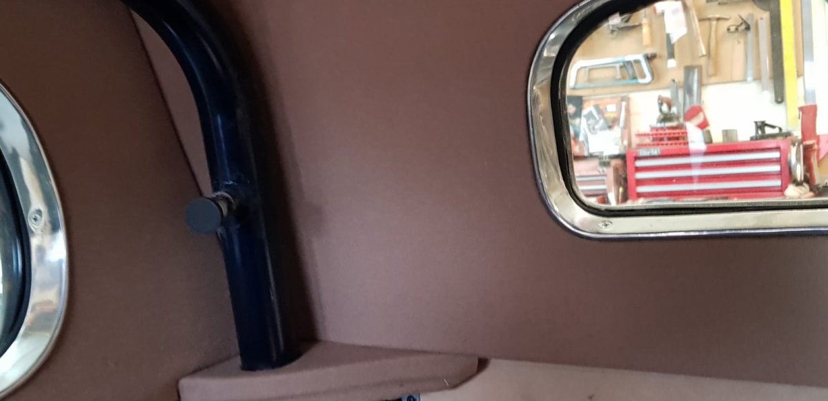

    All the headlining, carpets and panels now complete and the leather upholstery has started,

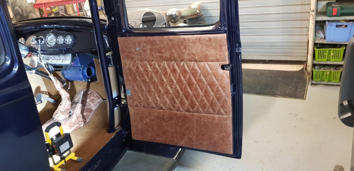

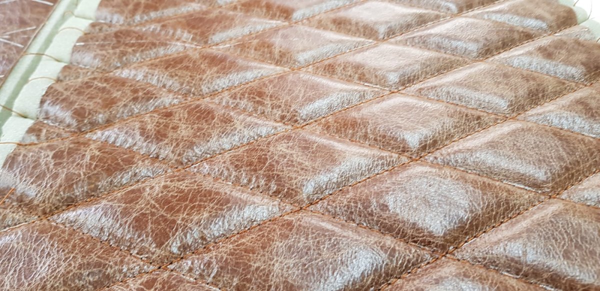

    First door panel complete

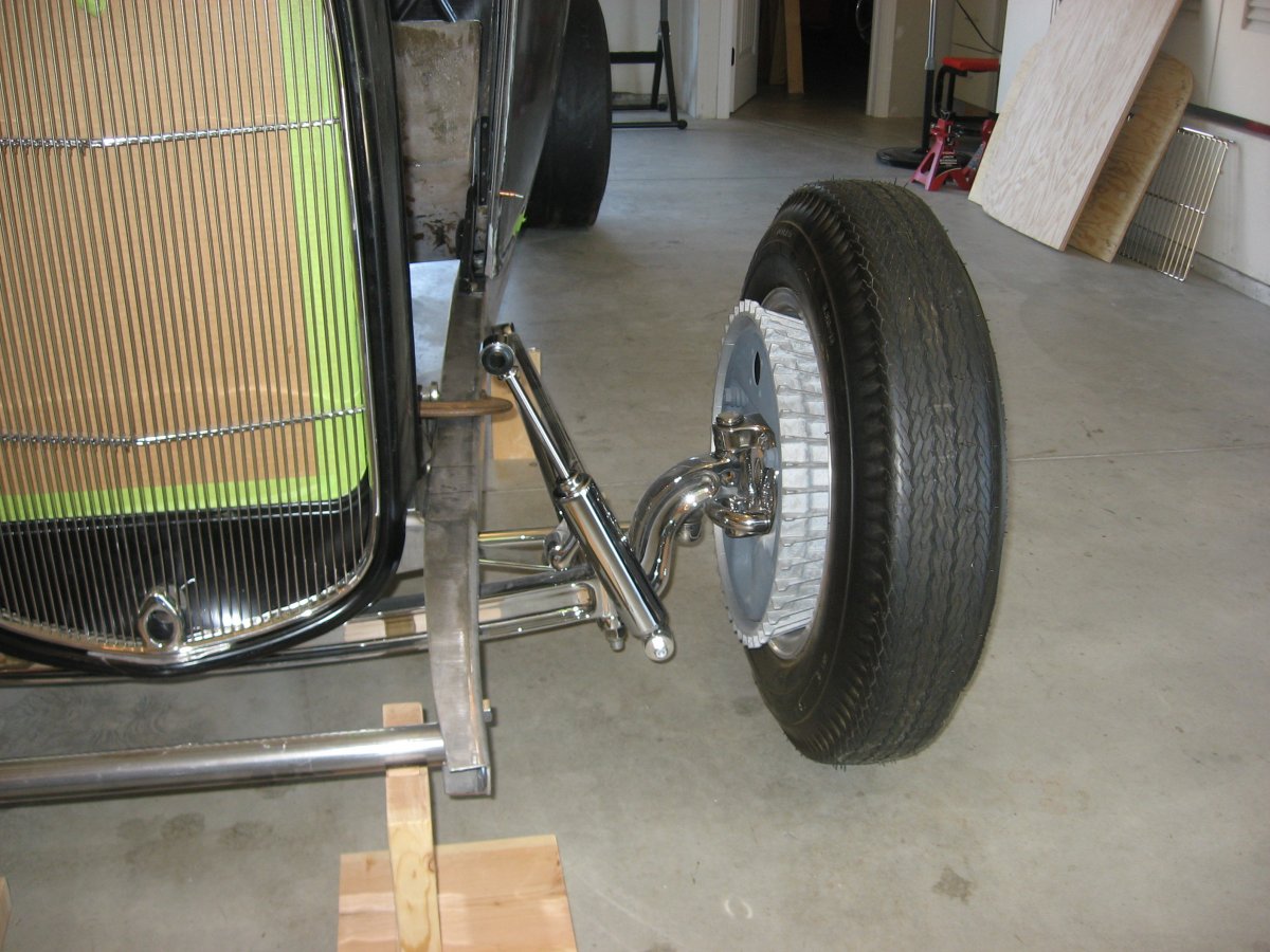

    IMG_2284.JPG Looks great, wish I could sew that straight! Might actually get to work on my coupe next week!!! I had no idea how much work goes into a house!! We are installing hard wood floors. Back to the coupe, it has been pointed out to me that I have an issue with scrub radius, king pin line meets the road just in side the tire! Looks like different wheels are the cure. Some guys say a little positive scrub won’t hurt. Not sure yet where I will go from here. Any ideas?

    Thanks, I’m very pleased with Chris’ work it is top quality.
    It never ends, we converted a bungalow in to a 3 storey house about 9 years ago and still not finished! It would be such a shame to cover the drums, you can’t beat that front end view but I guess safety comes first

    Think I will get her going and see how it feels. Maybe play with toe in and caster, even tire pressure could affect the feel! I found a few articles that say positive scrub radius isn’t too bad, guess I will find out for myself! For now the drums stay!!!
  24. Lots of cars are running around like that. I wouldn't worry about it, it's a Hotrod, not a new Cadillac.

  25. Splitbudaba
    Joined: Dec 30, 2014
    Posts: 987
    Splitbudaba
    Agreed!! I love the look, and that’s what it’s about!!!

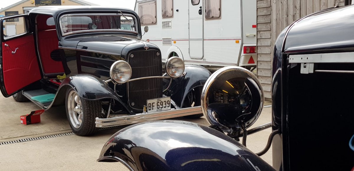

    Took this today at Wheels Day, this rod has been on the road for quite a while and still going strong

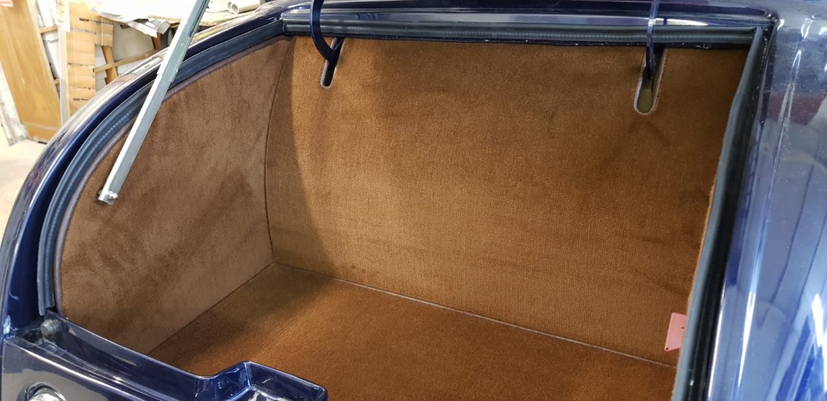

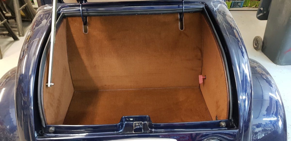

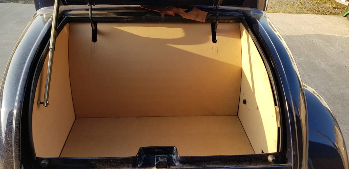

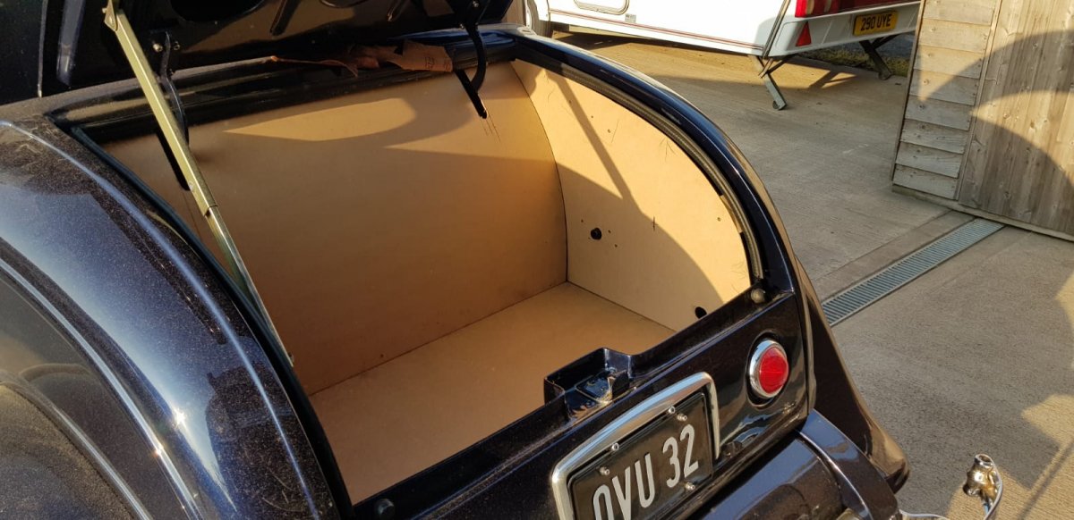

    Just received another update on my Coup, boot nearly finished just the underside of the lid to do
    1B1B7AF6-CAEF-4CC4-B56F-B3F81A2F0B95.jpeg B416DC2D-B6FC-4967-AFE0-E566E3637939.jpeg 8358182D-DF93-4C18-B6B4-AF01A65BB8ED.jpeg 134A72CC-1969-4948-9F2C-F5101F9C14AA.jpeg

    Thanks, I don’t think I will be concerned after seeing that pic!!! Many thanks!

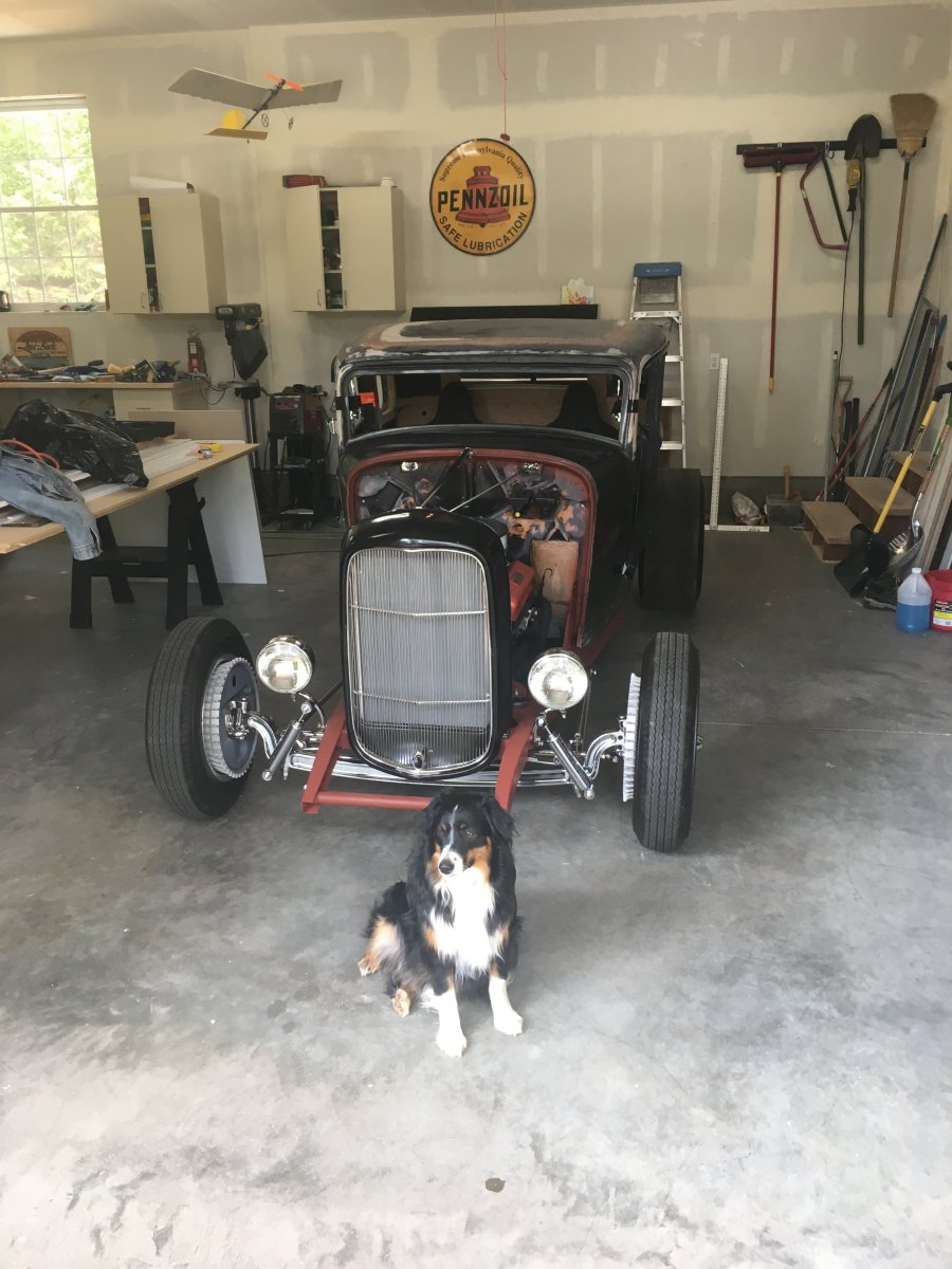

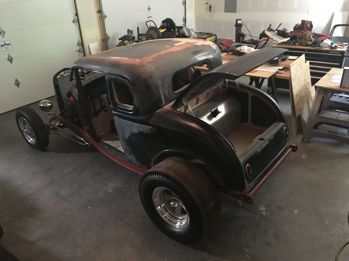

    64B38E90-299D-4848-8D08-158AB2400678.jpeg D040799D-B5BB-4E19-8F31-3ED9A2933772.jpeg Happy Easter, finally got the coupe in my new (but unorganized) garage!! Let the fun begin, 11 months is too darn long!! Daisy helped!!
