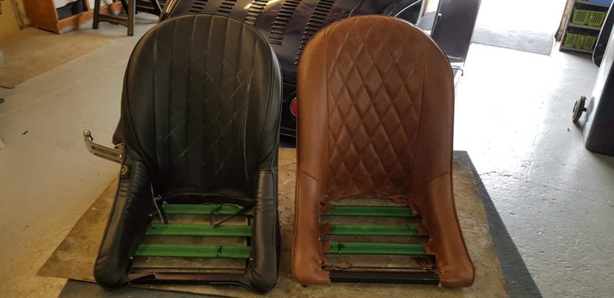

    Just the seats to do now, collecting on Tuesday and looking forward to the 3 hour drive home

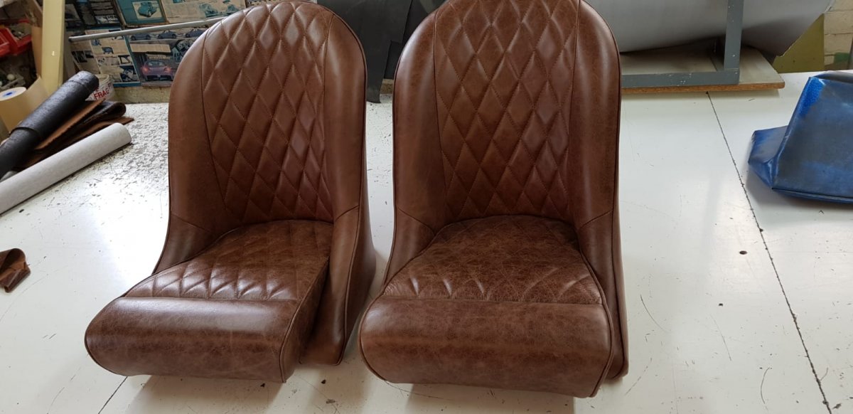

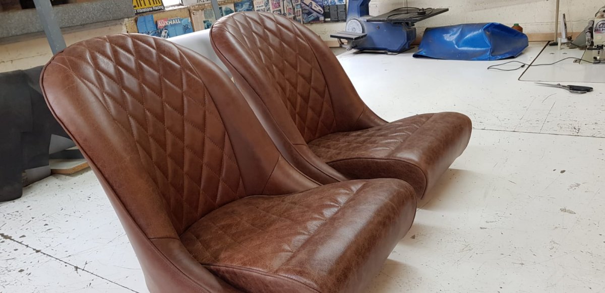

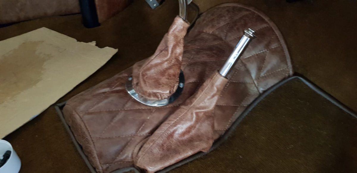

    Received this update this evening, the seats are now complete and all on schedule for collection on Tuesday. I’m absolutely chuffed to bits with the quality of Chris’ work, he has really transformed the look of the seats.

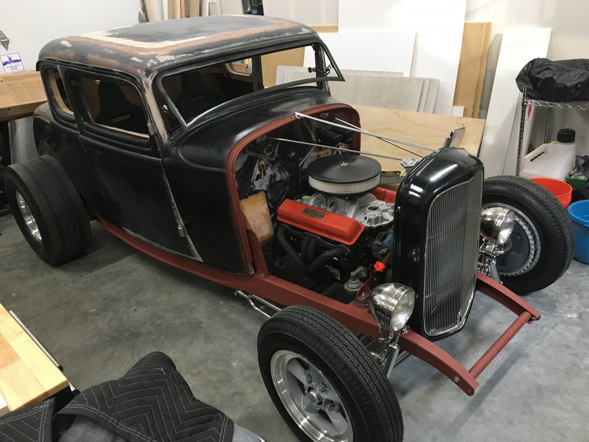

  7. daveh1932
    Joined: Apr 10, 2013
    Posts: 280
    daveh1932
    from UK
    It’s got bucket seats like mine by the guy who owns it wants to change to a bench seat

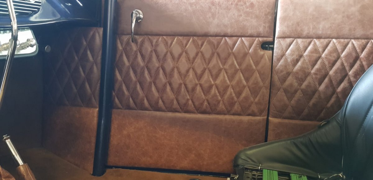

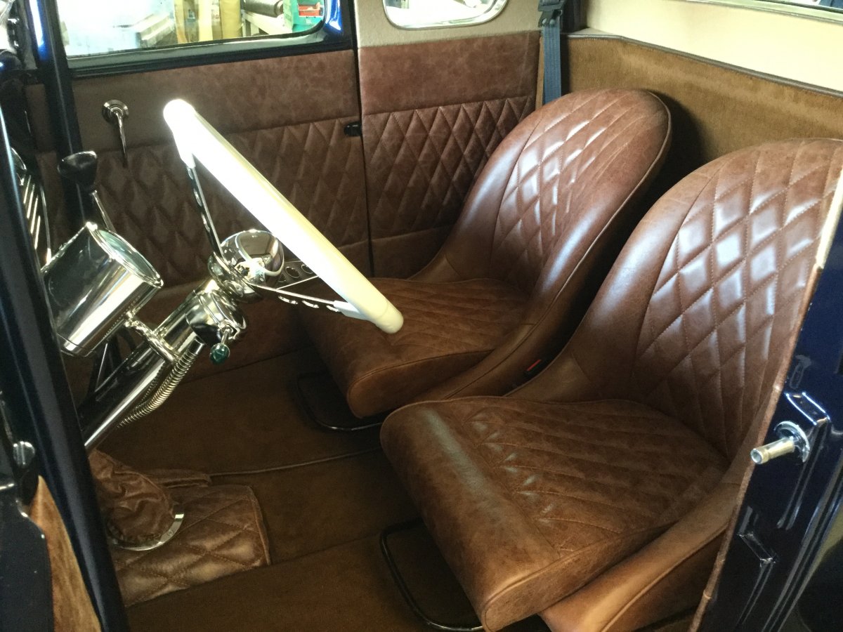

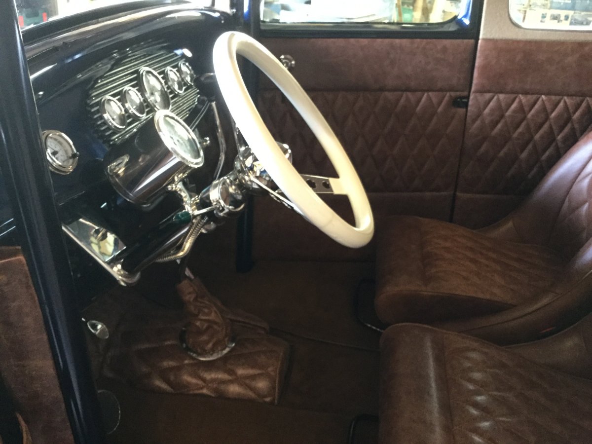

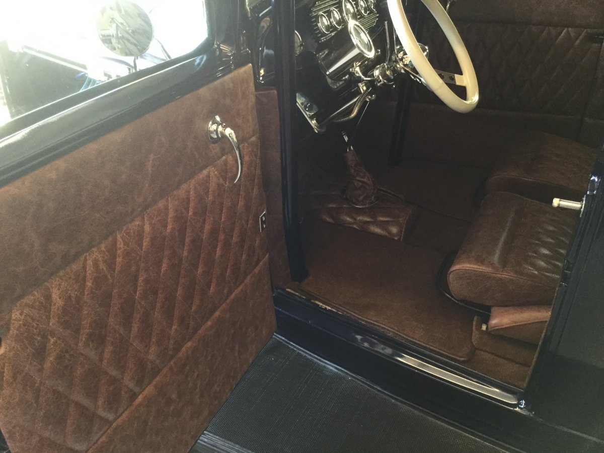

    I’ve just re-read this and must’ve had a senior moment, I thought you were asking about the 3 window Coup that was also in the trim shop! I’m on my way to pick up the Coup as I type this as it’s all completed now and the work is outstanding. I don’t have photos of the completed interior but will take some when I get it home.

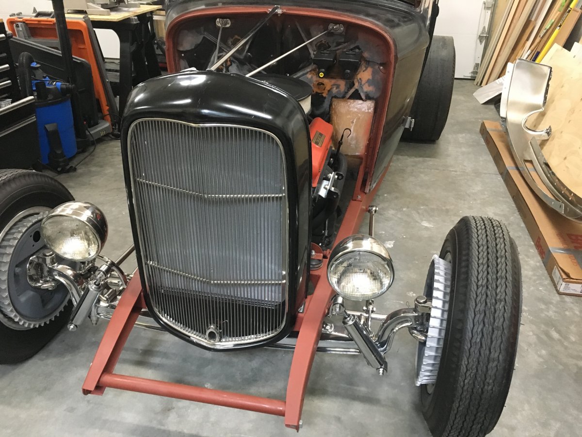

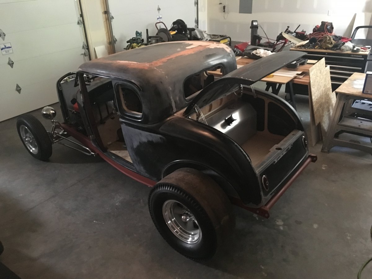

    E01C1FEC-5E69-4161-8934-F7D9F0459B69.jpeg 0B419912-E0A3-4459-B379-3866FB8B0098.jpeg Well finally getting to work on the coupe. Putting in parking brake system(live on a hill). Not very organized, but I don’t care!! Great to be back at it!! I turned 70 yesterday, doesn’t feel any different than 65, so far!!! Time for some me time!!

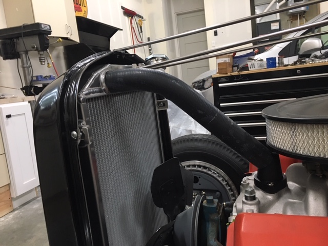

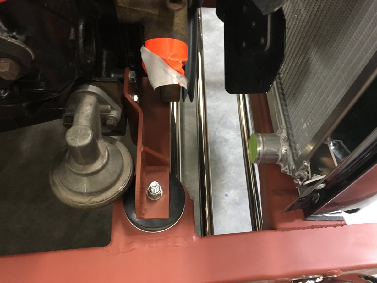

    9D83D523-8B19-4B7E-9DBB-4C5EF8F1650C.jpeg 8E6C2D7F-8683-471F-ADDA-AEF1A5943324.jpeg Anybody have any idea what p/n hose I can use in my coupe? It’s 1.75 ID.
  24. I HAVE USED 1955,56,57 CHEVY

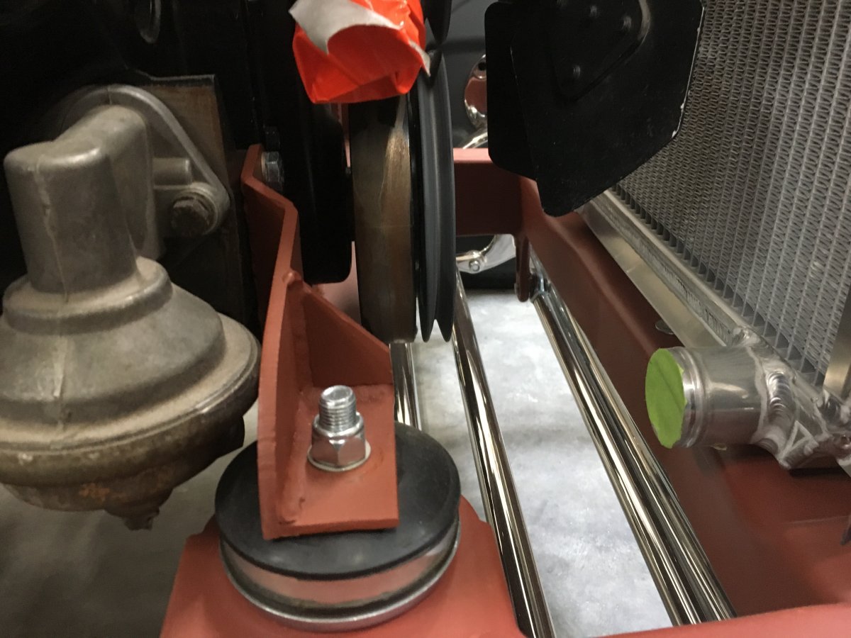

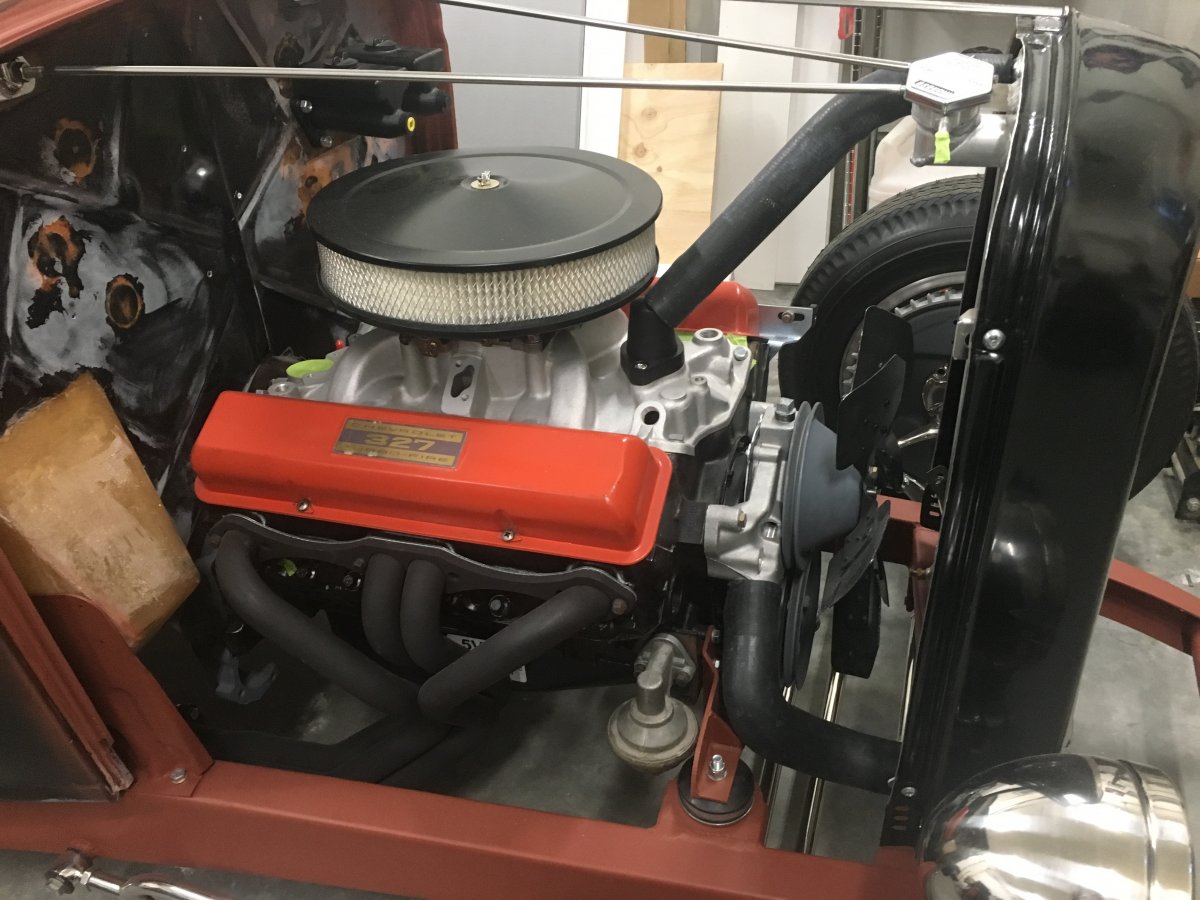

    IMG_0710.JPG Purchased a lower hose, tried it but since I joggled the Hurst style mount, it would not clear. Remembered the long style pump, perfect, only problem was all the extra bosses for accessories. Plan B , bid on a used set of Moroso water pump spacers. I can machine the down to any size I need. I will make a spacer for the lower pulley, plus the fan will be closer to the radiator. Might actually work. Generator mount is adjustable also. Installed the upper hose using a swivel 45 degree thermostat housing, worked great. Also started to install the throttle and mechanical linkage.

    Thanks for the help, used hoses from a 57 Chevy. Lower worked great, cleared the mount and fit perfect. Next the throttle and linkage. Just got a Fast Shaft driveshaft 33.5 ", need to fit it in this weekend. IMG_0727.JPG

    What top hose did you use? having a hard time finding one that will work...

    Top 57 Chevy v8 hose reversed direction. Had to use a 45 degree swivel neck water outlet to make everything line up!
