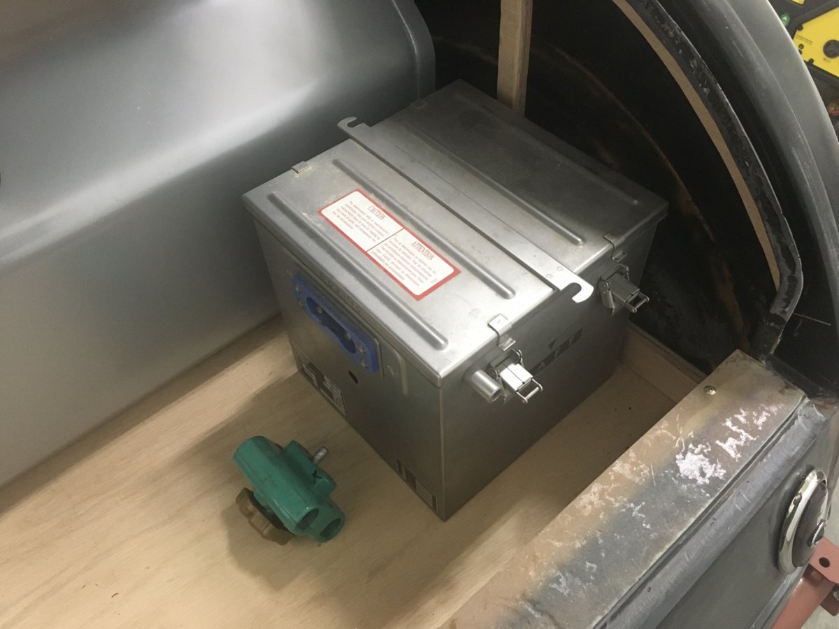

    Joined: Dec 30, 2014
    Posts: 962
    Splitbudaba
    BAD721DF-BED1-4B0D-9962-A43F5814ACCF.jpeg 7049C5AE-E8AA-498F-8A7C-64E1F4004D01.jpeg Finally getting back on the coupe. House is far enough along to have some fun. Here’s the coupe in her shop, next shot is my battery box. Anybody know what that is?

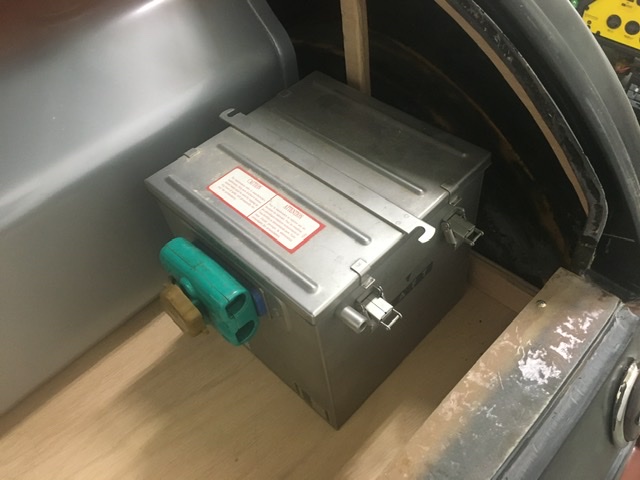

  5. Splitbudaba
    Posts: 962
    Splitbudaba
    44313687-323B-40DB-A0E9-9BCA8711058C.jpeg Has a cool quick disconnect! Vents, all stainless with top latches.

  8. Splitbudaba
    Posts: 962
    Splitbudaba
    That disconnect gets locked and has holes for breakaway copper safety wire.
  9. Tomastudor
    Joined: Dec 15, 2009
    Posts: 311
    Tomastudor
    That is an aircraft batterybox
    Splitbudaba and loudbang like this.
  10. Splitbudaba
    Posts: 962
    Splitbudaba
    Very good, it’s a big ni-cad battery box from a big Falcon 2000 aircraft. I must remove two baffles inside, and then drop in a 12 volt battery, it has internal connections for the 12 volt so the quick disconnect will be functional. I plan on running a vent system.

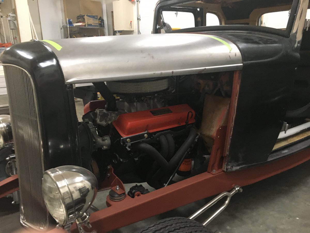

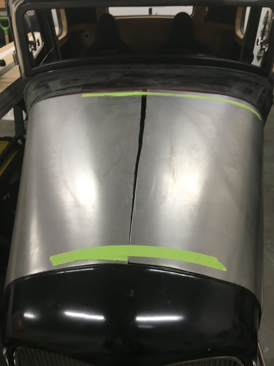

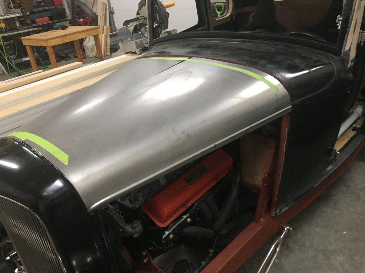

  22. Splitbudaba

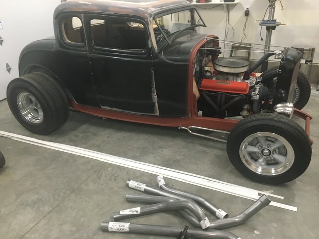

    Posts: 962
    Splitbudaba
    BE60574D-48E6-451C-83DD-61D2CF6454C4.jpeg 2940C28C-50C5-4F53-B50F-75B0A1E00EFE.jpeg 1EF20955-4645-4A74-AD14-9E2F9333AD2D.jpeg Finally got back on the coupe! Time to fit body panels, hood first. Bought a one piece hood somewhere, along with the center hinge kit! Good I did, hoods not even close (see pics). Had to re- radius the corners , still can feel the metal give at 70, encouraging! Anybody have any lacing ideas, how about rubber hose, I am not running sides, no need for lacing on the sides. Any softer products available?

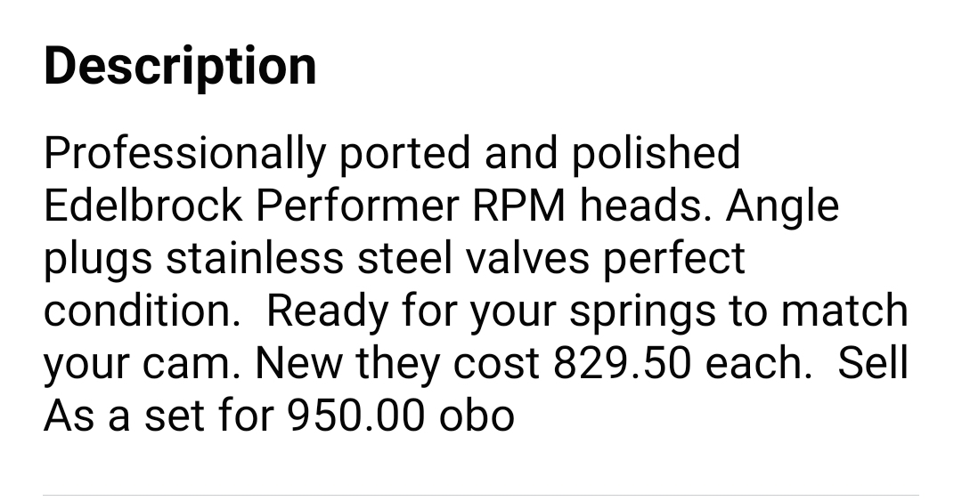

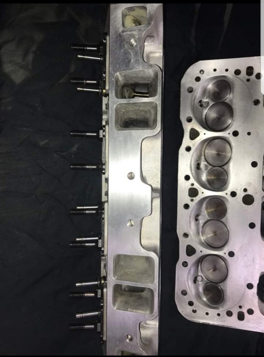

  24. swade41
    Joined: Apr 6, 2004
    Posts: 14,630
    swade41
    from Buffalo,NY
    Well when you see stuff like this it sure seems high to me, I used Edelbrock rpm heads on my Henry J and bought them pretty much like this ad, they worked great for me and I certainly thought about buying these as well. Screenshot_20200212-000328_Facebook.jpg Screenshot_20200212-000404_Facebook.jpg

  26. swade41
    Joined: Apr 6, 2004
    Posts: 14,630
    swade41
    from Buffalo,NY
    Those heads I posted are way way better than those 461's and only a couple hundred more than what they want to rebuild yours. What I was trying to imply was is you can get a much better performing, cooling, lighter weight head for practically the same money.
