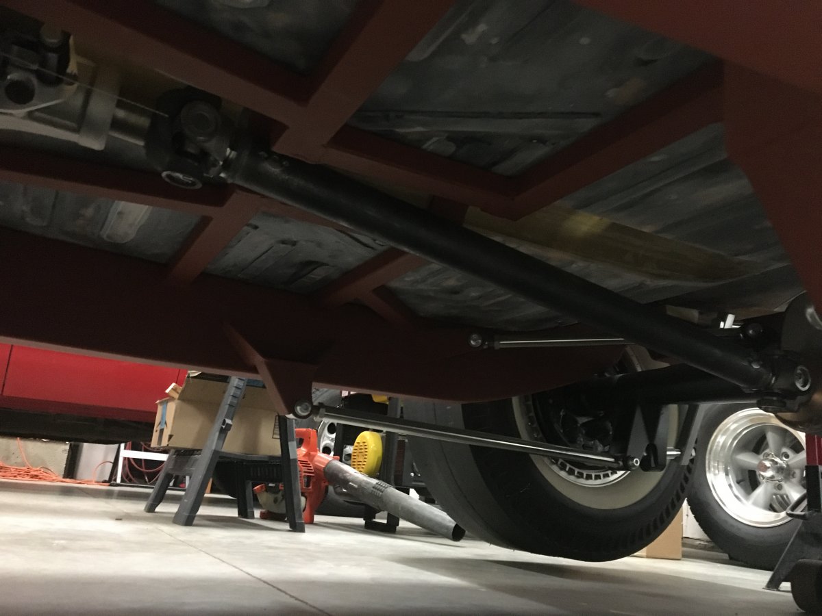

    35A0F62D-C788-4EC5-A3DA-2FAF0556E53F.jpeg Finally some progress on my coupe! Bought a Fast Shaft a few years ago, pulled the u- joints out, cleaned the ugly white paint off, checked the u-joints and re***embled with the yoke and slide it into place! Fits good, now on to seat mounts!

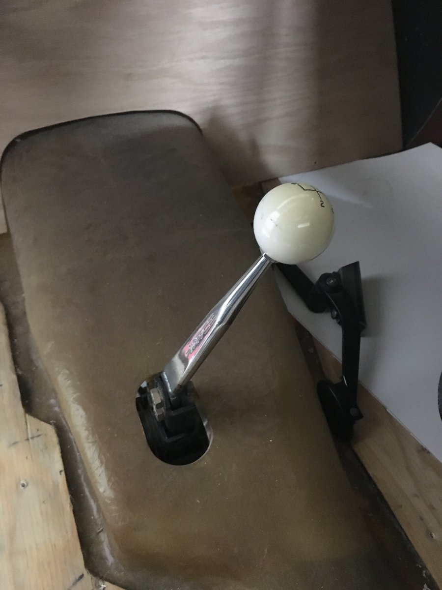

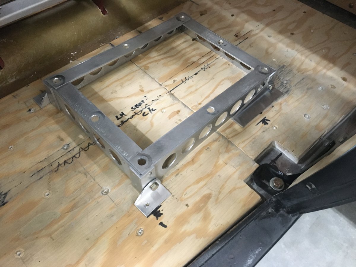

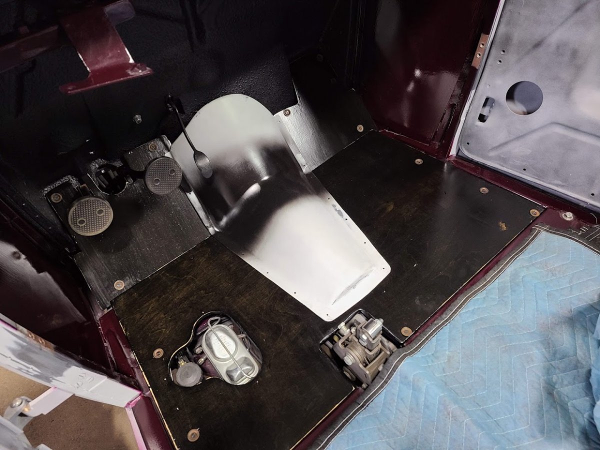

    1934DBCF-6EE8-489E-83B9-AF625F24C430.jpeg 9F471076-B675-464E-92BC-FBFBC27BE259.jpeg Wow, got some more work done, amazing!! Finished up the seat mount, except final holes in floor to grab the steel cross bars! Cut my Hurst shifter almost all the way through, laid it over for leg clearance and welded it back up. Works great, can’t wait to give it a try!

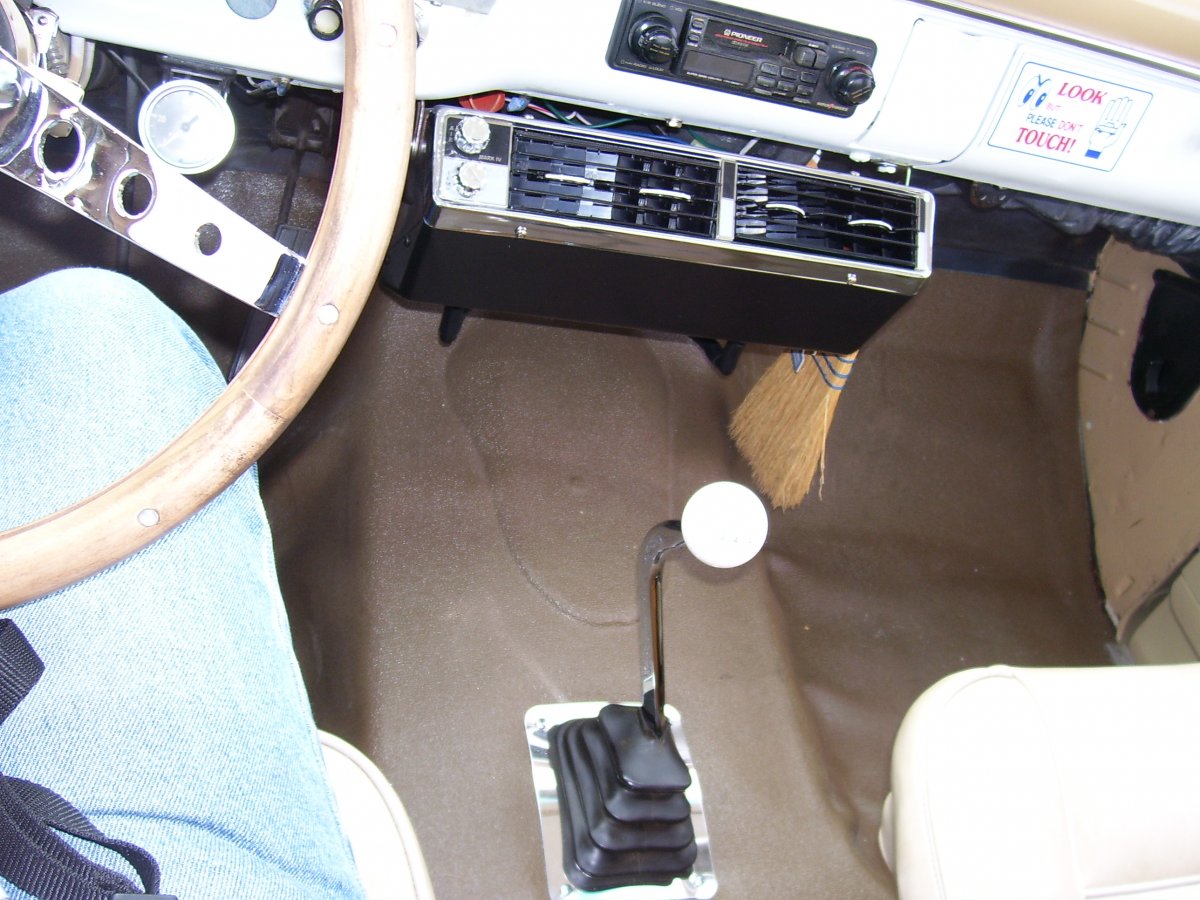

    Instead of cutting the shifter next time,try this. Done it a few times and works excellent. Love your build. Glad to see your back on it. Deuce Rdstr  floor 3 20 20 a.jpg
    31hotrodguy, loudbang and Splitbudaba like this.

    I have seen that before, still might add spacers and cut it up higher and bend it back to straighten it up! Need the seat in to decide. Thanks! Glad to be back on her myself, kinda the****utic!! How I have missed my garage time!!

    I just clamped my shift lever in the vise just above the bolt holes, heated the lever with a torch and bent it. Didn't even hurt any chrome that you could see, boot covered it all!

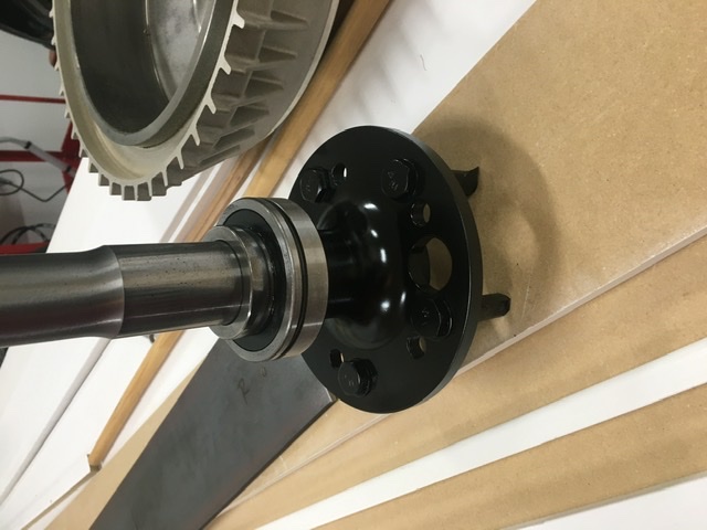

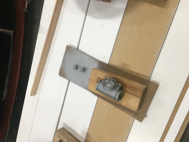

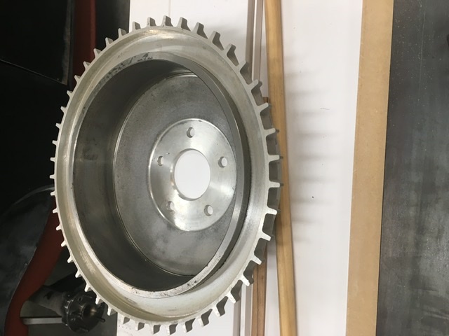

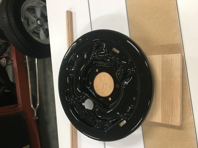

    DC99F1F5-076B-45A8-9608-9DCC7B3D3072.jpeg C045CED4-AC9E-4163-B686-C3258FBEBA83.jpeg C6FA1E5A-EE8E-436C-8339-CF74C0793FD6.jpeg 3FAF1E85-6AE3-4C59-B60C-E84982E9F3A3.jpeg Well, worked on the coupe since noon, took the rear axles and brakes off , detailed them and painted all the bare metal. Now I need the o’rings for the axle bearings, then ***emble it and fill it up with lube! The brake ***emblies are from John’s Industries! It was great working on her again!! I feel calm!!

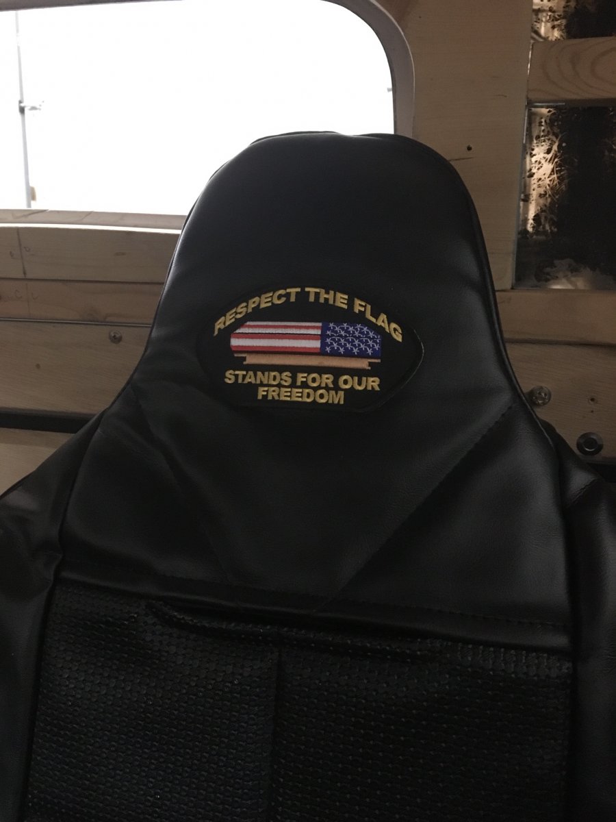

    FCD6AD99-E31F-4293-A61D-EB1BE42FDD3D.jpeg Worked on the seats, yeah Tupperware for now. The seat covers had a Jazz logo patch sewed to the head rest. Did not care for that, found these online! Much more appropriate, don’t you think?

  30. That's what was done to both shifters on my Model A and '32. Smokes the chrome a bit but does the trick!
