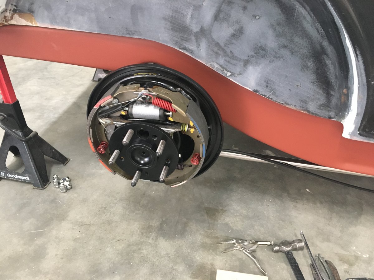

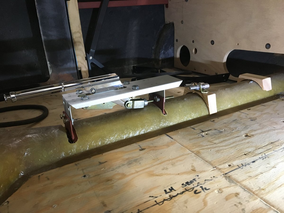

    A9A401B8-5B72-40B1-9A37-A81B28095516.jpeg AEB7C850-5F8C-47BC-872D-E32B5E4A6728.jpeg Got some more done. Figured out the parking brake cable install today. Had to modify the Ford e-brake spring to compensate for the Lokar cable! Now comes the routing into the cabin and finally to the handle. There’s not much distance between the cable on the backing plate and the handle mount! I need to know how tight a radius I can curve the cable housing?

    Finished up the rear brakes and installed the aft quick change gears. Love the machine work and simplicity of the quick change. Need to figure out a breather system next. Added some lube, but decided to wait in case I bore and tap the aft case for said breather. Time to route and connect the e brake cables!

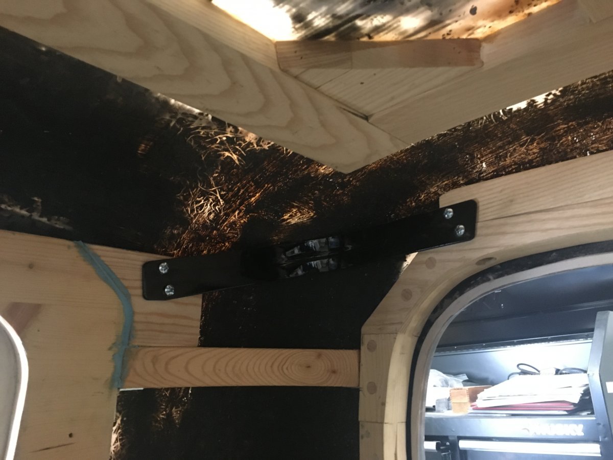

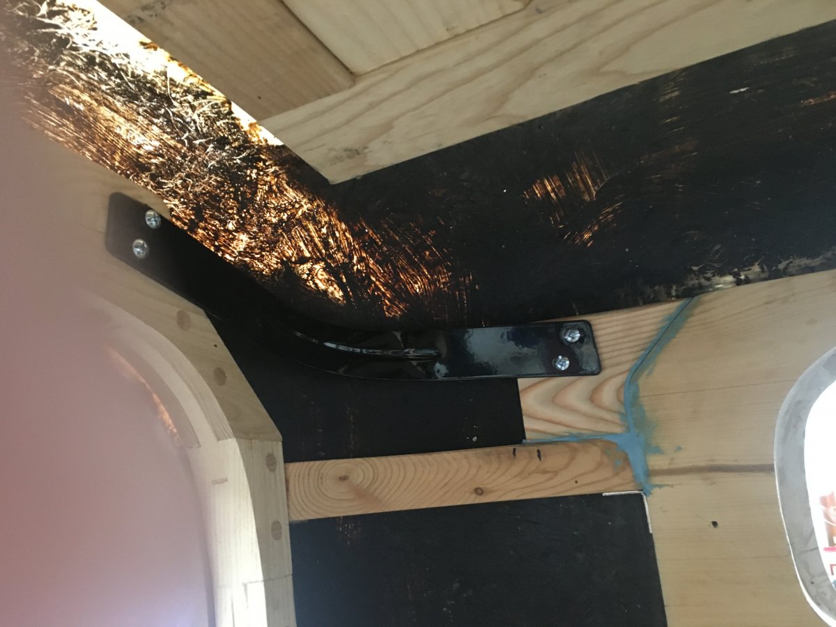

    B125CFD0-B615-44B0-A3FE-989C335D04D4.jpeg Fabricated an e-brake bracket, and wood stand off brackets. The wood will be gl***ed in and studs installed for the cable clamps.

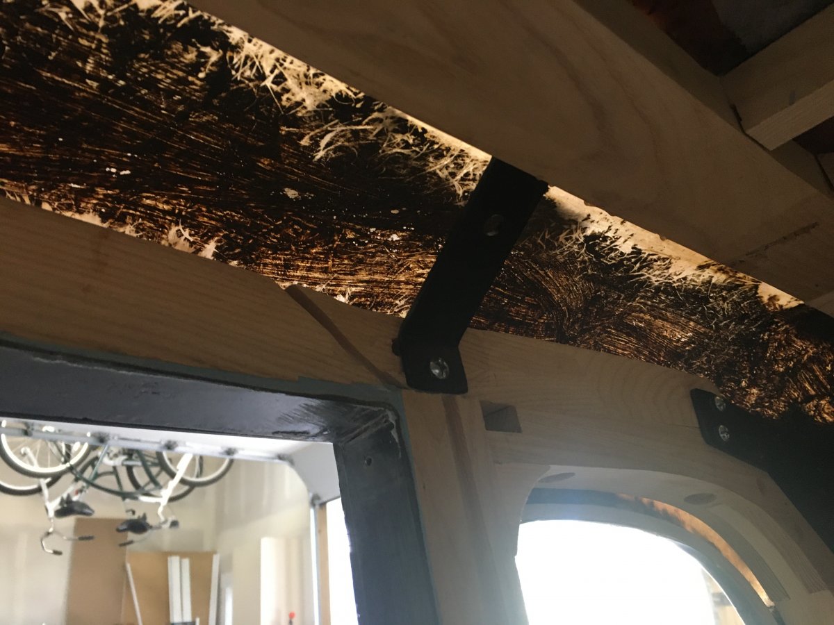

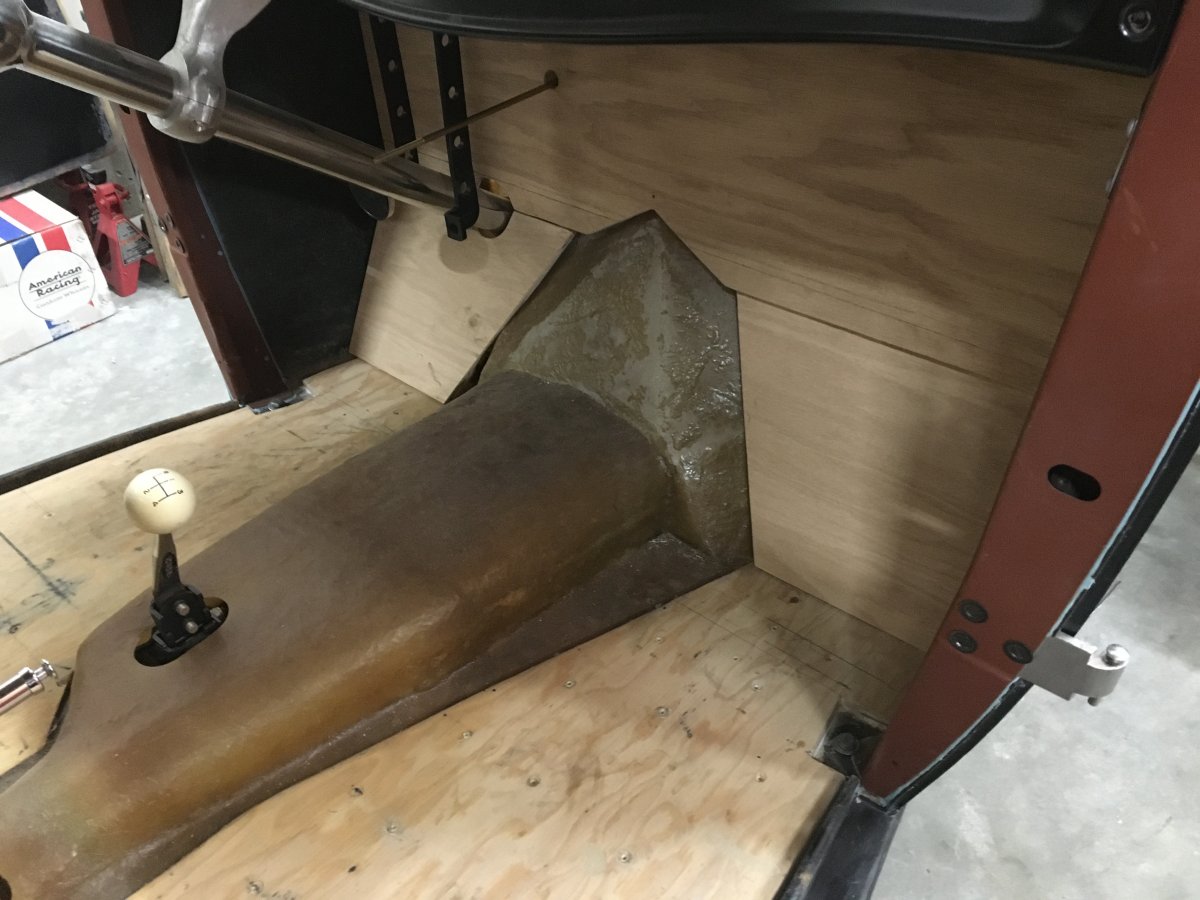

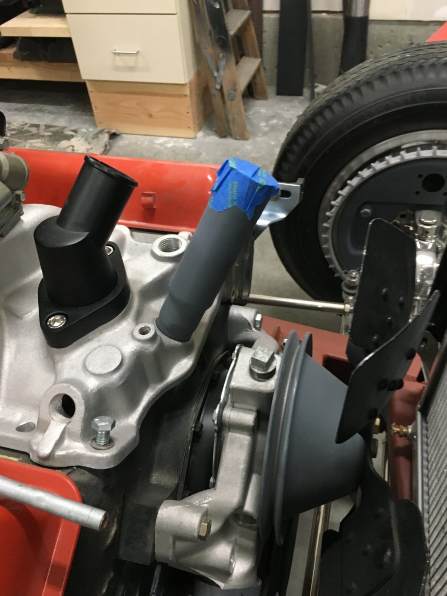

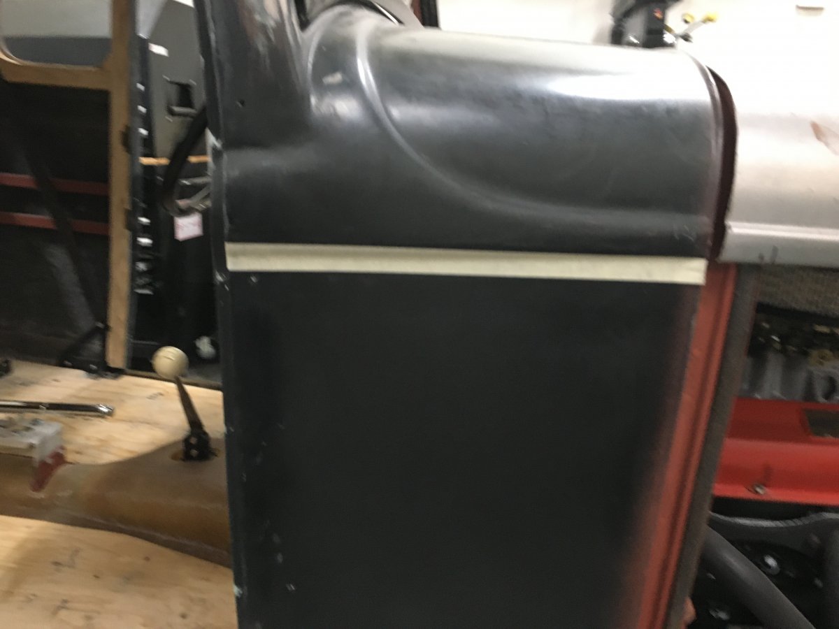

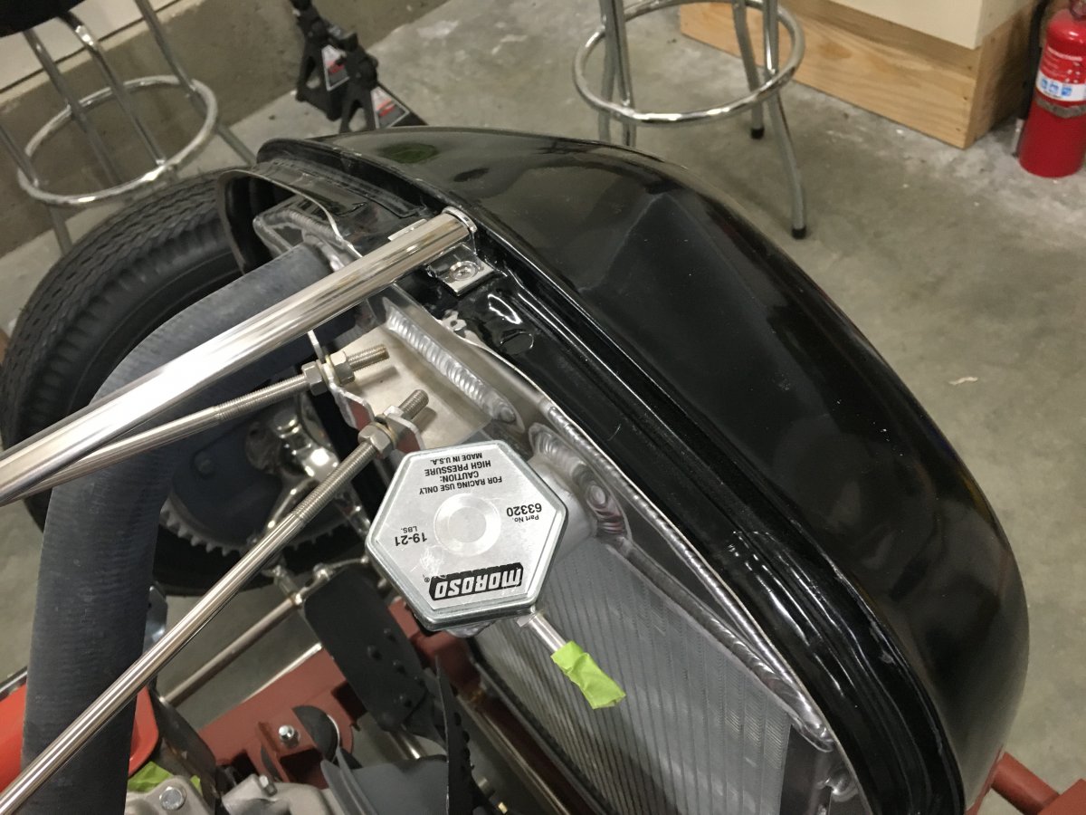

    A8D794CF-43AD-461E-A1AD-3E88118150C5.jpeg 90661A9F-FFED-4B81-B85E-8827E402C7D9.jpeg 649E0764-2771-4913-8EC6-AB2E13A6812F.jpeg Been awhile, House finished, C of O in hand, insurance updated, outside finished, and got our money back from the POA. Started on the hood, installed welt on firewall, no problem. Switched to radiator cover, not so good. Seems they didn’t run the welt channel far enough. Lucky I have a bead roller just that size. I will take the cover off and make the adjustments.

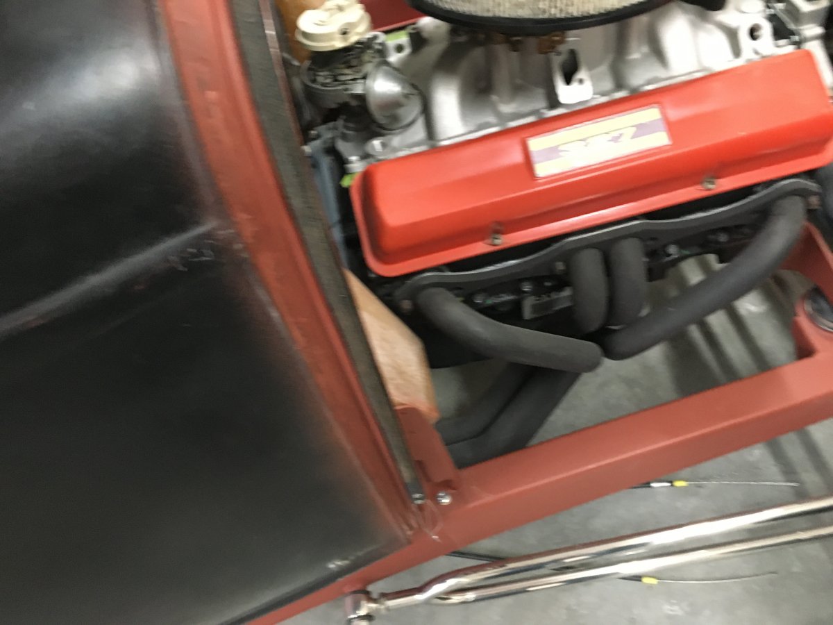

    I like the way the headers fit, were they out of the box fit?

    Yep, I got them from Speedway, nice thick flange too!

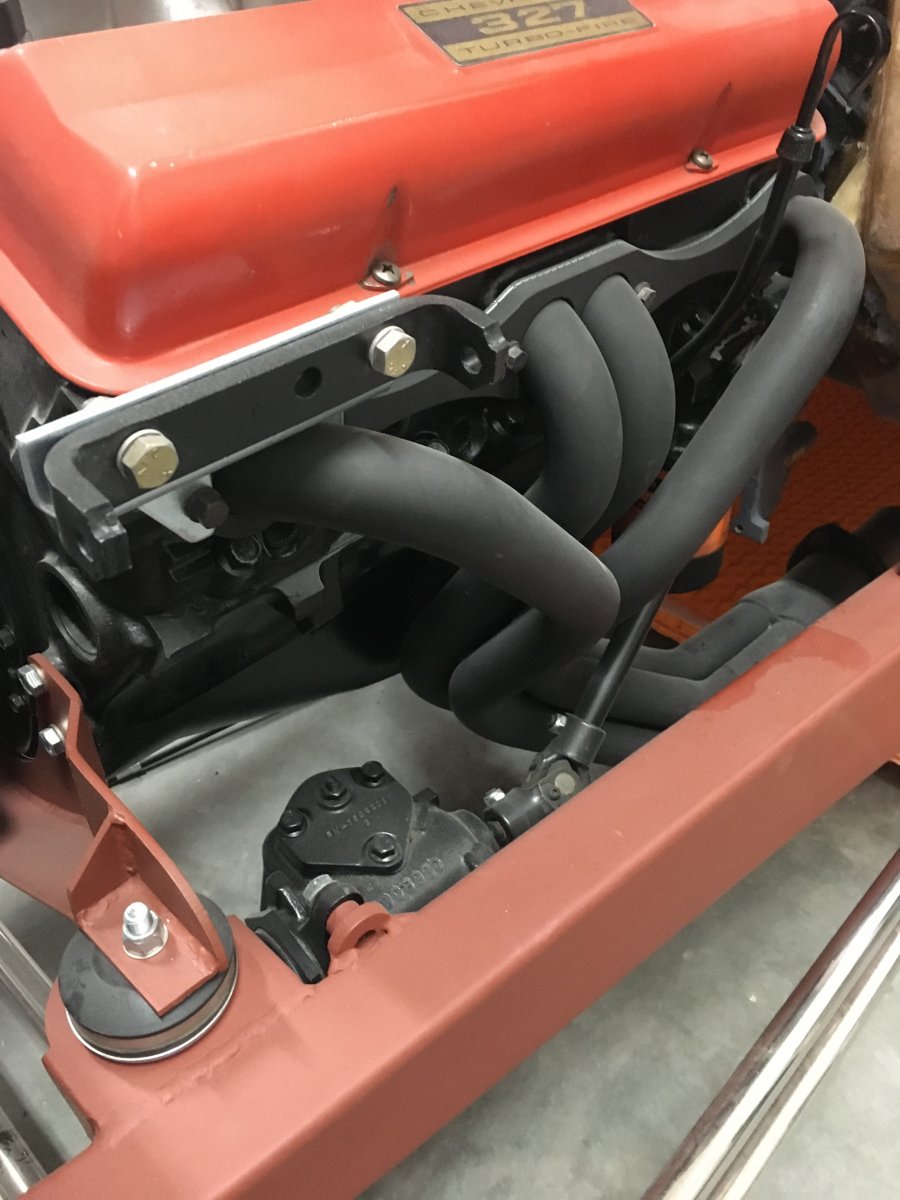

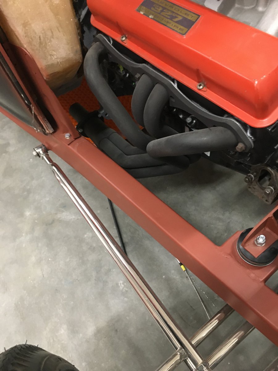

    I skimmed through their site, couldn't fine one that looked exactly like yours. Do the collectors come out parallel to the ground?
  11. Splitbudaba
    Joined: Dec 30, 2014
    Posts: 962
    Splitbudaba
    B1DC8BFB-DE76-4B68-A5BD-057A23F64E6B.jpeg D8193B73-027D-4044-81F5-073403775938.jpeg 930C32 or 930C32H are the Speedway part numbers. First number is a raw metal set and the second set is coated. Fit and finish are great. They are 1.5 “ tubes and a 2.5” collector, not the best for performance but ok for a 300 horse street rod. The scale size installed makes them look bigger, in a 57 Chevy they would look small! Oh yeah, you can’t run the old Chevy metal canister filter housing, I tried!! Steering clearance is ample too!

  12. big duece
    Joined: Jul 28, 2008
    Posts: 7,073
    big duece
    from kansas
    Thanks for the pics! I have Vette 2.5 manifolds mocked up now with side motor mounts. Really tight around the vega box.

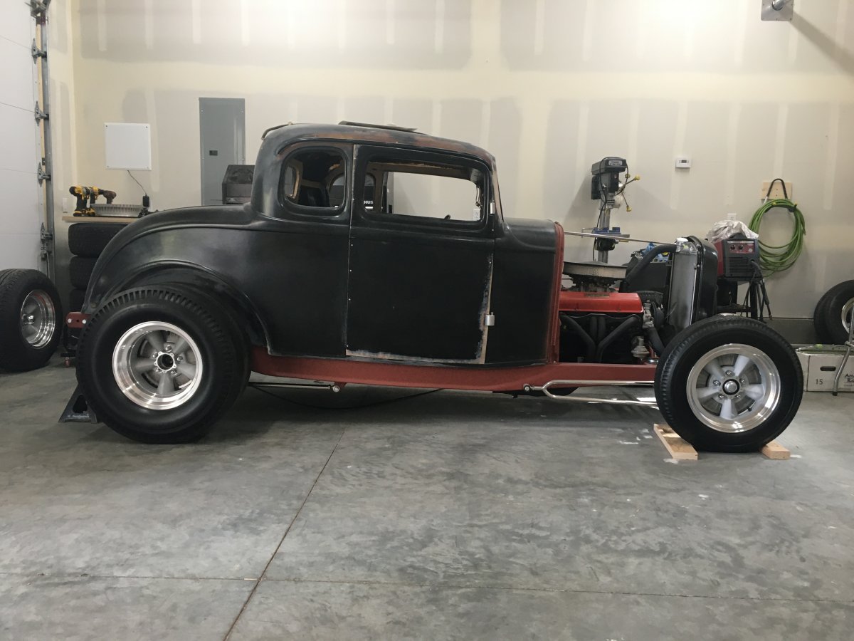

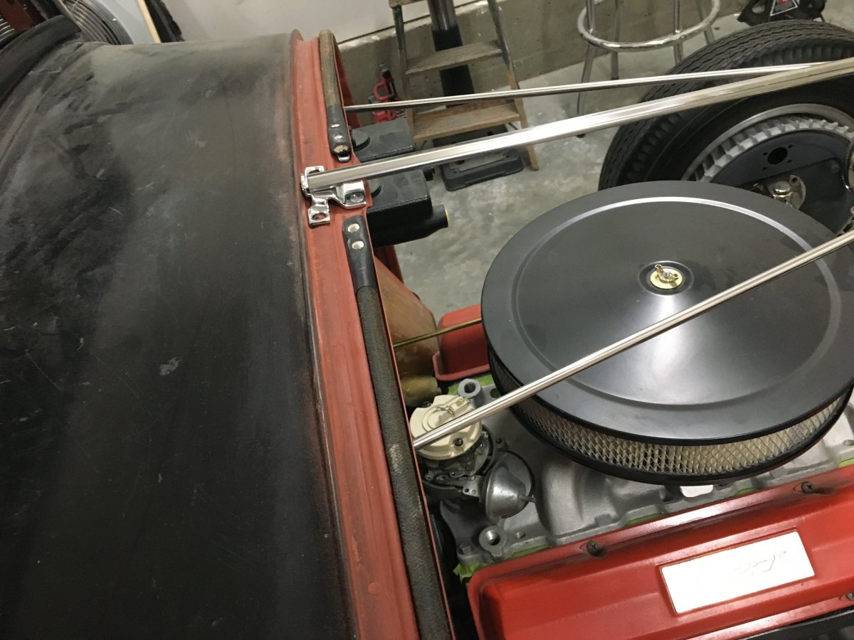

    C6F16B16-9008-4759-8FCD-C5FD28EAA8AD.jpeg CBD2B5FD-DE71-4878-AE21-3C0026D028C0.jpeg Got a lot accomplished today, figured out body issues, got radiator cover figured out, cut hammer welt area, when happy needs welding. Mounted radiator 1/2 “ higher, found error body contour in front of door. Now body lines are much better. Redid forward floorboard from one piece to two pieces. Picked up 2” more legroom, that’s a good thing, I am 6’3”.

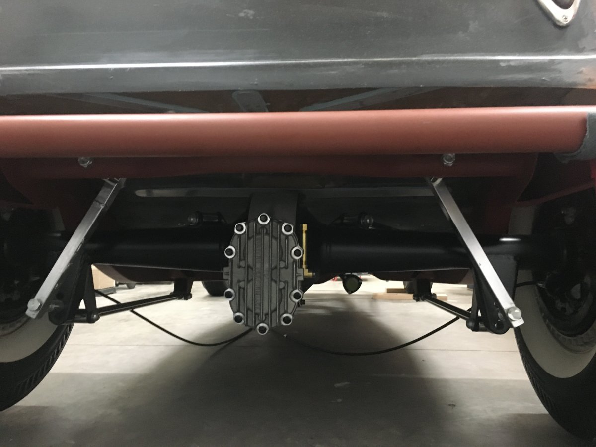

    It’s been awhile! Still working on the master bath, however I am back on the coupe as of yesterday! Ordered some fuel system parts. Big issue is parking brake cable routing from the backing plate to the handle mounted between the seats. Rear is not that far aft of the handle mount! Exhaust gets in the road. I’m using Lokar cables and handle. Made a good strong mounting bracket for the handle, in fact it’s welded to the frame! Any ideas on the cable routing?

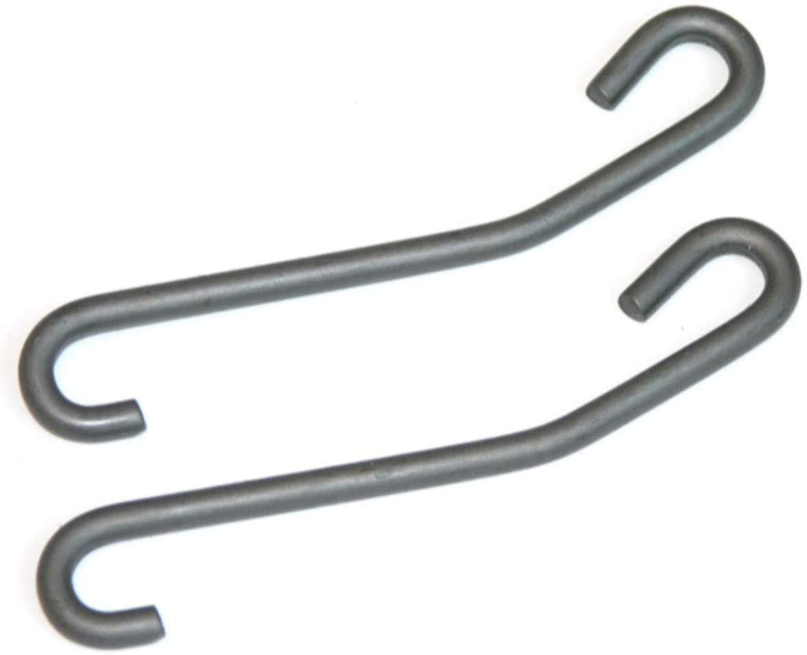

    Try making up some hooks that will hold the cable off the exhaust pipes. Have to be fairly substantial, much like you'd see on an early Camaro, Chevelle, etc.

    Would they be isolated or directly mount to frame?

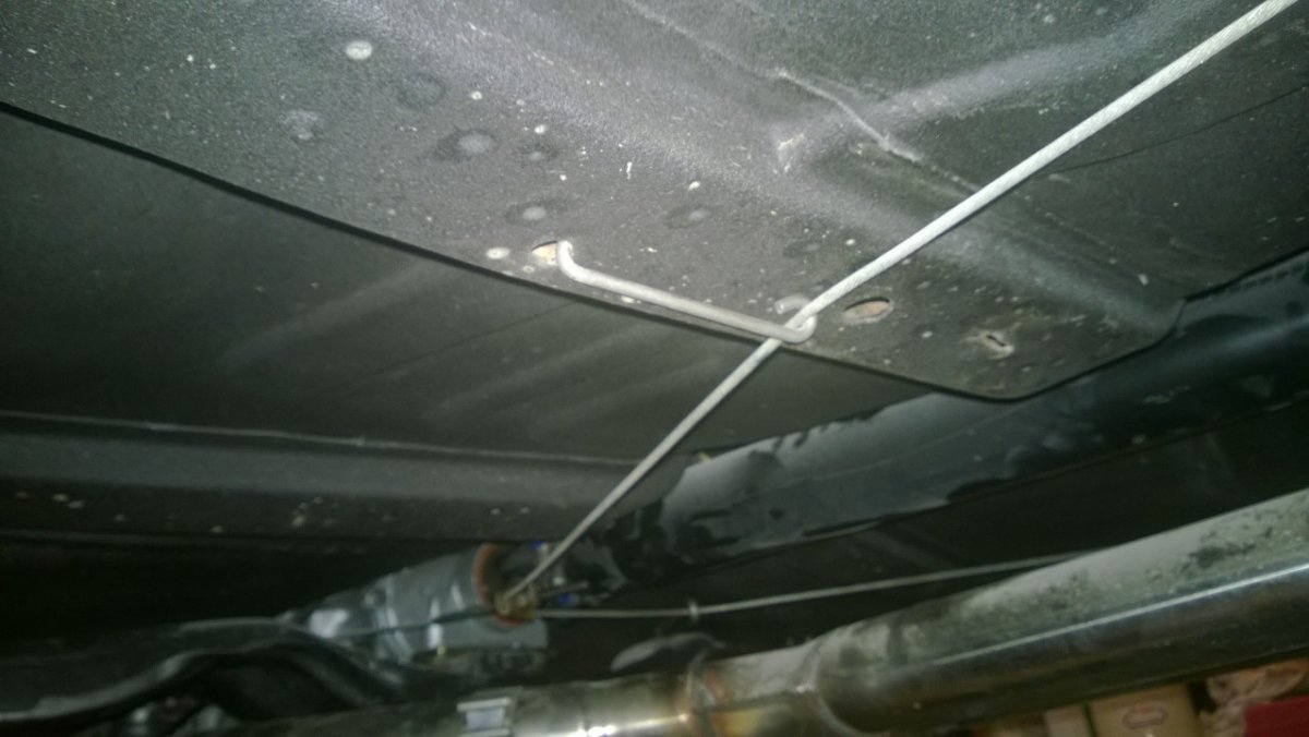

    Direct mount the the ch***is ,but attached so they have some movement. These are for a 64 - ? Chevelle E brake cable hooks.jpg E brake hooks installed.jpg

    Those might work, I don’t have a lot of steel cross members between the rear and the handle! But I can fab up something! Thanks for the help!

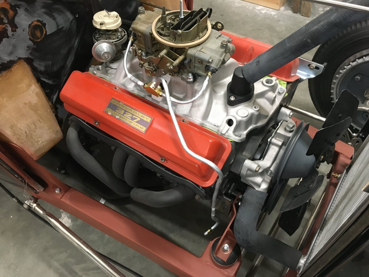

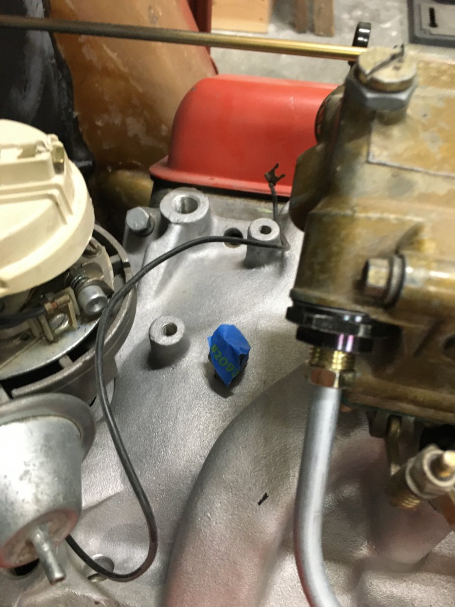

    1B481FE7-2EDA-49EF-97F4-7D9DE9382DAC.jpeg E418937F-375F-4A4B-929C-C2DBBA6EFFF1.jpeg Got some work done today. Modified the intake, drilled and installed a 1957 Chevy truck oil inlet tube and drilled and tapped a hole behind the carb for a vacuum source for the PCV system! All by hand, fun! Next is the parking brake cable routing and install.

    Not sure if you already plan to run some kind of a baffle inside the intake, but it will **** the oil right out of the engine of you don't. "Been there, done that". ;)

    I plan on running a windage tray in the lifter area and a small baffle under the hole! I hope that will work? Thanks for the advice!!!
