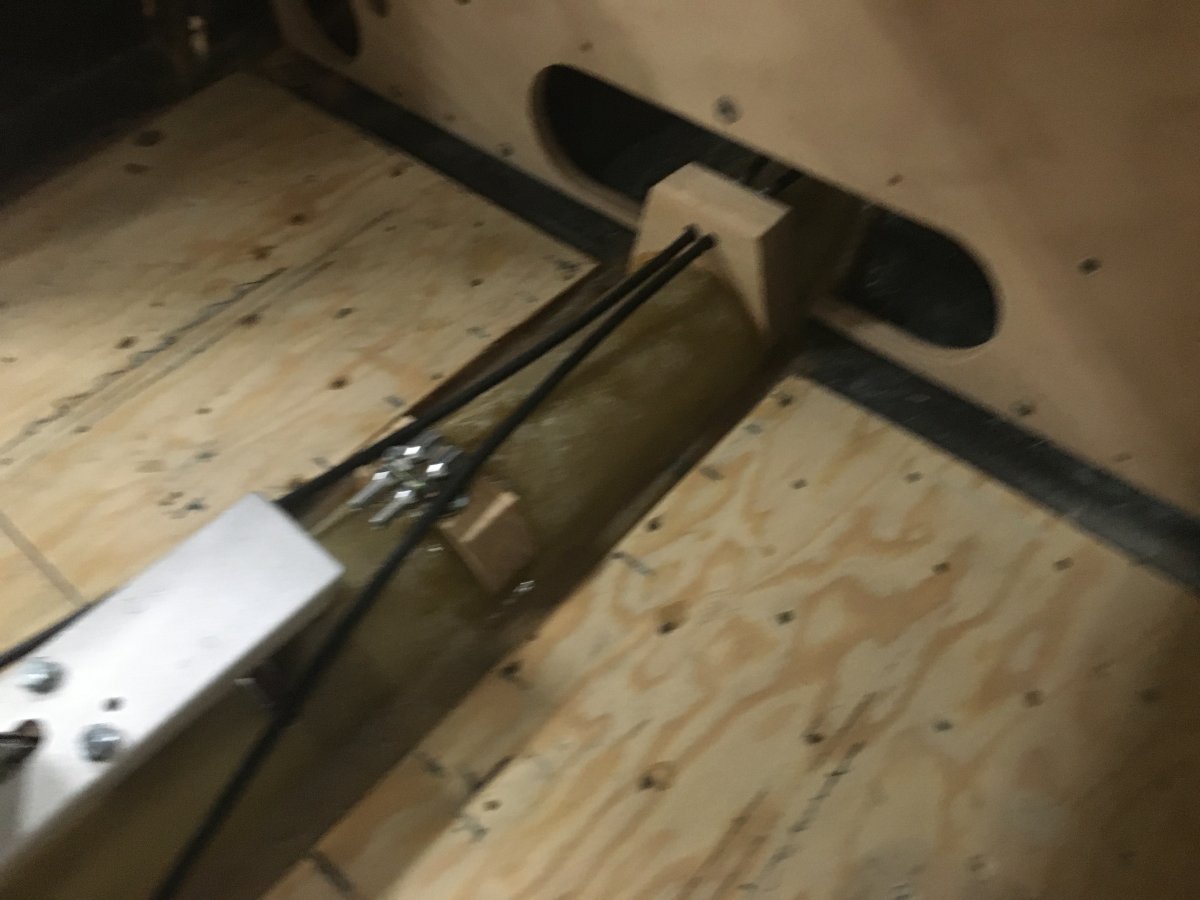

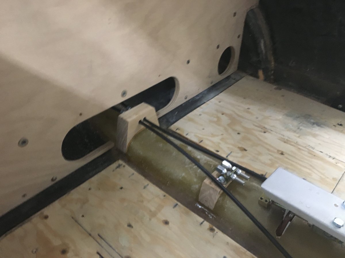

  4. Splitbudaba
    Joined: Dec 30, 2014
    Posts: 994
    Splitbudaba

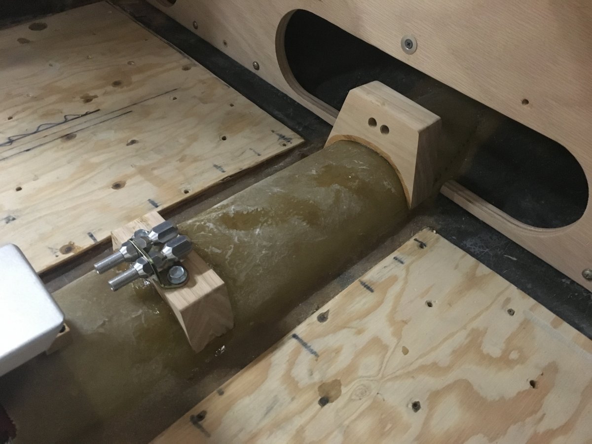

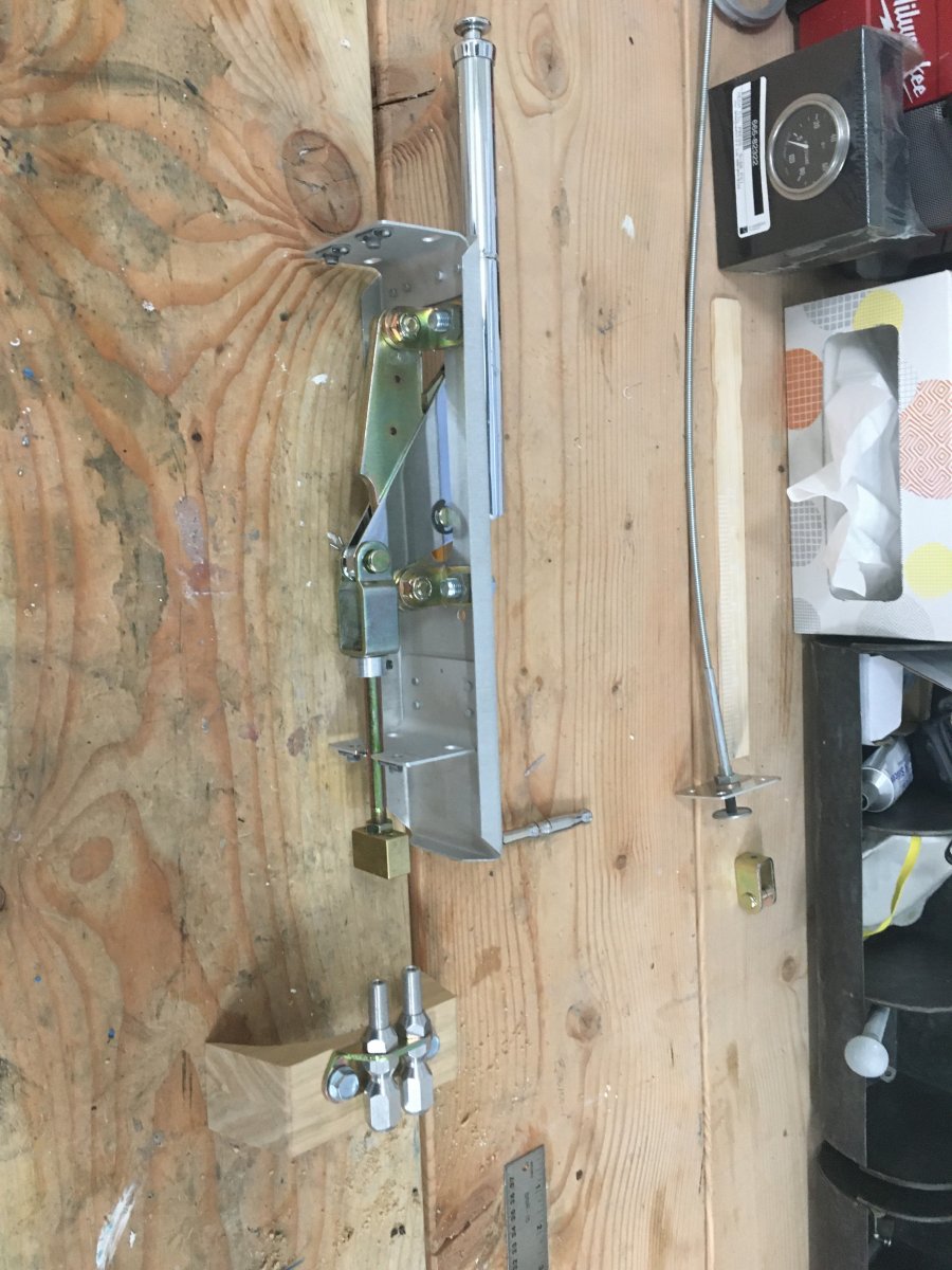

    C108B55C-DBF4-4B83-9FF4-E118CF5FC601.jpeg 07C483FF-F701-4927-B402-8D08D4310013.jpeg F5069503-0F3F-4997-93EC-EE9031928AB6.jpeg 7EF2C4ED-4989-44CF-BAA5-7124BF8B25E5.jpeg Got to work on the parking brake install. Fabricated oak stand offs with attach bracket. Gl***ed them into place with hidden fasteners in from below! Routed cables forward and then aft to go through the floor in a blister area for the quick change clearance, then through the aft block and finally up to the arm. Next I will secure the cable routing underneath and cut and install cables! Wow I might actually have mechanical brakes in the rear!!!

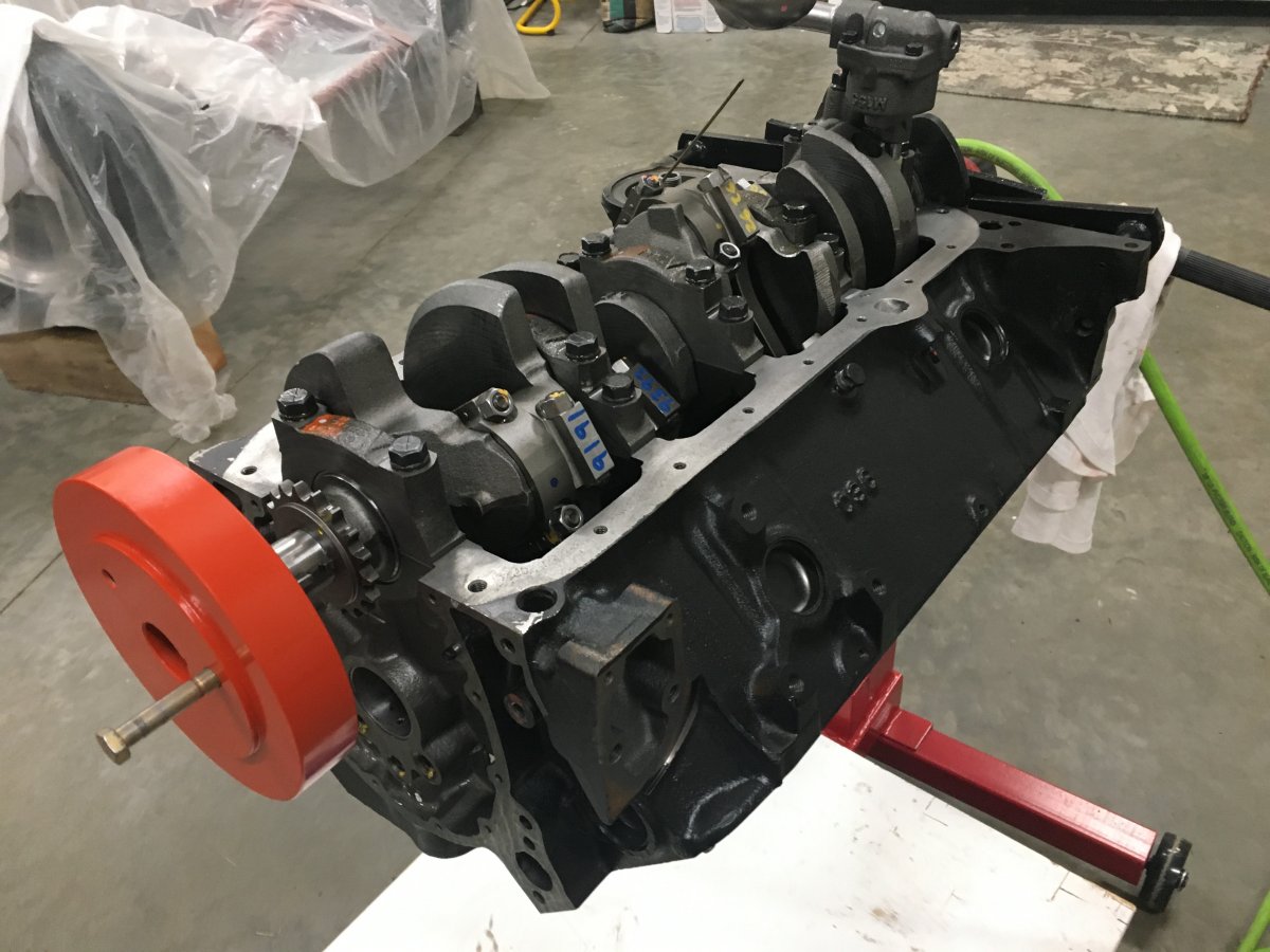

  8. Splitbudaba
    Posts: 994
    Splitbudaba

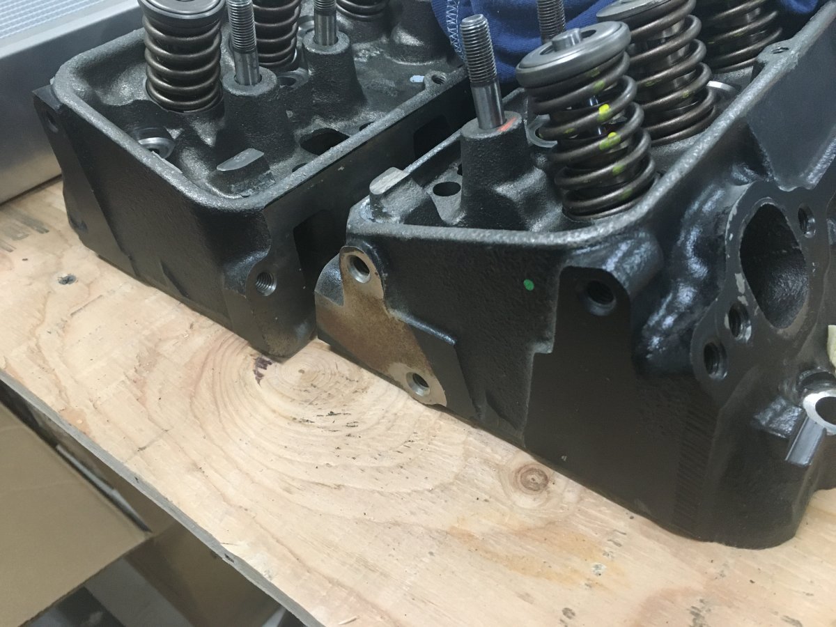

    99A580C9-0CEC-4559-8F65-8B2AB95A2043.jpeg Finally made up my mind and started on the crate engine mods. I am going to pull the heads, replace the valve springs with Comp Cams 981-16 springs. While it’s apart I am going to match port the heads and unshroud the bowls. The block will get a Comp Cams Thumpr cam and new gaskets and paint. What will help are the steel shim head gaskets that I plan to install. That will bring the compression up to 9 to one from 8.5 to one. Should make it a fun little hot rod with a mid weight flywheel and a quick change with 4:11 or whatever I decide to try!

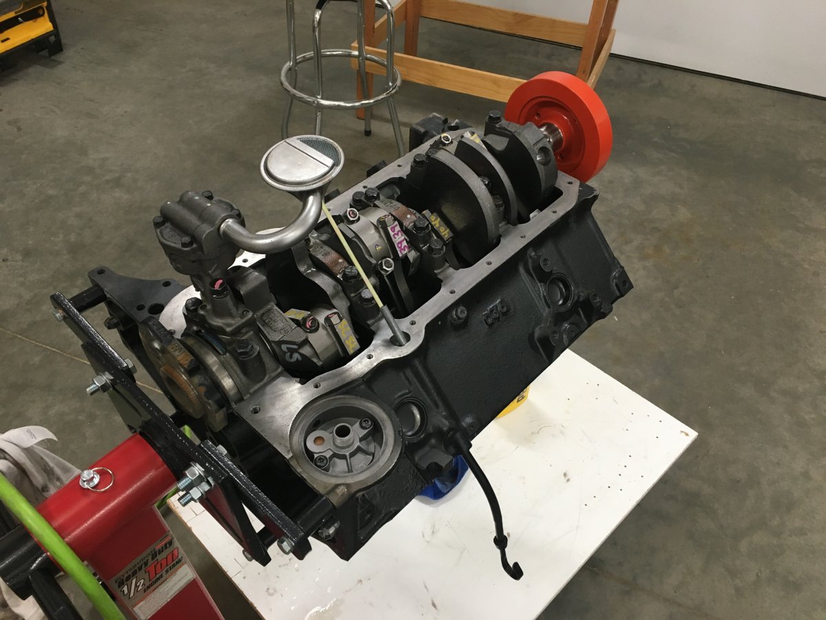

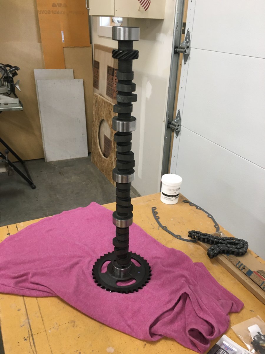

  9. Splitbudaba
    Posts: 994
    Splitbudaba
    045F98F0-52C0-4101-A224-56083CDF6D7A.jpeg D5303C69-D69E-4D2E-AC97-454DA56E0182.jpeg All the go fast parts are on the way! Some have arrived. Time to get serious! Pulled the motor/bell and trans. Motors on the stand, pan and timing cover are off. Stock cam is on the work bench, Thumpr cam about to go in! Wow starting to get exciting!! More pics to follow! Check out my one bolt retention on the front leaf spring mount! Might use it permanently since the front axle has a panhard bar!! Good or bad? Any opinions will be appreciated!!

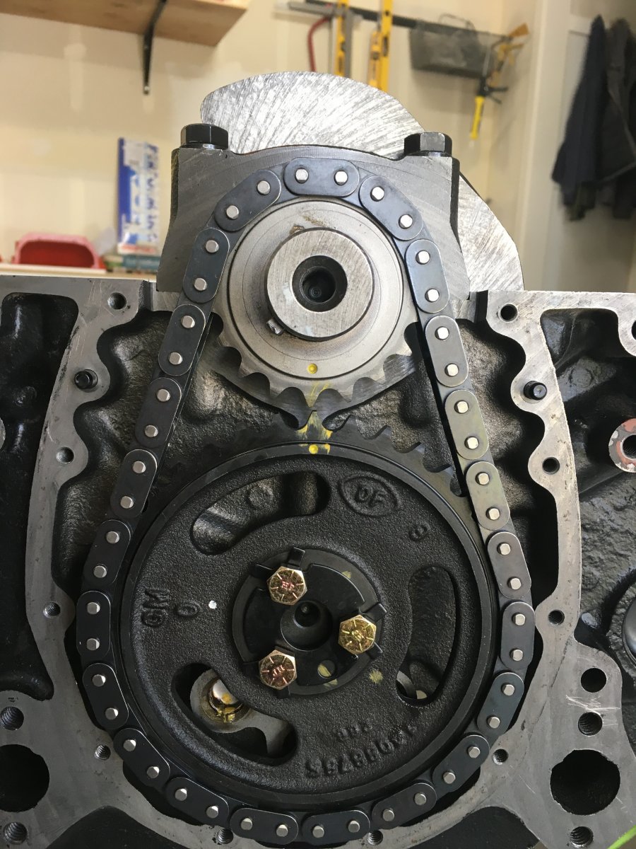

  16. Splitbudaba
    Posts: 994
    Splitbudaba
    903BD5E1-52A8-4634-B22A-0546C7BA6A51.jpeg 1586E342-E5B0-4ABB-89CD-82C42DEDC1F9.jpeg 510A1EA3-1E2E-40FA-90CE-7DD02C481A5A.jpeg 657ED95F-F5E4-4430-9BDF-6E7285AB2DDD.jpeg Had a great day working on the 350. Thumpr cam is in, pan next! Tabs are bent over on all 3 bolts, I swear!!!

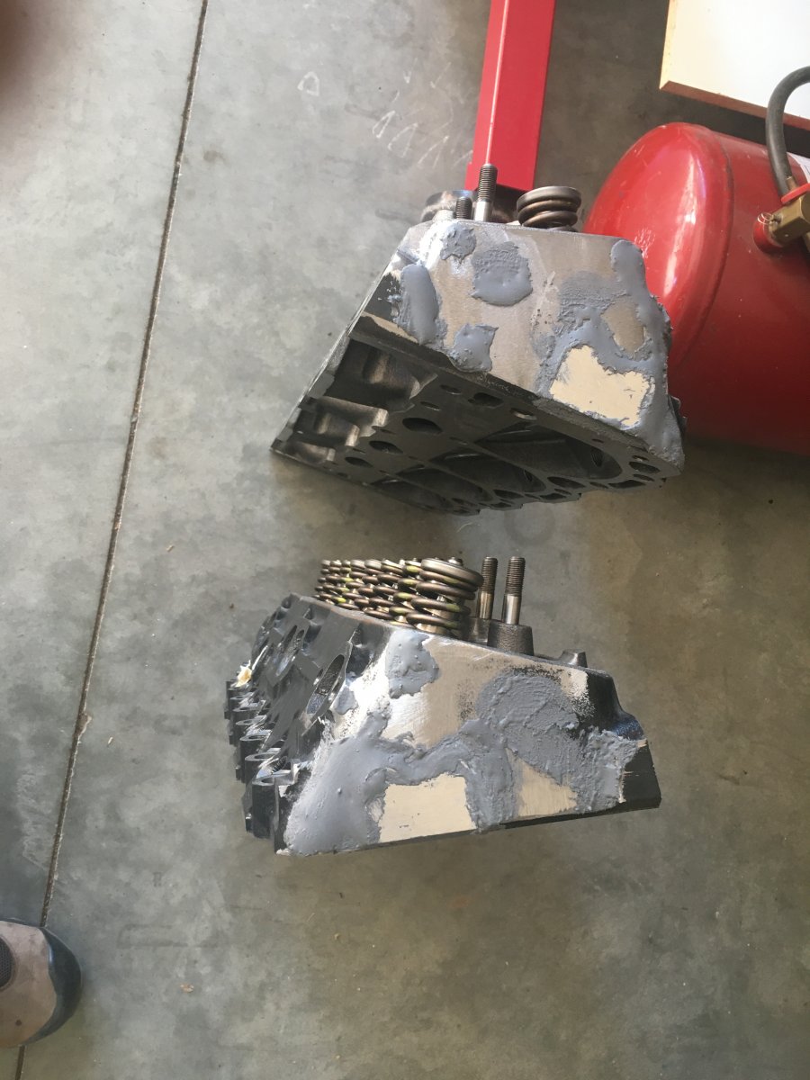

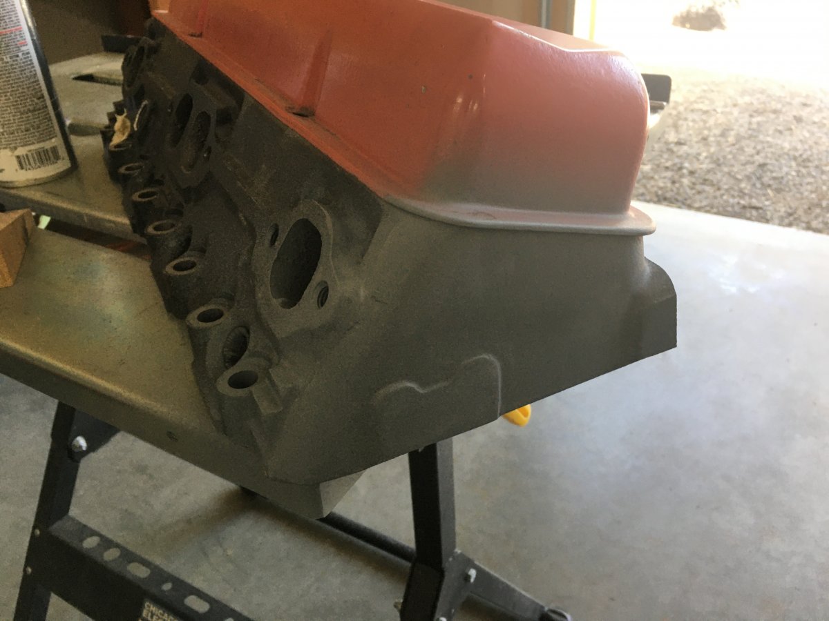

  17. Splitbudaba
    Posts: 994
    Splitbudaba

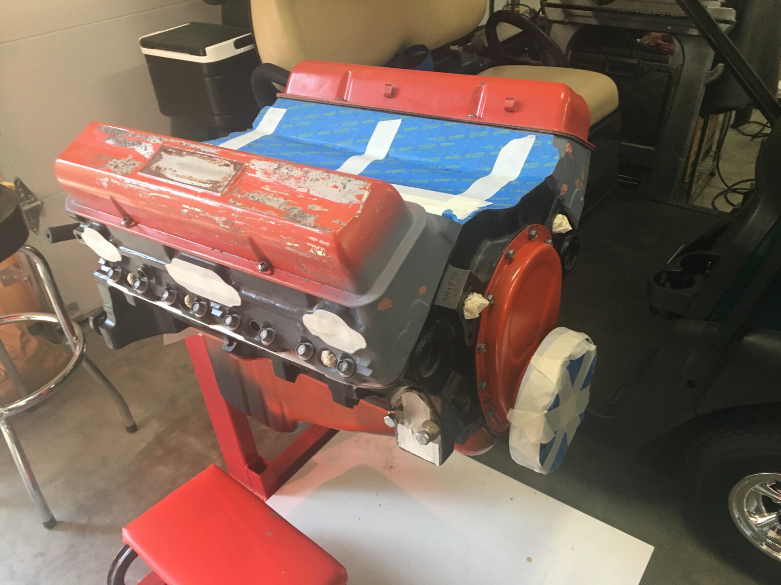

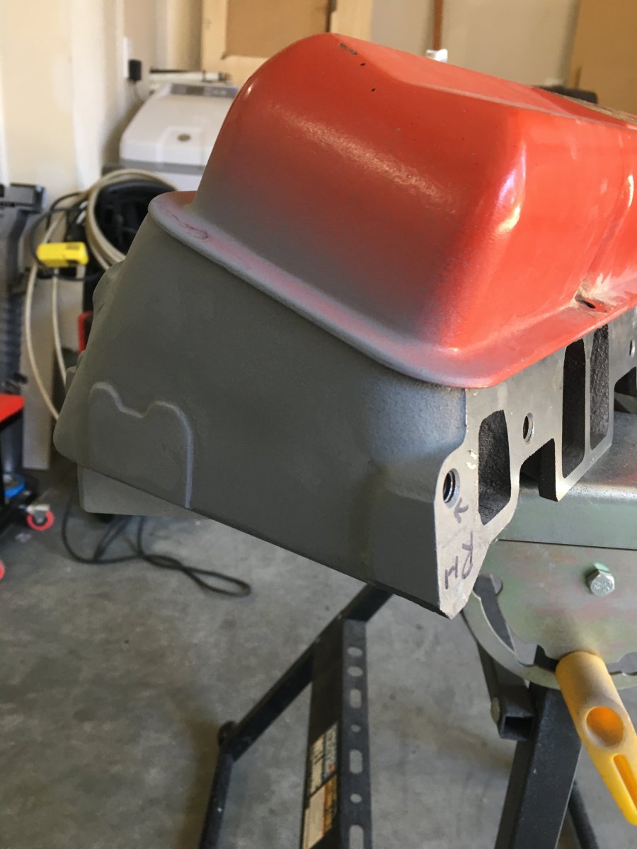

    It’s been awhile, but I have made progress! Short block is all together. Changed valve springs and reworked the front of the heads! I have about 5 hours of grinding on both heads! Had to have camel bumps, however all new heads , good seats and valve seals were hard to p*** up on! I am also using thin steel shim head gaskets which should give me a 9 to 1 motor!!
  18. Splitbudaba
    Posts: 994
    Splitbudaba
    B328057A-0899-4FC1-B985-7C090088908B.jpeg Got the long block together and ready for paint. Fake camel humps came out well!! Now for the trans and in it goes!!

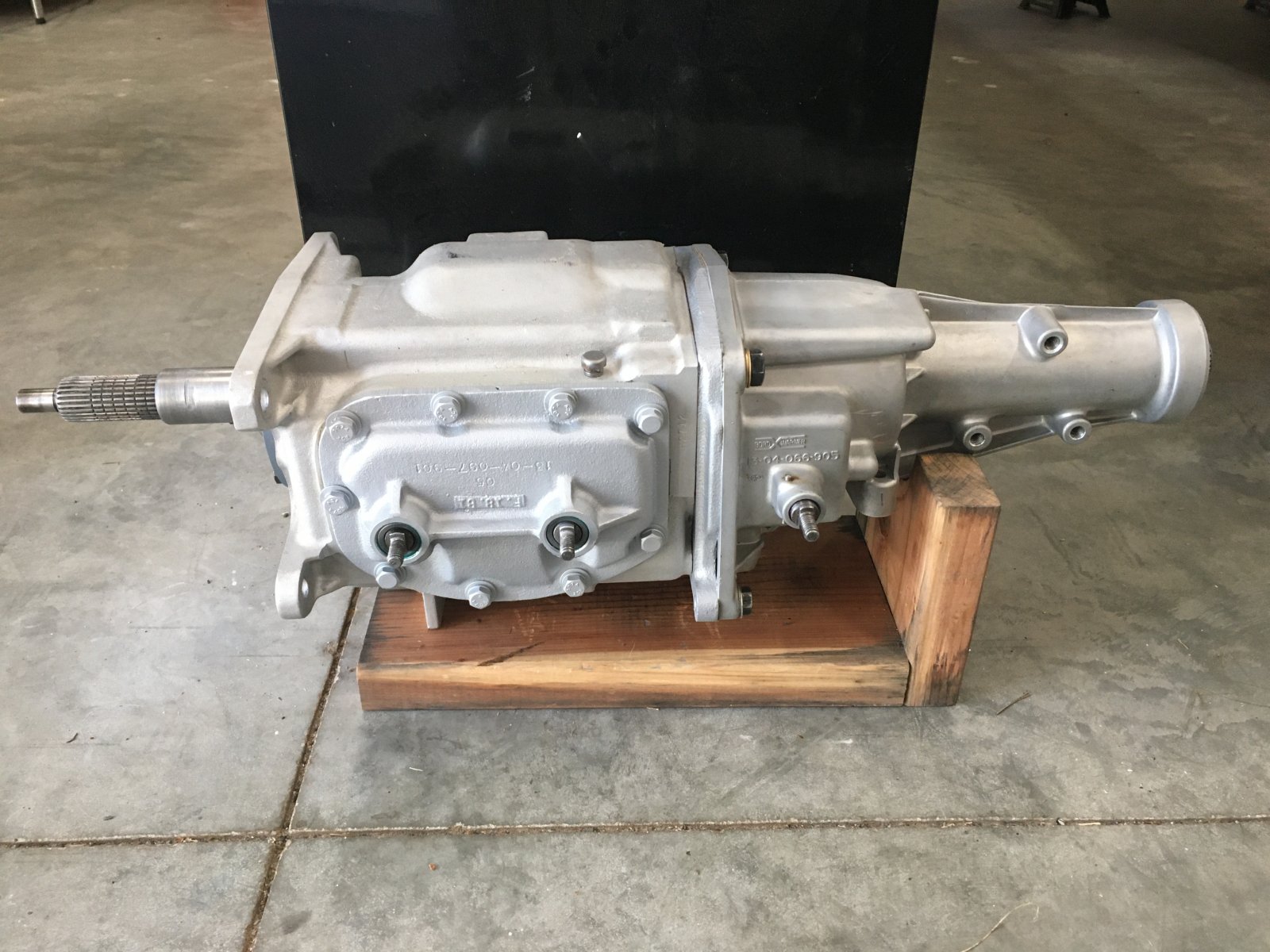

    Started to put my T10 back together after 4 years! Thank god for YouTube. There are two speedo gears available, I have the white one, what’s the difference/advantage when using the blue gear which has less teeth? Hope to put the completed engine/bel housing/ trans in next weekend! Time for a wiring harness, any suggestions?

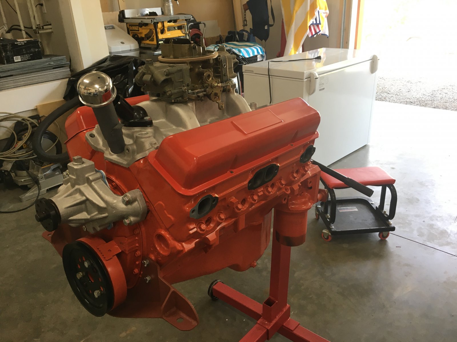

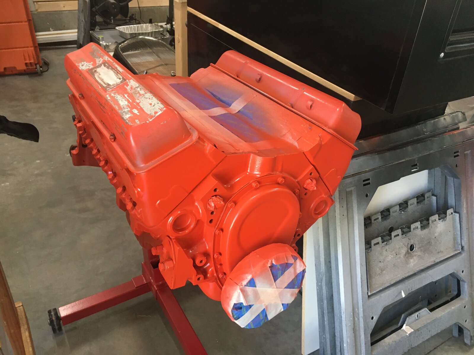

    2593C036-A8E0-4E0B-9803-123075B9DD64.jpeg Sounds like American Autowire is the way to go!! Like the name too!! Made in the USA I hope! First coat on the long block today, and afew parts on order for the T10. Might get the motor and trans in soon!!

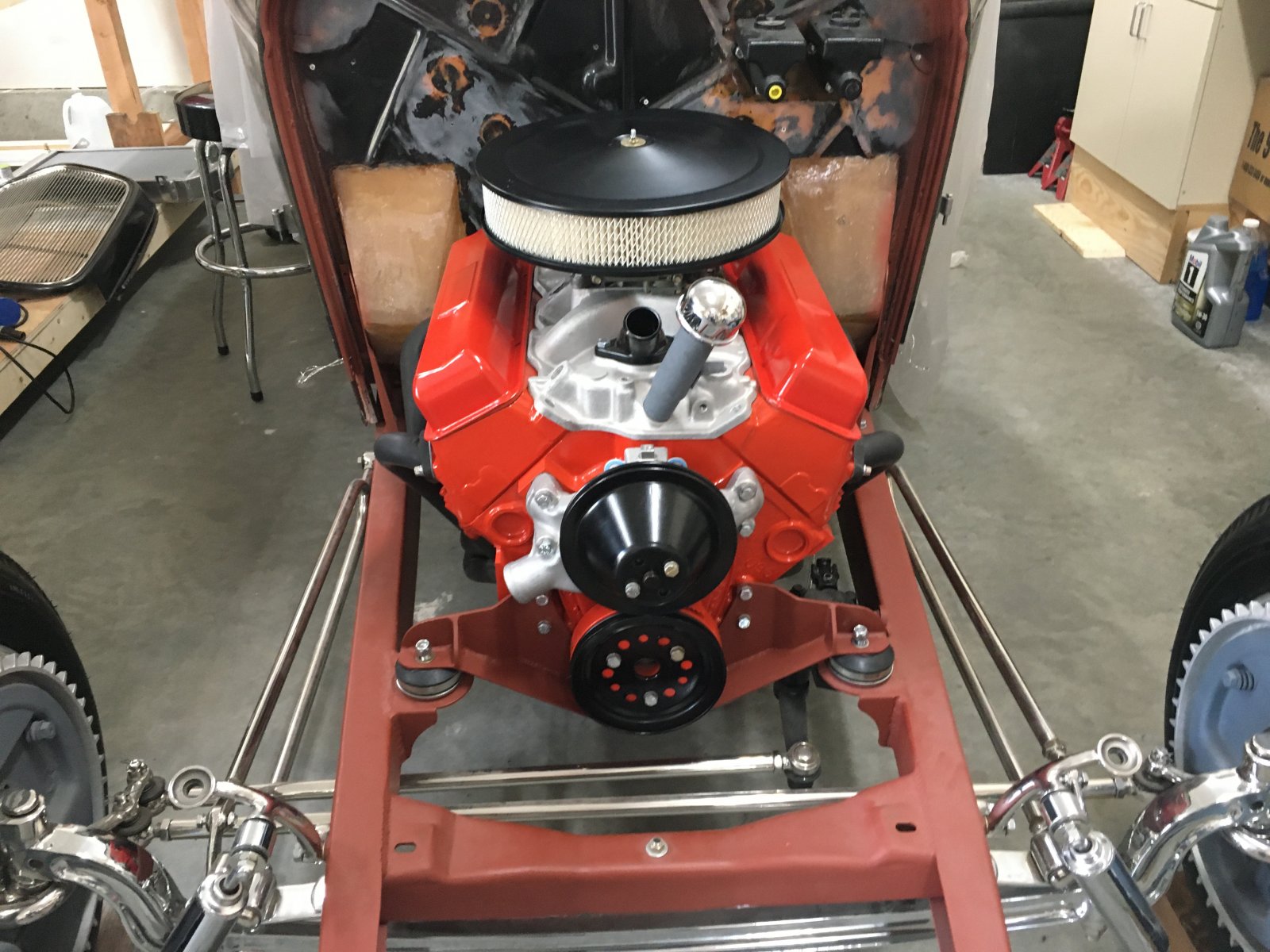

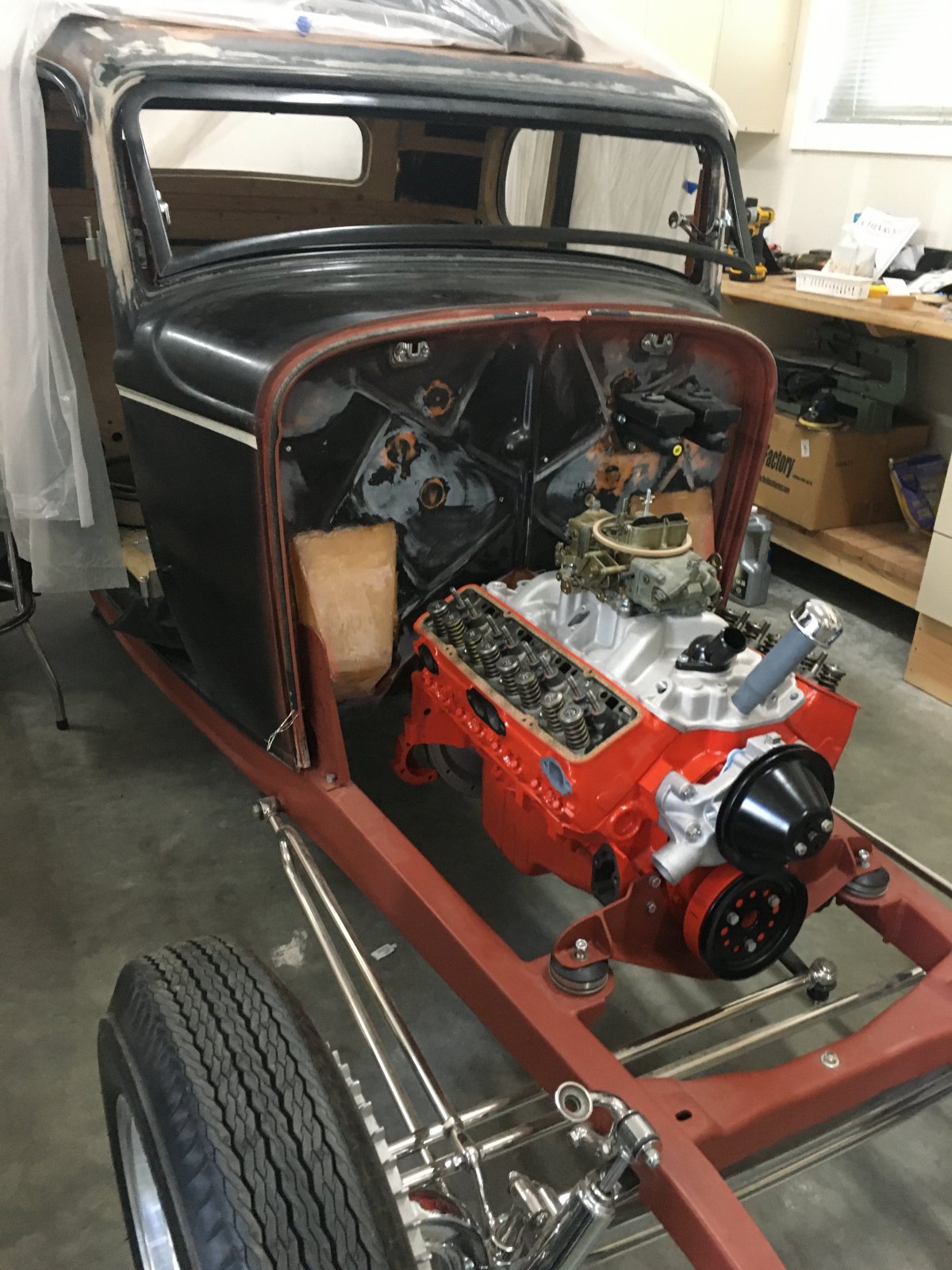

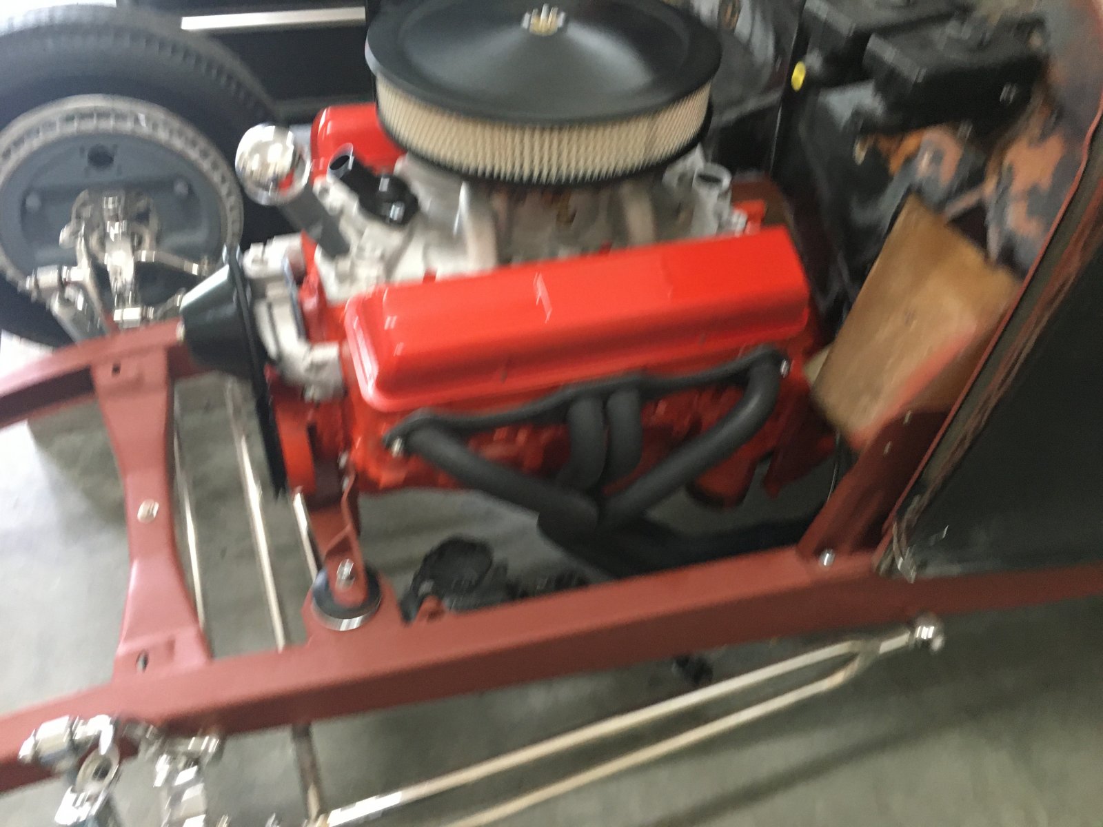

  27. Splitbudaba
    Posts: 994
    Splitbudaba

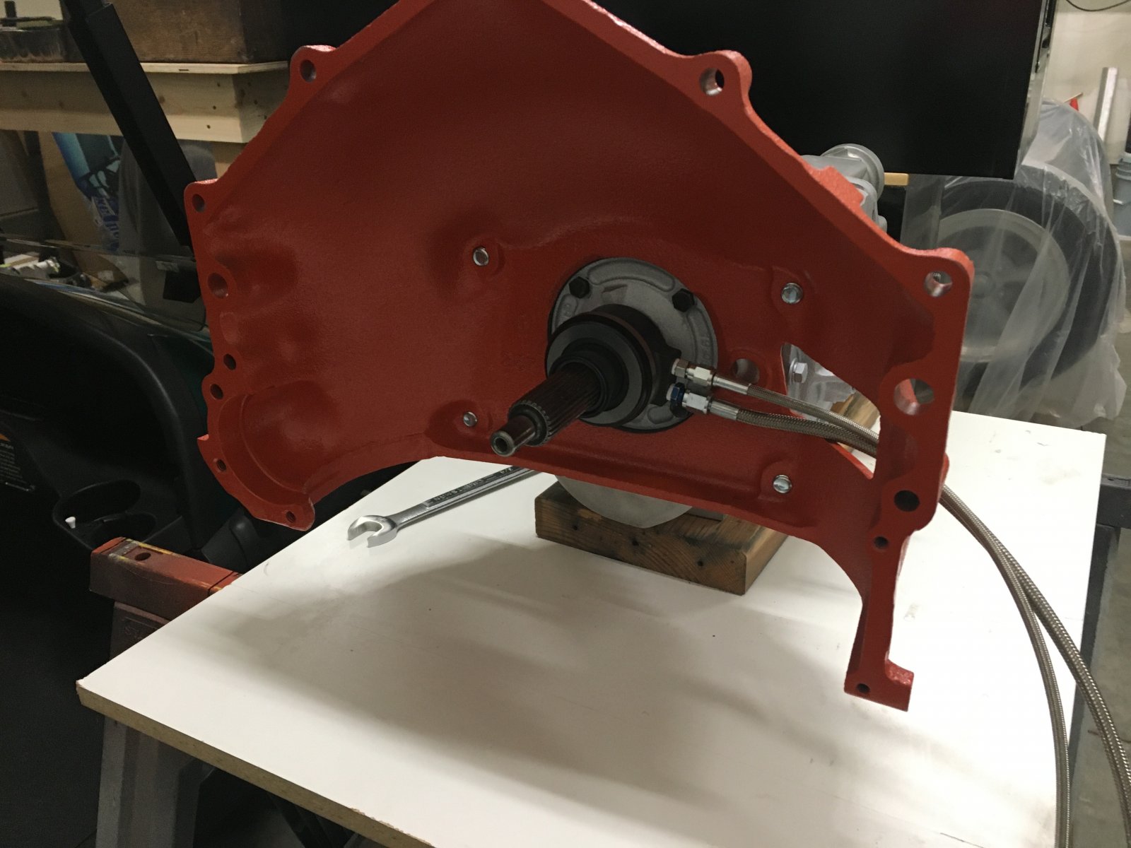

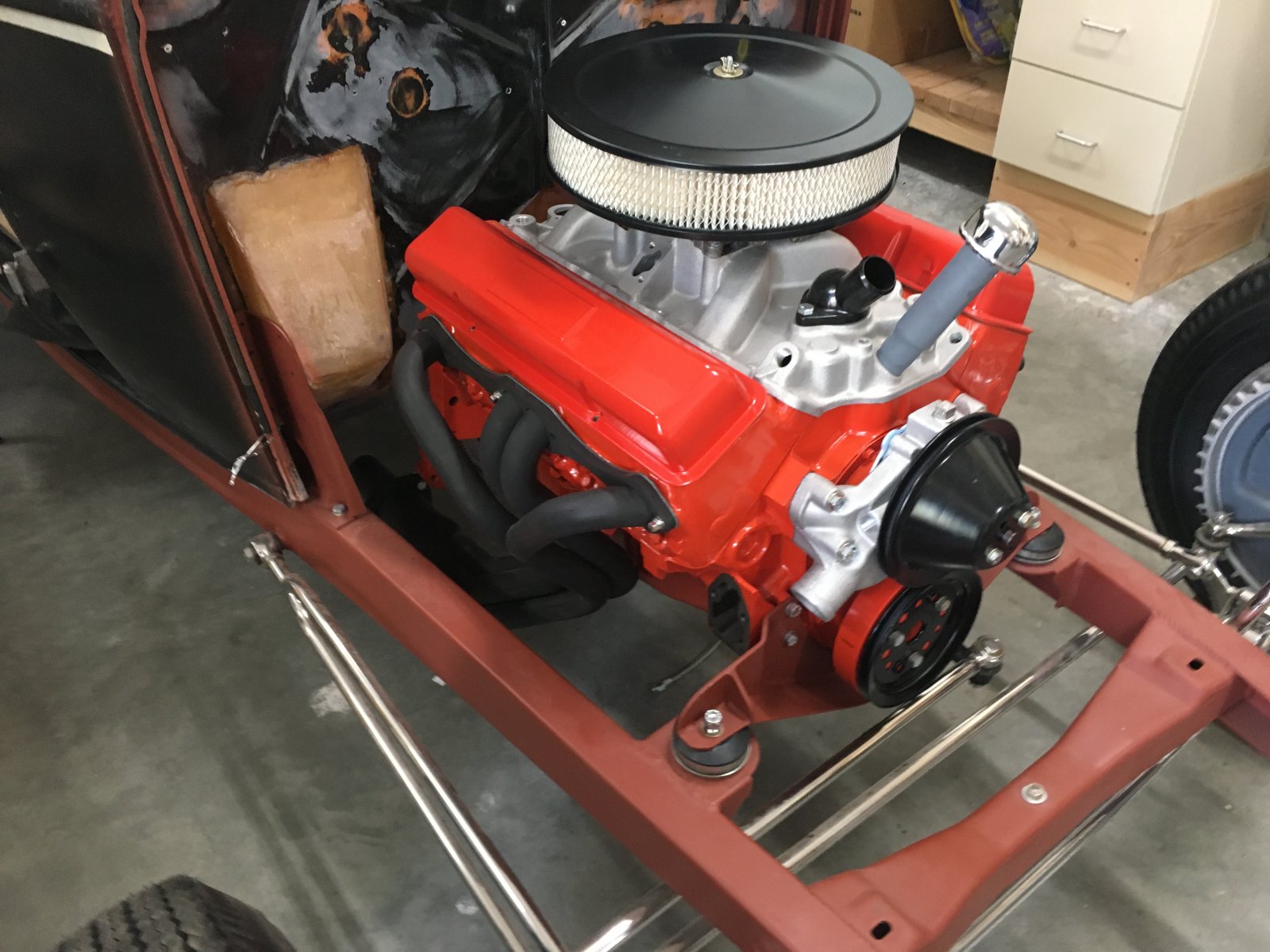

    271C1047-6257-4686-B84B-9AAA01BBB233.jpeg 7AF370A8-F0A0-4DA6-B36E-F2CC2E812EB6.jpeg Getting closer to going in the ch***is! Detailing takes time! Also rebuilt my Super T 10! That was fun considering it’s been over four years since I took it apart. You tube and Google got me thru it, but the true test is yet to come! Measuring for my hydraulic throw out bearing and new clutch!
  28. Splitbudaba
    Posts: 994
    Splitbudaba

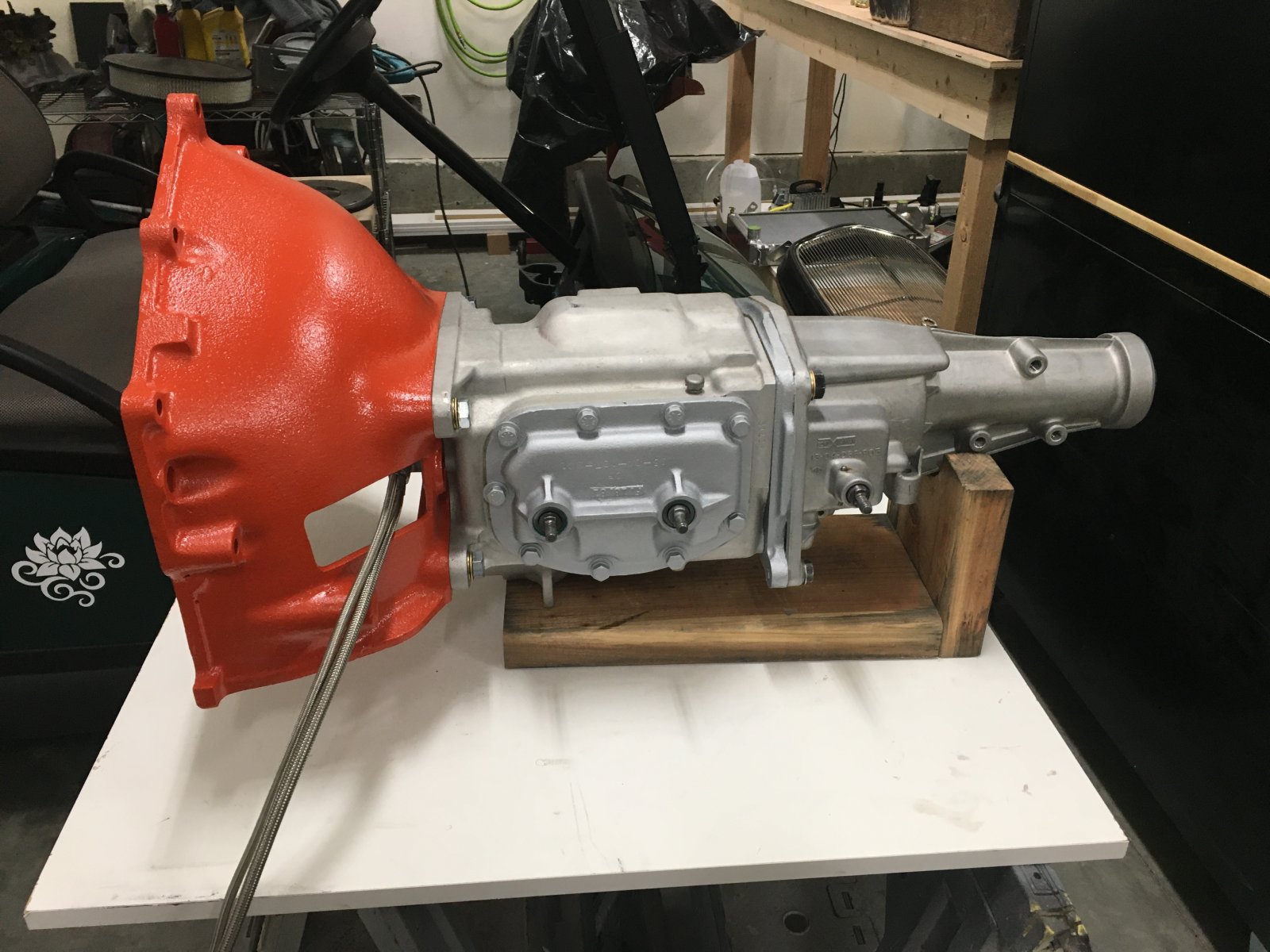

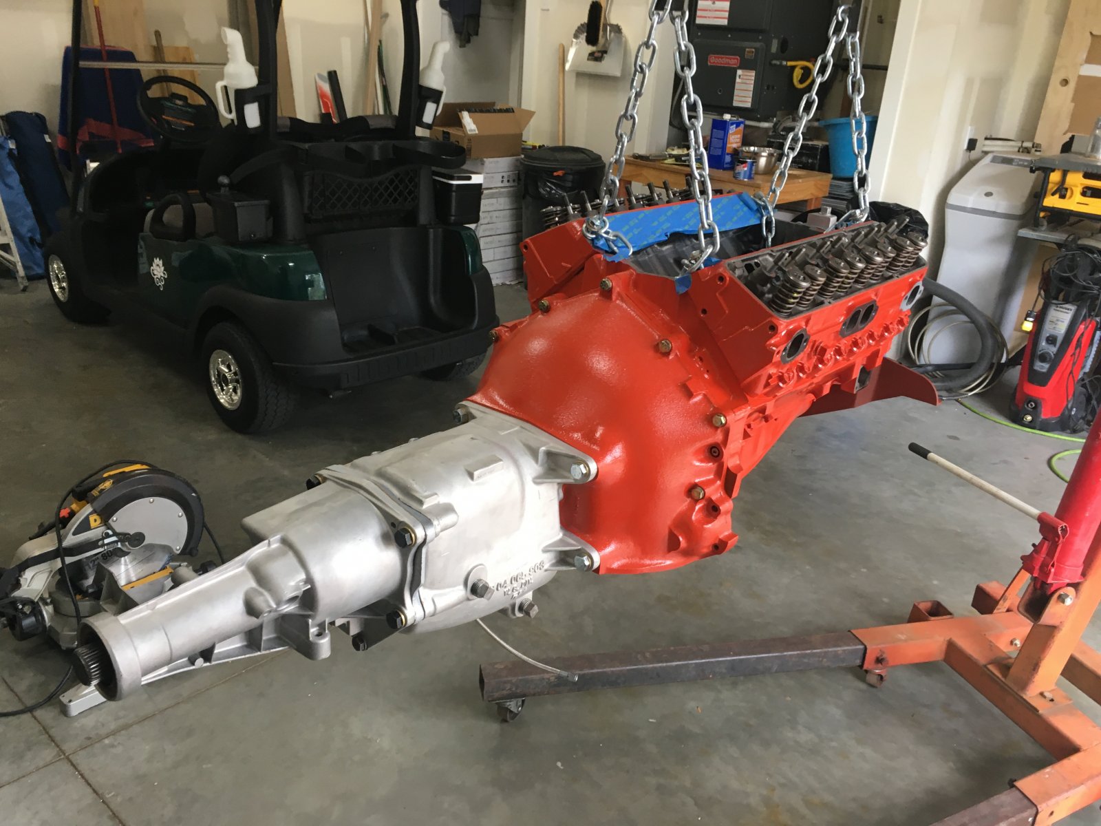

    D04B5721-7AE9-42AD-B0ED-0655378187A2.jpeg B2237E86-AF33-4435-A105-9E9F0383C55C.jpeg FEC56B26-85C5-4550-931C-BD9D0159A61E.jpeg Got the throw out bearing clearances figured out! Might try to couple the trans/bell housing to the engine with the clutch/flywheel/engine ***embly using with the engine on a lift and trans/ bell on a table! Then slide it in the ch***is!! Oh yeah, found a throw away kitten, turned out she’s a great little girl! Ellie is here name!!

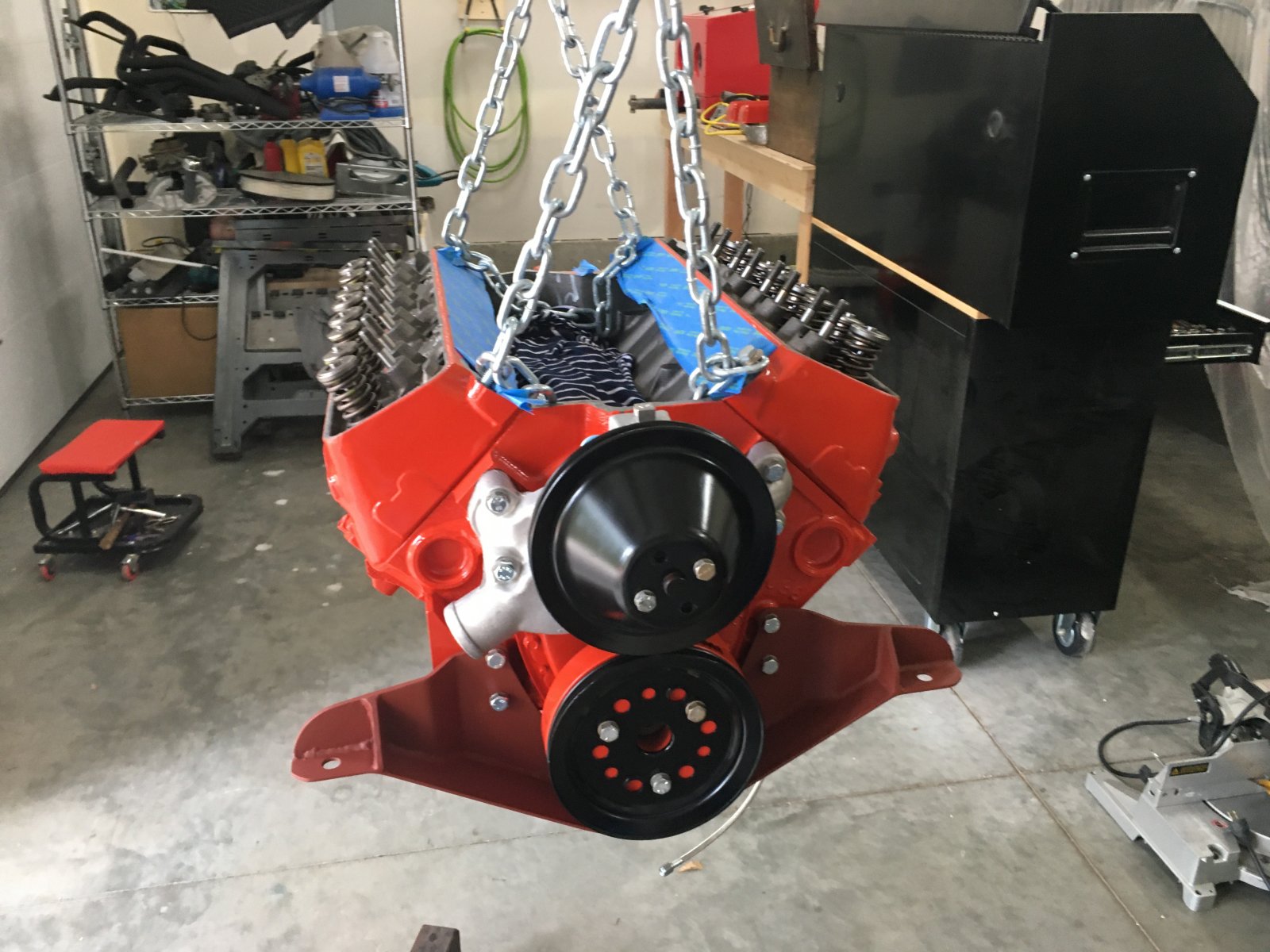

  29. Splitbudaba
    Posts: 994
    Splitbudaba
    6231C7A5-BBB1-4841-B3D0-AEEEB5EA679E.jpeg 5E3B072F-99B7-4293-99A0-7C663741918D.jpeg F3A77A31-50E7-4E9C-A2D8-4D17516CC370.jpeg 792FD2AA-6A08-4BBA-870B-E5905AD88006.jpeg 48F50111-1A0E-422E-B8D6-9ED272C71E13.jpeg 3B24445D-DCD4-4B13-9AFC-547E733005E6.jpeg Must be a good day!! Engine/ flywheel/ clutch matched up to bell and trans on the table on the first try so in she went!! Big day!!
