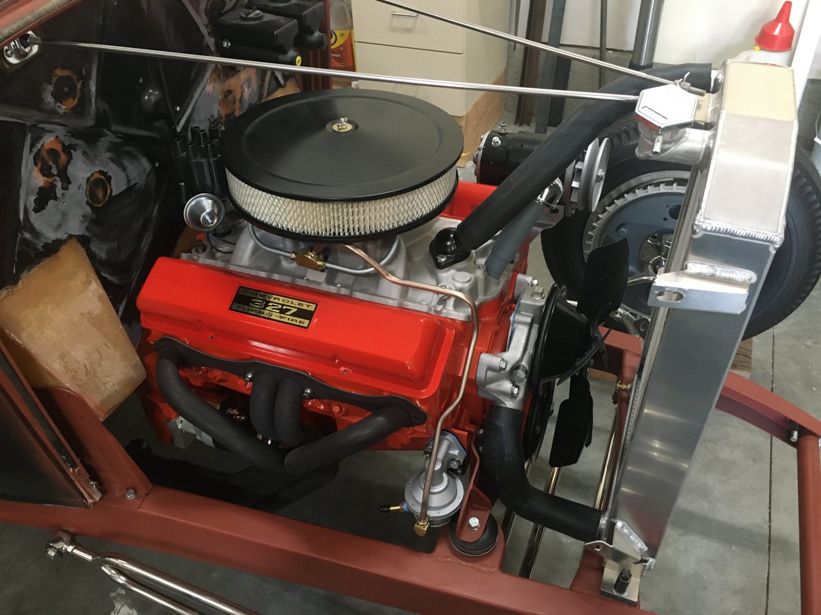

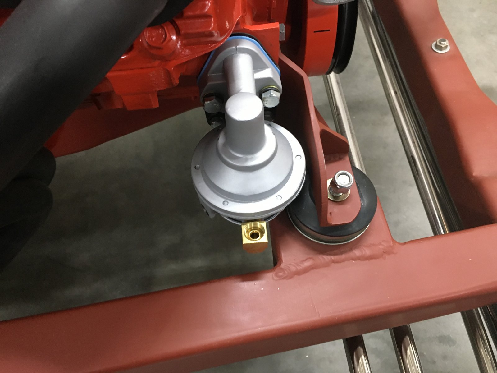

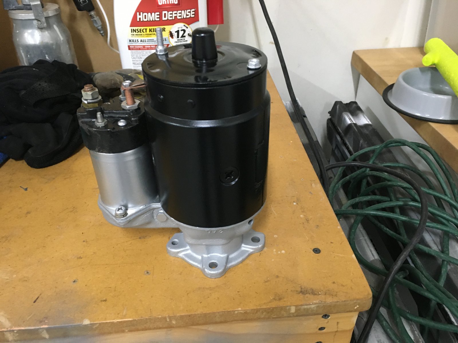

    5D03D363-C5BC-4141-BD6F-EE0772B6FC4B.jpeg 1887B4EC-B678-43F0-B499-2C1D6C71A196.jpeg 6488DE6E-CD88-45E9-BACA-B232B0D7C3CD.jpeg I have been working on the accessories. Fuel pump, shields, and starter are complete and ready to go! Generator is cleaned, painted and ready to ***emble! Working on fuel lines and distributor!

    BE5C2752-93B3-4ABC-BDF4-824C93D56964.jpeg Learned a hard lesson yesterday, tried to install the 57 Chevy starter I rebuilt and tested! When I put it in and installed the first of three attach bolts, something felt wrong. The GM crate 350 has provisions for a dipstick on both sides. That would not let the stater bolt up to the bell housing flange! ****, also found out my headers wouldn’t clear it either! So I ordered a new high torque mini starter from Speedway Motors! Does anybody need a fresh rebuilt starter, nicely painted and bench tested! Make me a reasonable offer and it’s yours!

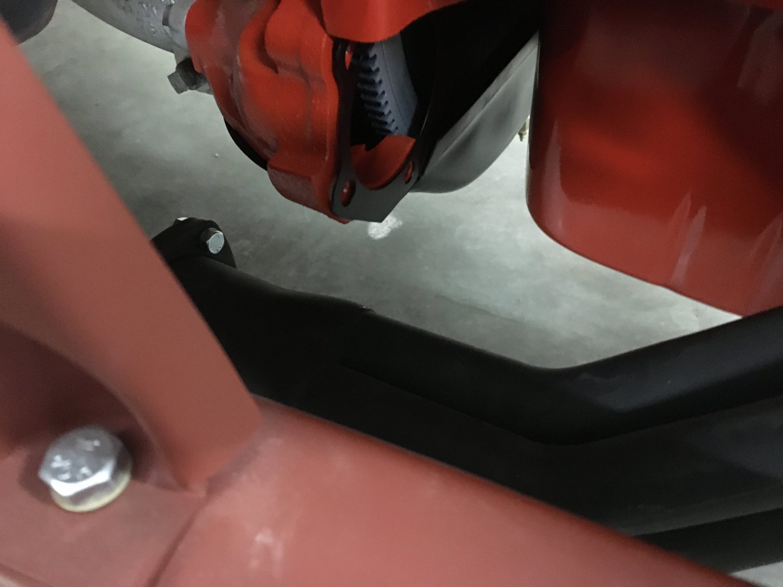

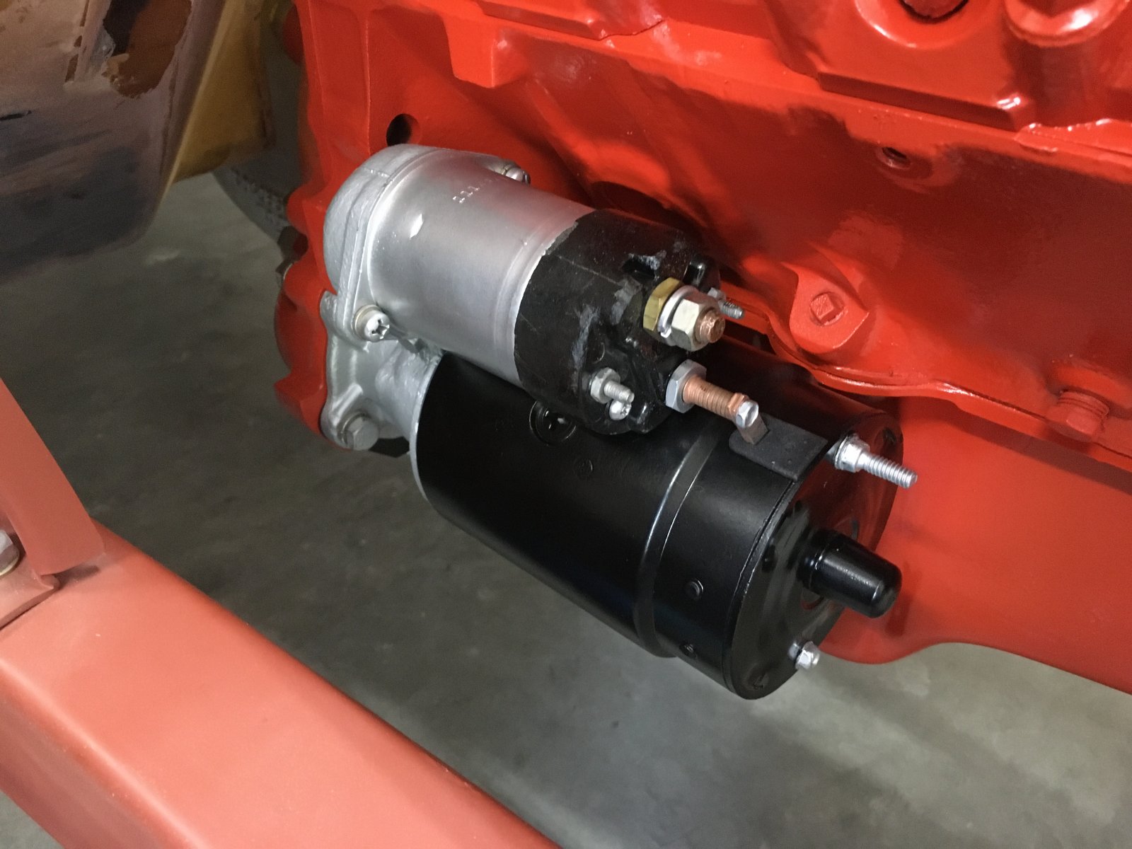

    3AFBCE21-7792-48FE-9769-8F79C1BEF840.jpeg C8C96278-73B9-4D6D-BB21-AD8DD728419E.jpeg F9CB39DE-585A-4503-870B-86571818144E.jpeg Installed the new mini starter. Loads of room. Had to modify the bell housing dust shields and rivet both pieces together. Goes on as one unit, worked great! Every thing is bolted in, all clearances are good! Need to finish the fuel line and mount the generator. Waiting on parts for the distributor, then it’s the carb!! Soon!!!!

    AC108D57-E0E2-4330-8C79-DA3DC9AFAB1B.jpeg A8BA0517-572C-4093-BB75-4D692B6B4EFE.jpeg Well, I have been working on all the accessories, lines, and mounts. So far, so good! No major issues!! It just amazes me how each part needs to be tweaked just to fit. Oh well, guess that’s the definition of Hot Rodding!!

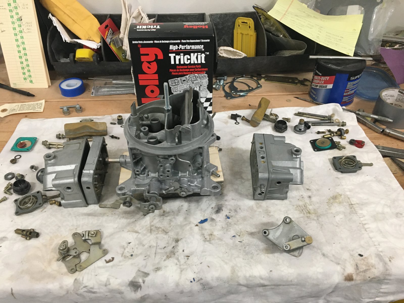

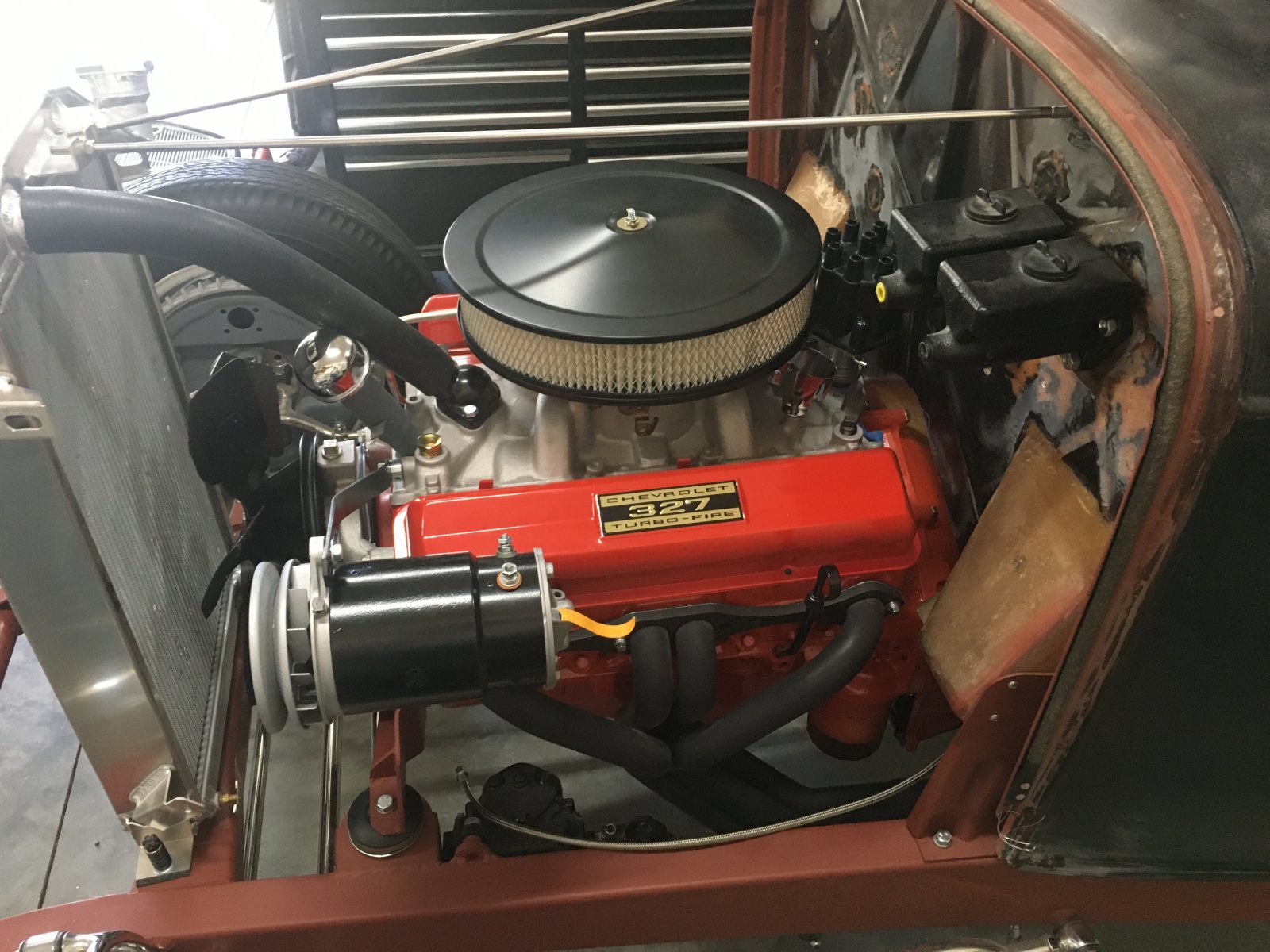

    30ADF352-A229-4CAE-89DB-045925E5CAE3.jpeg Time for the carb! Dis***emble, then to the gl*** beader! Seems the previous owner tried to paint the main body! After several hours in the beader, and a lot of lacquer thinner thru my hvlp spray gun and then 100 psi blow off and dry! Time to ***emble. The beader made it look better! I priced sending it to Holley to re coat, not in the budget. So guess we will see how it goes! Might paint a few steel parts and see how the other pieces fair in use! Any ideas would be appreciated!!

    Praying you got every last piece of blasting media out it!
    I'm sure the price has gone up considerably but the OEM 327/350 hp carb for my Nova was completely restored by Holleys' custom shop, a few misc. missing parts were fitted then the body was dichromate coated and test run in the late eighties.

    Thanks! I love to do all my own work! I just hate paying for someone else’s education!! And I am a little worried about blast media too! Bought a set of tiny brushes and I probe all p***ages with .020 stainless safety wire while blowing air through the port! Time will tell! Watched some YouTube videos about painting it and decided that’s not for me! New digs

    Yeah, no, the lifters , pushrods and rocker arms go in soon! Cam is coated with break in oil. So I will dip the lifters , install them add pushrods and rockers. Lifter are dry, makes setting the valves a breeze!! Good eye!! Wasn’t sure how long it would sit before initial fire up!

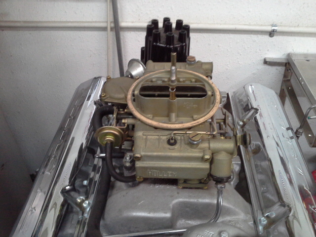

    Probably a little too late now, but you can get this stuff called alodine and dip your carb in it. It will take a few dippings to get the gold color, and you absolutely wanna wear gloves and keep it in a safe place, but I dipped my 2 Jets in it years ago after being blasted, and they came out decent. Lemme see if I can find a picture.

    I remember using that stuff in aviation years ago! I like the look too. Next time I pull it apart I will get some! Many thanks! Gloves required!!!

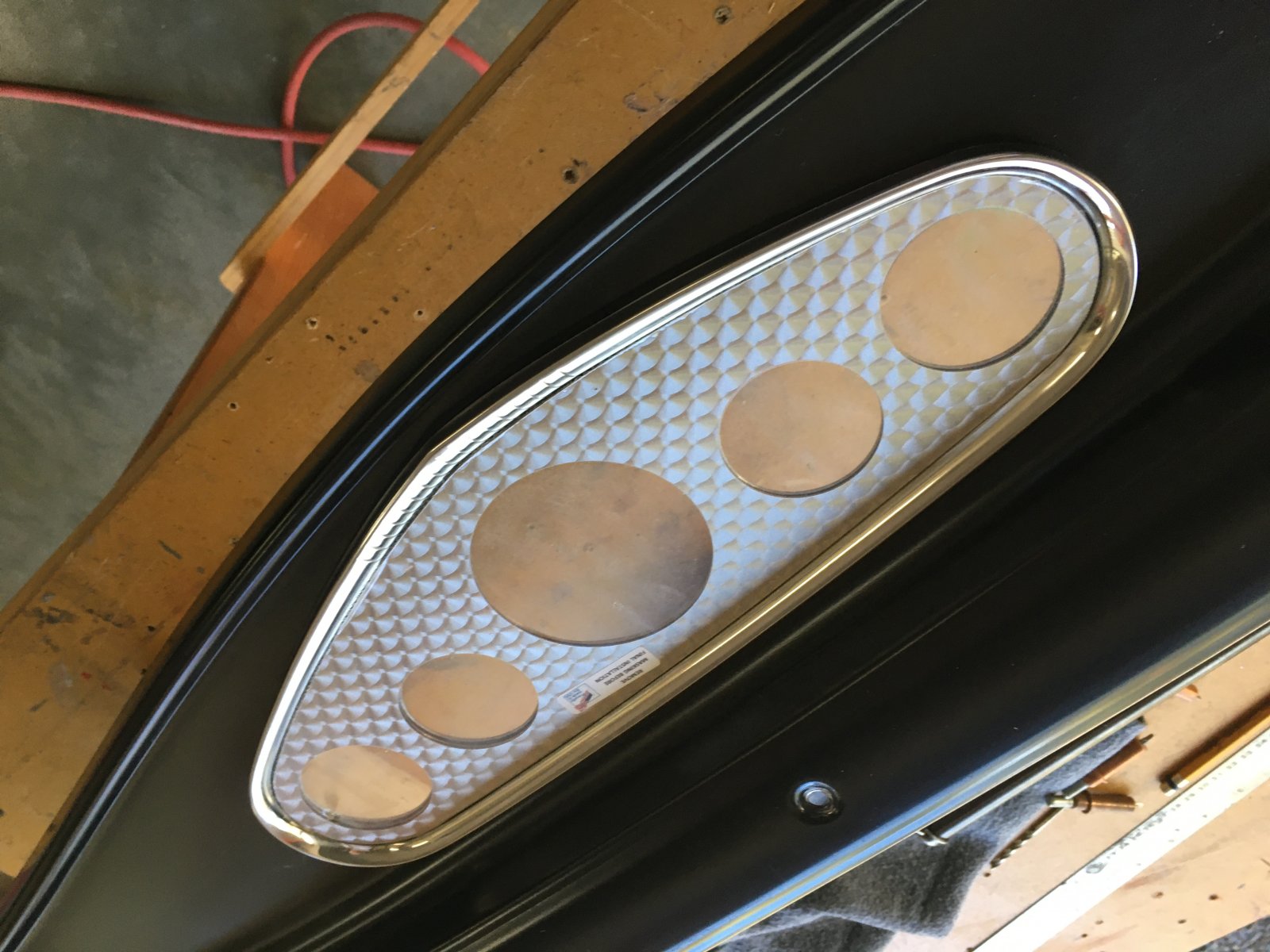

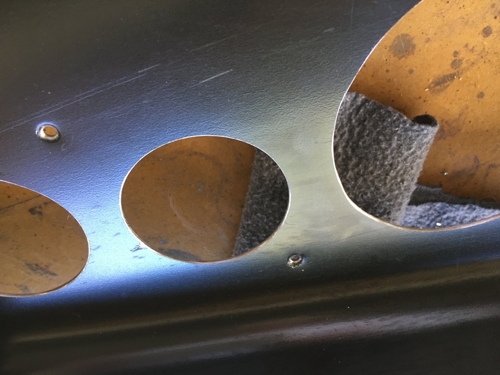

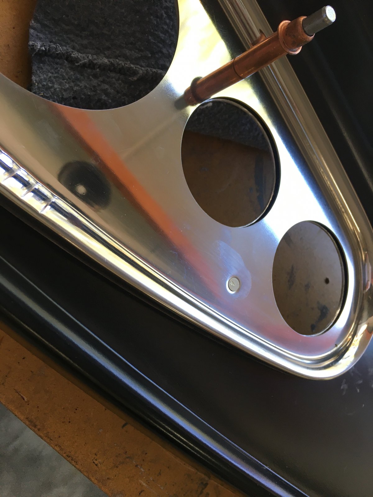

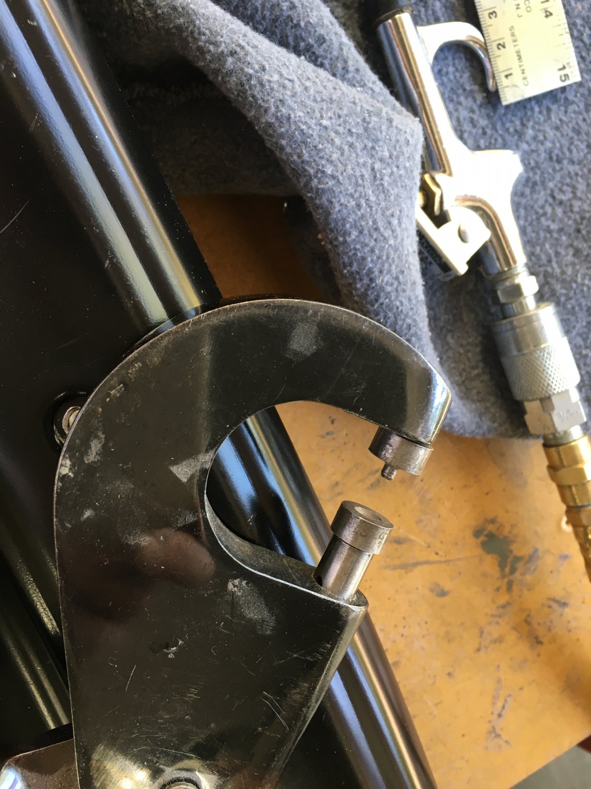

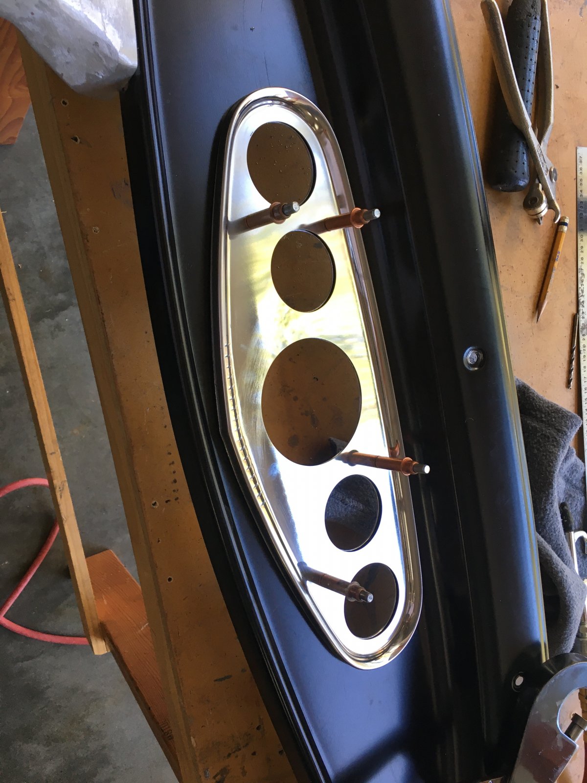

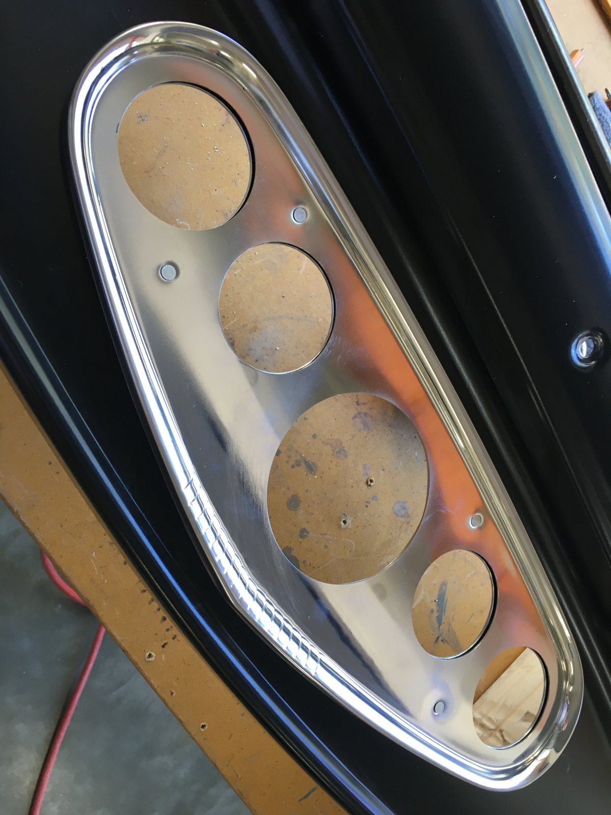

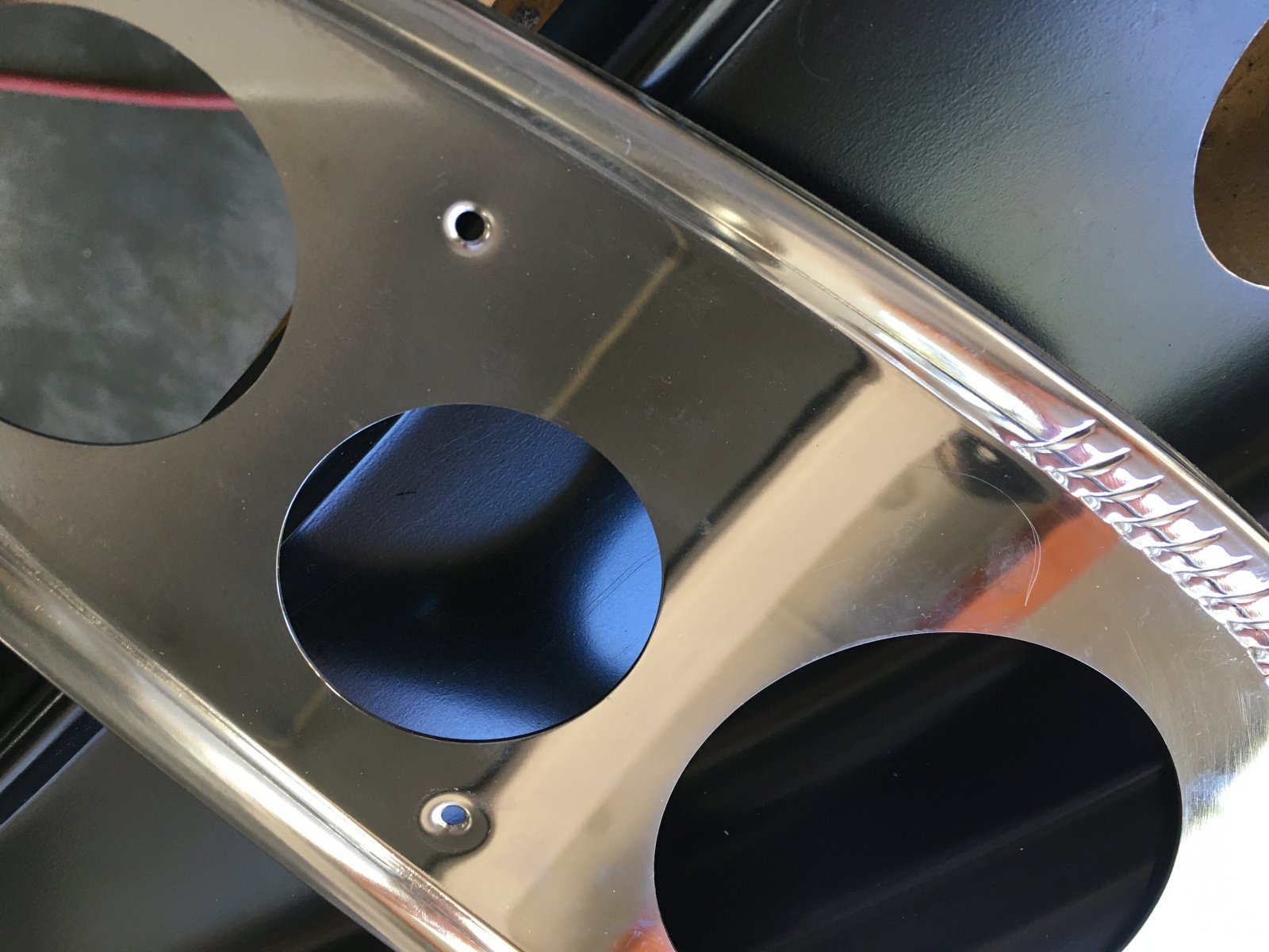

    45E02734-B5CF-45A9-906D-9C111E0CE2D1.jpeg 6E64D21D-73C9-439F-98EB-E82CDD7422B0.jpeg 95D8FC89-D685-453C-A7DF-9AB894681F2D.jpeg F80D6D88-8E38-4B12-B4F2-9F2B272E58E5.jpeg 0E5D8EDC-B735-4FB9-BA6F-10836B525A5F.jpeg F269683B-6CE8-4D44-9FCE-772A67ABE565.jpeg 9A5097EF-DAE6-47BD-A27D-07259E013E1D.jpeg Got some time, worked on the gauge panel and gauge install. Got out my old sheet metal tools and away I went! Cut holes, fit panel, drilled, dimpled for flush mount and it was a blast!! Plus it went well!!
