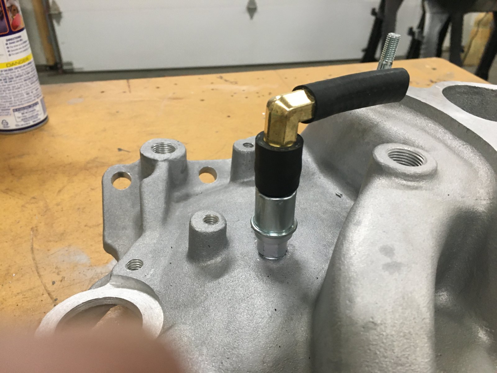

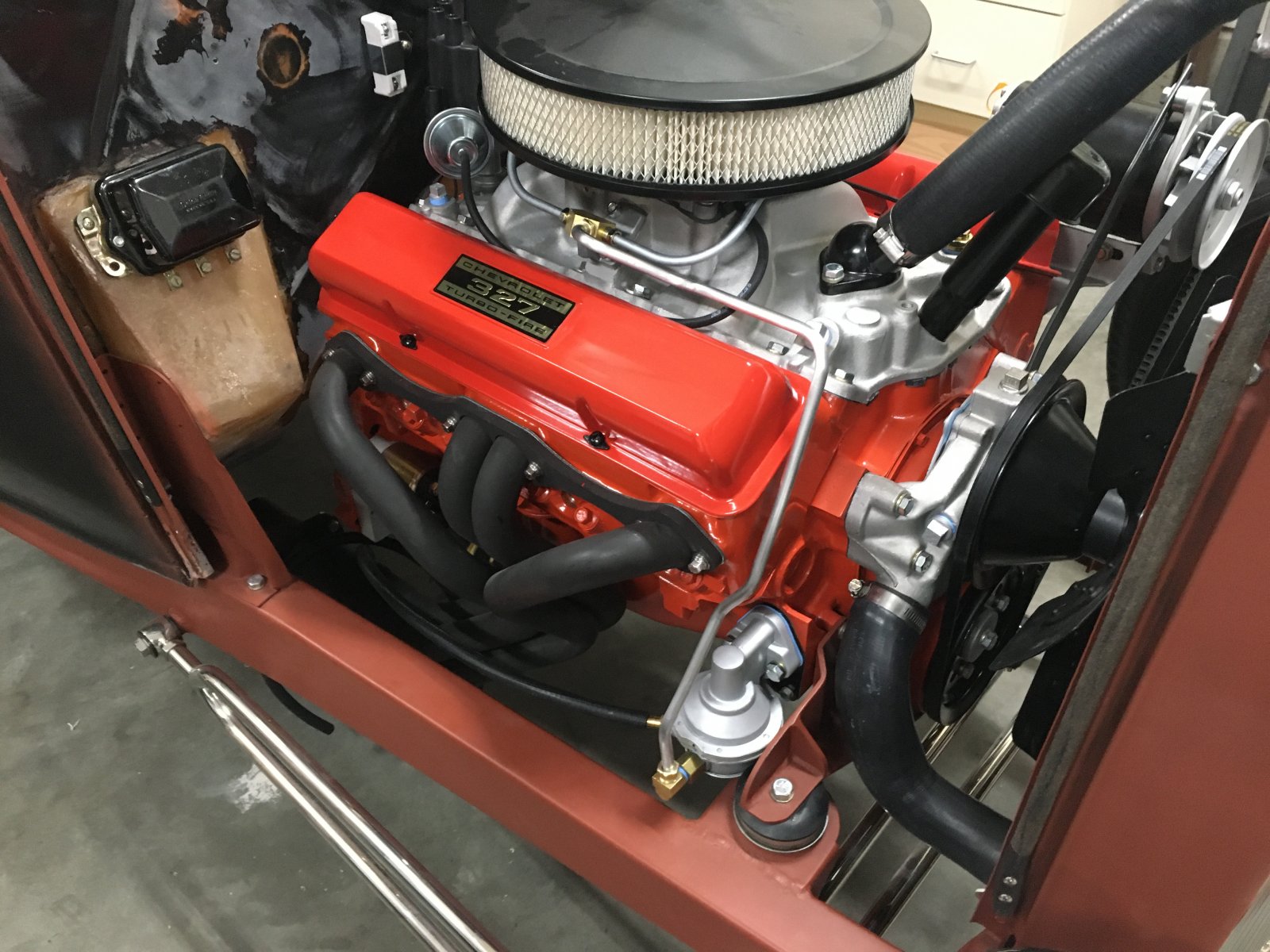

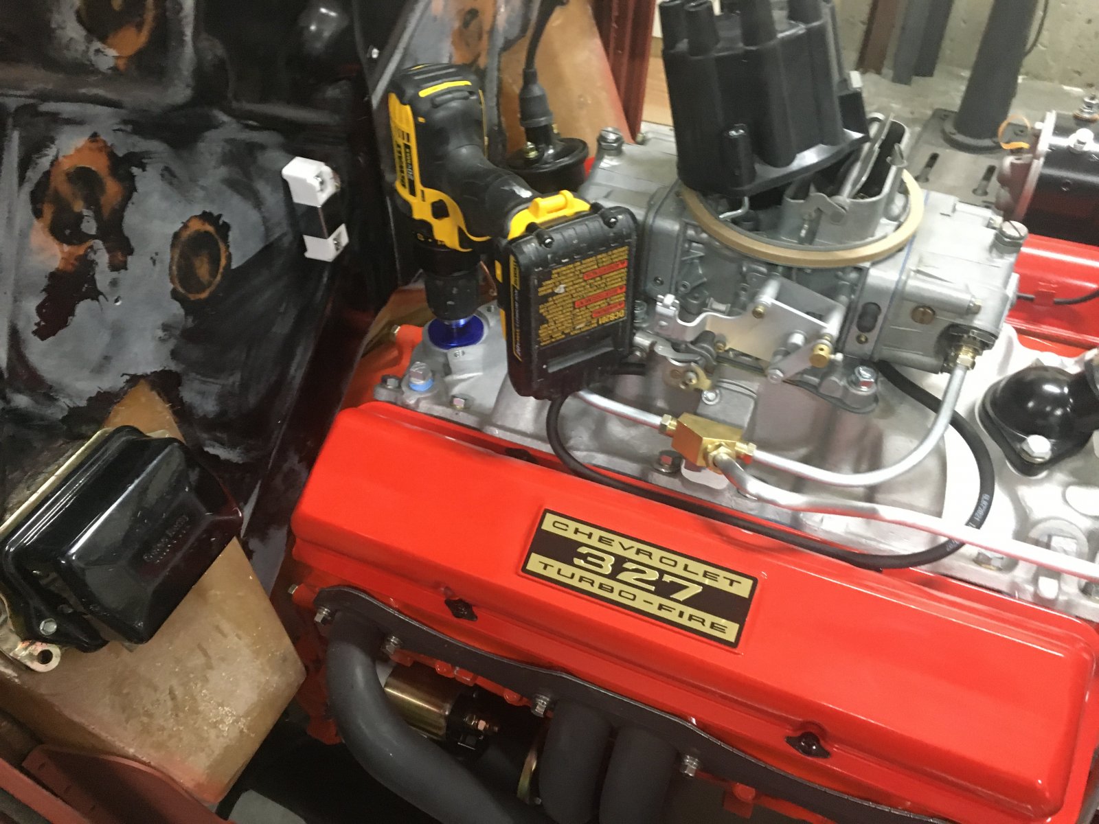

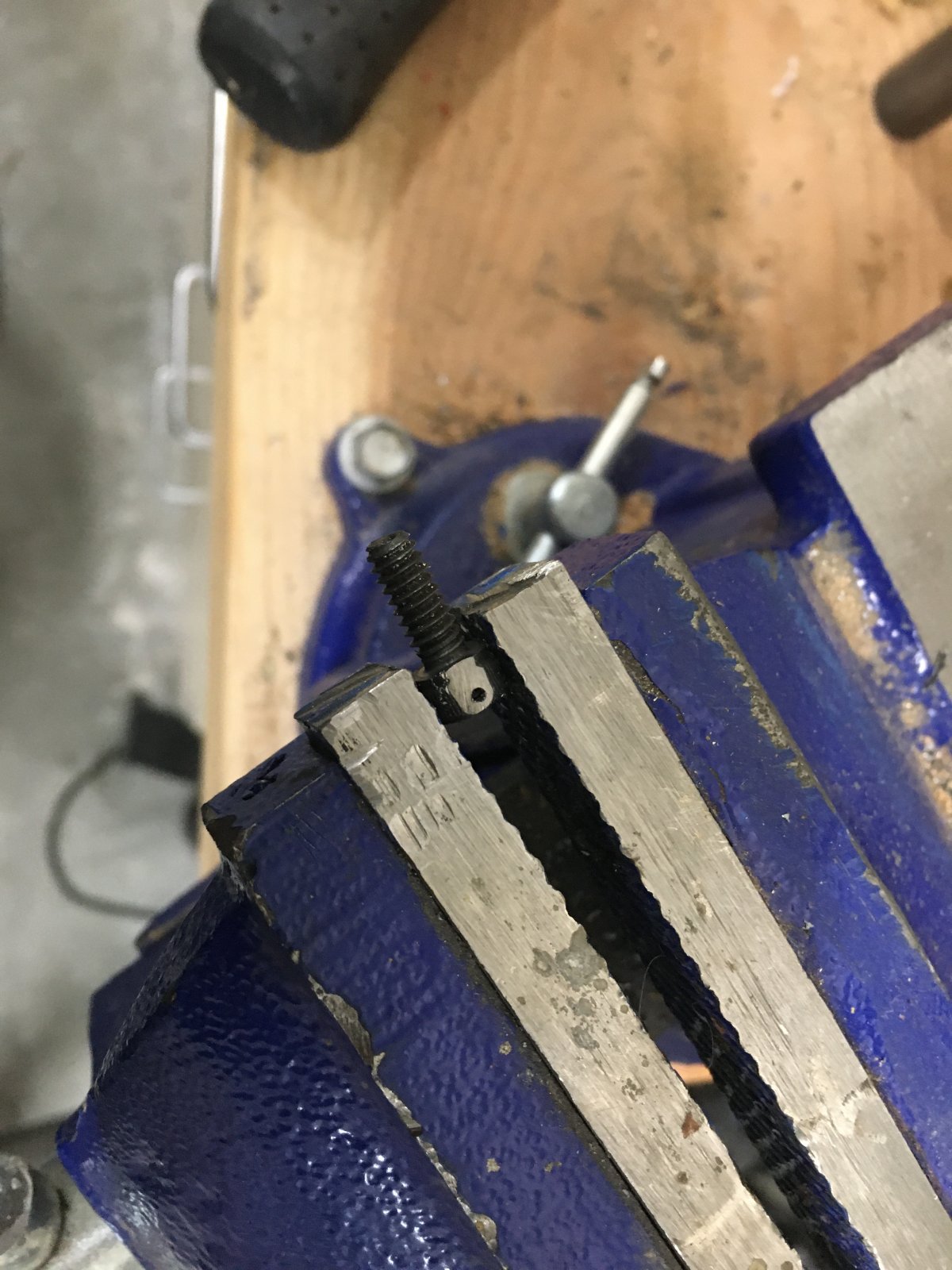

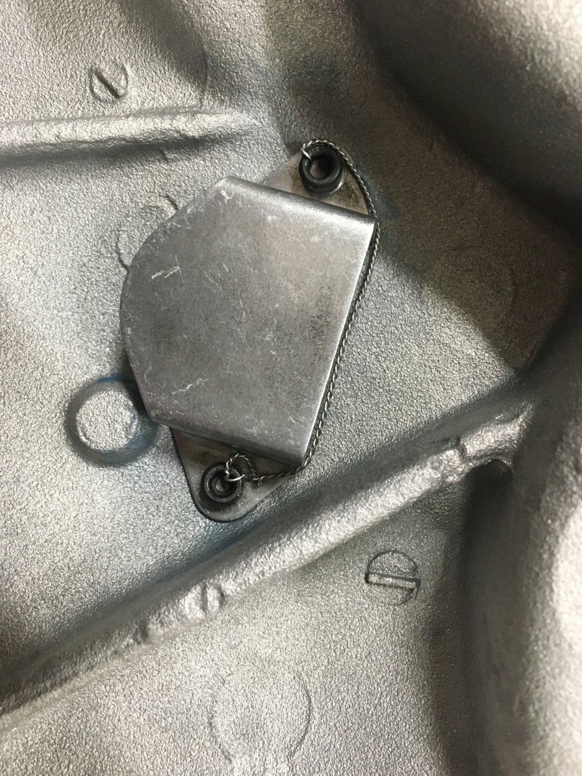

    52D716B9-D524-4C70-9475-4E11DF68E972.jpeg A6E293C6-08D0-42AB-A0EC-F3F4C1BD5B5A.jpeg 4187F53F-546D-427C-BB50-BE777B694DE1.jpeg Here’s an update, modified intake, drilled and tap, for the screw in PVC valve and plumb it to carb vacuum. Then flipped the intake and fit the baffle over the PVC valve, mark the holes, drill and tap for two 10- 24 Allen head screws. The screws have been ground flat on one side of the head and then drilled for safety wire. Don’t want it dropping inside!! Cleaned everything before installation. Used some thread locker and install. For good measure, .020 stainless safety wire added. Should be OK!! Time for some detailing on the intake, then break in lube on lifters, pushrods and rockers! I don’t want to forget the lifter valley windage tray before the pushrods!!! Then time for the intake, carb, distributor, etc. Soon time for some noise!!

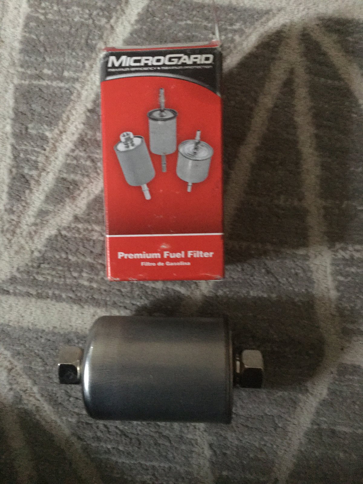

    Thanks! I have a MicroGard unit p/n 33481 with inverted flare fittings I plan on installing under the car mounted on the frame rail with easy access for maintenance! By the way I was born and raised in Reading, 5 blocks from the old fairgrounds dirt track! Spent many evenings watching the guys race flatheads in their deuce coupes! Bobby Abel was my favorite!! Miss those days!!

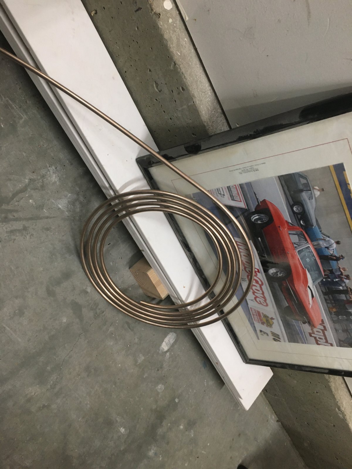

    Yep. The same one I use. Hate the cheap ones that use the rubber lines on each end. By the way, I used ni cop 3/8 line for gas line from tank to fuel pump on deuce pickup I'm building.
    Splitbudaba and loudbang like this.
  16. Splitbudaba
    Joined: Dec 30, 2014
    Posts: 1,025
    Splitbudaba
    Here’s my future fuel system 3/8”. A few bends and a couple straights, maybe some adel clamps and time to fill the tank!

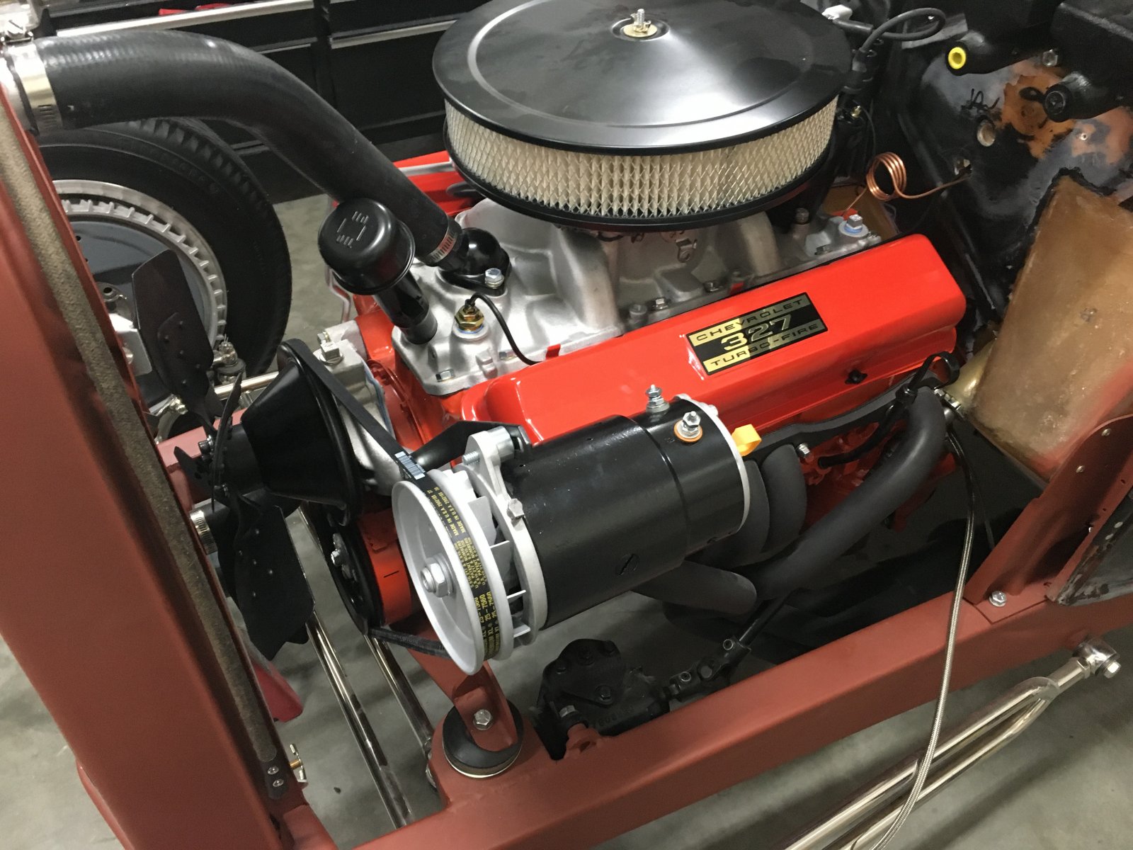

    5AB82B0D-3371-4CE5-B014-D02045A54002.jpeg C1FEC00C-EEA4-4D95-9E5B-0978998955DE.jpeg Got some more done today, fuel line pump to carb, generator belt alignment and tension, temp mounted regulator and resistor, and figured out the fuel filter and other details. Tomorrow I plan to plumb in the oil pressure gauge line and remove the distributor, time to pre oil and see what leaks? Cooling system is ready to be filled and plugs and ignition wires are next! Seems I don’t have to do a lot of wiring to light her up!! Getting closer!!

    Couple of minor things I'm seeing.
    When doing a first fire, it can be skipped, but on that first drive, fit up a section of small rod to hold the choke open. Too bad wire coat hangers are obsolete.
    That gen pulley is huge! A 327 is often a high-winding engine and generators don't like high RPM, so it should slow it down enough to live a long time, but check output at idle and just off idle with the accessories (lights radio wiper) all on to make sure you don't run the battery down while out driving in stop and go traffic.

    Good eye! It’s really a 350 crate motor my wife got me as a surprise. Valve covers were a Craigslist find, rare 1962 style. Dumb luck? If you look back in-my thread you will see my double hump heads are fake too! It’s a gl*** car so anything goes. I have a push- pull cable for the choke and the old piece of coat hanger that came on the carb! I still must do the double return springs and a few other details. Seems the small stuff takes more time than you think!! I might have to up the idle speed to help the generator make power. Maybe I can goose the throttle at a stoplight to get more attention? Thanks for the tips.
