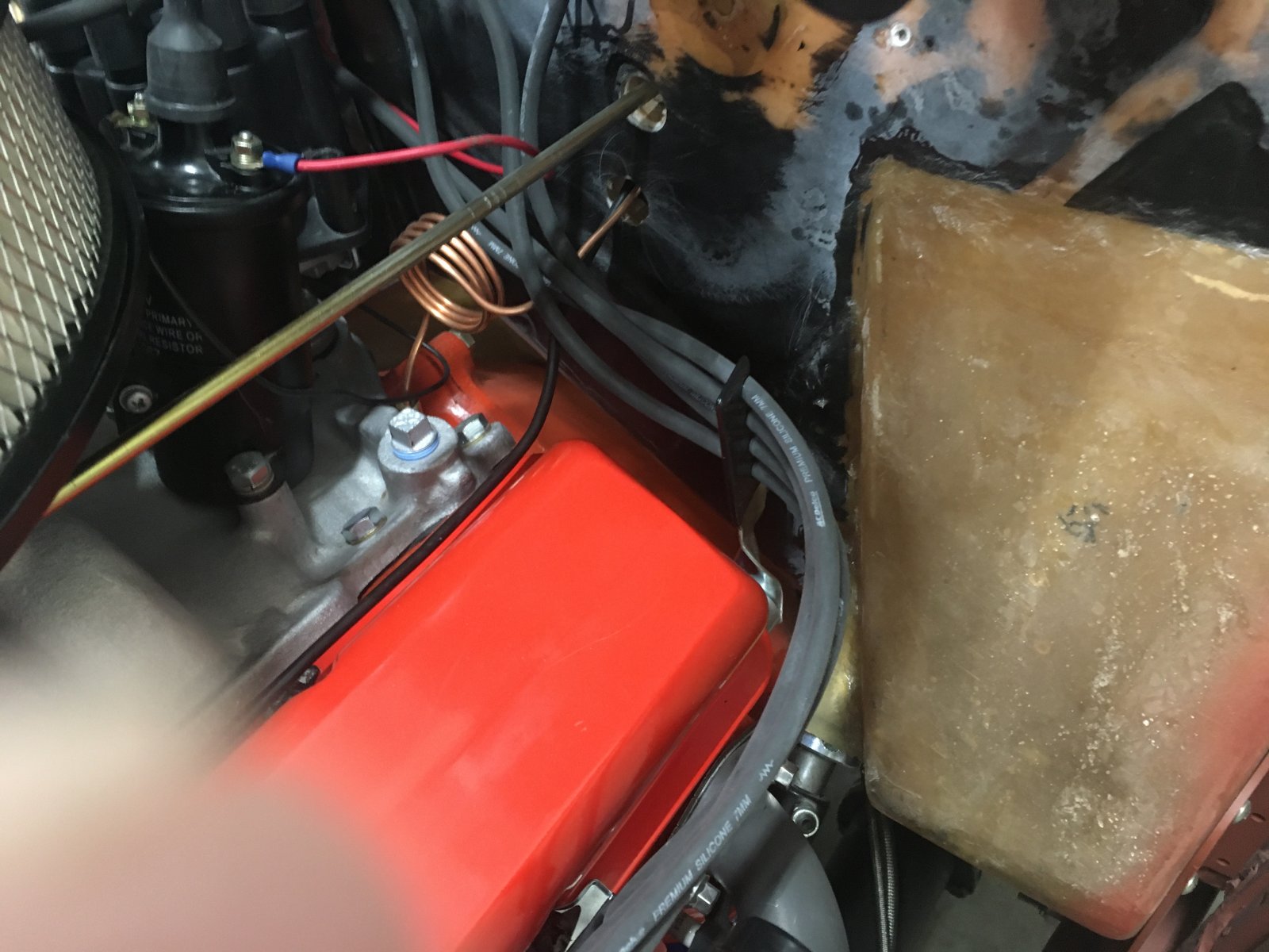

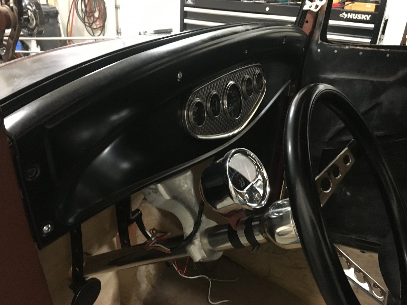

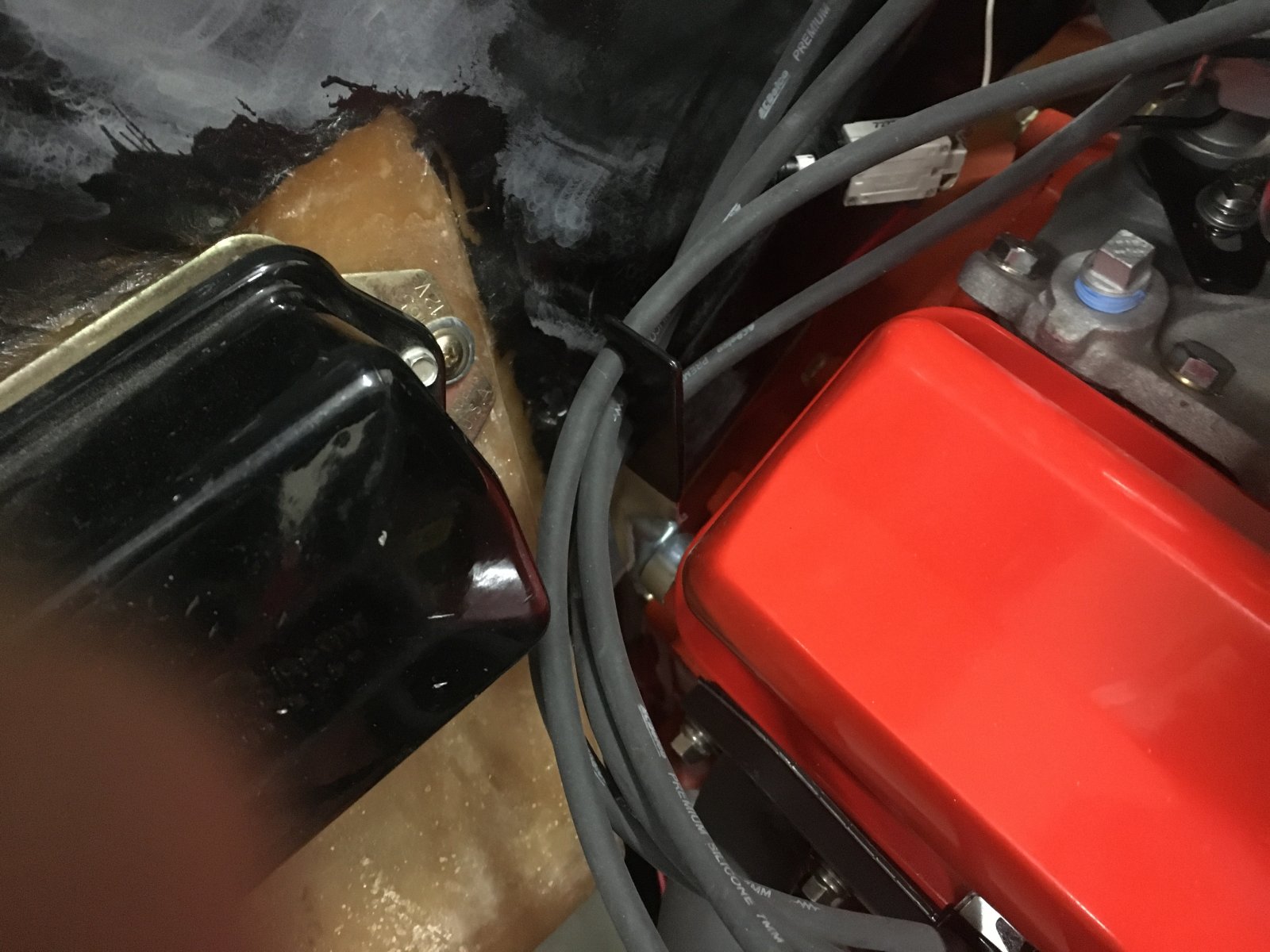

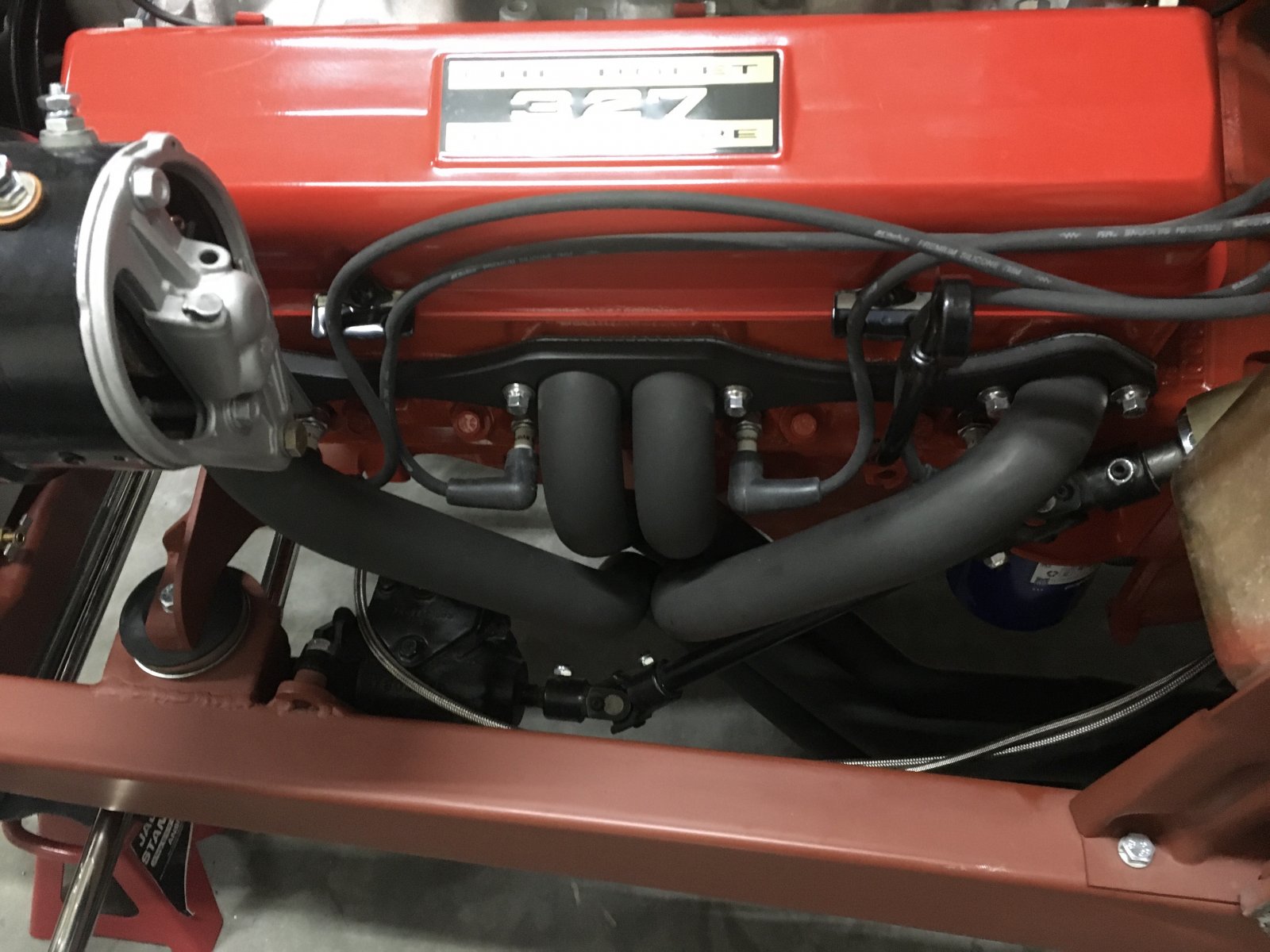

    60482EC1-CC0F-4A07-B3D3-EB8B4DFE6767.jpeg 0B428206-3CC4-4590-9D4B-952F2F71DD98.jpeg 6A32DFD4-602C-486B-9799-550320E9D19F.jpeg Still on a high from running my small block. Definitely got my juices following, I can’t wait to get more done! Details are next. Bought some late 60’s spark plug wire retainers and installed them. Holds the wires away from the headers. Now for some brackets on the back side of the heads and the ignition wires will be complete! Had to mount my tachometer on the column. Modified the mount to fit the column diameter. Worked great!! Next thing is to get the hydraulic system in place to operate the throw out bearing!

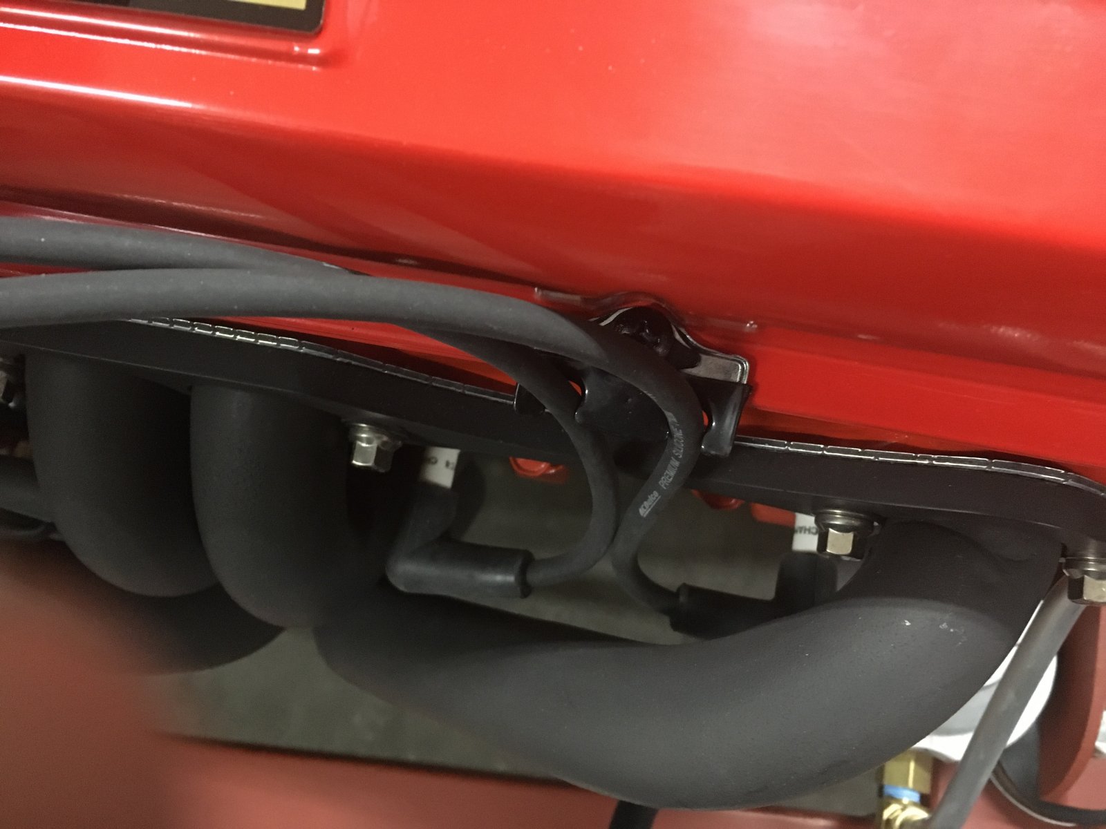

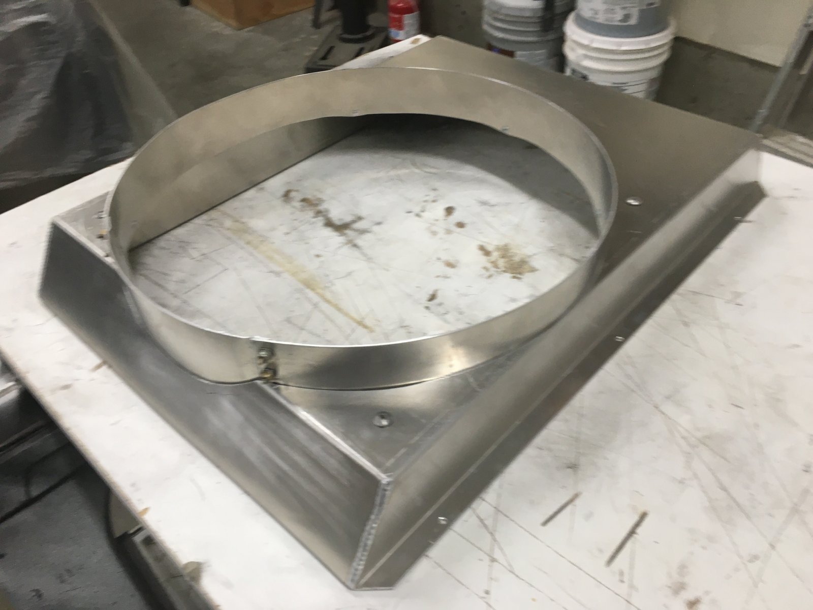

    BF411C55-DAAA-4411-948E-BAC7F5F6434B.jpeg AC0720B9-01CA-471A-8EBF-FCB281C6B75C.jpeg E7B1205A-1EC7-4A1A-A9CD-77DFE2DECD21.jpeg I had a set of retainers that bolt on the rear lower block behind the head. Shortened them, drilled a hole, and gave them a 90 degree twist. Bolted them on the back of my modern heads and ran the wires. Works great!

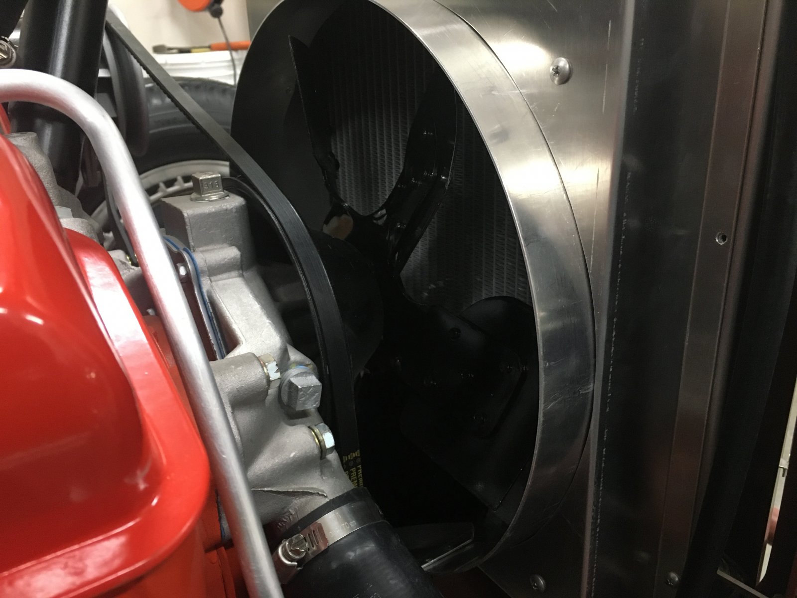

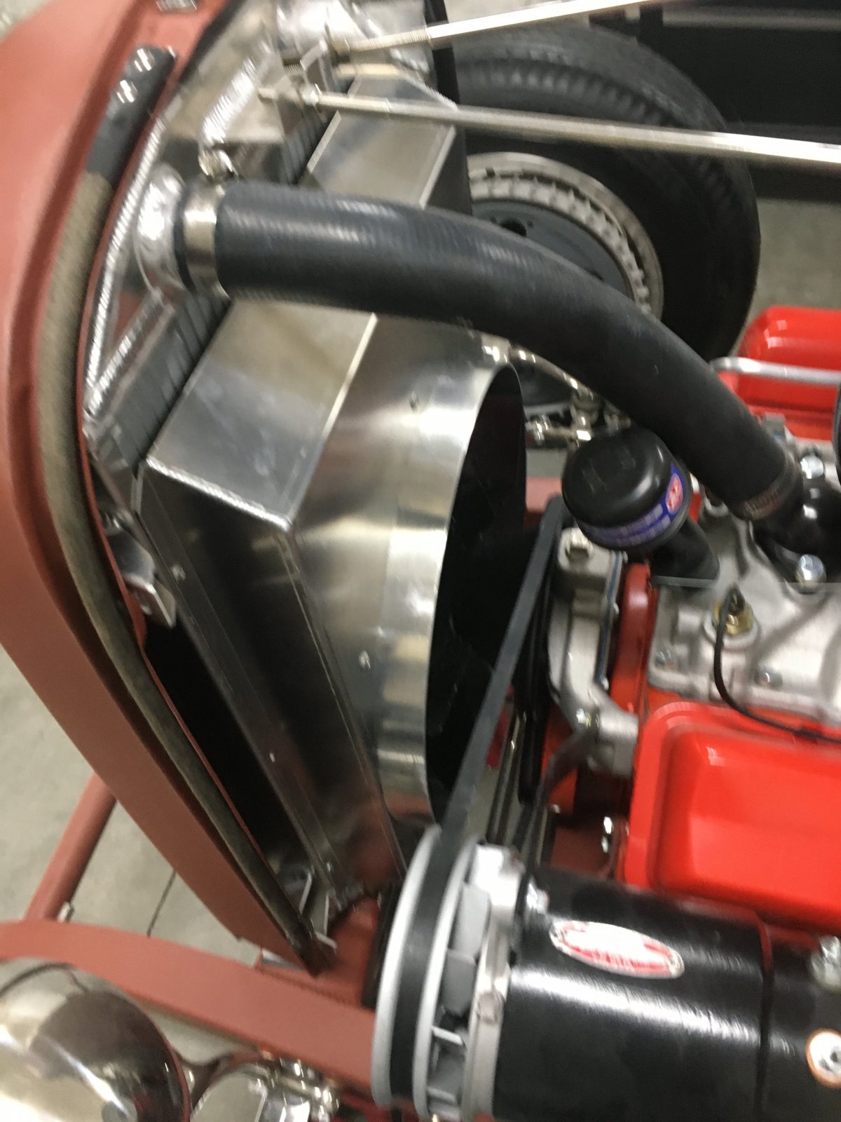

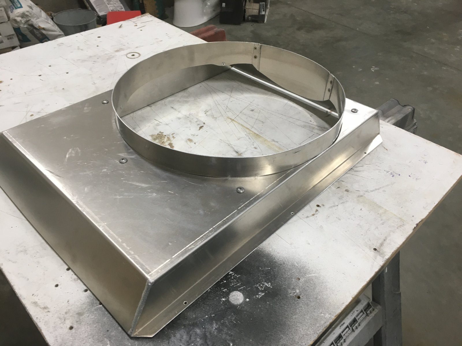

    A8230D03-844A-4485-B1C9-0FC632F34587.jpeg B5A4F0DC-F770-4740-9895-41DEC0A4B445.jpeg B46C9537-6AA7-471E-8F4A-FBC6B40B5518.jpeg Been awhile, finished the shroud mach up, fabricated a removable section in the lower ring. Take out the screws, unbolt fan, and slide the entire shroud out without removing the radiator! Ring is also removable and adjustable for blade exposure, if it is needed!

    The fan blade should be 1/3 in 2/3 out of the shroud for the best Cooling.

    I have 1/3 of the aft blades showing. I plan to install it and give her a run, eye on the temp!! I made it so I can put spacers under the ring mount to adjust the amount of blade to optimize the cooling!

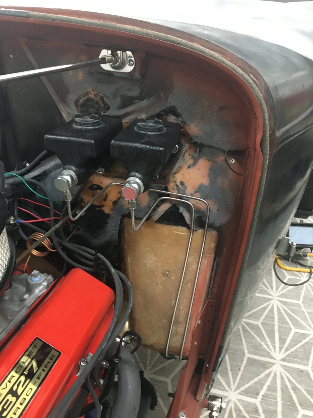

    9713FB4E-5931-4F6A-8CB5-1D27C318ACCD.jpeg D85A9351-6414-40F8-BA31-AB724DE3965D.jpeg 419480A8-36D5-4EBB-A563-E53DDEE52954.jpeg Finally have the master cylinders plumbed in. Had to cut 1/4” of material off at the pressure port to allow the banjo fitting to engage enough threads. Made a holding jig for the master cylinder to use the base on my metal chop saw to get a square cut! Seems to have worked so far. Leak check will tell the whole story! Used 3/16” stainless tube with stainless b nuts and ferrules! Borrowed a flare
    tool from a friend, mounts in a vise and has a rotating head with all the tools! Worked great!! If interested the inboard cylinder is for brakes outboard is clutch hydraulic throw out bearing.

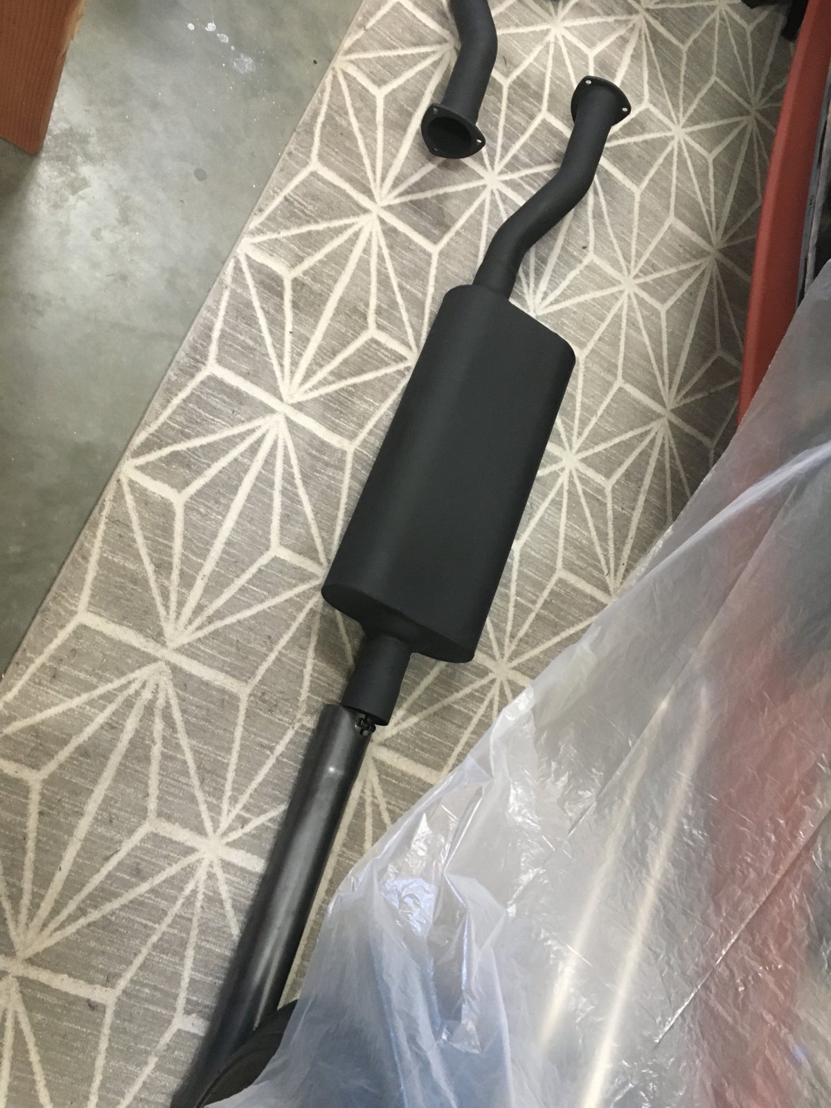

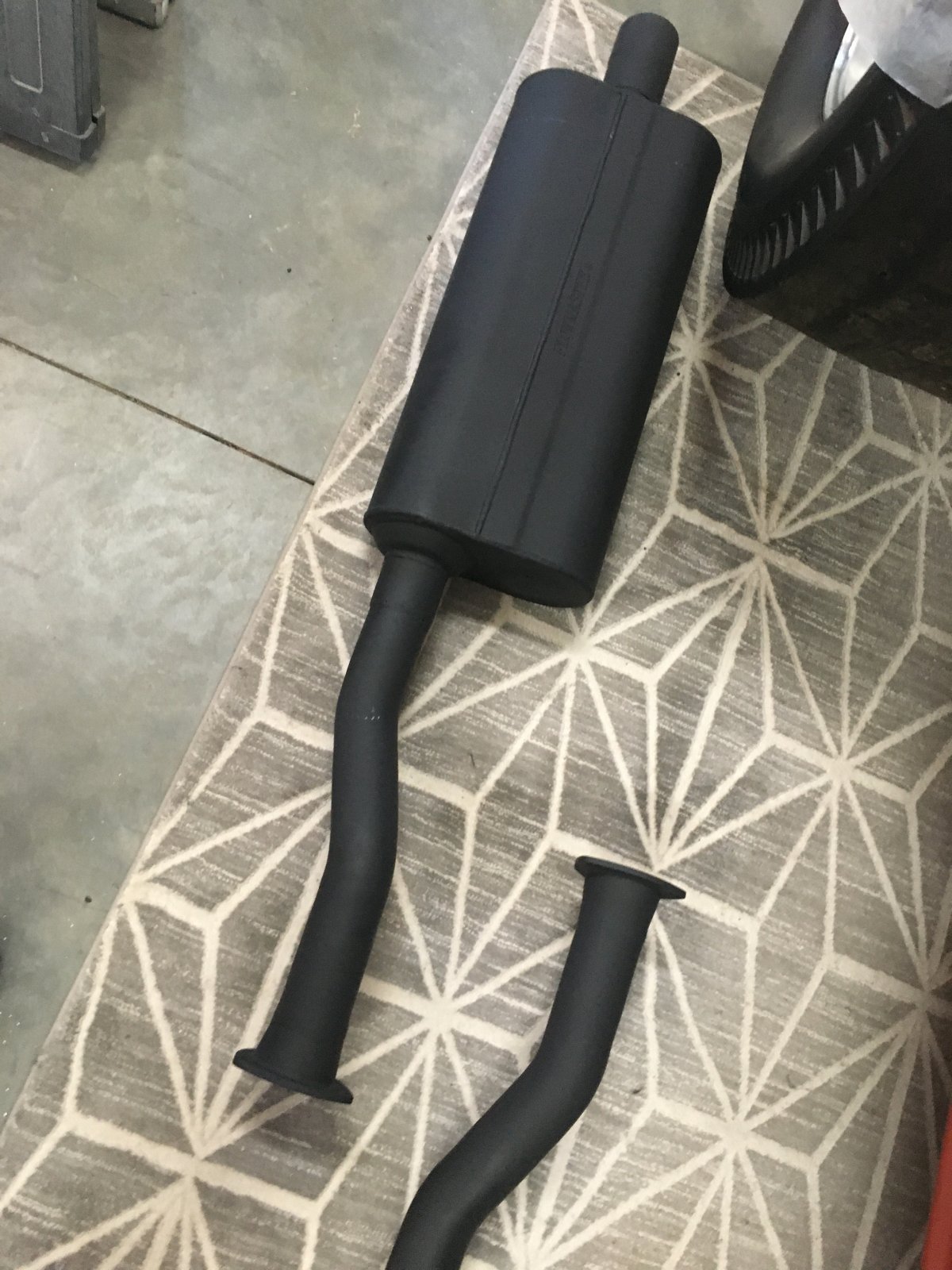

    28242451-FD52-4130-A487-F694A9D604D1.jpeg AF7A67BC-D1F6-4CC5-A047-AFC8EE1BBA56.jpeg Welded up the exhaust, smoothed it out and painted them black! My wife says it is still too loud. Saw some baffles and spiral tubes that I could install in the 3” tailpipes. Anybody ever try any of those baffles, if so which would you recommend?
    catdad49 likes this.
