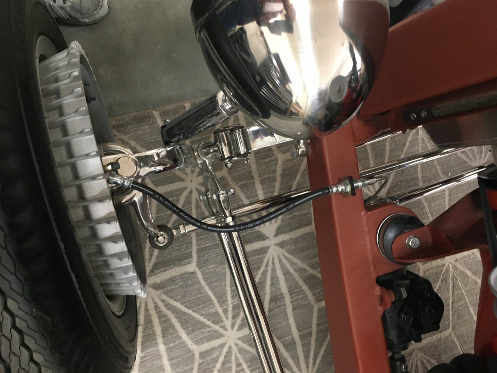

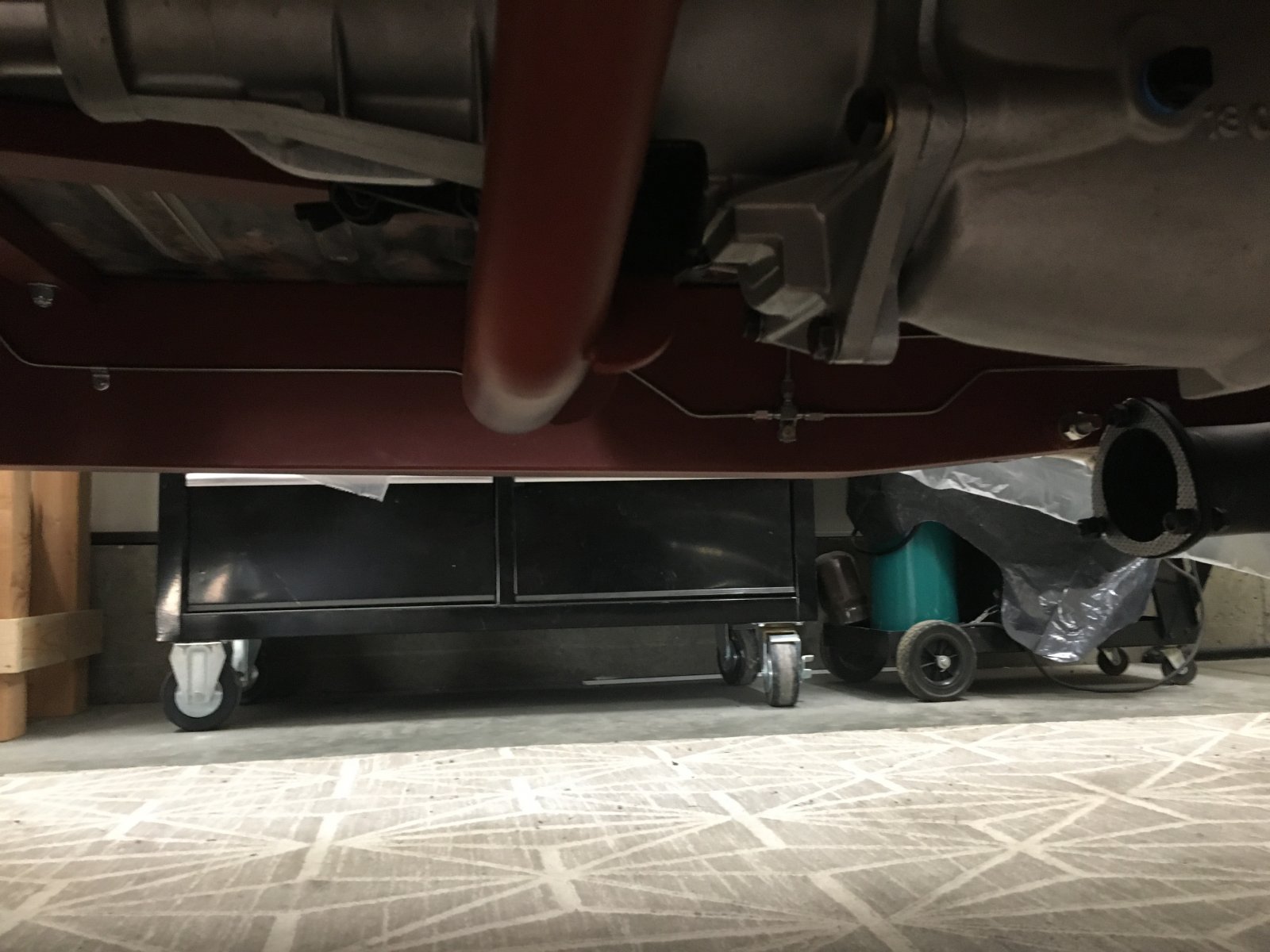

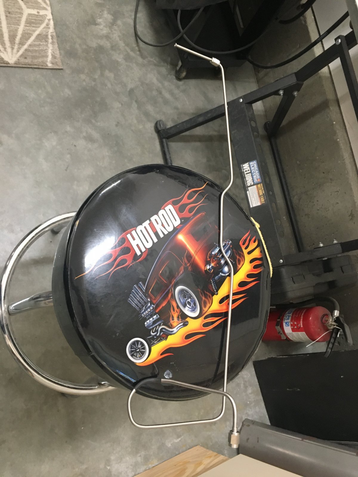

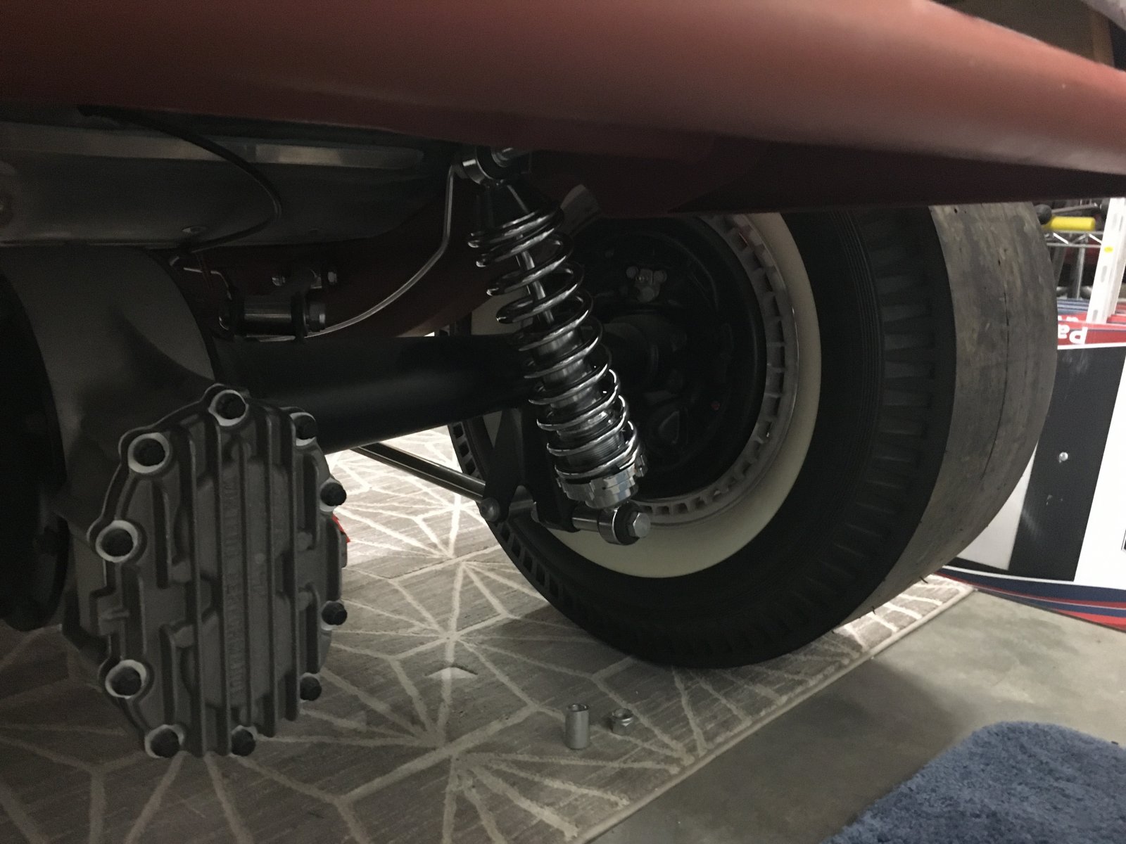

    DEC90C0D-1BD0-494A-95F1-6BD3F2D0D4C5.jpeg 26619371-A144-4B32-8401-A1CF2EBC34DE.jpeg I have most of the stainless brake lines made, fit the coilover shocks and set the front ride height! So far so good. Soon to be chasing dot 5 leaks and get here tight.

    Finished all the stainless brake and clutch plumbing. Time to bleed and chase leaks. I am using Dot5 fluid, main reason is it’s not a paint stripper!!! Had Dot5 in my last car, had no issues. Borrowed an Eastwood flare tool from a friend, totally the best double flare tool I have ever used! When all bleeding is complete, I can actually drive her around! Oh wow!!!

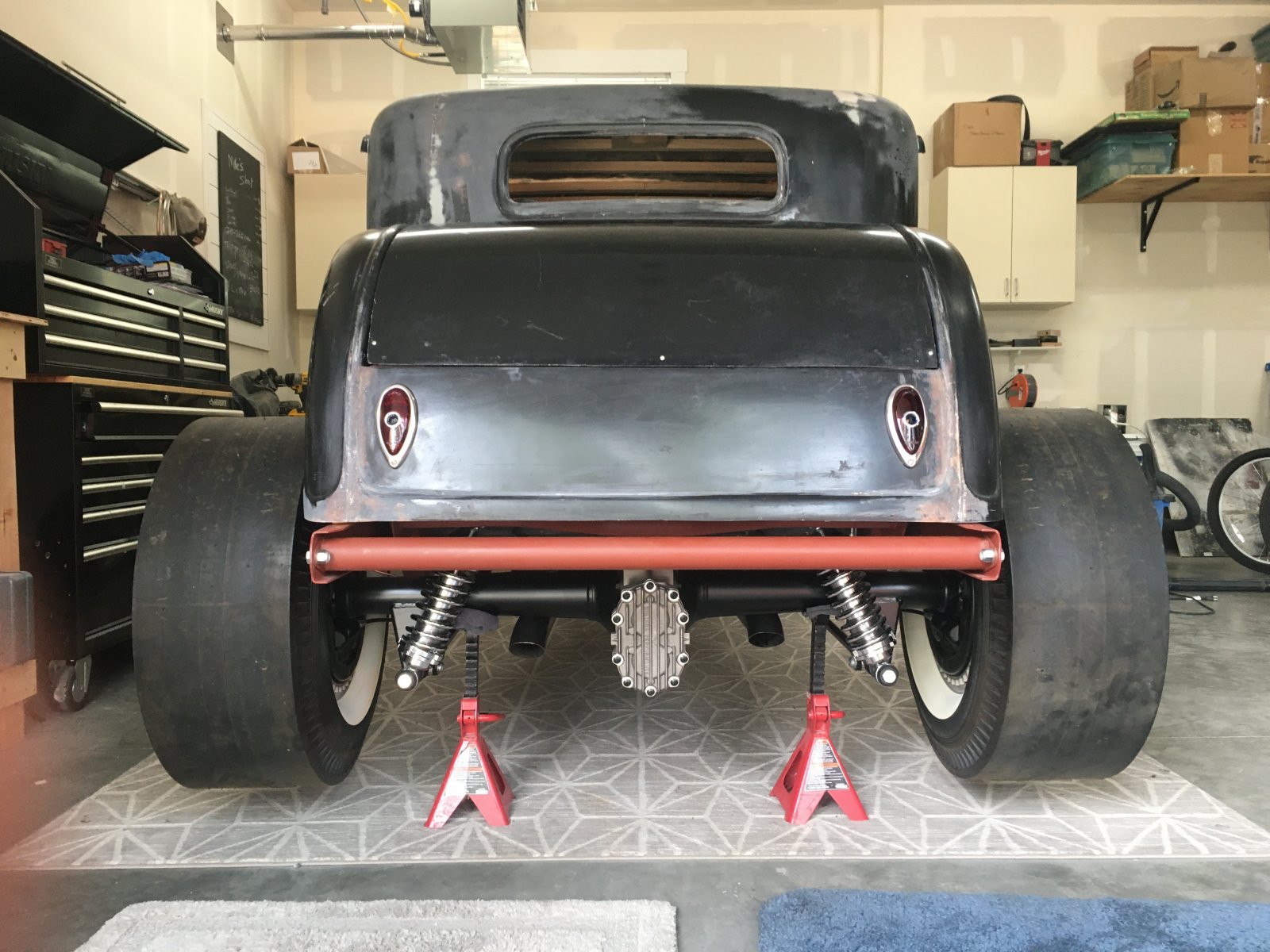

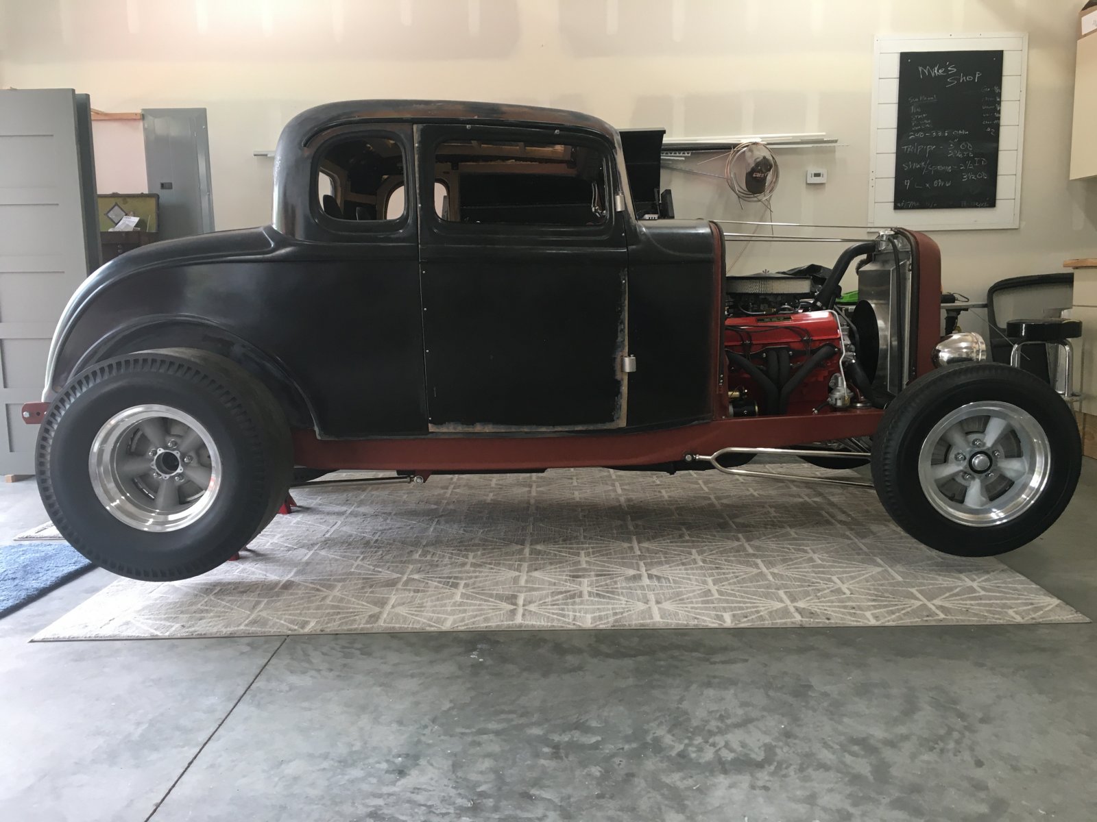

    866F9205-B08B-46CB-BEA0-7888D4AC16EC.jpeg 178377B4-C347-462F-9DD0-68C4AF868ACF.jpeg 242E1AD2-81B1-4560-B5F3-B1AA2F1C9AED.jpeg Here’s some pics, if they load!!

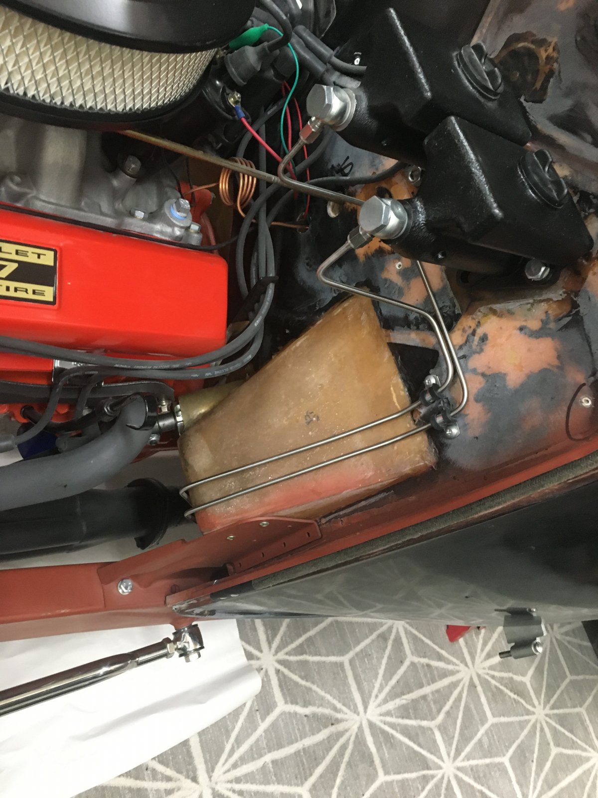

    2EF0FAD0-A658-4658-9394-BBA5B7ED2E88.jpeg 4D4611DD-2431-48A1-9F33-B8AEE45D233D.jpeg OK, good day, finished the clutch system, filled with Dot 5, bled it by myself, chased one fitting leak, and finally it works!!! Pushed in the clutch, found all 4 gears with the shifter and even reverse! Wow, it could move, if I trusted the hand brake? Fuel system is in, waiting on the sender unit. Put some gas in the tank and see if she runs, and spin the gears!!! Closest master cylinder is for the clutch, pedal pressure is good!!!

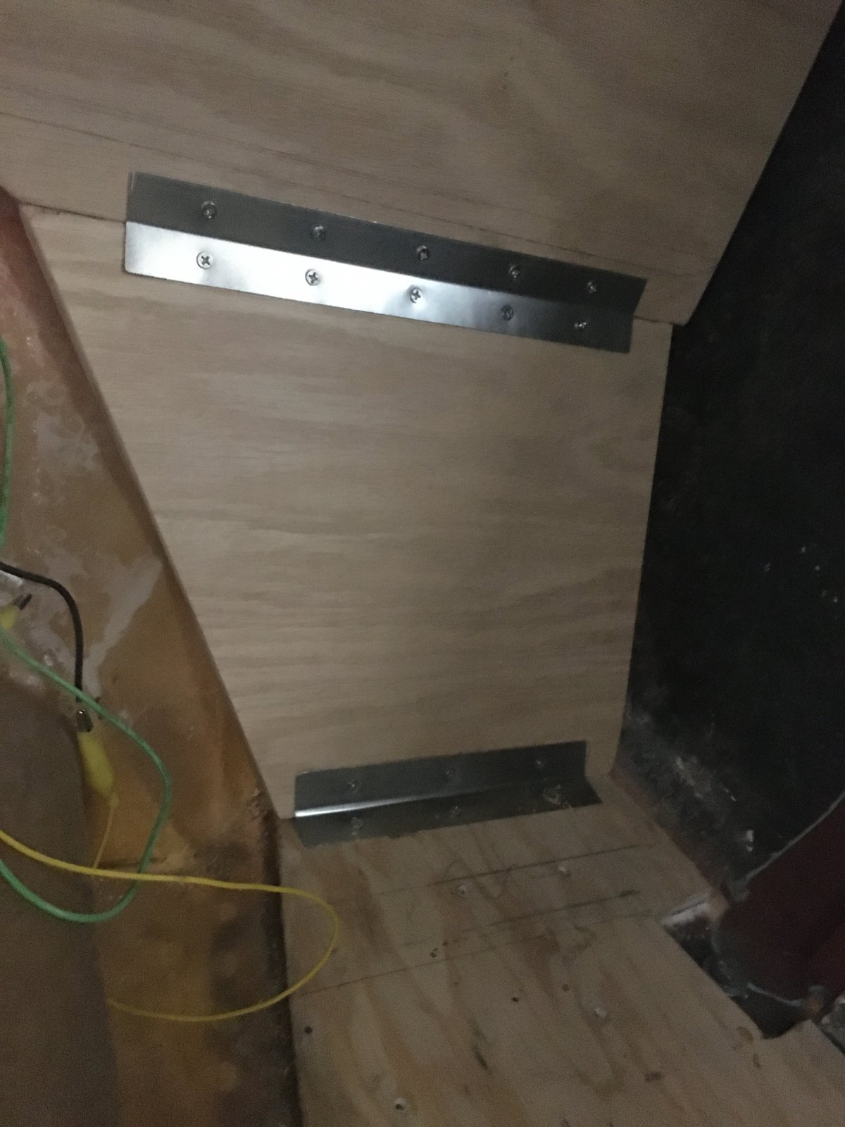

    As promised, I fabbed up some galvanized metal to secure the center floor board sections! Holes are dimpled to keep the screw heads flush! 3A317580-83B0-48DD-B444-23156D8A310F.jpeg B922048F-2712-43D9-9585-82A43396DFE6.jpeg

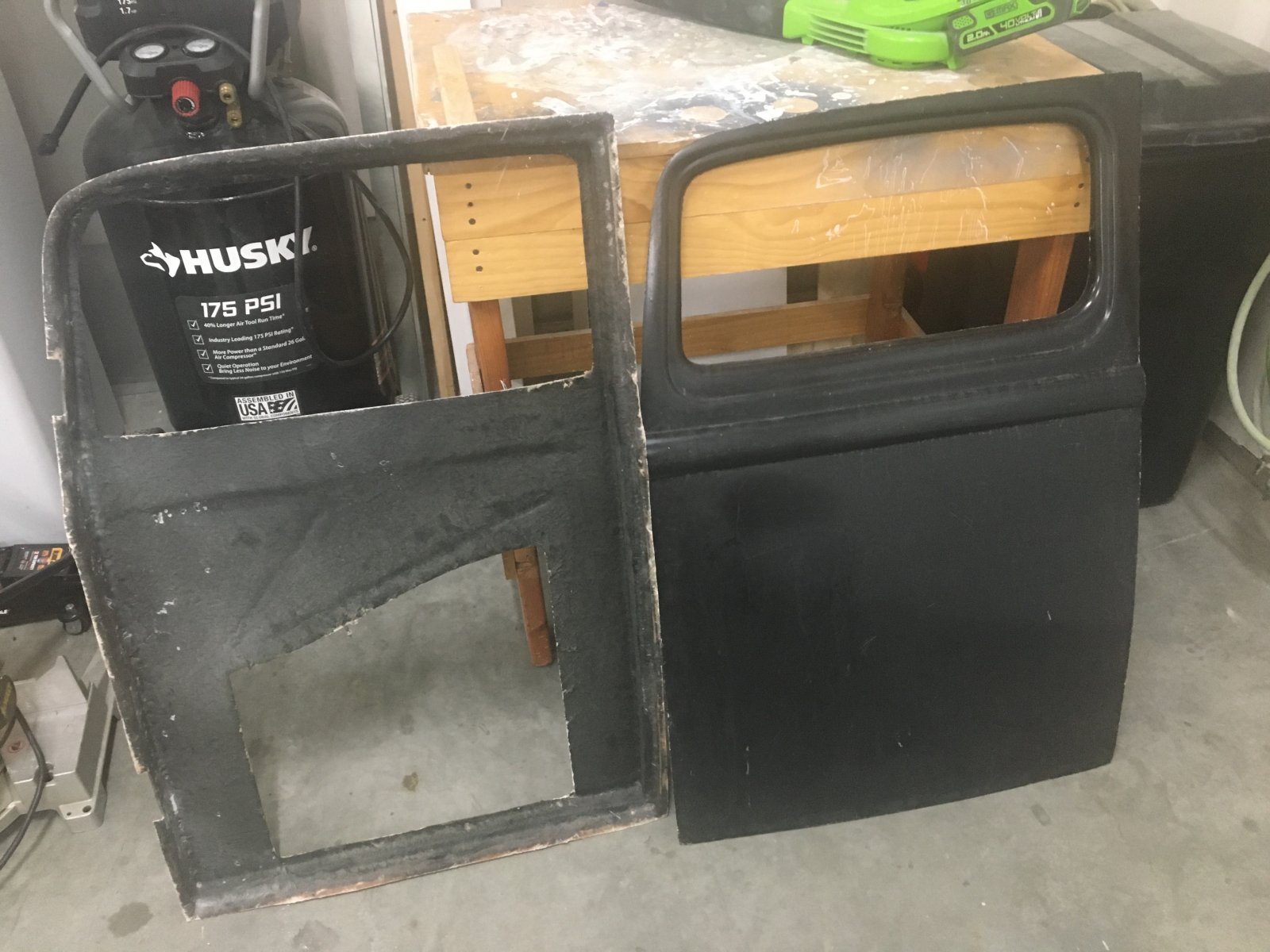

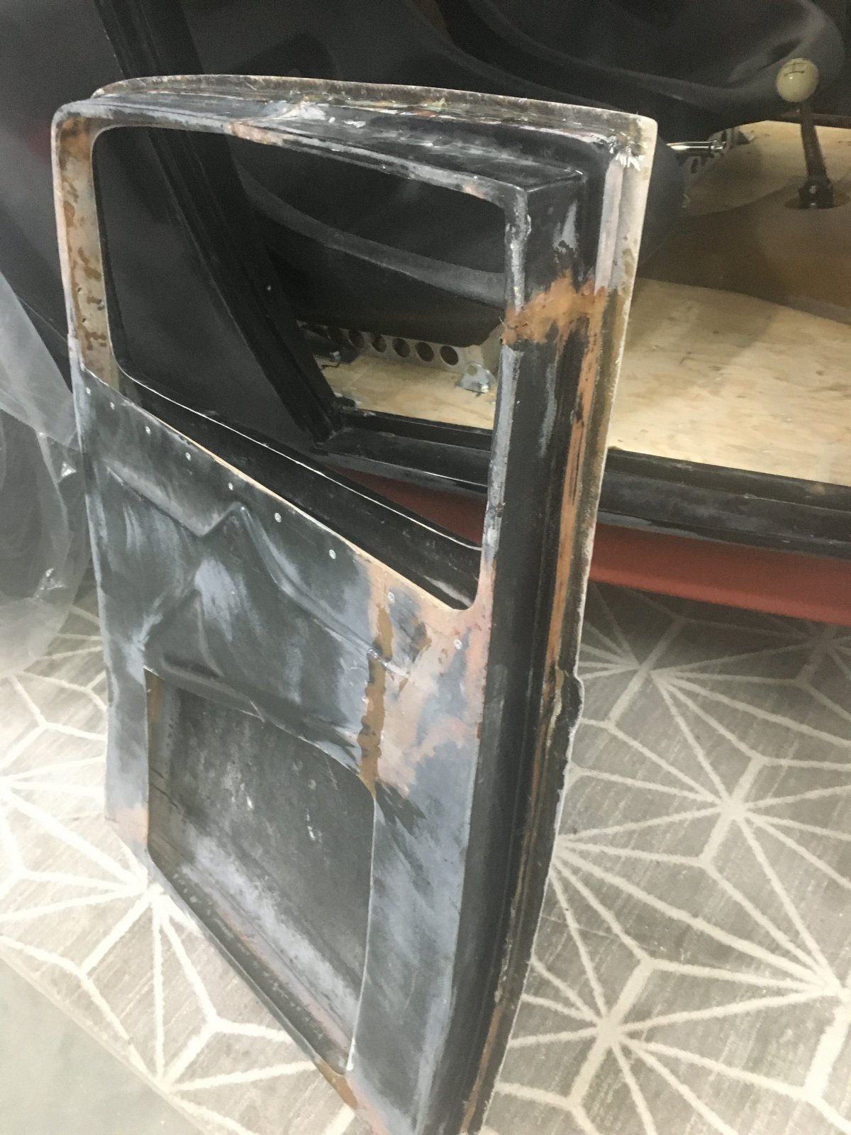

    Time to shift gears, fibergl*** work! Started on the doors! The doors come as an outer and inner skin! They don’t fit for ****!!! The right door has been roughed together, using stainless hinges and repop latches and window regulators! See pics! Had to cut up inner skin to get it to fit the opening. See pics again on the ***embled inner skin! You can see where I cut it and spliced in at least 6 spots. Even the outer skin was cut short! Still more fitting to do, then make it pretty!!
