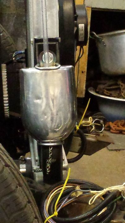

    Had an old canteen laying around PXL_20230201_213123284.jpg PXL_20230201_213131243.jpg and found some hardware. Put it together and now I have a puke canteen! Undo the snaps and pull it out to drain. There's also an 1/8" copper vent tube on the backside of the inlet fitting!

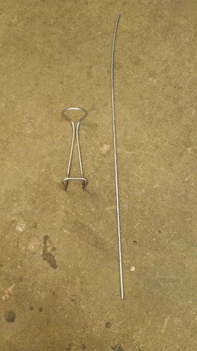

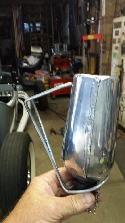

    That's looking good, I did the canteen overflow as well, except I ran mine upside down so I just unscrew the cap to drain.
    Took some straight rod I had laying around and bent it up to make a "spring tension" holder, worked out great.
