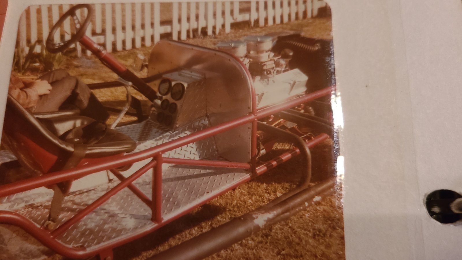

    I remember (like) those seats too. My dad built a home made dune buggy in the 70s when I was a kid that had similar seats. 20230607_213955.jpg 20230607_214027.jpg
    Splitbudaba likes this.

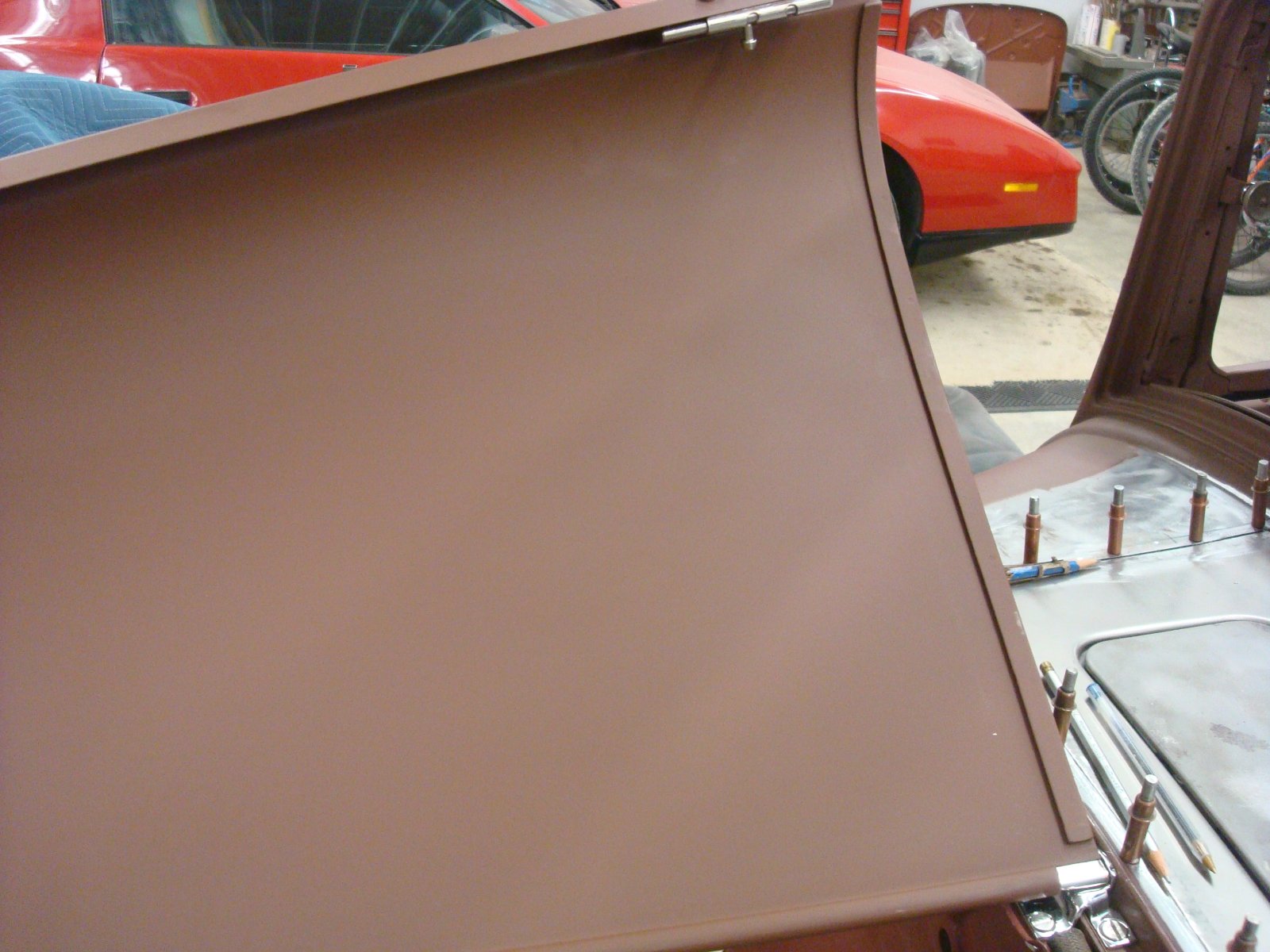

    Bought repop 32' Ford center hood hinge pieces, 2 sides and one polished center. So I slid in the hinge about 2" into the center strip. Cool it went in easy, but it only opens about 20 degrees. What's the deal, I thought they opened almost straight up. Anybody ever experience this? Help!!
  13. Splitbudaba
    Joined: Dec 30, 2014
    Posts: 1,025
    Splitbudaba

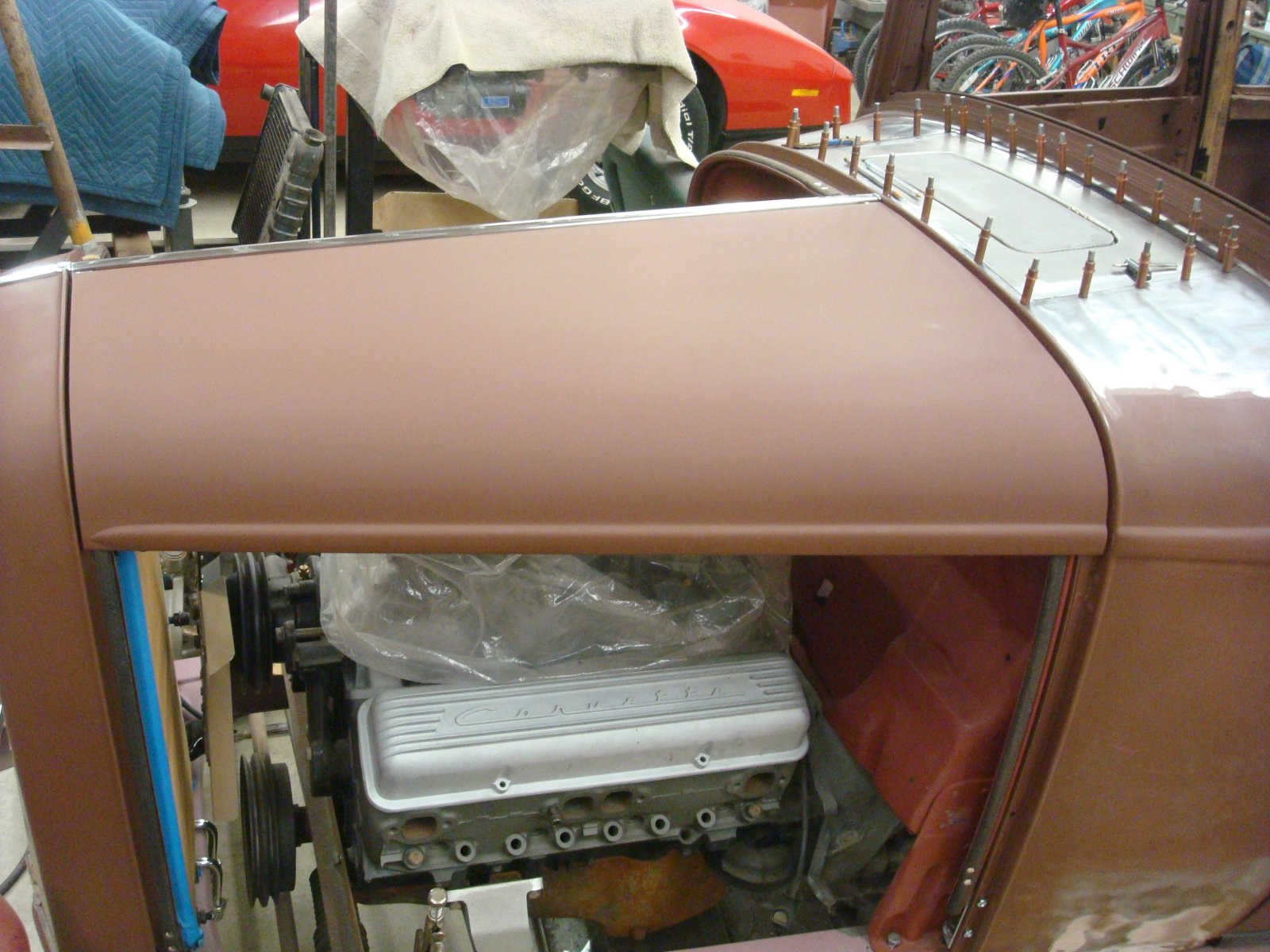

    Well, got the steel hood trimmed, primed and temp fastened to the hinges. Wasn't sure if I would like it on or not! But I think I do! PXL_20230718_014544171.jpg PXL_20230718_014553458.jpg

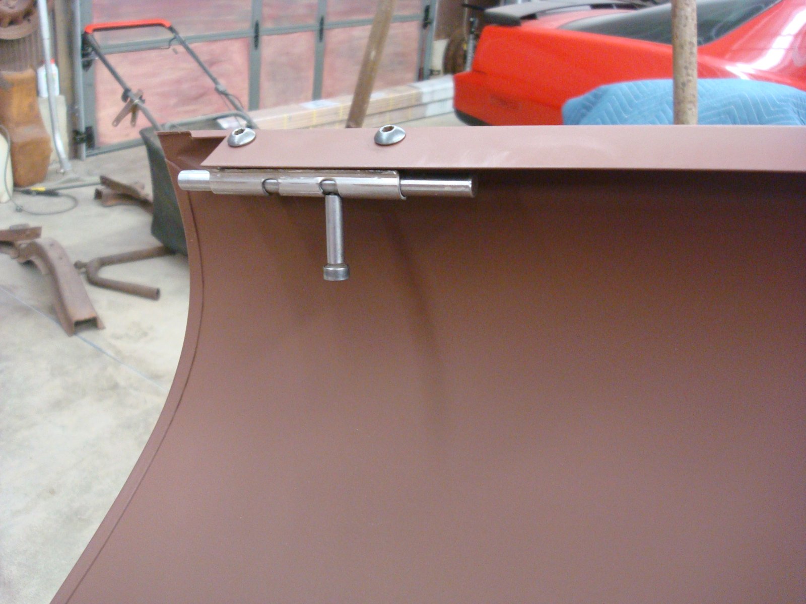

    2014-02-01 13.54.20.jpg 2014-02-01 13.54.47.jpg 2014-02-01 13.55.05.jpg 2014-02-01 13.55.18.jpg

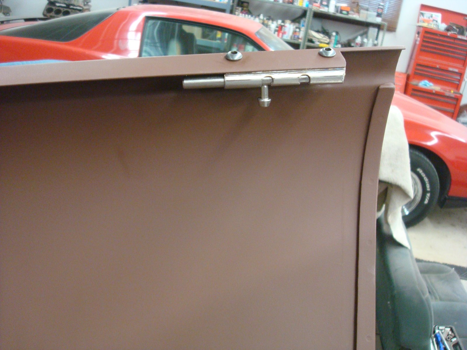

    Hood looks awsome! Here are some hood latches I made from scratch that are hidden.

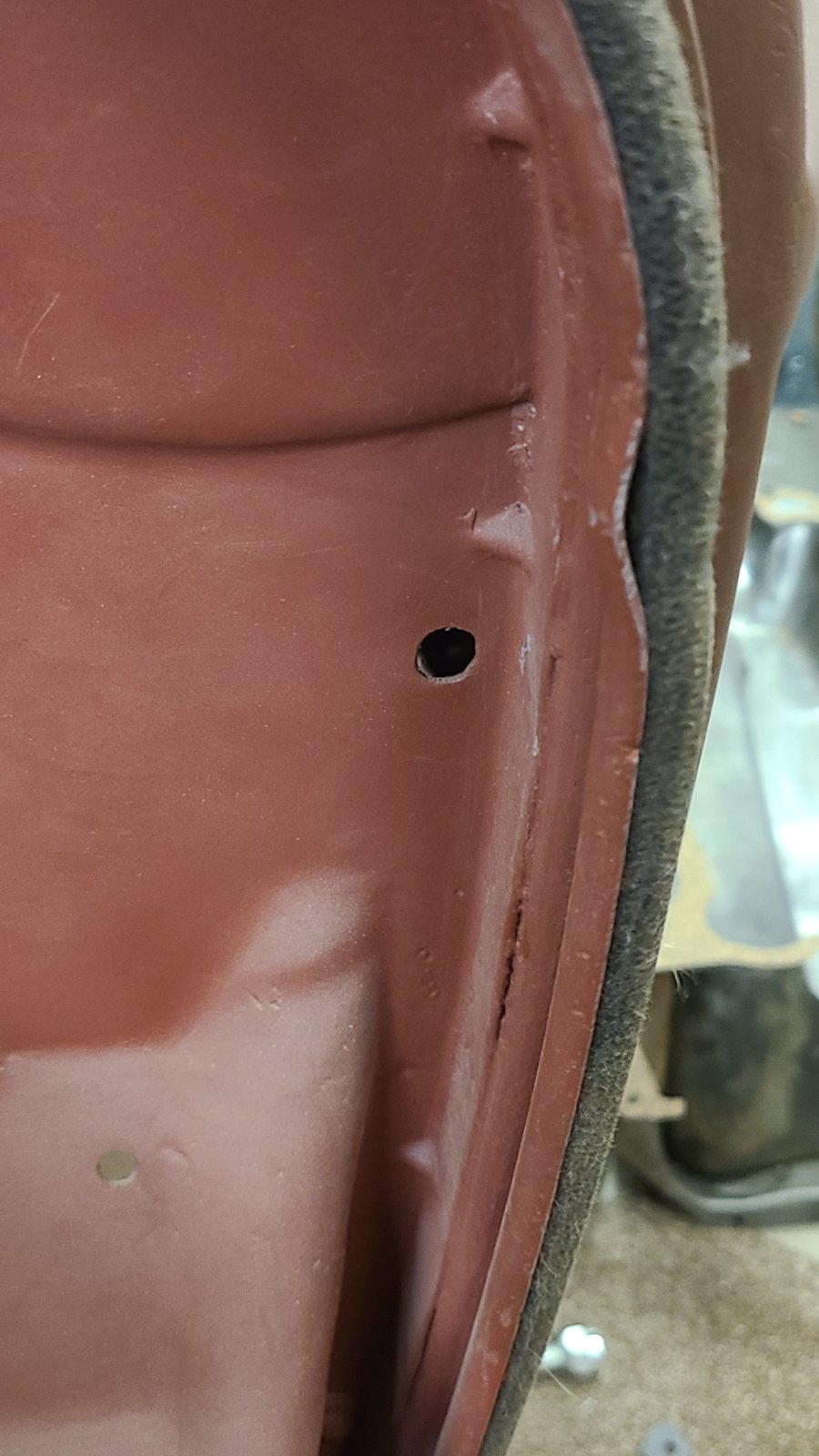

    Just found a set of black leather V strap hood hold down kit with br*** fittings on ebay. The shape would be the same as the headers. Might look really cool?

    I’ve run both the limeworks style (with the banjo springs) and the ones made by the fella that sold on here (Eric, I believe his name was) and had only one little problem with them. I seem to get caught in rainstorms all the time and when the leather gets wet, it stretches out a bit. Would just unfasten them as they were drying and they tightened up again, but hood tops would move a bit (at speed) when they were wet (stretched out). They always held, but it can be a bit unnerving watching your hood lift a bit.:confused:

    I honestly don't remember the source for hardware dead bolts, but they are stainless. I don't recall buying them online, probably a local thing. I did make sure the hood lacing was in place. The new aftermarket hood lacing was tool "round" and flattened it by running through a slip roller to flatten it.

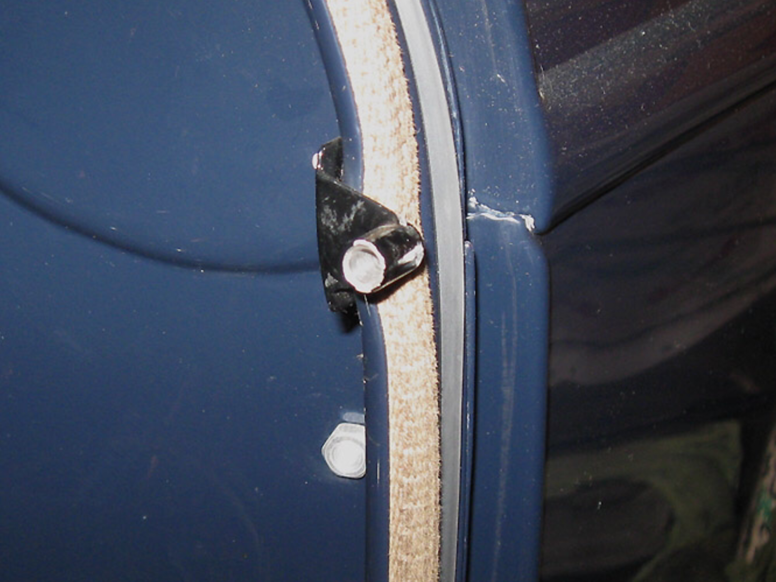

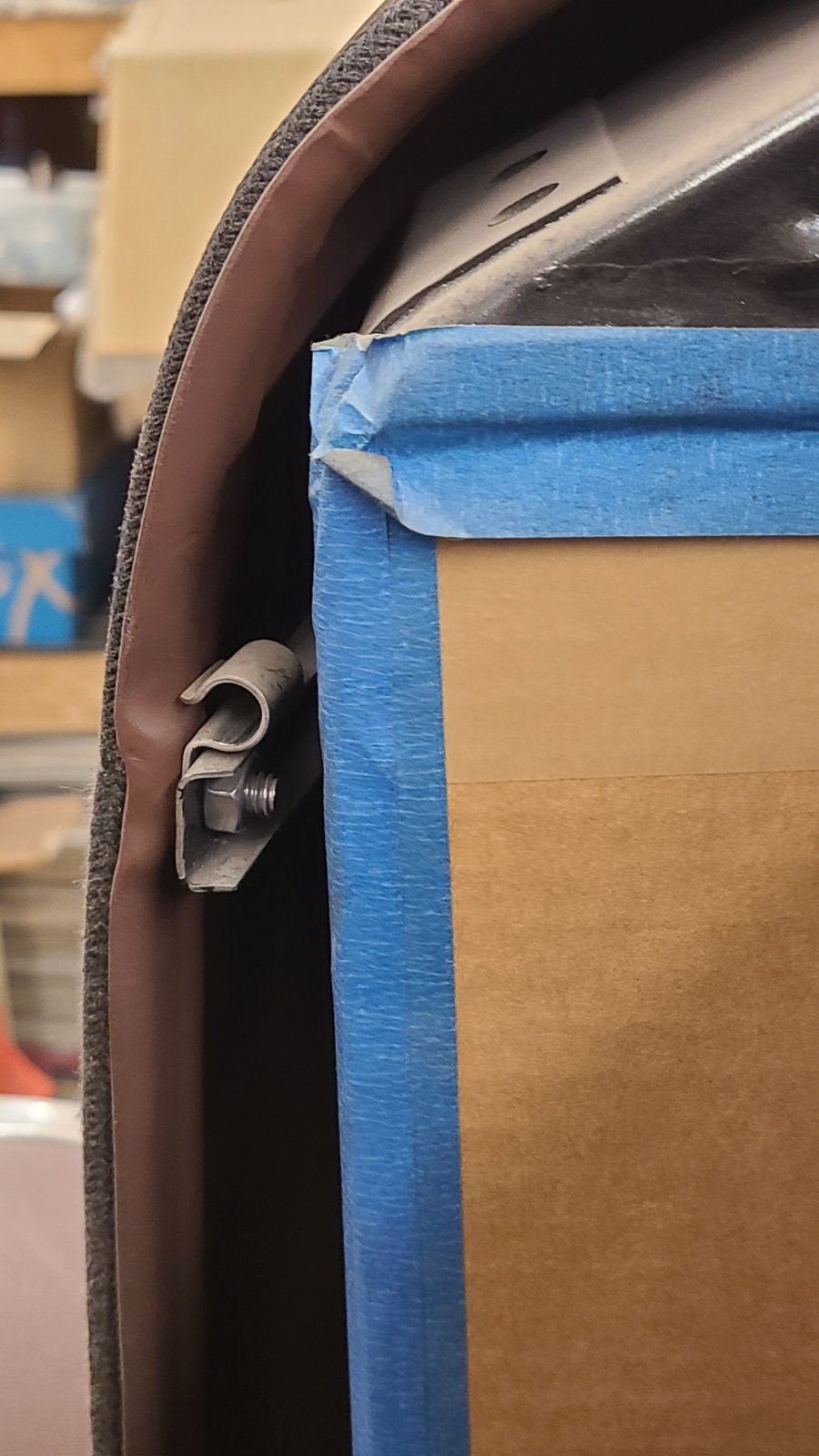

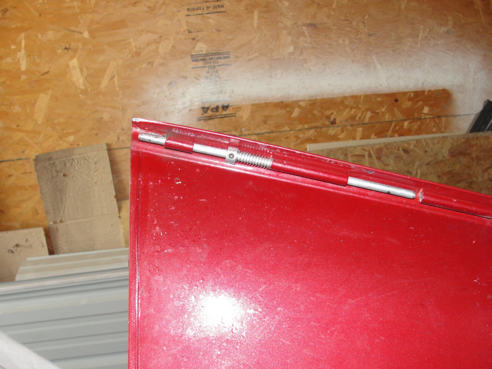

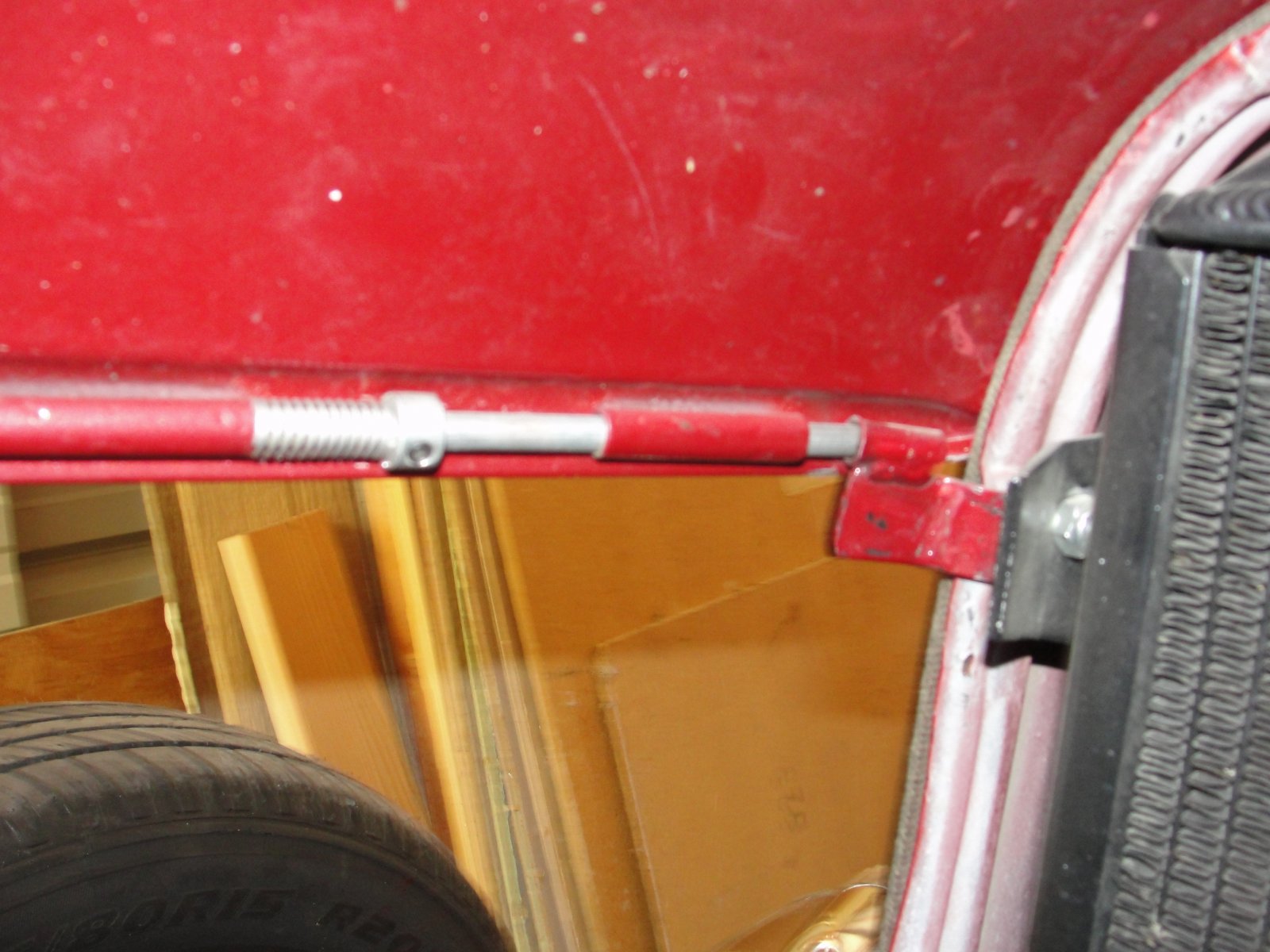

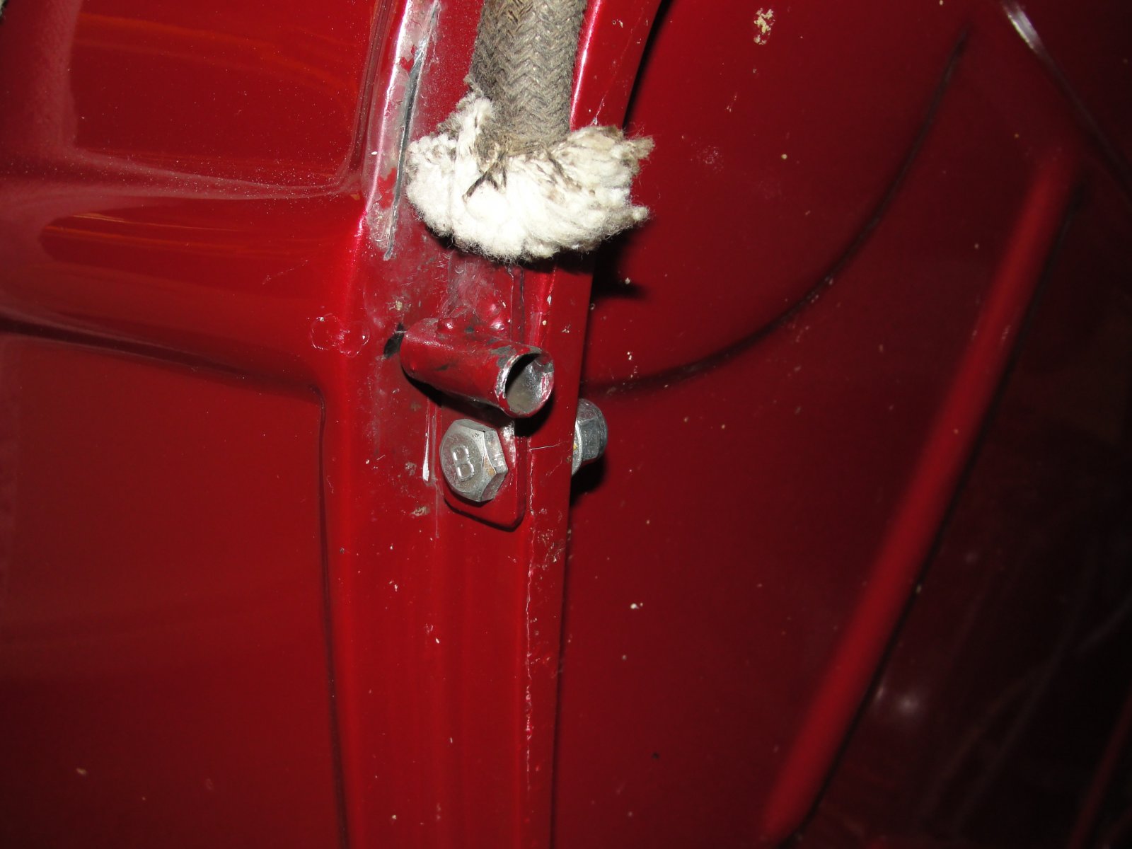

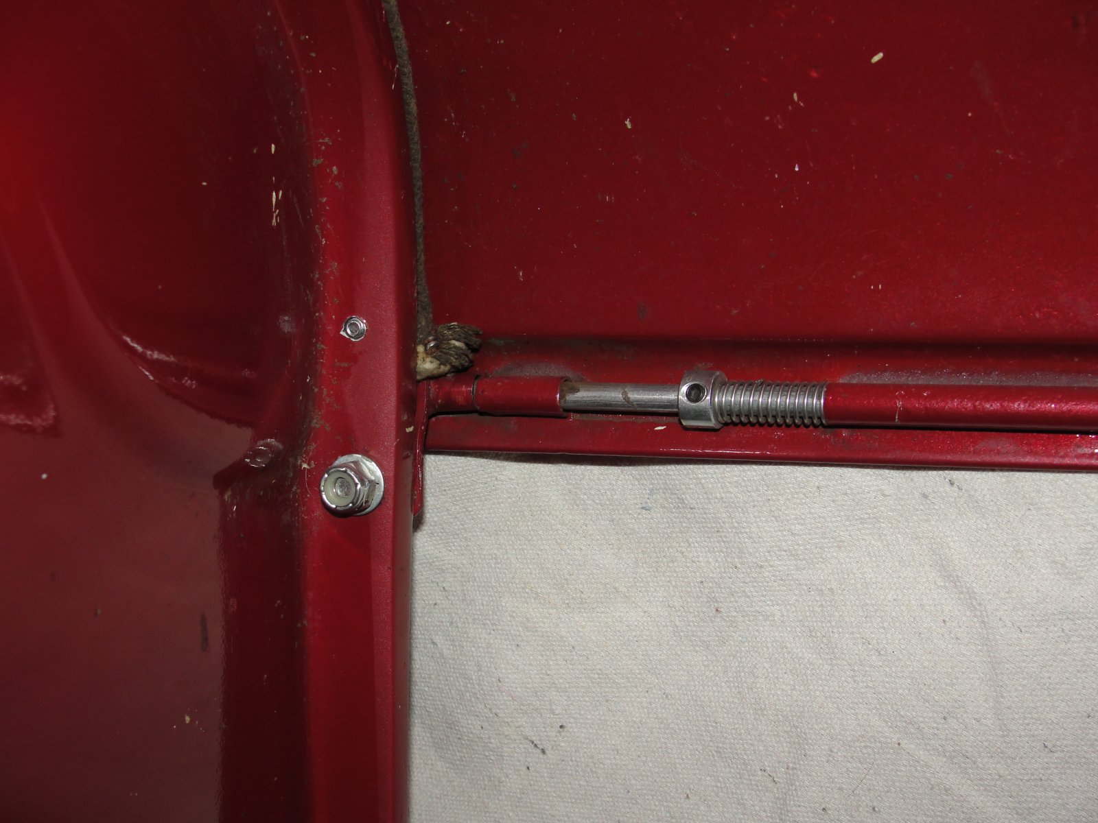

    I’ve been considering the ‘dead bolt’ method for a number of years now and big duece has a great example of them on a flanged hood top. If you are using a standard type set of hood tops that have the hinge rod style hinge then something like the following in the pics might be considered. Credit to the fellas that designed/built them and I’ve ‘borrowed’ their pics.
    and I’ve seen those s/s deadbolts on Amazon.
    Hope these help.

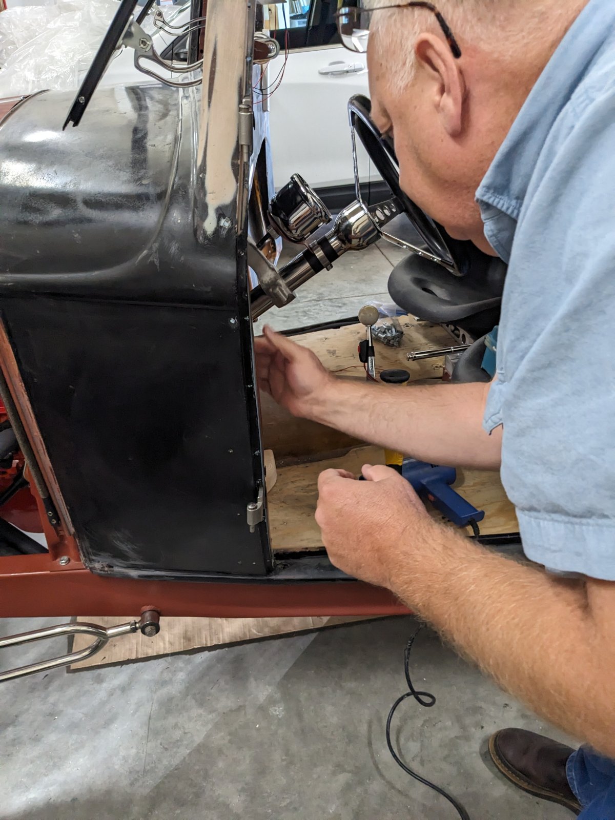

    Big day today, had the coupe inspected by the Idaho DMV inspector, p***ed with no issues. Here's a pic of the inspector installing the vin tag. Step one complete, now to pay the taxes and get my ***le!
