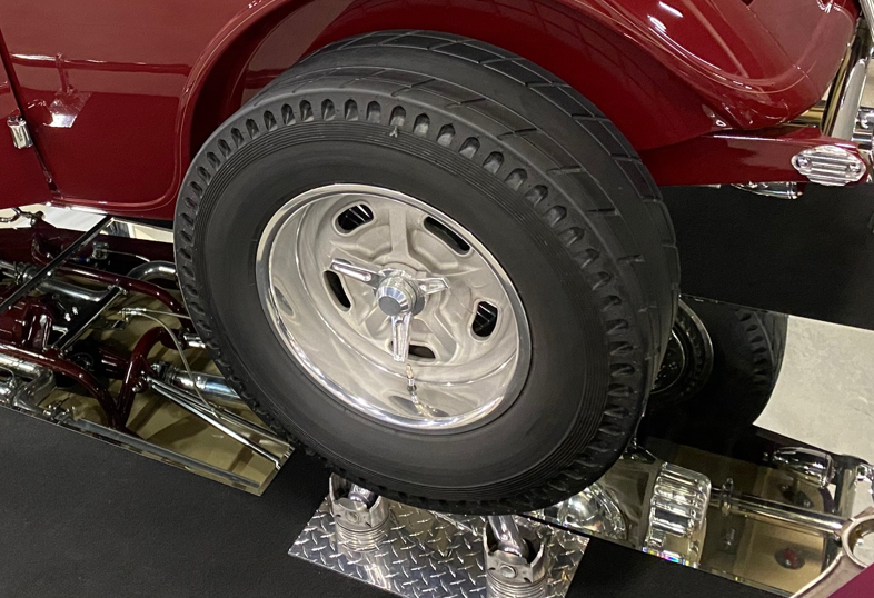

    28-Custom-designed-headers-and-side-pipes-of-the-hot-rod.jpg I plan on two symmetrical lines and finish it off with angled grooves to the edge of the tire. I plan on making each angled section about 3" long. With the angles going opposite directions from the inside to the outside. Maybe that will help push the water out if I get caught in the rain. I like this guy's idea. Make that 4 symmetrical grooves! Might be fun to do!

    I have seen some pretty amazing siping. Flames, words, and wild patterns. One tip I can offer. I saw someone layout the design using a paper pattern cut to the proper length (tire cir***ference) then use those punch wheels once the design was drawn.
    Wrap the paper pattern around the tire and a chalk bag to mark the pattern. It really, really helps to have a mount to allow for spinning. A balancer or even an old axle on stands. Something to allow steady cutting.

    I like that idea, a friend of mine does leather work. Bet he has one of those roller markers. Another idea is aluminum cut out for the angle cuts. I remember hearing something about tread design, something like if all tread blocks are exactly the same size, you could get a whining sound going down the street. Or maybe you don't. Anybody ever experienced that?

    "Siping" is the very thin razor-like slits in the tires tread blocks.
    As far as I know, siping has very little to do with a tires ability to evacuate water from the contact patch.
    It does increase traction by creating edges in the surface of the tire that will offer more grip to the road surface.
    "Grooving" is what sheds the water.
