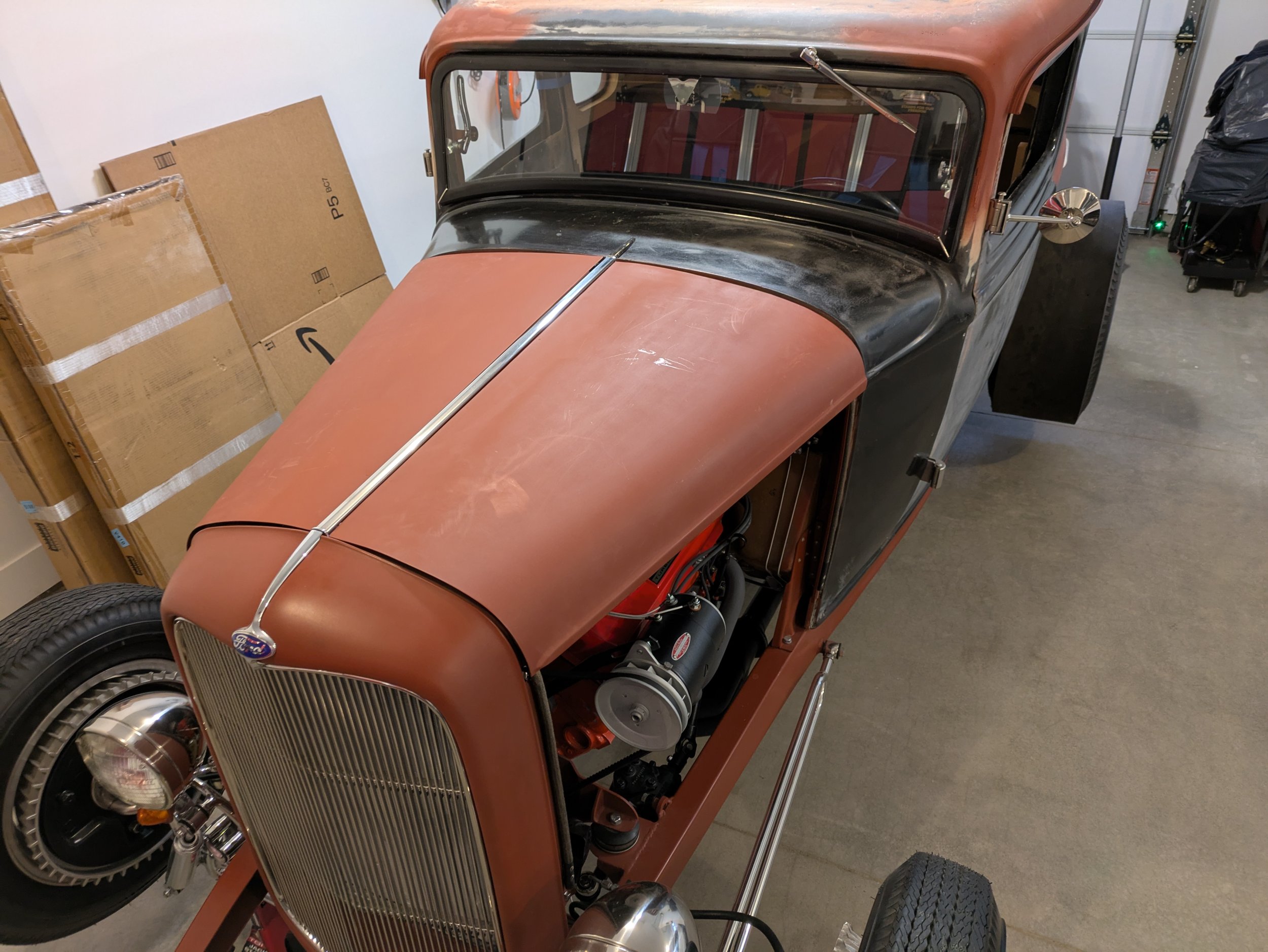

    Here's some pics of the new stainless rear spreader bar (front soon). The pain in the **** top hood hinges. This was a one piece hood, but changed my mind. Cut out the center, riveted 1/2" aluminum angle using solid aircraft rivets. Marked and drilled the holes for #10 screws, but only used #8 hardware to get some adjustment room. So far so good? PXL_20250208_003625048.jpg PXL_20250208_003615695.jpg PXL_20250208_003642316.jpg PXL_20250208_003629727.jpg PXL_20250208_003602411.jpg

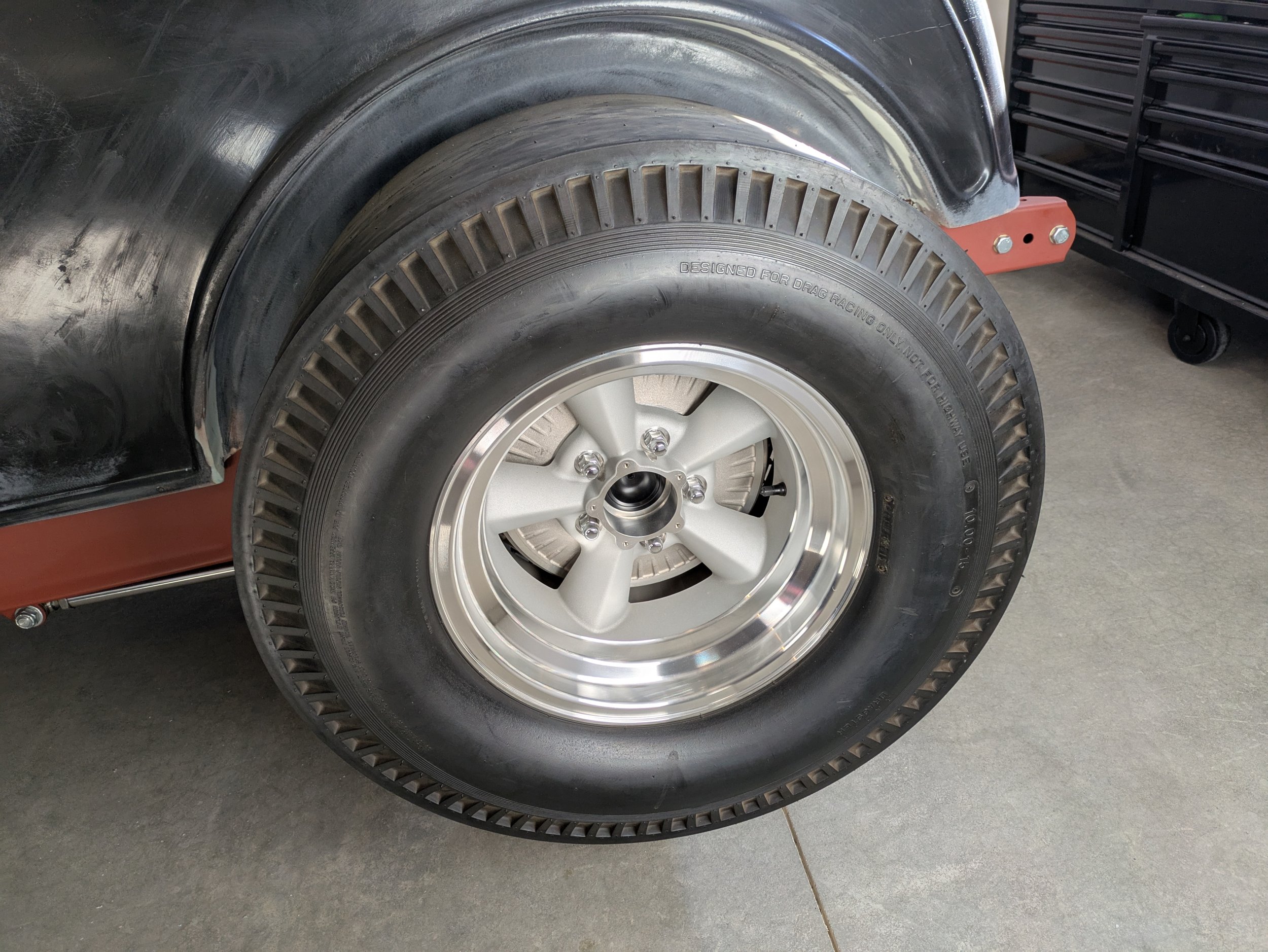

    Decided to sell the back wheels and cheater slicks. They just seem a bit to big plus not very streetable. Look in for sale! PXL_20250208_183813072.jpg PXL_20250208_183821831.jpg

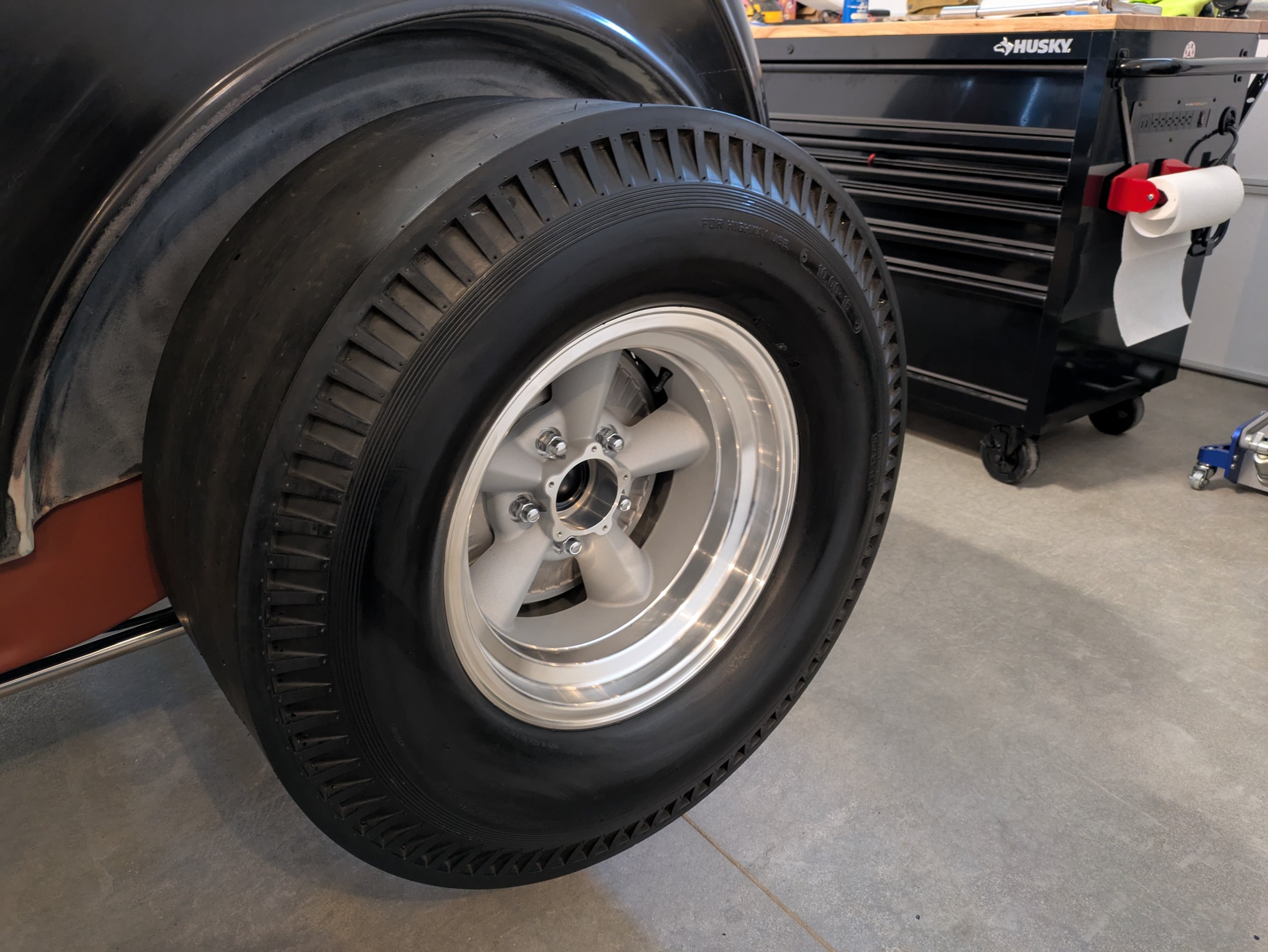

    They aren't cheater slicks either, true dragslicks. I plan on sanding off the warnings and groove them and go. How's that for a pair? Zoom in on the sidewall back half. You can read the message. PXL_20250208_183813072.jpg

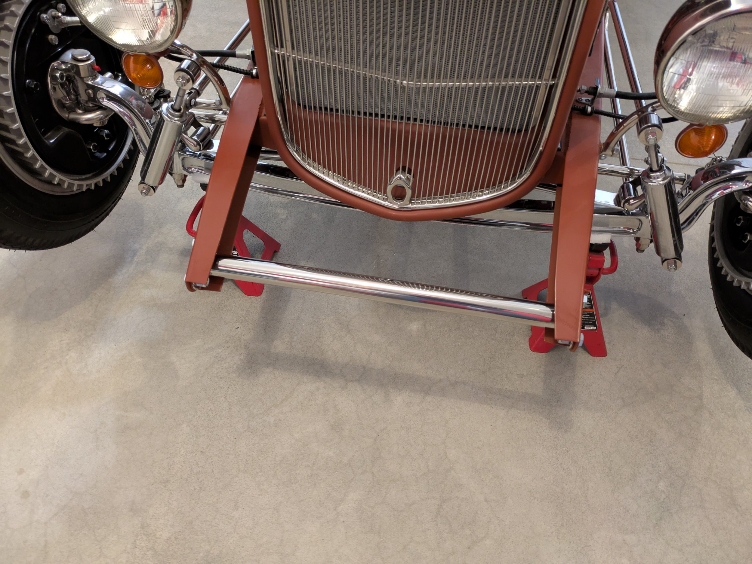

    Ok back to the coupe! Installed the front stainless spreader bar. Nice addition. Hood hinges are ready to align and bolt on. Latches and receiver tubes are next. PXL_20250216_010255890.jpg PXL_20250216_010313478.jpg

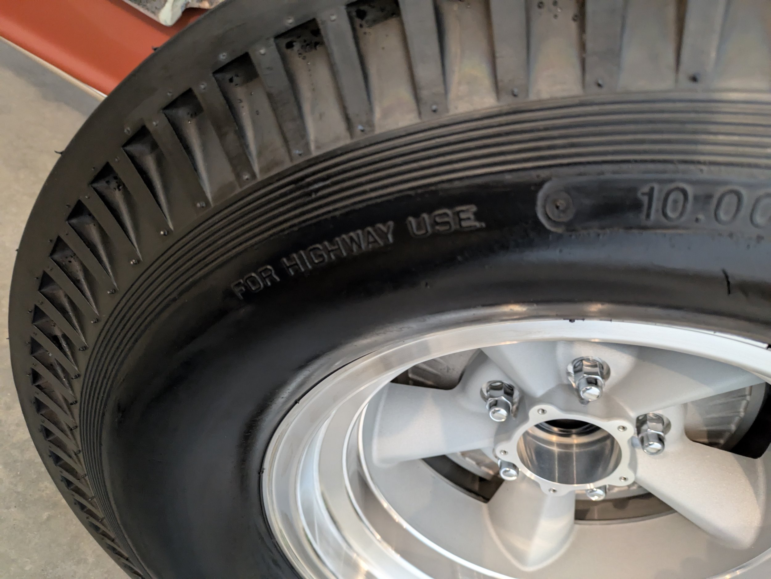

    Well got the DA out and gave it a try! Any comments? Zoom in!
    brEad, Butch M, guthriesmith and 3 others like this.
  29. Bandit Billy
    Joined: Sep 16, 2014
    Posts: 17,207
    Bandit Billy
    I have done this procedure several times and it looks like you don't good! The last step I do is to polish the tire with a buffer where I sanded off the lettering. I hit it with 2000 wet paper and then an old bonnet that is headed to the garbage can. It doesn't take much speed to melt rubber so keep it under control.
    loudbang and Splitbudaba like this.
  30. Splitbudaba
    Joined: Dec 30, 2014
    Posts: 1,025
    Splitbudaba
    Good to know, I will try that. I did it on the white wall side too. Only problem is the inside of some of the letters were white? Surprise, surprise, surprise!! Black shoe polish worked great! Any other ideas?
