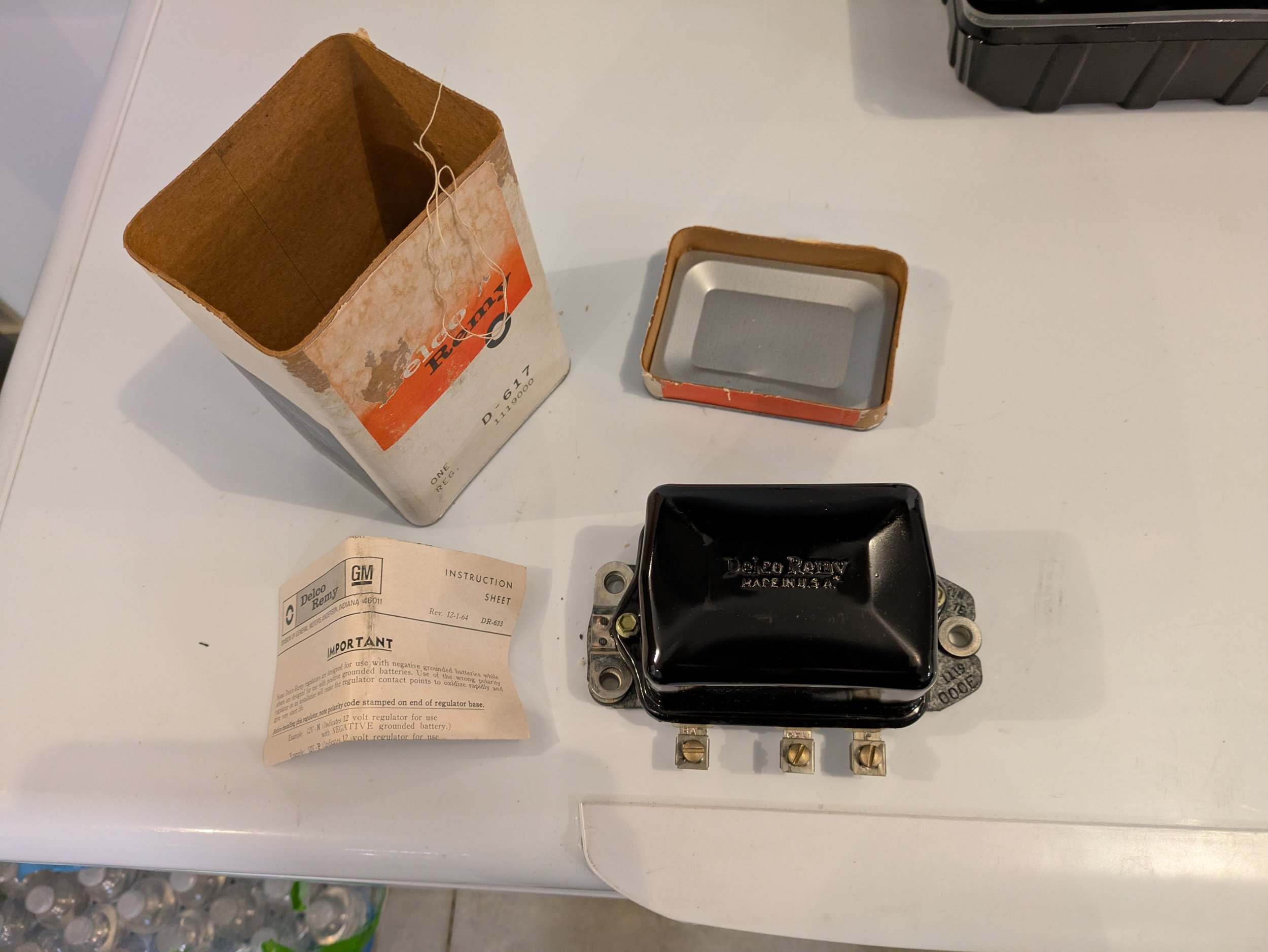

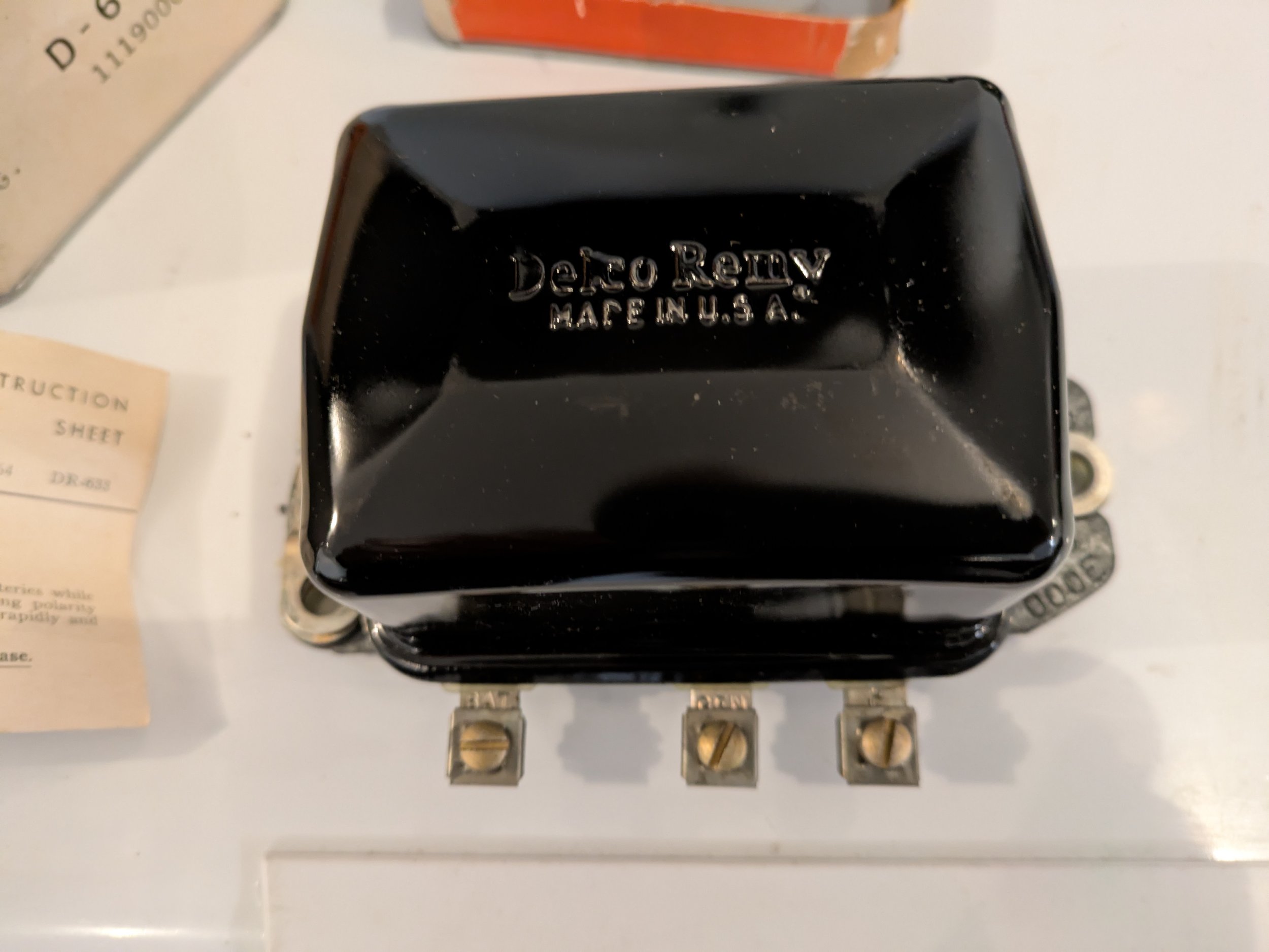

    Getting ready to groove the slicks. But I made a find in the voltage regulator issue. Seems the D618 has been the issue, it is the newer version, however it is made for higher amp generators. Precisely 26 to 35 amps.Well mine is a 25 amp generator. So did some digging, found I need a D617. No longer made!! eBay to the rescue. Found a never opened D617 regulator in the box. Got brave and bought it. Nice part it is easily adjusted. Like that idea. I get it next week, fingers crossed!

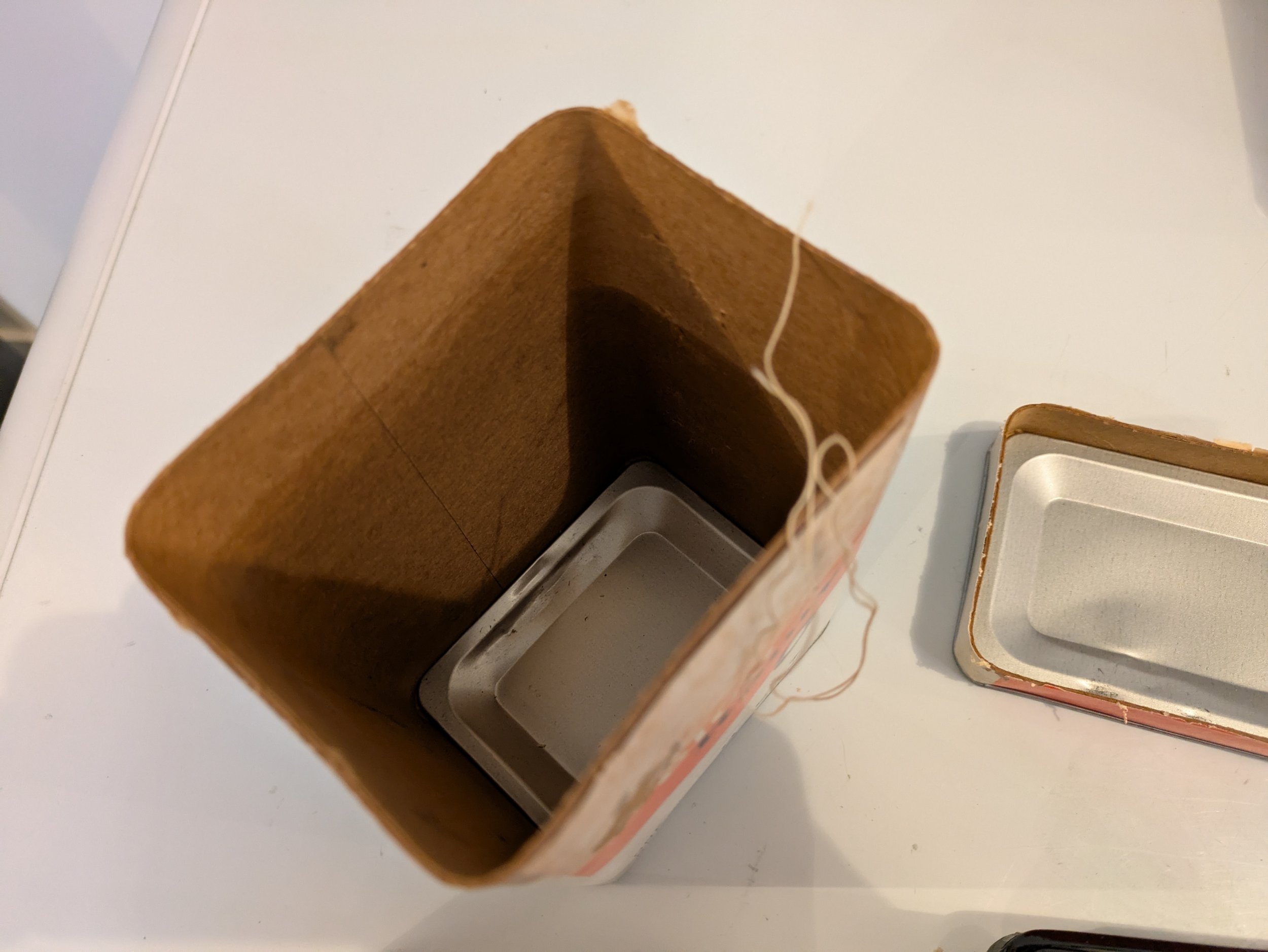

    Got my voltage regulator today. Two days late, USPS delayed. Kinda fun opening a piece of the past. Pulled the string and popped the top. The smell was familiar, everything inside is mint. Next bolt it on and hope for the best!! PXL_20250312_154923381.jpg PXL_20250312_154916309.jpg PXL_20250312_154919585.jpg

    That did the trick!! Love the adjustability, second time set it right in, plus I am going to add another ground to the regulator case for extra measure! No hot spots, sparks, etc. Gen and regulator stay cool!! Next thing is groove the slicks!

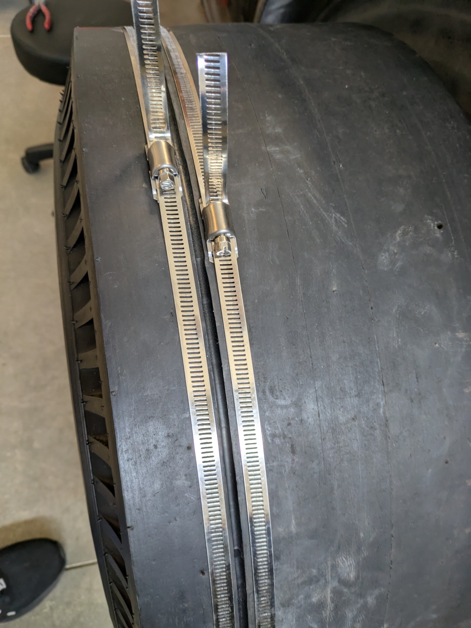

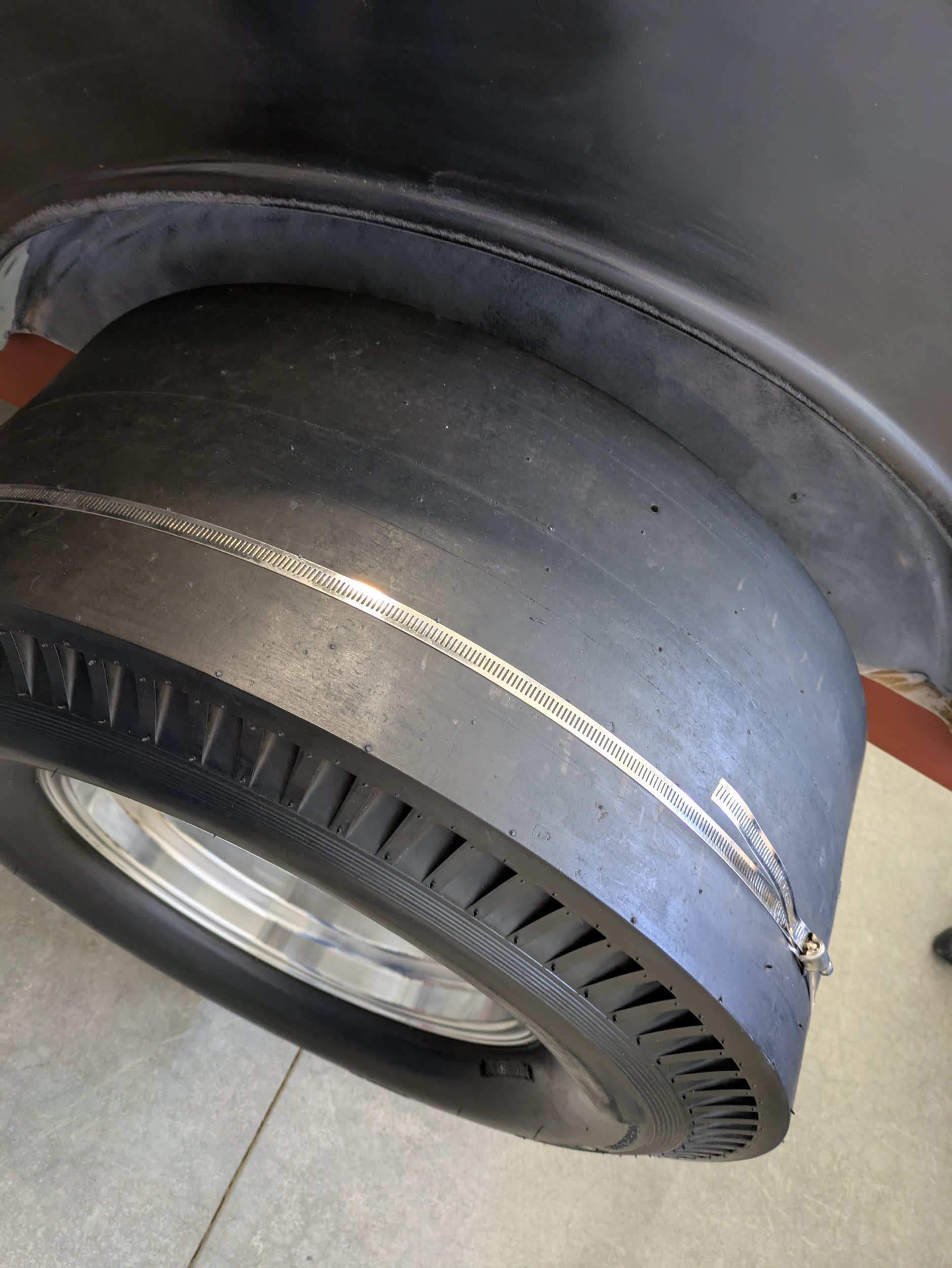

    Finally getting back on the coupe. Had more generator issues. Had to replace the field coils, all is well now. Here's my idea for grooving the slicks. Big long hose clamp, tighten down where you want it, use it for a guide for the grooving tool. Will try it tomorrow, wonder how bad it will smell? PXL_20250417_225608492.jpg

    That’s clever, I’m curious if it would be easier to keep uniform depth if you hold steady and have a helper turn the wheel?

    That's what my wife is doing!!! See more tomorrow!!

    It doesn't smell too bad. I have done several sets for sand rails when I was younger. Just do it in a well ventilated area.

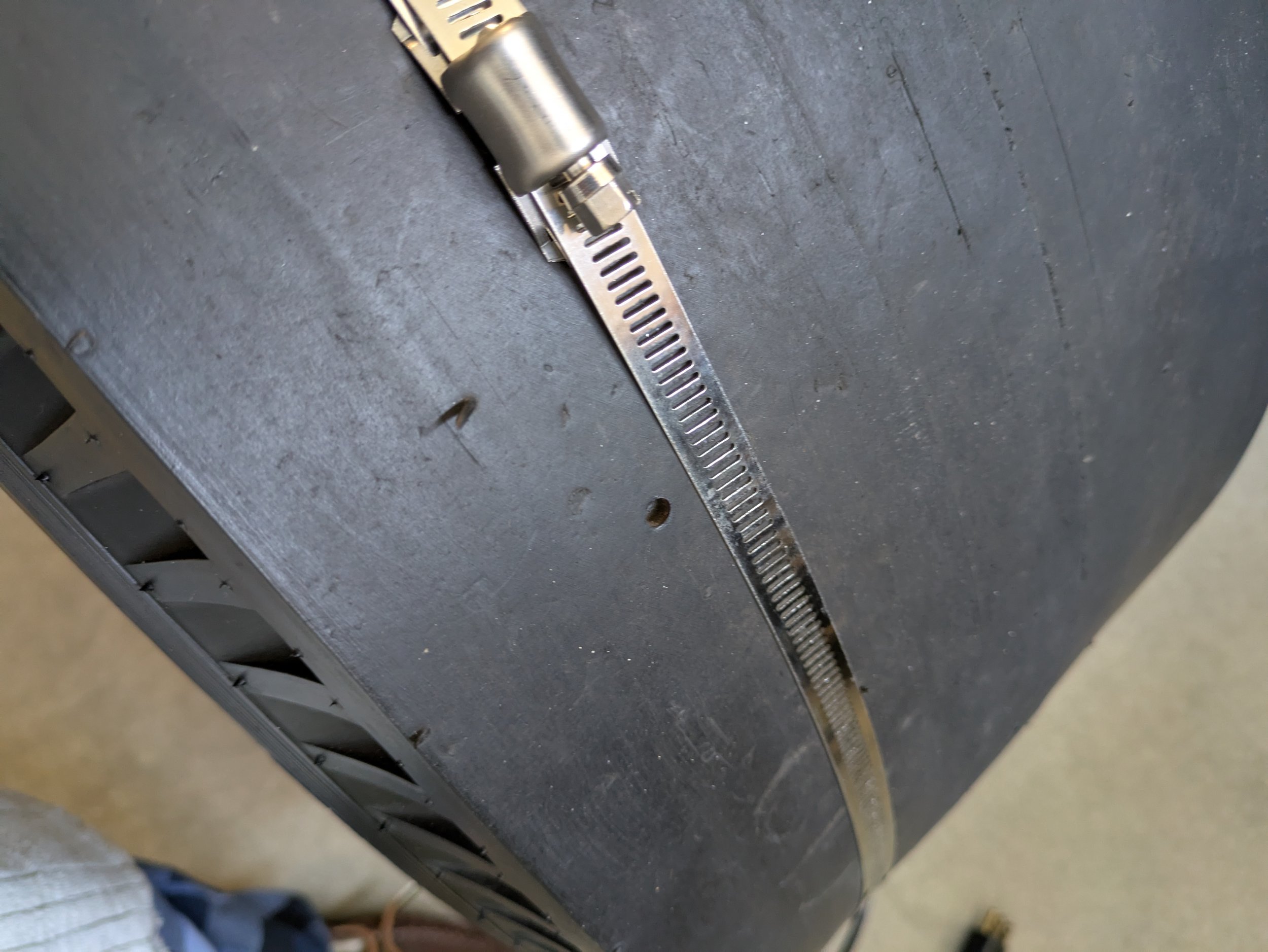

    Tried a small section. Went like ****er, speed is the main thing. Now it's time for the long cuts. My wife agreed to turn the tire. Smell wasn't bad, fan helps. PXL_20250420_164304443.jpg PXL_20250420_164400585.MP.jpg
    shortypu, Tim, brEad and 4 others like this.

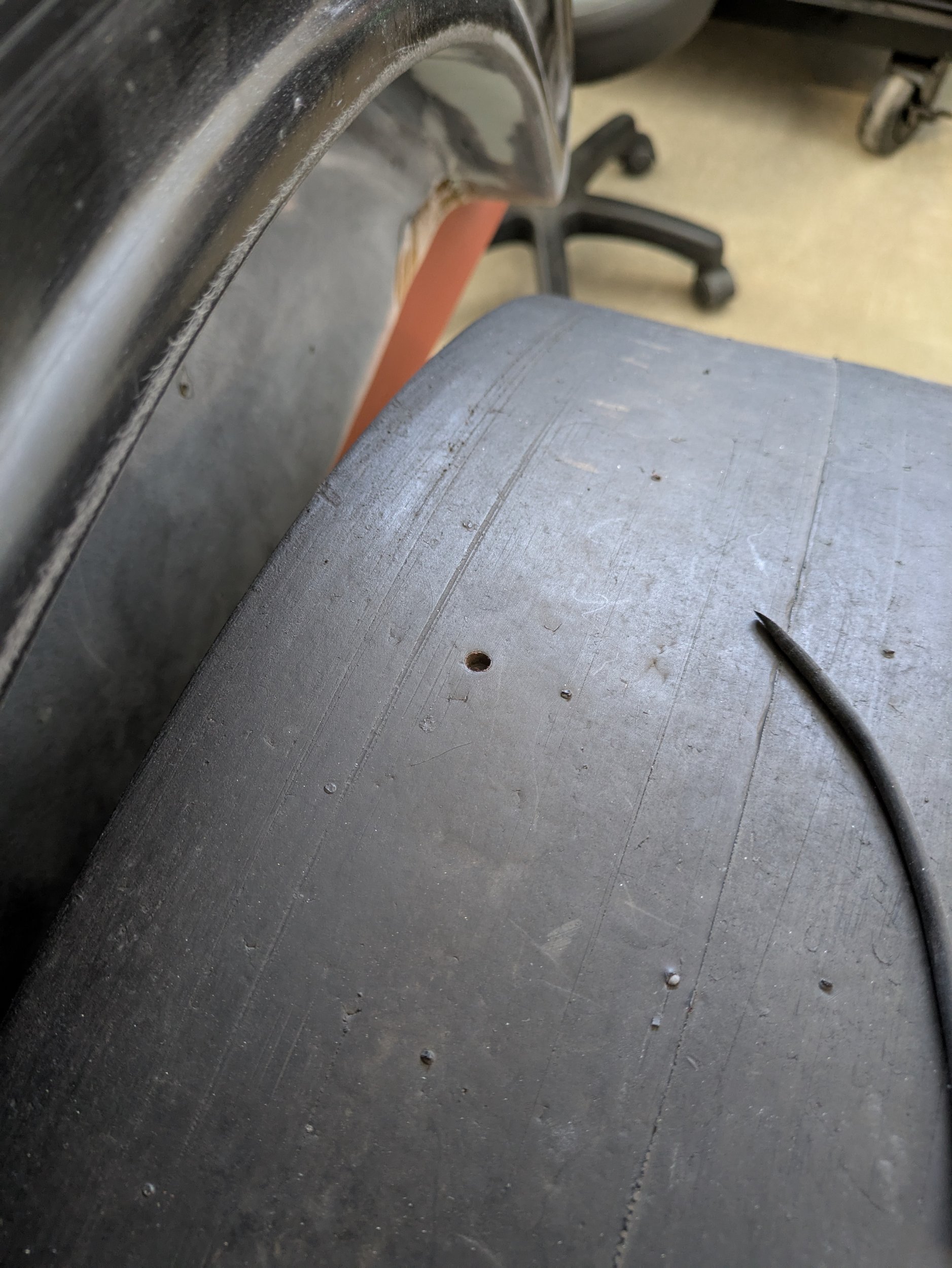

    That looks great! My TC tires have a little hole in the tire, dead center, at 12:00 and 6:00 on each tire. Obviously, a mould mark or something. It is the only thing I don't care for. I tried filling them with black RTV but it doesn't stay in under driving conditions. Do your tires have such a thing?
    Splitbudaba likes this.

    I have holes around both tires. They are a certain depth. When the holes disappear from loss of tread, it's time for a new set tires soon. That's the depth I made the grooves. PXL_20250420_174924389.MP.jpg PXL_20250420_174915355.jpg

    Those blind holes are usually wear indicators.

    I never thought about them being wear indicators. Thanks guys.

    Yep, referred to as "check holes" by drag racers. Shallow check holes mean your wallet is about to get thin.

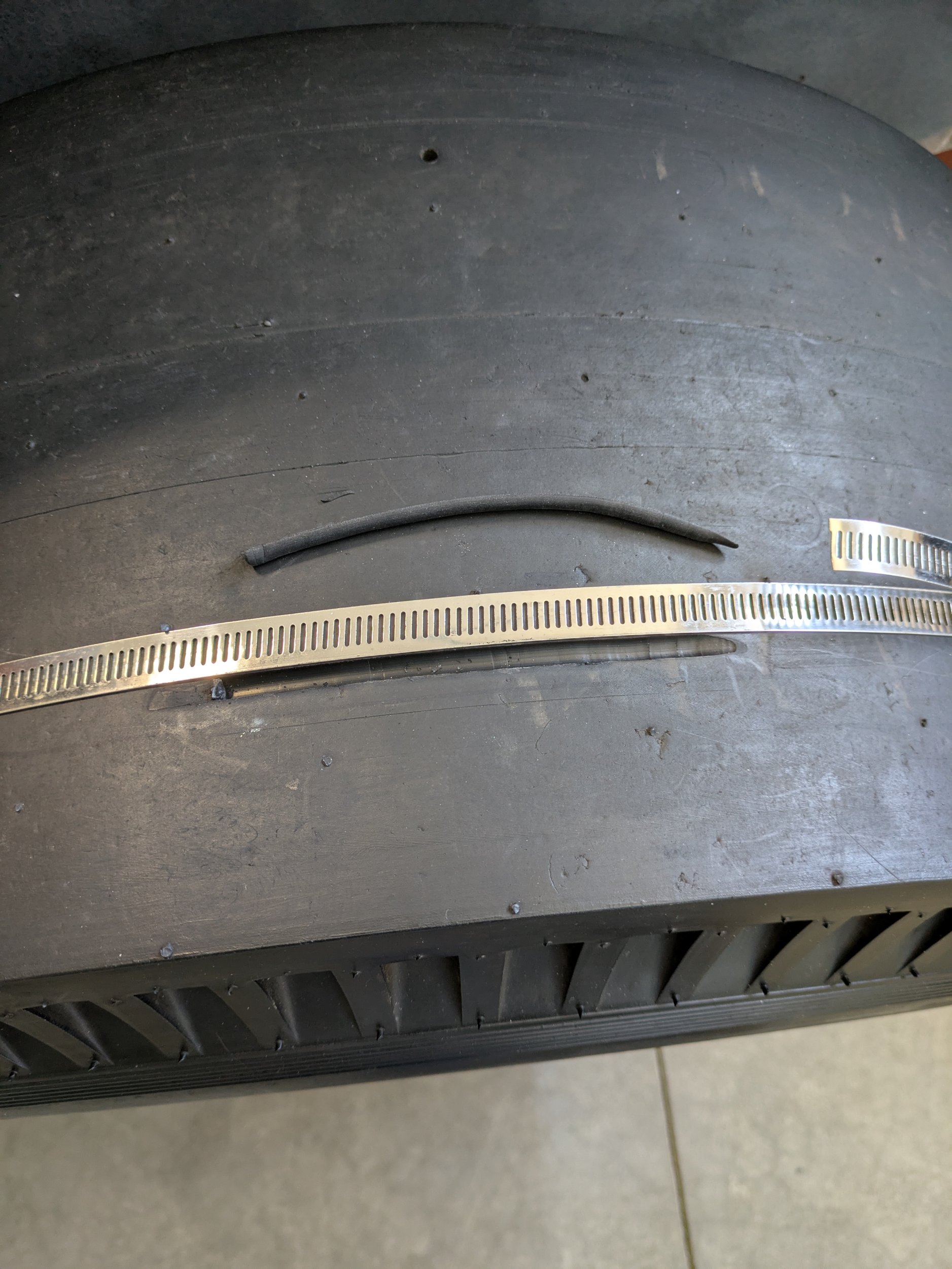

    Went around turning the tire myself. Didn't like the way the groove came out. So next try will be the 1/2" blade between two clamps and my wife turning the tire. I learned the angle which you hold the cutter must stay consistent or the depth varies. PXL_20250420_201822066.jpg PXL_20250420_201814249.jpg

    Update, didn't do so good on grooving the Radirs. My wife stepped in.
