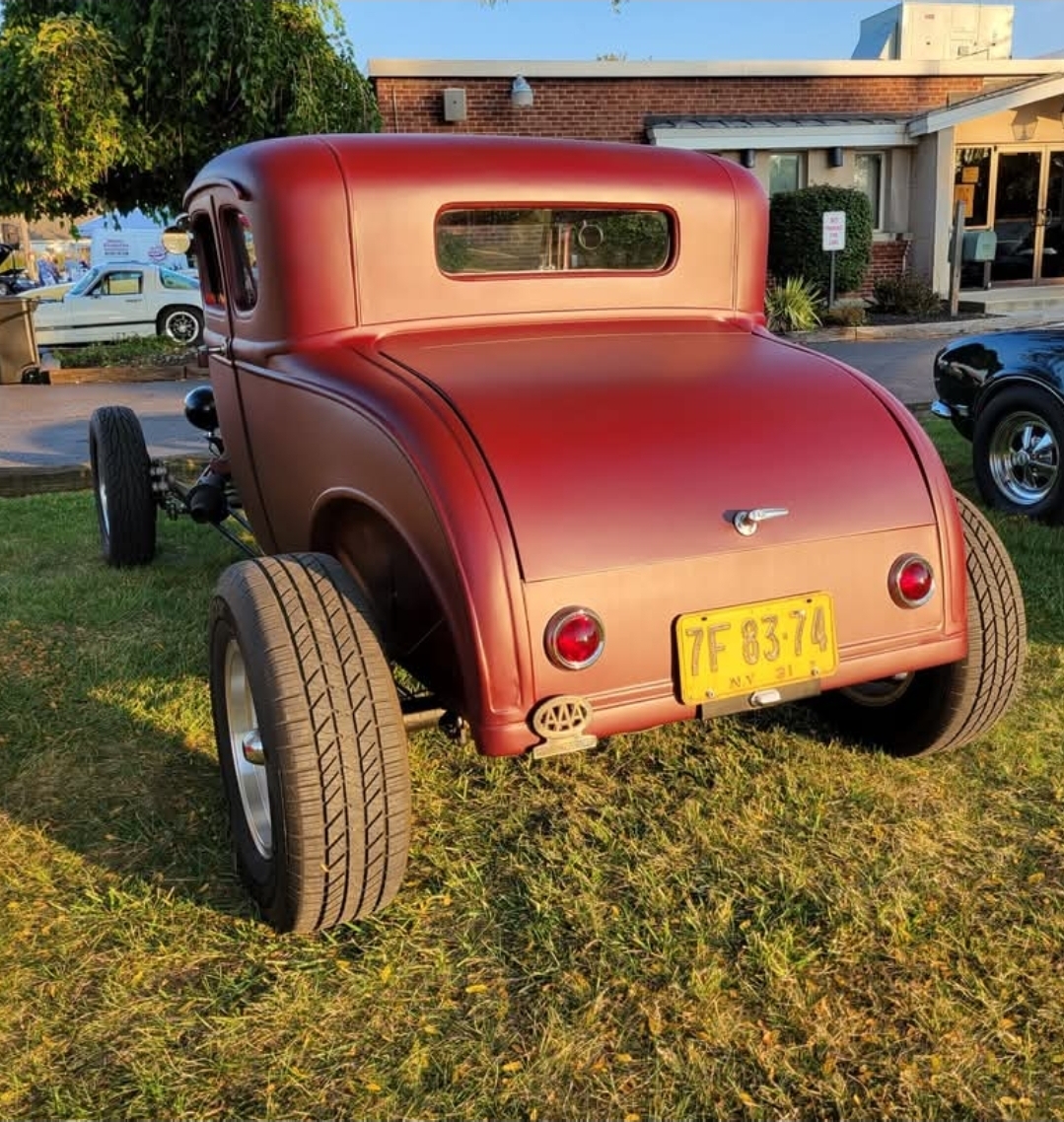

    I dig it, I'm not a big primer fan as it doesn't protect well, non UV, blah, blah, blah. I created a paint for the underside of GM F bodies that is a dark red primer looking color, matte finish, a knock off of what GM used but better because it is paint. Just a variation on your theme. Congrats on the successful drive. Really have enjoyed the build.

    Bet you don't drive that in the rain or snow!! Just the way I like it. Beautiful!!

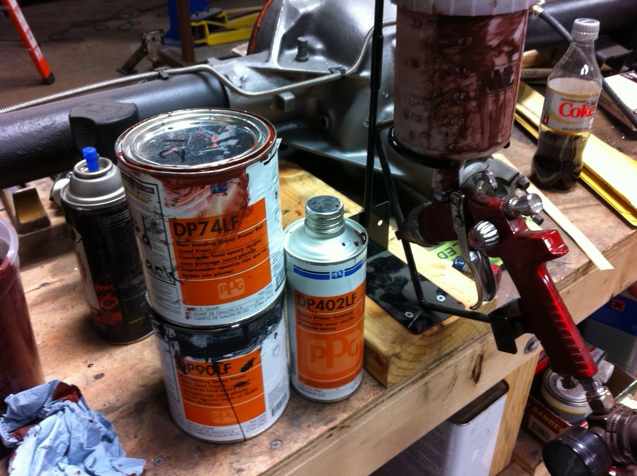

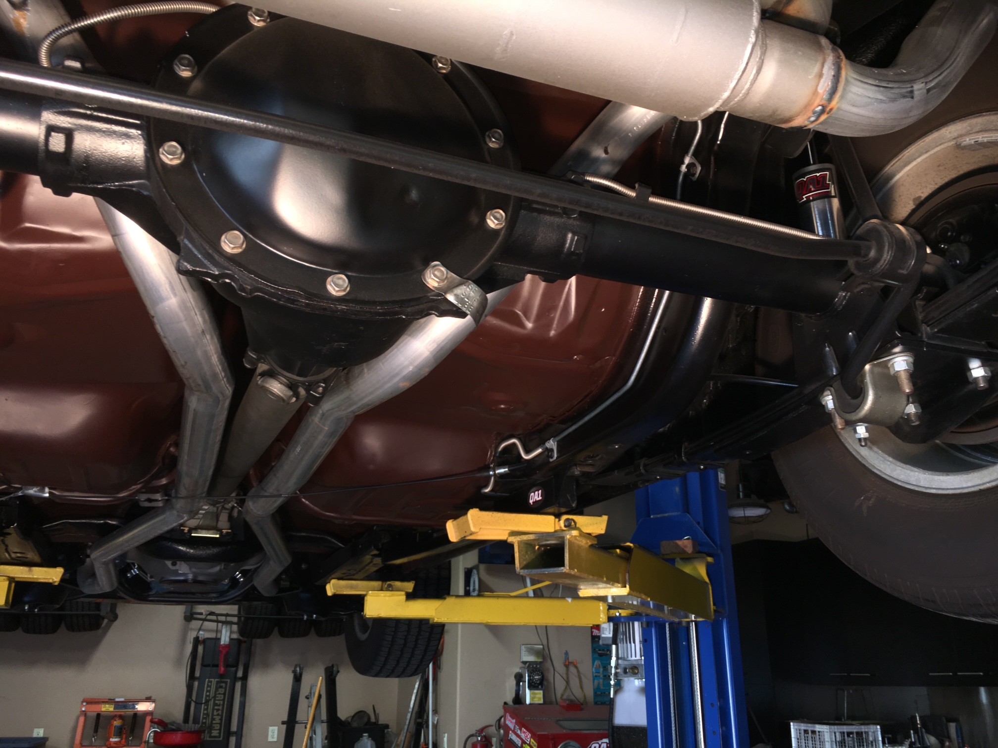

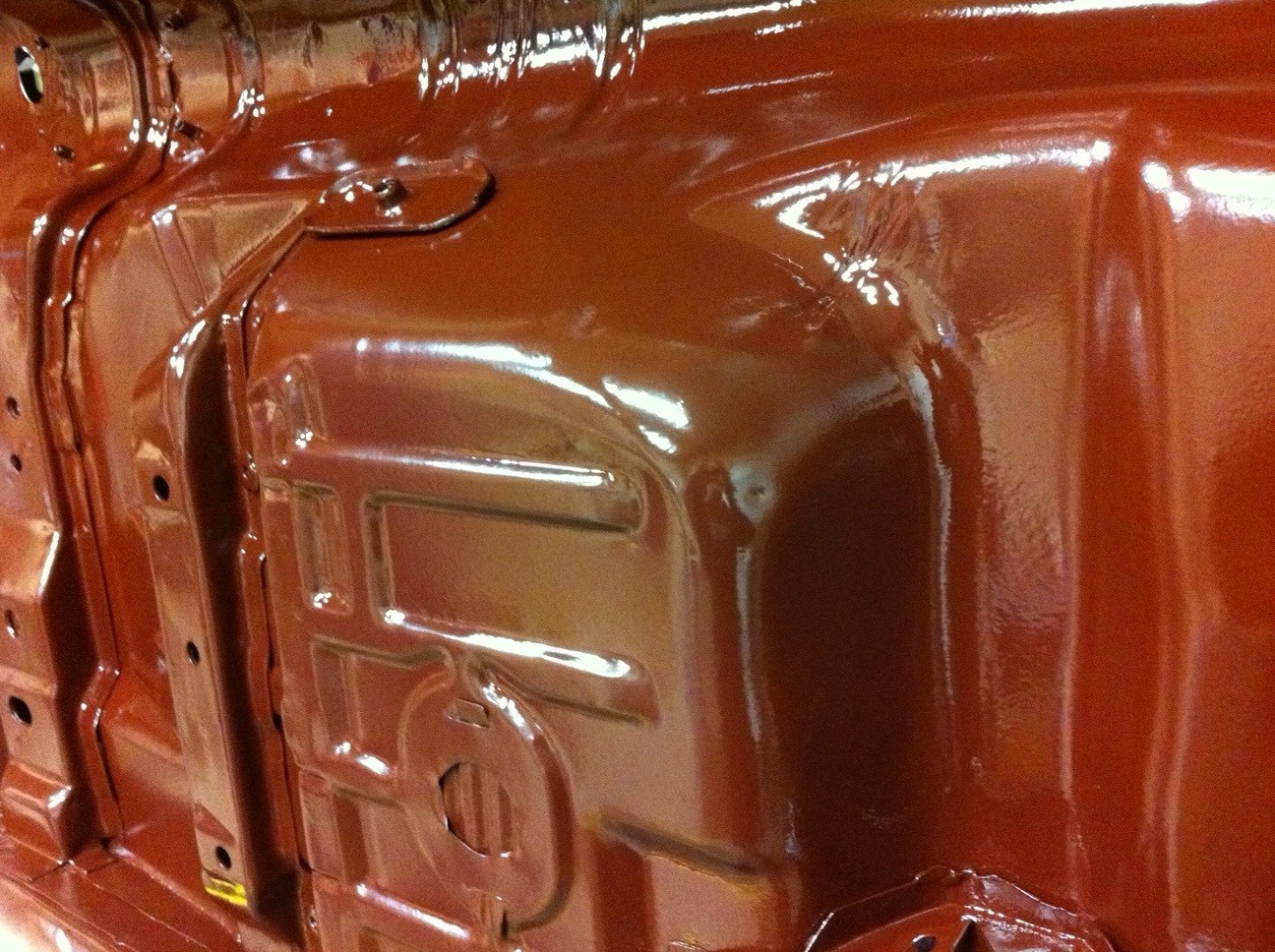

    Here is another underside I did trying to find the right color and sheen
    This was close. The color is spot on but here I used epoxy primer and shot hardened clear over the top. Result was too shiny (I can't believe I said that). This was the product, the mix was 50/50. I should have used a little flattening agent in the clear.
    Not to steal away the thread but I paint matched these two PPG primer colors in hardened base (shop line) and cleared with Shop Line 2:1 clear (production clear) with flattening agent on later cars (like the one pictured above).

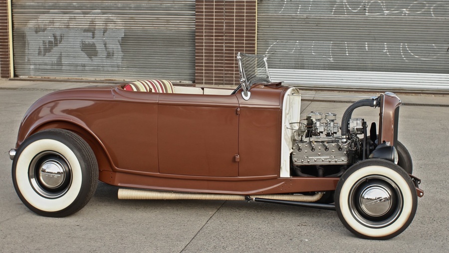

  7. DDDenny
    Posts: 23,416
    That satin ruddy brown is the bomb!
  8. DDDenny
    Posts: 23,416
    catdad49, Zax, Motorwrxs and 3 others like this.

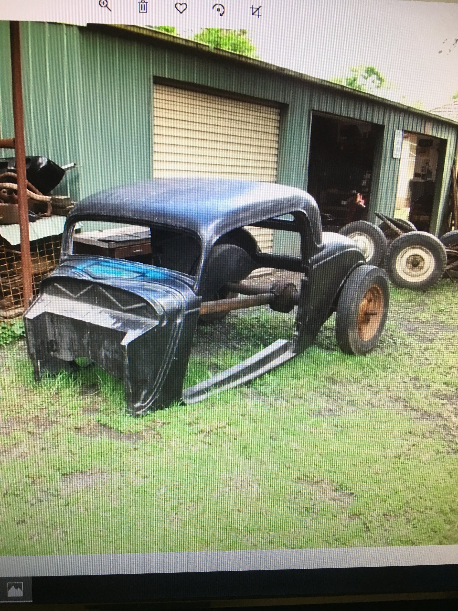

  10. Dago 88
    Joined: Mar 4, 2006
    Posts: 2,496
    Dago 88
    Not hard at all, I started with a gl*** body with a 3” chop & went another 2”. This was the first time I worked with fibre gl***, it was quite easy really, good luck.

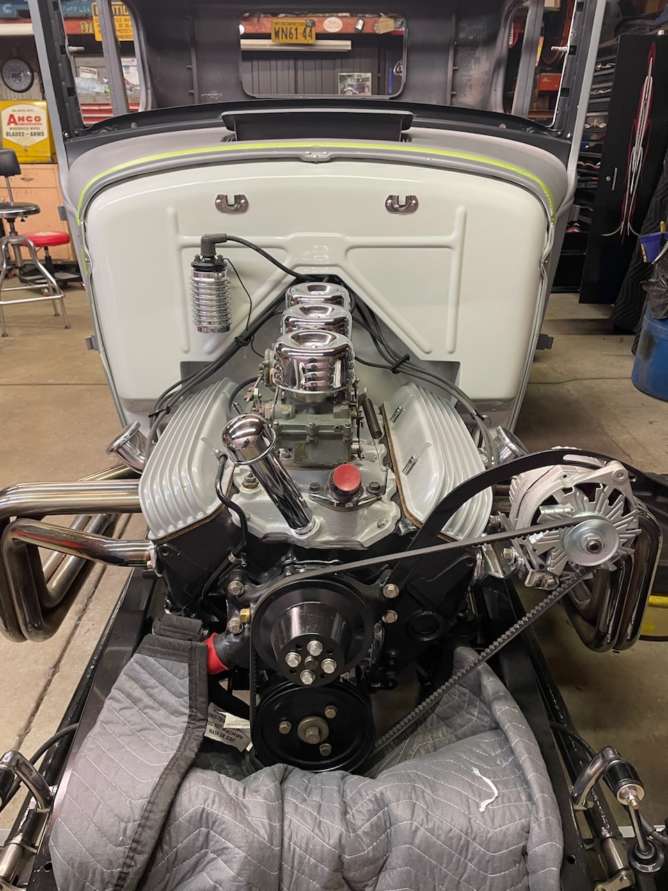

    I didn't really think so, I even hesitated to post it, but the white firewall drew me in because I thought you had that in mind.

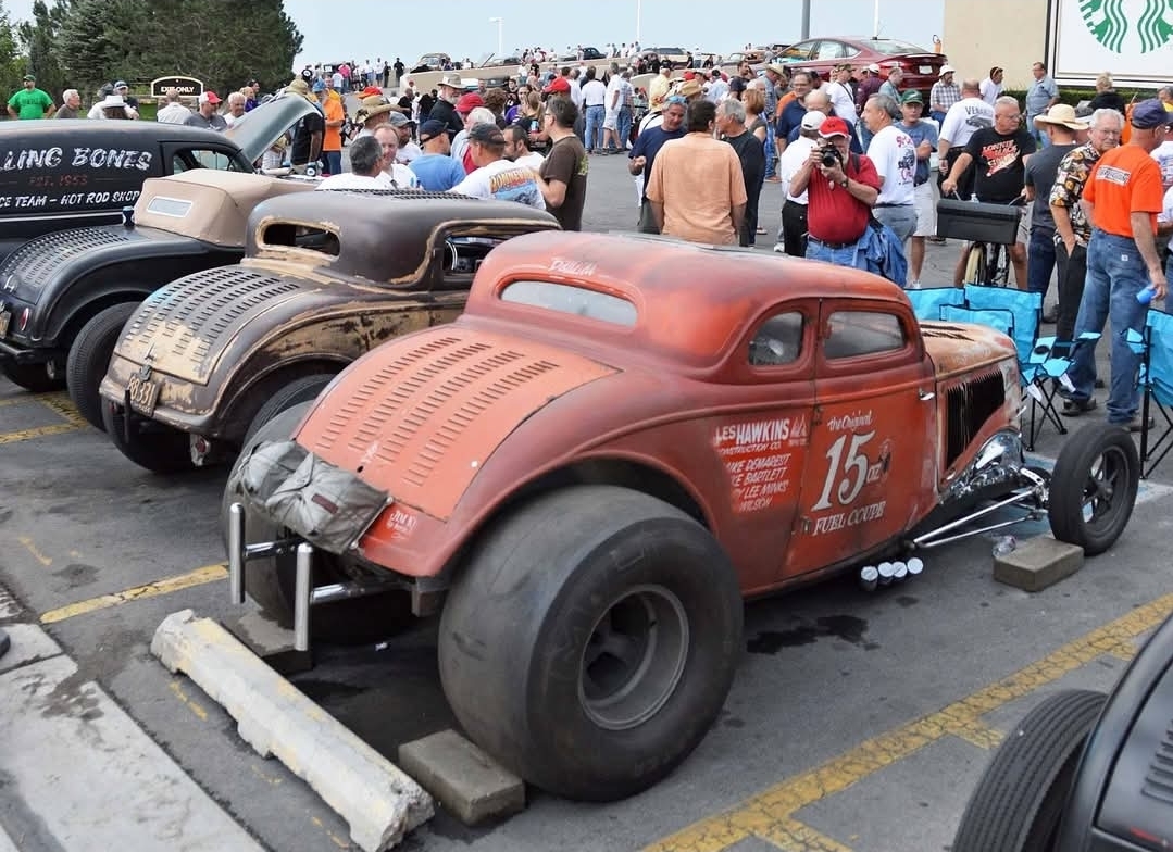

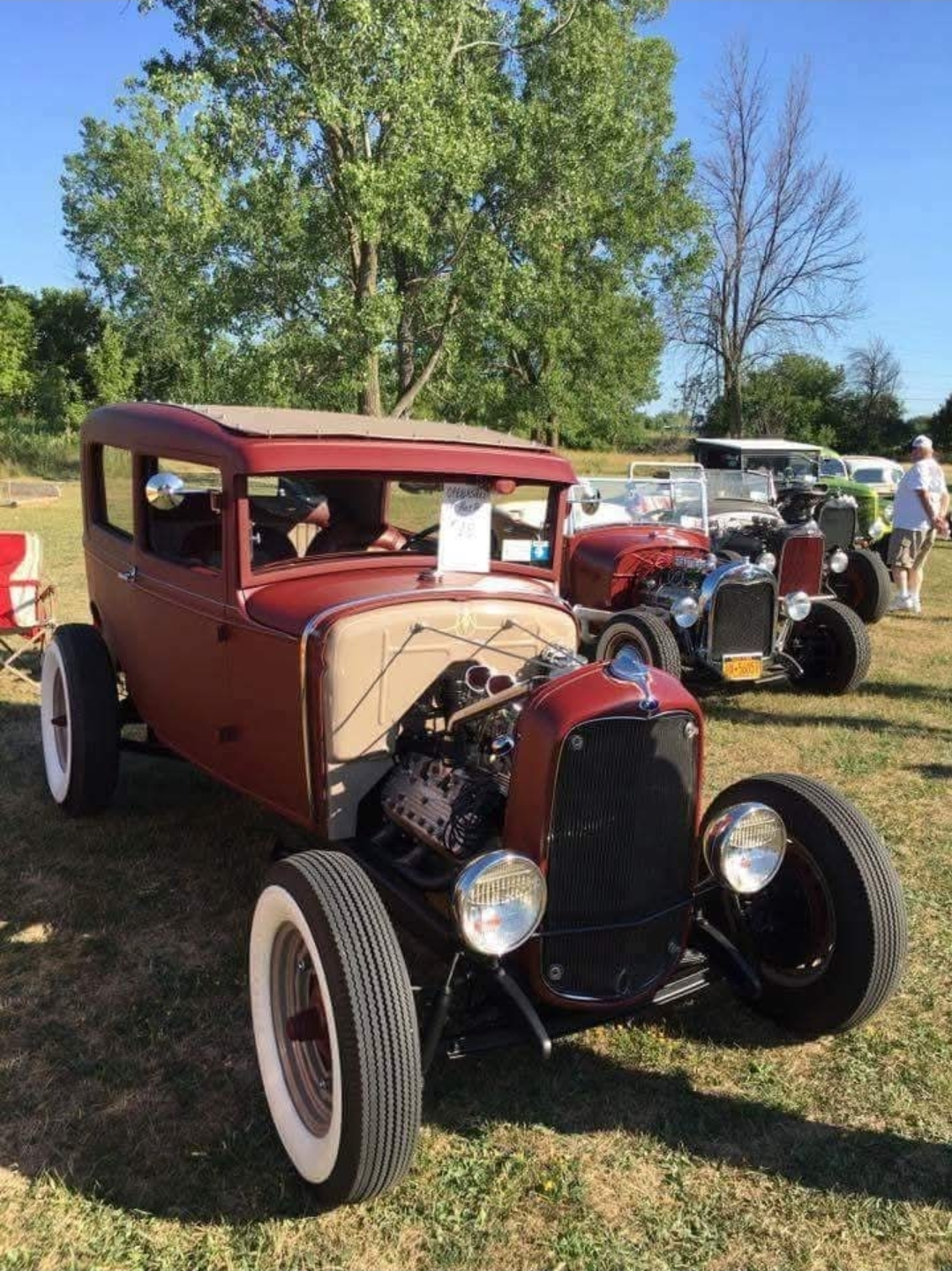

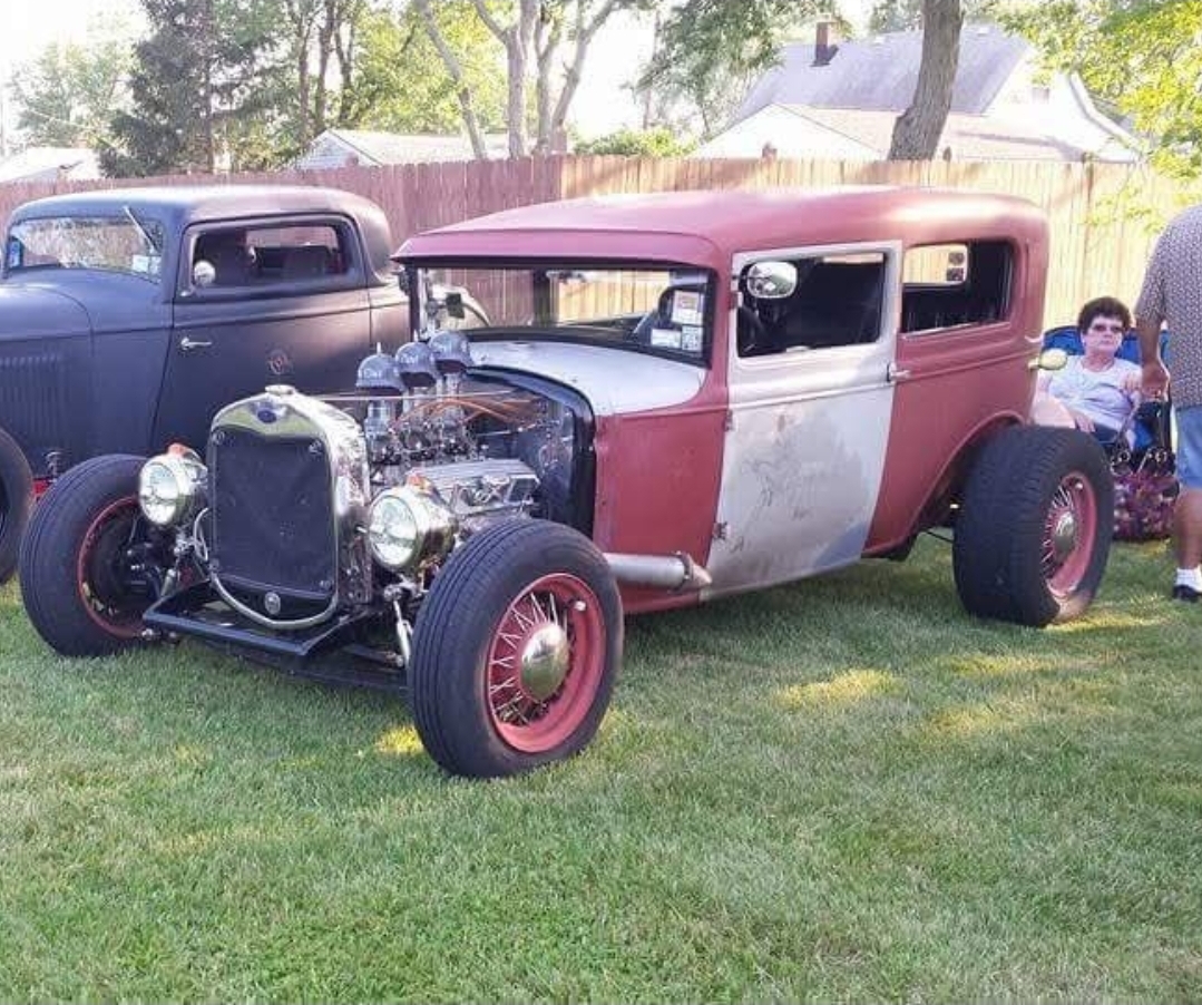

  17. swade41
    Joined: Apr 6, 2004
    Posts: 14,990
    swade41
    from Buffalo,NY

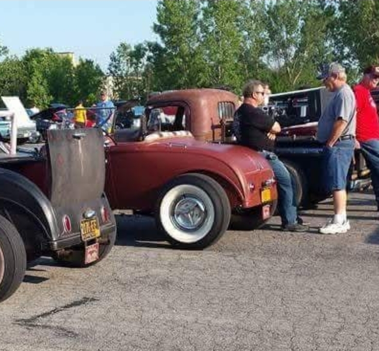

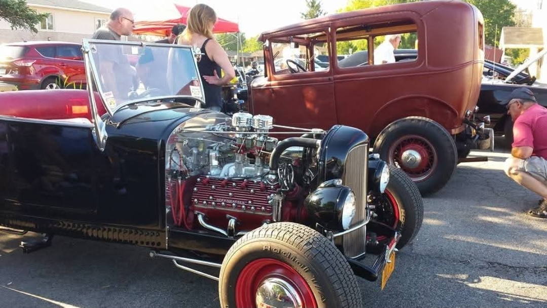

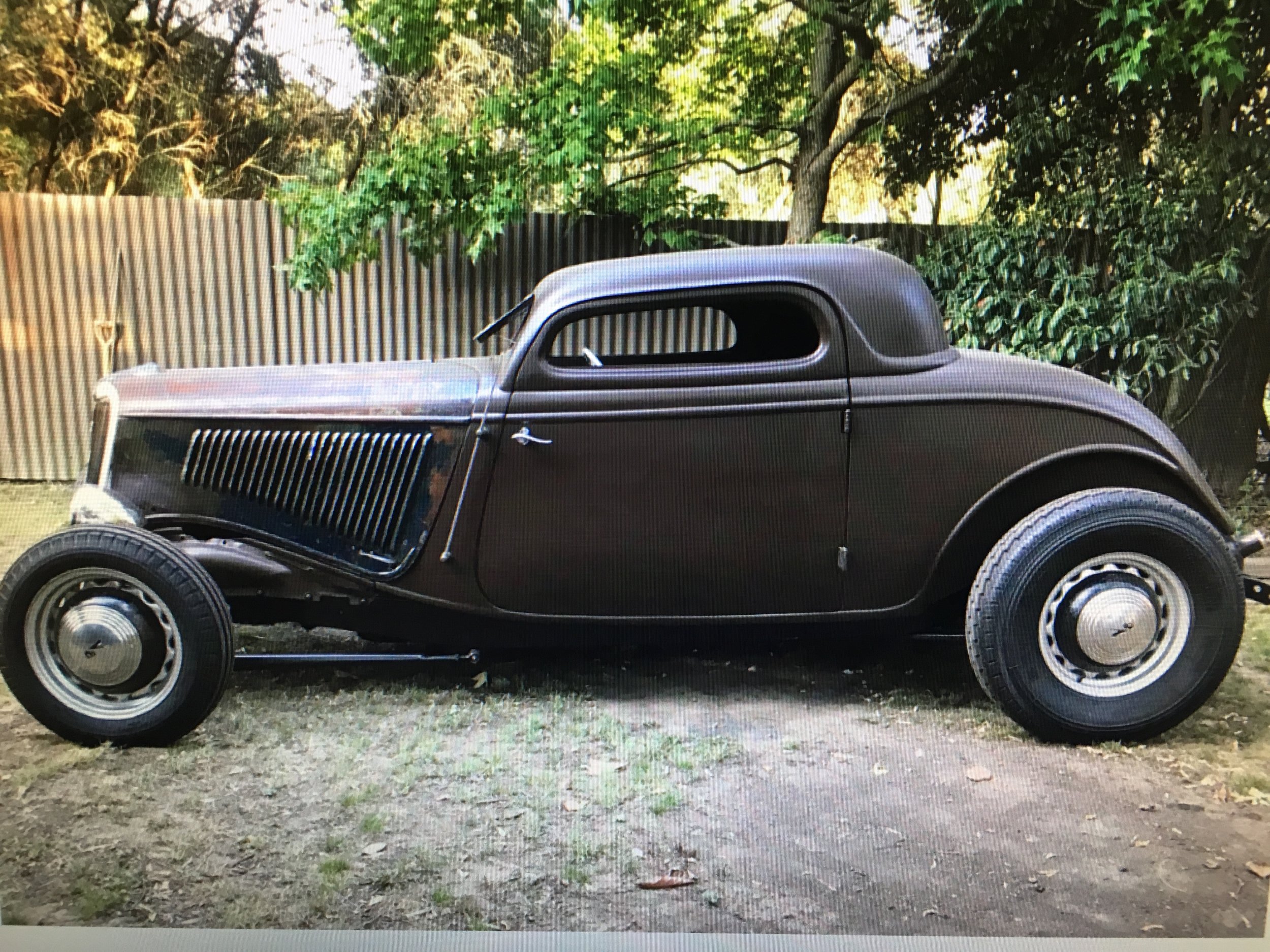

    Going through some old photos it's actually kind of hard to find the old red oxide primer color
    Screenshot_20250904_141544_Facebook.jpg Screenshot_20250904_141201_Facebook.jpg Screenshot_20250904_141258_Facebook.jpg Screenshot_20250904_141212_Facebook.jpg Screenshot_20250904_141348_Facebook.jpg Screenshot_20250904_141800_Facebook.jpg Screenshot_20250904_141720_Facebook.jpg

    Saw the color and completely missed the firewall. I do like that look. Picture the body belly white and bolted to the red oxide frame with black exhaust and rear axle tube.

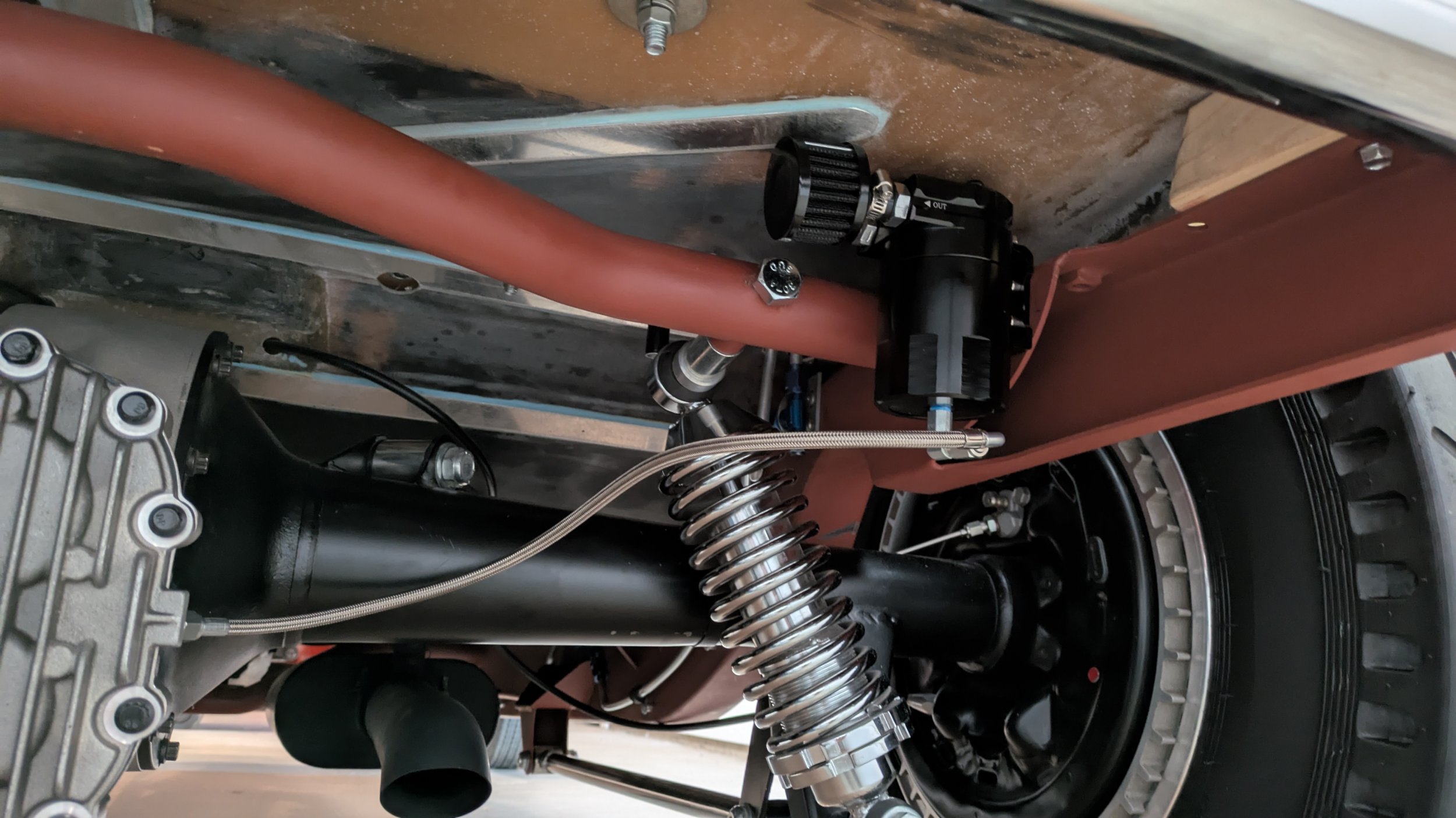

  24. Splitbudaba
    Joined: Dec 30, 2014
    Posts: 1,025
    Splitbudaba

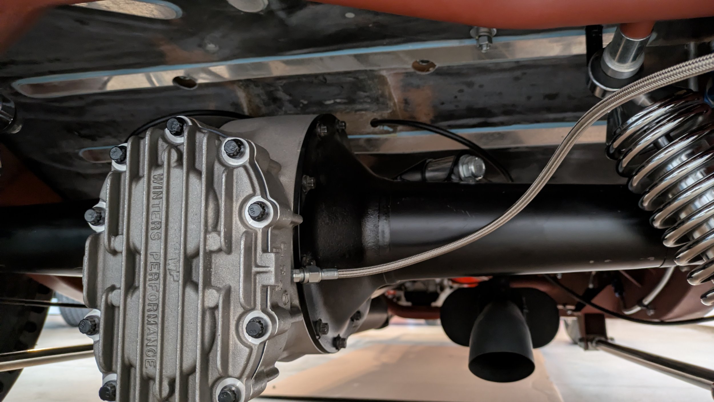

    Dealt with the quick change vent issue. Found a catch can/ breather ***embly. All aluminum,screw off lower half, with an inlet and outlet with a breather for $35.00 delivered. I drilled the lower cup, tapped it and installed an AN 4 fitting. Mounted it as high as I could. Connected a -4 AN hose down to the filler port. Now when the lube expands up the line and into the catch can the rear will be vented. When it cools the lube will run back into the quick change. An added bonus is using the can on the hose to fill the rear. Time to drive it and see if my theory works. Standby!! PXL_20250914_173638989.jpg PXL_20250914_173650612.jpg
  25. Bandit Billy
    Joined: Sep 16, 2014
    Posts: 17,190
    Bandit Billy
    That is quite the breather! My QC just got a bolt with a hole in it. You are making good process.
    Splitbudaba likes this.
  26. Splitbudaba
    Posts: 1,025
    Splitbudaba
    There's a 3/8" pipe plug on top of the banjo housing. Problem up there isn't enough clearance, even for just a vent. Look closely at the second picture.. You can see where I put a bump up blister for more cleary. So I got creative. Also made it easy to fill. Pour the lube in the can. Wait a couple minutes. Place a clean can directly under the QC filler port. Take the hose off the fitting at the fill port. Catch the excess lube. Replace the line and you are serviced to the correct amount. Did it once before with a funnel and hose. Got messy quick!!
