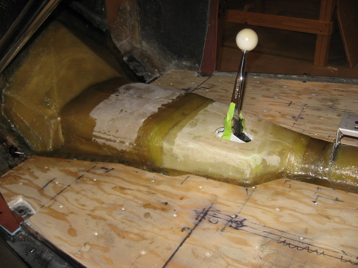

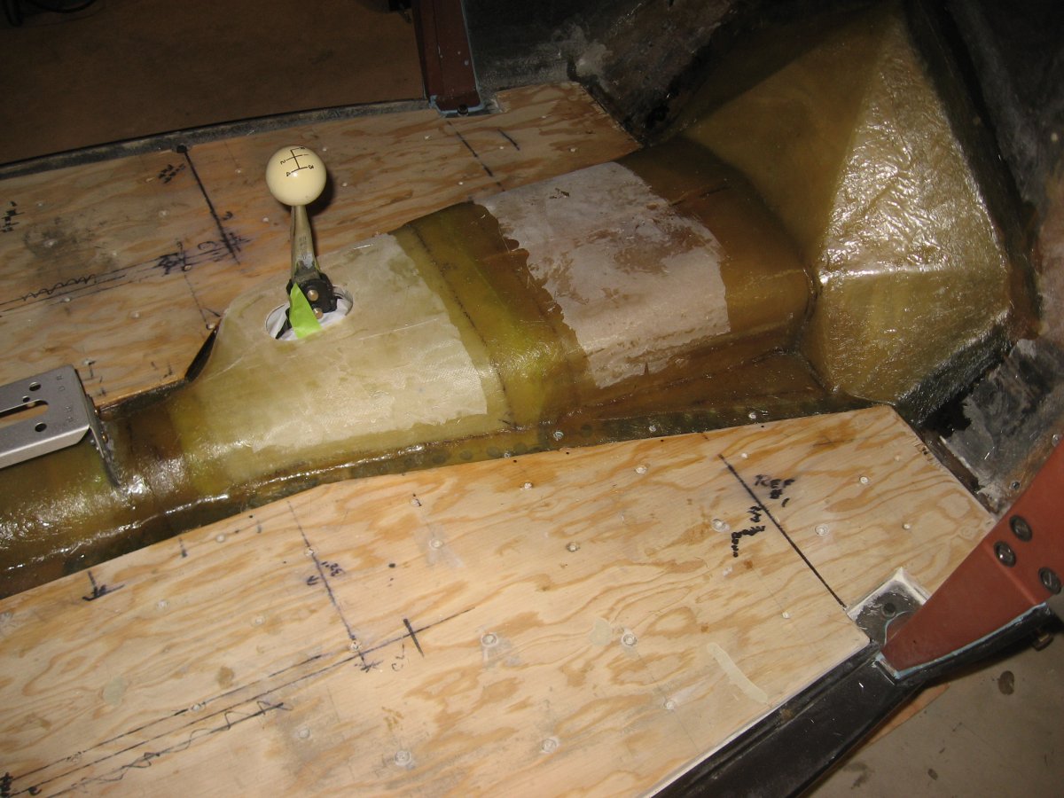

    br.jpg oct 17 2.jpg t.jpg Got some work done this weekend, raised the rear 1" to get more clearance for the drivetrain. Applied the 4th coat of gl*** on the tunnel, nice and strong now. Fabricated the parking brake mount and temp install the handle. Position is great, close to the shifter, yet not in the way. Thinking about building a fibergl*** top for the brake bracket and extend it aft to house the ignition switch and all accessory switching? Built in a blister over the rear end center section for more clearance when I hit those big bumps. Now on to a custom trans tunnel with as much space as I can get for the throttle and a comfortable foot position for driving!

    Gave my boss my 6 month notice that I am retiring 28 May, 2018. Bought a lot in New Meadows Idaho at Meadowcreek golf course subdivision, complete with a ton of 100 year old Ponderosa pines. June 1, 2018 we break ground on our retirement home. All new including my shop. Can't wait!! Finished the trans tunnel yesterday. Had to make a custom mold for the section around the shifter. Made a flat area that will mount the small Mr. Gasket shifter boot, using aviation # 10 floating nut plates riveted to the fibergl***. Next will be a set of wooden floorboards and throttle.

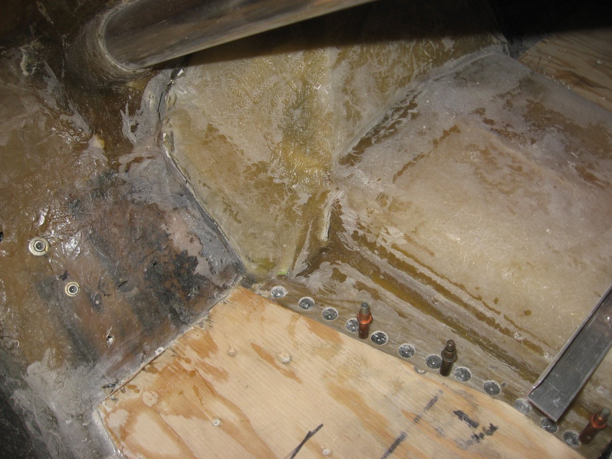

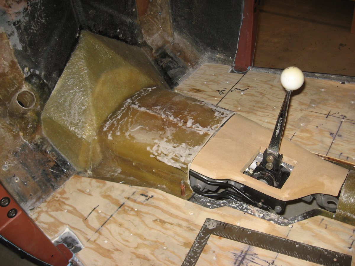

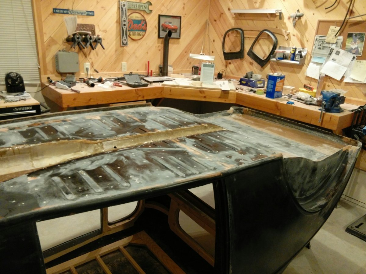

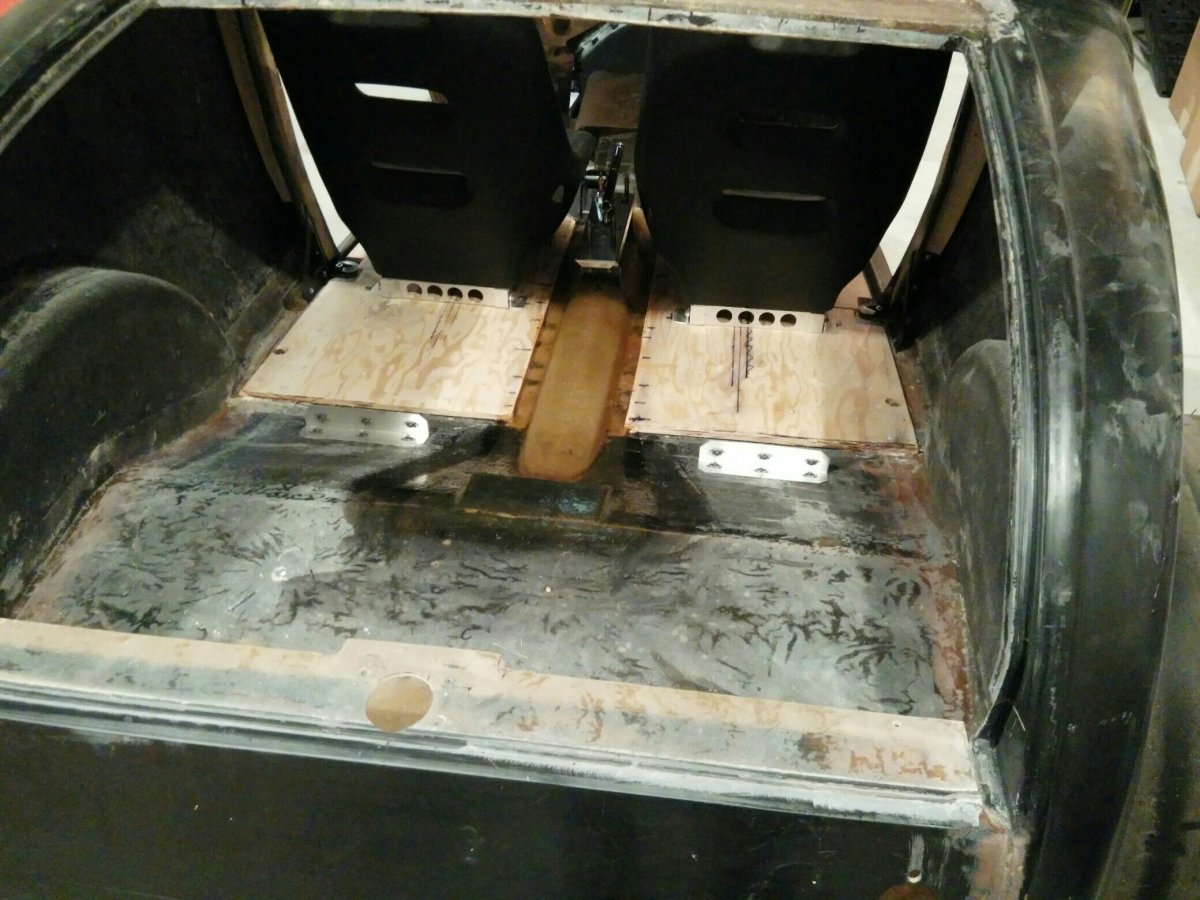

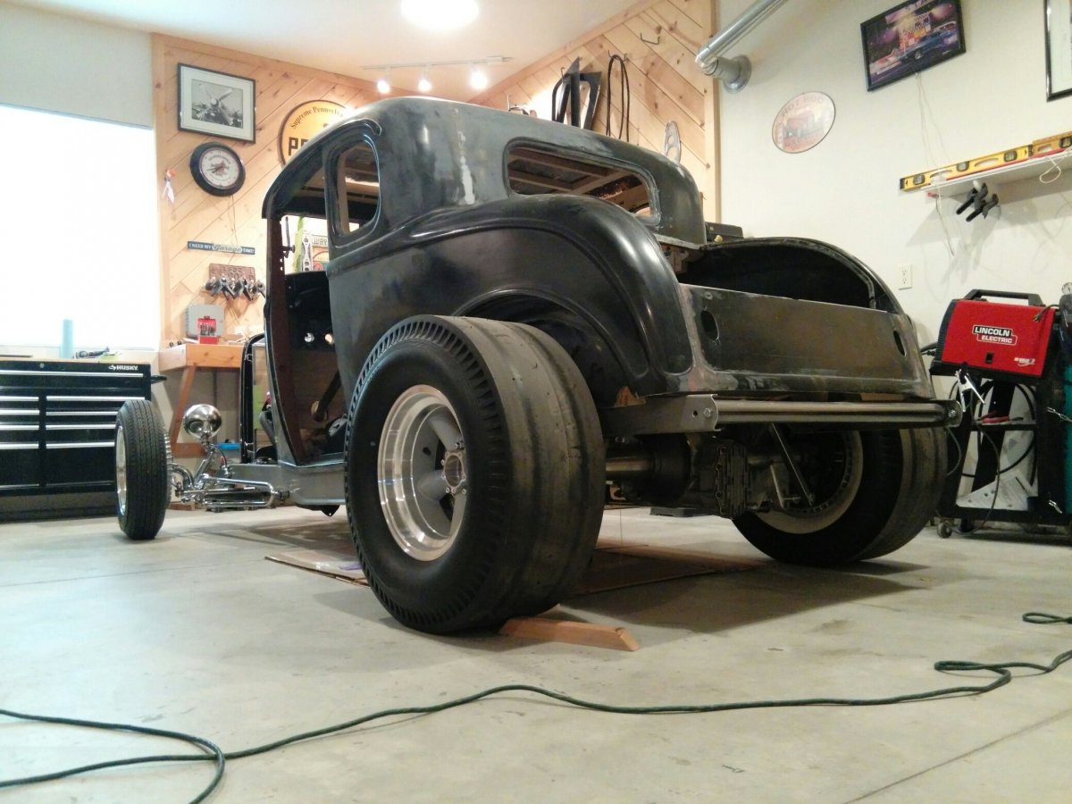

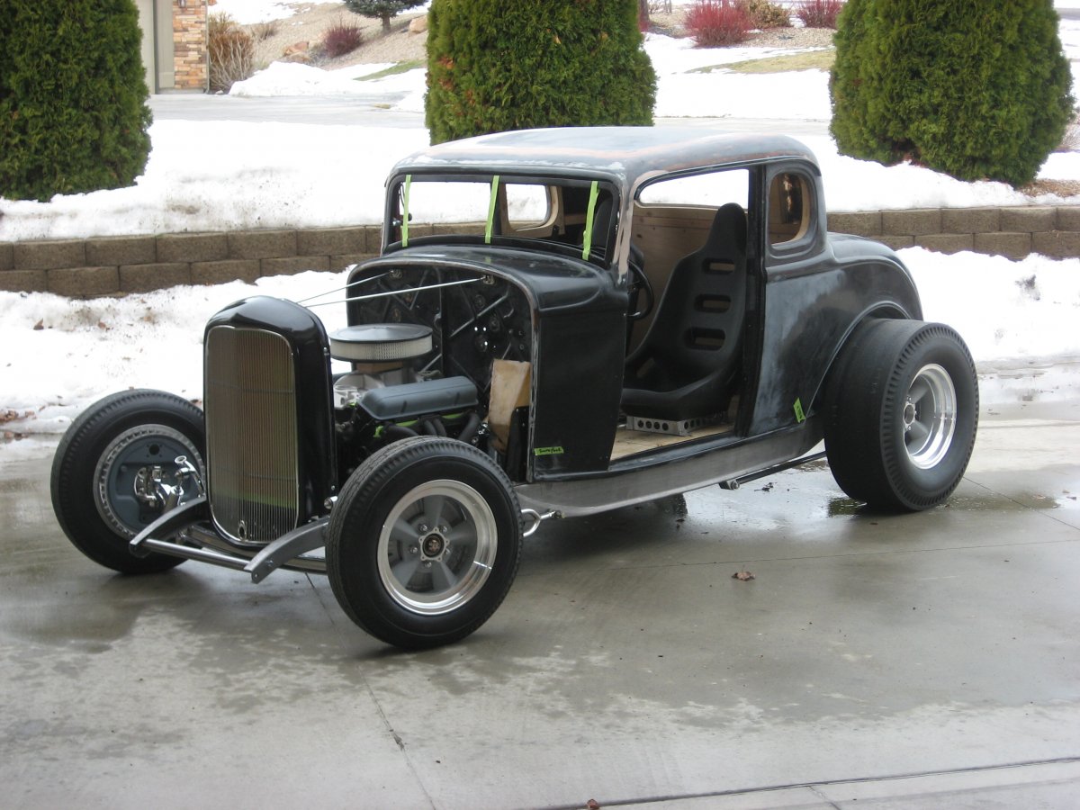

    Got a lot accomplished this weekend, time to clean up the underside and strengthen the trans tunnel area. Frame goes to the welder and hopefully get it back soon enough to have a fun Christmas week putting it all back together. Decided to go with my 1957 265 cu. in. Chevy, which is .040 over (270 cu.in.) with 462 double hump heads (1.94 /1.5) and a Comp Cams Thumpr cam, (Hydraulic flat tappet cam). They must modify the rear cam bearing for oiling, cost a little extra. I have a 600 holley double pumper and aluminum intake. I'm going to run the generator and points distributor. Old school sounds like fun. I might run Flowmaster 50 series mufflers, any input on the sound levels would be greatly appreciated, I watched the videos.

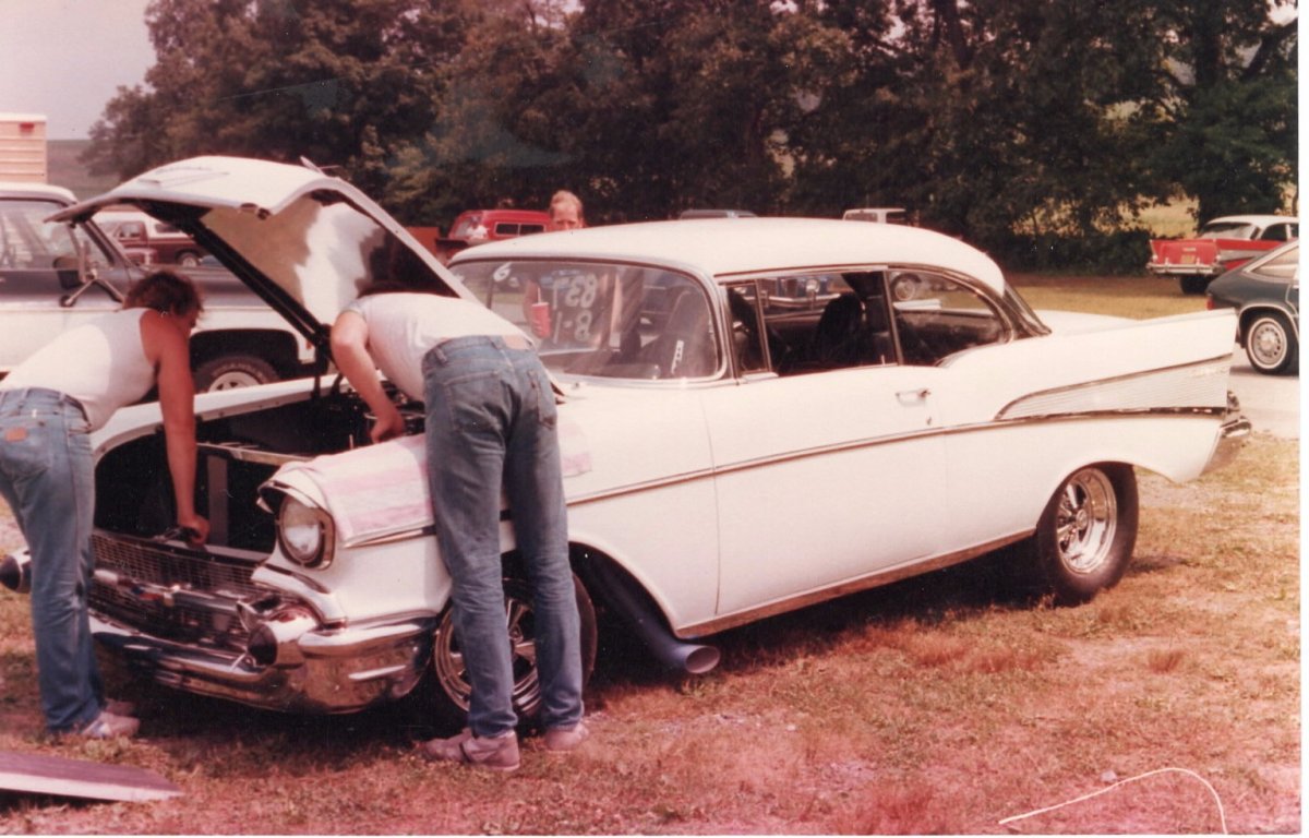

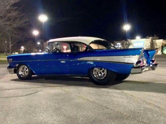

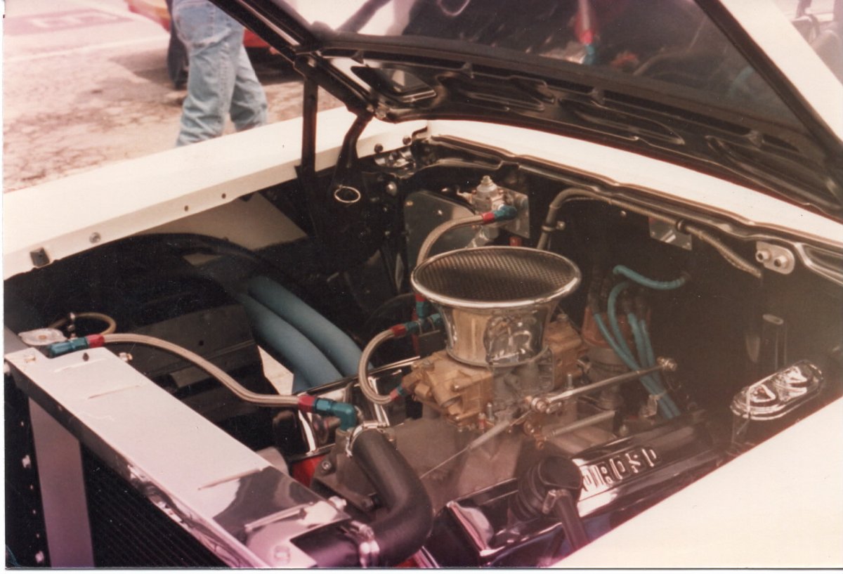

    Here's a few from back when, and the last two are of her today (I think, found them in Pinterest, tried to confirm but had no luck). Anybody recognizes her let me know. Many, many thanks if you do! Found a few more!
    Note: The pic in the garage is the place where I built it starting in 1972. I had to crawl thru the car to work on the other side when the garage doors were closed, no heat either.

    NICE! What were the specs?

    On your floors, what thickness plywood did you use? The various smaller holes - were those for cleco's? I ended up with a gl*** '32 project, and the gl*** floors are pretty flimsy, then I noticed what you'd done on yours. I'm loving this build thread - if you had time to show how you lay up your gl***, that would be really cool! Thanks for sharing your work so far; it looks great!

    All steel down to the bumper brackets, cleaned and sandblasted underside. She had a 331 SBC with the 292 castings, turbo heads, ported and polished by me with 2.05 intakes and 1.64 exhaust valves. Ran a flat tappet solid cam and an 800 Holley DP. I think it was about 11 to 1 motor, I built it in the ba*****t., she ran 11:20s at 123 all day long. Had an old Doug Nash magnesium 5 speed with a Hurst vertical gate shifter and a 3 finger Ram clutch. Can't really say I remember the launches till I got into 3rd gear, it was pretty busy till then. No electronics launched by sound, had a Moroso cable driven tach. Had a 12 bolt nova rear with 4:88 and Summers spool and axles. Set up my own gears after two failed attempts by the local so called pros, no failures after. Ran ****** adjustable fender well headers, I think they were 1 7/8". Wow haven't thought about all that stuff in a long time, amazing all details are still in my head. Sure wish I still had her!!!
