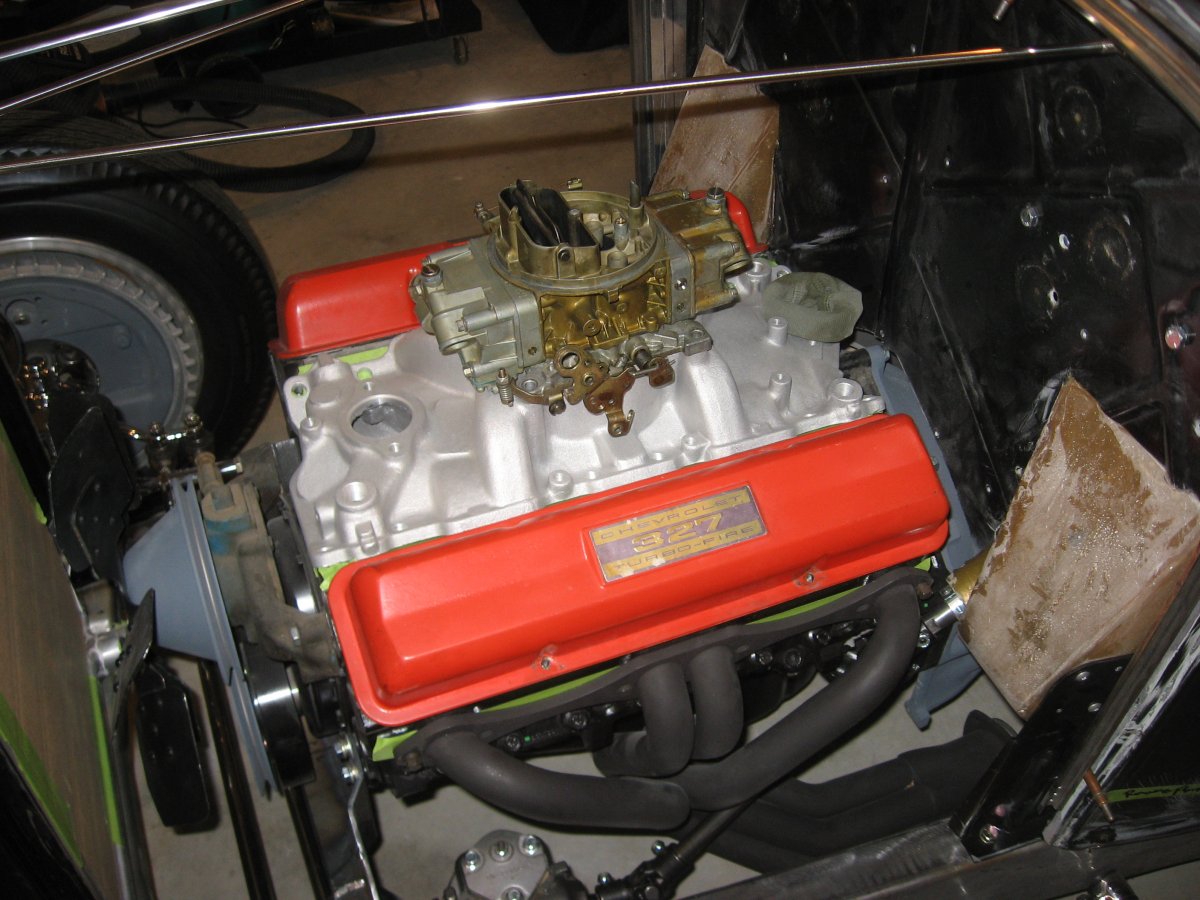

    IMG_2537.JPG Here's the crate motor in disguise (sort of). Needs the 462 heads, Mutha-Thumper cam, and orange paint!!! OH yeah and white headers, no chrome except the top shields. Just like I swung it out of a Vette in the 60s.

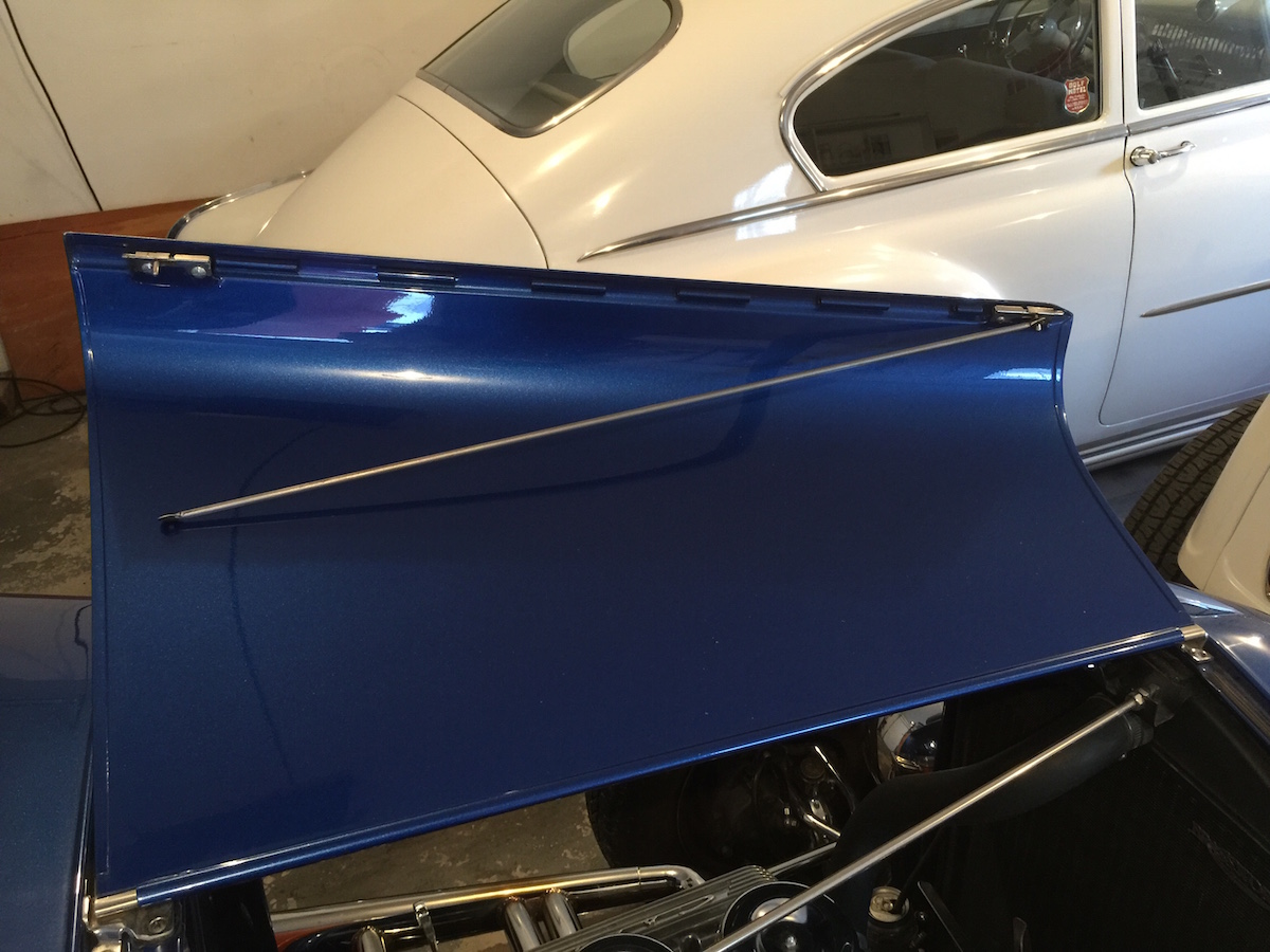

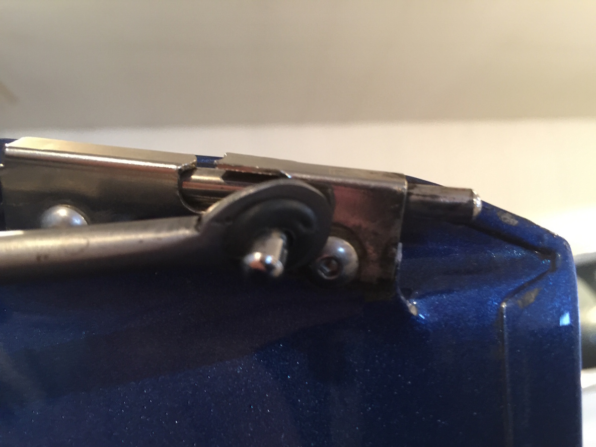

  16. What I did was use a small cabinet pin-style lock at both the firewall and rad shell mounted to the lower edge of the hood. The pins go into small holes in the cowl and rad shell. In order to have them stay in place I use a 1/4 inch stainless rod with an o-ring equipped eyelet at either end which fit over the "handle" of the locks.. Geez I hope that make sense! I will try and get a pic for you as this has worked really well for me.

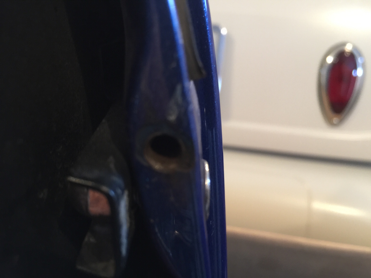

  20. Yes Split, the holes were re-inforced with a short piece of tubing (later on as the holes were enlarging over the years..). I found a couple of pics:
    The hole in the grill shell (prior to the sleeve install):
    The latches mounted to the hood and the rod to keep them positioned in the holes:
    Eyelet and grommet:
    Sorry for the interruption!

    Very nice, I definitely can run with this. Thank you very much!! You are one of the good ones!!
