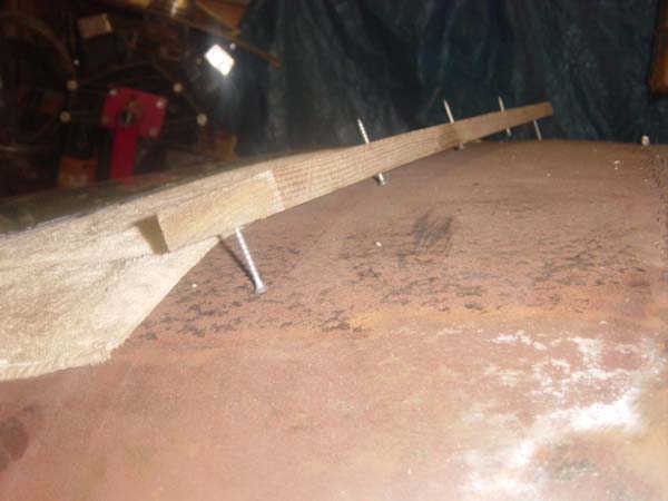

    I cut a new back glass for my 51 today.I started by making a guide to find the arch of the top.Just a scrap piece of wood with screws to show contact points.I then went to the junkyard to check it against every windshield that looked close.The winning windshield was from a Fiero.

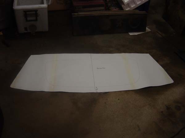

    Next I made a template of the fiero glass,and one for the desired backglass shape.It is as wide as the fiero glass shape would allow.Marked the centers and started to get nervous.

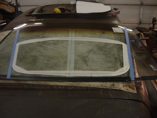

    Put the marks on the glass.

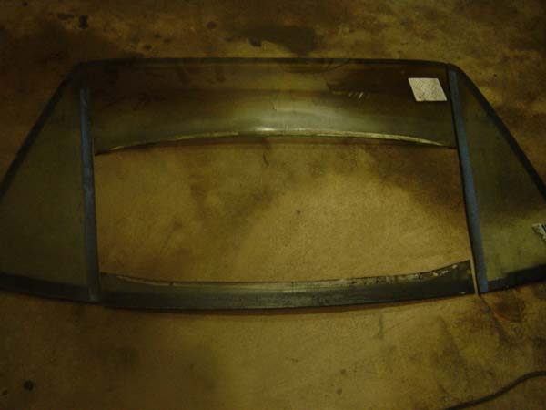

    Broke out the grinder.
  5. lulabelle
    Joined: Aug 25, 2002
    Posts: 1,246
    lulabelle
    thin cut-off wheel.

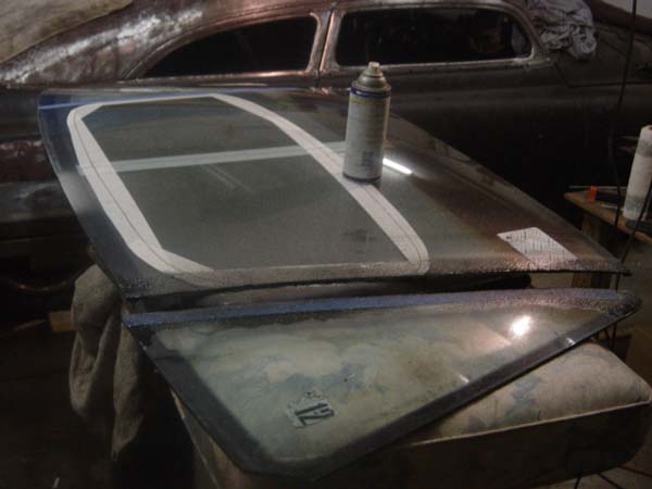

    put the glass on old couch cushions so it was supported evenly.and made the first cut.

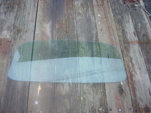

    here is the finished product.Now to make the surround.

  9. Were you using any special type cutting wheel?
    did you saw clear thru or score and break?
    and also what are you using for "coolant"-or liquid?

    Regular metabo cut off wheel-wd-40.The cutting took less than an hour.The marking took about 2.

    alot of light passes with spray lube between.
