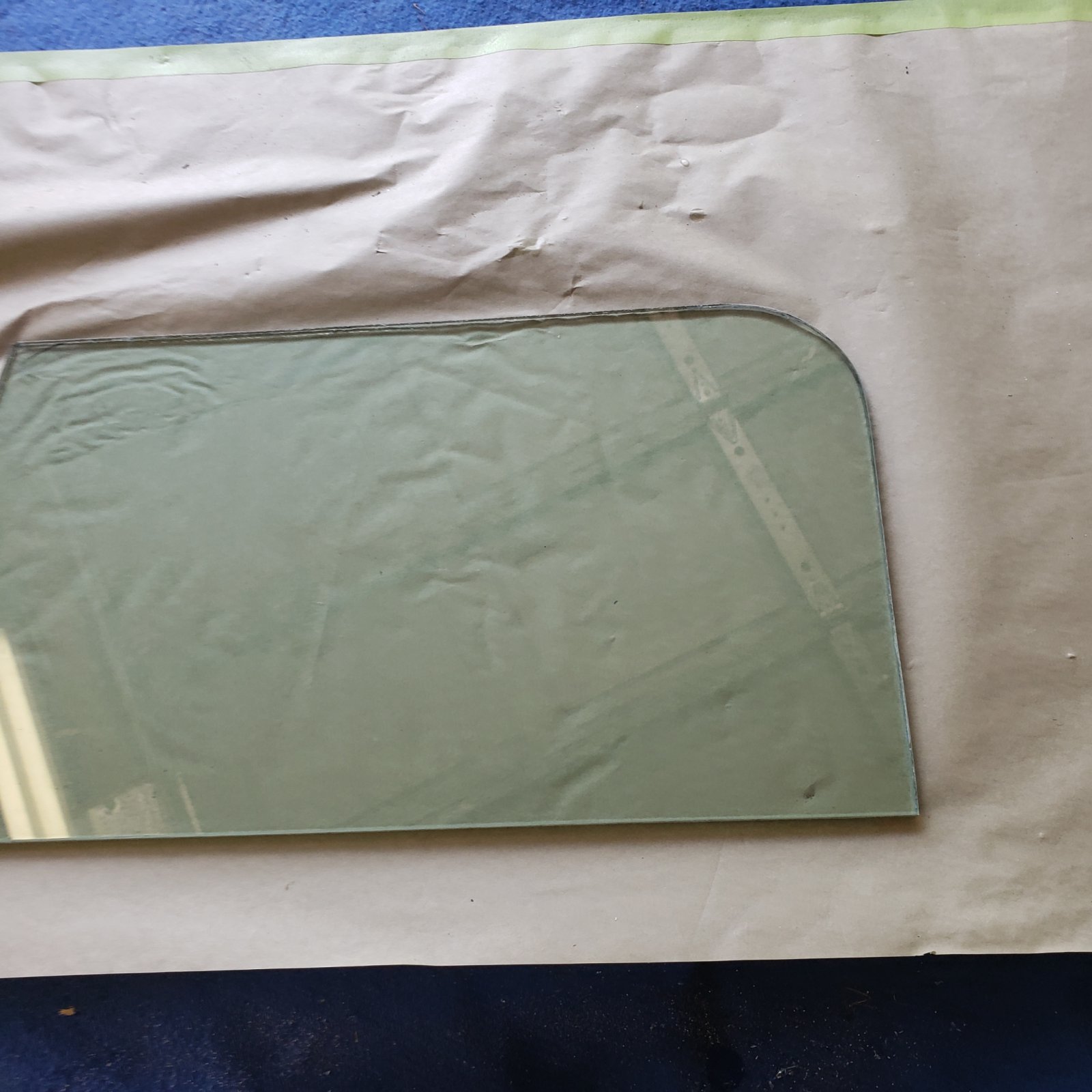

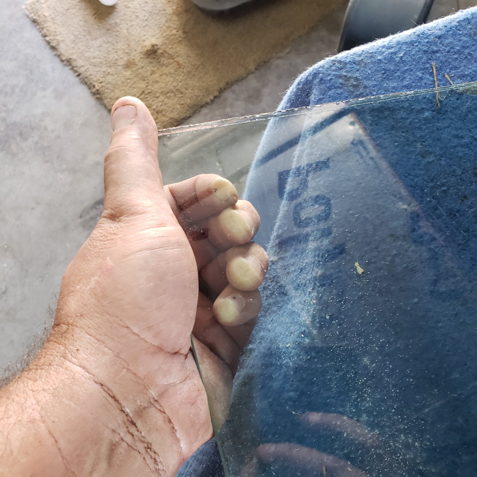

    I use gl*** pliers, but small channel locks work just as good. 20220511_130438.jpg 20220511_130623.jpg

    Spray your belt, spray your gl***, often. Signs of heat are bad, and you will break the gl*** 20220511_130947.jpg 20220511_130957.jpg

    Take your time, 80 grit cuts fast, you can go as far down as you want when it comes to polishing the edge. If it's a door gl*** that you set your arm on, i go to 240. Everything in a gasket i stop at 180. Ease your edges, prevents stress risers. 20220511_131222.jpg 20220511_131229.jpg

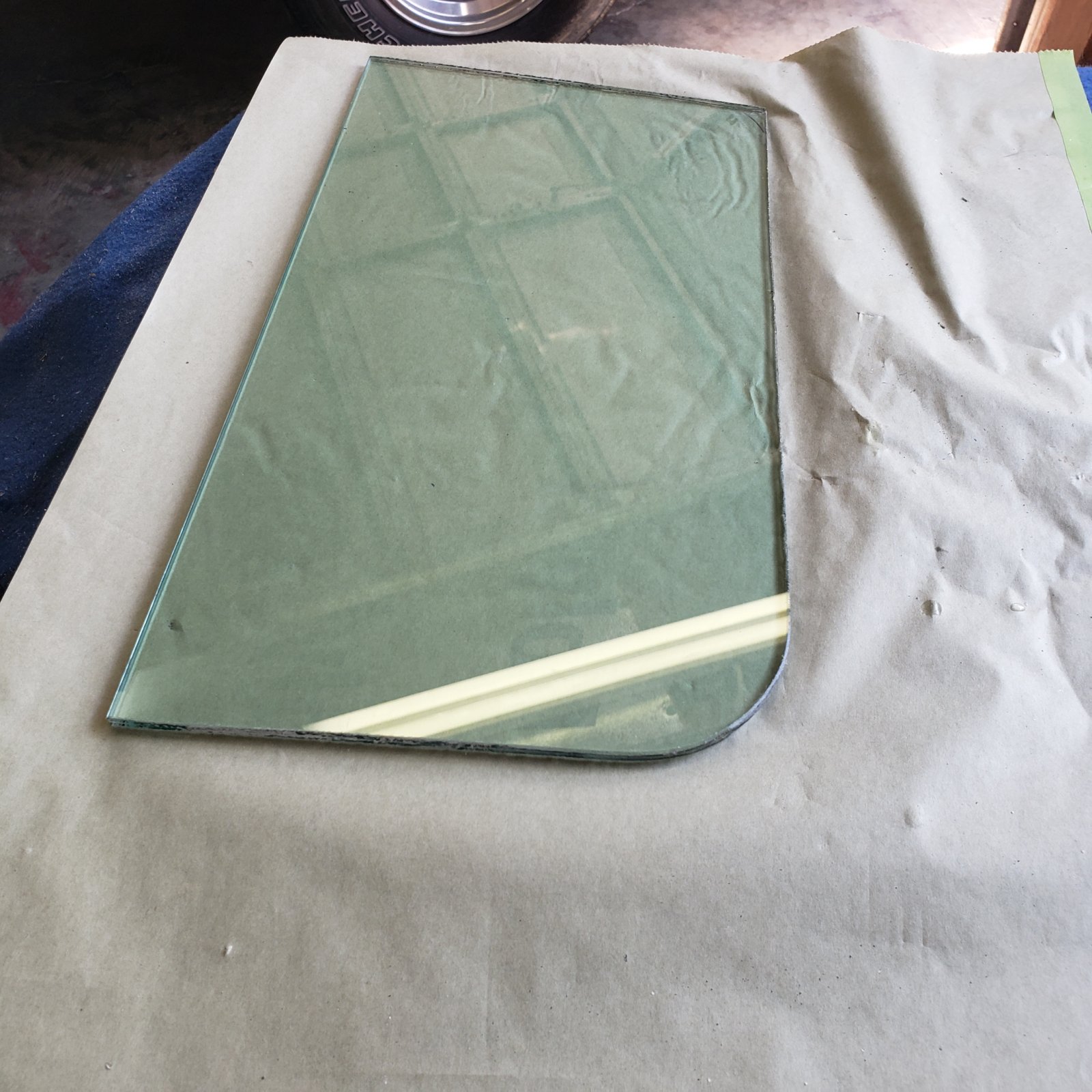

    And that's it! It's not rocket surgery. Just takes finesse and experience. But I'm not gonna finish it, nobody is paying me and I've got body filler to sand :p:D hope this helps somebody! 20220511_131617.jpg 20220511_131625.jpg

    Hey @rusty valley ,I didn't mean to ramrod your thread, just trying to help out. And as far as a curved gl***, I use the same process. Kinda like a torque spec, you just creep up on your final desired size. Problem is, gl*** breaks, it happens. And when you're cutting flat gl*** and make a mistake, you grab another piece and start over, and hopefully your mistake piece is still big enough to cut another piece from, but on a curved windshield, it's a different story, you've gotta get another one to start over... :( hammer down guys! Get that gl*** cut! Yell if I can help anybody :D

    When you score the gl***, you start on one end and go all the way off the gl*** on the other end. I go to the end that I ran off of, because you have to actually start your score on the gl***, and if you put pressure on the gl*** there, you can't really control the crack, but on the other end, a little pressure, and it'll crack down the score line, look close, and move about 2"at a time, you'll watch the crack run. Sometimes it'll run the whole score in one click. 20220511_171439.jpg
