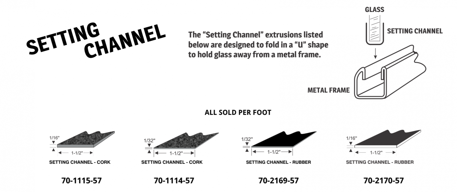

    What's better to use the all rubber stuff or the cork/rubber stuff?
  2. 325w
    Joined: Feb 18, 2008
    Posts: 6,527
    325w
    Most gl*** guys use the all rubber. Either work well. Need to check the fit of the metal channel to the gl*** and see how thick the rubber needs to be. If it needs to be thick you can mash the metal together some and it will hold better.

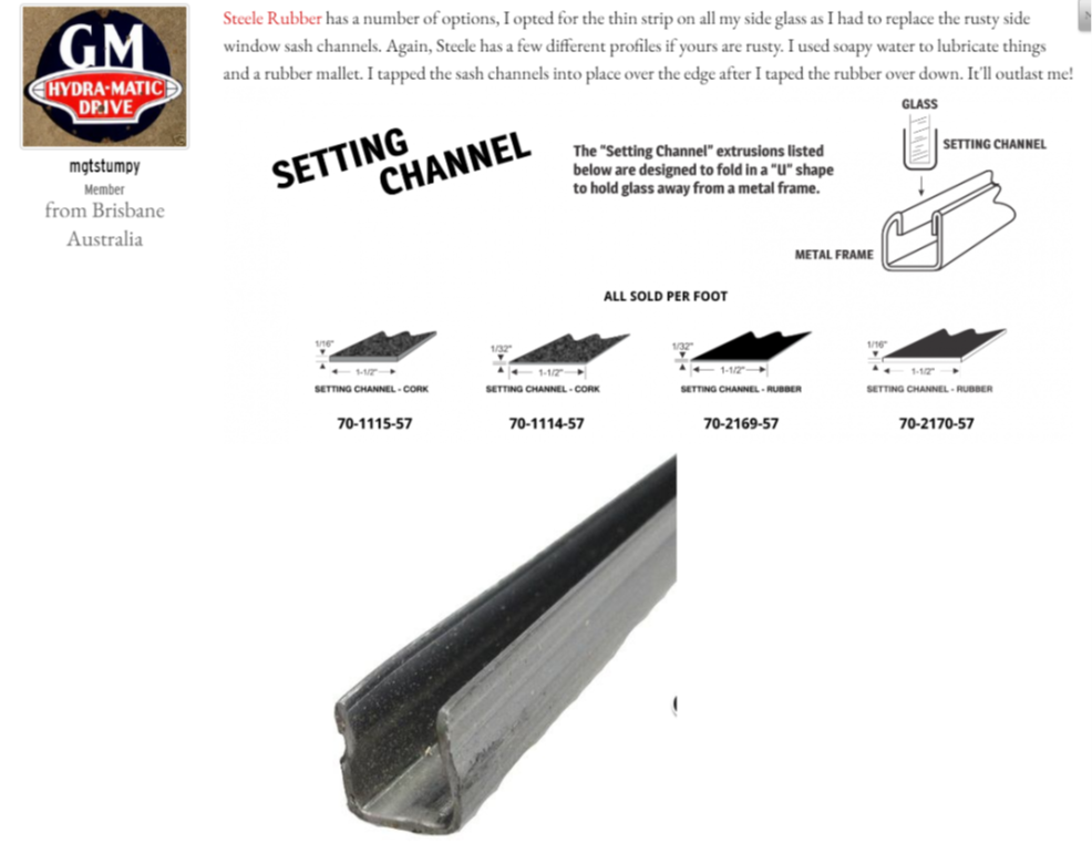

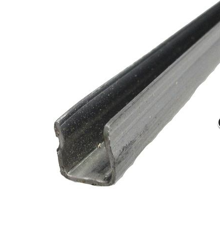

    Steele Rubber has a number of options, I opted for the thin strip on all my side gl*** as I had to replace the rusty side window sash channels. Again, Steele has a few different profiles if yours are rusty. I used soapy water to lubricate things and a rubber mallet. I tapped the sash channels into place over the edge after I taped the rubber over down. It'll outlast me!

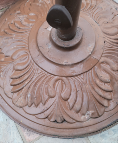

    Ahhh… so that is the official name of the product. We have an 80+ lbs metal base for our patio umbrella. It is the portable one that travels all over the backyard. It is made of heavy duty metal and is a bear to lift and move to where we wanted it placed for best coverage. It is not used as a stationary umbrella for shade. We have another exact large umbrella in the table area on the other side of the yard. That one is for table shade use only.
    The shade the large umbrella provides is immense. But, lifting that whole attached unit is a back breaking event, every time we tried. (I was 25 years younger, lifting it was not a problem from the umbrella store.) So, I searched for a “U channel” gasket. I remember those units by the foot at the local auto parts store near out Westside of Long Beach house. If the auto parts store did not have any, the antique auto parts store on the opposite end of our streets usually had them in stock. Out pops a variety of “U Channel” products, online. I knew it looked familiar, but the project was at hand.
    The "setting channel" on the outside of the heavy steel base.
    I figured out I could easily tilt and roll the metal base anywhere in the backyard. But, each time I rolled it, the factory paint chipped off. Soon, the whole circular base had nice paint on top, but the edges looked like a badger attacked the base for his evening meal.
    So, I decided to paint it in several more layers with some polyurethane type epoxy paint that matched the patio furniture. That lasted for a month or so, until the same little cracks turned into larger ones and the paint chipped off each time I rolled the heavy base across the patio tile surfaces.
    Jnaki
    So, finally, after the search for the U-Channel gasket, I found one that looked like the photo in
    @mgtstumpy and his post.
    I attached it with Shoe-Goo and the size fit the metal rim edge perfectly. Now, it is sturdy enough and the rubberish compound flexes enough to roll the heavy umbrella base anywhere in the yard. When we do yard work on a sunny day, it rolls over to the exact spot in the backyard/frontyard or side yard for shady coverage.
    The original auto window version was good, but did not last as long as we needed. But, it was replaced by a thicker version that slid right on to the edge of the metal base and all it needed was some measurements and some Shoe Goo.
    NOTE: I am about to replace the version two, U-Channel edging with some new ones as the weather around here is cuckoo… extremely hot, cold, hail in the winter, windy, rainy, foggy and yes, salt air encrusted mist, along with the hot blazing sun, when the wind dies. So, since it is always on call sitting outside, the elements attack it daily and it is taking a toll on the rubberized U-Channel. (setting channel)
    But, for the old guy to move the heavy base and wide umbrella, it just tilts and rolls wherever it is necessary to provide shade. Just for relaxing, or when we are doing intricate garden work. Tilt the whole umbrella, get the rubber edge on the tile surface and it rolls anywhere. YRMV
