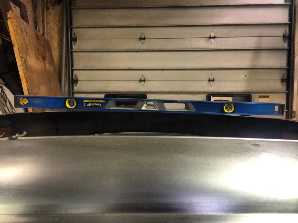

    ImageUploadedByH.A.M.B.1450387717.017350.jpg mehhhhhh
    Wanted to start making a buck for the roof insert ....
    Start measuring
    You can see the sag
    Stogy, wedjim and Als27T like this.

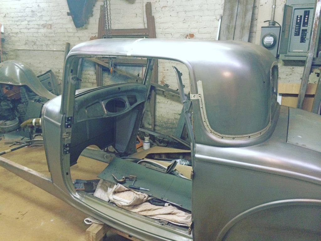

    Getting ready to bring the top down .
    Stogy, Baron and Als27T like this.

    Its Lemmy approved time to go after I fit the bracing !
