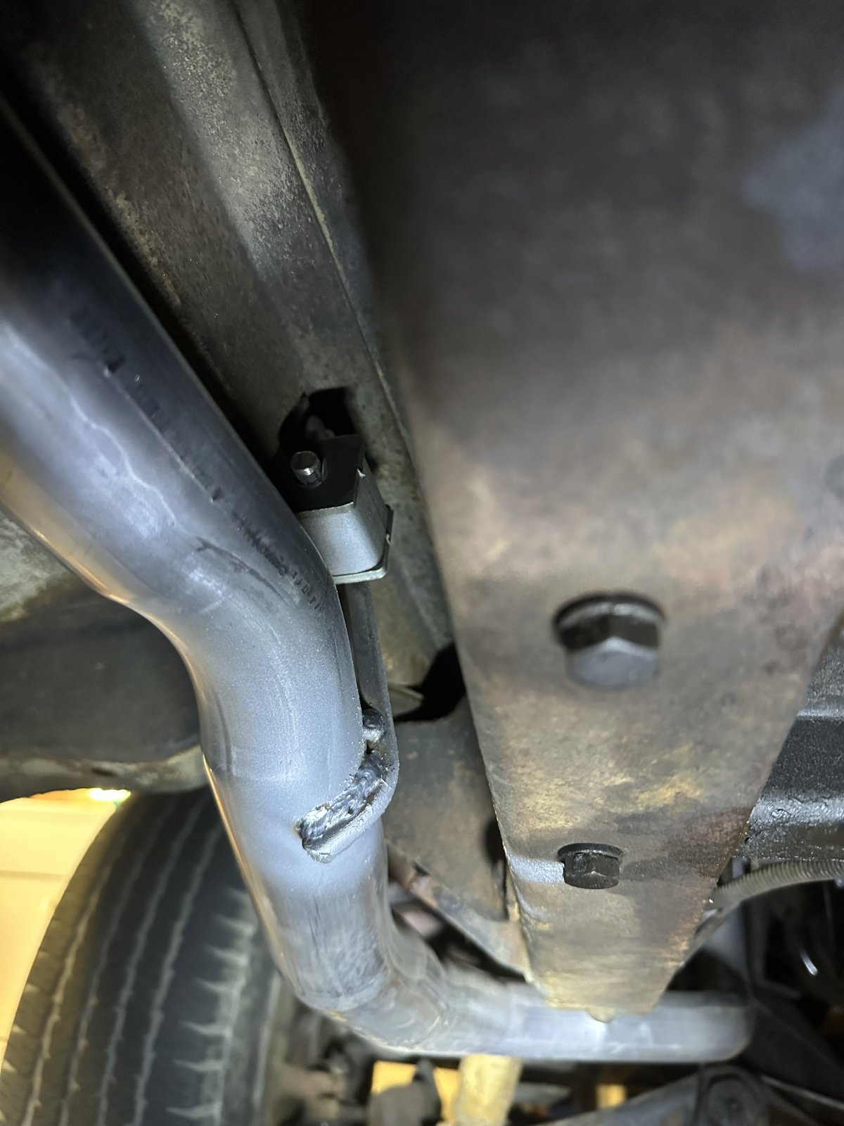

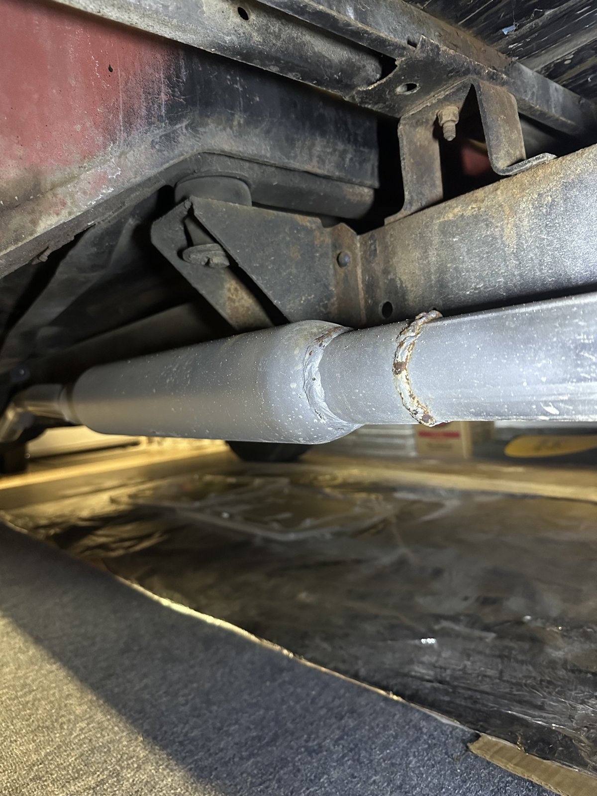

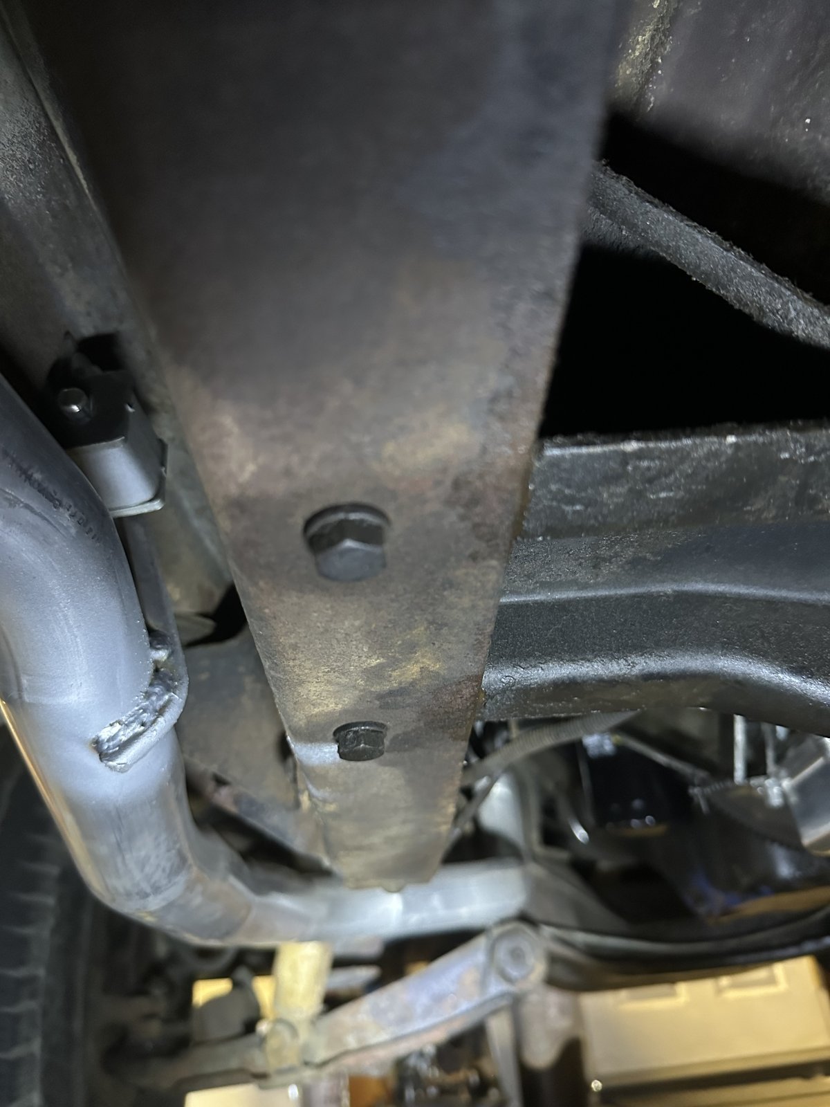

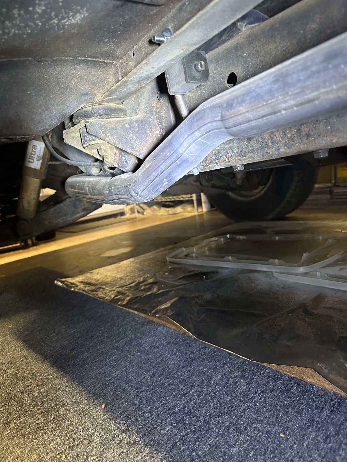

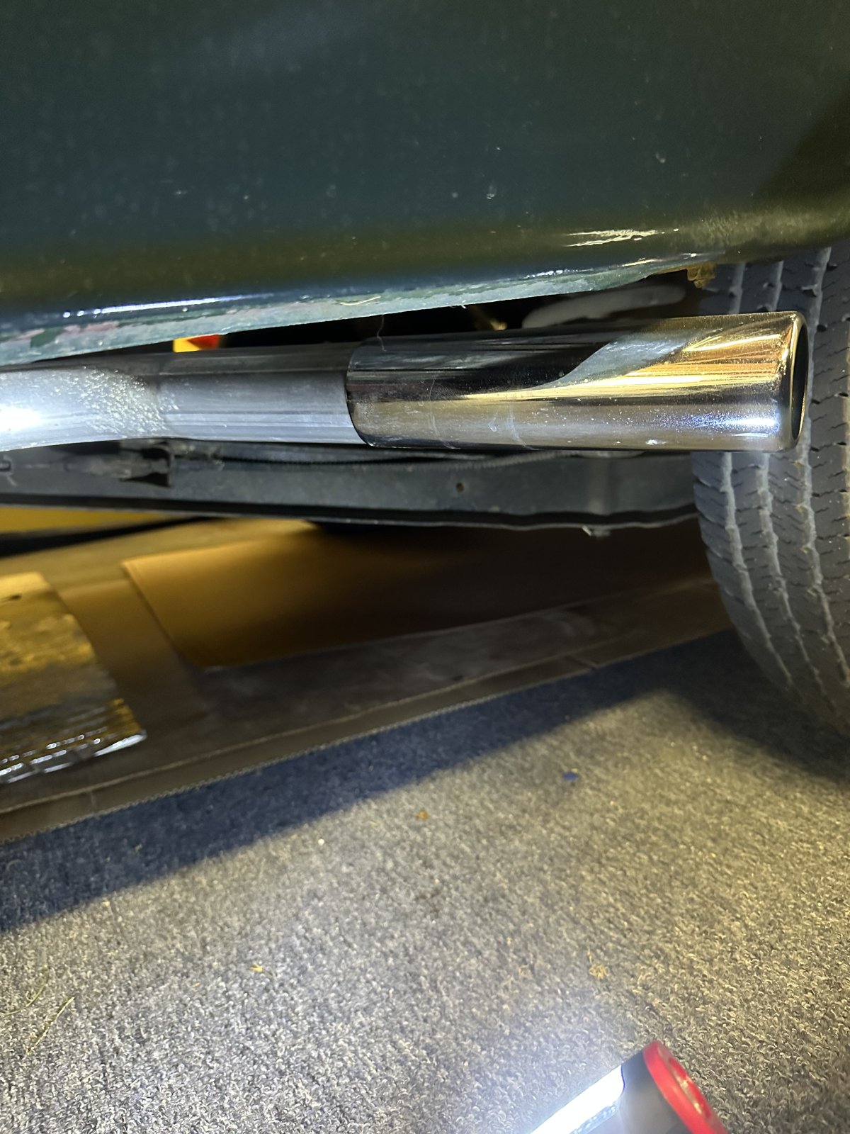

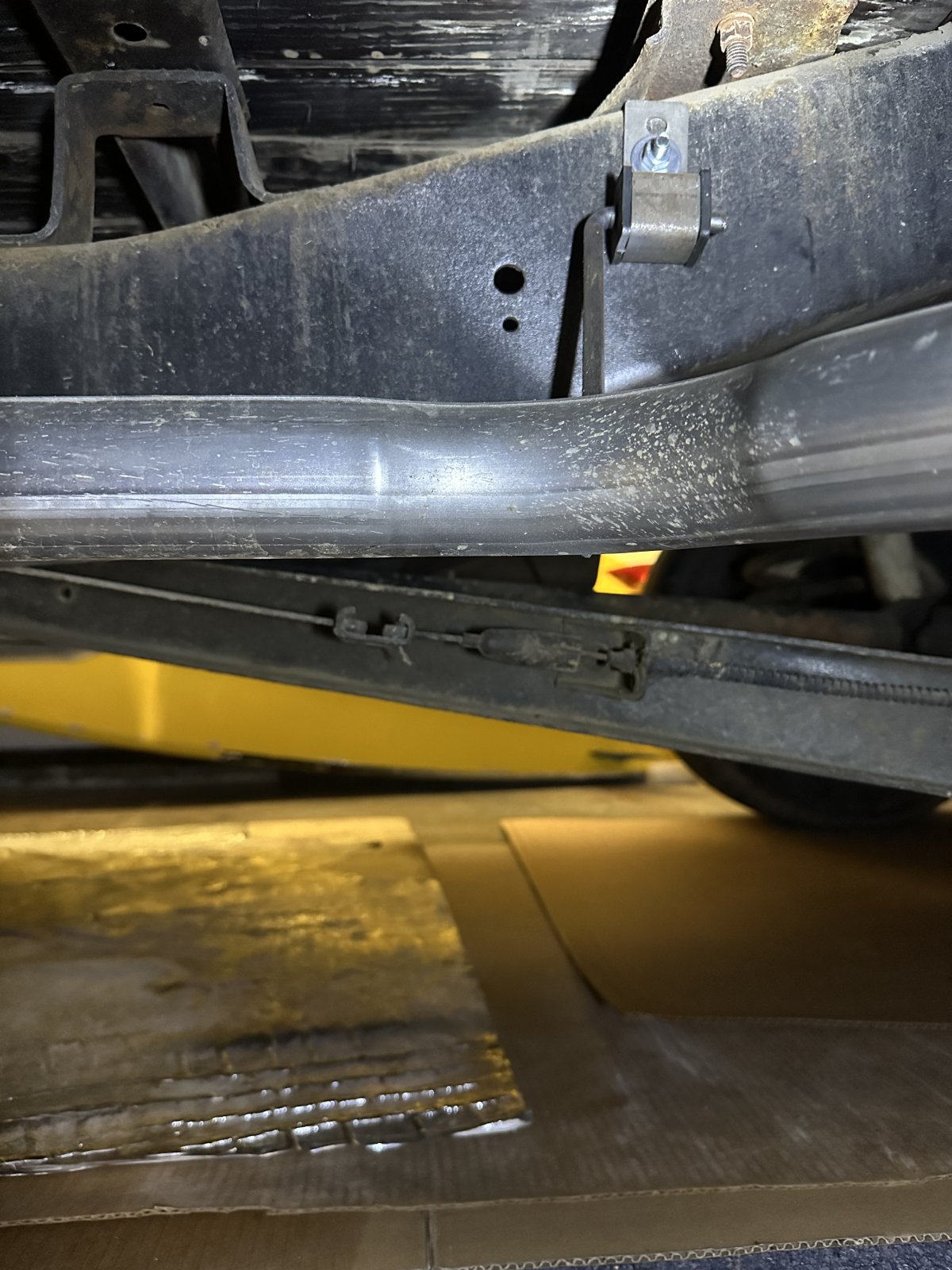

    Here are some photos of what I have:

    Those exhaust hangers are good hangers, but it sure looks to me like all the rods are welded to the pipe facing the wrong direction (unless what I think is the front of the car isn't). Also, the short amount sticking out past the rubber isn't long enough (if it really was letting the exhaust expand, the rod could fall out of the rubber and the exhaust would fall to the ground).
    This set up looks to me like as the exhaust gets hot, all the hangers are bind it up and are trying to keep it from expanding, causing the noise you are hearing. That noise is very likely the rods at the point they are welded to the pipes twisting, or it is stressing the bolts holding the rubber bracket on the body. At some point the rods will fail and break off the pipes, or the bolts will break or pull out of the body. Those rods and bolts do not have the capacity to restrain the exhaust expansion for very long.
    Good pictures by the way. Gene

    Thanks! Interesting a muffler shop installs exhaust without considering how things would contract/expand. In the photos you will see a white door towards the floor that would be towards the front of the vehicle or you may notice the washer/dryer. Otherwise in other photos where its a side view looking left would be front and right would be rear. The exhaust exits in front of the rear wheels.
    To me it looks like the front hanger would let it move forward.

    Yes, the hanger like installed would let the exhaust move forward, I am assuming this exhaust is cold, or near cold.
    As the exhaust gets hot, it expands towards the rear because its bolted to the motor at the front, and hanging in space at the rear. The exhaust has to expand towards the rear when it gets hot.
    Now if that exhaust was hot and hung like it is, it might be OK (other then the rod is still too short). As the hot exhaust cools, it contracts and moves forward towards the motor. The difference between the exhaust being cold and the exhaust being hot can easily be at least an inch and could be two inches difference in length in front of the rear axle, and another extra inch in length at the rear bumper (if the exhaust hangs back that far).
    There is no place on the hangers on the car pictured that can accommodate 2" of exhaust expansion and contraction.
    Most muffler shops are not concerned with any noises an exhaust would make involving pipe expansion and contraction. If the vehicle gets out the door and is gone for 6 months, they don't care. They will just charge you to fix it again and blame you for somehow breaking the hangers. Until someone points it out, they probably have no idea, and even if its pointed out, they would probably be suspect to the information.
