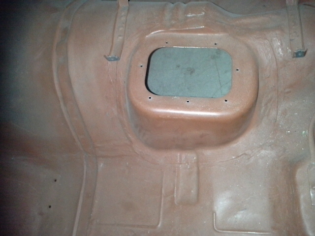

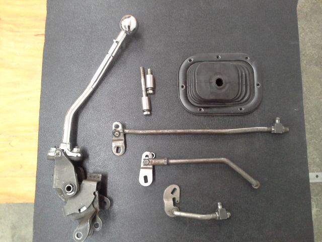

  16. DDDenny
    Posts: 22,426
    Not saying your mistaken but the 66/67 Nova/ChevyII had a black trim ring and it was under the carpet screwed to a factory hump.
    Like this.
    This is the oem shift boot and trim ring (four speed).
    I'm guessing the chrome shift boot trim ring came from the same Chevelle that the three speed transmission came from, like the photos in article below. A lot of swapping of parts happened early on when they started hitting the wrecking yards, four speeds even back then were out of reach for many people and three speeds were more reasonably priced.
    https://www.chevellestuff.net/qd/manual.htm
    1Nimrod likes this.

    Joined: Dec 11, 2018
    Posts: 753
    1Nimrod
    DDDeny I never had my carpet out so I can't say for sure that part looked like your picture. That photo looks like it came from a console mount by the looks of the other small mounting brackets. But I do remember the ring was crome and was screwed down to a rolled factory looking hole not a hack job like alot of old boys use to do back then.
  20. DDDenny
    Posts: 22,426
    Yes, those brackets are what a four speed console screws to but the bench seat cars used the same hump, and you would be surprised how knarly the factory torch cut hole looked before the hump was spot welded and sealed to the floor.
    1Nimrod and 427 sleeper like this.
