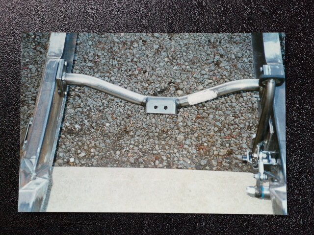

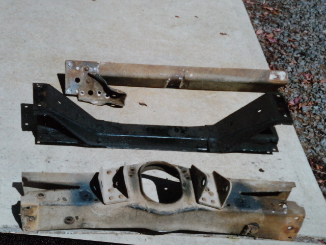

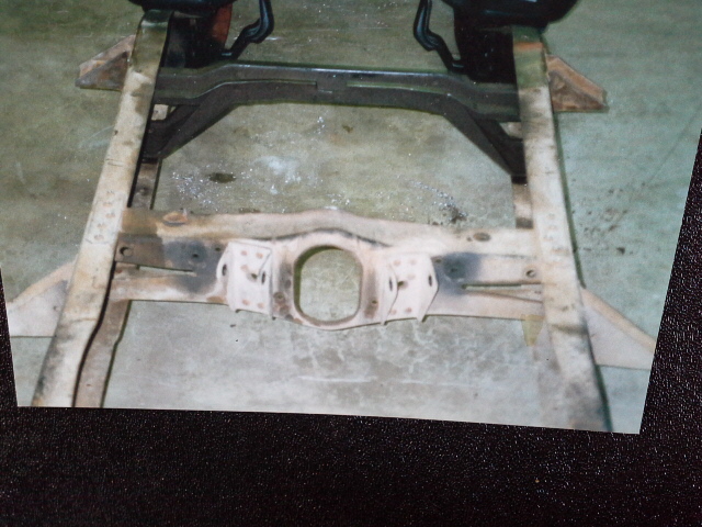

  14. DDDenny
    Posts: 22,401
    Original automatic truck so no belhousing.
    I used the powerglide crossmember when the turbo 350 went in then things got kinda crazy, all this junk went in the dumpster.
    I wish I had known that the automatic crossmembers were hard to find.
    20190429_181345.jpg 20190429_181432.jpg 20190429_181459.jpg 20190429_181636.jpg 20190429_184958.jpg
    The tubular transmission crossmember is an aftermarket unit.
    1Nimrod and Shadow Creek like this.

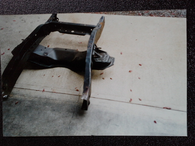

    20241028_120451.jpg Year's later lol...
    Found two old pictures of one of my off topic Chevy II's. My 67 post Chevy II, it was my older brother's in 1975, he gave this Chevy II to me in 1977. This 67 Chevy II had short back buckets green interior, had the PG with Console Shifter & 283 original, my brother Bill bought this 67 Chevy II from my Brother-in-law's Brother Dana Knowlton, Dana was original 1st owner. The old 67 Chevy II had seen its better day's parked in a farmers field for sometime before my brother Bill bought the Chevy II, good old memories when I found these two old pictures from the 1970's.

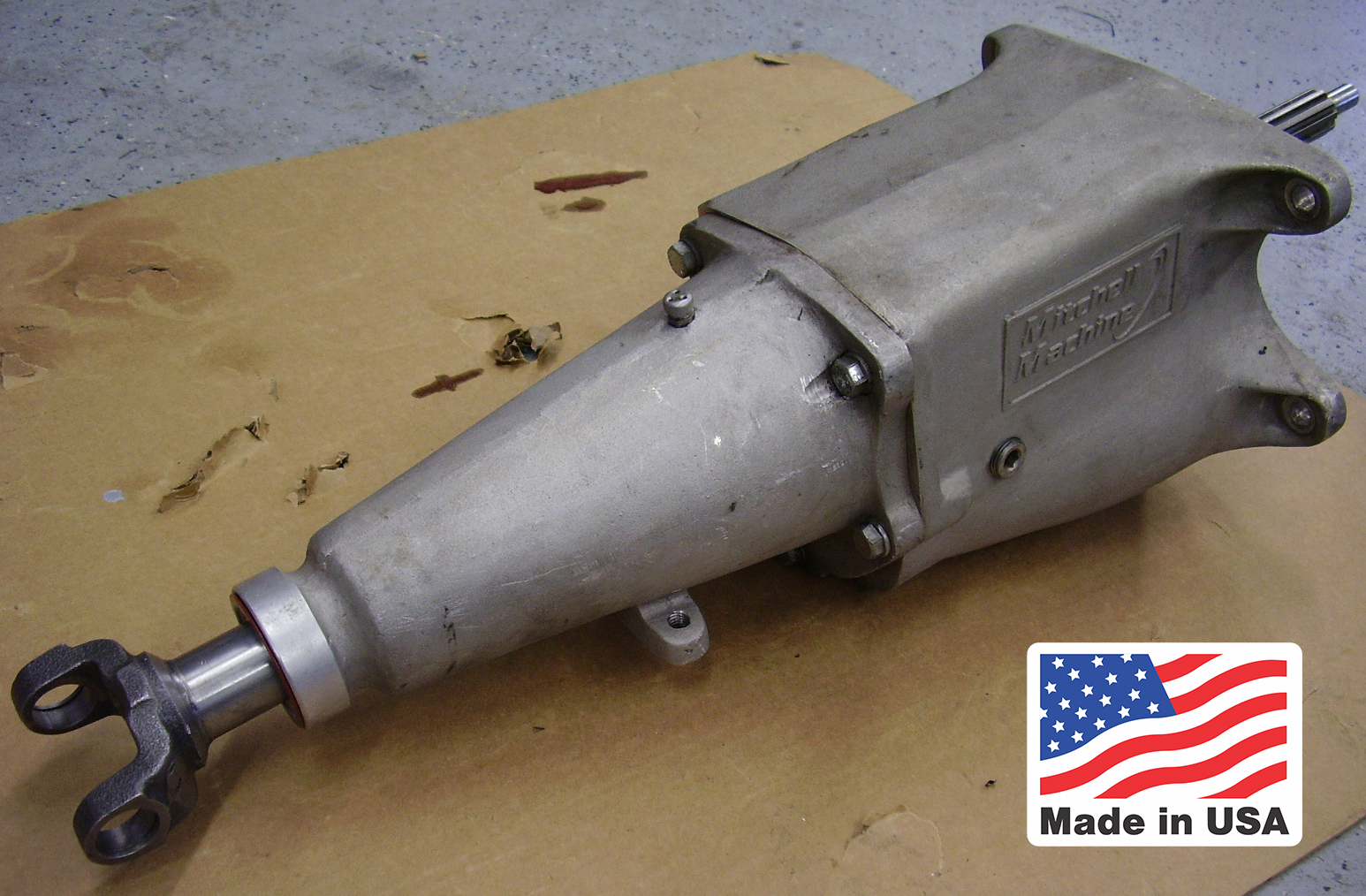

  18. jimmy six
    Joined: Mar 21, 2006
    Posts: 17,058
    jimmy six
    1968-up not sure on which year had a 3-speed with a floor mounted shifter with a V8 a friend bought a new one pretty basic but it’s what it had.
    There is an aluminum case 3 speed “Saginaw”made for circle track racing. Mitchell Machine makes them in Iowa.They are called the Mitchell Bullit. The case “appears” as stock but has thicker ears and takes all stock parts. 1st is removed on the cluster so it has reverse, 2nd, and 3rd. All the gears have been narrowed. 2nd is for moving around in the pits and out on to the track; it is not for power application. We have had one in our 3000# 1/2 mile car for 8 years. I had him install ceramic bearings also. IMG_0398.jpeg
    X-cpe and 1Nimrod like this.

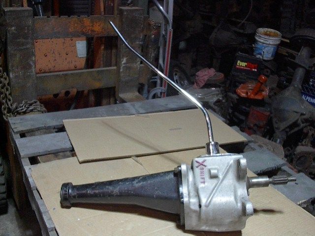

  20. Gofannon
    Joined: Feb 8, 2007
    Posts: 993
    Gofannon
    X-Shift. Aluminium case for GM 3 speed internals.
    1Nimrod and jimmy six like this.

  22. 1Nimrod
    Joined: Dec 11, 2018
    Posts: 738
    1Nimrod
    Looks like my 63 C10's original short tail shaft iron case Muncie M318 ****** with the tapered front shaft, I see the X has the Shifter on top going into the ******, C10's M318 has the two side linkage shifting rods. If I remember right Butch said the nickname for the stock 63 C10's M318 is "the peanut ******" bcuz of it's small size and being a light duty ****** (for the C10's.)
    That X-Shift is a cool looking 3 speed ****** $$, it would work great for the Jr Drag Racers.
    Dustin
    Tickety Boo and TrailerTrashToo like this.

  27. jimmy six
    Posts: 17,058
    jimmy six
    The Mitchell aluminum case accepts ALL stock Saginaw gears, spacers, shafts, etc: You can contact him and I’m guessing he can ***emble one for the street or possibly sell you a case and tail housing. He’s a business man and his business is building and selling transmissions a**** other things..
    1Nimrod likes this.
