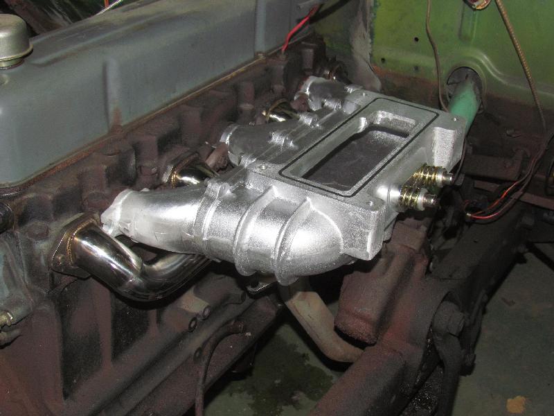

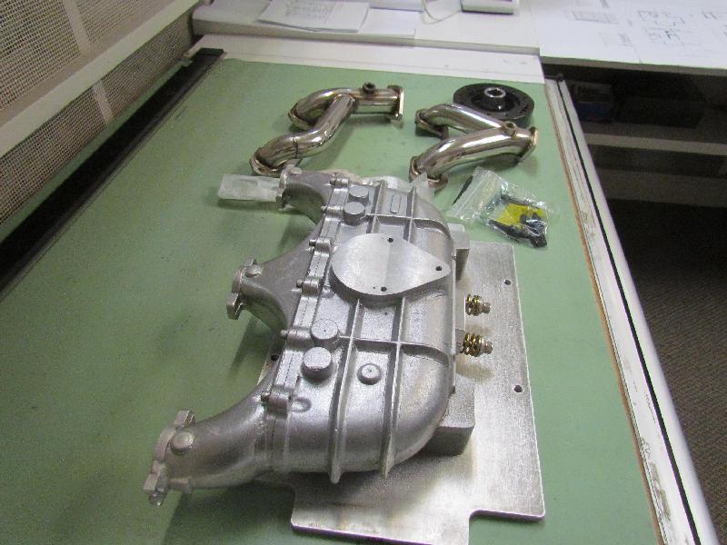

    Mockup of my current 4-71 build

    OMG! What manifold is that?!

    ^^^^ I would say a 1 off prototype,
    Looks to be straight 6 chevy?
    Can not make out name on valve cover & only 4 bolts .
    LAROKE and Desoto291Hemi like this.

    It is a manifold from James Larrowe of JJ Inlines on a 235 Chevy stovebolt. He also set me up with the blower, headers, double-keyed crankshaft and a mul***ude of other related goodies. The valve cover is a Thickston repop.
    http://www.jjinlines.com/
